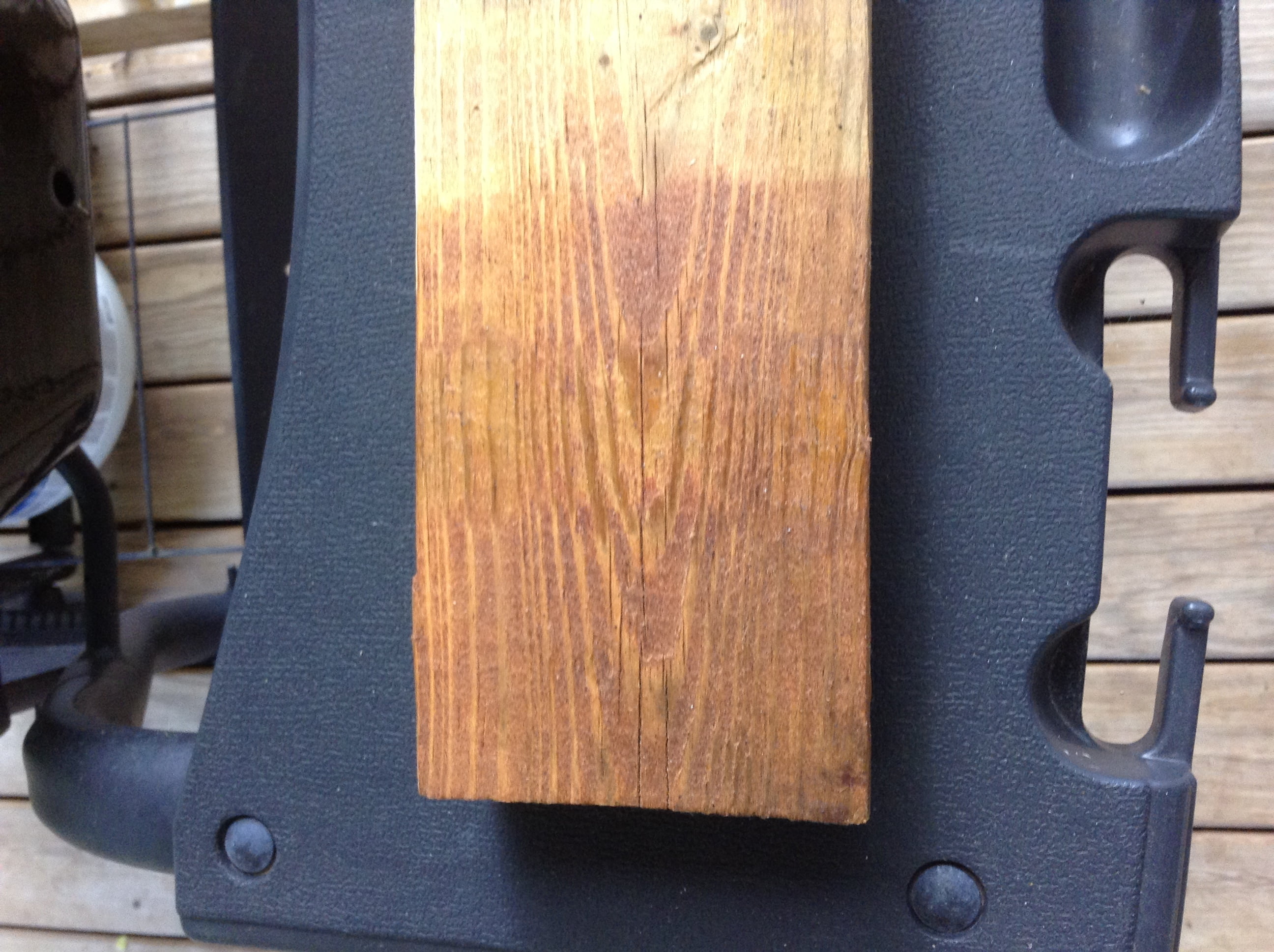

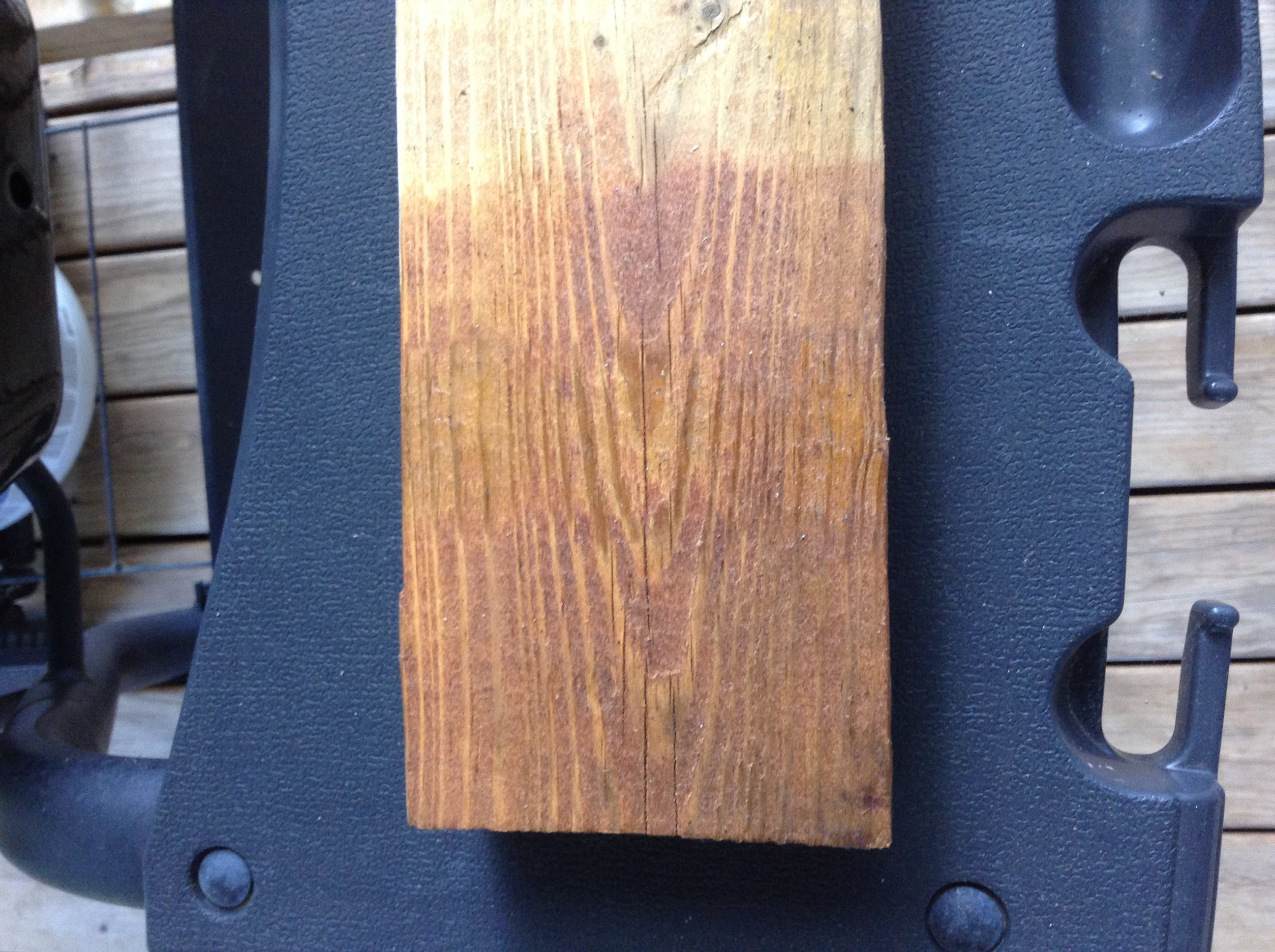

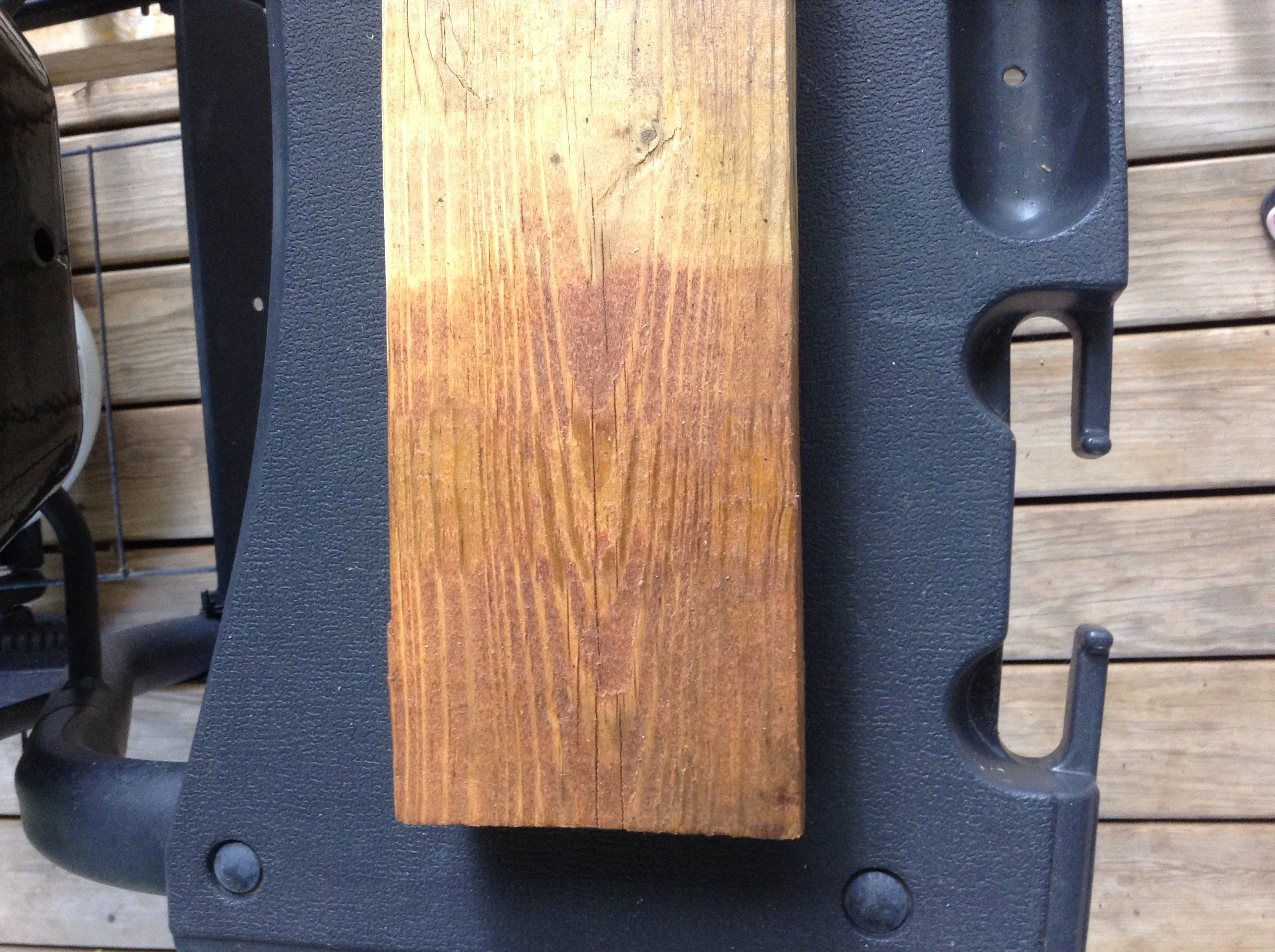

I ordered a sample of the TWP 100 Dark Oak and it is no where close to a dark brown, see photos…
I was wondering if it’s possible that the sample I received had the wrong liable on it?
When using a semi-transparent stain color like this, the final will vary based on the age of the wood, what type of wood it is, how many coats, how it was prepped, etc. That is more likely the reason, not the stain samples itself.

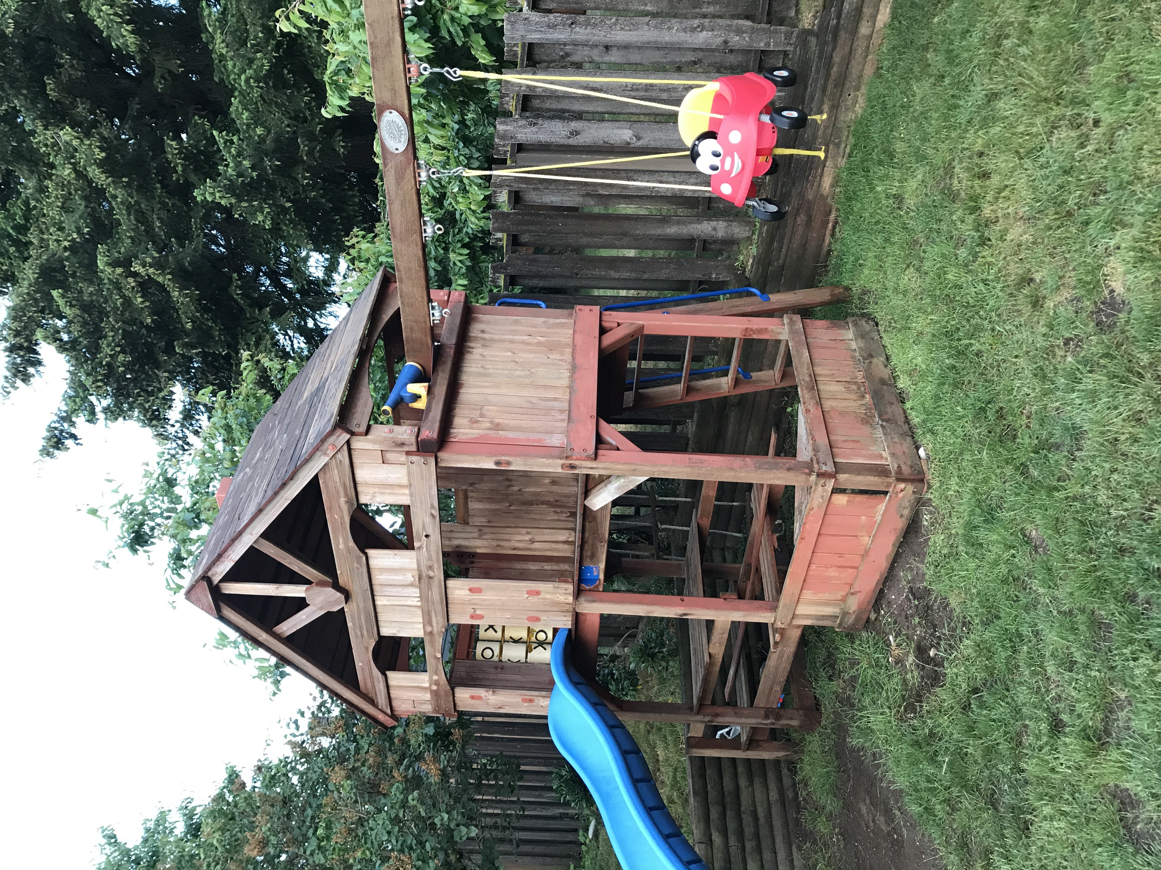

I am refinishing a wooden play structure that was previously ‘stained’ with a solid colour. I live on Canada’s west coast: wet winters and hot rainless summers (the new norm). I am looking to use a transparent product that will protect the wood from moisture, Mold/algae, and UV. Can you recommend a product? I don’t see TWP in any of my local stores; thoughts on where in Canada you can find it? What would you recommend second?
-I’m still working on stripping the old finish 😉
TWP is not sold in Canada. Most quality brands are not sold in Canada and not sure what you can buy locally. You will probably have to sand to remove all of the solid stain.

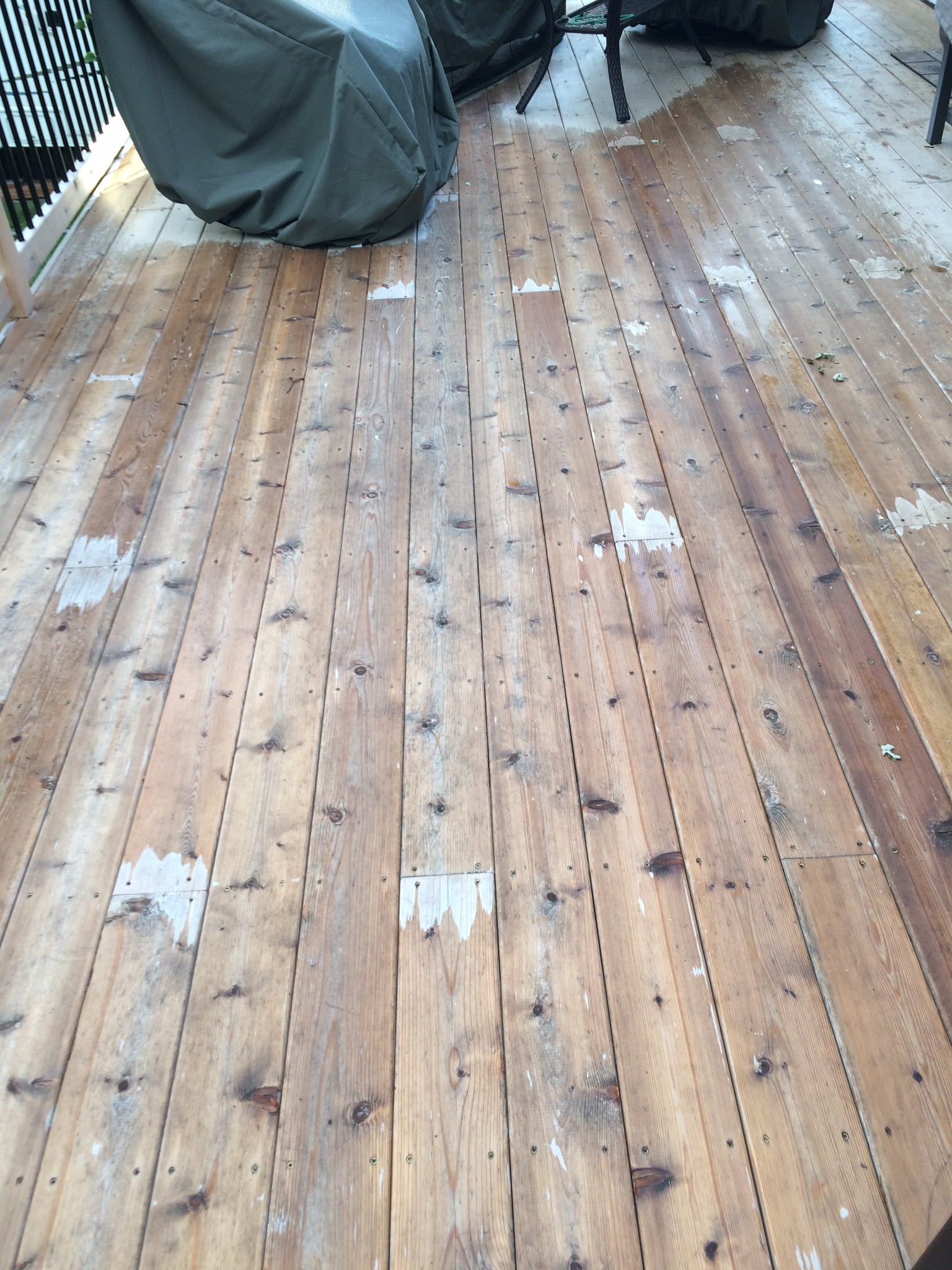

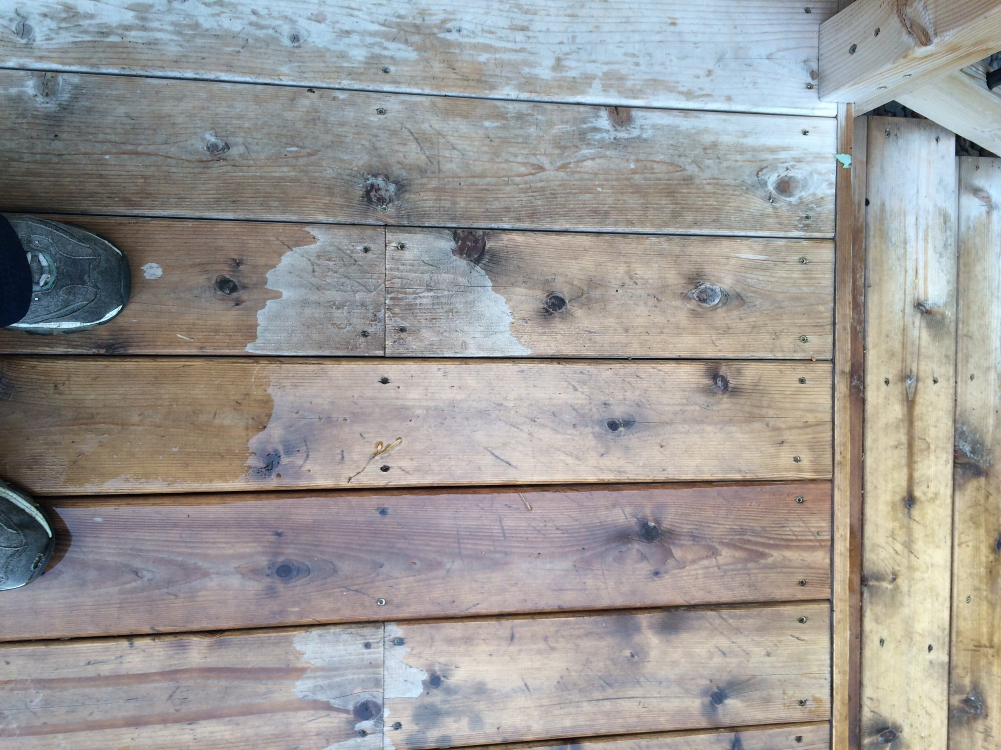

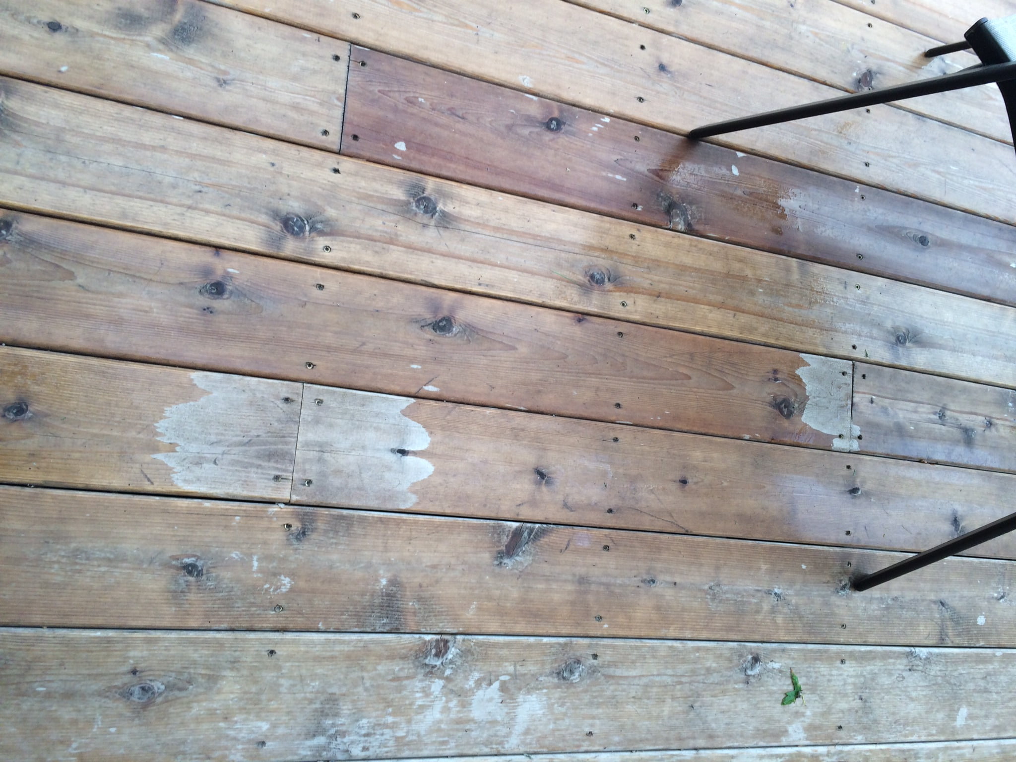

Hi! I have a brand new cedar deck, now 8 months old and am planning on using this oil based paint. I have a worry though, there appears to be a wax build up at the edges of the boards. (Please see photos). If I follow all the proper guidelines for cleaning the deck and then follow with the clear oil based paint is it going to still show through or will it cover it? I don’t want to spend all the time and money if this is not the proper route to take to cover the area. Please let me know your thoughts?
It will most likley show through unless you remove it first. Not sure why it is there in the first place? Sanding or stripping may be needed.

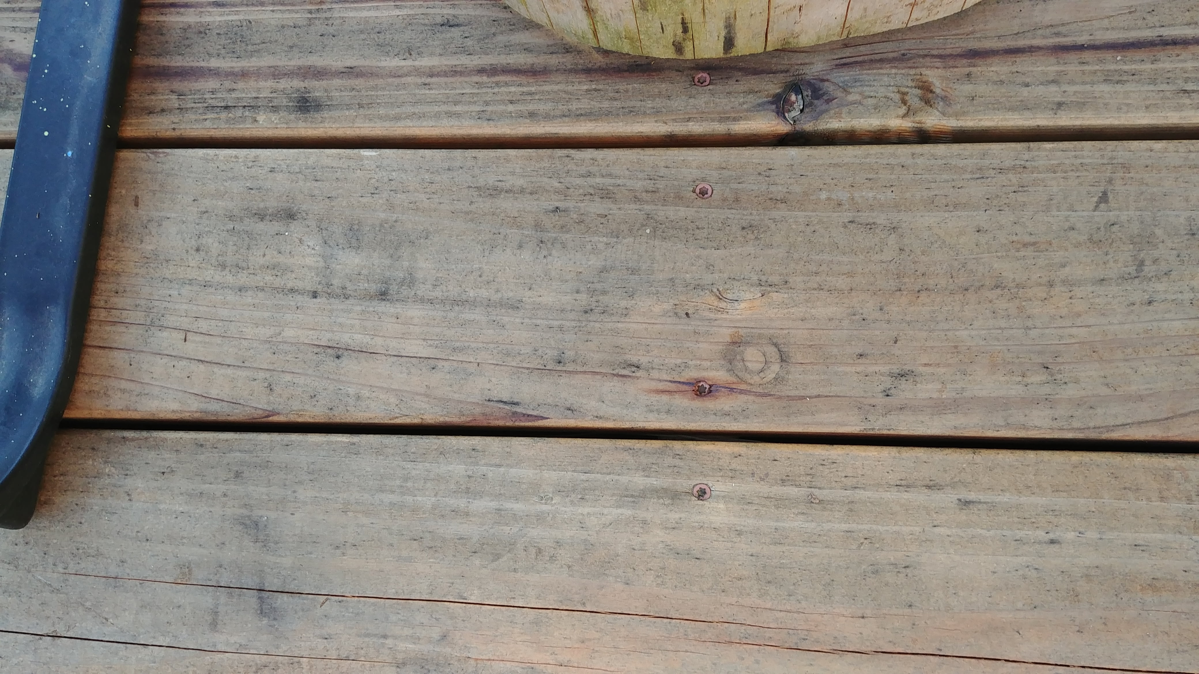

I made the mistake of putting Rust-Oleum Restore on my treated wood deck and it peeled after one year and looks terrible. I have scraped it off and now i’m sanding what wouldn’t come off, however it seems some of it is embedded in the grain. My plan is to sand it and go over it with cleaner and power wash and then stain it with TWP 100. Any suggestions?
You must remove 100% of the current products before using the TWP. If you can get it all off, you are good to use the TWP. Sanding is the only way to remove all.

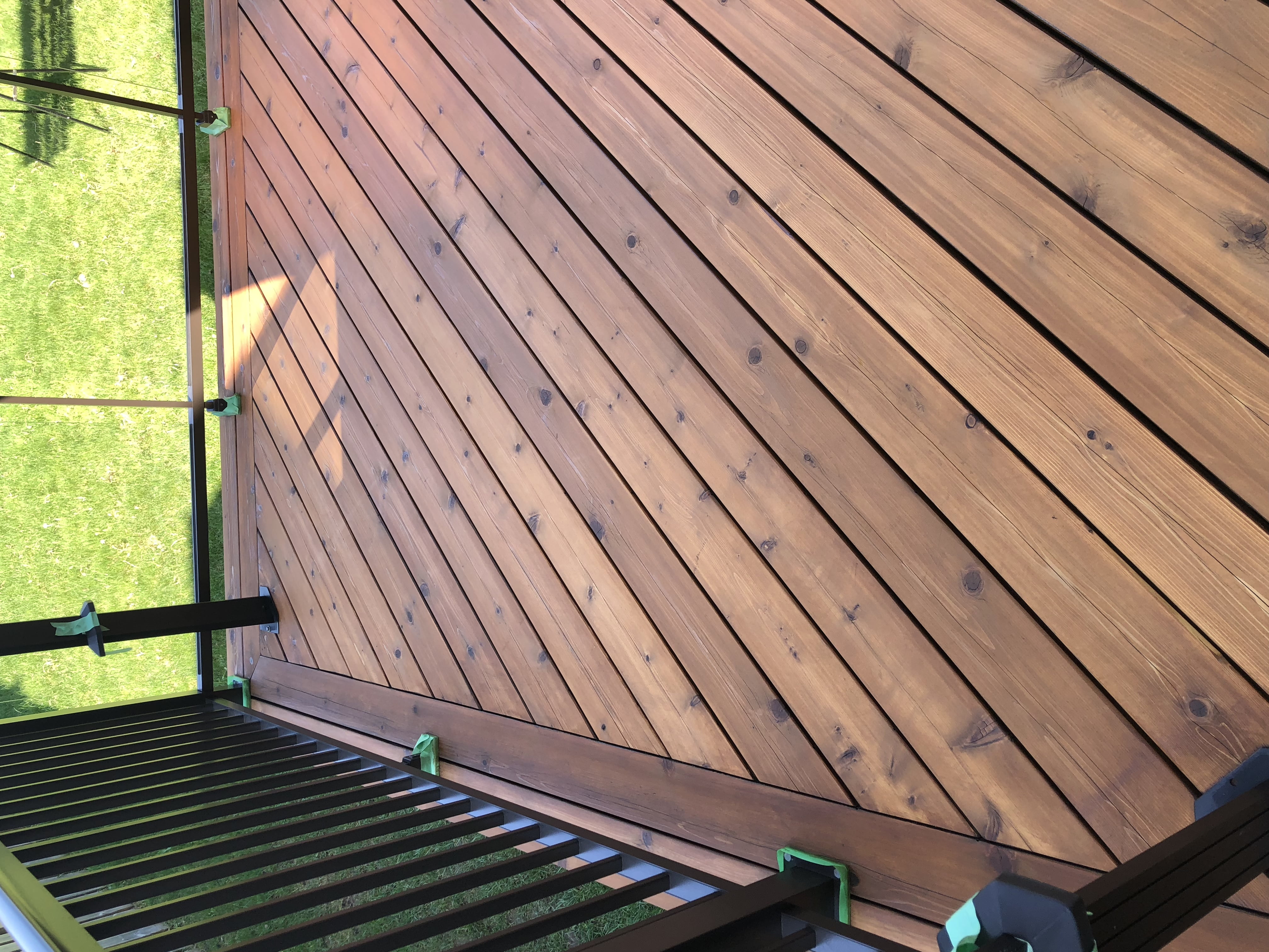

I stained my cedar deck with twp 100 and wiped off any stain that was not soaking in do you recommend me putting another coat on or does it look good?
Looks great! Leave alone. More is not better.
May I ask what color stain you used? That looks awesome, just what I’m looking for. Thank you
Looks like Pecan 120.
Pecan 120
What color is that looks great

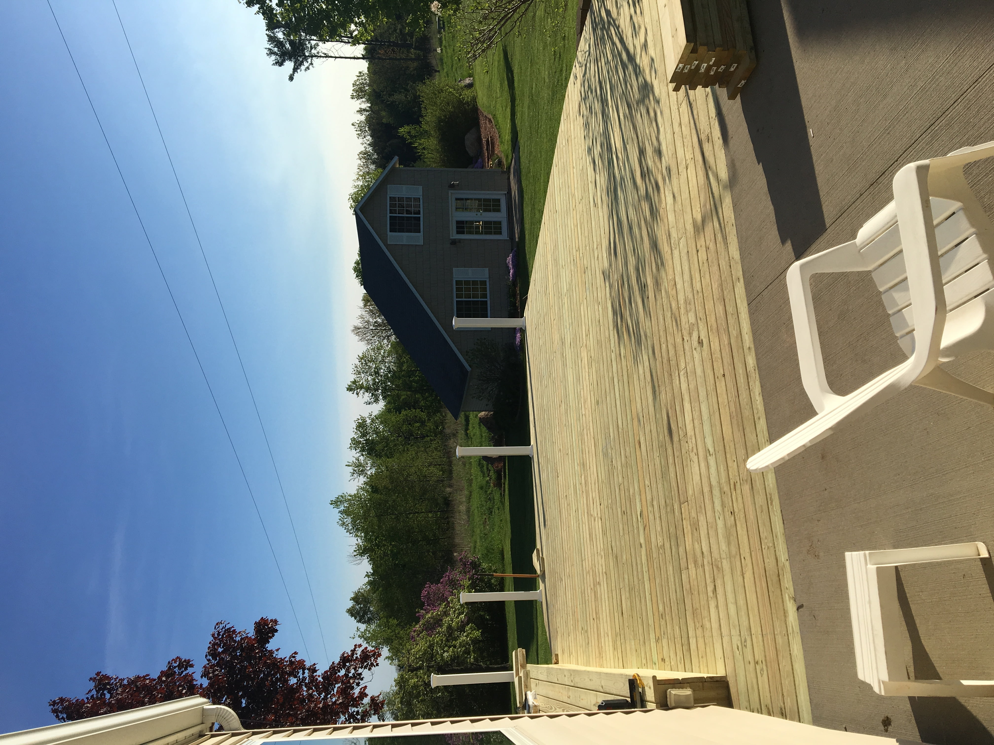

I live in Northern Michigan and just had new decking put on my deck (Pressure treated pine) . It receives full sun. But we do get lots of snow in the winter. What stain should I use? I was planning on staining it in September. I always used a Sherwin Williams Timeless stain on my old deck but it was 30 years old and I had many cracked and split boards.
The TWP 100 Series would be a great choice for MI. Make sure to clean and brighten before applying. Just one coat of the stain.

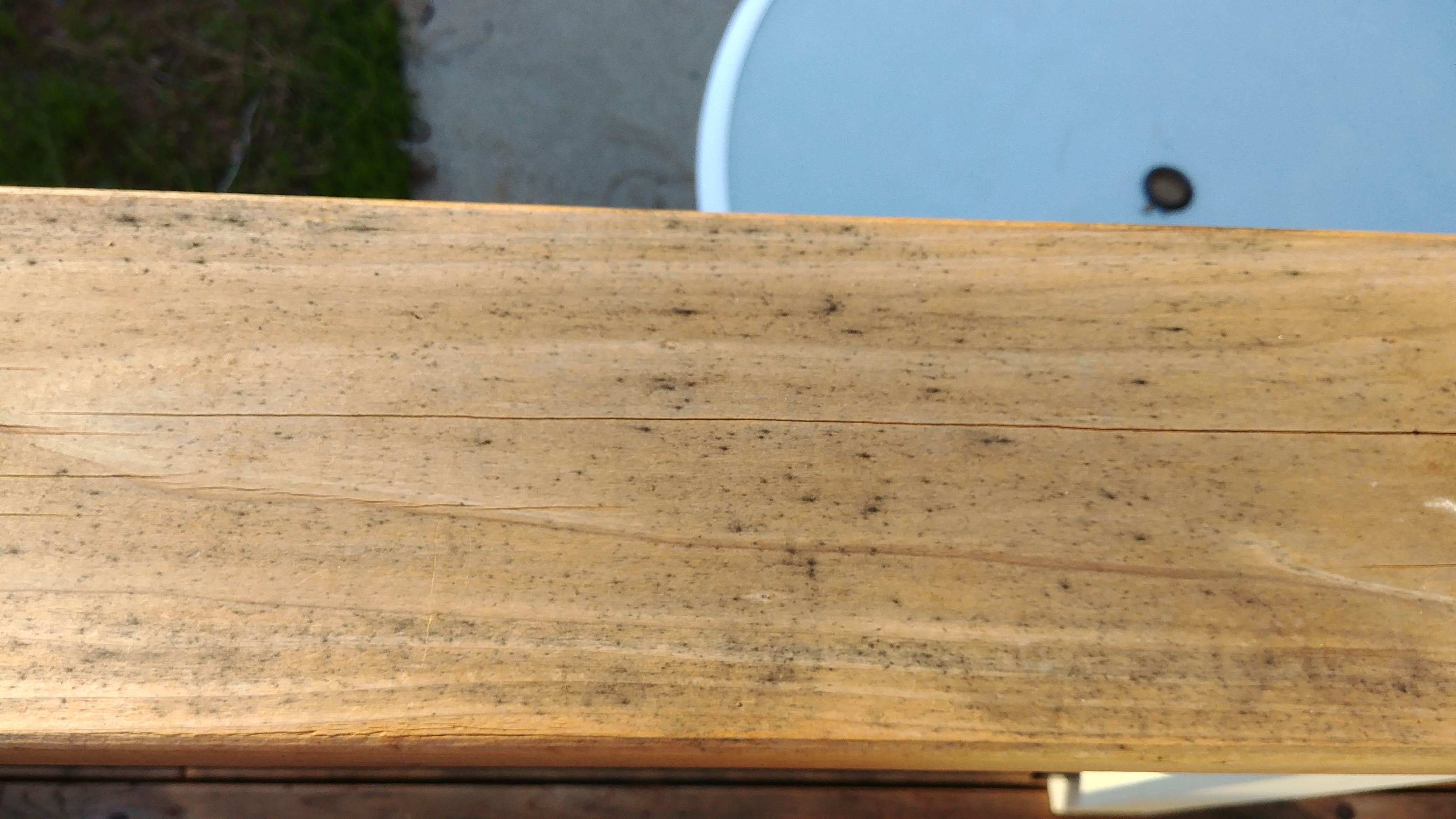

Entire redwood deck is covered in Mildew after less than 1 year. What ia the warranty?
Hi Janice. TWP contains a mildewcide that prevents the growth of mildew in the stain but a deck stain cannot stop mildew from growing on top of the stain like it is in your pictures. The mildew issue is not related to the TWP but your environment. Doesn’t matter what brand of stain you use, you will still have mildew forming on top based on your environment.
my deck did same thing but with the Flood-CWF product. It looked great at first, but the mold went nuts. I’ve Sanded the boards down to fresh wood. I’m looking for good product to seal again. I might have to do the shou sugi bon method?

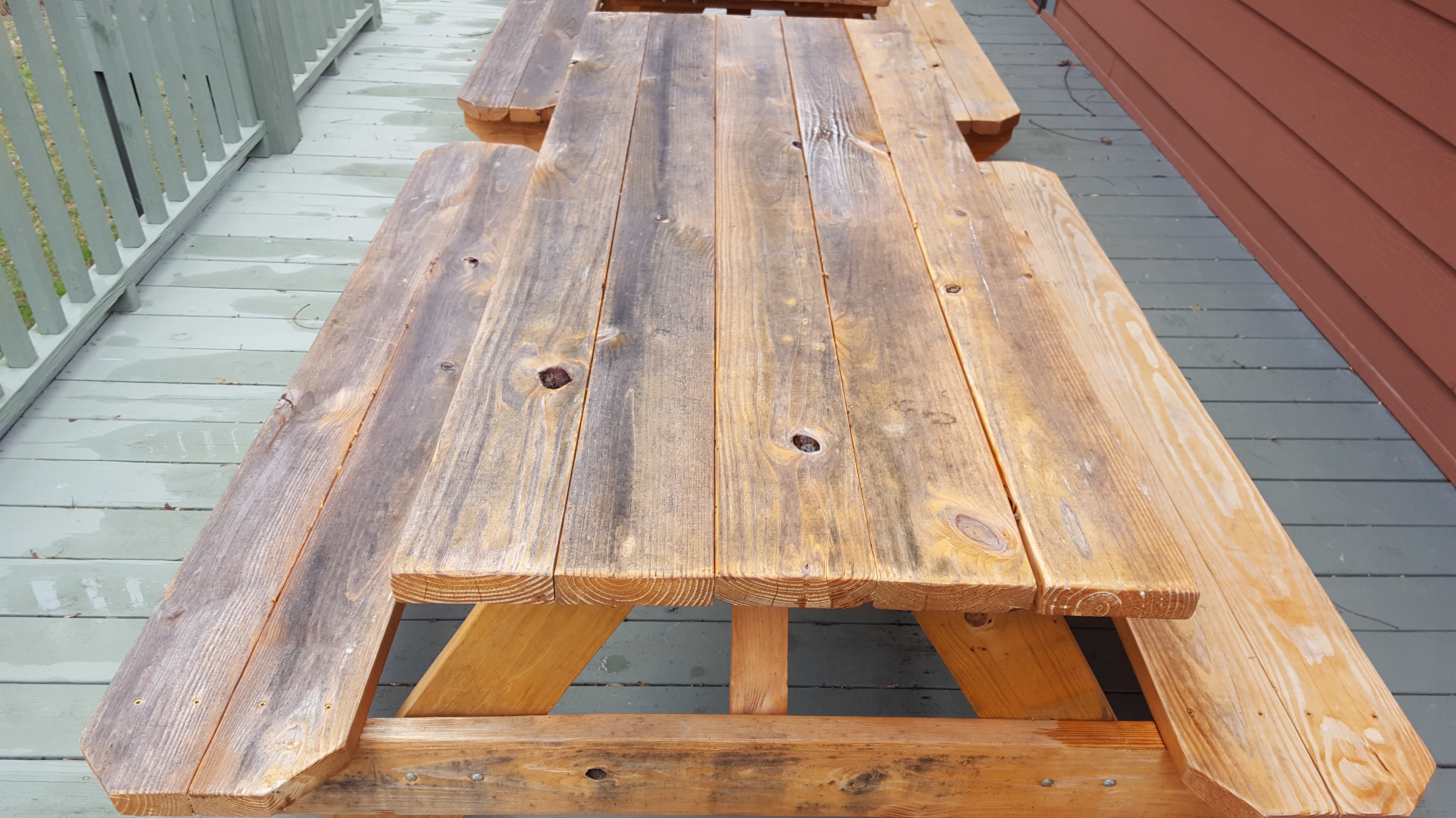

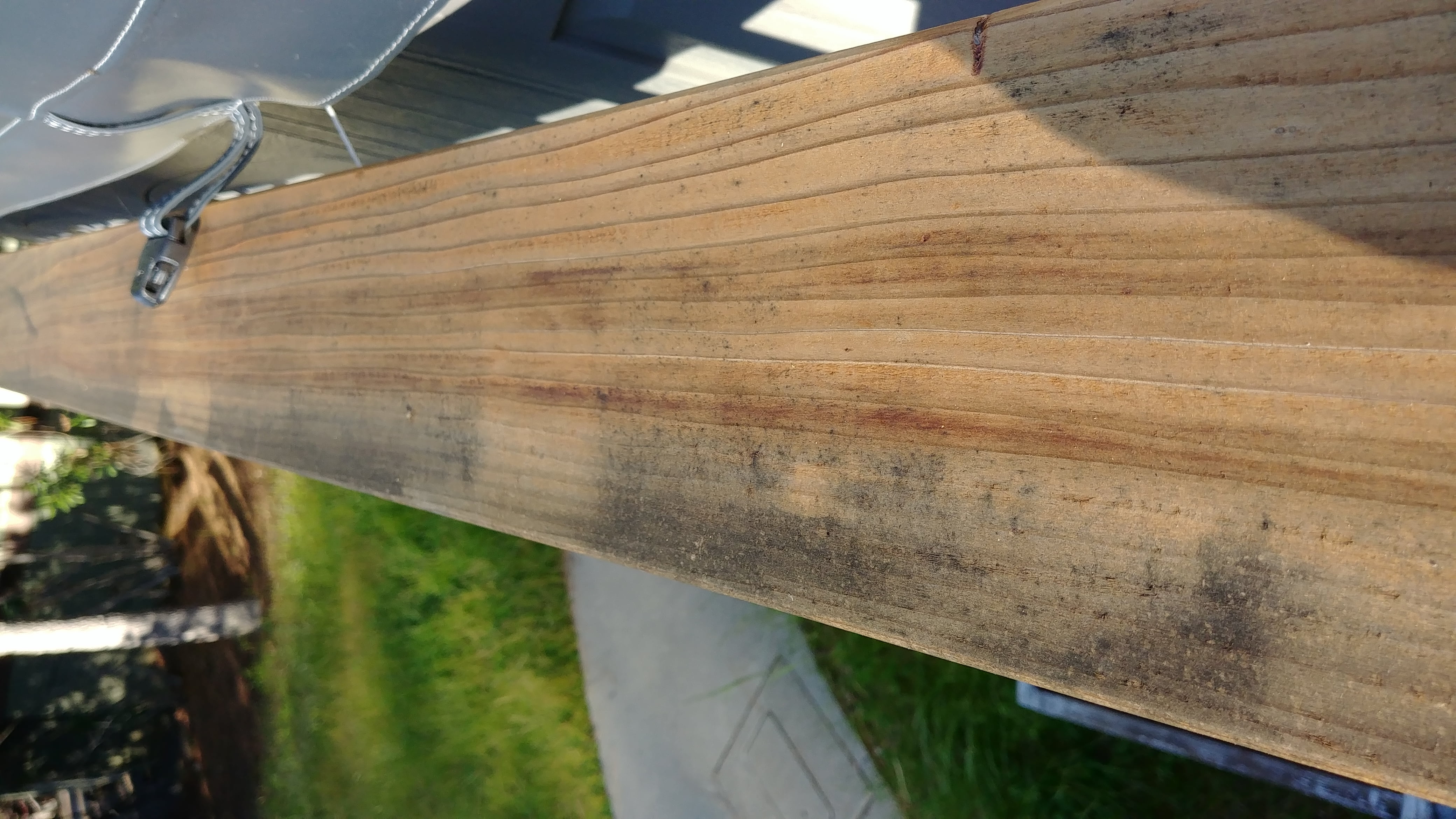

Could not be more DISAPPOINTED in this product. After one year my log Adirondack chairs and picnic tables look terrible. I thought after reading tons of reviews, I thought I found a decent product that would at least last 2-3 years.
Did you apply the TWP to new wood without prep? It looks like you may have. TWP requires 4-12 months of natural weathering and prep before staining new wood.
