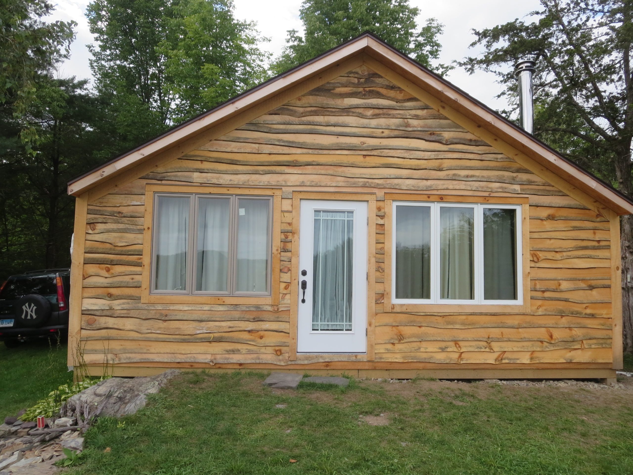

We have made an outdoor pavilion with an exterior consisting of walmanized wood with a ceiling made of knotty pine. What would be the best stain preservative with a medium brown color to use on this
The TWP 100 Series would work well. Look at the Pecan color.

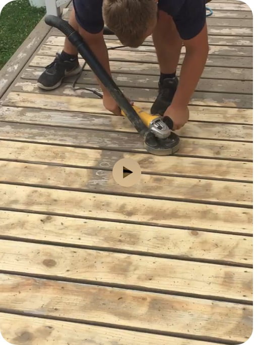

Hi. I previously stained my 25 year old, wrap-around deck with Deckscapes solid alkyd stain. It peeled within two months under chairs. It didn’t last a year before breaking up and peeling. We let the decking go for 6 years. We decided to tackle the decking this year. I tried removing a small section of this rubber film with an ASR stripper with no success. I called others to hire this out, but the cost quotes were astronomical. Then I found diamabrush. The diamabrush removed the rubber film and cut deep enough to remove several layers of old stain. But the groves or sides of the boards remained covered with this solid stain. Then we found an attachment for an oscillating grinding tool that fit in the groves and cleaned the top edges and sides of the deck boards. Finally we went over the face of the boards with an orbiting sander using 40 grit sandpaper. Very labor intensive. We are going to use the same solid that was on the rails until we chang out the railing boards. Here’s my question: after all this prep do I still have to use a cleaner or brightener? I intend to stain the flat boards with TWP 100 series stain. I’m hoping for the easiest maintenance path to take. Thank you for your support. I spent a lot of time researching on your site. First picture shows deck condition before any work. Middle picture shows use of diamabrush and last picture shows a portion of deck after the groves were ground. 😐 😮 😥
Yes, a cleaner and wood brightener will help to open the wood grain and swell the wood pores so the stain soaks in deeper. Right now it looks too “smooth” for the TWP to soak in as well. Overall you did a great job of removing the solid stain!

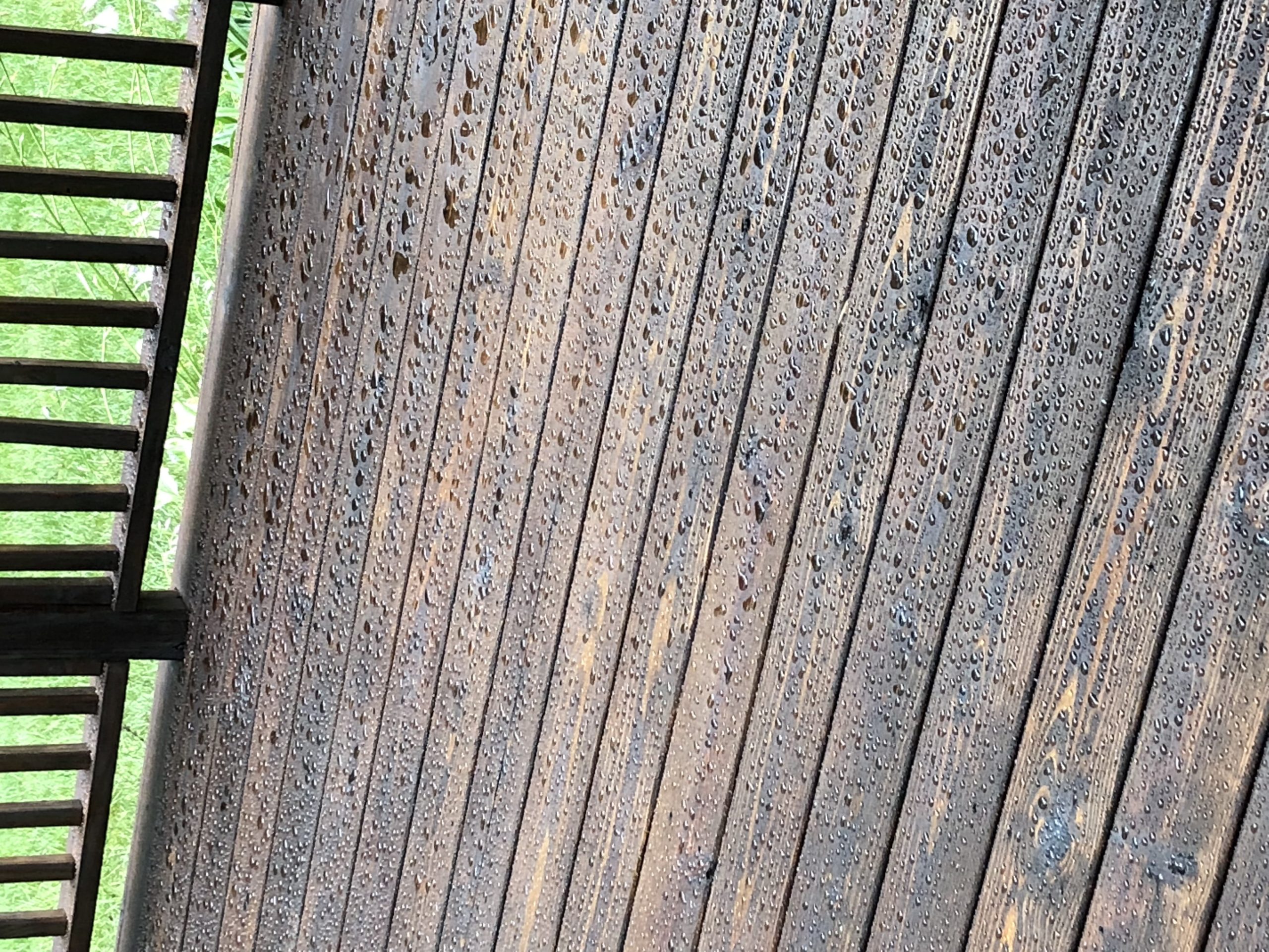

Finished staining deck with 103 yesterday afternoon at 2pm. Unexpected rain showers popped up today at 12pm. Water is pooled on surface. Should I wipe water away once rain stops? Will the finish be okay?
Leave alone. It is fine.

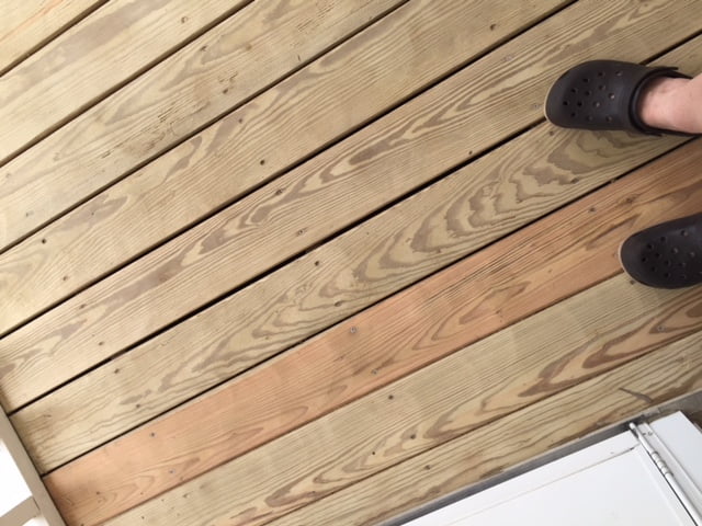

I just installed a new deck around Mid-April here in VA. Am I able to apply TWP to the untreated wood at this time? If so, what is necessary to ensure good adhesion? a deck cleaner, soap and water, bleach, etc.. it just has light foot traffic stains at this point.
And how far will product go with roughly 100 sq. ft.?
thanks!
For the prep, use their Gemini Restore A Deck Kit. Only 1 coat for new wood. One gallon covers about 150-200 sq feet.
thanks! is it too soon to prep and stain with the wood only being installed in mid April?
Yes. TWP suggests 4-12 months.
