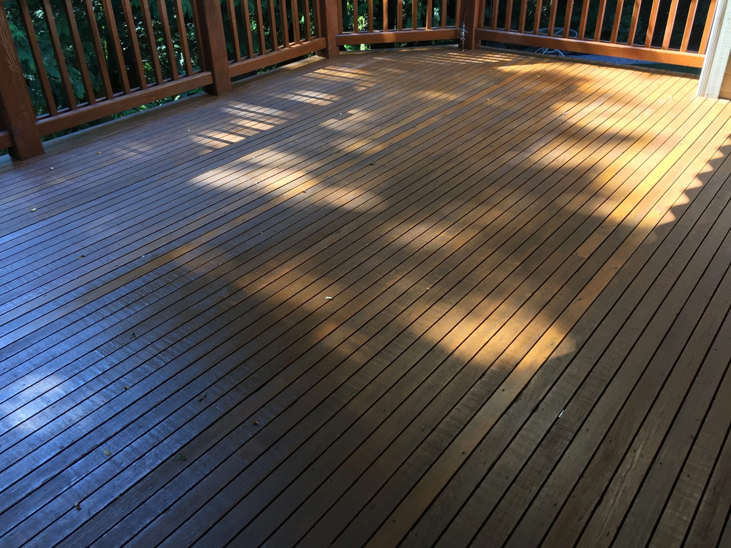

TWP 100 series stain
Used Gemini 2 part cleaner
https://youtu.be/xH6RnzN4M-c
Looks really good!

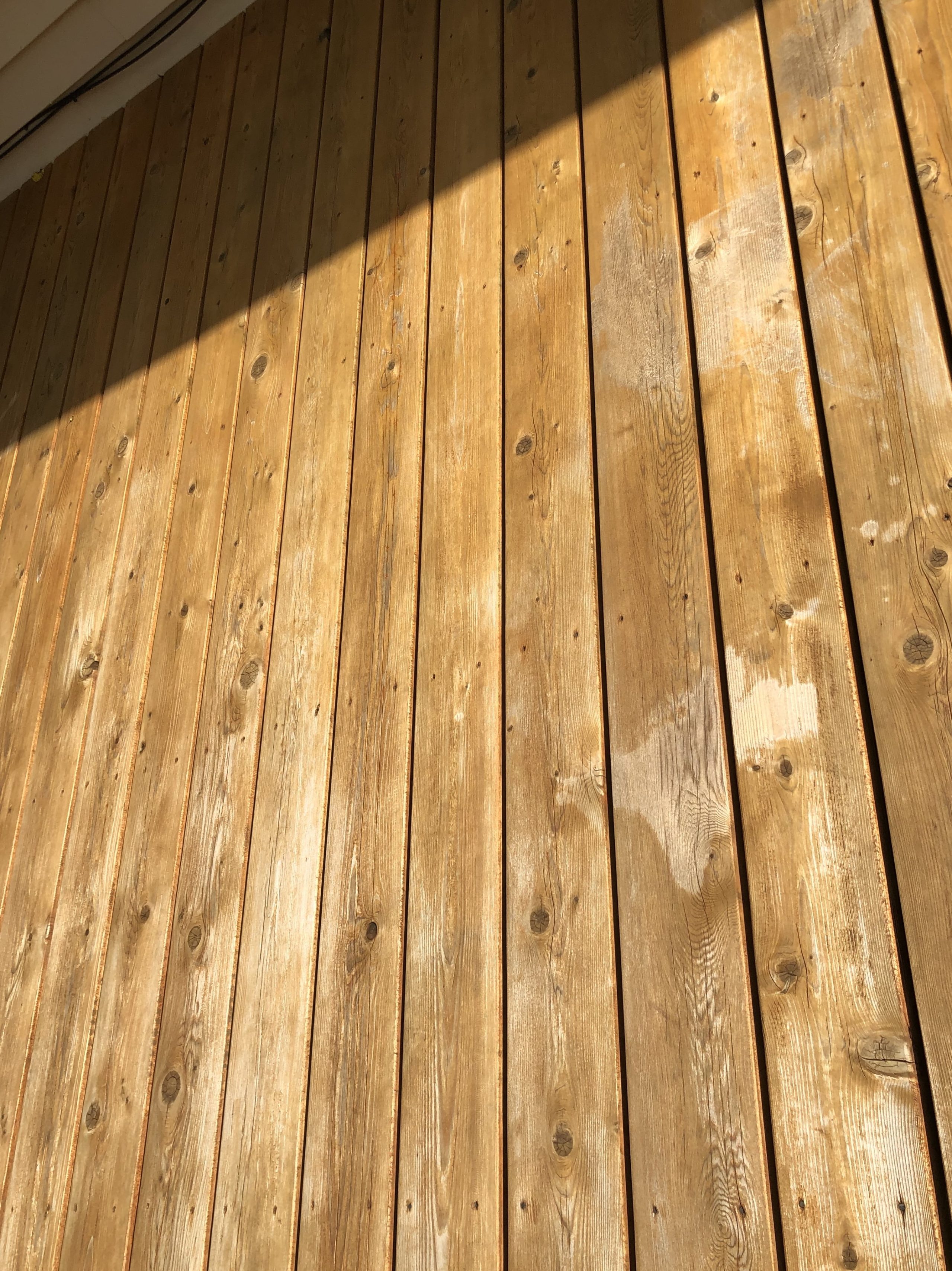

I finished cleaning, brightening and staining a 20 ur old cedar deck. On the deck floor itself, I used 3 coats of TWP 101 cedartone.
Some of the boards were more weathered than others and I’ve had a few of the floor boards replaced a few deck floor boards a few years ago. Attached pic may help.
Question is this. The deck is fully dried and some of the wood looks a little shiny ( which I like) and some of the wood is dull and looks like it could absorb more stain.
Perhaps a shiny finish is too much stain? Can you please comment on whether additional stain is recommended or to be avoided?
You applied too much. TWP is 2 coats at most and needs to be applied wet on wet. Shiny means it did not soak in fully and can prematurely fail because of this.

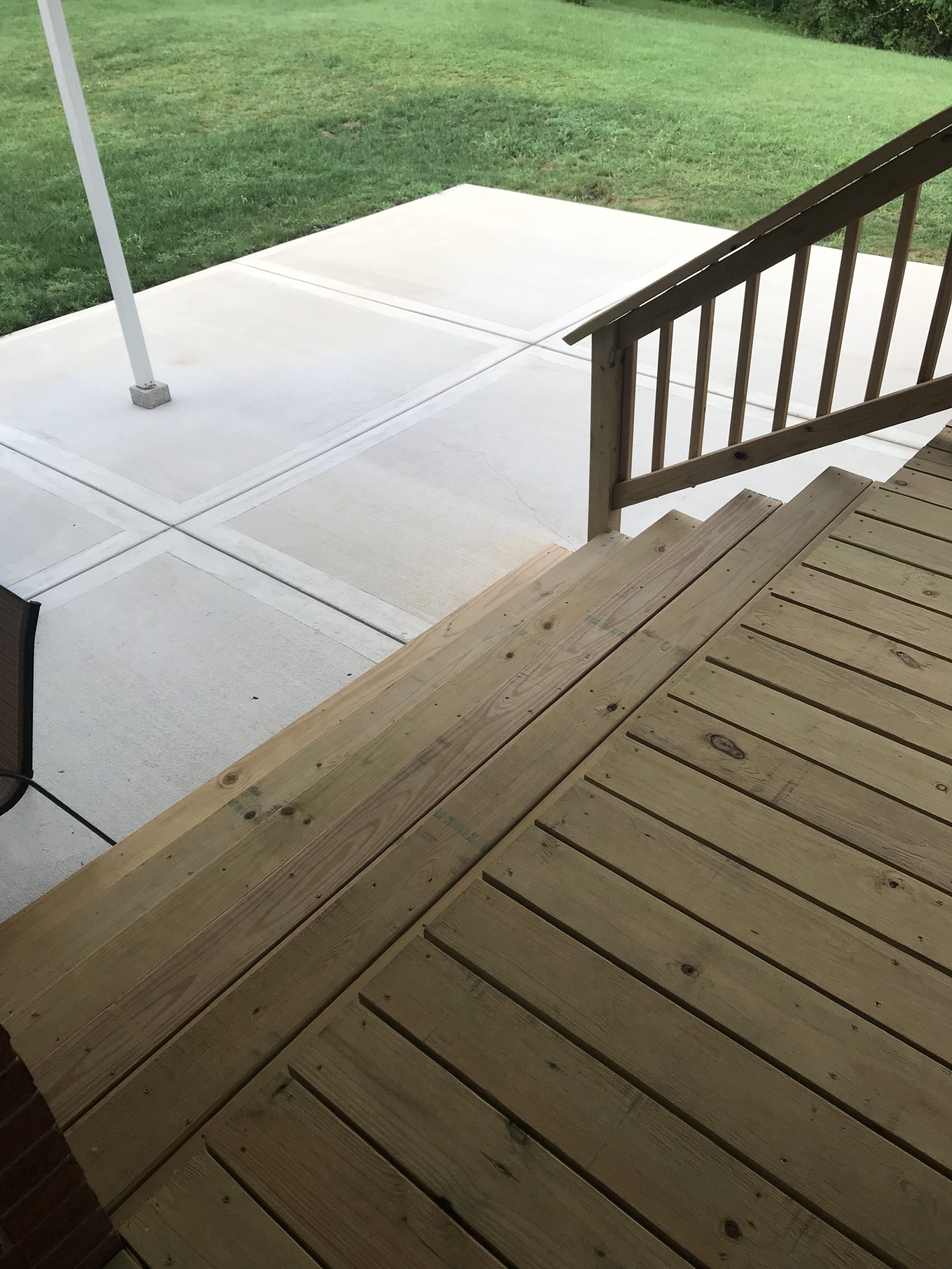

Wood TWP 100 work on new wood that has been kiln dried after treatment?
Not right away. Wait a 2-3 months and then prep first.
What would the prep consist of?
Clean and brighten the wood. Use their Gemini Restore Kit.
So do I wait 2-3 months first or do I prep first?
Wait then prep.

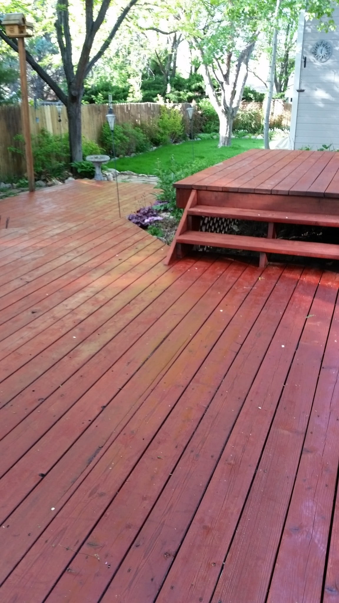

1st time staining my deck this weekend with TWP 100 Pecan. Your reviews and website helped me to go this route. AT 1st I thought you were sponsored by TWP but now I know that you are giving honest assessment. This product is excellent. It’s really dummy proof. Stain goes down well, has excellent consistency in wet form and as it dries. Really easy to wipe down. I worked in sections brushing between each board, applying with a stain pad to main surface, back brushing, waiting about 5 minutes (as I started working in next area) and then wiping off any excess stain with rags. My deck was thirsty. I know there are quicker ways to work but since I am a beginner I wanted to make sure I did this right the 1st time. I will go back in spring and apply 2nd coat knowing the main work is done. Thank you again for helping people out.
No problem, do you have a finished picture?

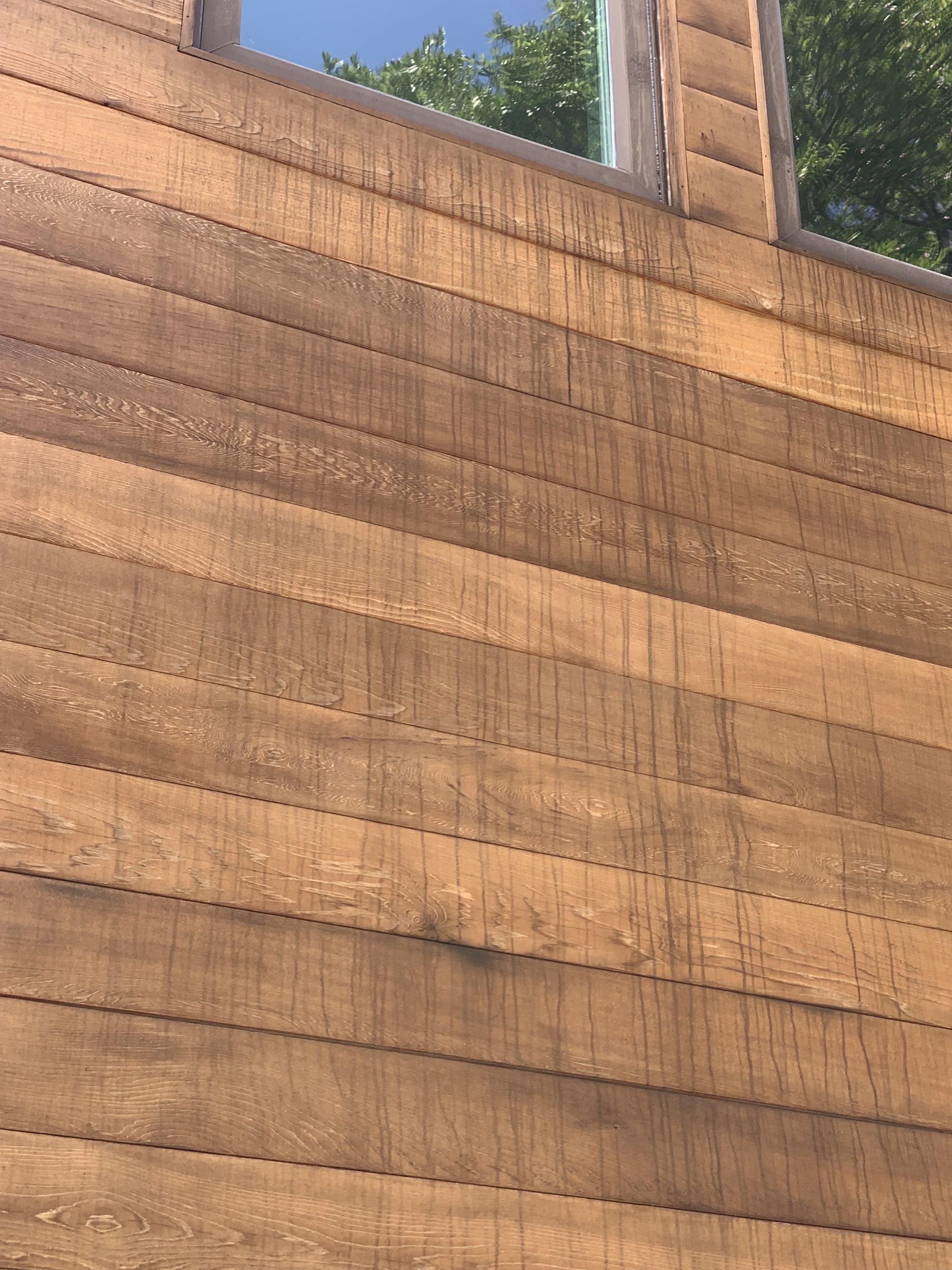

2 years ago we applied TWP 100 to our cedar wall in the front of our house (wet on wet 2 coats). A year later at the advice from this site we reapplied after a light wash. The product has held up much better than the other product but for reasons unexplained still the trim has leaded all over the wood. I guess we can sand the trim and start over. The discoloration mostly washes off with a light/moderate scrub. What would your suggestion be if we can start fresh on the trim to the remainder of wood? If we scrub the stains how would you prep for another coat? Thanks for any help.
That looks like leeching down from the window trim. It should wash off since it is on top of the wood stain. Not sure if you can prevent this from continuing to happen. Maybe painting the trim with a solid color stain might help?
Thanks. Can you provide some instruction on how to pre treat the wood prior to restaining (note this will be the third application in 3 years).
Use the Gemini Restore Kit from TWP.

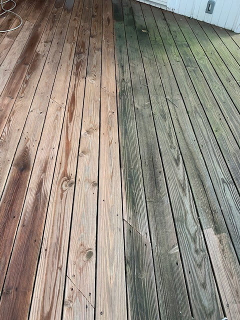

I am pressure washing my deck which is a year old and has a lot of graying.The deck is constructed of pine.I have used a cleaning product called M made by Mi-T-M corporation sold at True Value & I added about a cup of bleach to the M automatic mix on the pressure washer. I’m a third of the way done on a 12 by 40 ft deck . I just found the TWP 100 and want to apply it but want to make sure my prep will be ok the way I have already done. Will I need to do it over with Gemini Restore Kit.Prior to TWP 100 ? Thank You For any advise.
Hard to say. Best to reply with a picture of your prep to see how it is cleaning up.

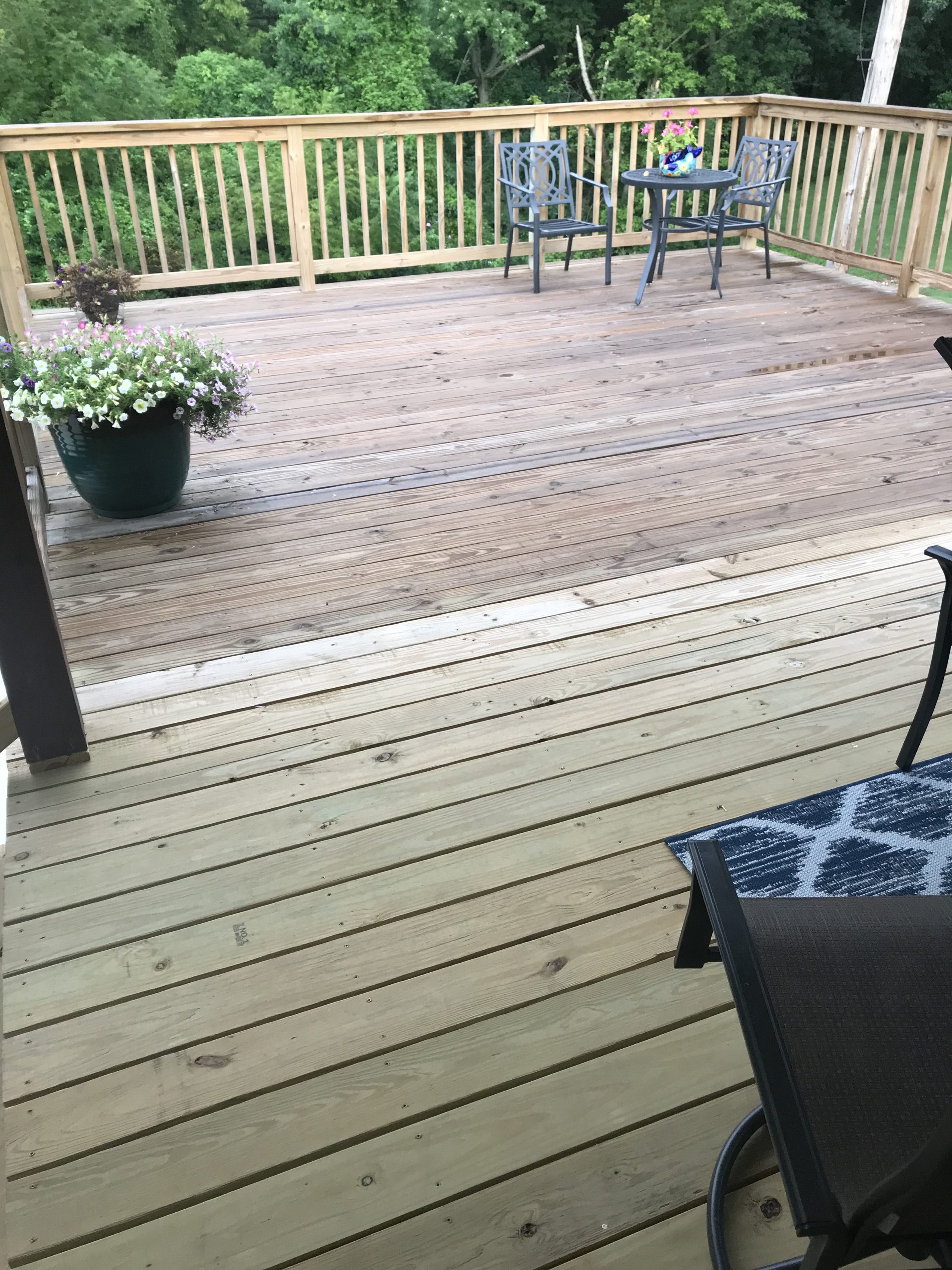

Going to apply this to new deck which has weathered 1 year. Since it has weathered so long should I go ahead and apply two coats?
Also, can I just clean & reapply in the future, I will it have to be stripped each time? Thank you!
Do the 2 light coats applied wet on wet. Clean and recoat as needed.

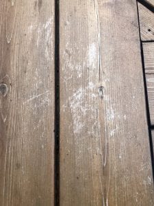

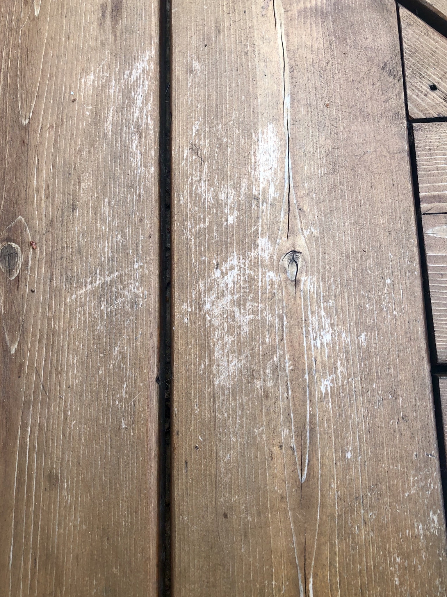

had cedar deck cleaned and two coats of twp 100 cap cod stain. Covered nice but after drying black stain bleed thru. should I keep coatind until black stain no longer shows?
Black stain? What do you mean? Was there a current stain of a different brand that you did not remove first before applying the TWP? TWP cannot be applied over a different brand of deck stain.
Same stain TWP 100 was used

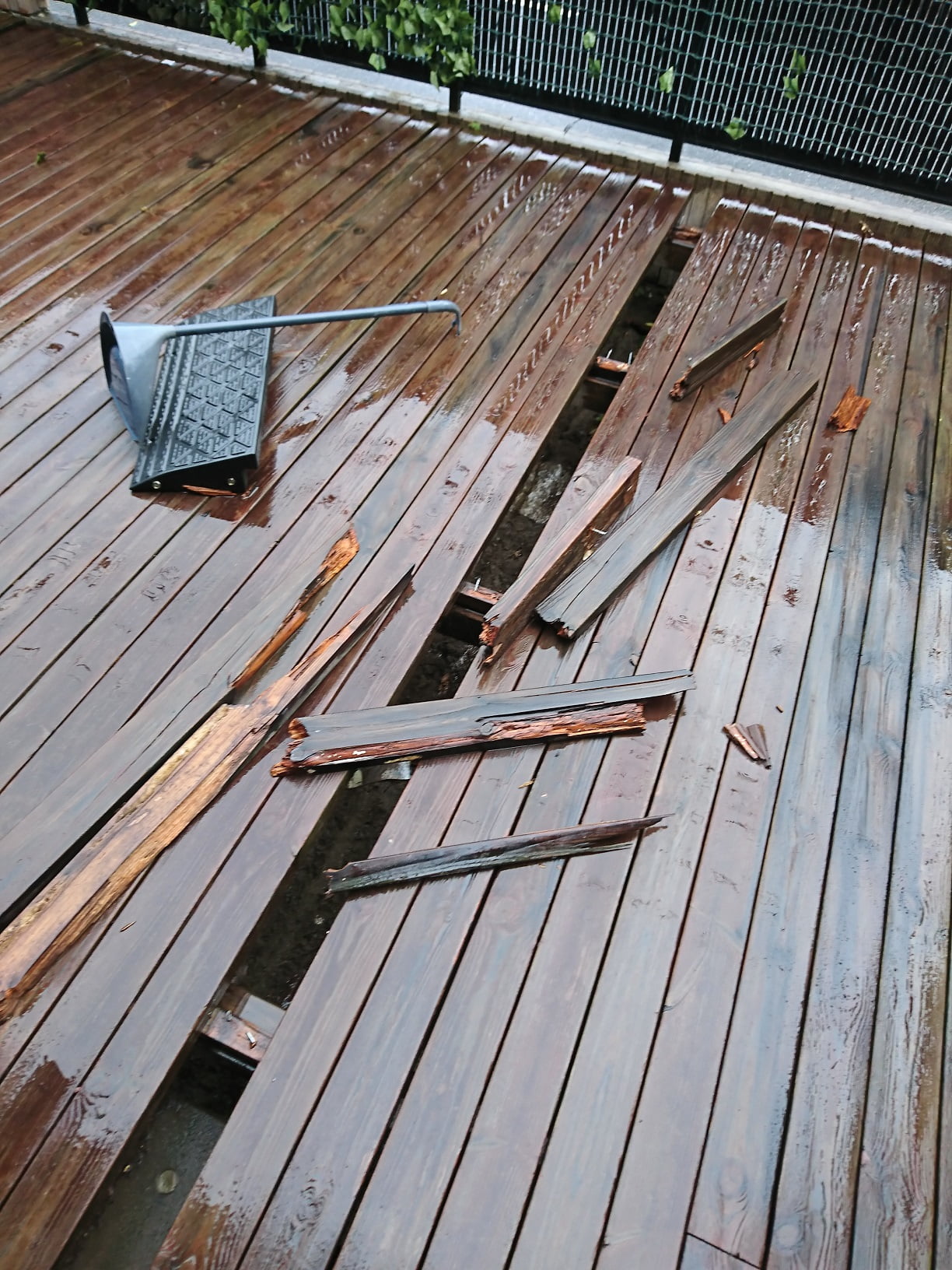

Have you heard of Thermowood decks rotting over time even after a stain was applied?
These wood products are supposed to be more durable because of the higher heat treatment though kiln drying.
This 2×4 Pine deck is 5 years old and had a stain applied 2 years ago.
All wood will decay over time. Typically 20 or so years is normal before a redecking is needed.
