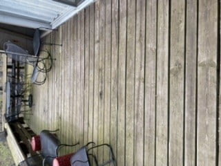

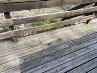

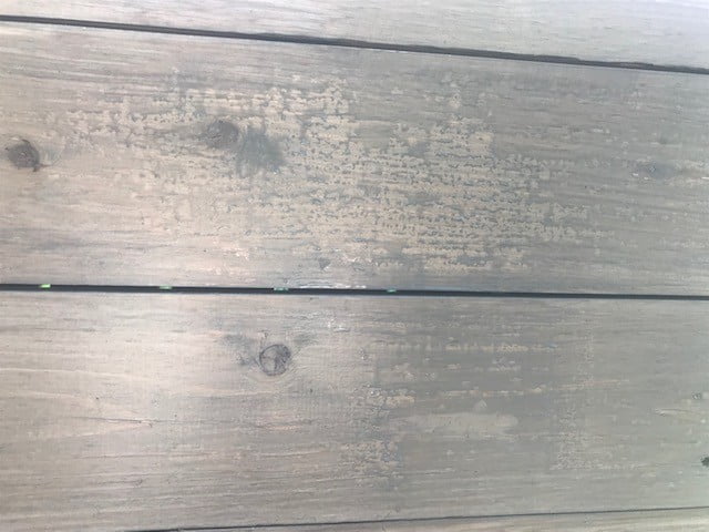

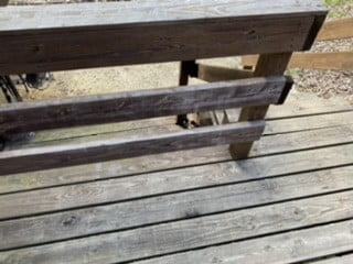

So I have a 2 year old pressure treated pine deck. I am in southern Ohio and it is south facing so it gets hit hard by the sun all day. It was stained with Olympic Elite which has faded and peeled terribly where it has been exposed to the elements. The section under the roof looks just like new! From what I have read here I think I want to use TWP 100 or the Restore A Deck. Any idea which of the two I should use based on the info provided? What is the best way to prep and what products should I use before application? Any info is greatly appreciated!!
The Olympic has to be removed first. Do you have a picture?
I can send more if you like.
Strip and brighten to remove this. Stain with TWP 100 or RAD after.

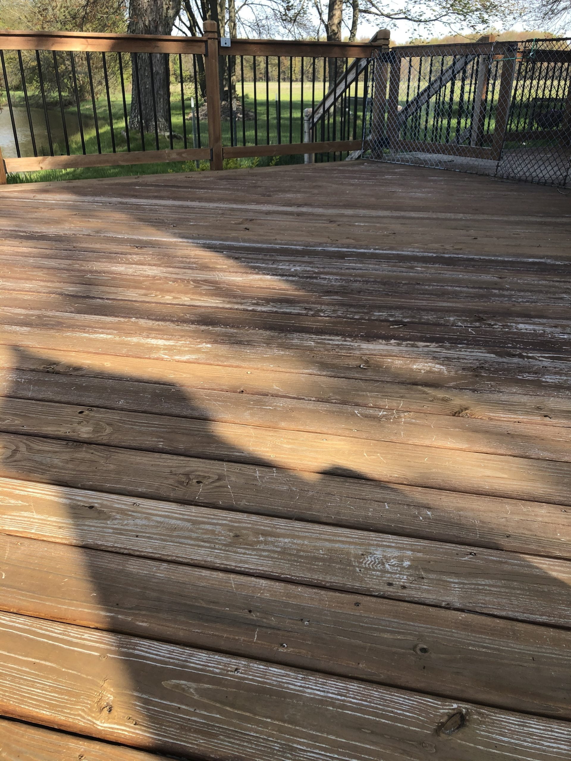

We replaced our deck floor last spring and ready to stain. We live in Missouri. The deck takes a beating from the sun. We previously used Olympic Maximum stain and seal. Our spindles are still in pretty good shape but may need to touch up in some areas. I am considering trying the TWP because of the reviews vs Olympics reviews but concerned that the stain shades may not match. Do you have to seal after staining with TWP? Our deck is massive and would prefer not to have to do that.
You cannot apply a sealer over a deck stain. No need. TWP cannot be applied over the Olympic so you would have to remove that first.

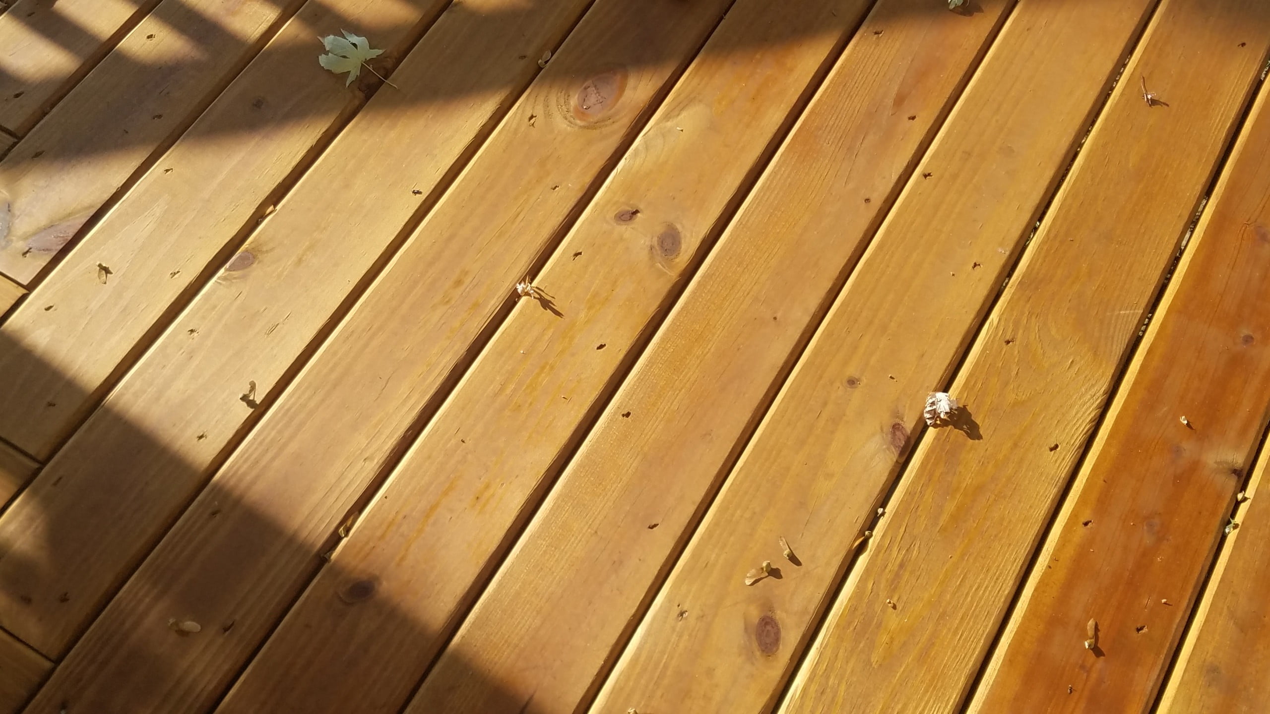

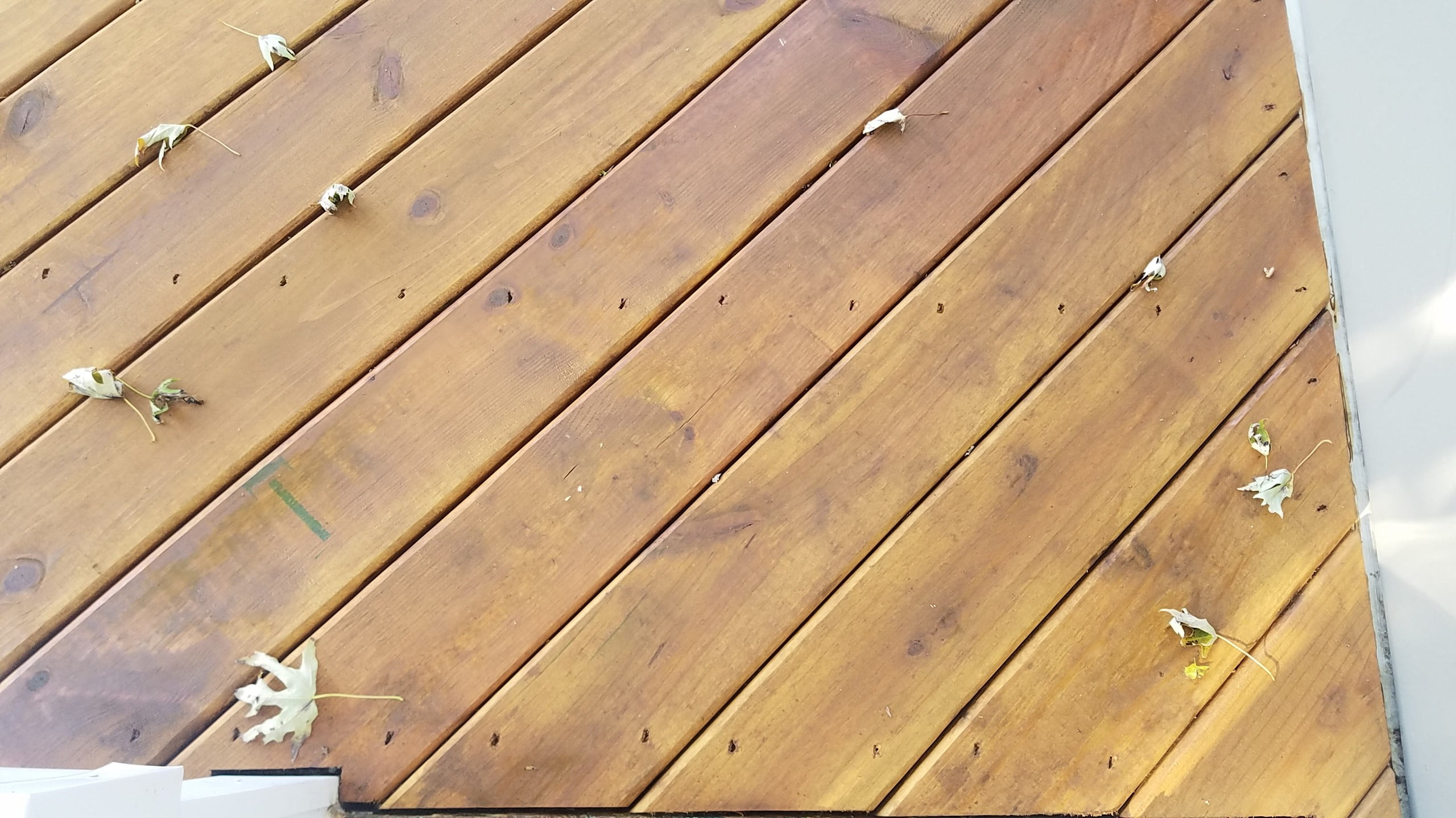

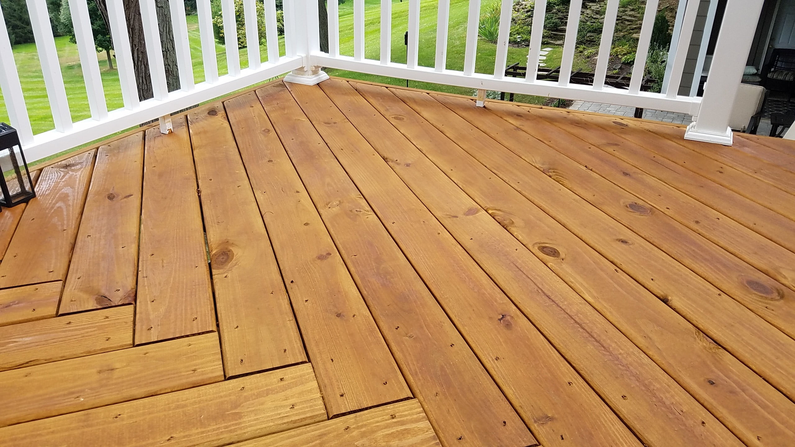

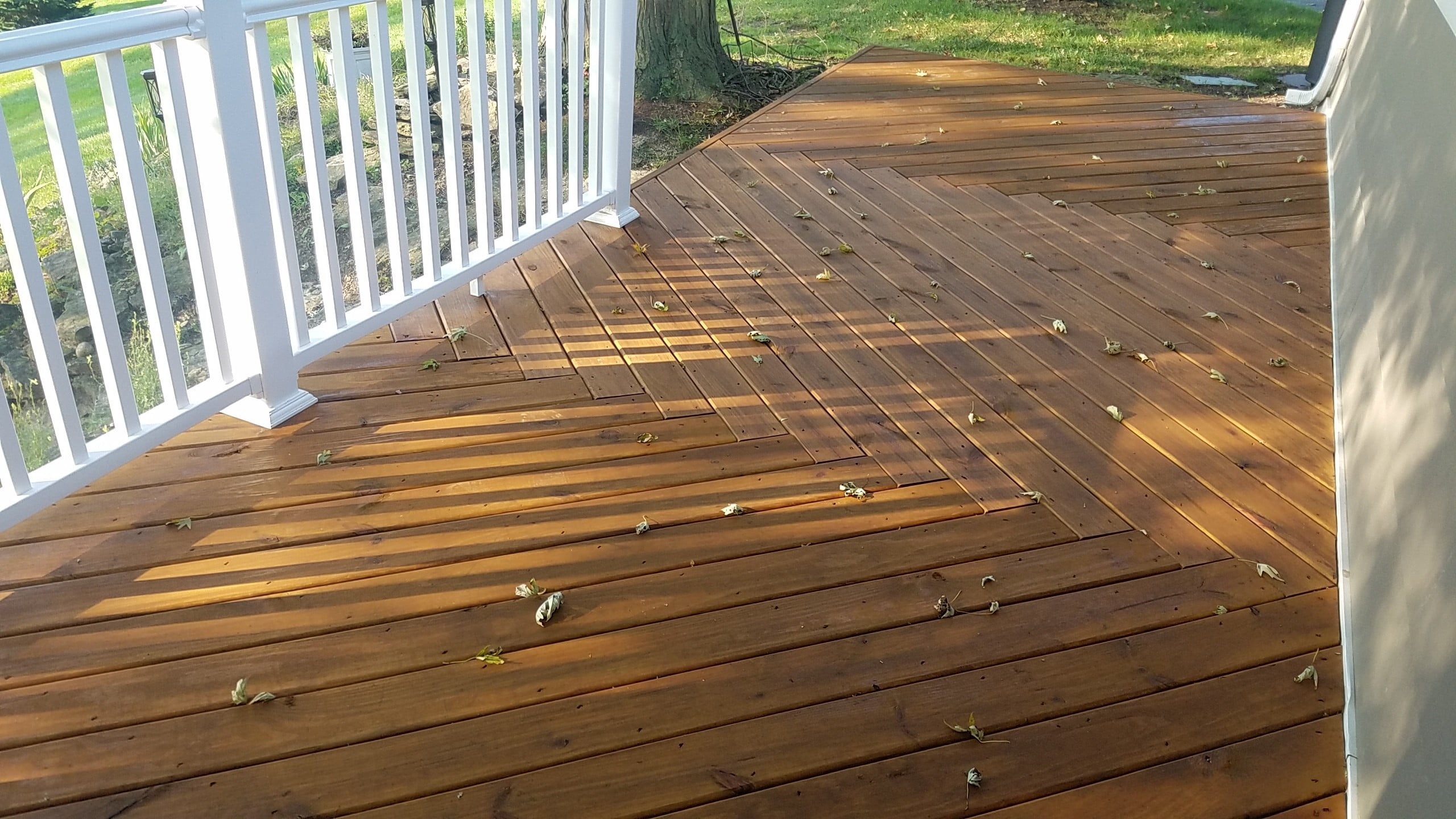

just finished staining our decks with TWP100. we selected this product based on the glowing reviews, but since we just applied it we cannot speak to the longevity. however, we can speak to the color. we chose pecan #120, but the way it applied looks nothing at all like the samples. it looks uniformly orange, not brown and with barely any hint of woodgrain highlights. i think there was a mix-up and we were given cedar instead of pecan as indicated on the label.
color issues aside, we’re hopeful that the product will protect/preserve as advertised!
another pic… #orange
The color looks correct. Pecan is not a straight brown but a caramel/brown mix. Wood age and type also dictates the final color as well.

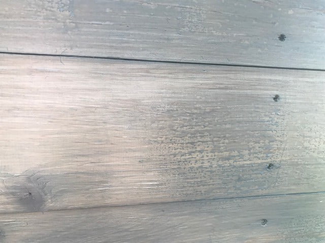

HELP! So we paid a lot of $$ last year for brand new cedar horizontal fence. The stain was put on half ass, to say the least. There are darker strokes, lighter, etc. Needless to say, it’s 2nd yr and it looks bad as it has chipped & faded. NOW, our bad too, but we don’t know what they used on the fence! We have lost touch with him. We just tried to put some water based Behr semi-transparent and it got all sticky. So, is it due to the product or is it the previous stain? I have read many reviews of others using Behr that have sticky issues. The color of the fence is a nice light gray. It goes well with our dark gray home. But now, we are having hard time figuring out what to do. Should we go with a more solid color now that the stain underneath is different colors (darker and lighter). But do those hold up as well. It seems solids would deteriorate and look worse even quicker. My pretty horizontal fence is becoming a nightmare. We get a mix of sun and shade during the day as the fence goes around 3 sides of the home. There’s a lot of fence! It’s in Denver, CO, so no mold issues. Any tips appreciated. Thanks
Behr is horrible, do not use it. You would be best with a solid stain to cover this and even it out. https://www.deckstainhelp.com/what-are-the-best-solid-color-deck-stains/
Now you tell me, LOL… Maybe I can donate the 5 lbs of stain to some place (?) But it REALLY is sticky and runny so not sure who’d want it. I am on my way to get some solid color samples. THANKS
So why does consumer reports rate some Behr as the best..like many brands they have multiple versions and I am guessing that some versions are better than others?

It is September here in Idaho and we have sanded a 15 yr old redwood deck down to bare wood. Do we need to wait till Spring to stain? And before we stain we will need to strip and clean? Would this be true no matter what brand we used?
Post a picture of the deck the after sanding.

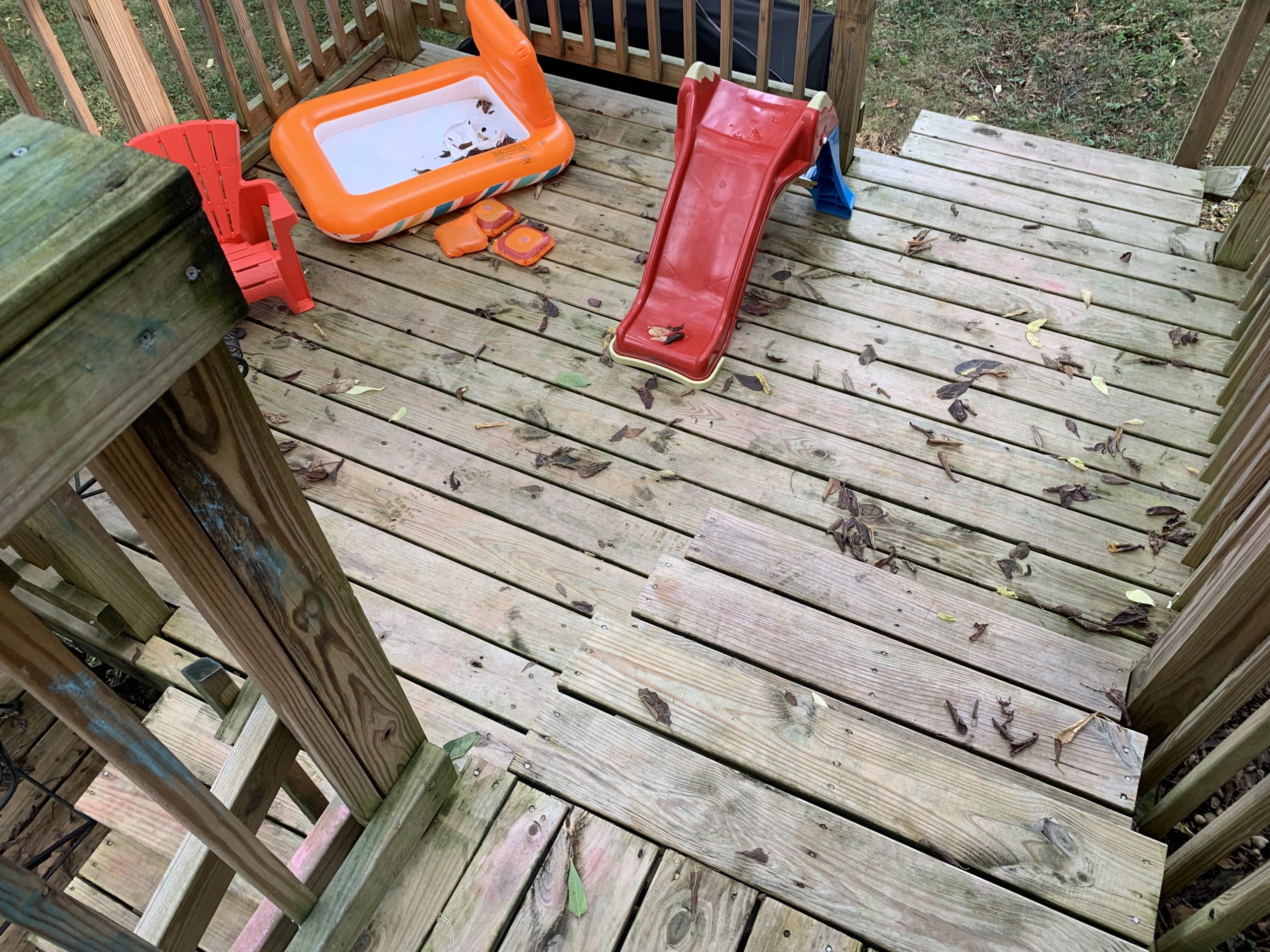

I purchased 10 gallons of TWP Stain and Sealer on 04/04/2018. My deck was about 25 years old so I hired contractors to come out and flip the boards for a semi new surface where they could. In other areas I had them rough side up as they were too difficult to flip. In other areas I had to purchase new lumber.
Next I had a contractor come out and pressure wash all of the entire deck; old/new/flipped so that it was all clean. I did this in early Oct of 2018.
Today is Aug 25 2019 and as shown in pictures, all of the deck is molding under the product!!??? I followed all the directions to the letter, making sure to age the new wood several months prior to application and ensuring the wood was completely dry before applying. It is a very large deck but I was able to get 2 coats down from the 10 gallons at a cost of $389.90. This cost was just for the stain itself and does not include the labor of approximately $750 for pressure washing and applying the stain.
This is a very large expense for me as I’m single and not a young person. I even pressure washed one board to see if it (the mold) would come off. It did after taking some of the sealant off, but 2 months later the mold was starting again.
I’m not sure what I’m going to do now to remedy this issue.
That is not a TWP issue but an issue with your environment. No deck stain can stop mildew from accumulating on top of the coating but TWP can and will prevent mildew from growing in the stain. In other words, doesn’t matter what stain you used, you would still have mildew on top based on your environment. BWT, you are only supposed to apply 1 coat of stain to new wood.
