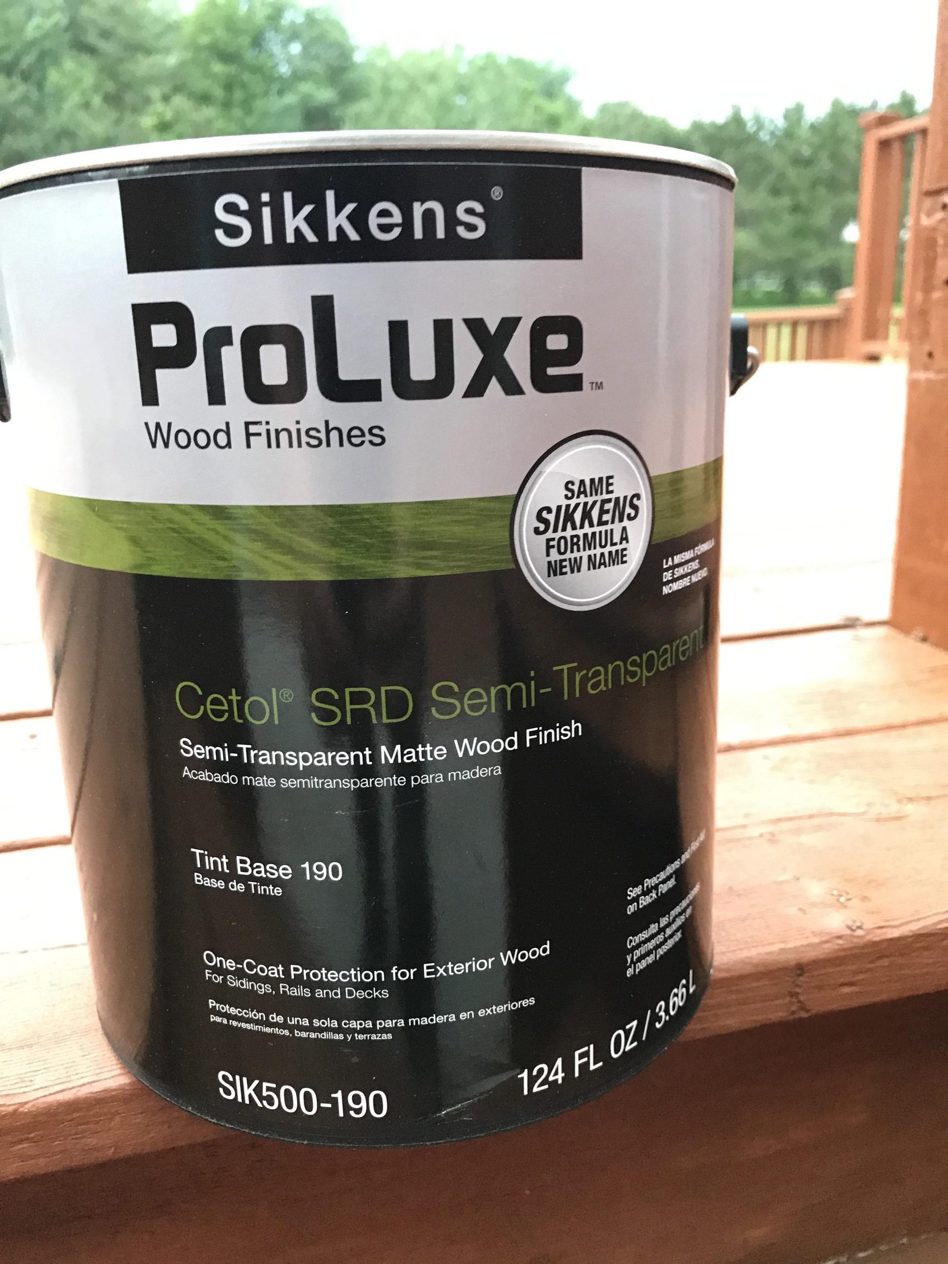

This is what I used

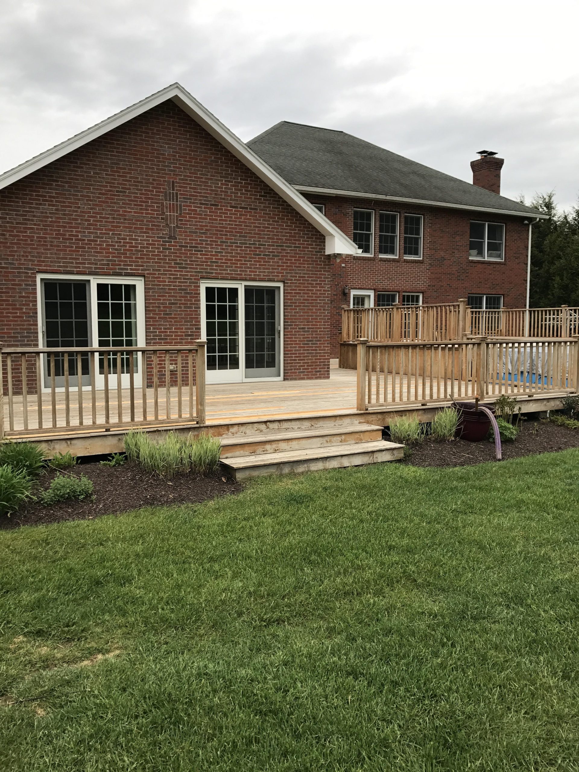

That was in 2017 all clean and ready for stain I wanted oil sikkins but they don’t sell the oil base paint here in mass so he got me a hybrid waterbase did not work

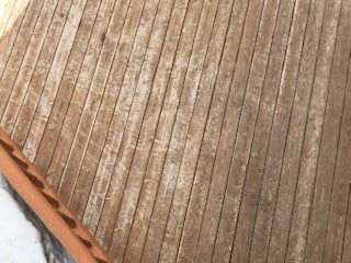

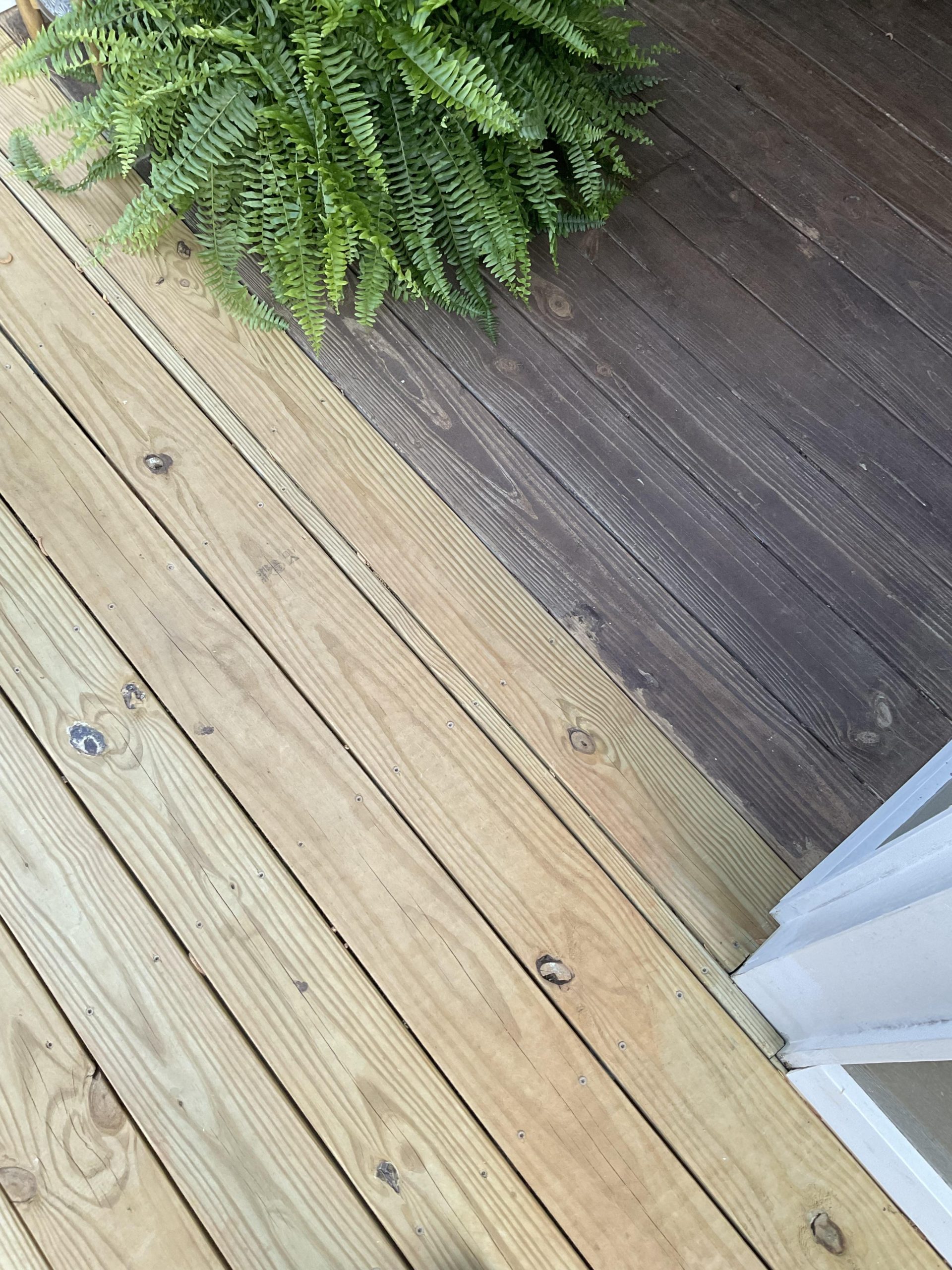

This is my deck I’m taking all the decking off and replacing about 1200 Square feet I’ve had people stain it and clear nothing works. I had it done in July come May all peels off but nothing but a nightmare for me.it’s twenty years old
Look at TWP 1500 Series or Armstrong Clark Stains. Both are VOC-compliant oil-based stains that are allowed in your state.

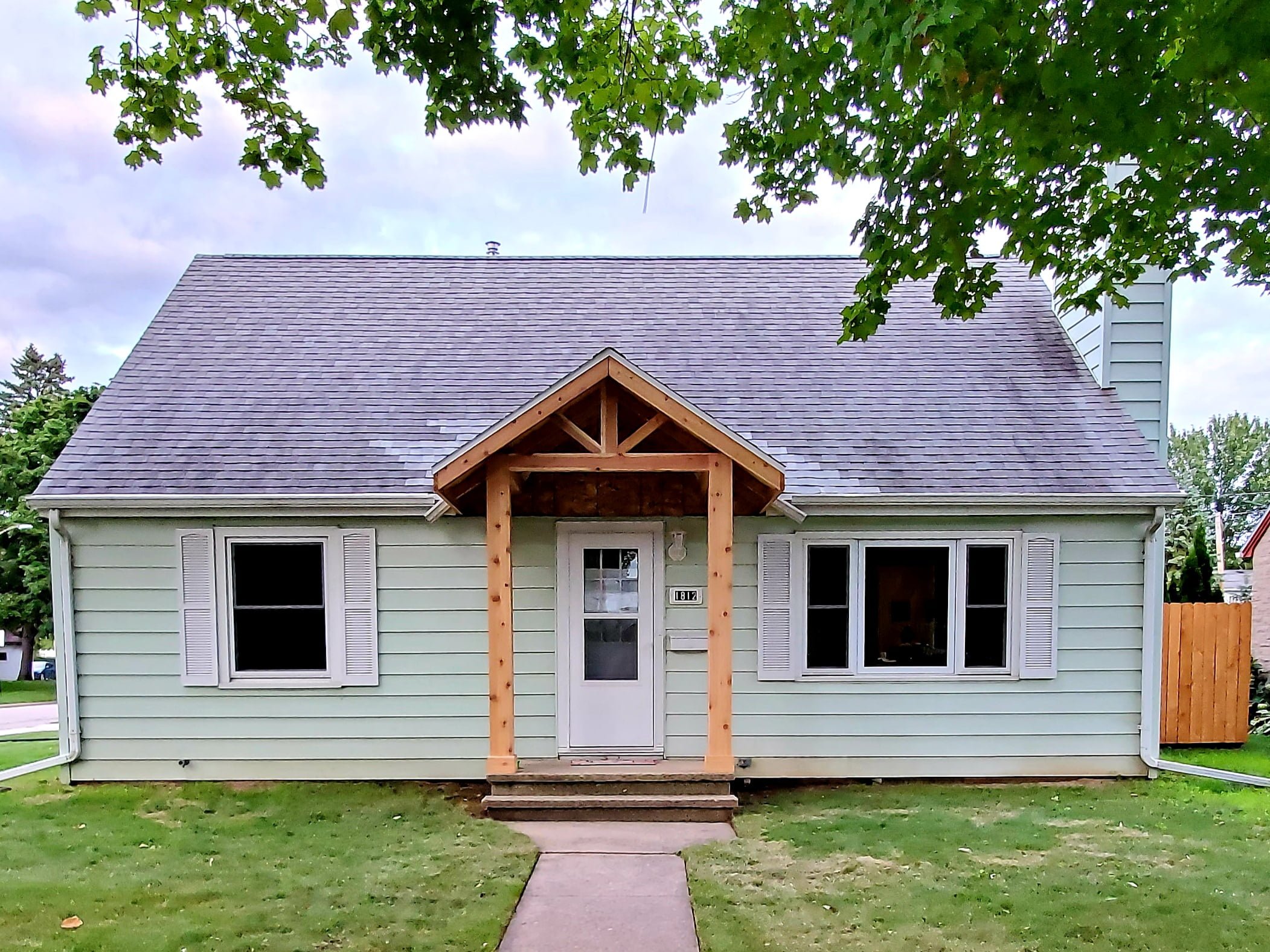

I have beautiful 2 x 8 clear cedar facias. I love the natural, warm orangey color. We power-washed and oil them about every 2 years.
I live in CA about 1/2 mile from the ocean. I am told that the salt air tends to cause my cedar to gray. Also, I have a “galvalume” metal roof, and the chemical in the roof’s run-off seems to add to the streaking and weathering of the facia. (No rain gutters except where necessary.)
So far, we have been using the Armstrong Cedar Tone oil finish. We are willing to clean and condition the wood for a new product, if there is anything better. It appears that TWP 100 is not available in CA, and Armstrong v. TWP 1500 is comparable.
What would you recommend for my cedar facias?
Thanks, GJ in CA
Salt air does not cause graying. UV oxidation from the sun does. As for the streaking from the galvanized roof, no stain will be immune to this. To give longer life from UV graying you will need to up your UV protection by going from a transparent color to a semi-transparent color. You can use the AC Cedar Semi-transparent or try something like the TWP 1500 Series or Restore A Deck Stains.

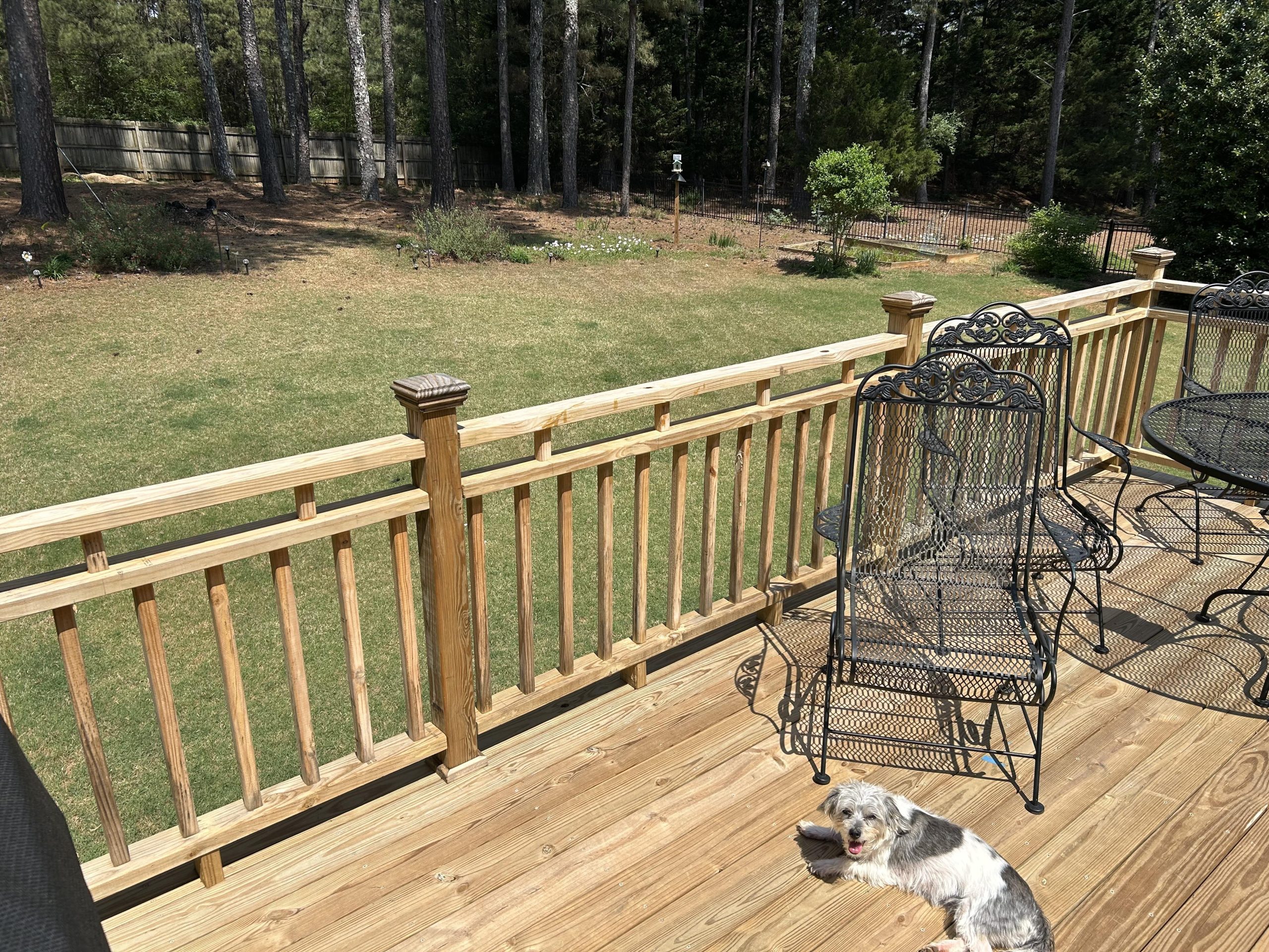

Wanted to get your thoughts for the best product for the job.
Large deck in North Carolina lots of sun an humidity. Some snow an ice.
Mostly redone with kadat kiln dried pine but still has some 20 year old previously painted but 95% stripped an blasted.
The TWP 100 Series would be a geat option for this deck in NC.

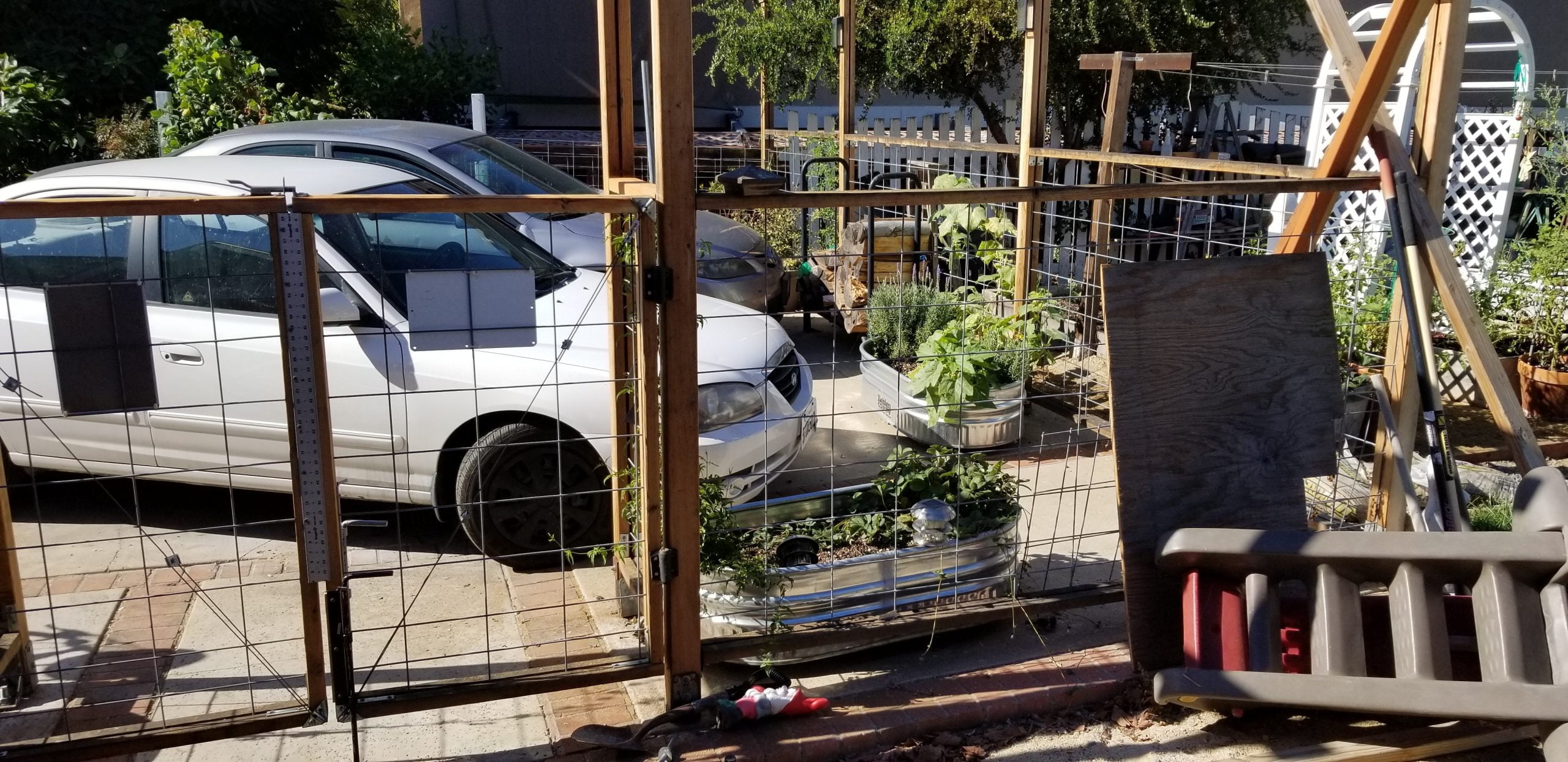

I’ve got a fence that has a redwood frame and galvanized mesh. I don’t remember what stain/protector I used when I built it a year or two ago. I’m adding some additional features to the fence and would like to clean up the existing portions, too. I saw some comments in the Q&A section that the product shouldn’t be used on new wood. How long should I let it age? After it has aged, what steps can I use to clean it up prior to application? I have a pressure washer, but the fence design is so simple that I can easily sand the wood. Or should I avoid sanding?
Wait 4 months and then clean and brighten for prep.
Will it be better to sand or just pressure wash at that time?
Pressure wash.

In Montana there is no such thing as re applying in 2 to 3 years. EVERY year or you’ll be down to bare wood. I’m not happy with this product as compared to the reviews I see. Pic below is one year skipped! Odd how similar this site is to the TWP website. Now I get it….
The pictures in the photo show wearing due to the TWP not soaking in when applied. If it soaks in fully then it does not wear. Looks more like an application issue than a stain issue. Also, that looks 2-3 years old and would be time to prepped and recoat. We restore over 4– decks with TWP and never seen issues like this after 1 year.
As for this site, the very first article on the home page will answer all questions to who maintains this site.

We are building a barndomenium. We purchased cedar posts to use for the porch posts. My husband used a pressure washer to remove the bark. They have been in place for about a month. I want to keep the natural light color of the wood which has the dark spots or holes in the cedar. Can I use the clear color on cedar posts and if so, will it keep them from the graying process?
Jana, the TWP in Clear will not provide UV protection. Any of the other semi-transparent colors will provide UV protection.
FYI, not clear sealer (no pigment at all) will provide UV protection. You must have tint in your stain for this.
Okay so if I go with one of the pigments ones, do you know how long I can expect it to last and if it will keep the cedar from graying? Also, I’m thinking either the cedartone or the honeytone. Any suggestions on that?
Honeytone is the lightest. For vertical posts, 3+ years is normal.
Great! Thanks so much for your help!! Maybe I’ll post a before and after pic for others to see in case someone else has same question. 🙂
Yes, please do that!

I have a log sided (not full log) home that needs new stain. Western and southern exposures are quite dry; east and north still have some sheen. Had Sikkens Cetol applied 6 or so years ago. Estimators say it needs help. It isn’t Terri le. Do I need to continue with Sikkens or can I switch to TWP? Must it be fully stripped to switch? I can’t afford the bids I’m getting that include stripping….
To switch you will need to remove the Sikkens.
