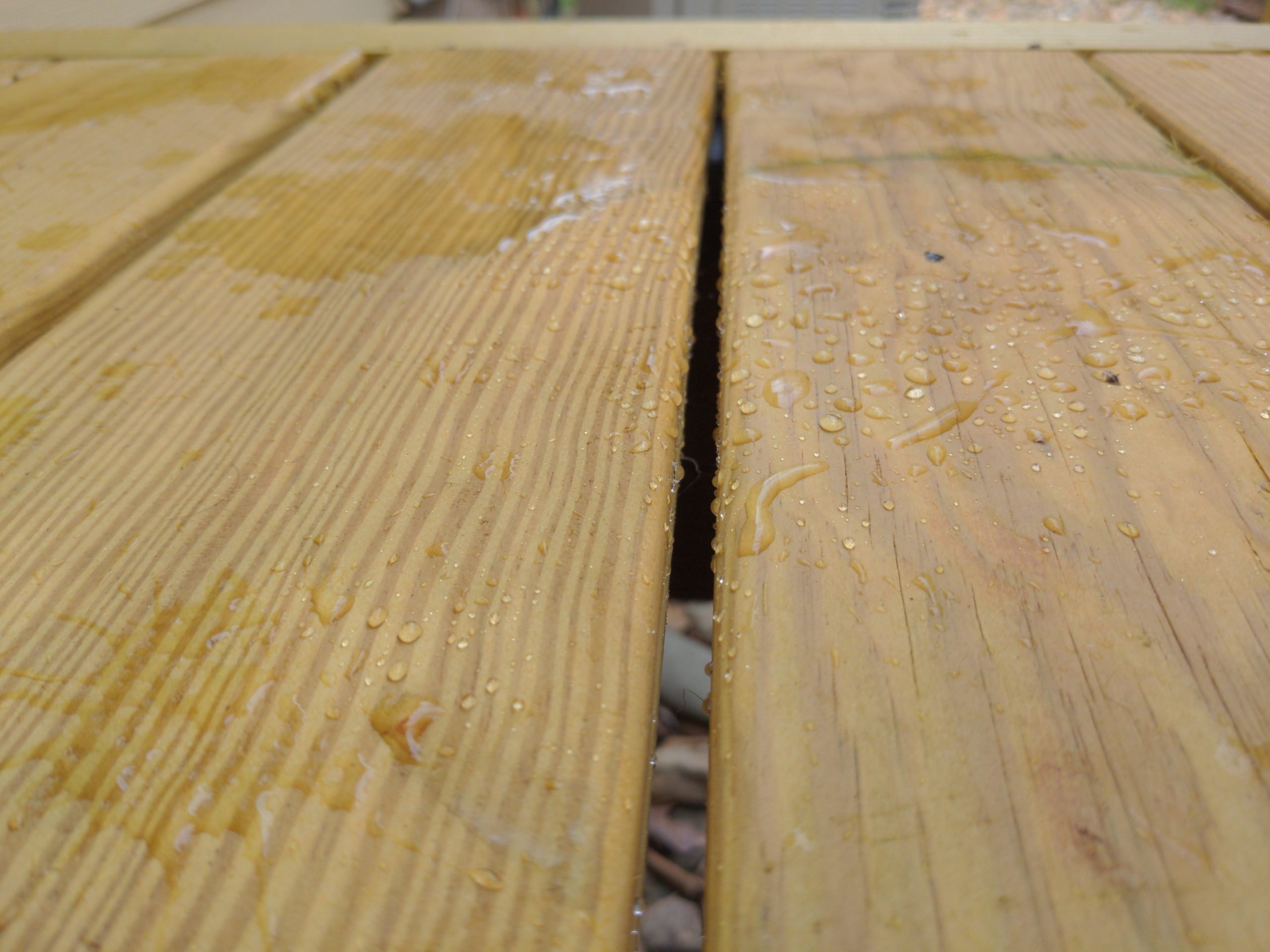

Allen Monsarrat
Allen Monsarrat
I redid my deck last year with kiln dried after treatment KDAT pine. I waited several months for the mill glaze to go away and then applied one coat TWP 1500 Honey color after treating with cleaner and brighter. Very pleased with results.
Now it seems like it’s ready for a second coat. Water no longer beads up like it did originally. I’m assuming that my steps will be to use cleaner and brightener then apply a another coat of TWP 1500. No stripper will be applied. Is this correct?
In the photograph the circle on the right of the photograph is where a pot has been sitting, The deck outside of the circle has been exposed to the elements.

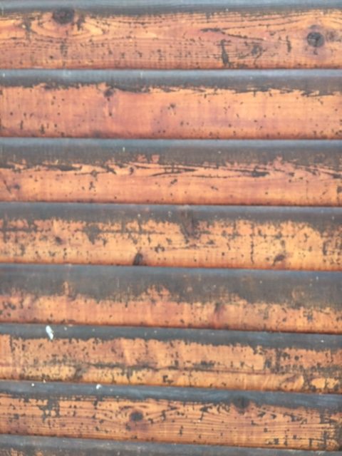

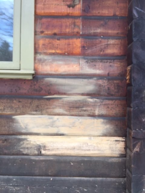

Robin Nolan
Robin Nolan

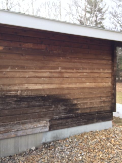

Hi there:) So happy that I found this site! Bought a 1970″s Pan Abode cedar log home kit. Previous owners didn’t maintain the cedar logs well. Can’t sandblast or power wash because it’s like Lincoln Logs and no chinking so water, sand etc gets through he logs into the house. So, painstakingly wire brushing and sanding old stain off to bare wood best we can. Plan on retaining in a dark mahogany semi transparent stain so can see the grain but cover well to hide any mistakes or oops. Any preference as to satin should use? Here in northern NH it’s pretty damp and New England weather. Many folks here use Sikkens products or Ben Moore “Arborcoat”. Not familiar with the products I’ve read here but will take your advice!
Thank you for what you do!!
Some pics of the house,
Robin Nolan
Shelburne, NH

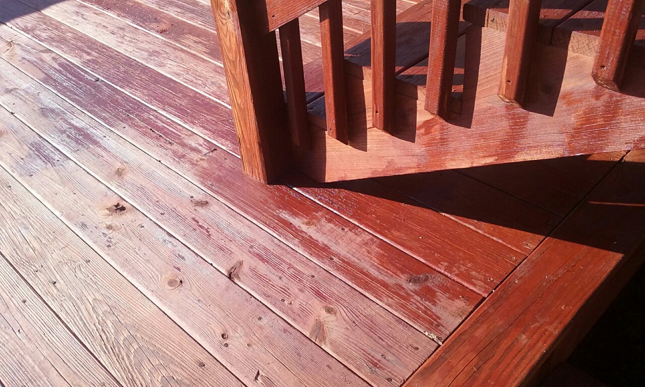

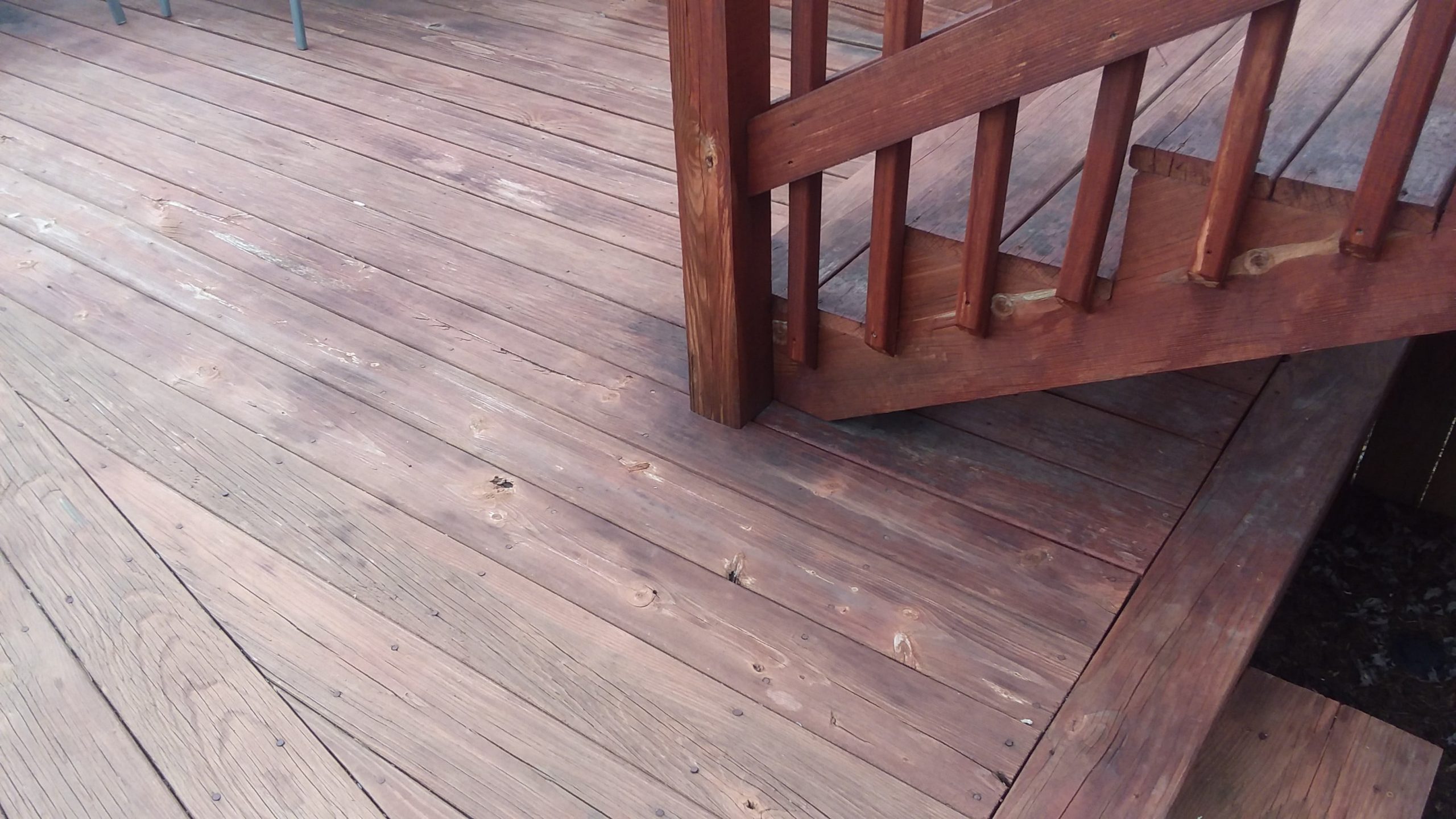

I did not have as good of luck with TWP-1500.. Evidently, it’s not a true oil base stain but a hybrid of some kind.. Floor was rolled consistently and some areas just didn’t take, leaving these shiny spots.. It’s been 2 years and contractors are talking about stripping so they can re-do with a true oil..
Blotchy Stain Application
Ask a Question or Post a Review…Thanks for reply. I was told it is “formulated” oil. Deck was pressure washed before staining. So TWP 1500 would not have to be stripped to go over with any oil base stain ??
Ask a Question or Post a Review…Picture above is from 2017. This picture is same area taken March, 2019. If we went with TWP-1500 again, would you still recommend strip and brighten ? If so, do you have recommended products and process ??
