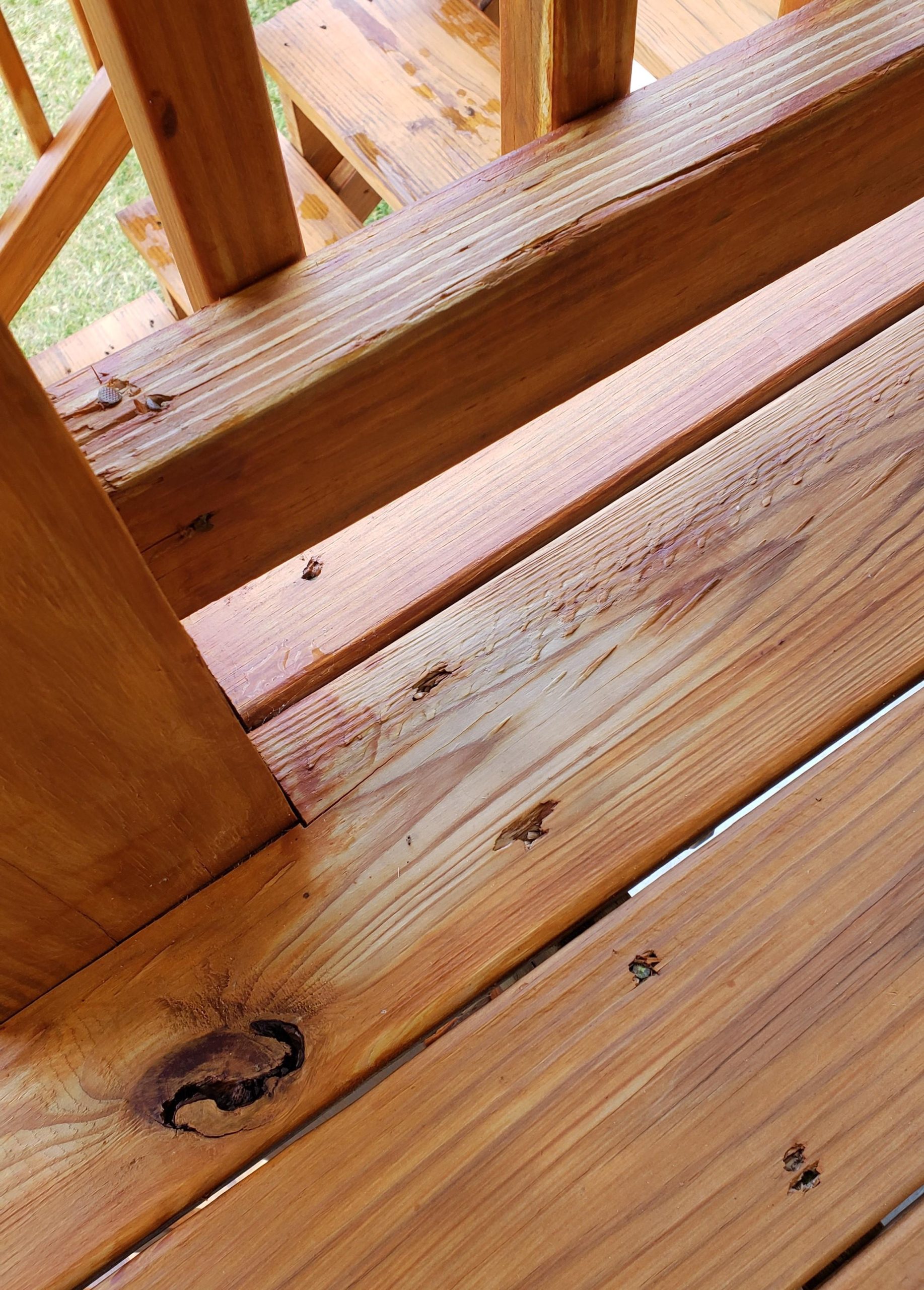

Valspar Deck Stain Photos

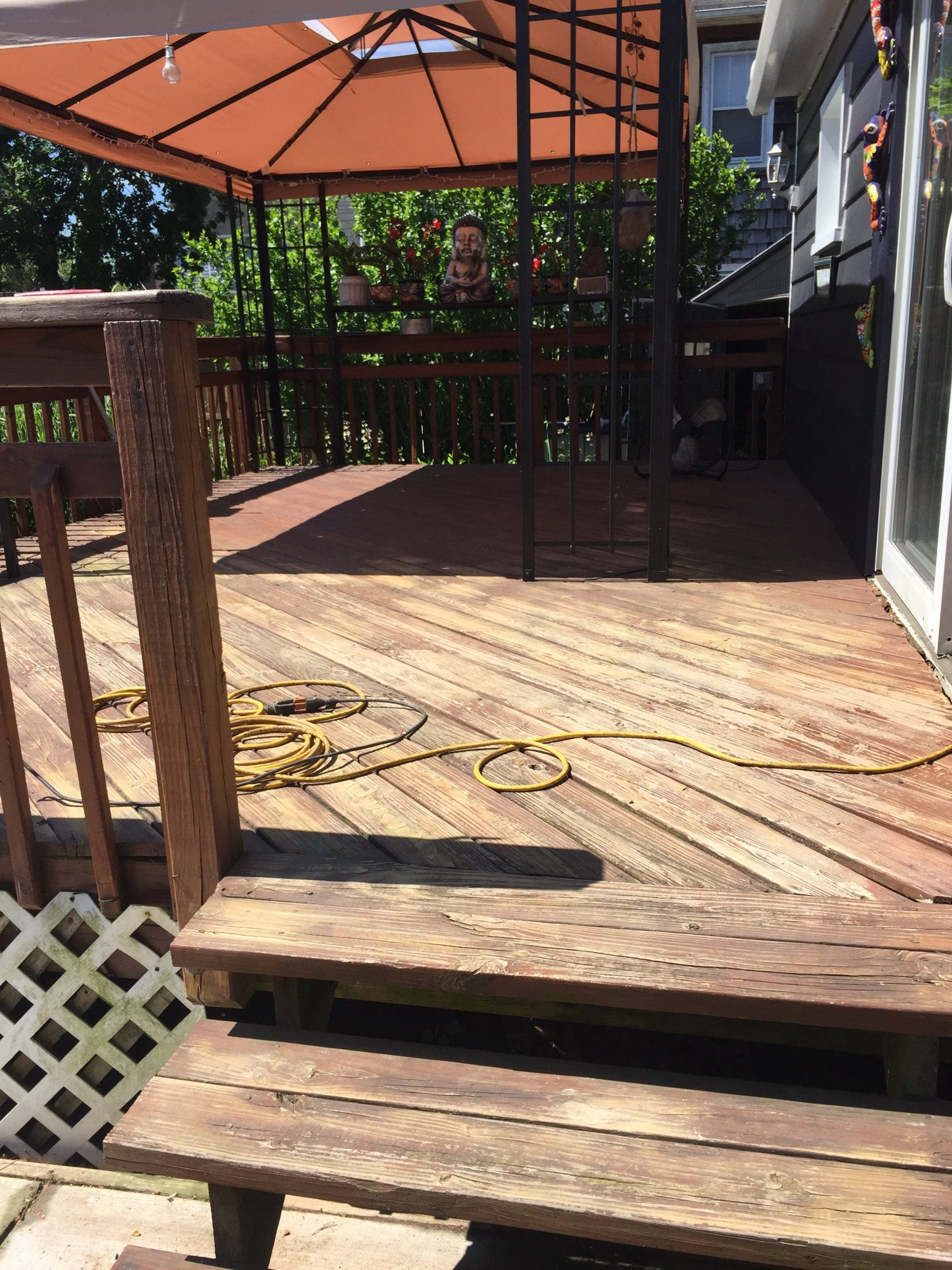

I bought Valspar Transparent Cedar NaturalTone Stain and Sealer. My deck is 4 1/2 years old. I first power washed the deck. Then I used Valspar All-in-One Wood Prep and power washed the deck again. The wood looked great. Nice and clean. All the gray gone. At first I was going to use a clear stain/sealer, but decided a little color would be nice. After the deck was completely dry, I then spent a few day applying one coat of the stain/sealer. I did not spay it on. I rolled the areas where I could, followed with a brush to smooth it out. And brushed areas I could not roll. It looked great when completed. Then it rained 8 days later and again 15 days after completion. The rain washed off the color on many parts of the deck. Part of my deck is covered, but what is not covered now looks blotchy in places where the color washed off. I tried adding another coat over the blotchy area but it would not take. It was as if the sealer part of the Stain/Sealer was preventing the stain/color from sticking. Another coat would not cover up the blotchy areas. I’ve owned a few houses, so this is not my first deck project. But it is the first time I’ve used Valspar. I put a review on their website, but the review never posted and now their website is currently not allowing any reviews. I spent a lot of money and time to have my deck look horrible. My only option now is to strip it down and start over or live with it. I had actually planned on buying a different brand when I saw a Valspar can that said it was rain ready in four hours. I knew I would not cut it that close, but just in case of a pop-up shower, I wanted to be safe. I do not believe this product is rain ready ever. Normally I always check reviews before buying a product that I have never used before, but this time I didn’t. Every deck in the past that I have stained, I have been able to sit back and admire the job at least for a few years before the color started peeling off. But I am disgusted with this product just after one week. I will never use Valspar again. And I will contact them about a refund on the five gallons I purchased.
I assume there is not a paint/stain remover product that can remove the transparent stain/sealer. And I do not want to power sand the whole deck. Can I put a solid color stain/sealer over the existing transparent stain? Will it stick? And if that is possible, what product do you recommend? Thanks.
The following pictures were taken shortly after a rain. The deck looks good from a distance, but up close pictures show the blotchy areas.
Deck
Deck-Picture-3
Deck-Picture-4
Deck-Picture-5
One last question. If I use the Restore-A- Deck stripper and brightener kit, can I then re-stain with a different transparent or semi-transparent product or am I stuck having to use a solid stain? Thanks for your time.

Before and After using Valspar Deck Semi Translucent. I did my Deck today, All Day! Took the live long day prepping and repairing prior to the Stain. Before and After.🤭😃
