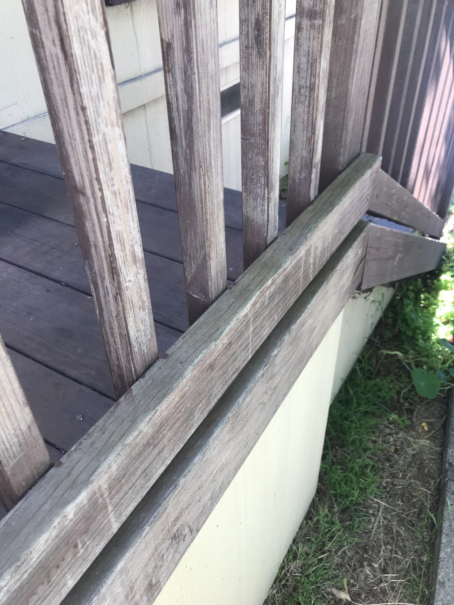

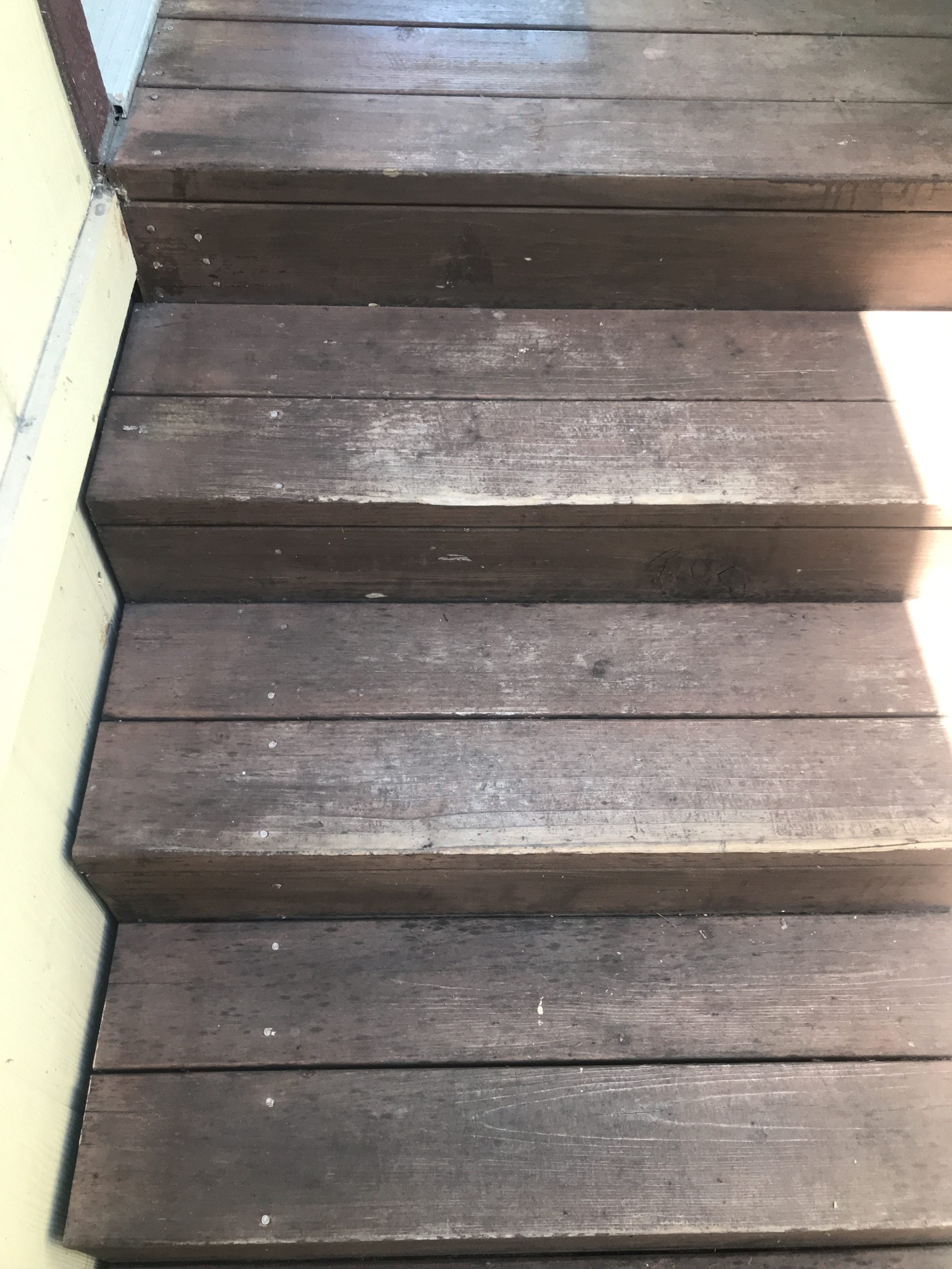

Hi, my husband and I have 3 separate wood outdoor surfaces we need to stain/seal. A large back deck, small balcony, and some front steps.
These pictures are of the back deck.
The deck is old with cracks and weathering but still in good condition. Before pressure washing it didn’t seem to have a stain on 85% on it, just greying all over. So we pressure washed the whole thing and it looks new again. But 15% had what the pictures show below and the pressure washing didn’t get it all off. Is it an old stain that I need to strip? Does it need to come off or can i stain right over it?
What do I use after stripper if I need it? A brightener on the whole deck or just those areas?
And if I do need to strip whatever this is, do I need to do the same to the whole deck?

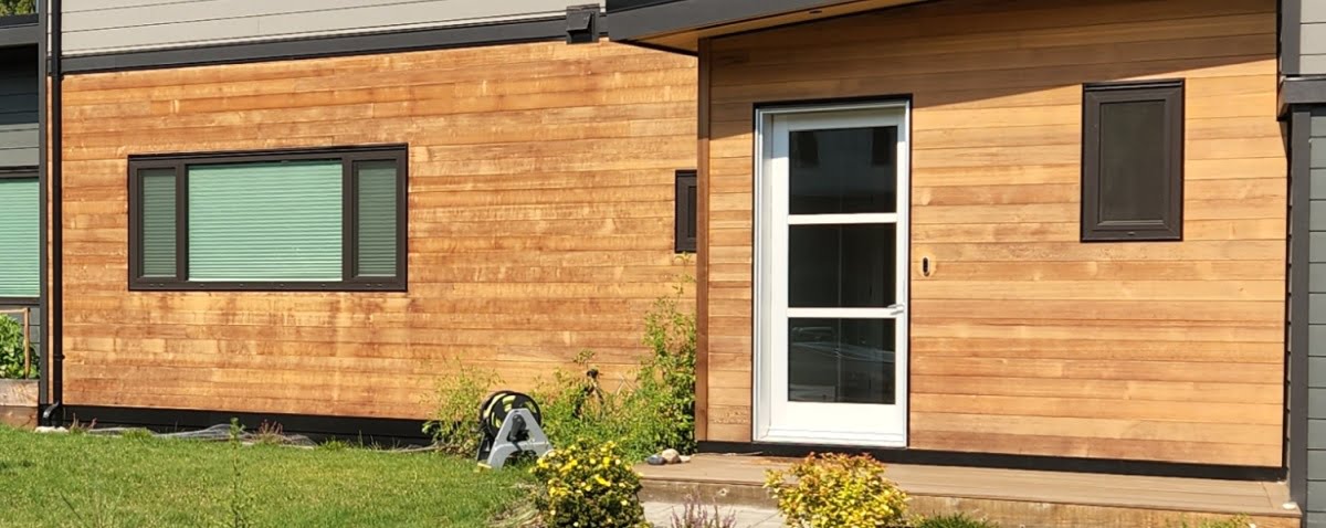

We had Arborcoat natural put on our cedar siding in fall 2019 here in mountainous B.C. Canada, which receives full sun and some rain/snow exposure. It started looking poor after the first summer and looks terrible now. Would oil-based be better than water-based for this setup? Do we need to sand off the Arborcoat before putting a new product on? Would you recommend TWP 200 or Armstrong wood stain or something else? We would ideally still get this transparent look to see the beautiful western red cedar but have a product that continues looking good for years to come with least amount of maintenance possible. Thank you for all you do.
Thanks Scott. Looking at TWP stain stripper to get the Arborcoat off. Would you suggest 1 coat or 2 coats of TWP 200? And how many years to re-apply? Any idea on which TWP 200 colour would be the most natural looking for cedar — perhaps TWP201 Cedartone or TWP205 California Cedar?

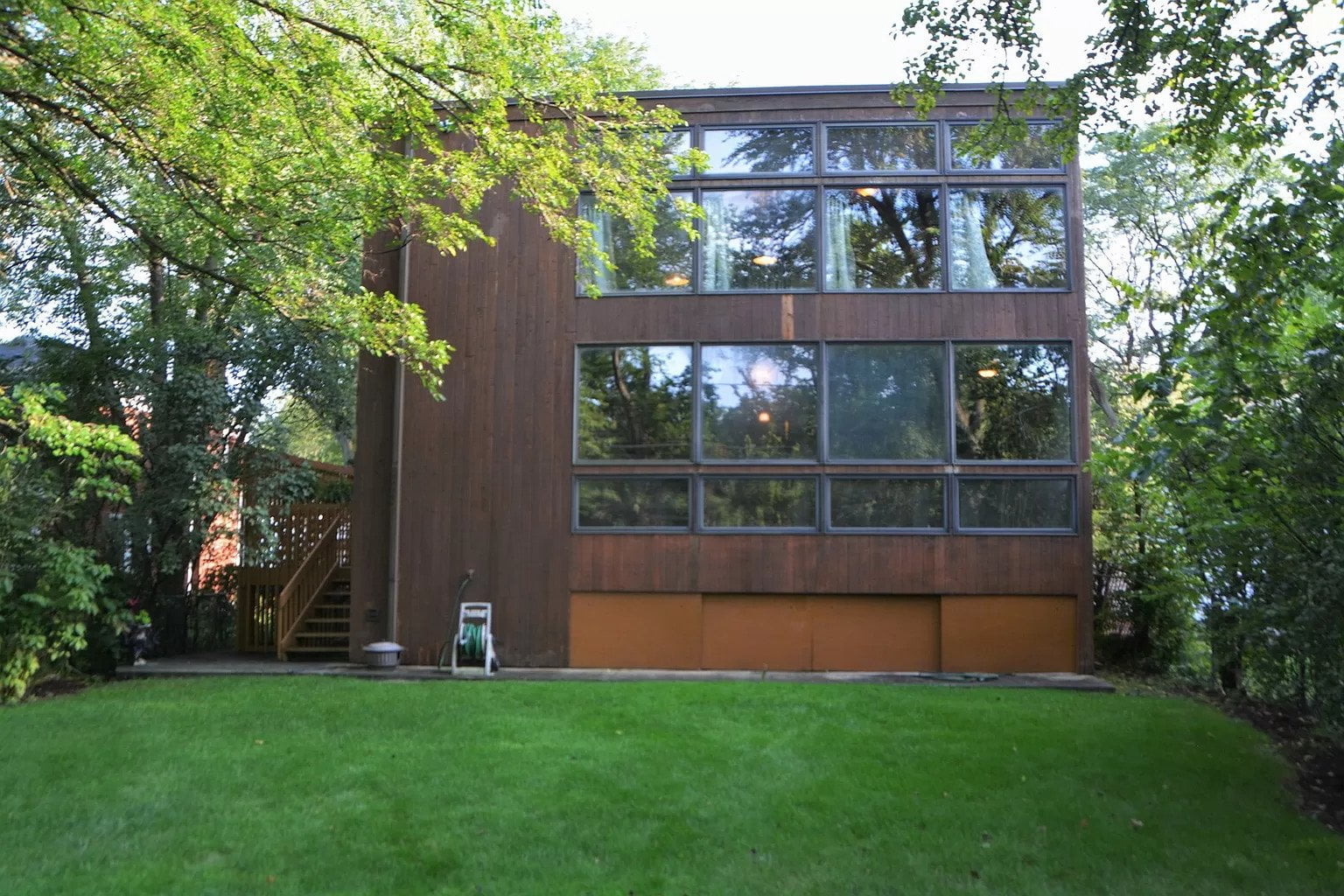

Hi, I’m in the Chicagoland area. We have a pressure treated pine deck, and then an addition covered in cedar car siding. What would you recommend? Thanks a ton!
