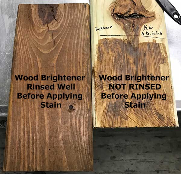

Bonus Step: Rinse the Deck Brightener Thoroughly
One of the biggest mistakes I see is not rinsing the brightener properly. If the brightener isn’t fully rinsed, the wood remains highly acidic, which can cause:
  • Uneven stain penetration
  • Blotchy or streaky appearance
  • Poor adhesion and premature stain failure
My Test Results:
I conducted a test using Restore-A-Deck Wood Stain in Dark Walnut on two boards:
  • Left board – Stain applied after rinsing the brightener for 20-30 minutes
  • Right board – Stain applied without rinsing the brightener properly
The result? The right board showed poor adhesion and an uneven finish due to the leftover acidity.
💡 Pro Tip: Rinse your entire deck (not each board) for at least 15-30 minutes using a garden hose or pressure washer.

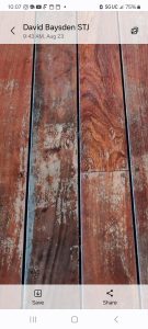

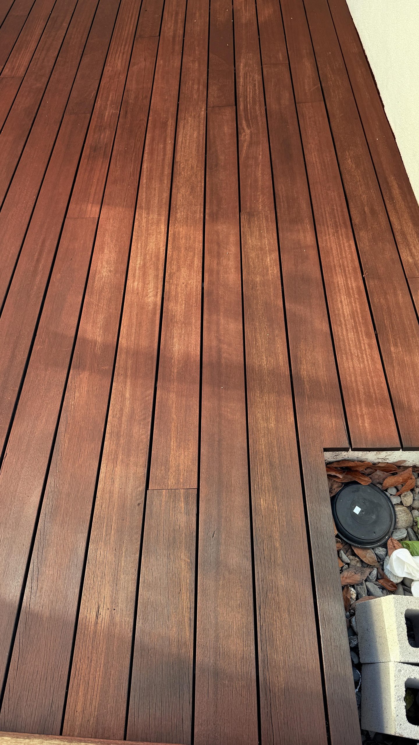

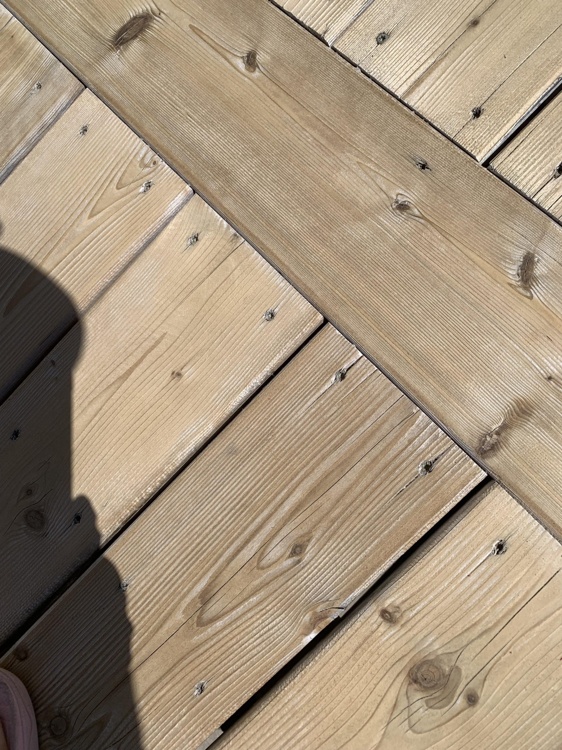

First time using a brightener on my ipe deck and I’m worried I didn’t rinse the brightener off enough yesterday. Is this fine? Do I need to worry about the darker spots vs lighter? Or is this fine and ready for the stain in 48hrs?
IMG_3971
IMG_3972
Julie
Julie
6 months ago
Is it safe to strip the entire deck again or should I spot touch the darker points?

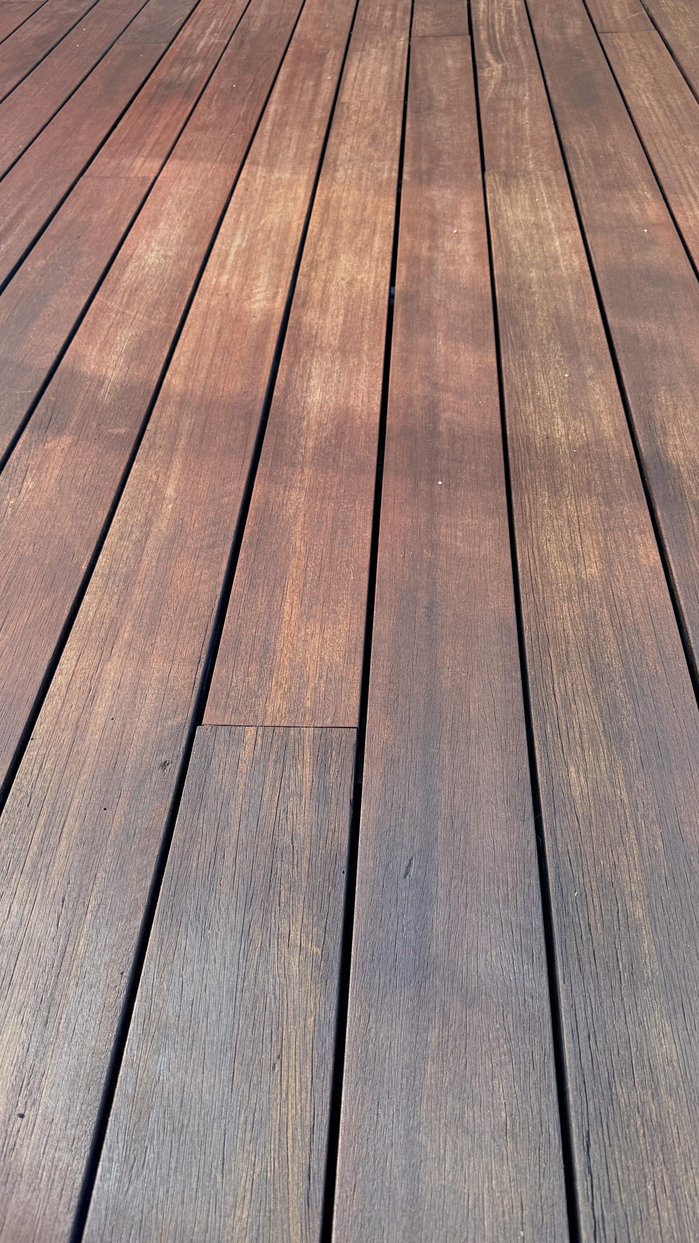

Julie
Julie
6 months ago

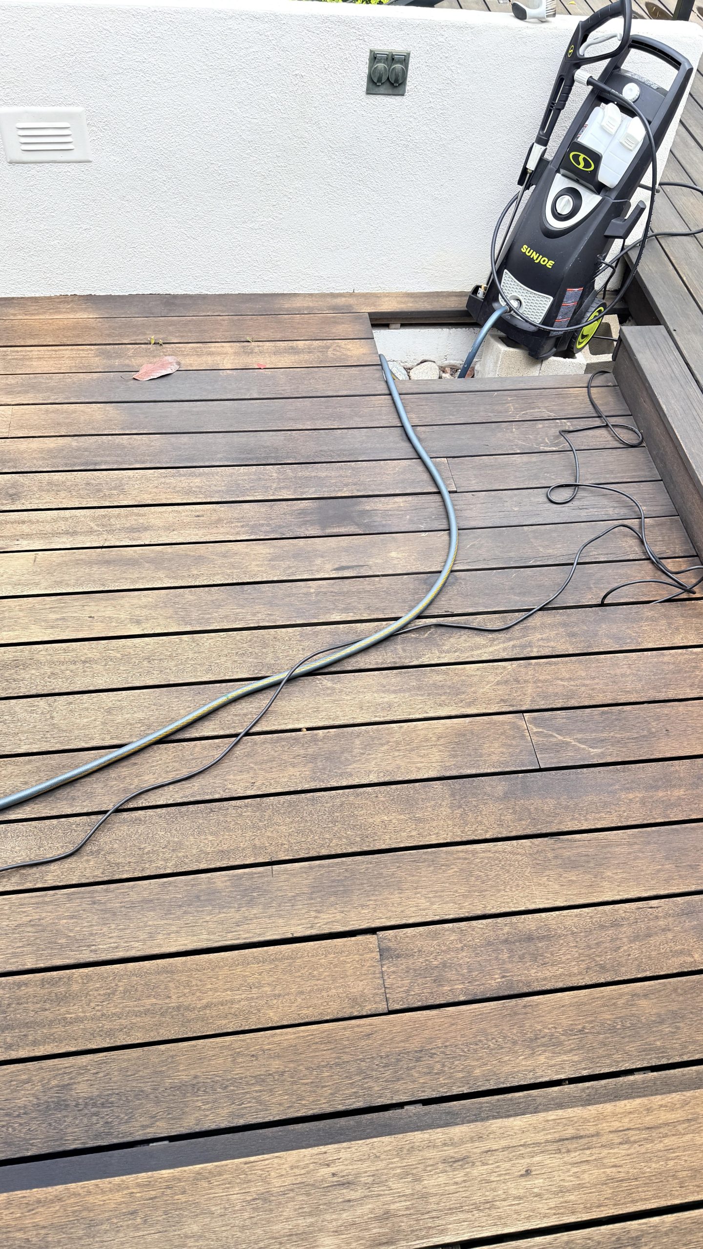

Thanks for all your help! I stripped again and most of the deck is clean, but this section still has some patches. Are these big enough to mess up the oil coat? So do I need to strip again?

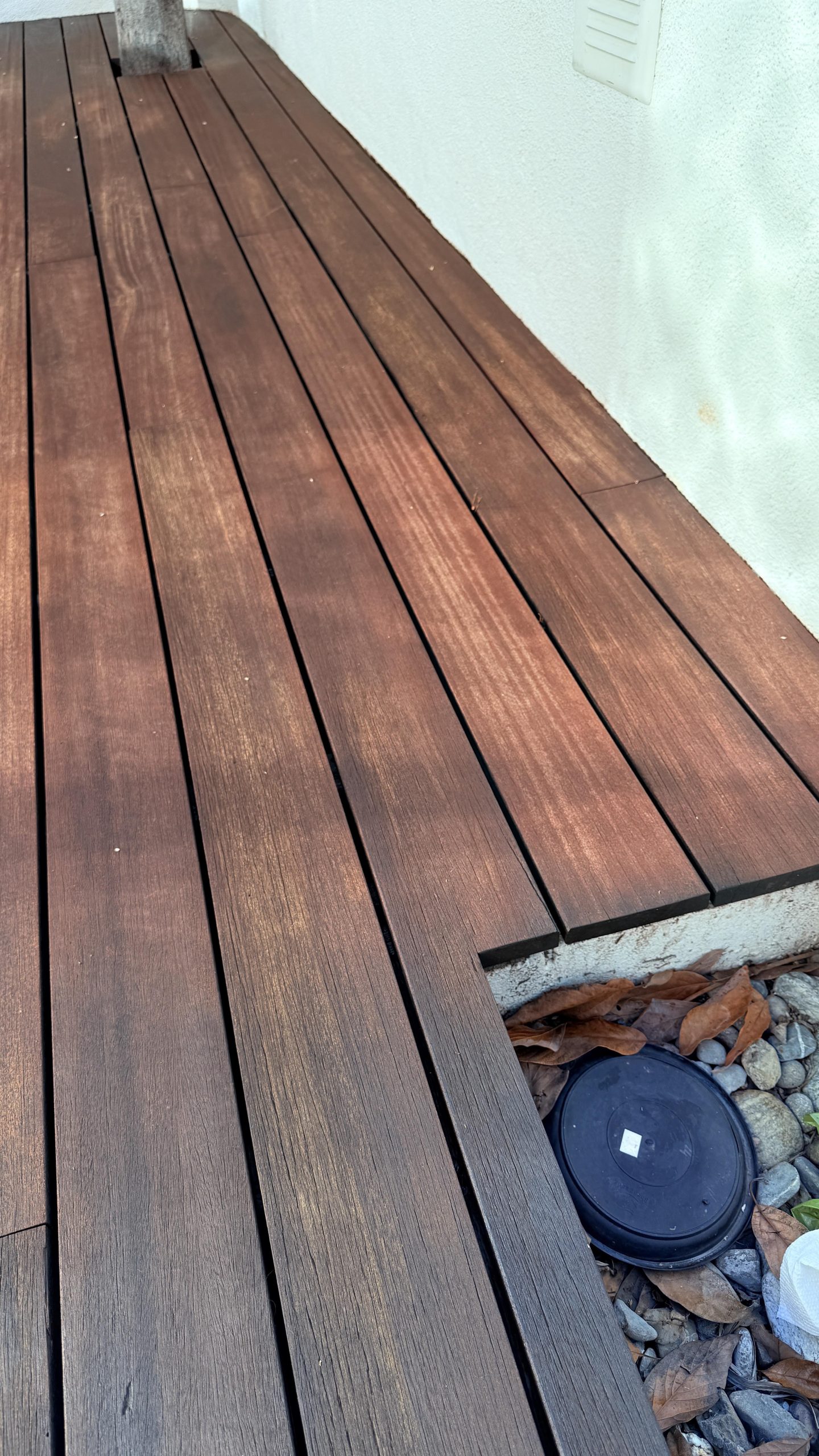

Julie
Julie
6 months ago
A few oops marks from my pressure washing are showing through the oil. Is this just vanity or is it a reflection of how well the oil has penetrated those spots? Either way, is there anything I can do to correct it? Next time I reapply I’ll sand everything to correct a few boards with some cupping, so it’ll get sorted then if there’s no easy fix now.
Thanks again for all the advice!

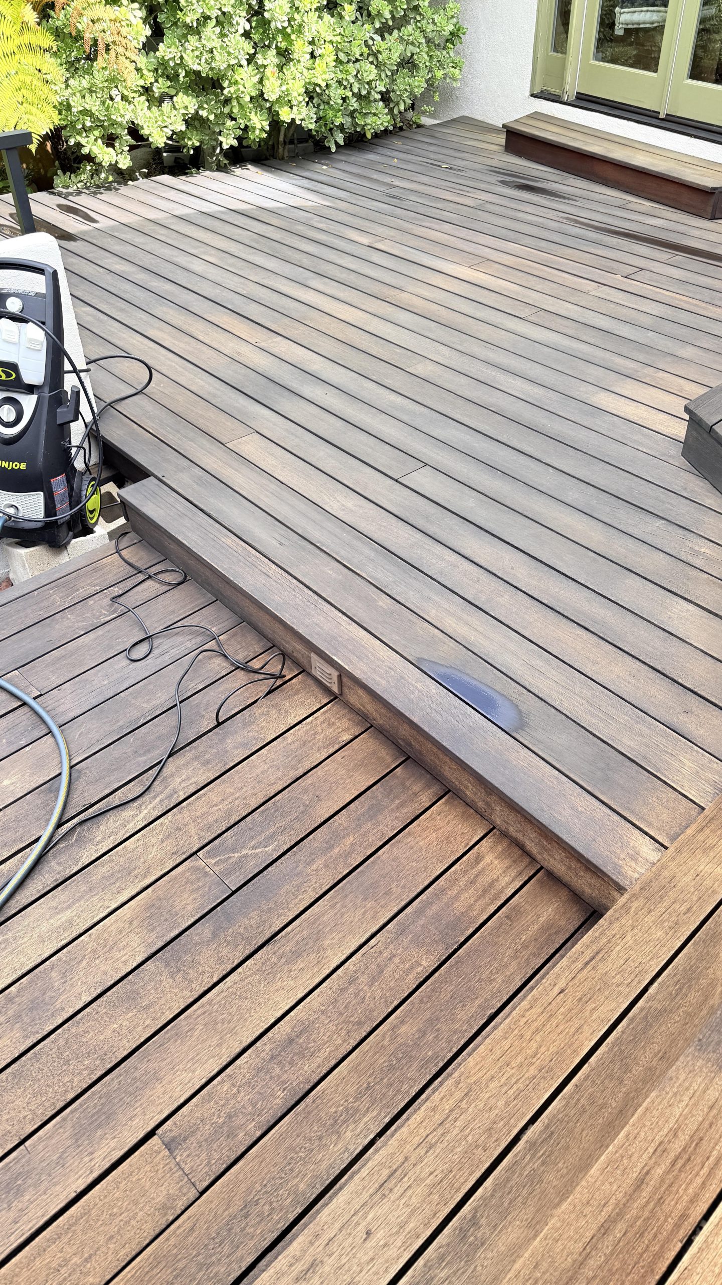

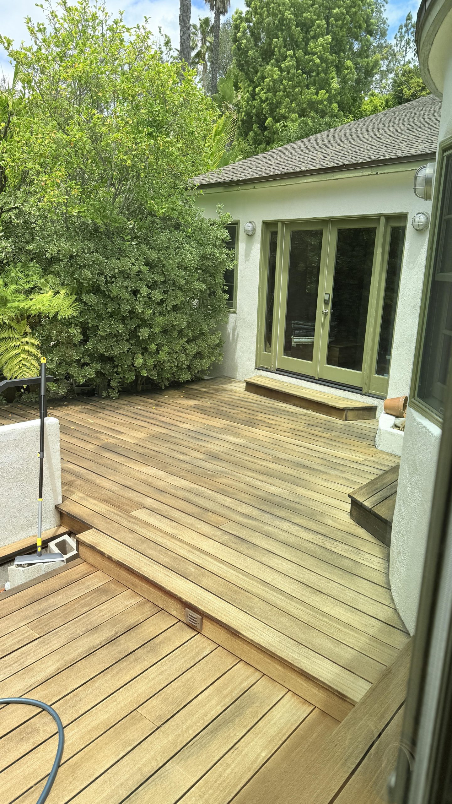

Andrea
Andrea
7 months ago

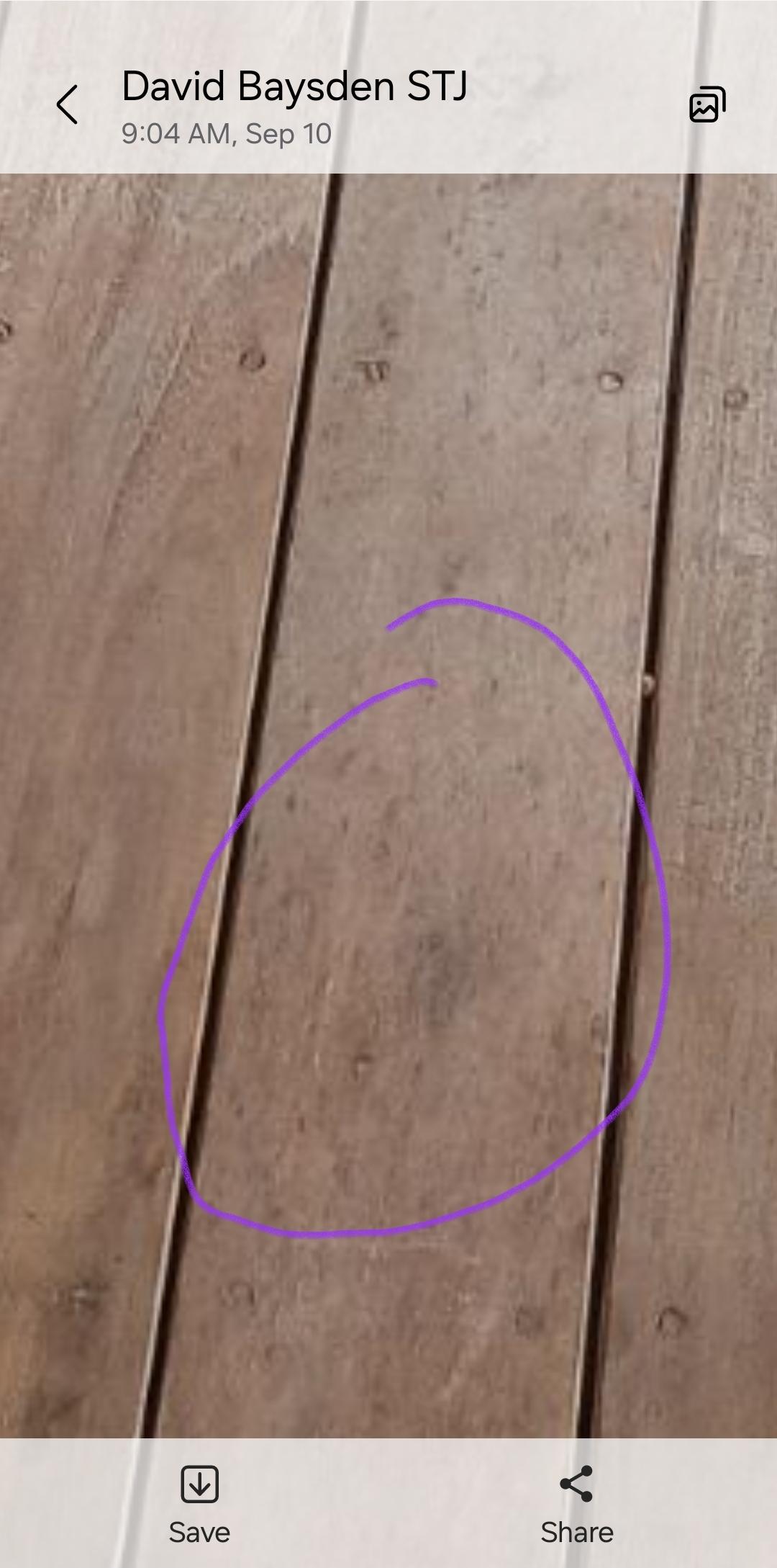

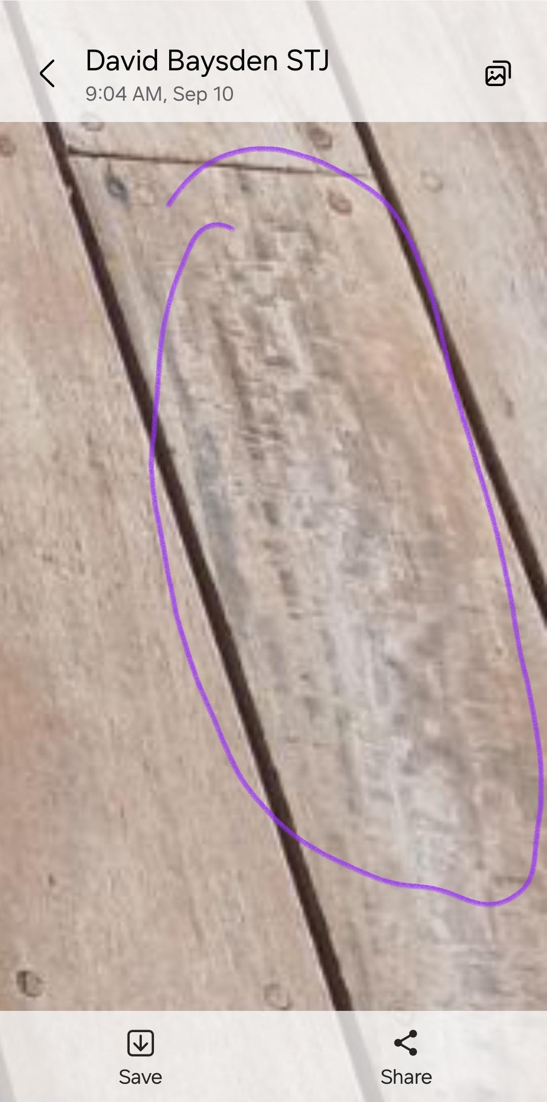

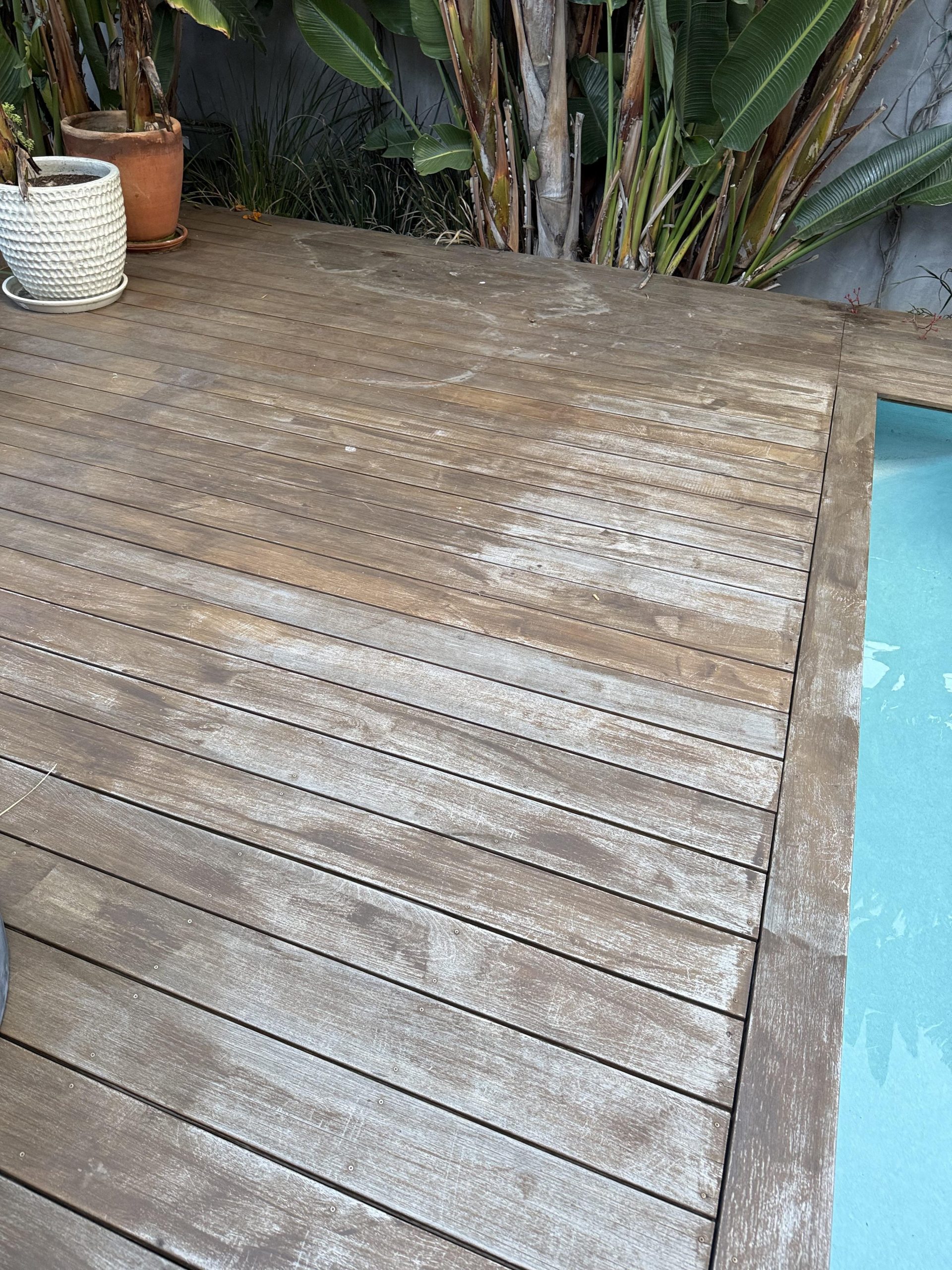

Hi! I am trying to clean up the white patches without redoing the entire deck. Is it possible to just do the cleaning and brightening? I want to get close to the weather dark on the left? Thanks for your help.

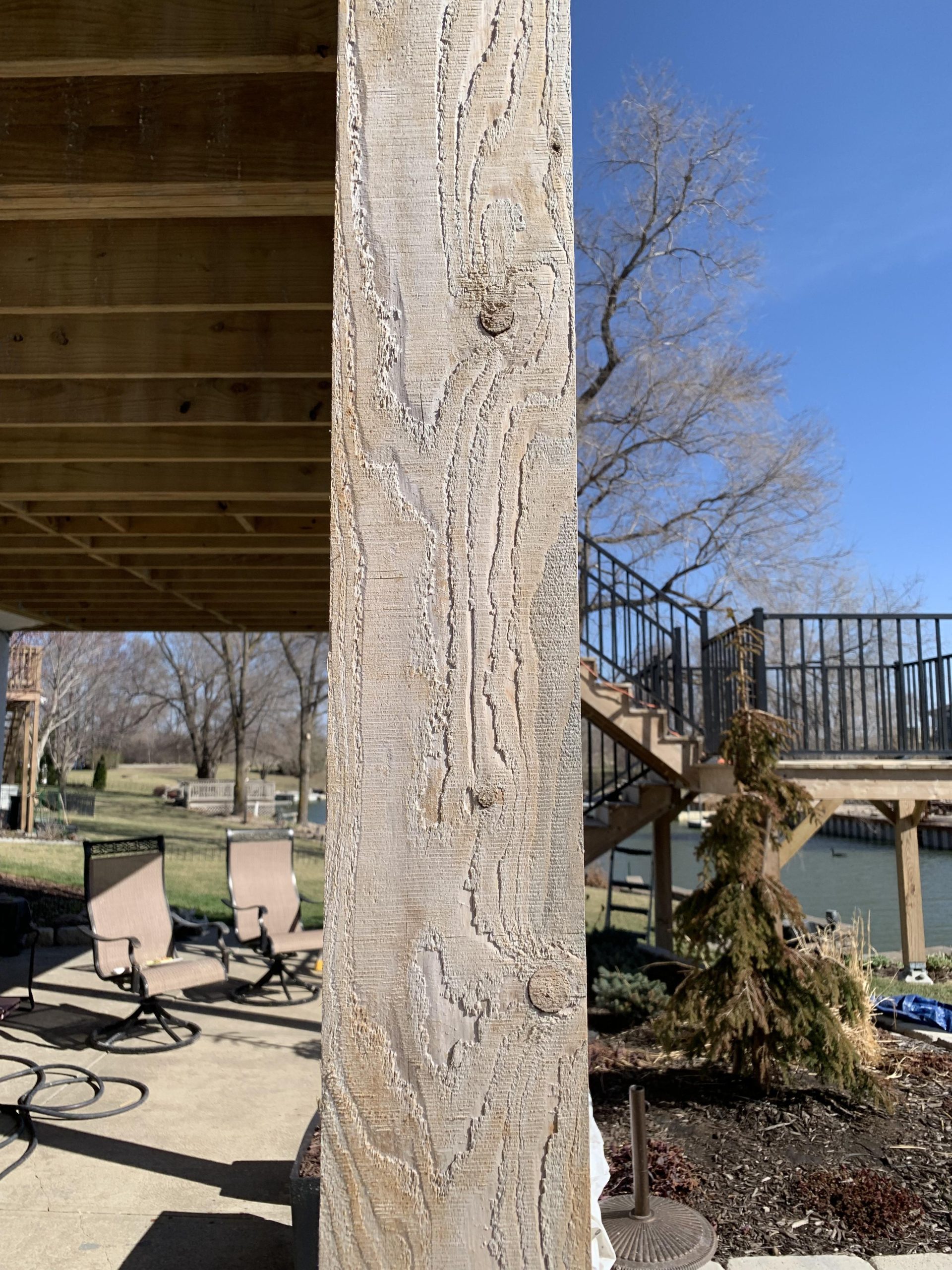

LA Foster
LA Foster
8 months ago

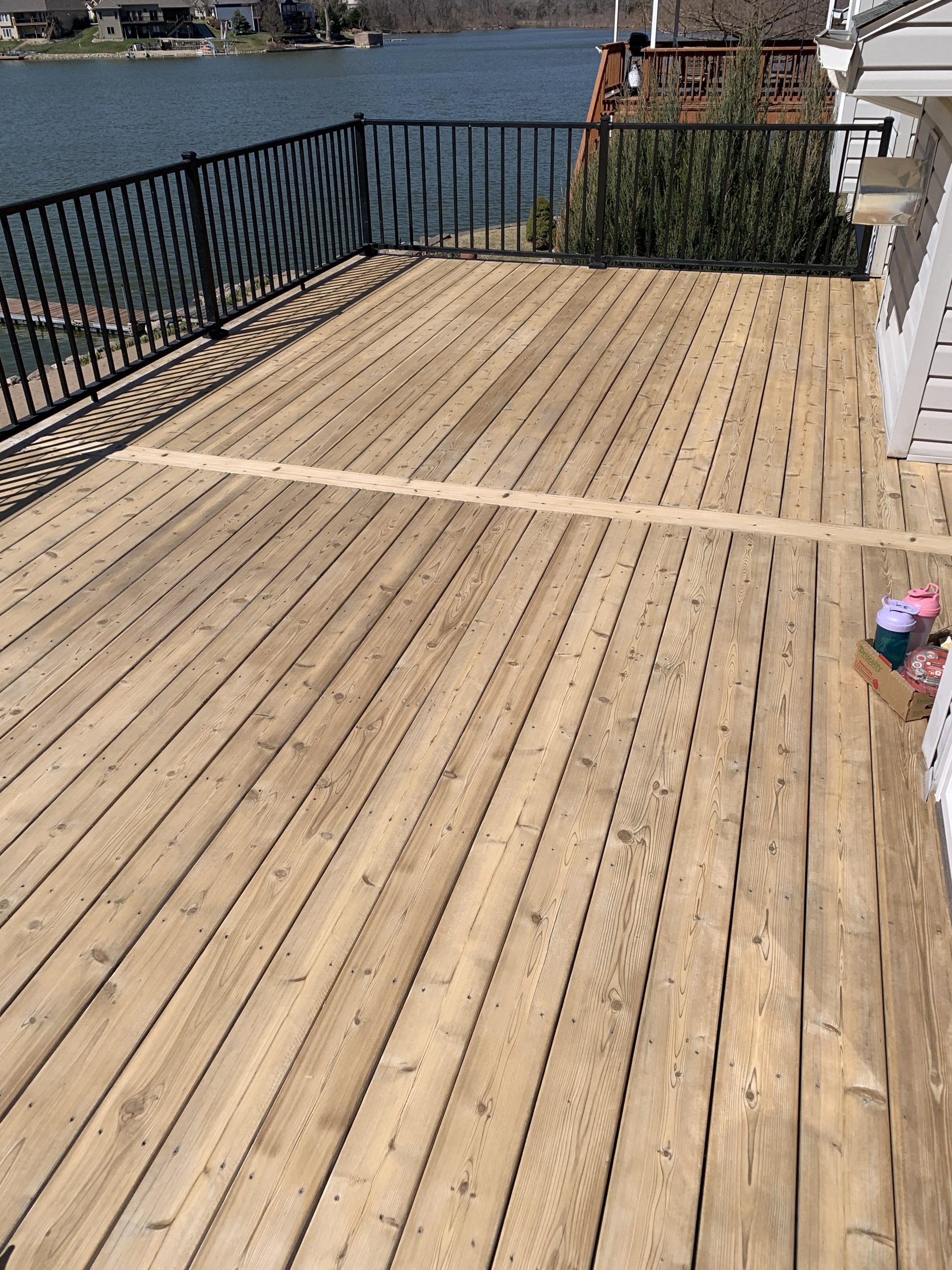

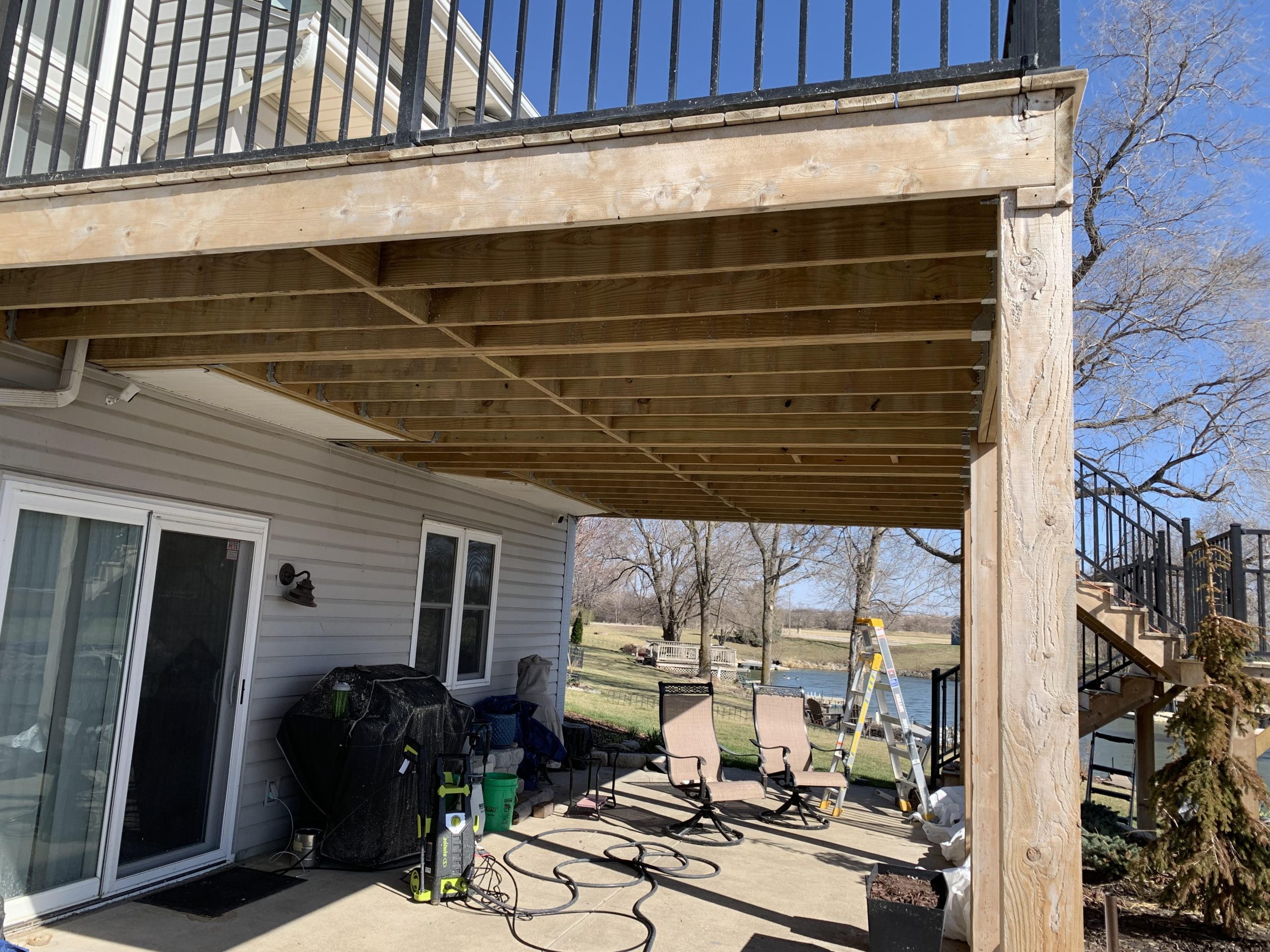

panicking, time is of the essence, supposed to be staining tomorrow, Sunday 3/29/26
Really hoping someone can pop a quick answer back 1133am CDT Sat 3/28
We have cleaned, brightened with the defy products which did amazing the prior two years – mistake made was that I was scared to use oil, so did water based clear sealer, which is the devil.
Finally flipping to oil now
We are doing all of this ourselves, have had a professional deck guy helping mentor us with advice
He looked at it and said that he thinks I should do more rinsing because of the white areas still showing in between the grain, still remaining after sanding with 80 grit on cedar-in Omaha Nebraska if that makes a difference
I am really dreading starting the whole rinsing process all over again, and waiting for low moisture content to 13% at least.
I have the time off these next several days to get this done before precipitation starts hitting us on Wednesday
Will you please look and tell me if you feel that it is necessary to do yet another rinse session, as I’m already 50 hours into this myself with physical challenges; and while I don’t wanna have to start the rinse process again, I certainly don’t want all of this time invested only to end up with residual leeching through the stain once supplied – if, another final rinse truly is needed.
we’re starting to wonder if maybe this person is hoping that we get frustrated enough to hire him to finish the job, although that’s not an option as we cannot afford it
I do know that the 1 post photo I am sending to you definitely needs to re-rinsing, it is clear that that layer is definitely bleaching through
But I am not convinced yet, that the rest of the deck and beams need an entire re-rinsing
And I do understand “furries” and that we do have some still present despite sanding

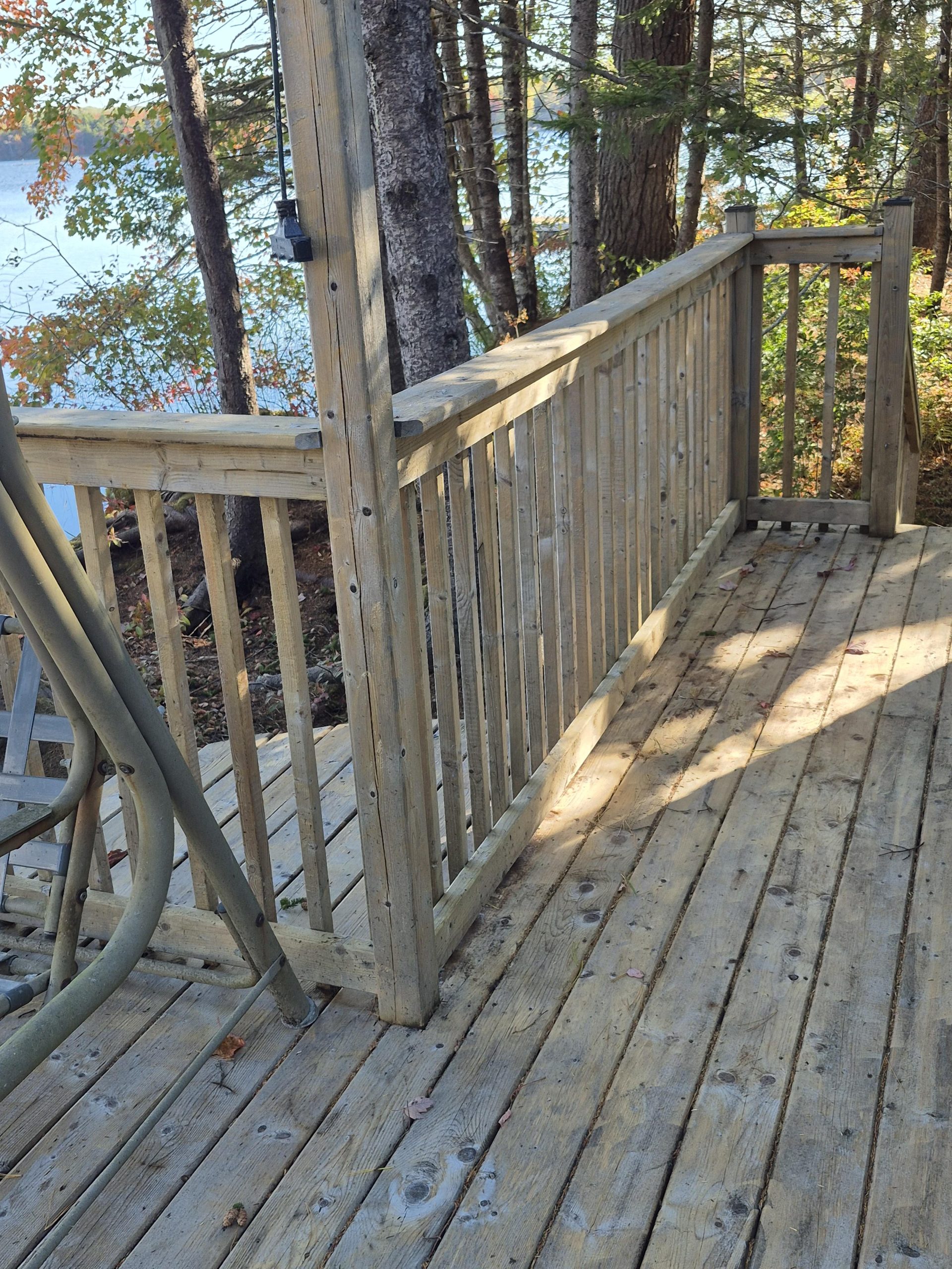

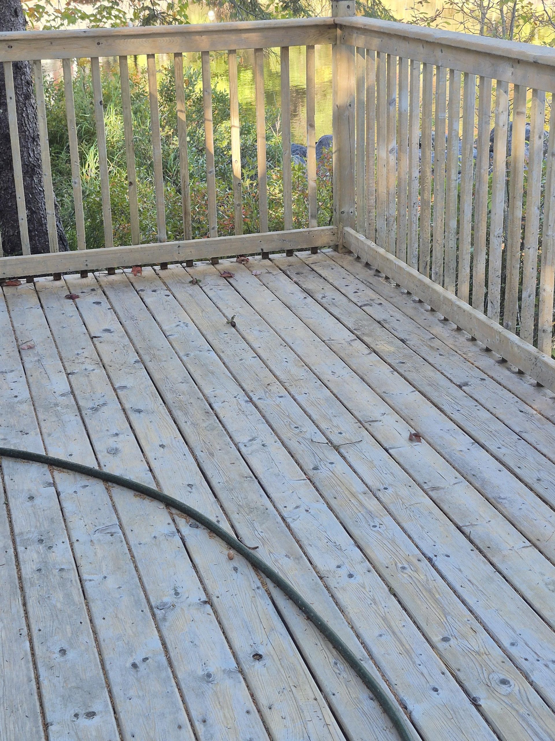

Thank-you. This site has been enlightening to say the least. So prior to seeing it, already had cleaned 7 year old, weathered, previously untreated in any manner by me, PT deck with Thompson’s wood cleaner. End result will be Defy semi-transparent cedar stain. Suggested intermediate steps? Thanks, Stephen

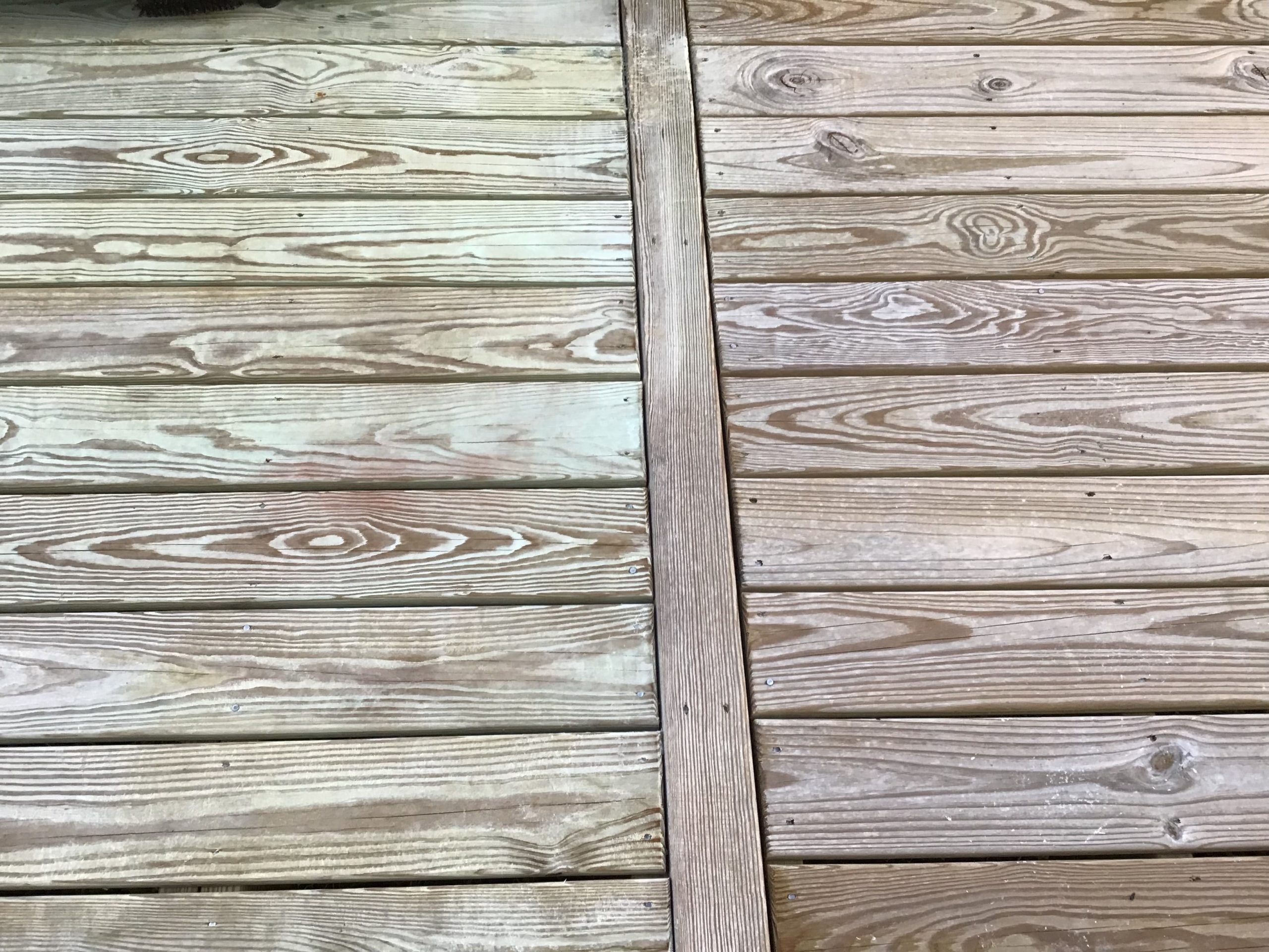

How can I tell if the brighterner has been washed off well?
I rinsed each board twice/three times using power washer.
Some board that have dried since the brightening and washing, still have a slight white powdery layer on them.
P.S. how does one include photo attachments to the messages?

Not sure if my previous reply went through
Here is a photo of the white powdery looking stain left after multiple rinsing with a power washer. Is this still not sufficiently washed?

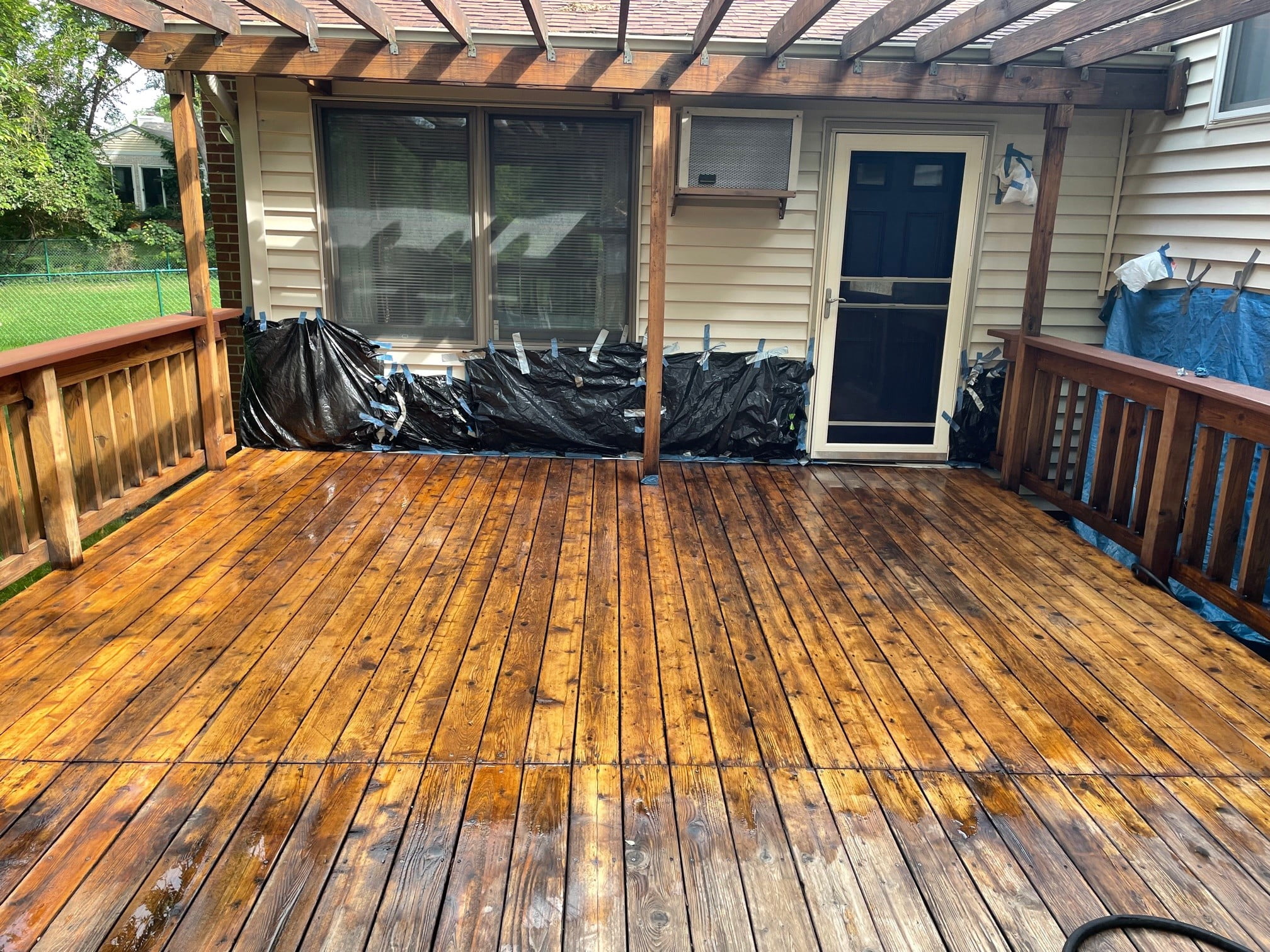

In the process of refinishing my mildewed/darkened and dirty deck, I applied Dep cleaner and then lightly powewashed it. The mess has been removed but there is still a good amount of the original semitransparent stain on the boards. Do you recommend proceeding to application of brightener before applying the same gray-colored semitransparent stain?

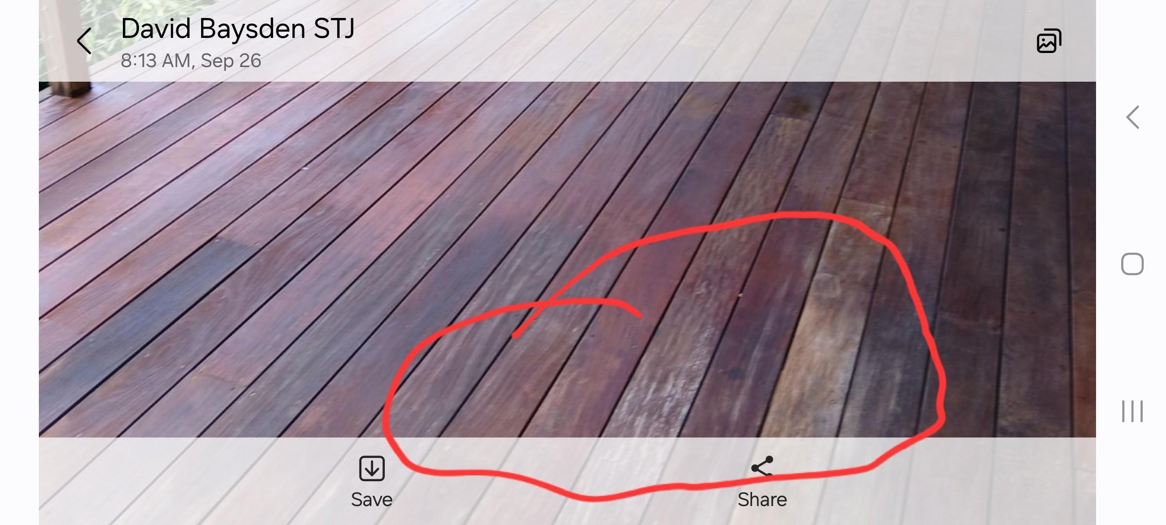

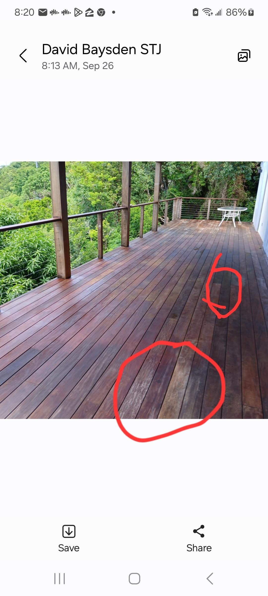

We applied the Armstrong Cark to the IPE deck and the results are less than thrilling. Lots of variation in color and some boards aren’t taking the stain. I’m perplexed.
Screenshot_20240926_082115_Messages
2874543994859377375
1006526401423085090
Screenshot_20240926_082034_Messages
John Tulchin
John Tulchin
Thanks Scott. We’re hearing ‘lapachol” from others as well. Is there any rhyme or reason to when lapachol presents? Does it come and go? We didn’t experience this with the initial finishing 5 years ago and didn’t notice anything during the cleaning and brightening process. Is there anything we can do now to lessen the effects? We expect that we will have to reapply stain in 6-12 months due to the extreme UV exposure, is there anything we can do at that time to lessen the effects? We’re thinking a darker tint may help.

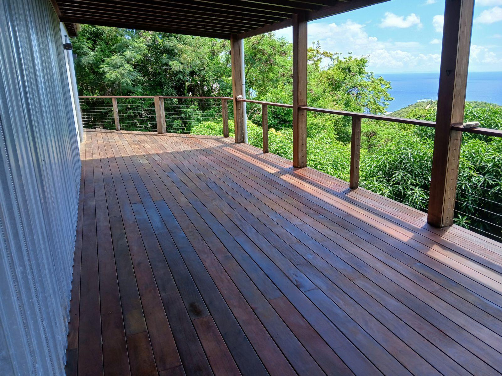

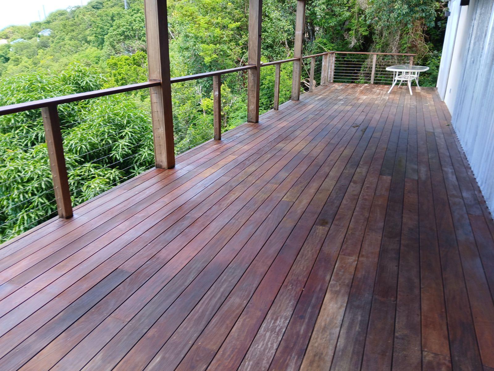

I have an ipe deck that gets a lot of Caribbean sun. It was originally finished with Cabots Australian Timber Oil and it has not performed well. There is a lot of uneven weathering and some of the deck is going gray. Nothing has been done to the deck since the original finish abiut 3 years ago. We’re stripping the deck with Penofin’s stripper and then using deck brightener. The deck looks pretty good in some areas but other areas have a lot of variation and also some dark stains that aren’t coming up. Looking for suggestions on things to try before we finish with Penofin.
Steps thus far
1. Penofin stripper
2. Penofin cleaner with agitation and low pressure power wash
3. Penofin brighter
John Tulchin
John Tulchin

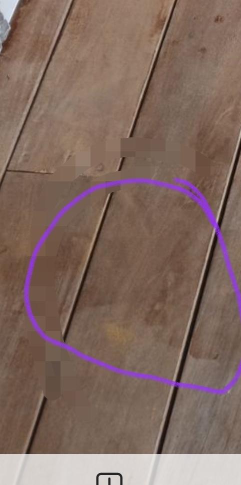

Here’s a Pic after multiple stripping/cleanings. The dark areas are where we applied stripper on some stubborn spots.
5012570718934838363
John Tulchin
John Tulchin
I’m a little worried that there’s still a.lot of uneven color and some blotches compared to the beautiful grain of the original wood. Will the color variations be exacerbated or mitigated by the Oil finsh. I’ll be using Armstrong Clark amber. Also would like to get an idea of the recommended ongoing maintenance. The deck is in the Caribbean in full sun so there’s serious UV exposure. I expect we will have to reapply every 6-8 months. Will that be just a cleaning and reapply? Some areas in the sun will be faded whereas other areas will not. If we just hit the entire deck again will it even up.? The alternative is to not oil it and let it go gray but I love the rich color when it’s oiled

More pics. Let me know whether sanding will help or if this will disappear when the finish is applied.

John Tulchin
John Tulchin
Here are the latest photos. There are still have some areas with color variation including some black spots, some that look like residual stain and dome areas that look bleeched. Should we continue to try to strip and/or sand or is there another approach for these areas?

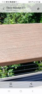

Thanks. We’re continuing to strip and will also try spot sanding the blemishes …The handrails are very noticeably golden and much more dried out compared to the rest of the deck. I’m not sure why that is as it’s the same material with the same original finish. Could be just a difference in sun exposure? We’re concerned about how they will look when stained. Do you have any experience with this?
Screenshot_20240911_113437_Messages
John Tulchin
John Tulchin

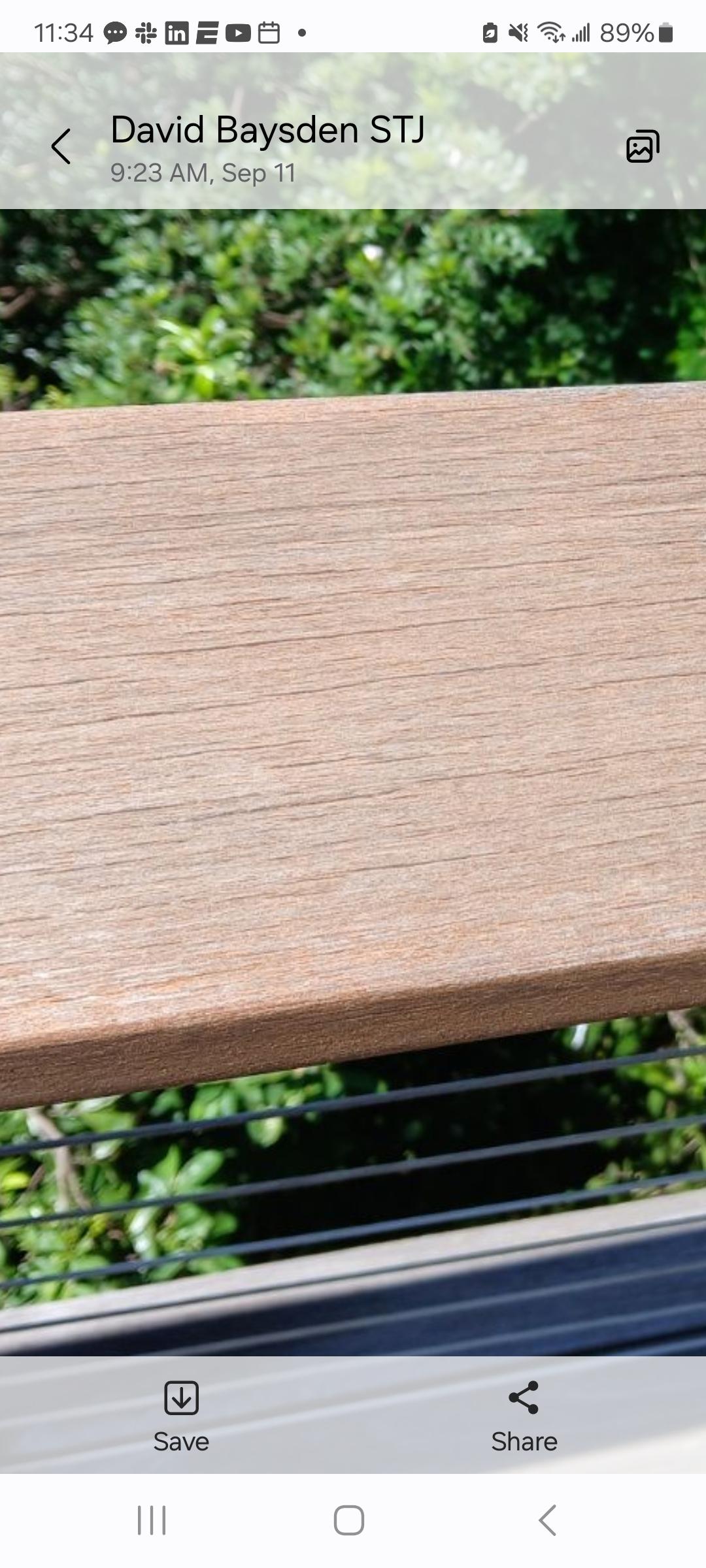

Yes it’s the same wood, wondering why the handrails now appear so much more golden and much drier compared to the rest and whether we should do anything different when applying the finish
John Tulchin
John Tulchin
Yes it’s the same wood but it’s much more golden color and more dried out. Is there anything we can do in the process so it looks the same color as the deck after finishing? Right now it looks quite different. Prior to stripping the color looked similar although the handrails looked more dried out and weathered

One more. I’m a little worried that there’s still a.lot of uneven color and some blotches compared to the beautiful grain of the original wood. Will the color variations be exacerbated or mitigated by the Oil finsh. I’ll be using Armstrong Clark amber. Also would like to get an idea of the recommended ongoing maintenance. The deck is in the Caribbean in full sun so there’s serious UV exposure. I expect we will have to reapply every 6-8 months. Will that be just a cleaning and reapply? Some areas in the sun will be faded whereas other areas will not. If we just hit the entire deck again will it even up.? The alternative is to not oil it and let it go gray but I love the rich color when it’s oiled

Here is a photo of the weathered Cabots Australian Timber oil

Thanks for the tip on stains. We will use Armstrong Clark instead

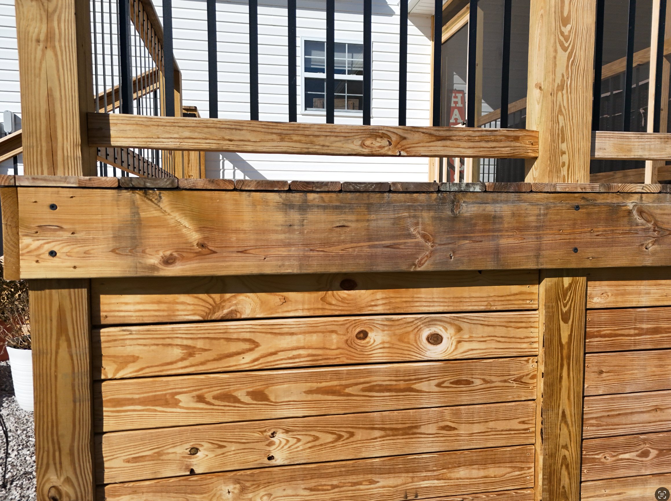

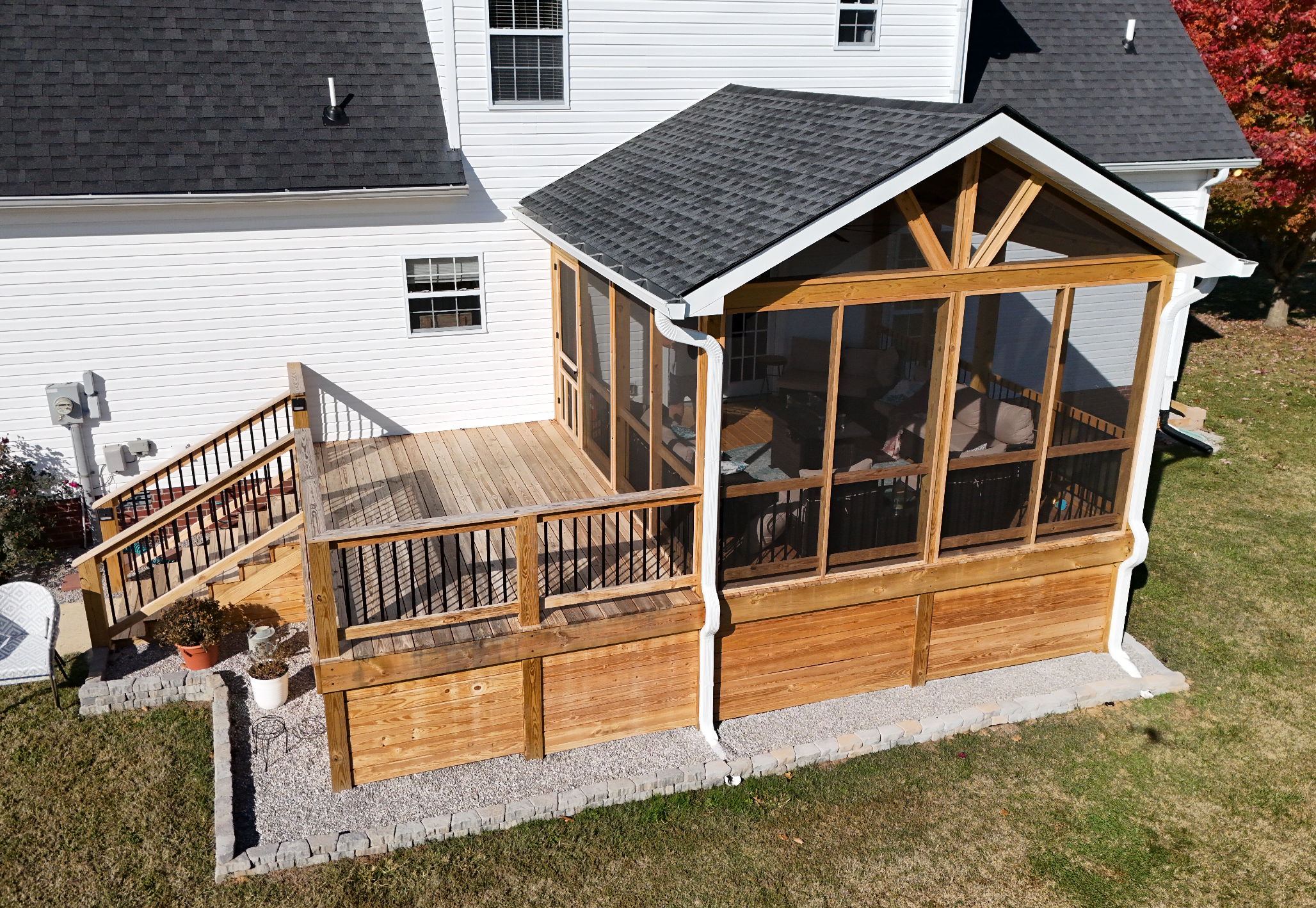

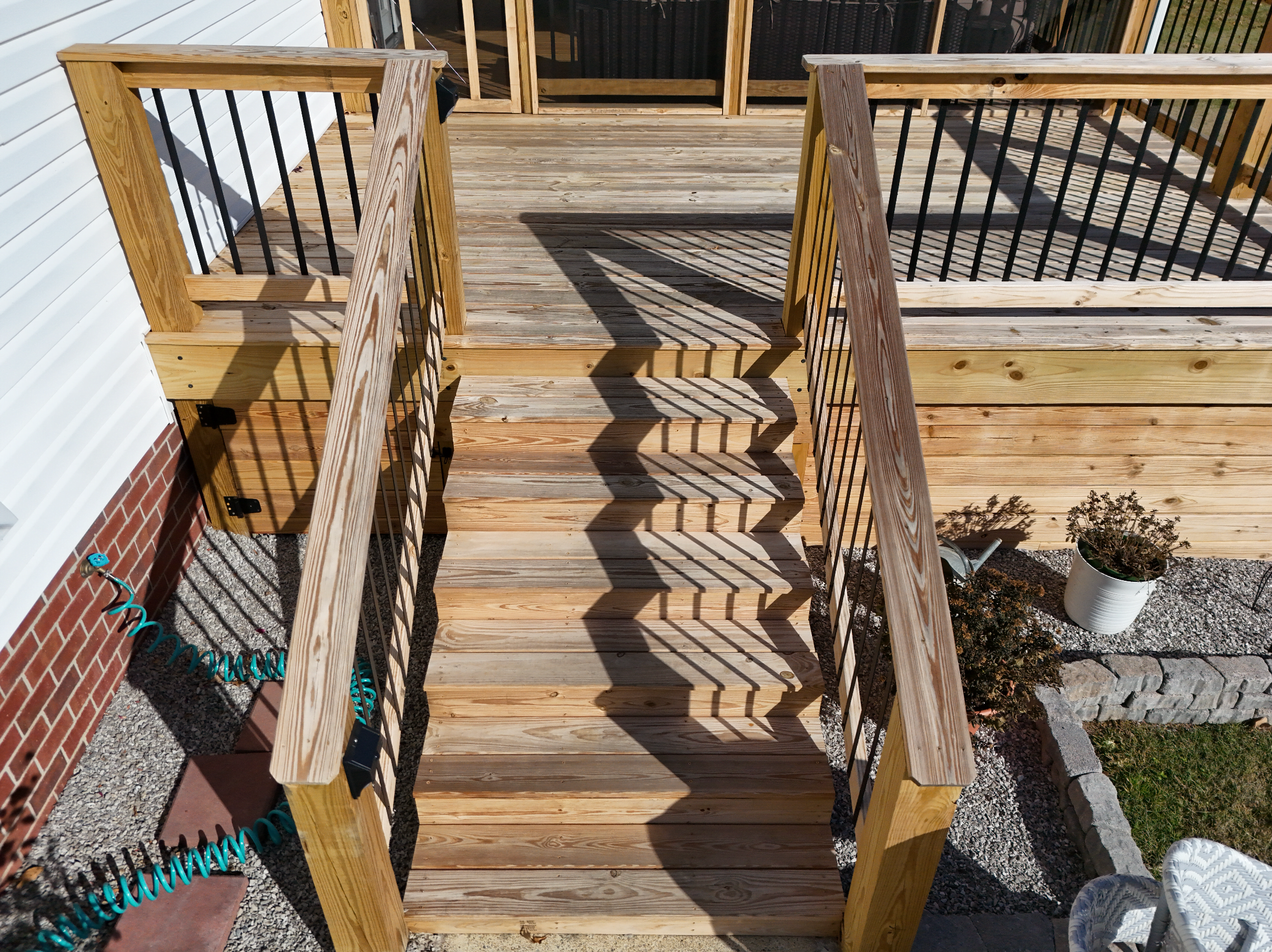

Thank you for your time! Our deck was built June 2023. It is now Nov. 2, 2023. Pressure treated pine wood. Seems to me the uncovered area is ready. But covered and inside look not as weathered. We live in Middle Tennessee. I was hoping to seal and stain the uncovered before winter. Question we need a deck cleaner and brightener right? And I am leaning towards Ready Seal Light Oak Semi transparent, or Cabot new cedar semi transparent. We are hoping to seal and stain uncovered before a family event on Dec 1. 2023. Main question, should we seal and stain ONLY uncovered / exposed deck now before winter? And wait until spring to seal stain the interior? Your thoughts are appreciated! This is slightly overwhelming thank you so much for your time.
