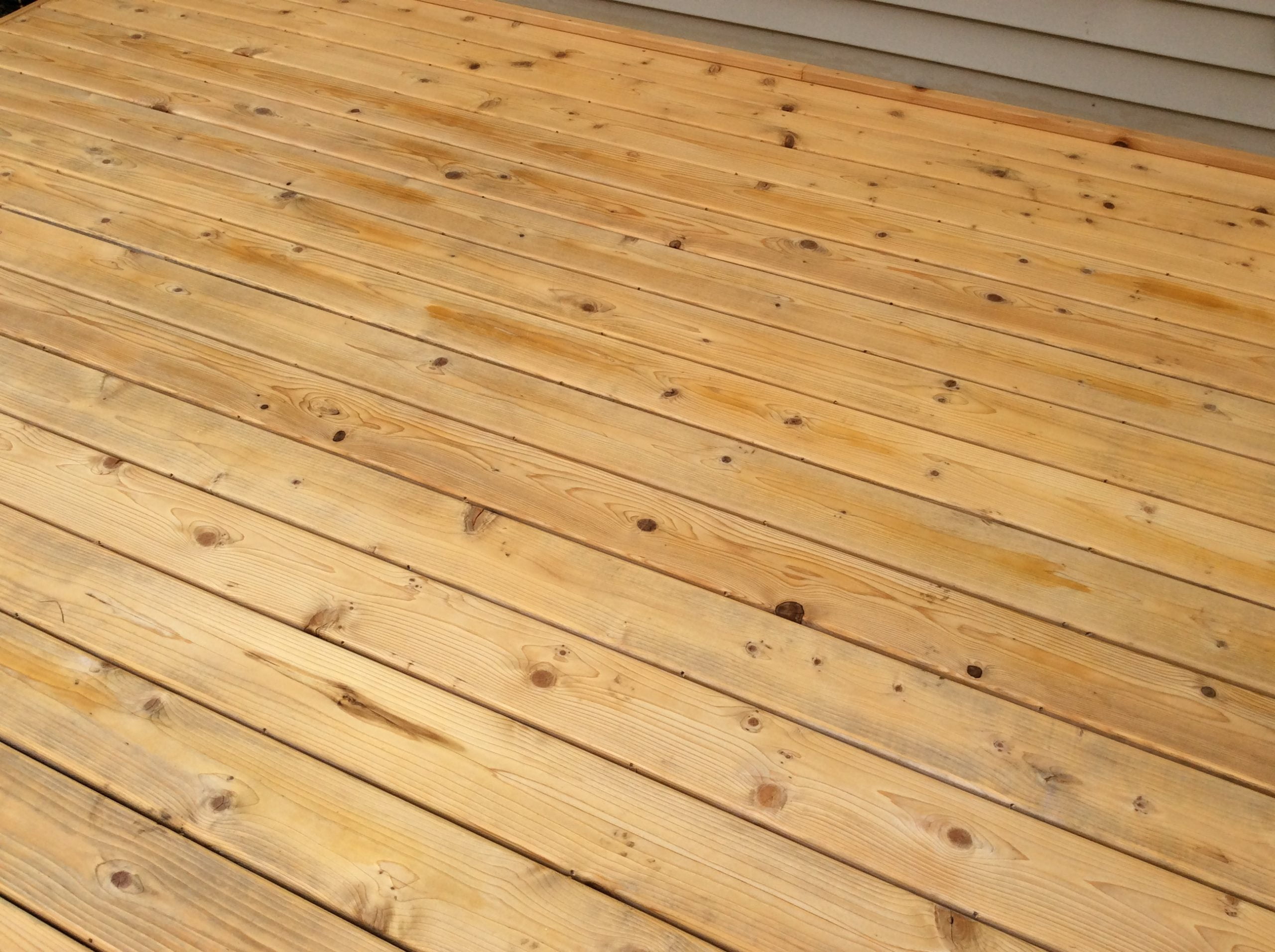

What Is a Deck Sealer?
A deck sealer typically has a clear or transparent finish, either penetrating the wood or forming a clear film on top. It helps lock out moisture and reduce water intrusion. Unwanted moisture can lead to fungal growth and wood rot, so reducing the chances of jeopardizing the wood’s longevity is crucial. A deck sealer, however, will not protect from sun damage. UV rays can be very harmful to exterior wood — prolonged, unprotected exposure to sunlight can lead to graying and fading. It also dries out the wood’s natural oils, causing cracks and splitting. So although a deck will benefit from a sealer by repelling moisture, it will still turn gray and become sun-damaged.
My Pro Tip on Deck Sealers: If you want to protect the wood from water and mold but are okay with the wood graying, there’s nothing wrong with choosing a deck sealer as your coating.
Clear Deck Sealer
Clear Deck Sealer

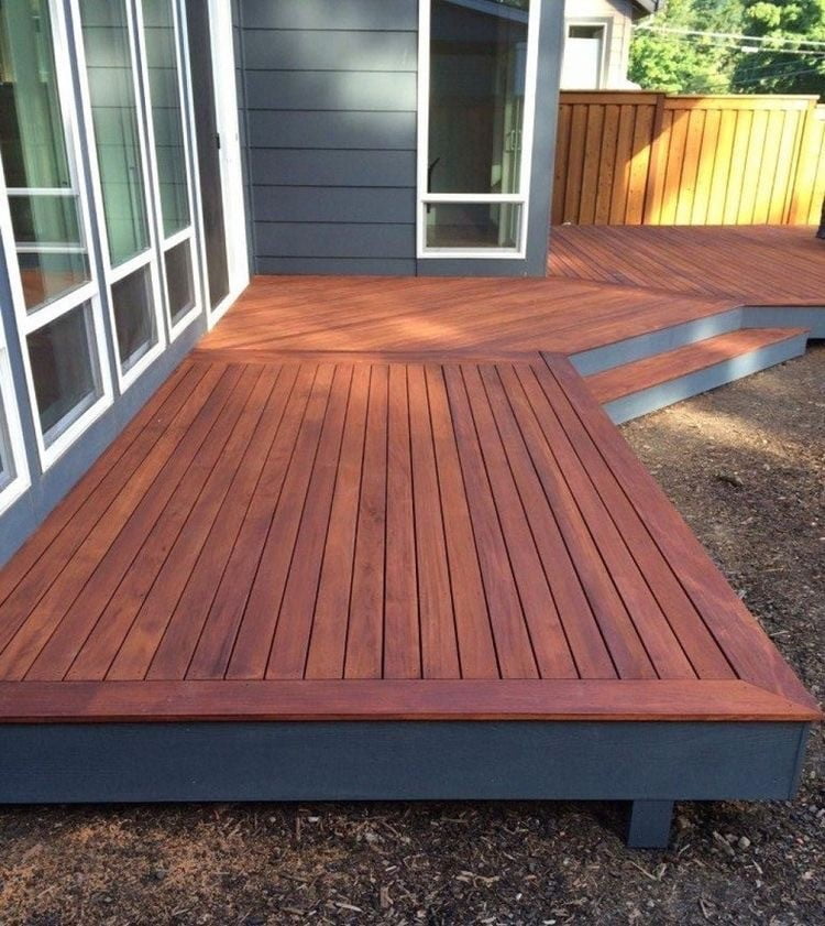

Deck Sealer vs. Deck Stain: Visual Comparison
Deck Sealer versus Deck Stain

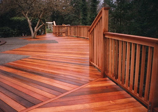

How can I get my new clear cedar deck to look like this? Is this a clear oil based product? or a tinted stain? I like the ambering effect of oil based products. I’ve done some research and some information says that clear finishes don’t have UV protection? I do have some Thompson’s Waterseal Waterproofer PLUS CLEAR Wood Protector that claims UV protection.
Deck Stain Looks Too Orange
Jonathan Arciszewski
Thank you for the information! I have ordered some Sansin products for testing.
