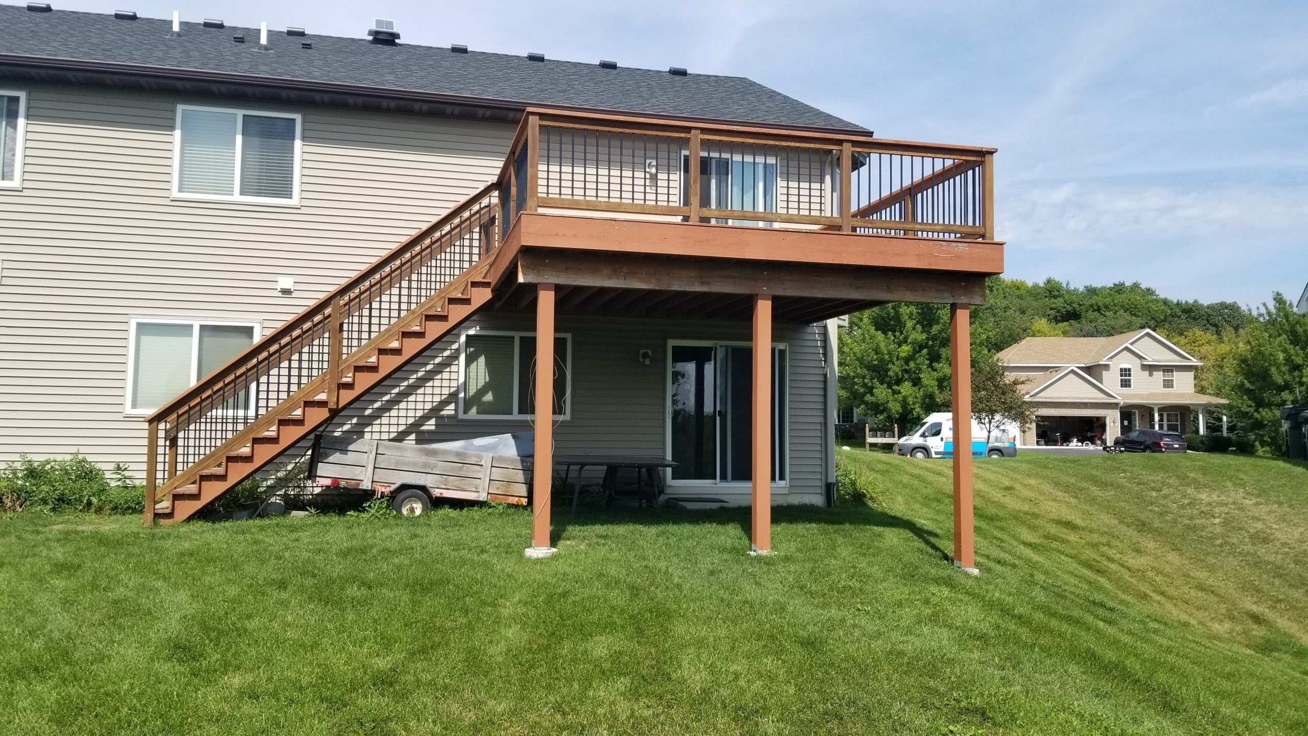

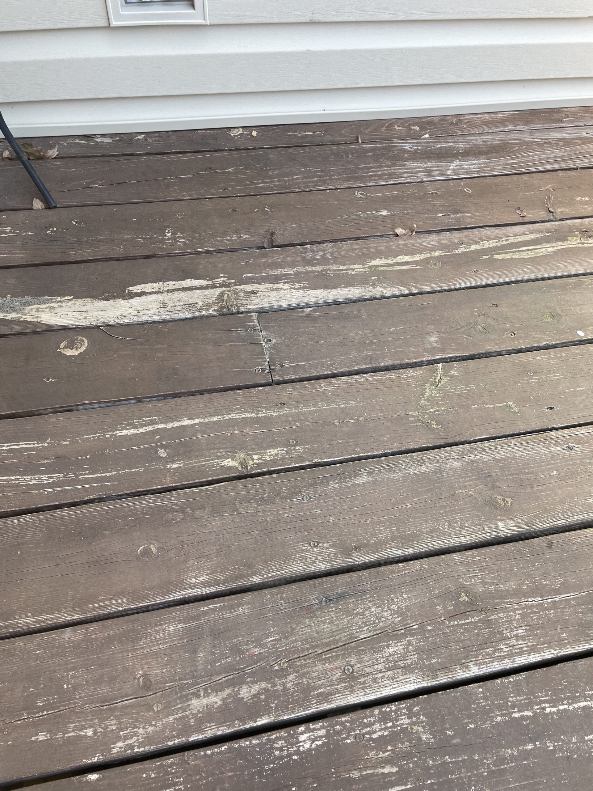

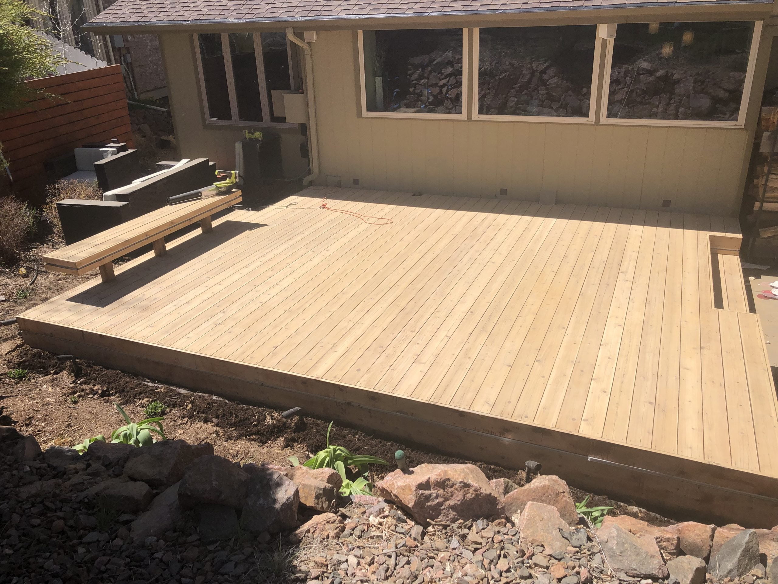

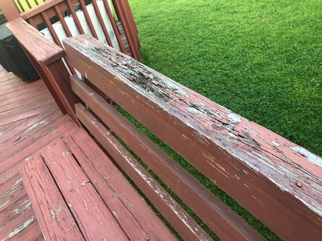

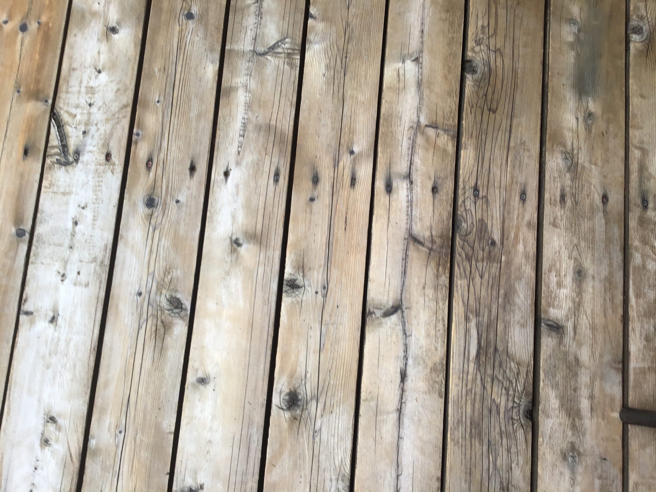

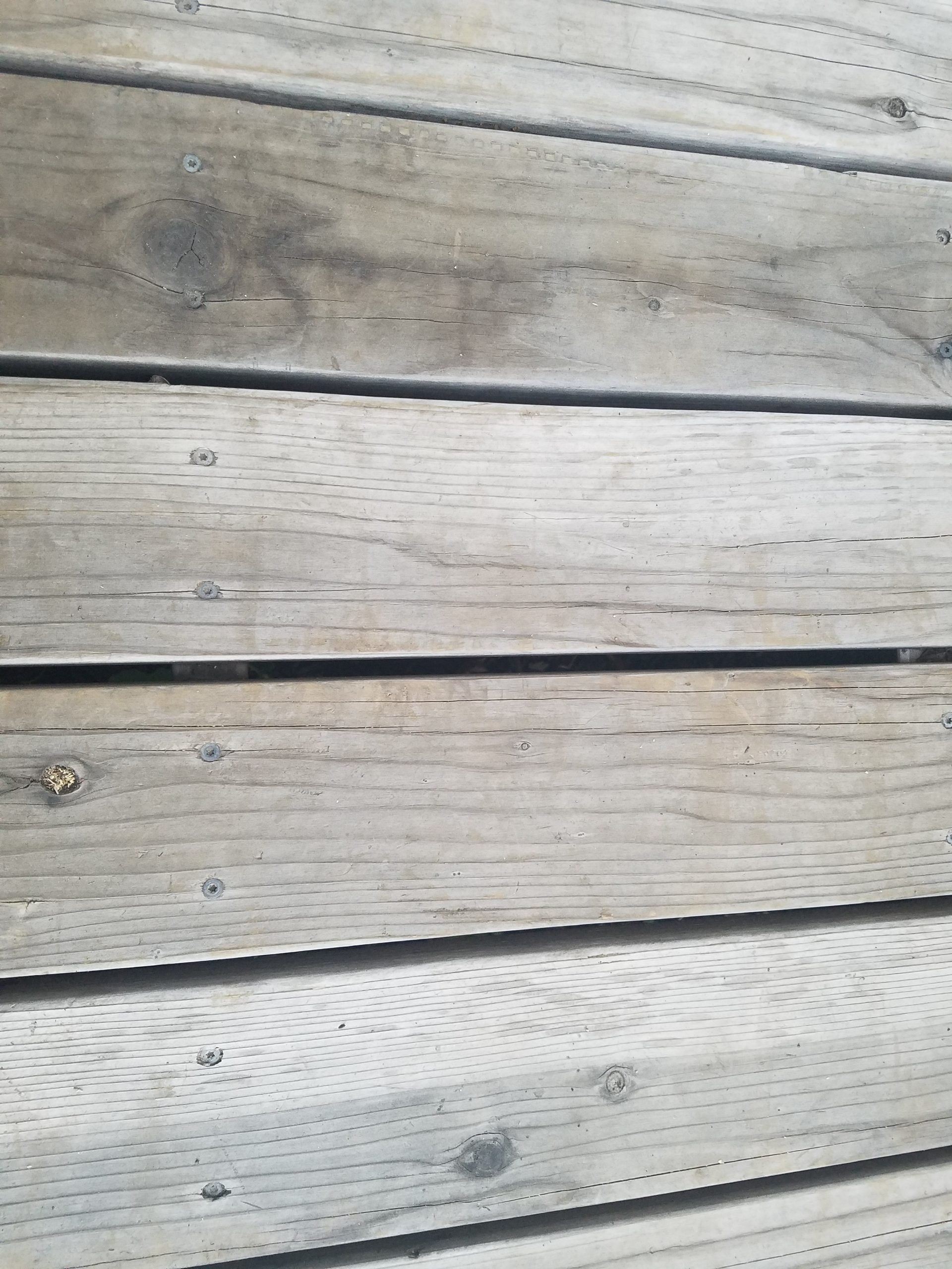

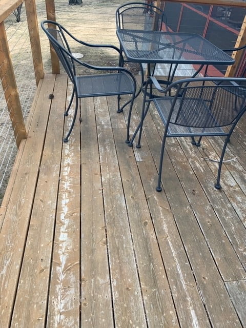

Hi! I had a deck rebuilt 5 years ago with fir. I live in VT where the deck is covered with snow most of the winter. The deck is on the south side of the house and in direct sun all summer.
I believe the new deck was initially improperly stained with oil based translucent stain over the raw (dry) wood with no preparation. Within months, the deck was covered with black splotches. Since then, it’s been cleaned and re-stained, again with translucent stain, and always looks terrible. See the photos.
detail-of-railing

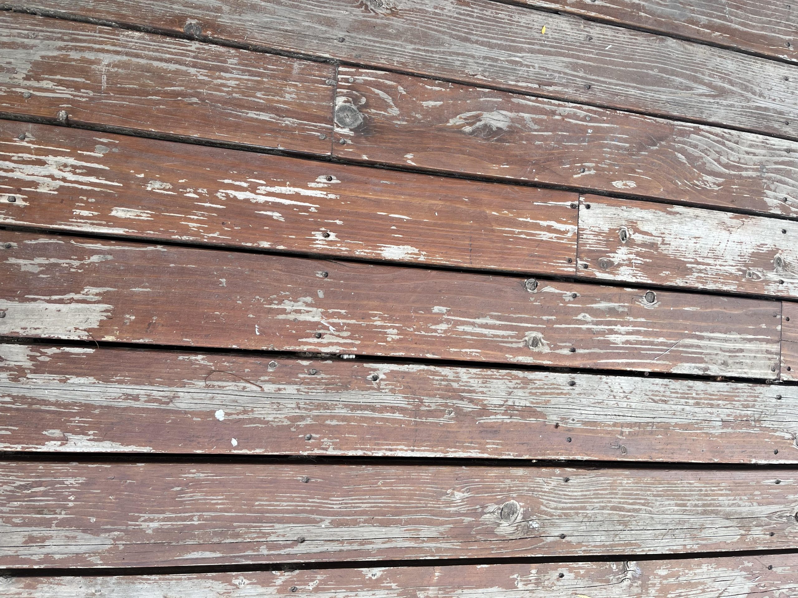

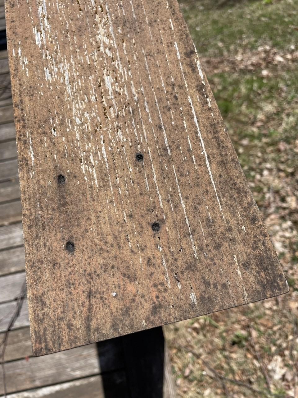

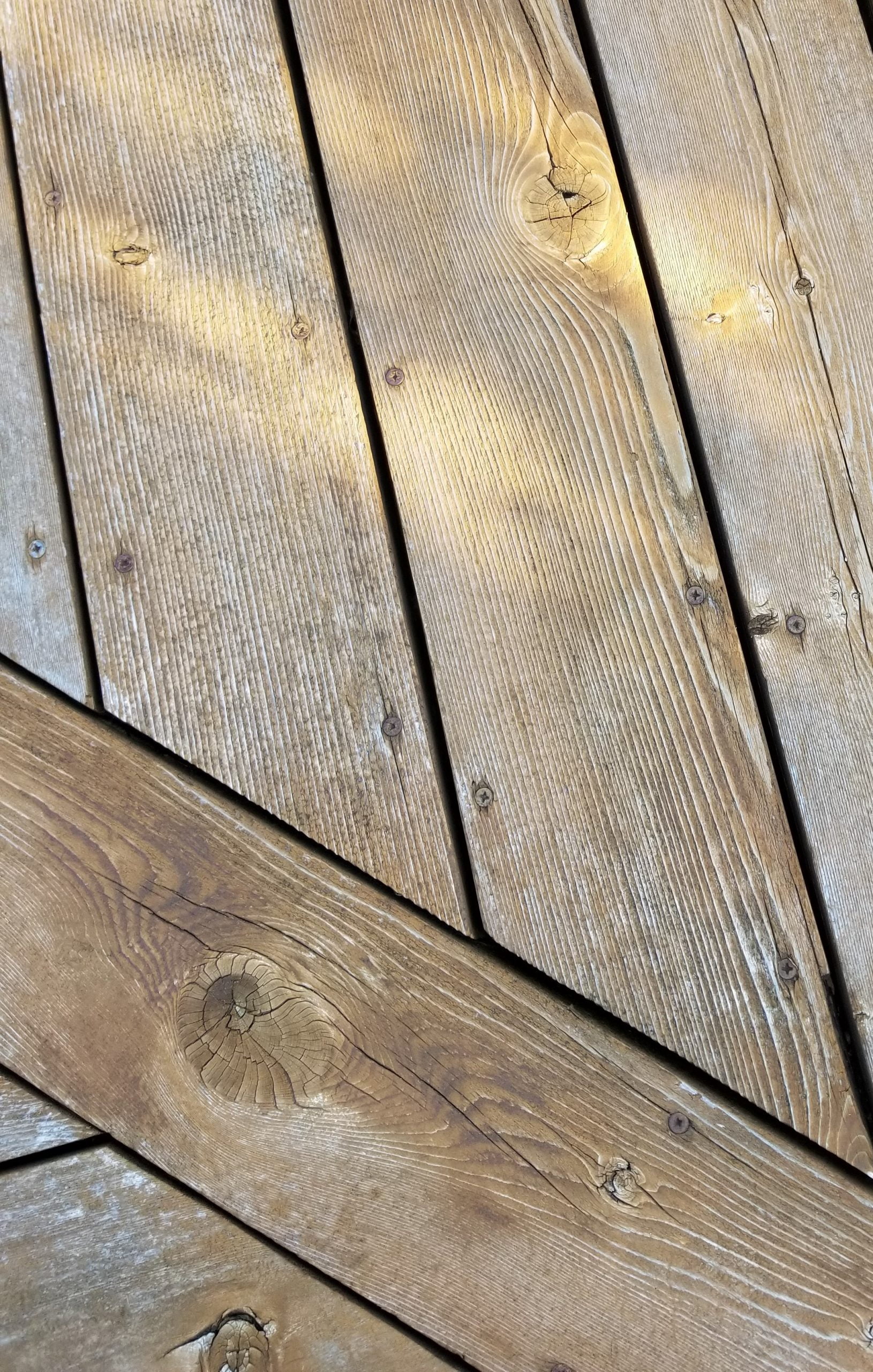

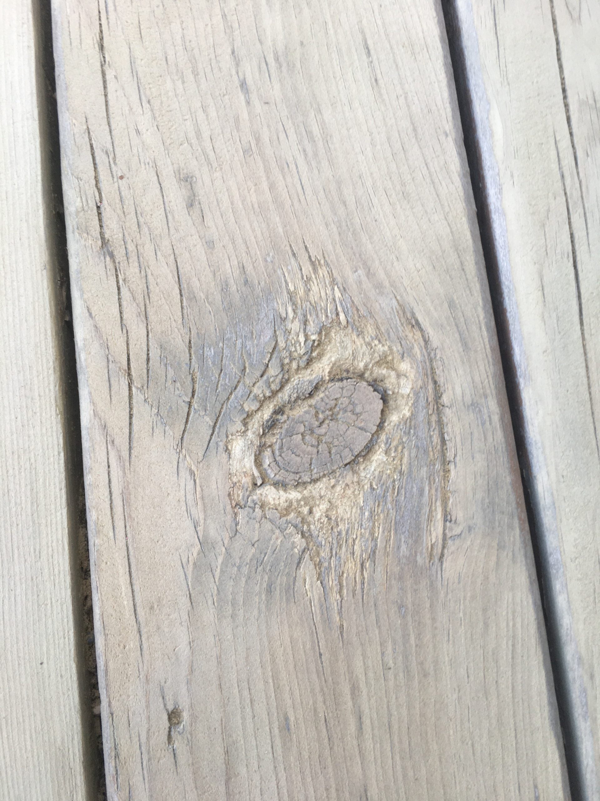

We built our redwood deck 5 years ago and used Penofins Transparent Stain in Redwood color. Each year we clean it with their step 2 and then put another coat of stain. In the shady areas (1st pic) the look is exactly what we first had and would like to continue to have, however, every year the sunny areas get blacker and blacker. This year all H… has broke loose. In areas where plant were watered or umbrellas stands were, the stain is gumming up and coming off kind of when useing the Step 2 cleaner. I called Penofin directly and she said to keep using it and leave it on longer so the cleaner will do the work. Well the cleaner isn’t cutting it. Leaves hairy chunks is some spots and does nothing in others.
Thinking I need to strip it all and start over. What do you recommend and what have done wrong? Help and Thank you. PS we live in high desert 4 season area of far northern CA.

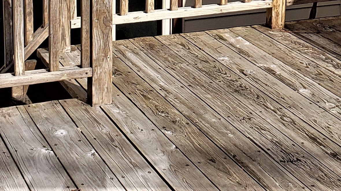

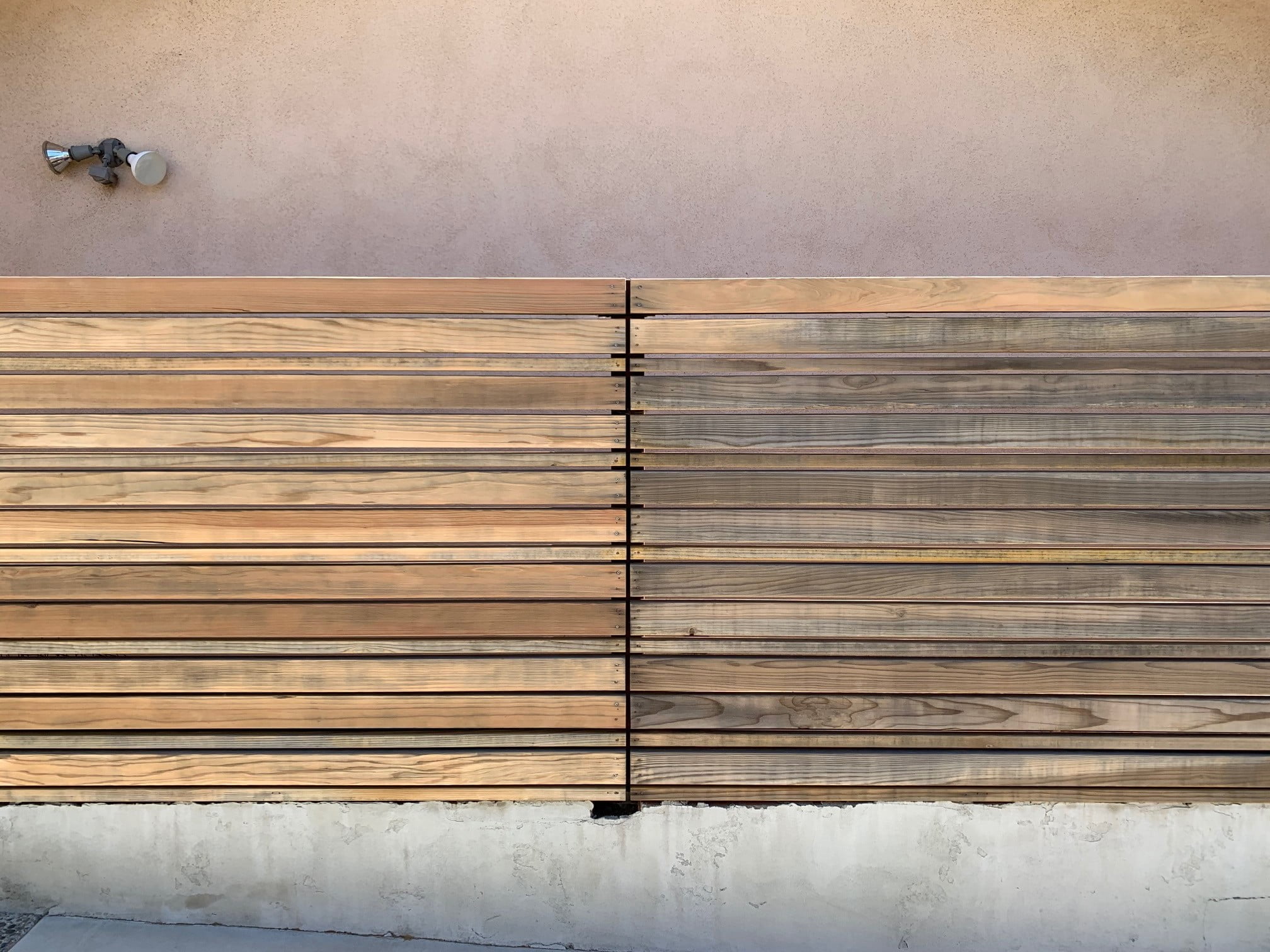

I have a ~25 year old redwood deck located in Ruidoso New Mexico. It is in the Rocky mountains at about 7500′ elevation so intense summertime sun and sometimes significant snow in the winter. About 5 years ago I hired someone to restain it and they put solid stain down (while I was not present to protest!) on top of what had been semi-transparent. The solid stain was peeling up pretty badly so about two years ago we sanded it down to bare wood and applied Cabot’s Wood Toned Deck and Siding Stain (#3002 Cedar) – a translucent oil stain. This looked great initially but now appears to be totally gone — the wood looks bare to my eye, water doesn’t bead at all, etc. So I am about to redo it. The wood itself is in great shape (for 25 y.o.). I am planning to use a TWP 100 semi-transparent product — maybe the 102 Redwood since I think it would show some wood grain (which I like / want) and also have decent UV protection. I would be interested in your thoughts about that … but my primary question is about the prep. Do you think I should strip + brighten since I am changing products … or given the situation and wood I am describing would clean + brighten be ok? Thanks in advance for your advice.
IMG_4255-RUI-Deck
Adam
Adam

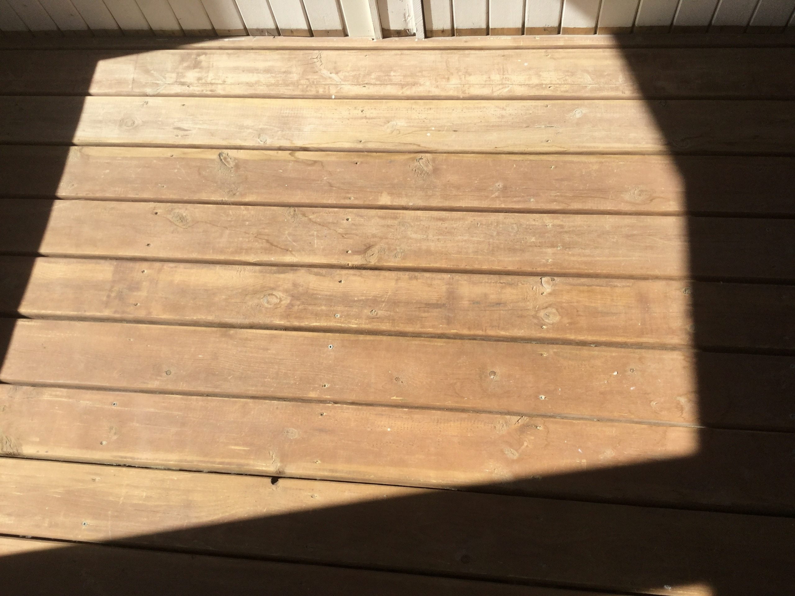

Thanks for your reply Scott. Followup question: This time of year an average day is sunny with high temps around 60 and low temps in the 30s, with daytime relative humidity around 20%. If i strip and brighten one day then let wood sit for 48 hours before staining … if temp is forecast to drop to 25-30 range overnight is that a deal-breaker for staining that day? Or with several hours of sun and low humidity immediately after staining is that overnight low temp ok? I would really like to get the stain down before winter sets in … but of course i dont want to compromise the end results! Thanks again

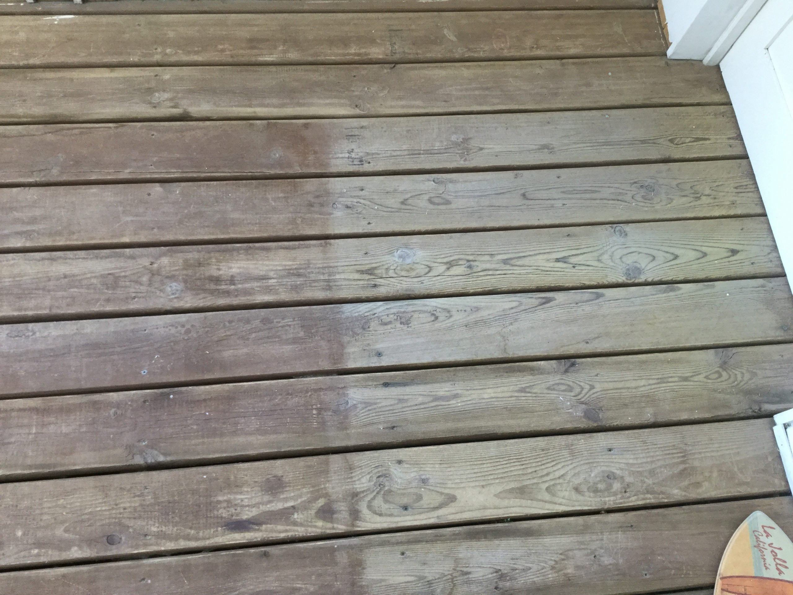

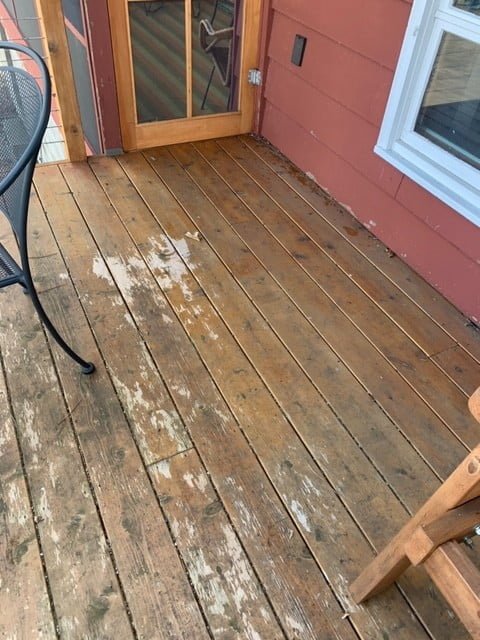

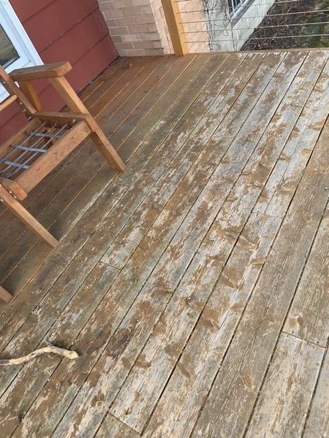

Hi there, I stained by deck about 4 years ago and it’s much overdue for a restain. However, half of the deck is covered and half exposed to the harsh elements (intense sun and snow/ice) so the wear and tear between these areas is significant. How would you recommend prepping this deck for an even finish and do you have recommendations for a tough finish?
IMG_0085

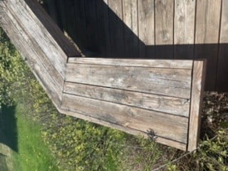

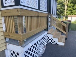

Hi, Scott. Just got a new pine deck built in April and had it stained a few days ago. We were going for a two toned look. Unfortunately, we don’t like the end result and desperately want to change to a lighter stain on the skirt. What’s your recommendation on how to accomplish that as effectively and as economically as possible. The larger deck on an angle in one photo is the one we were hoping to achieve. The smaller deck where the photo is straight on is the one we ended up with. Halp!

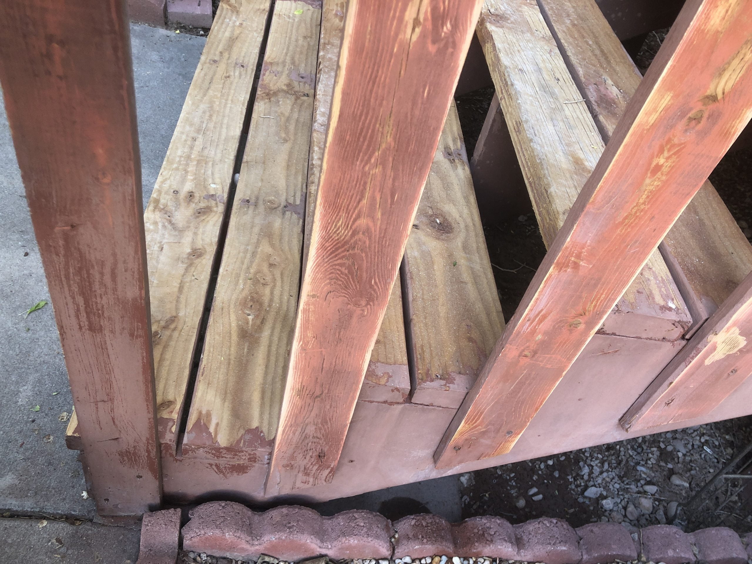

We used Rymar stain
Hi Scott, what a wonderful site! This deck is weathered with an Arborcoat solid stain. See the photos I added. Can I get away with using a cleaner instead of a stripper? I don’t want to have to remove all the stain before re-staining.
Also, what solid stain do you recommend if I want the same color as the Arborcoat?

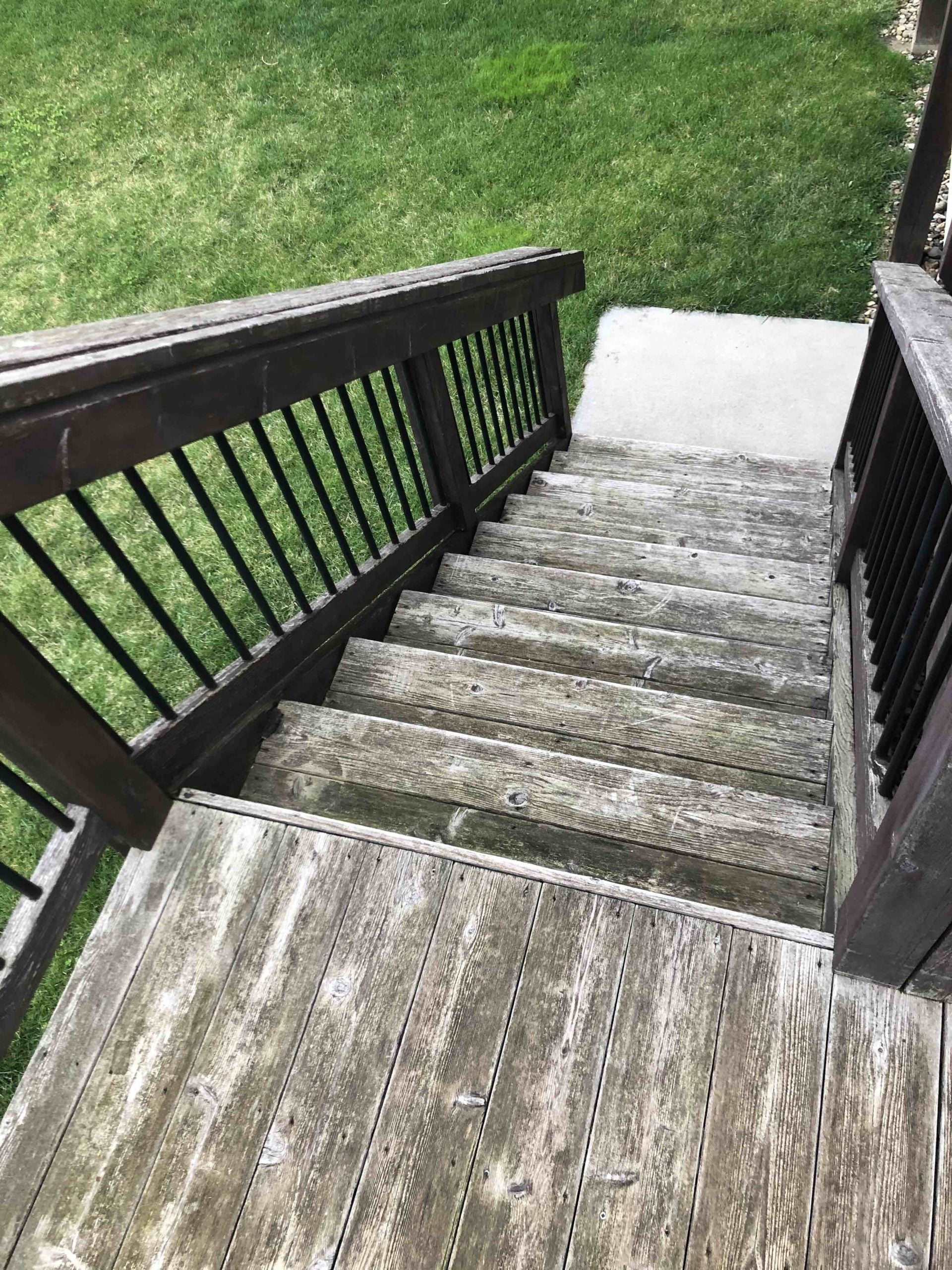

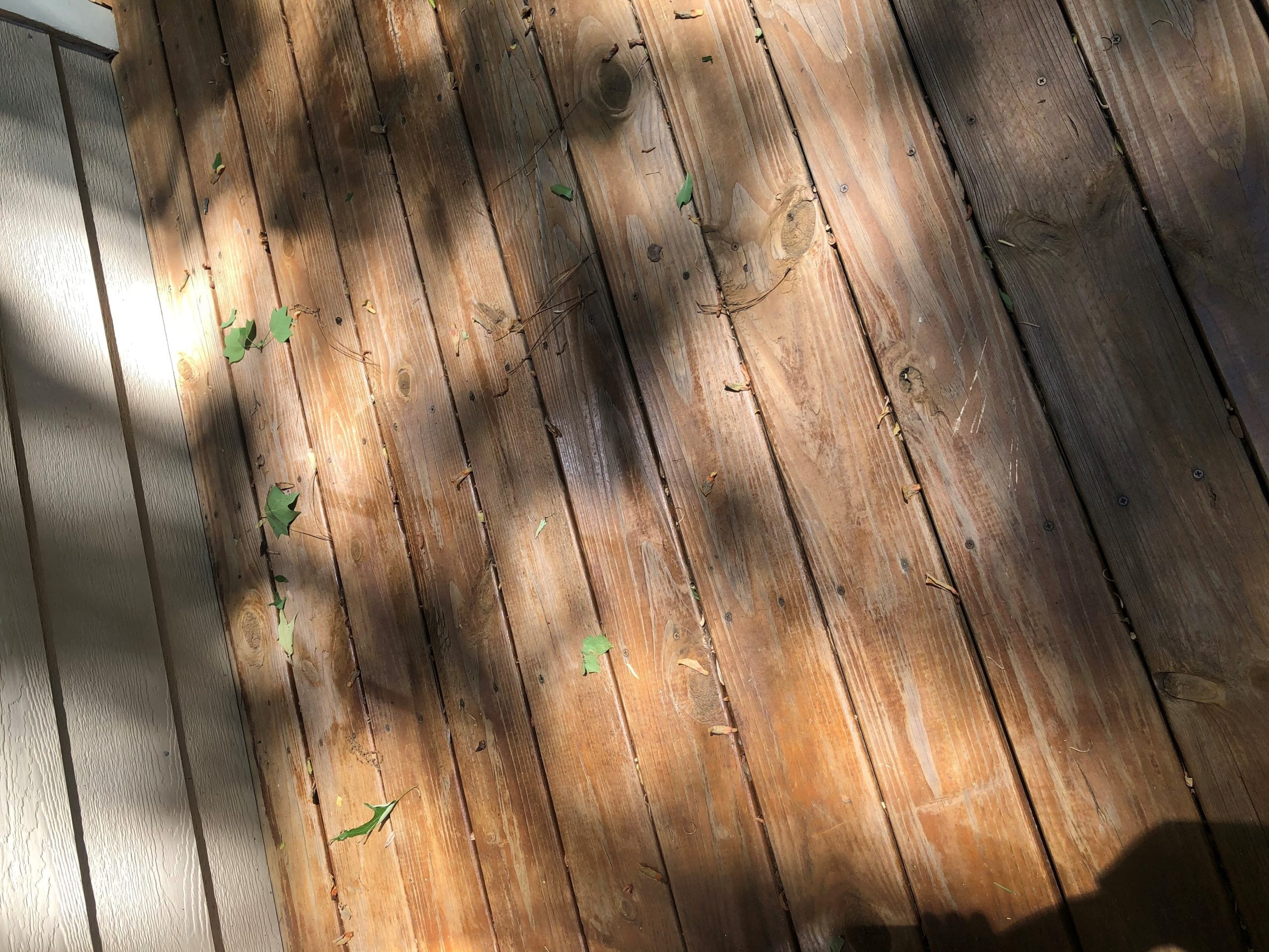

Hey Scott, thank you for all the great information and help! Our property is lake front, so I was hoping not to use harsh chemicals on this project. I used a random orbital floor sander to try to remove as much as I could, then was intending to use sodium percarbonate to clean and then brighten. I am worried what stain remains on the deck may not come up in the cleaning process and become an issue down the road. Do you recommend that I use a stripper for this, or do you think cleaner would be sufficient? Thank you!
IMG_9036
IMG_9043
IMG_9044
IMG_9045
Thank you very much for your input!

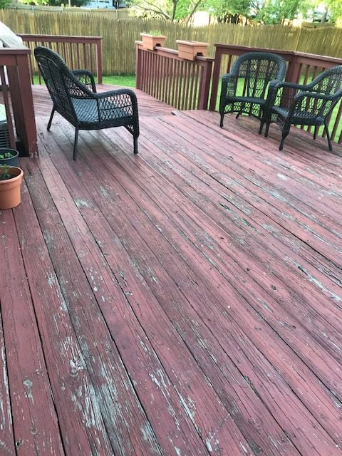

I have on a tigerwood deck with Ready Seal stain on it. I would like to remove the stain before I put a stain on it. What is the best stain stripper I could use. Let me know your suggestions. Thank you for you help

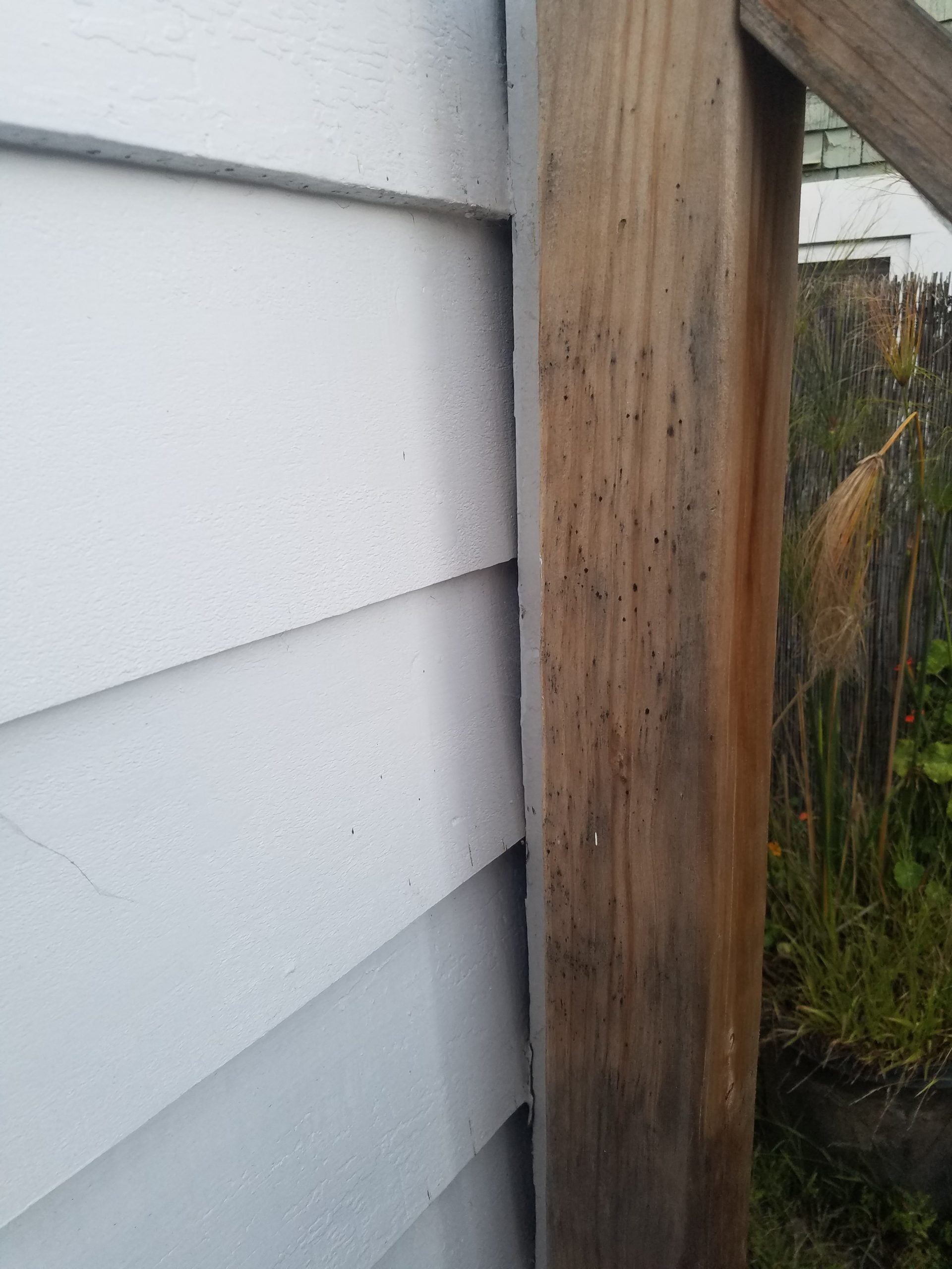

Hi, I have a covered porch with the deck that the former owner built and used SW SuperDeck oil-based Transparent Cedar Tone Natural. I am planning to maintain it. If I still use the same product, do I need to use stripper?
I read your review and seems that TWP is better product. If I switch TWP, do I need to use stripper?
Here are my deck pictures. Thank you very much!

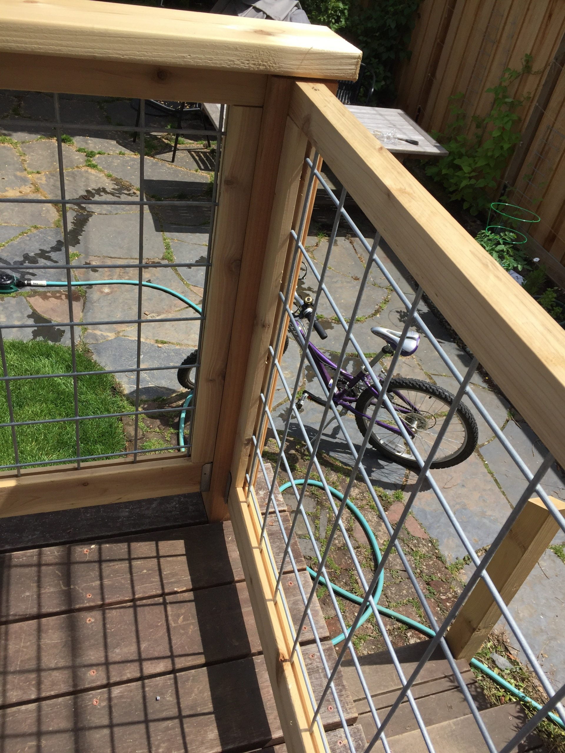

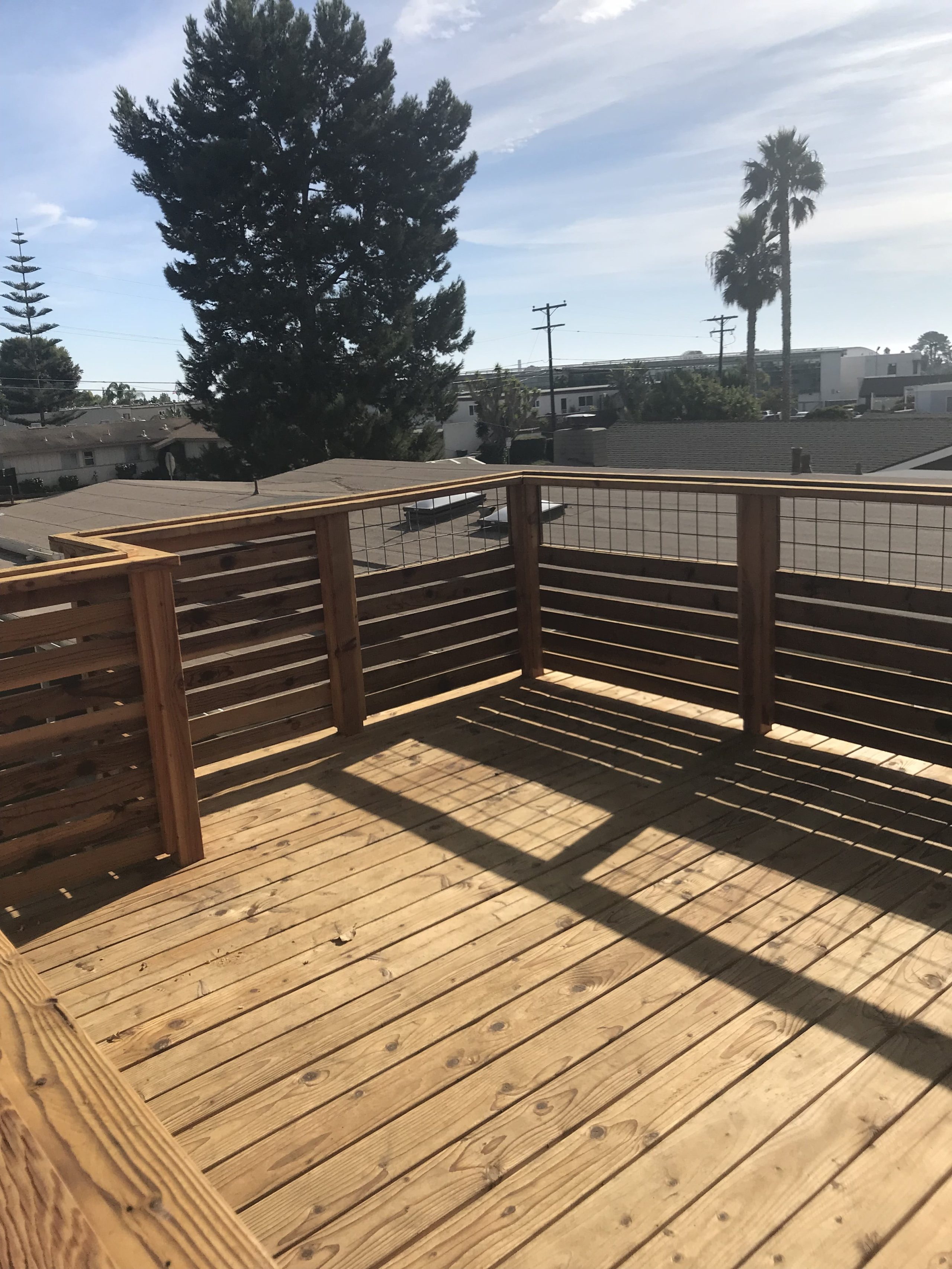

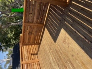

I replaced 18 mahogany decking boards with new ones and hope they all blend with the older boards. I am planning on using Wolman paint stripper followed immediately with Defy Wood Brightener. Can I use two different manufacturer products? Will I definitely have the “fuzzies” to hand sand? Thanks.

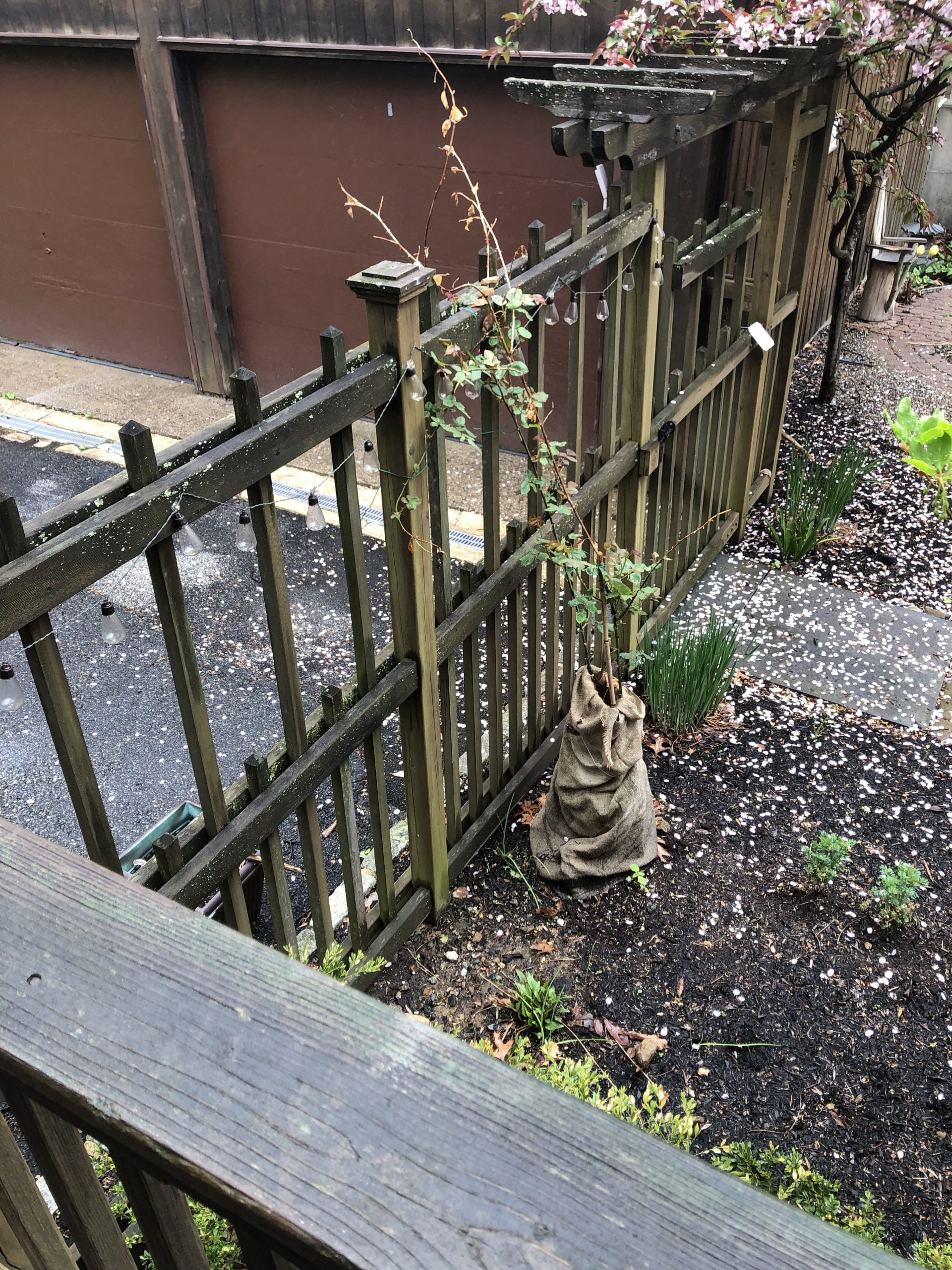

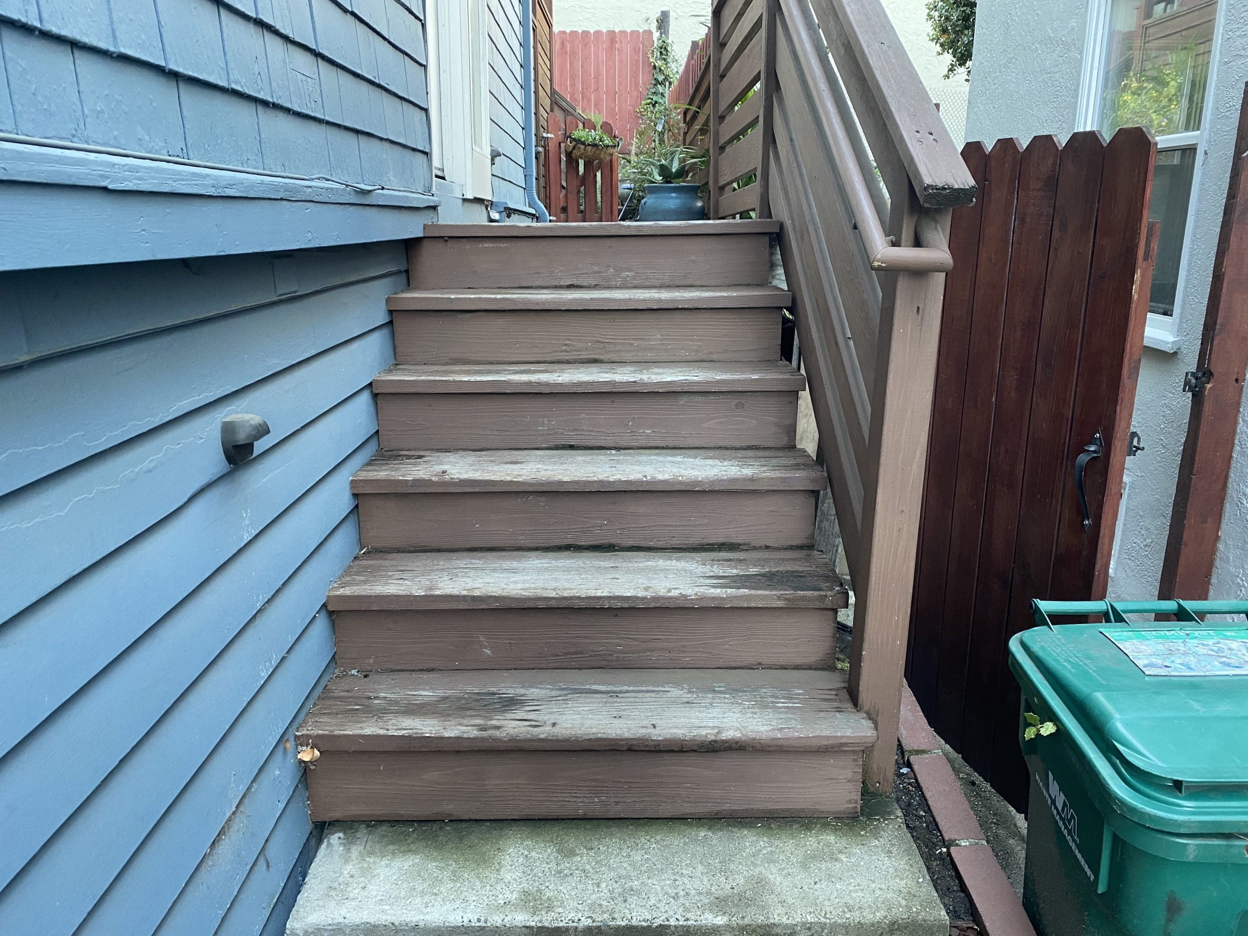

Here are the photos of fence and staircase
R Jolly
R Jolly
Here are photos of deck
R Jolly
R Jolly
wondering what processes to use here to restain and what order. 2% Bleach clean brighten with oxalic acid.
I wish I knew what material was on here already as we want to keep same stain. Would it make it easier (time and labor wise) if I am able to find out or not really? Could I skip sanding or stripping if so? If not we’ll just pick a similiar color.

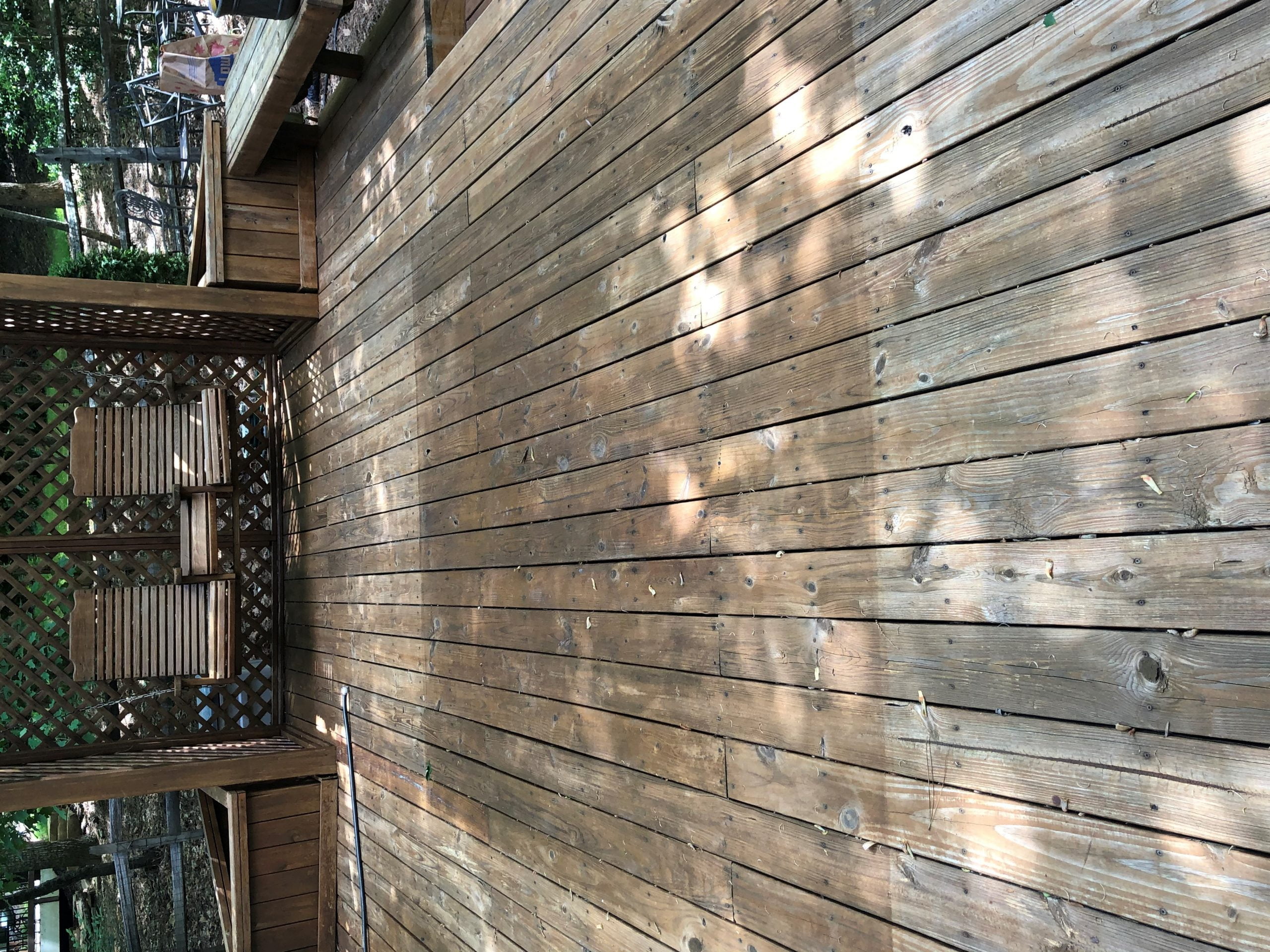

I forgot to attach photos of my deck showcasing th DEFY EXTREME Semi-transparent stain. (Redwood color)
Mark P
Mark P
Good morning. I used DEFY waterbased stain on my Colorado sunsoaked deck and absolutely love it. It’s infinitely better than the Superdeck stain I had on previously. The stain has been on only a year and looks great, but the deck is dirty and has some small stains from the winter. Mostly dirt, melted snow and leaf stains. I am not planning on restaining it or adding a maintenance coat this spring, but I would like to clean it. Should I use DEFY Wood Cleaner, brush and hose or should I just use a simple dish soap solution and then rinse with hose? I guess the question is, if I use the DEFY Wood Cleaner to clean and rinse without brightening and staining, will it ruin my deck? 😀

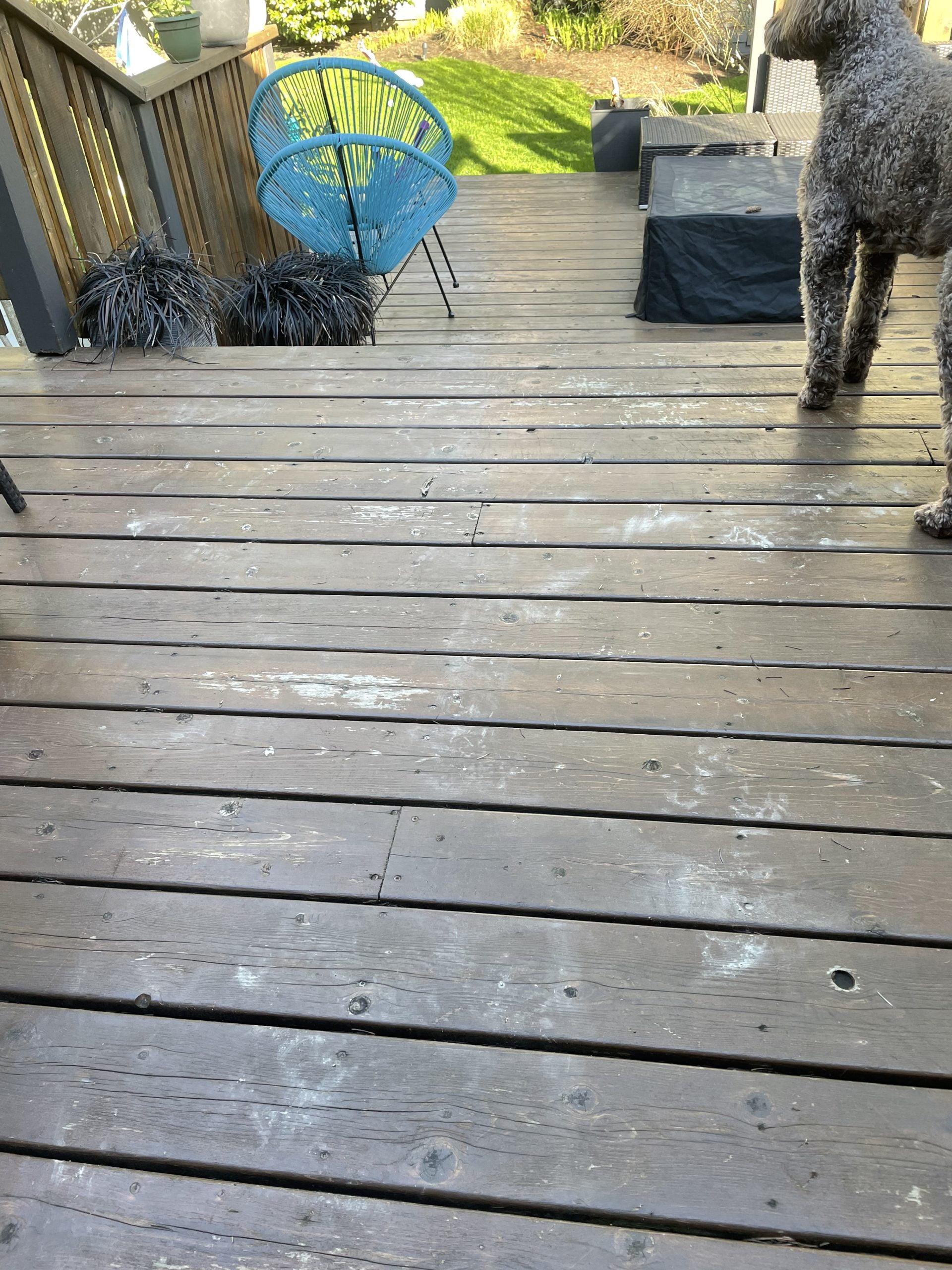

Hi! Have a 3 year old st (behr??)failing semi-transparent stain on our 10 year old PT deck.
Hoping I can just strip it and not have to sand?? Thoughts

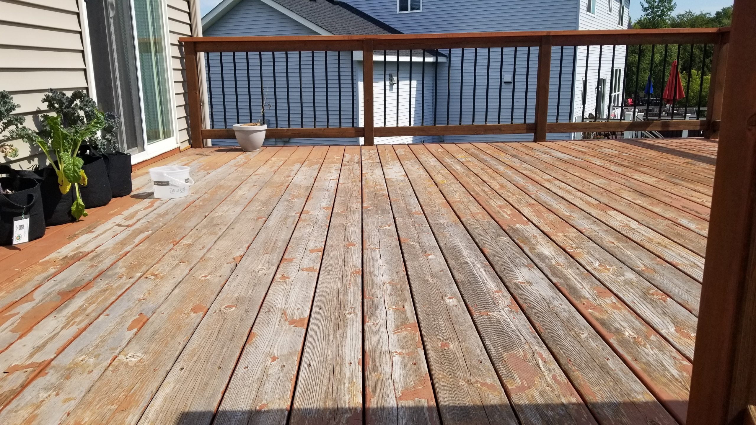

We’re trying to figure if we can clean our deck, retouch certain spots with paint, and then put a sealer on top?
Or strip the whole thing?
We have a certain area where a hot tub was removed, that we DO need to strip and redo. But the rest of the deck (we were told) wasn’t in bad shape and didn’t need to strip, just touch up.
So what should we do with the other parts of the large deck? There are a couple spots, such as on steps and by the door where some paint has chipped off.
It costs us $1700 to hire someone to just strip and repaint the whole thing. Should we do this or can we touch up the other areas (minus the hot tub location) ourselves?

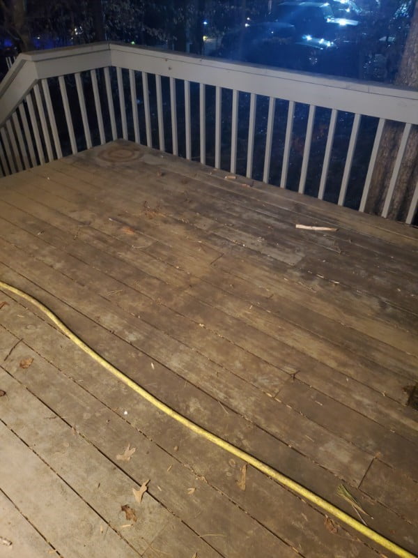

We moved in 3 years ago Oct and had been told the deck “had been refinished”, but after winter (Minnesota) there were places starting to peel like paint and even what looks like worn old stain underneath. Like all our projects this was put off too long. We will be sanding because frustration took over with having NO luck using a stripping product and thus chewed up the wood a bit. But if there is any other product we can use to strip this coating that’d be great. Please give any and all advise you feel pertinent 🙂
1) We Assume the deck is 11 years old (same as the house)
2) yes, current coating UNKNOWN
3) some mold/mildew looking spots after pressure washing also some under deck
4) reason for failure…unknown, possible use, neglect or bad refinishing last time?
We are deadlocked to paint the whole thing or 2 tone finish? Your thoughts?

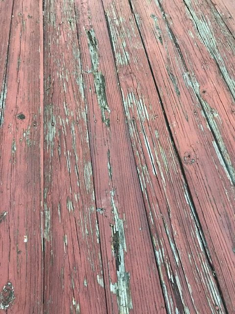

We have been trying to repaint our deck and having the worst time trying to get the paint up. I just found this site, we have tried a power washer and deck stripper to no avail. We can get some up with a wire brush but we would be scrubbing for a weeks to get all the paint up that way.
I think the previous paint job was a solid stain because the undertone red seems to have penetrated pretty deep and won’t come up without sanding. We don’t know for sure though just bought the house a year ago.
We bought a brown solid stain to go on top. Do we need to make sure all the red undertone is sanded off before we use the new solid stain? Any recommendations on getting the rest of this paint up? Should we use a different deck stripper?

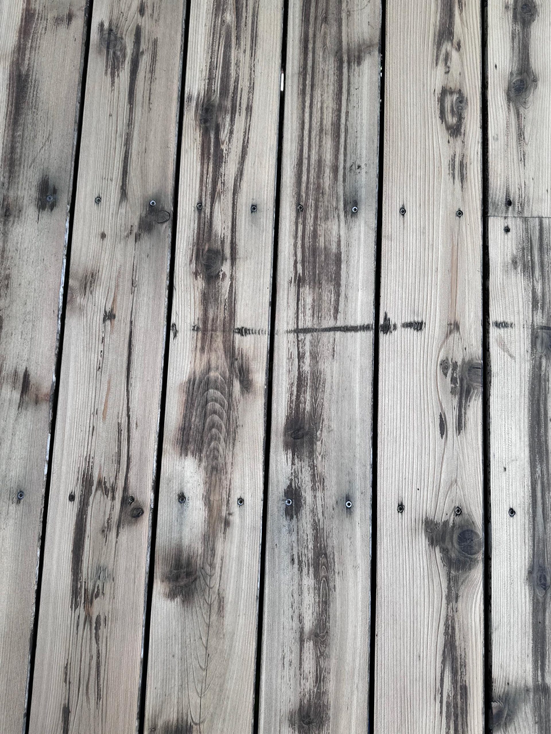

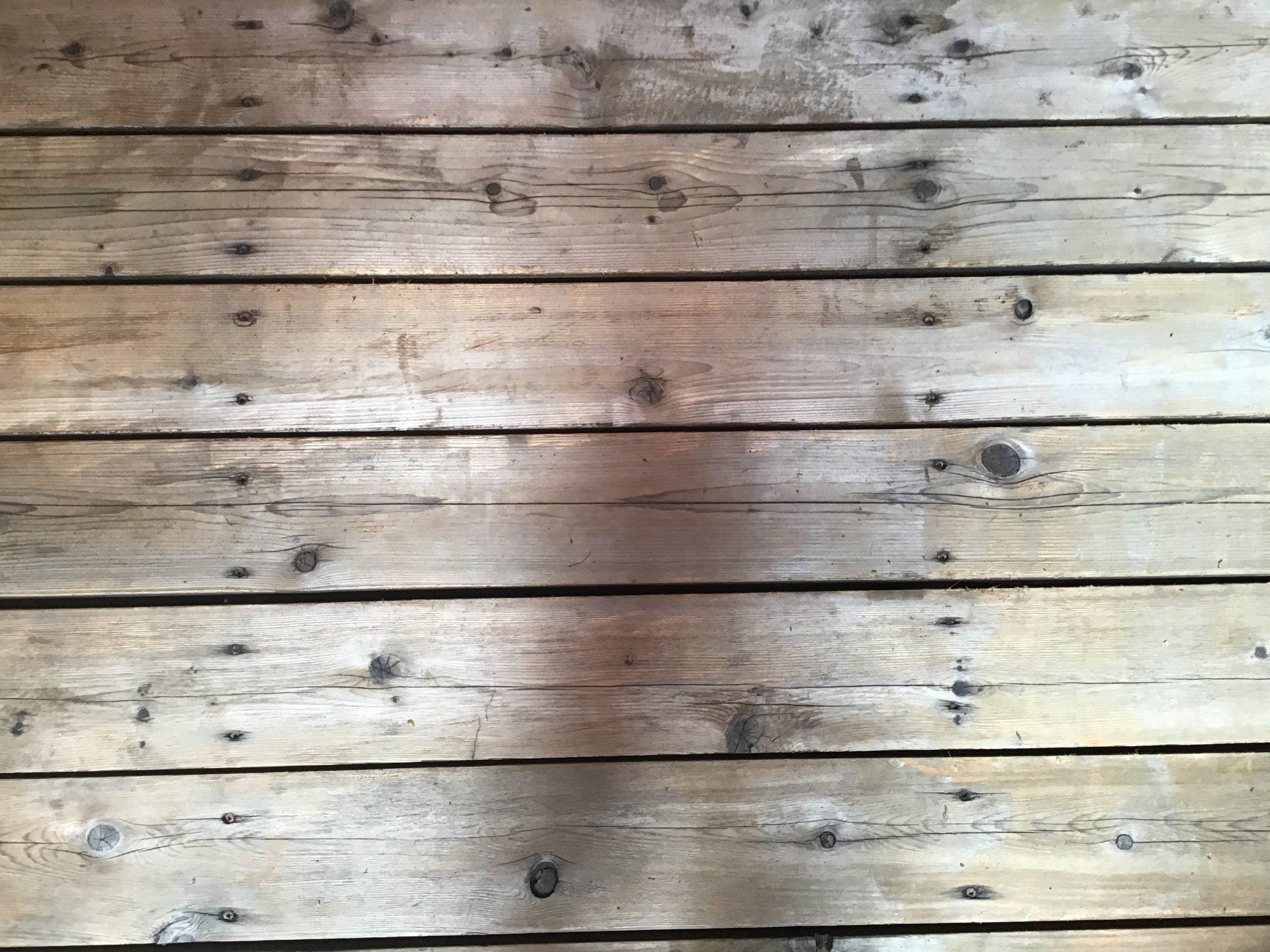

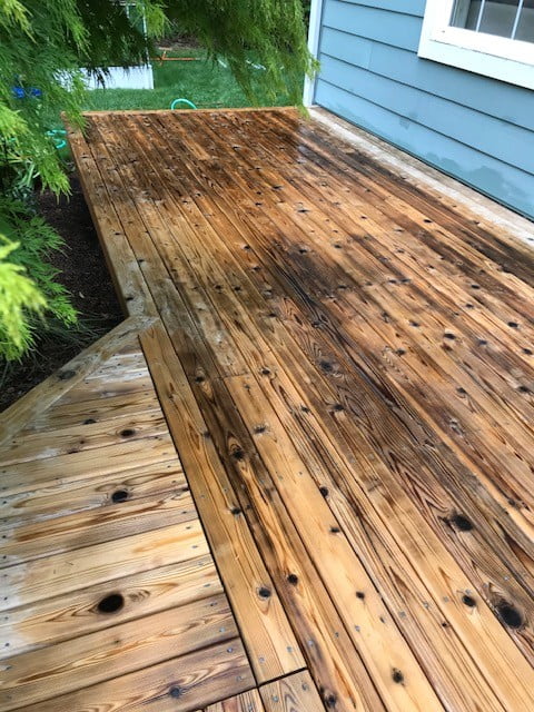

Hi guys,
Lee here again. Gosh, I can build a decent deck but I can’t seem to finish it correctly and I need your advice again. So this last winter when I bought more TWP 101 Cedar from your associates, I also ordered RAD Cleaner and Brightener. However, based on our conversation below, it became apparent that I needed to strip the old stain as some of it had failed within one year. Not having time for another mail order before last weekend, I went to the big box store and got the Behr Stripper No. 64 and Cleaner/Brightener No. 63. (I know, me bad! I have since read your reviews.)
I used two different set of steps as my test areas. After letting the stripper sit for 45 minutes, I scrubbed, power washed then proceeded with the Behr Cleaner/Brightener solution for 15 minutes then power washed again. Both solutions were well shaken and both sets of steps turned out great.
So I moved on to the deck following the exact same procedures, working about 40-50 SF at a time, on a cloudy day and keeping moist. OMG, the results are awful with black areas everywhere. I noticed some, but not all, of the overlap areas seemed to be brighter so I hit it all with a second coat of Behr Stripper followed by another pressure wash rinse and then another round of Behr Cleaner/ Brightener followed by a yet another pressure wash rinse.

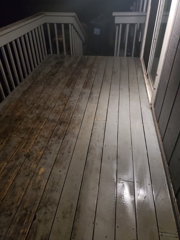

As you can see in the pictures, I still have black area everywhere, and even though they are less noticeable when dry, I know that if TWP 101 stain goes on, they will stand out as if they are wet. (It just rain and I just took the wet pictures – Ugly!)
I do plan on sanding with 80 grit to remove the white fuzzy, and I still have the RAD Cleaner and RAD Brightener but I need some advice as to how the black areas can be neutralized and then what steps to wrap up the prep prior to the stain. (This time I will wait at least 1 week, not 3 days for it to dry before staining.)
Thanks in advance, I’m desperate here.

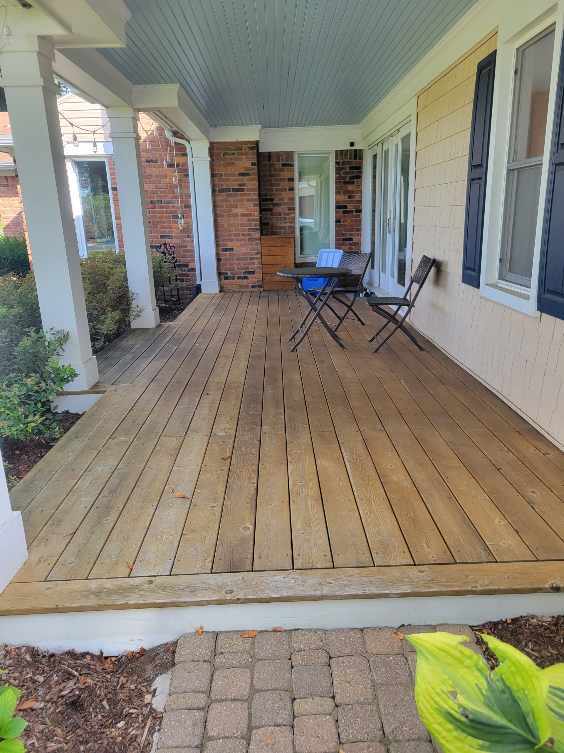

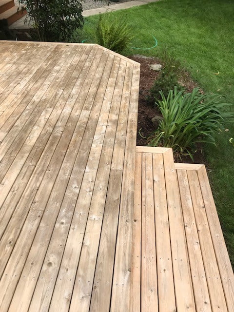

Hi Deck Stain Help,
Two years ago I built a new cedar deck. Per your instructions I waited a 9 months before cleaning, brightening and staining. We used TWP 101 – cedar tone. The main deck area must have been still a little damp as the stain failed badly over the last year with a chipped appearance.
Q1: I’m assuming I need to strip this main deck area? (First three photos)
The porch area (connected) seems to have held up OK. I must not have been damp. It is dirty though, as can be expected after one year.
Q2: If I need to strip the main deck area, should I strip this porch area too or just clean it? (Last photo)
Will brighten and dry all areas before staining again with TDP 101. In hindsight, I wish I used the Restore-A-Deck as the moisture would not have been a problem. Augh!

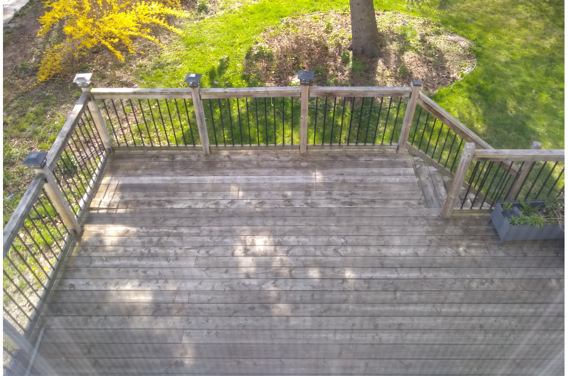

Lee

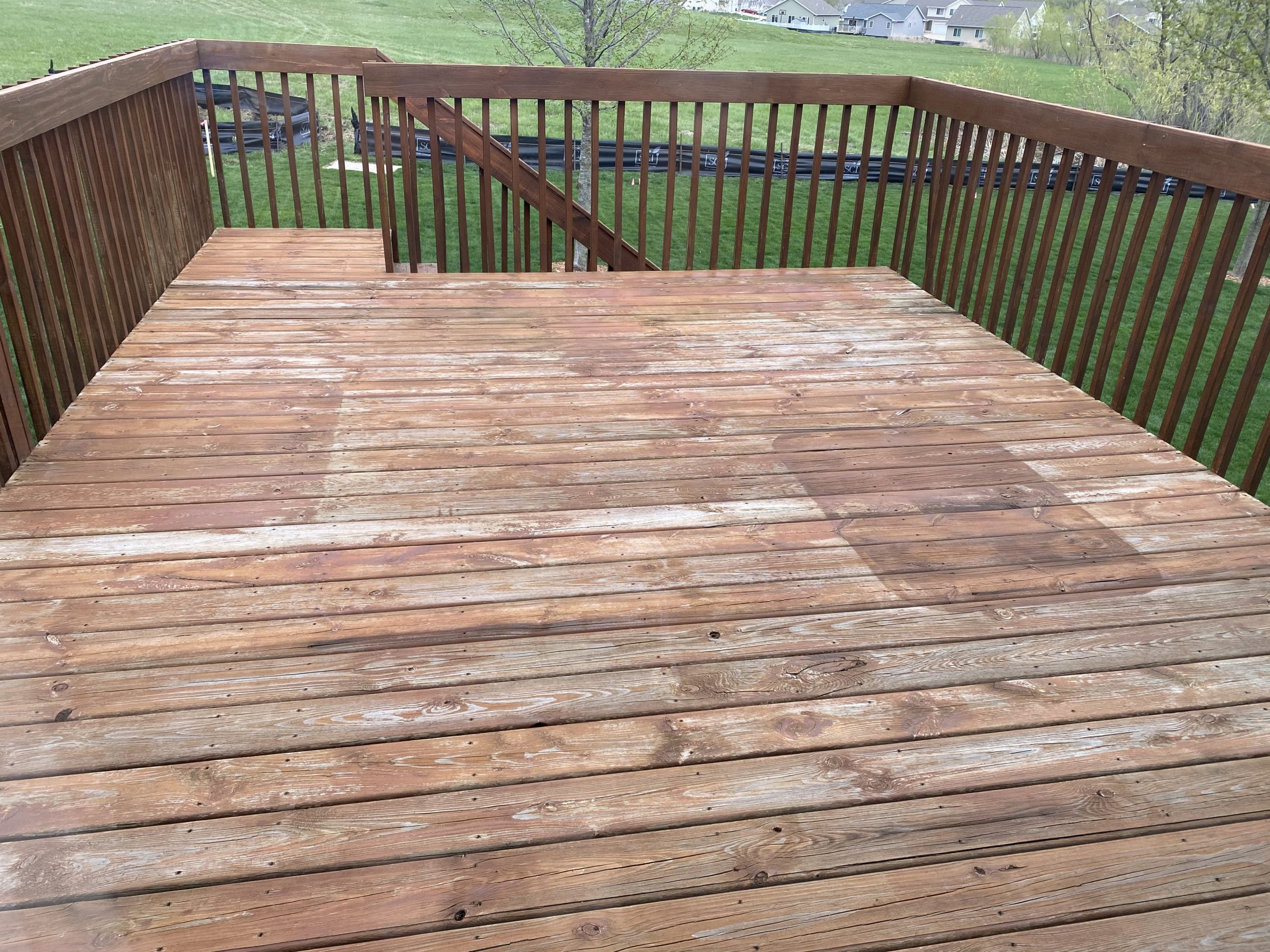

I have a behr semi- transparent tint stain on my deck and I want to apply a new semi-transparent stain it’s been 2 years since I applied a coat what’s the best way to prepare the deck
Carlos Torres
Carlos Torres
Here is deck picture
Carlos Torres
Carlos Torres
Thank you for your help

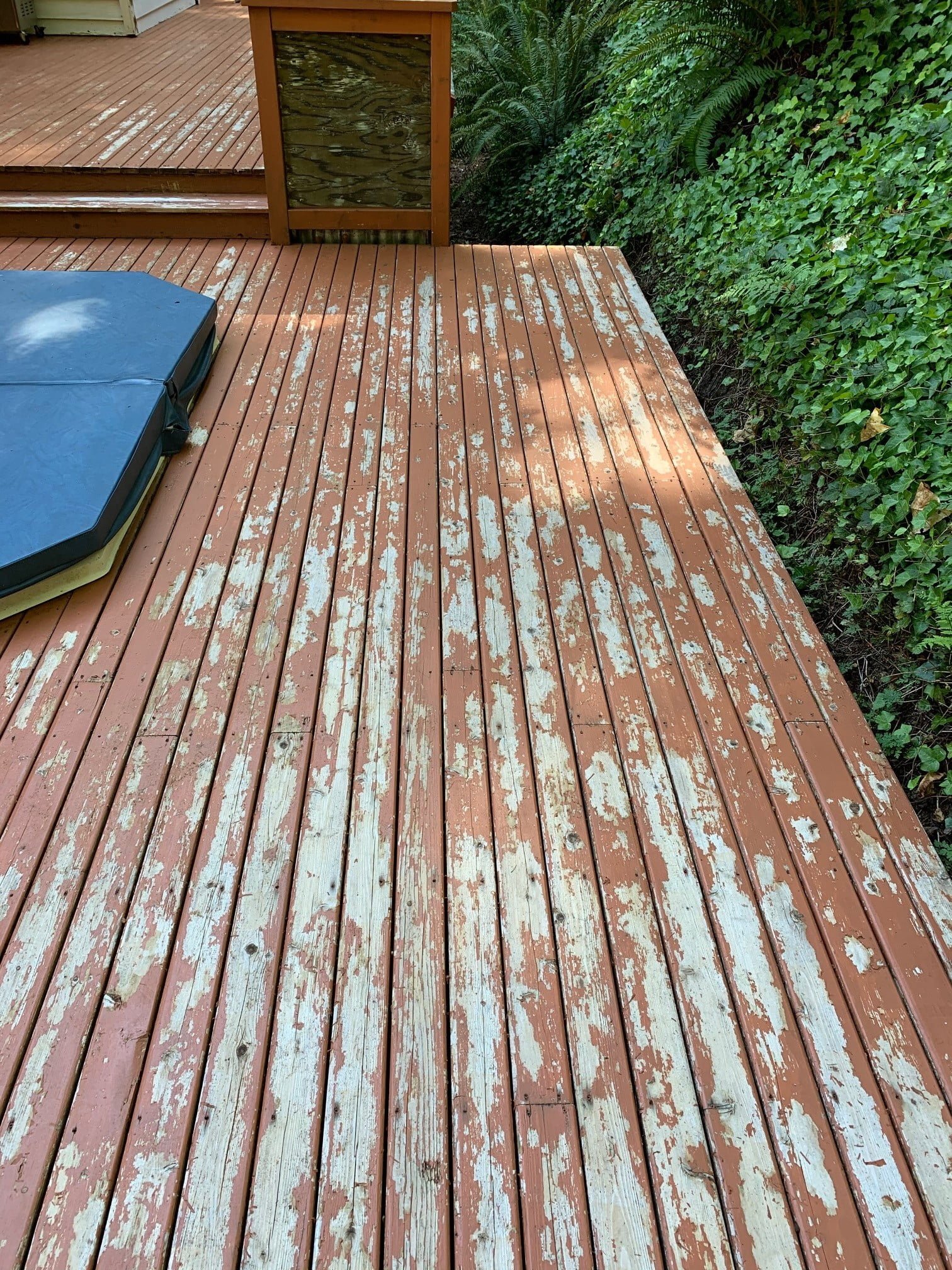

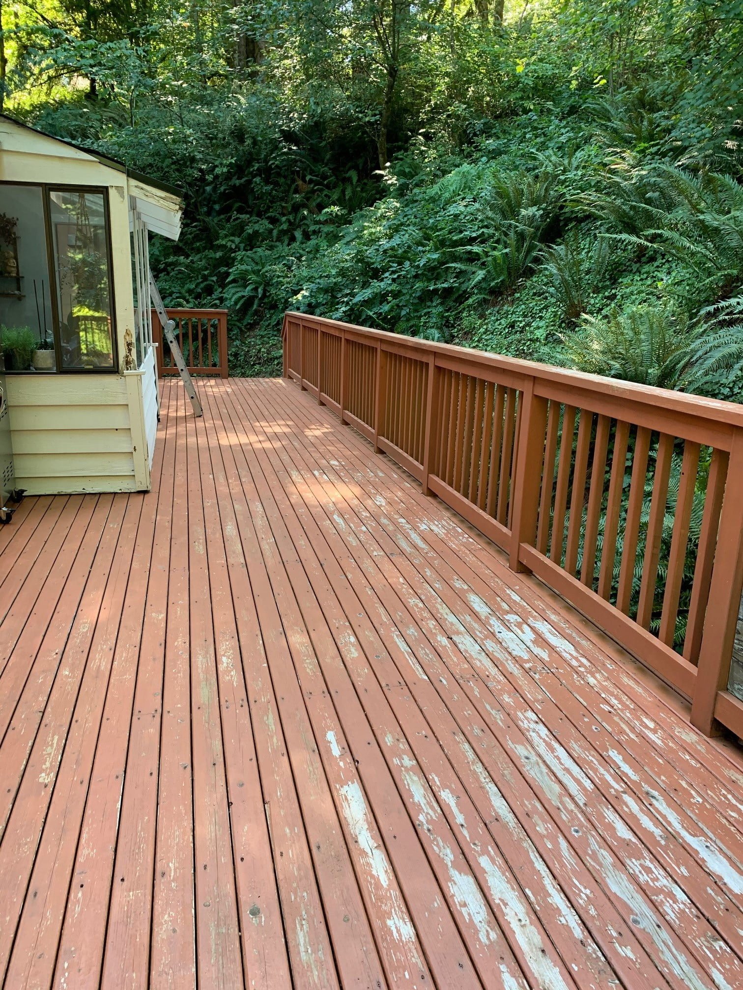

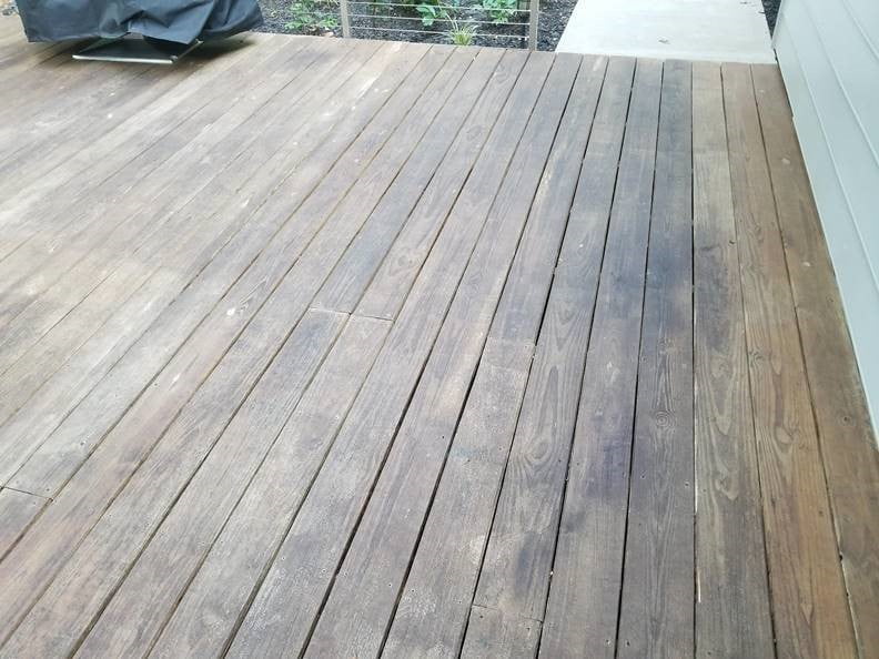

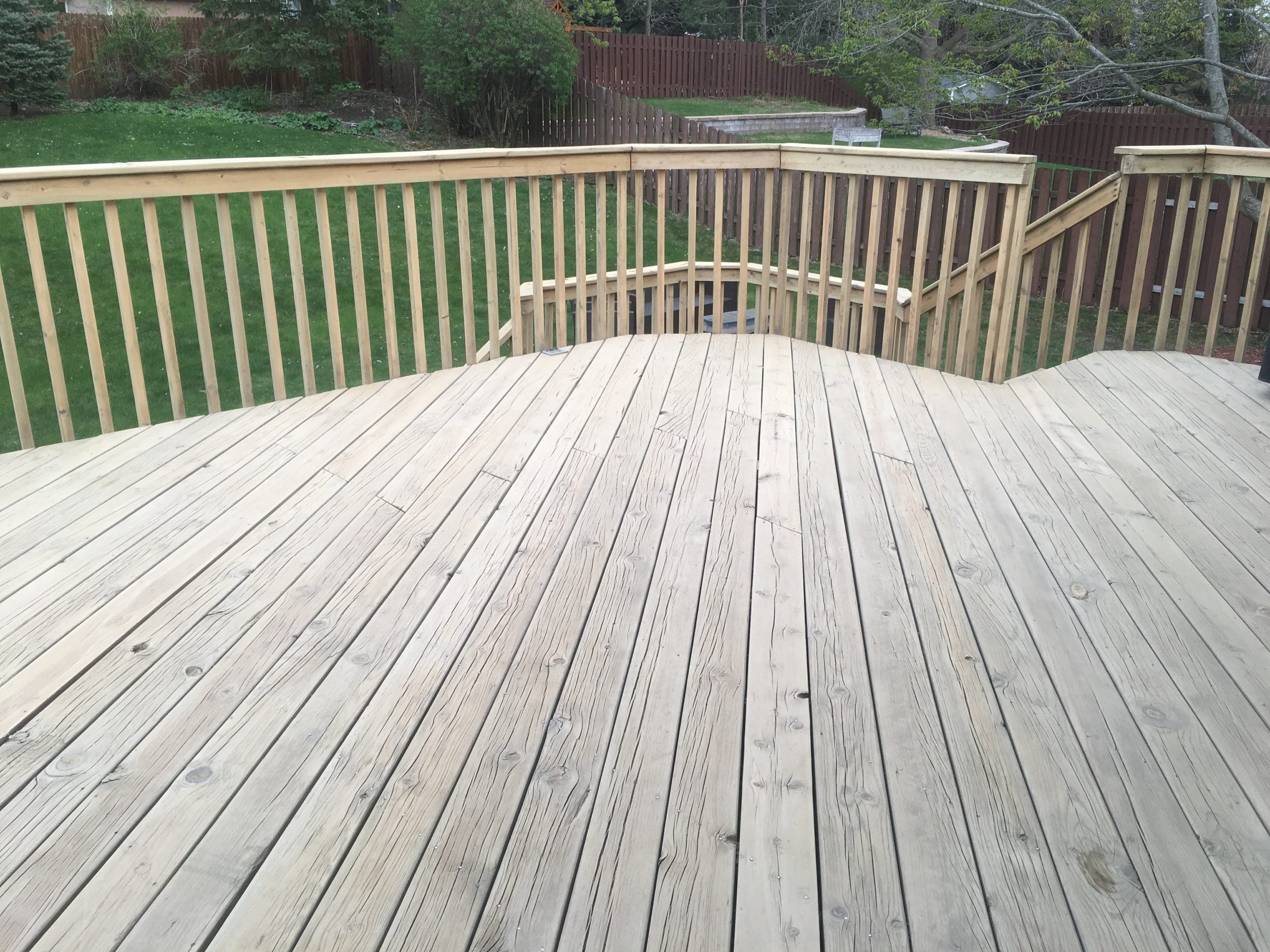

Hi please can you advise me what I need to do with this decking?

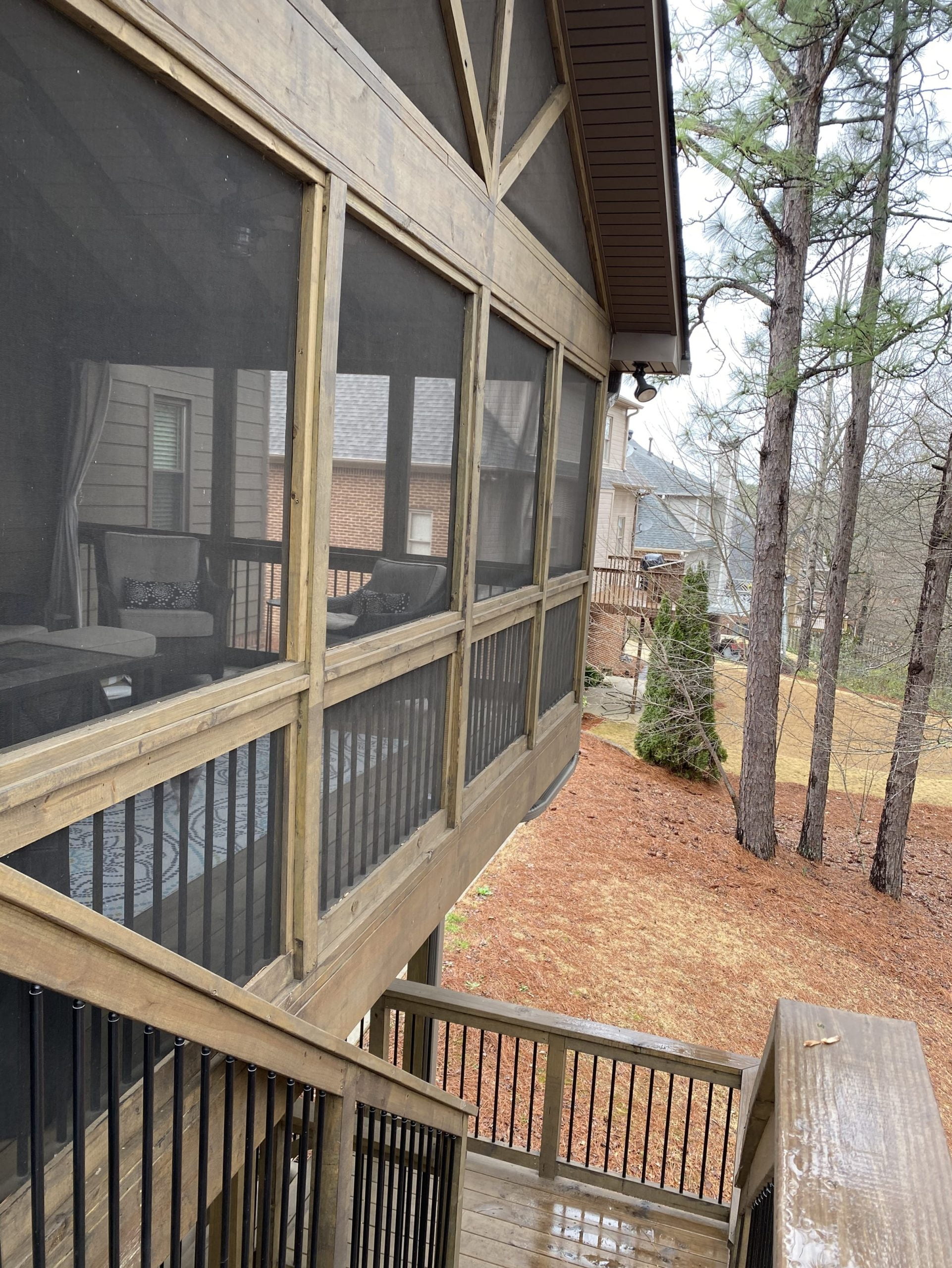

We have a large screened in porch and deck that was built with pressure treated pine 2 years ago. After waiting several months it was pressured washed and stained with 1 coat of SW semi-transparent stain in a dark “charwood” color. Though not a great product we will probably stick with it for a second coat bc of the sheer size and investment we have already put in to it. The screened in portion is fine but open deck is absorbing moisture and showing signs of green and black discoloration as it is under trees and shaded a lot. Since it is new and only been stained once we know it is time for another coat. Because the color we chose is dark and because the interior is holding up fine we would like to leave it as is and only redo the stain on the exterior. For color consistency on the outside this means doing the open deck, stairs, and all exterior framing of the screened in porch. I’m getting conflicting info from painting companies regarding cleaning vs. stripping. To keep the color from darkening too much with a second coat on the outside I like the idea of stripping but I’m worried trying to apply the stripping agent on the exterior framework on the screened in porch will inevitably harm the interior framework of the screened in. The company tells me they will cover the interior with plastic but covering the framework around the screens so nothing is sprayed through seems nearly impossible to me. This company tells me the stripper is necessary with semi-transparent bc there is still a “sheen” on some of the framework (but the open decking, stairs, and rails, have definitely lost their “sheen).” Other company’s tell me stripping is not necessary.
Stacey
Stacey
Pictures
Stacey
Stacey
Will stripping on the outside of the screened in porch risk damaging the stain on the inside of it?
Stacey
Stacey
That’s what I’m worried about. I should clarify, however, this company plans to use the SW Stain Sealer Remover which also gets terrible reviews so I’m not sure how powerful that is and therefore how risky it would be. The floors and railings all seem to be worn evenly and have lost the “sheen.” The frame of the screened in would be the only areas that may still have some protective coat bc they are vertical and some are shaded, but I guess I’m failing to understand any major risk of just cleaning and putting a second coat on those even if they do still have some of the protective coat (other than darkening the color).

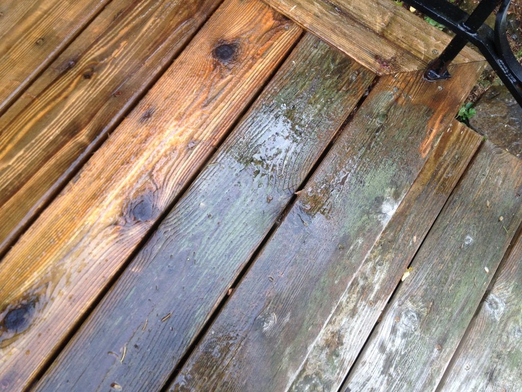

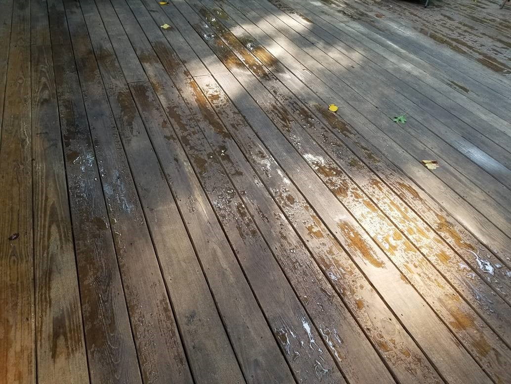

Please help! I bought a heavy duty stripper and still have spots that will not come off (the wood is very uneven so sanding doesn’t do much either).

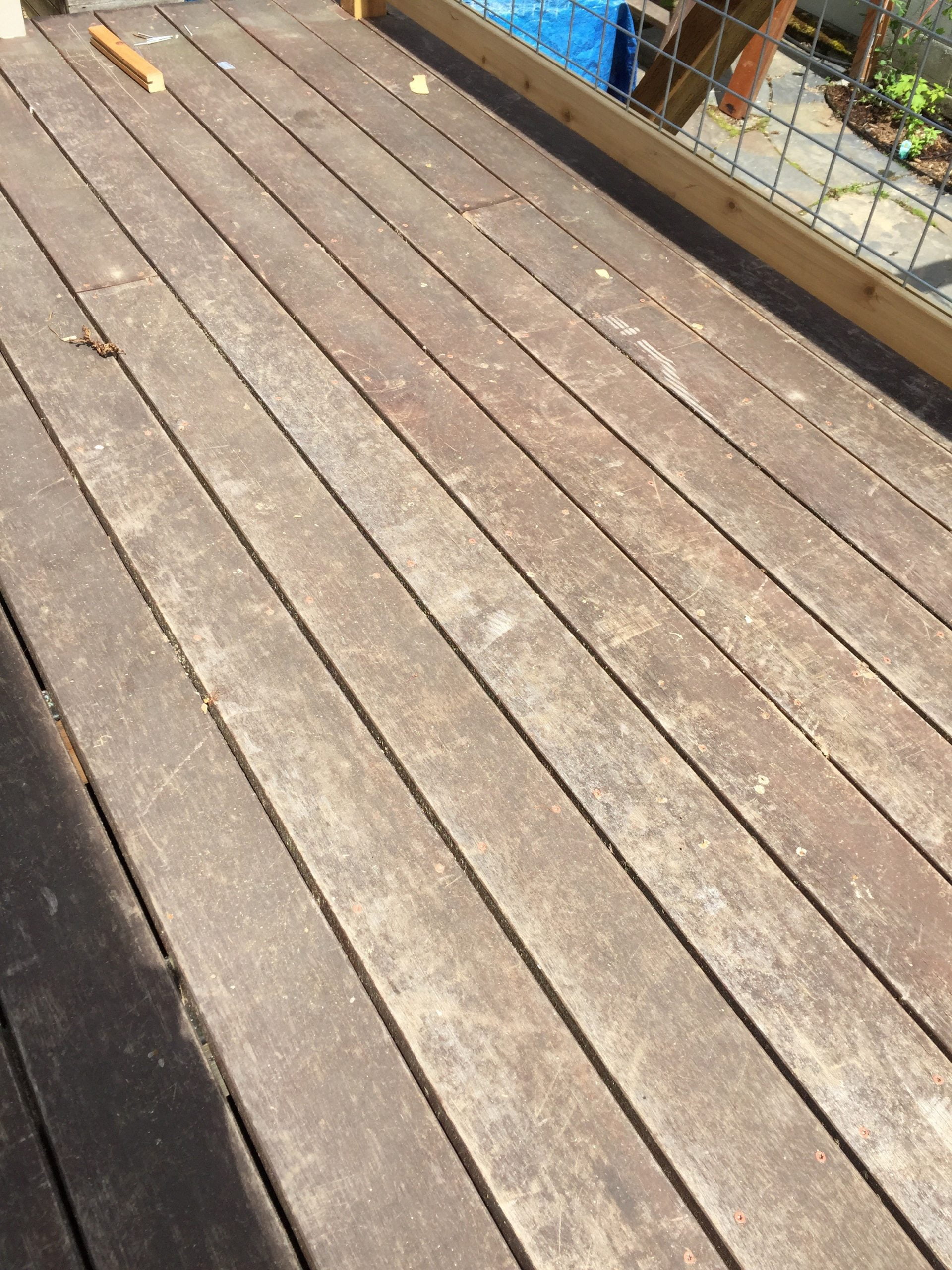

I’m not sure what product was used on my deck, it looked great when we bought the house 2 years ago and during the first winter it started pealing and flaking of in the areas that are most exposed to the elements and it’s gotten a lot worse as you can see. The deck is very big and wraps around the house with a railing that is finished using the same product. I was hoping I could sand the areas that it are pealing and then cover with a solid stain or paint without having to remove all of the previous product. On the railing and closer to the house the current product is holding up fine. From what I’ve read on your site I may need to strip the entire deck and railing to do it right. What would recommend?

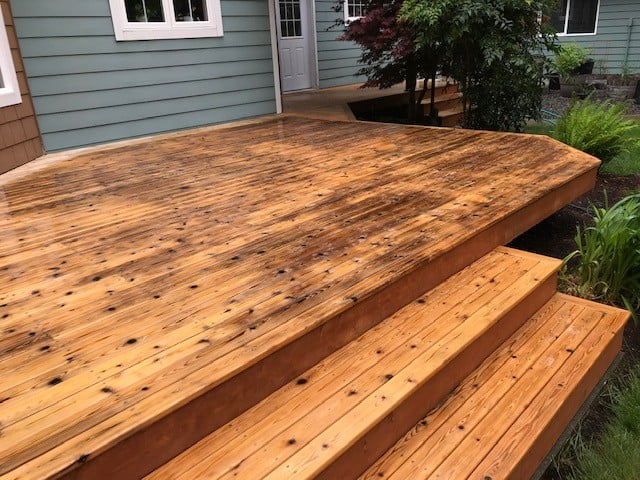

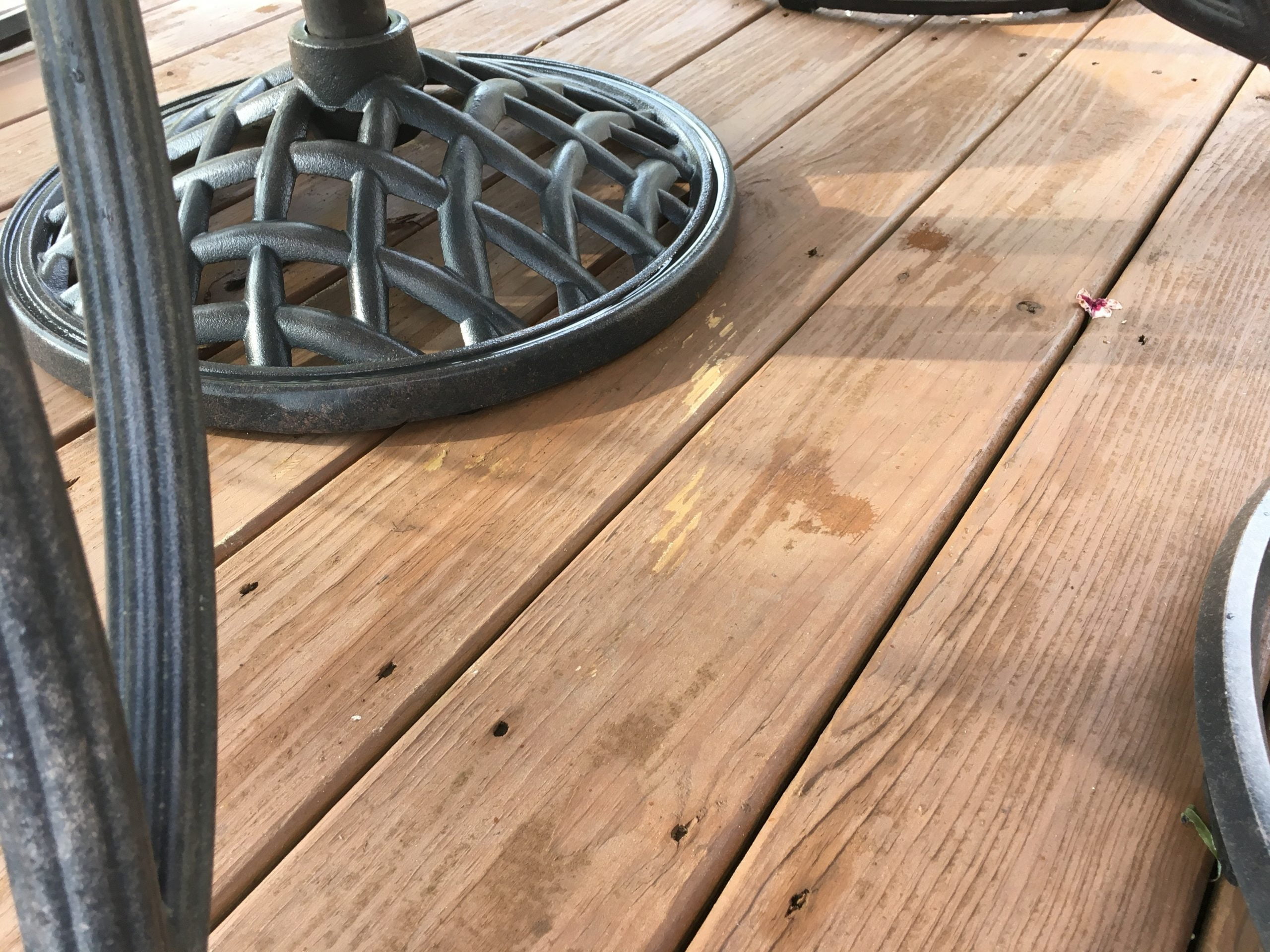

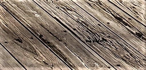

Hi, I applied Thompson’s clear coat on my patio yesterday and it darkened it considerably, which I absolutely hate. (I should have patch tested). What can I use to get it off and restore the wood to its original color? Thanks.
Caroline
Caroline
Reply to  Caroline
The first pic is what it looks like after the Thompson’s. The 2nd pic black portion is what it was when I moved in and the light area is after cleaning. I wanted the eood to remain that light.

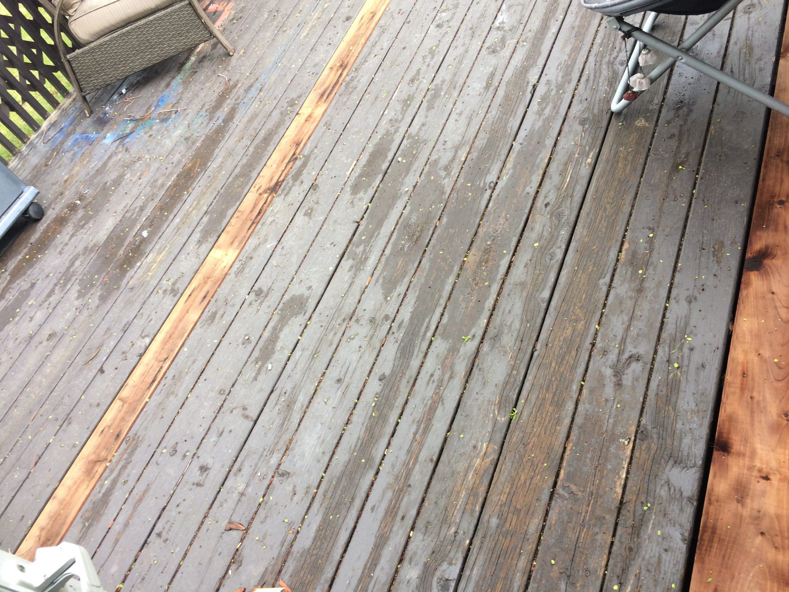

Deck location: Oregon. Southern facing deck – tall trees start blocking sun around 2pm. Cedar deck, been around a long time.
Progress to date: Pressure washer, Simple Green Deck Cleaner and bristle brush, wood filler (where needed) and 100 sand paper applied. No stain yet.
Stain to be used: PPG “Sikkens” Black Oak (just a dark color)
Issue: struggling with getting ALL the old stain off – especially in boards underneath railings. Really inconsistent stain removal, even though applied evenly throughout process. Wanted to get some input here before putting on stain. Any thoughts of whether it’s ready for stain or needs a stronger method of stain removal?
Photos posted in reply to this.
Pete
Pete
Reply to  Pete
Photos here

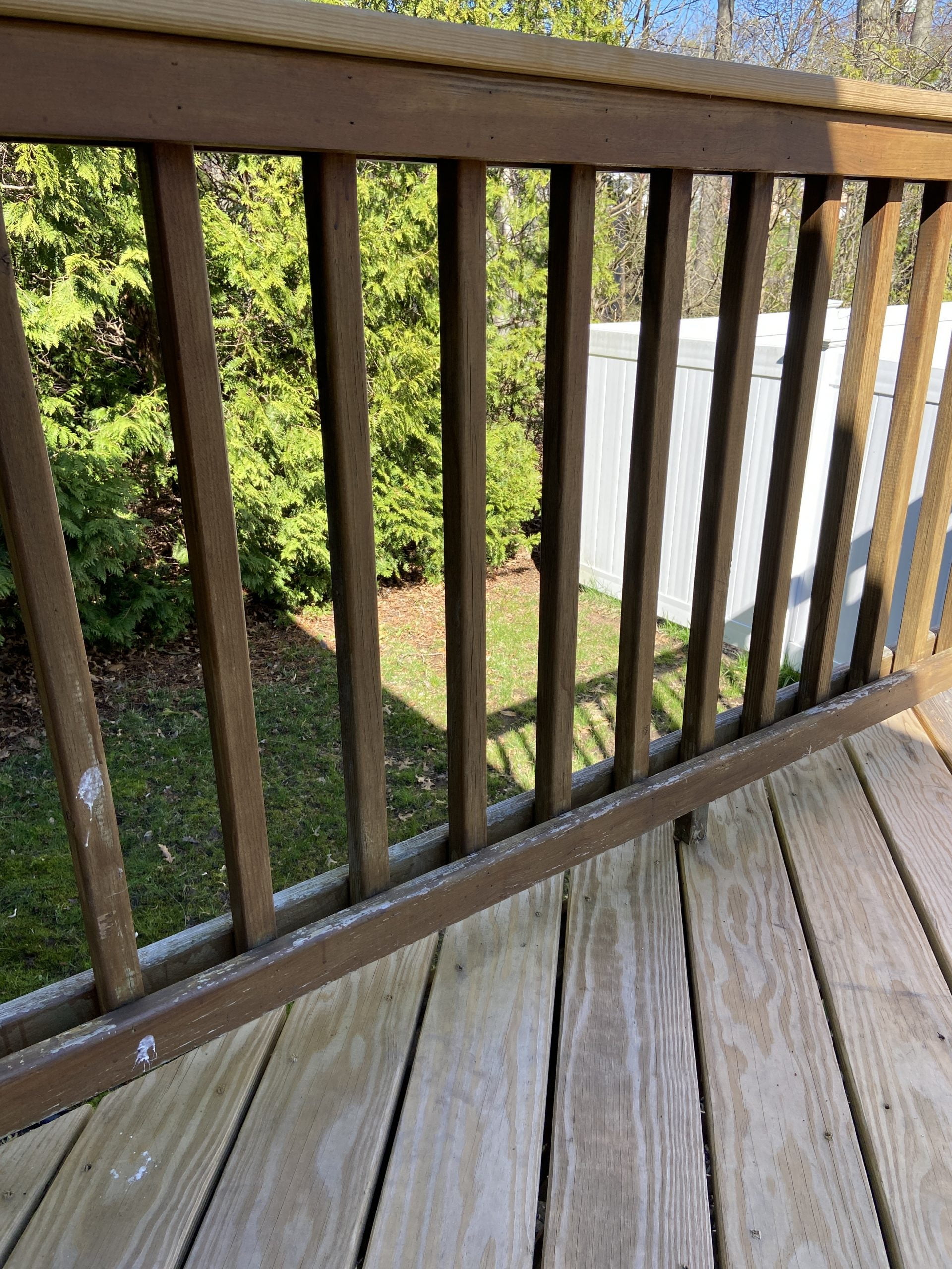

New house, old deck. We renovated shape and added new railing. From the little bit of color left, I imagine it’s been stained before. I prefer the beautiful natural look of Cedar but don’t want to reseal every year so will probably use semi-transparent stain. Any thoughts on best prep approach and then stain to tie it all together? Thank you!

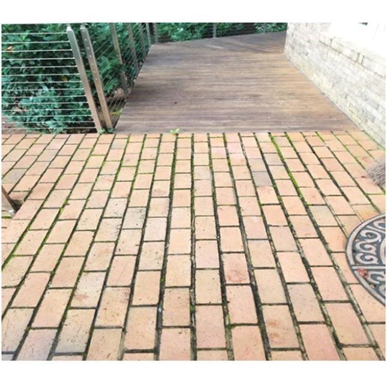

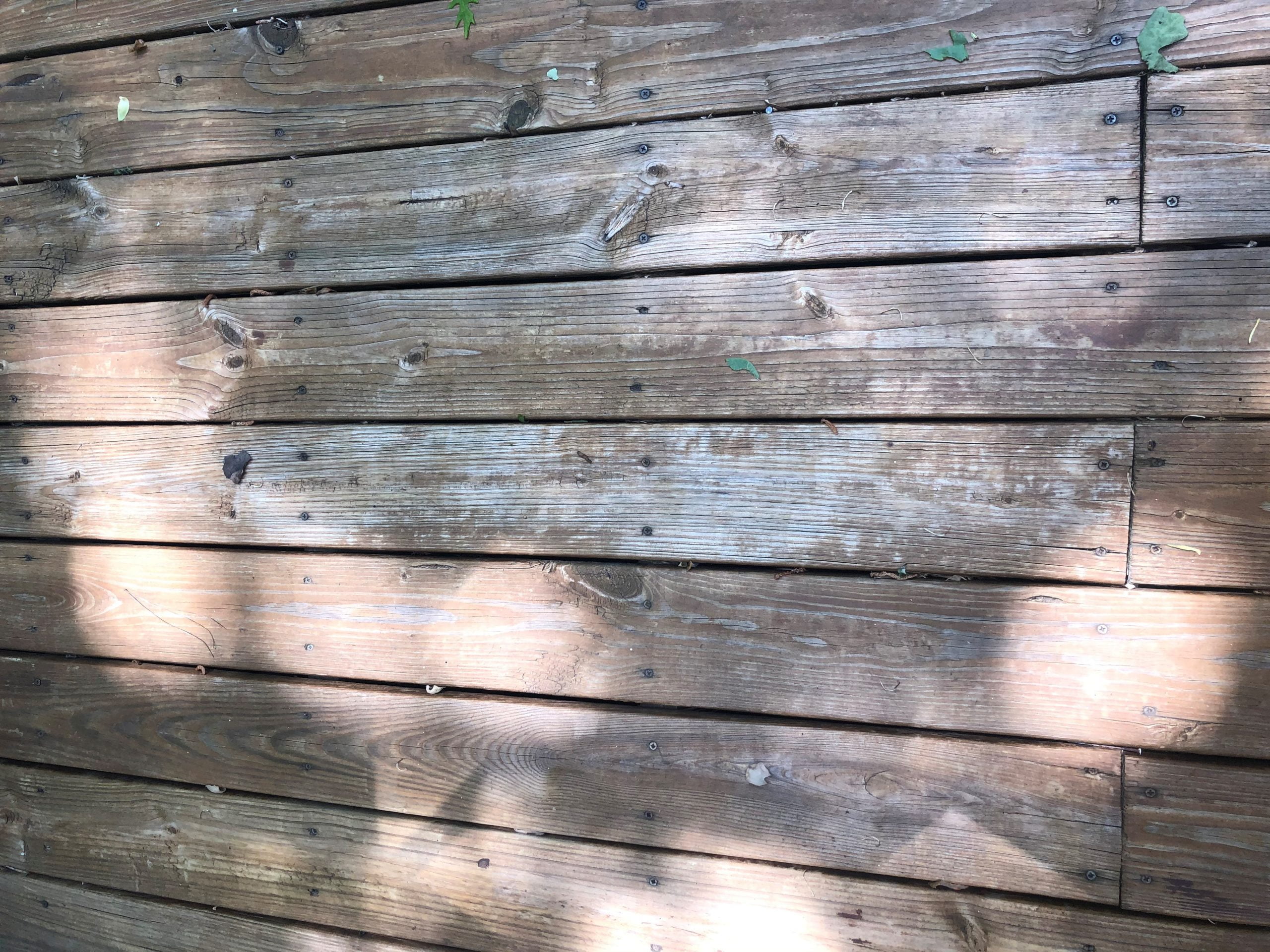

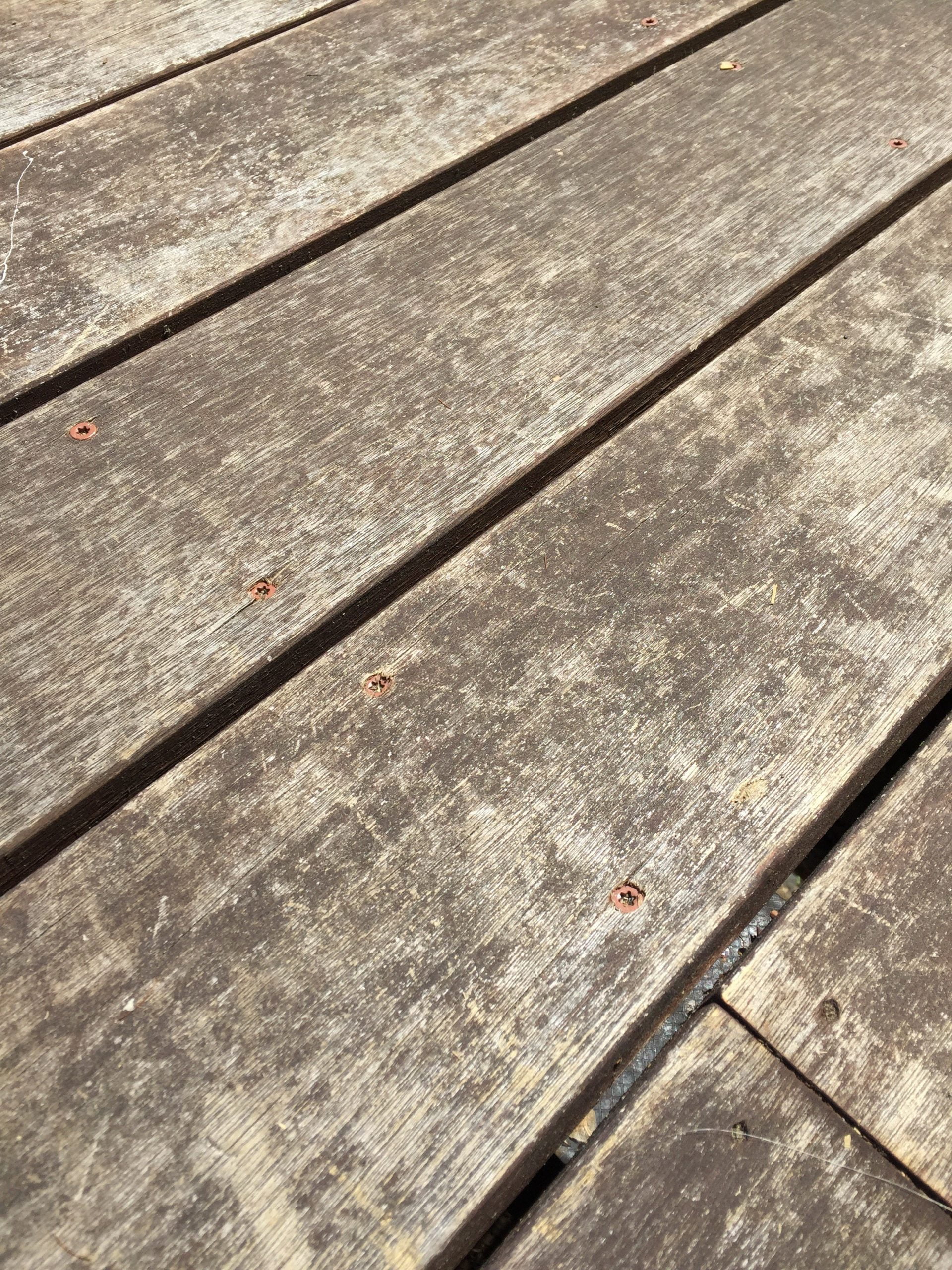

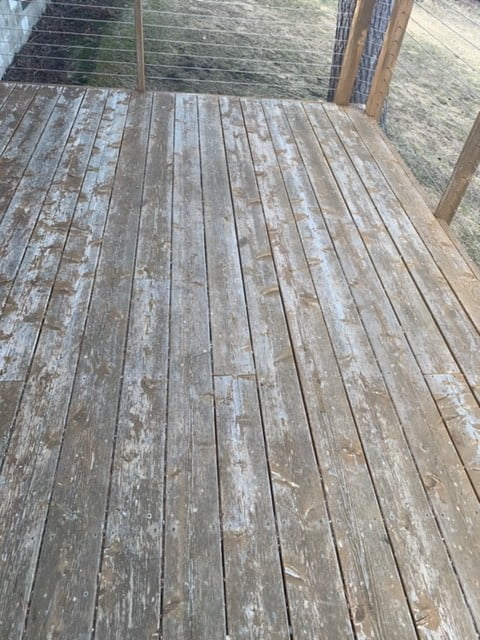

Hi, what about this deck? Stripper or cleaner? I went to the shop and they gave me both, but I am wondering if just one of them would be enough. Thank you!
Our screen room floor was made with brown pressure treated lumber about 10 years ago. The high traffic areas are faded. It has not been previously stained. What would be the best way to prepare the surface for stain so that we get even color?
Pretty sure there is no stain, just the pressure treating. Will strip and brighten work for that?

2 years ago we had a new deck professionally installed. We waited 1 full year before we had it “professionally” stained to make sure the wood was totally dry. Unfortunately we hired the wrong company to stain our deck. The company totally botched the job. They applied a semi transparent Behr stain with a sprayer on the same day that they power washed it. The stain has obviously failed and our new deck is a mess. We have now waited another full year and now want to correct the problem. We are now being advised that we will need to use a solid stain over top of the initial semi transparent stain because bare spots on the deck where the original stain did not adhere would show through. We are not wanting to use a paint or solid stain as we want the wood grain to show. What alternatives do we have? Stripping has not been advised – why? Sanding? See pictures.

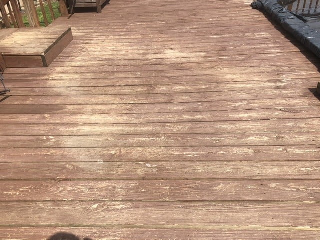

My decks are treated wood and had a cheap solid stain put on many years ago. I am not sure what product to use to try to get more life out of them but am hoping you can give me suggestions. What’s my cheapest/best option. I don’t care what they look like just that they don’t deteriorate

This small deck can’t be more than 5 years old. I have no idea if it was ever stained but I’d like to protect it. I can see that there is mildew/mold. If I don’t know if it was stained previously, is it best to strip it?
R.D.
R.D.
Reply to  R.D.
Here’s another

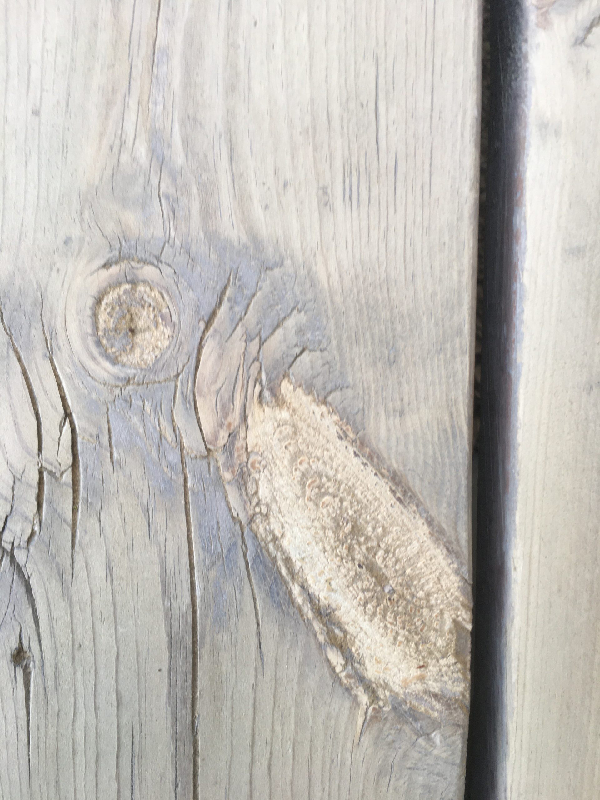

I stripped a solid stain off my cedar deck and then sanded the entire deck. There are still grey spots near the knots. Cant tell if its stubborn stain and i need to strip again or if its something else and a cleaner and brightener will finish the job?
Jared D
Jared D
Reply to  Jared D
Additional photo.

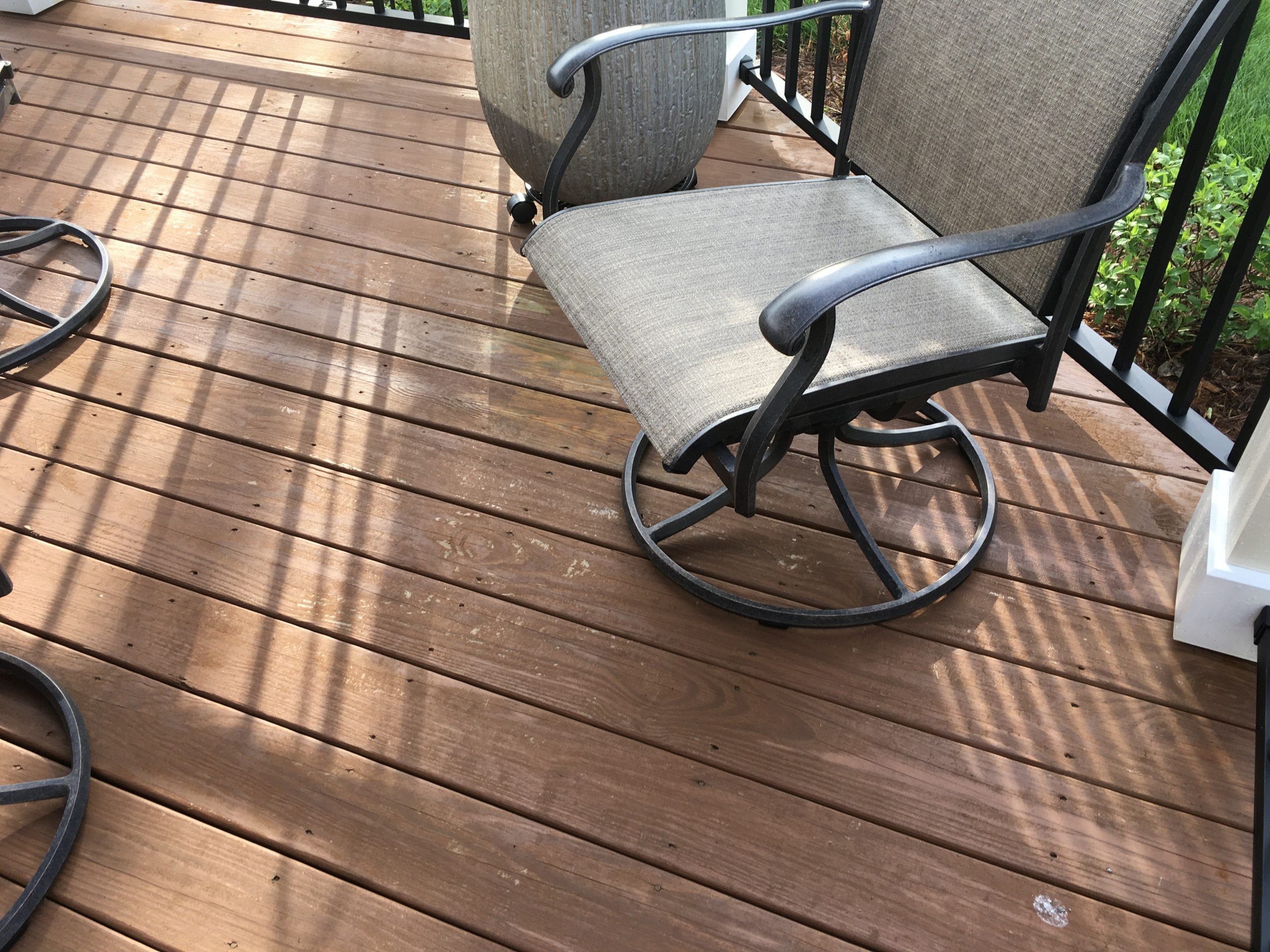

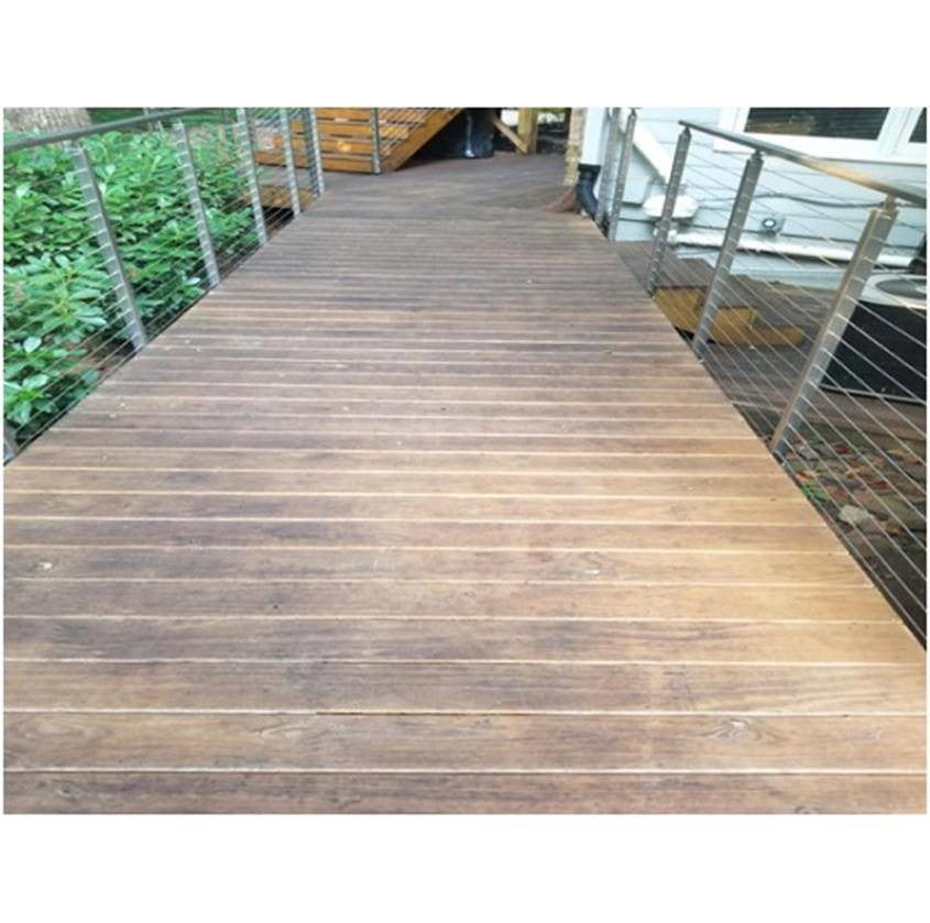

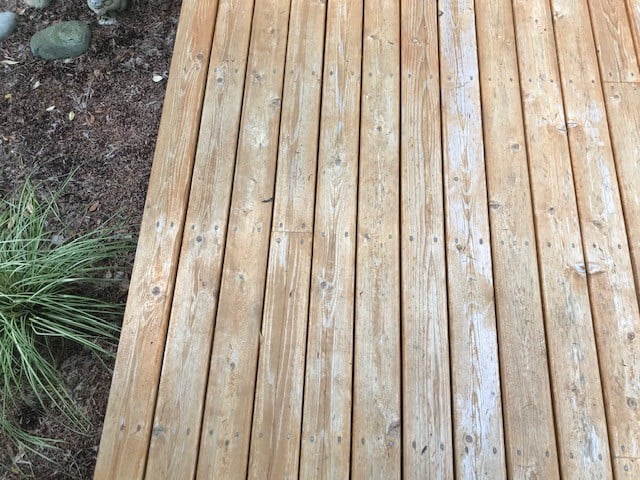

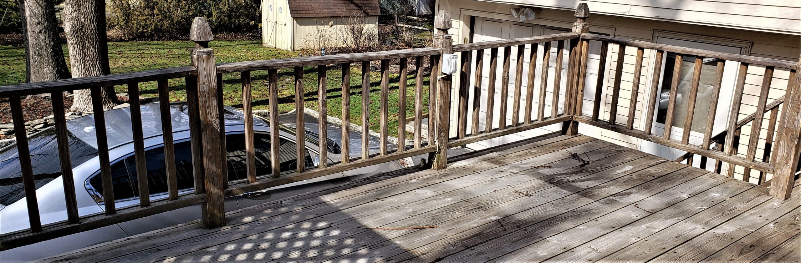

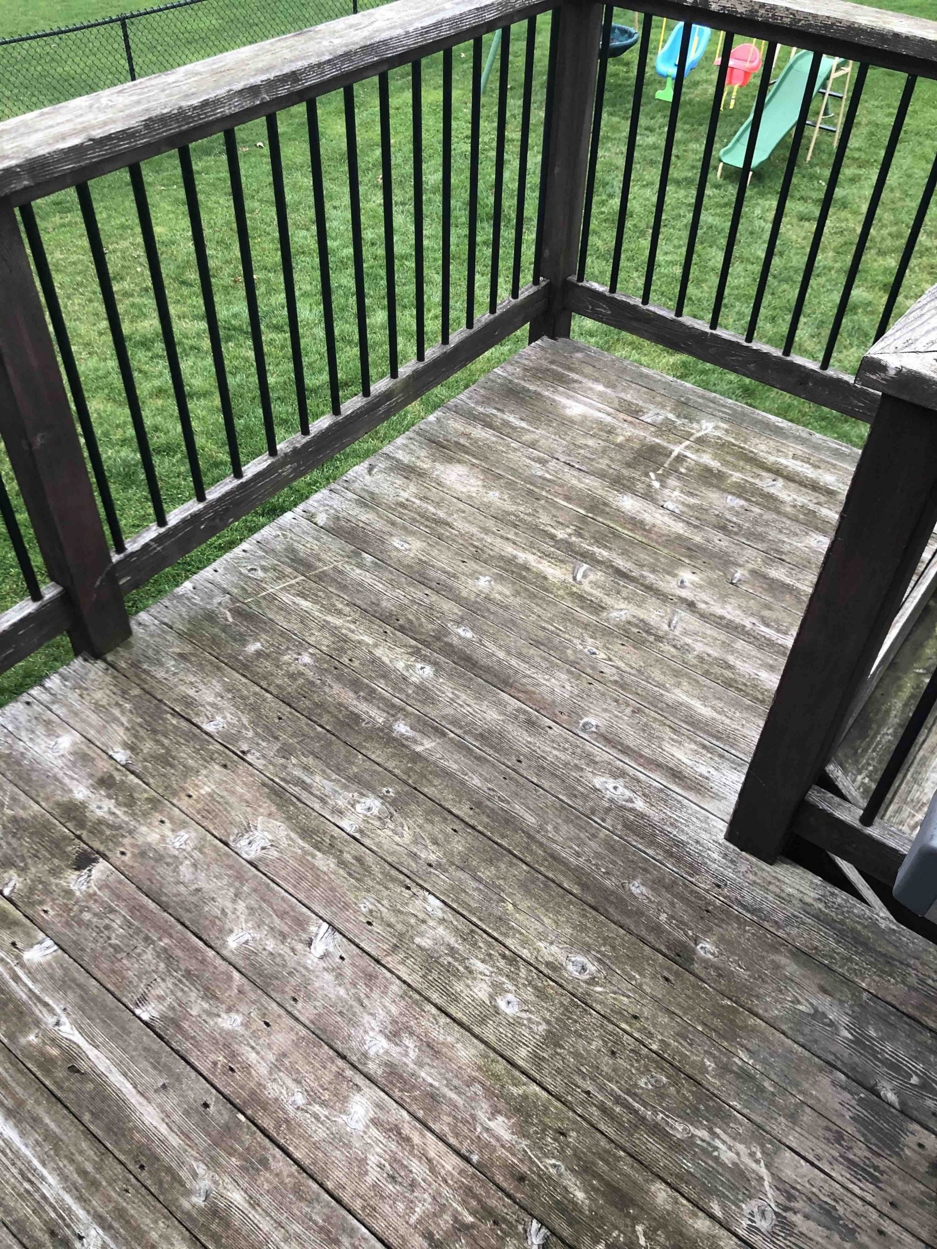

Would you recommend stripping or cleaning this deck prior to staining? Thanks!
Jennifer
Jennifer

will the cleaner brightener damage aluminum balusters like the ones pictured?

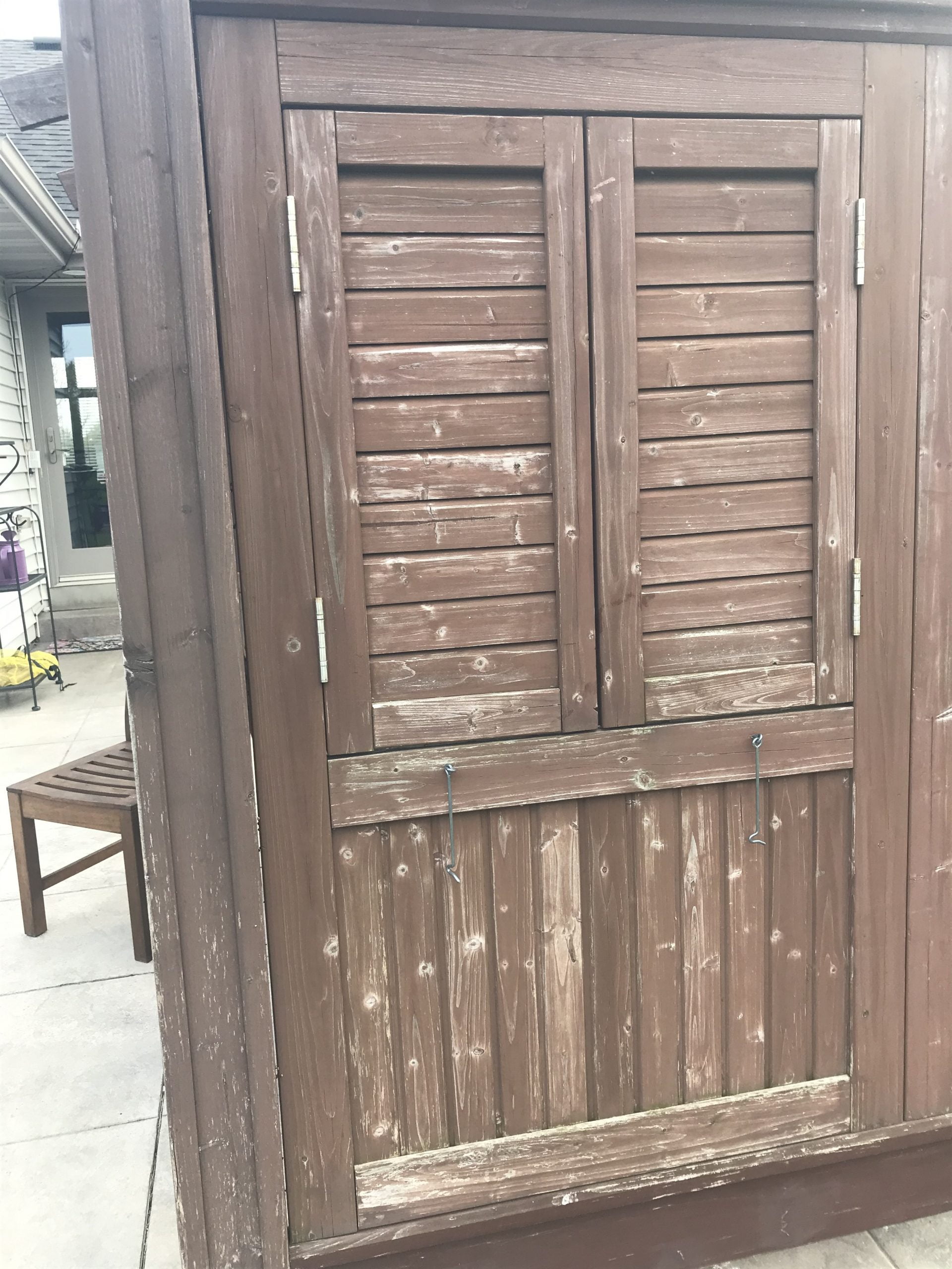

We just moved into a new house and the pergola stain is staring to wear in some areas. Can we use the Behr all in one wood cleaner and then restrain with a similar semitransparent stain? Would it be better to track down the prior existing stain and go over it again? Or do we need to strip the whole thing first? Some areas are worn more than others
Diana
Diana

We replaced most of the board on our deck but did not replace the balusters. We also replaced the top rails. I’m not sure where to start! I’m not sure if it’s stain or paint on the balusters.

brett
brett

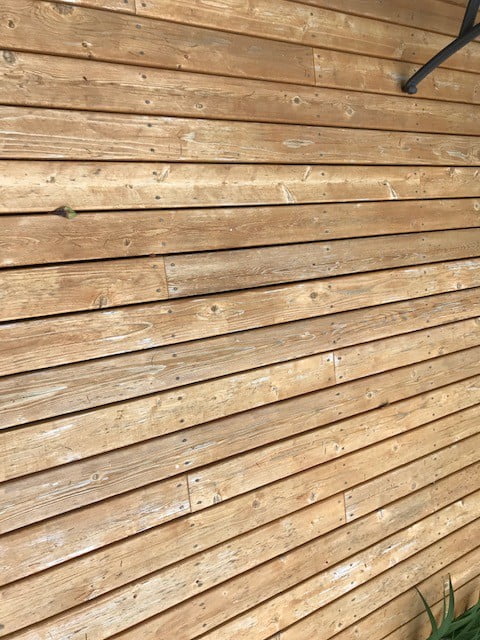

I have a redwood fence that was installed in 2016. It was stained with the cabot clear wood protector at the time of installation. I thought I needed to sand the whole thing down before moving forward with the rest of the prep work, but I am realizing it will take me a month to sand the whole thing when I think all I need to do is a stripper or cleaner and a brightner with a light sanding where needed only. The picture below (without the bbq) shows one side where I have sanded and the other is what it looks like now. The picture with the bbq shows what it currently looks like. I live by the beach so it gets a good amount of sun and salt exposure. What do you recommend? Cleaner and then brightner, stripper and then brightner, or something else? Thanks in advance for your help.
brett
brett
Thank you. If i use the stripper on wood that is connected to a metal gate will it strip the paint off the metal as well? I don’t want to remove the paint so want to know if I should cover the metal first. Appreciate the help and quick replies!

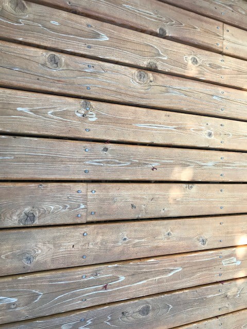

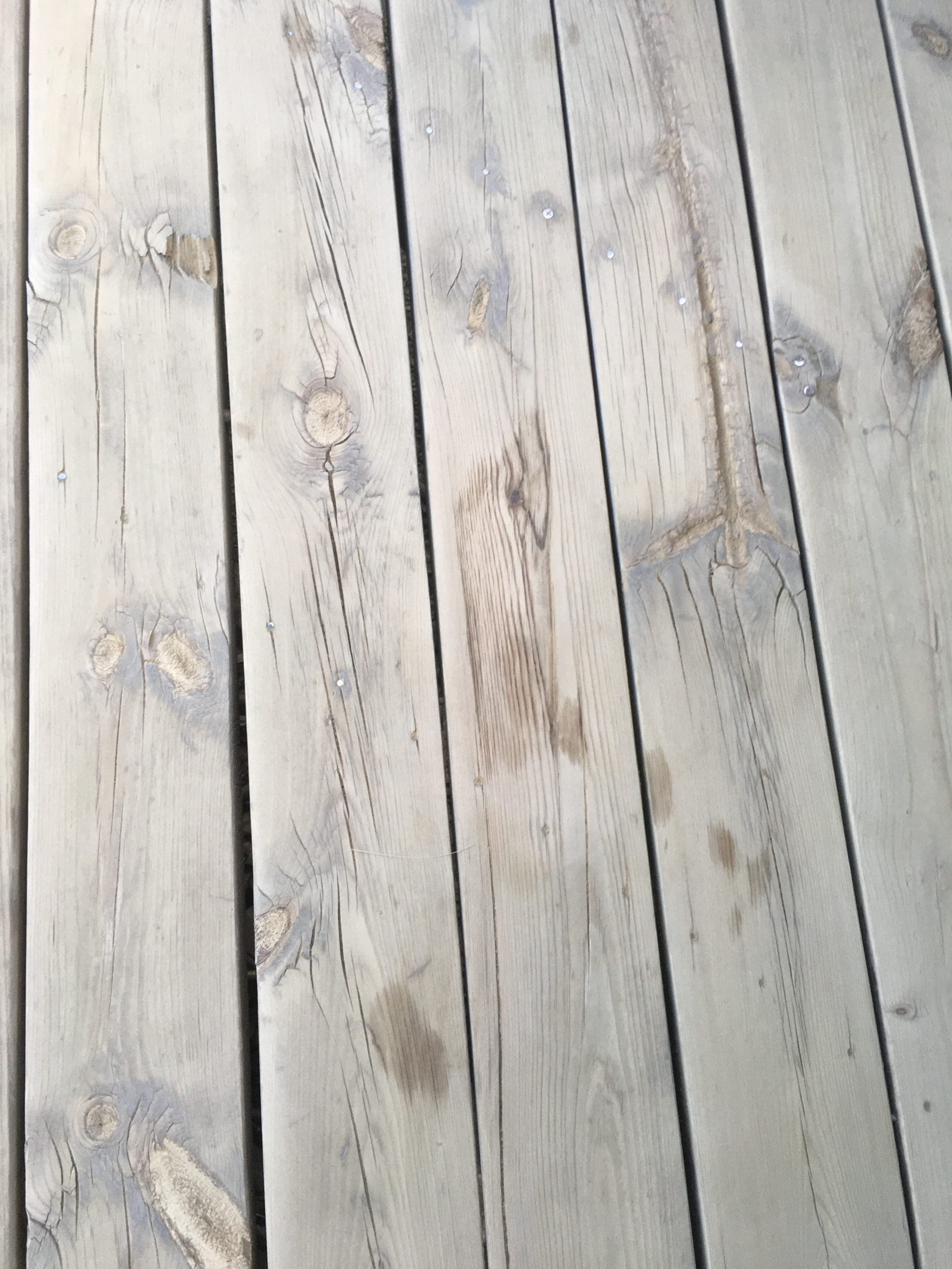

I attached a couple pictures of our deck… we stained the deck about 3.5 years ago with a Cabot Oil Based Stain. What product would you recommend to strip/clean the deck (with a power washer)? Should I follow that up with a brightener? I will then will have to sand to remove some of the splinters/etc which are there now. What type of product would you recommend to deal the deck (semi-transparent, semi solid, oil based vs. water based, etc)? Also, is it ok if it rained between power-washing and refinishing (then dried fully 24+ hours before staining)?
Kevin
Kevin
Kevin
Reply to  Kevin
I forgot to mention, we live in Iowa.

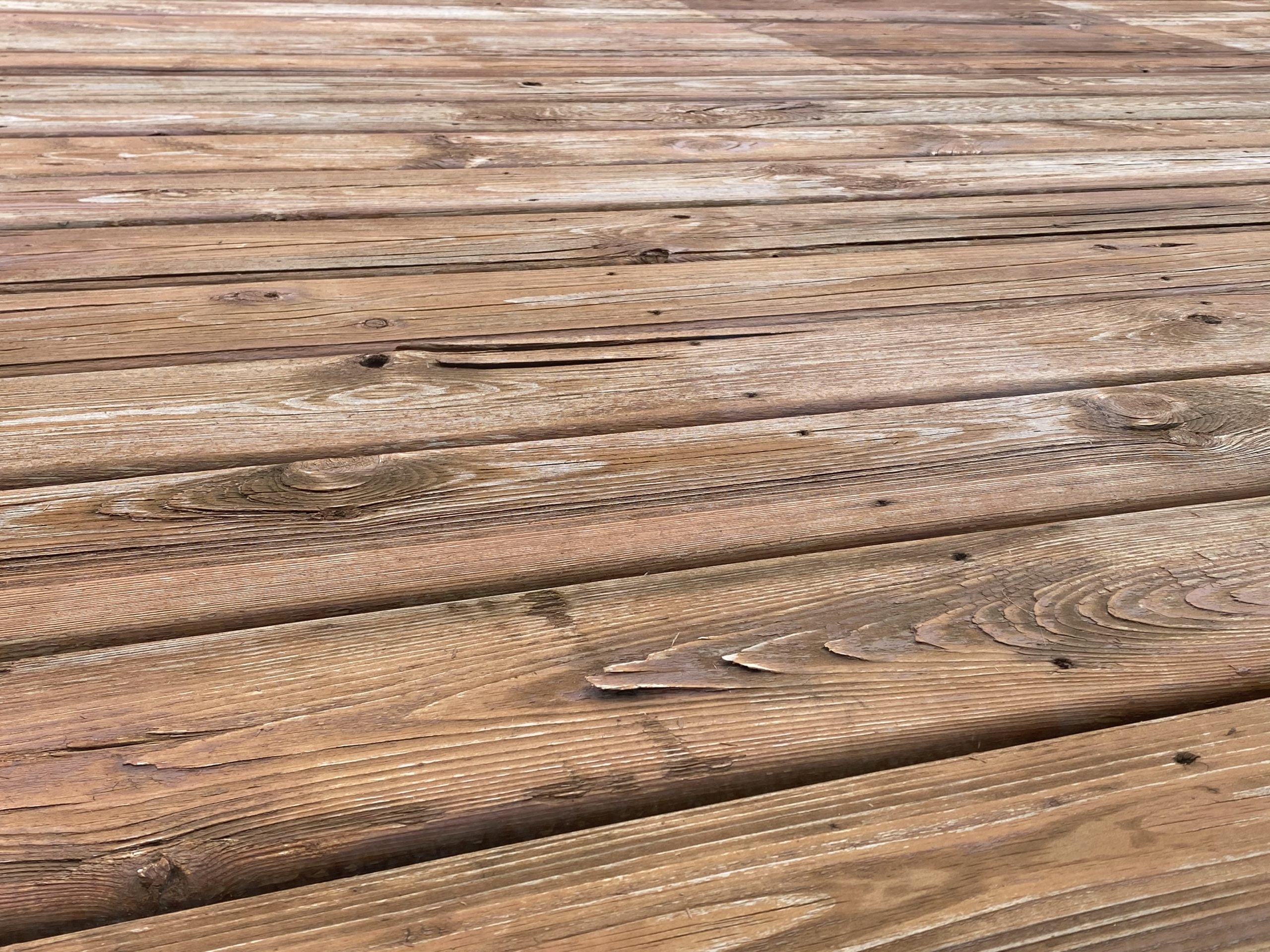

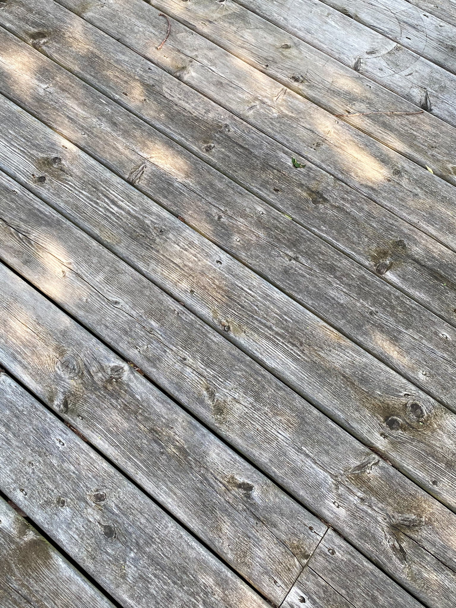

I have a cedar deck (10 x 18 feet) new in fall 2014. TWP cedar tone finish applied the following summer. It now seems to be wearing off in spots, primarily on the flat surfaces exposed to sun, but also mildly on the vertical posts. I would like to retreat the deck this summer with TWP Cedar tone again and would like to know the process. Stripper and power wash, then brightener? If so, what brand to use. How long to wait before applying the TWP product after cleaning? Is there one TWP product that is better than another?
The deck in on the north side of a cabin in central MN. There is a large pine tree which overhangs part of the deck and drops sap on the deck in the summer.
Thanks for your advice. Mark

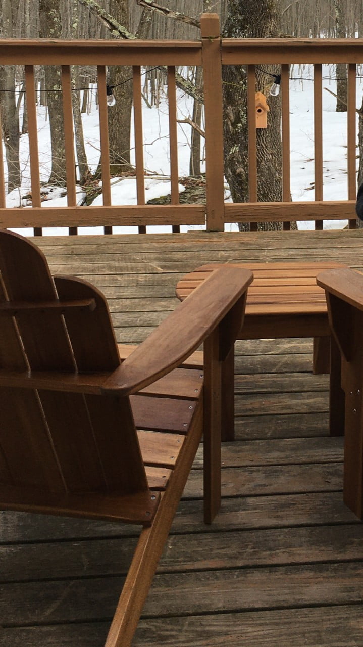

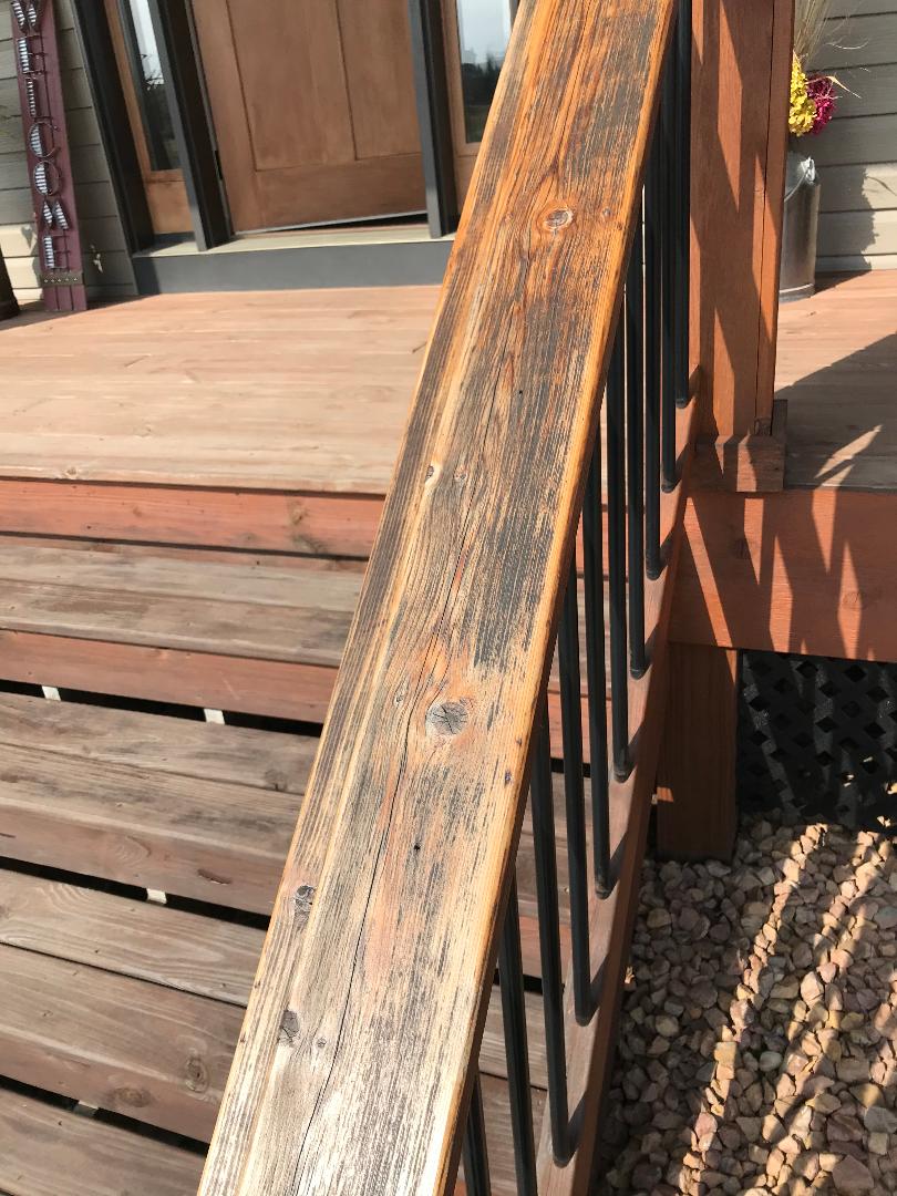

Our cedar deck is 4 years old. The railings have turned black (see pic) and we haven’t been able to get rid of it. We have tried sanding with no luck. The last stain used in this pic was Flood CWF Oil – oil wood finish in cedar color. Should we strip and do a brightener? What kind of stain should be used?

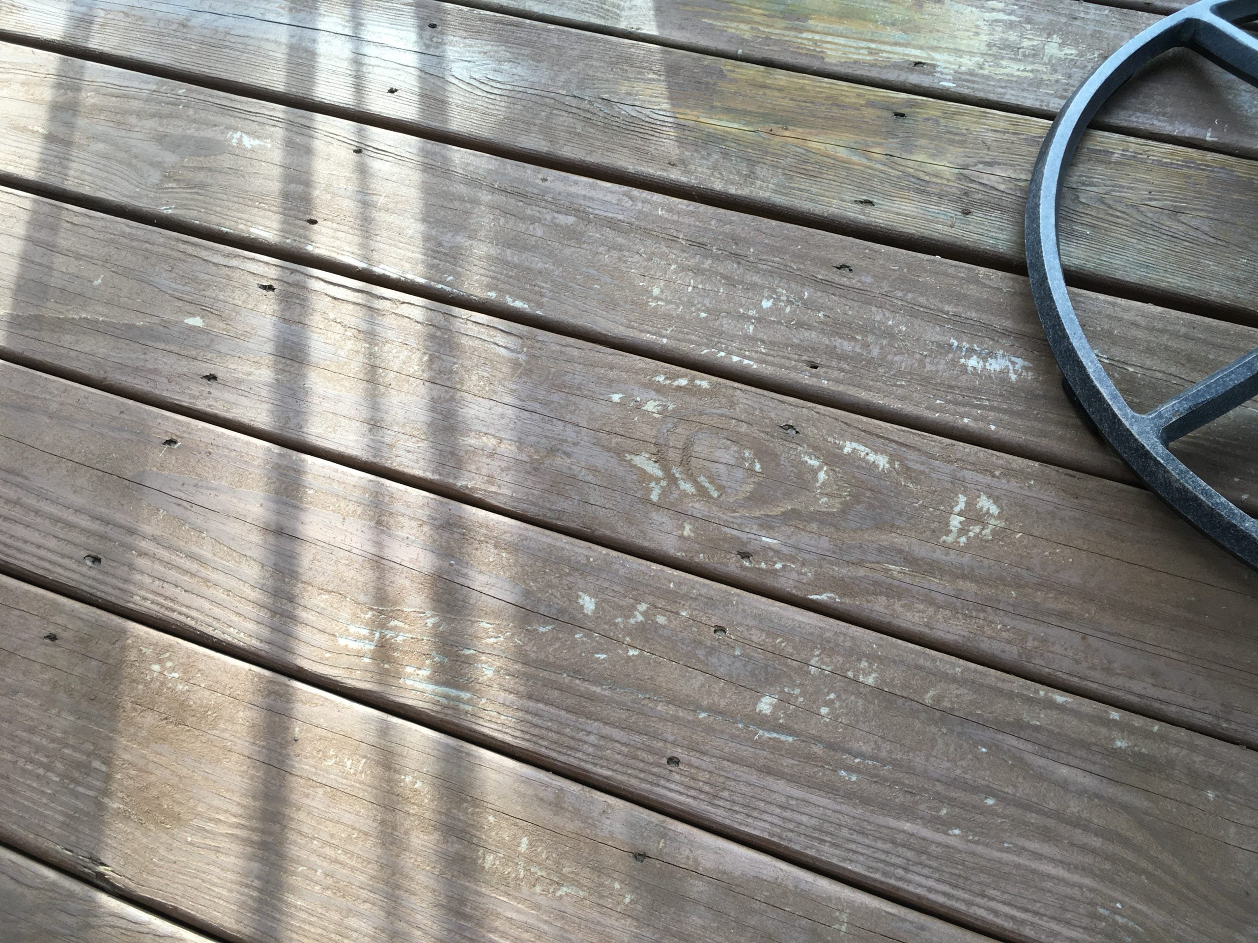

A few years ago we stained our deck with an Olympic brand semi-transparent stain. The stain never really took. We are looking to restrain it this spring, but are not sure what steps we need to take. Stripper, brightener, then stain? We also have a big stain from a citronella candle that oozed off the table when we forgot to bring it in on a very hot day. Can this be removed with a project or are we stuck with a solid stain?
Amanda
Amanda
Reply to  Amanda
Product not project.

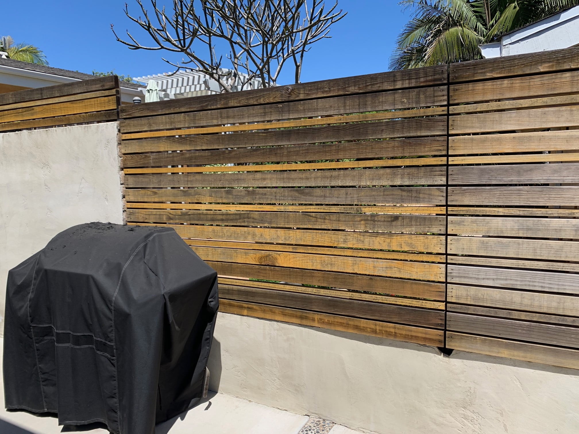

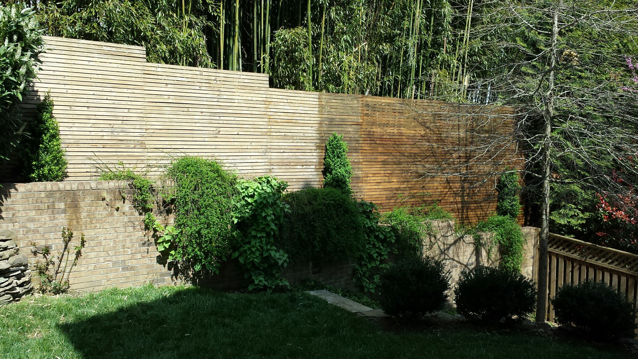

Western red cedar 1×2 horizontal fence installed in 2017. Just got around to having it stained by a contractor. He power washed, let dry for 1 day and then applied Cabot’s wood toned deck stain in Natural. The finished product was splotchy, black in areas, orange in others. I used Penofin Wood Stripper to remove stain and did it in sections over 5 days. I’m happy to see it come off, but boy did it take a lot of elbow grease! I have not followed stripping immediately with brightener. Part of fence is still drying. Could you please tell me what my next steps should be and why it turned out so poorly when done by the contractor?

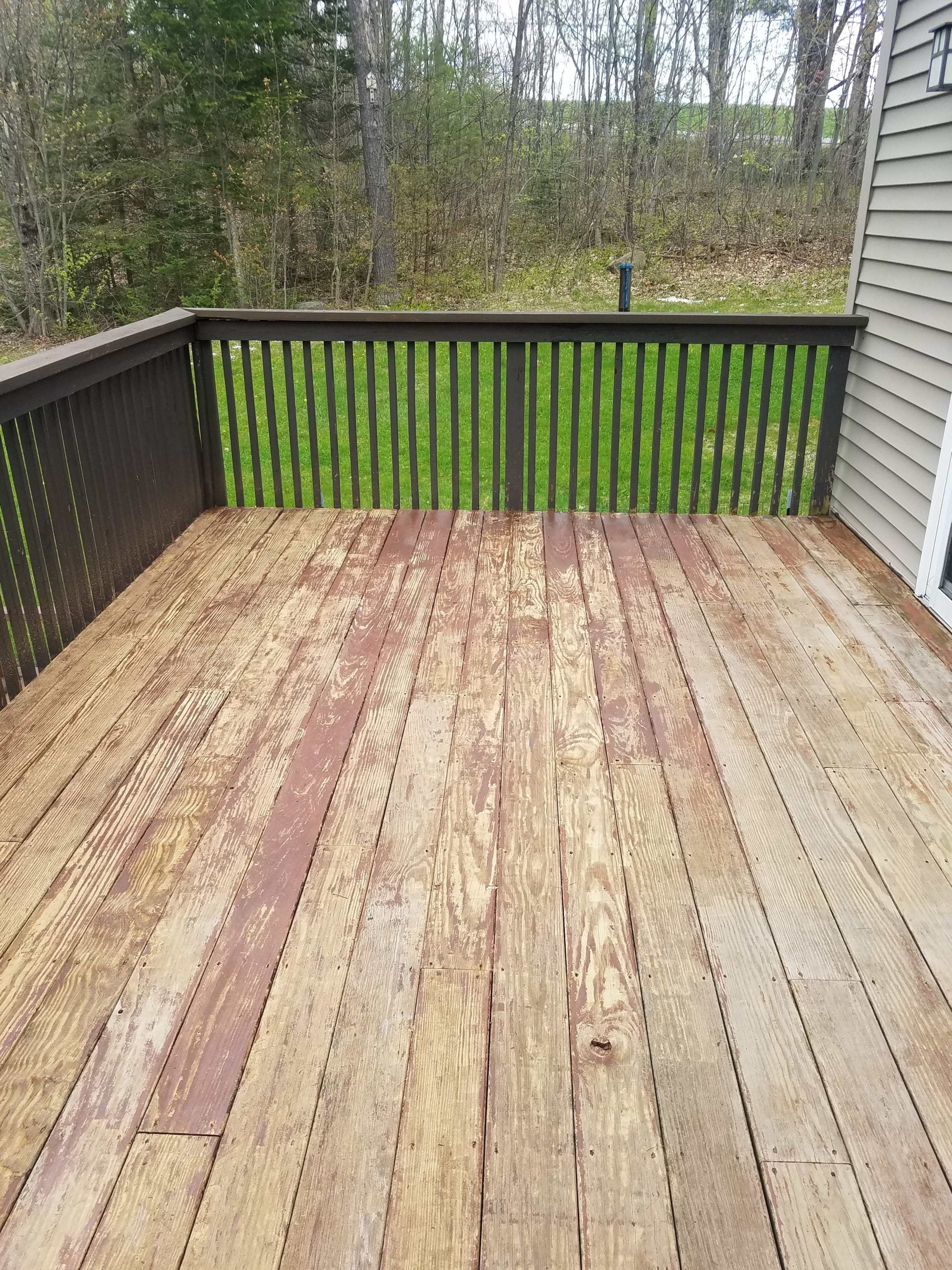

Question. My deck had a horrible old blue paint on the surface. We pressure washed and sanded. It still has some blue remnants on it. We are hoping to use an exterior solid stain over top. Do I need to strip or clean the deck with either of these products, or will a solid wood stain do the trick?

Nate
Nate

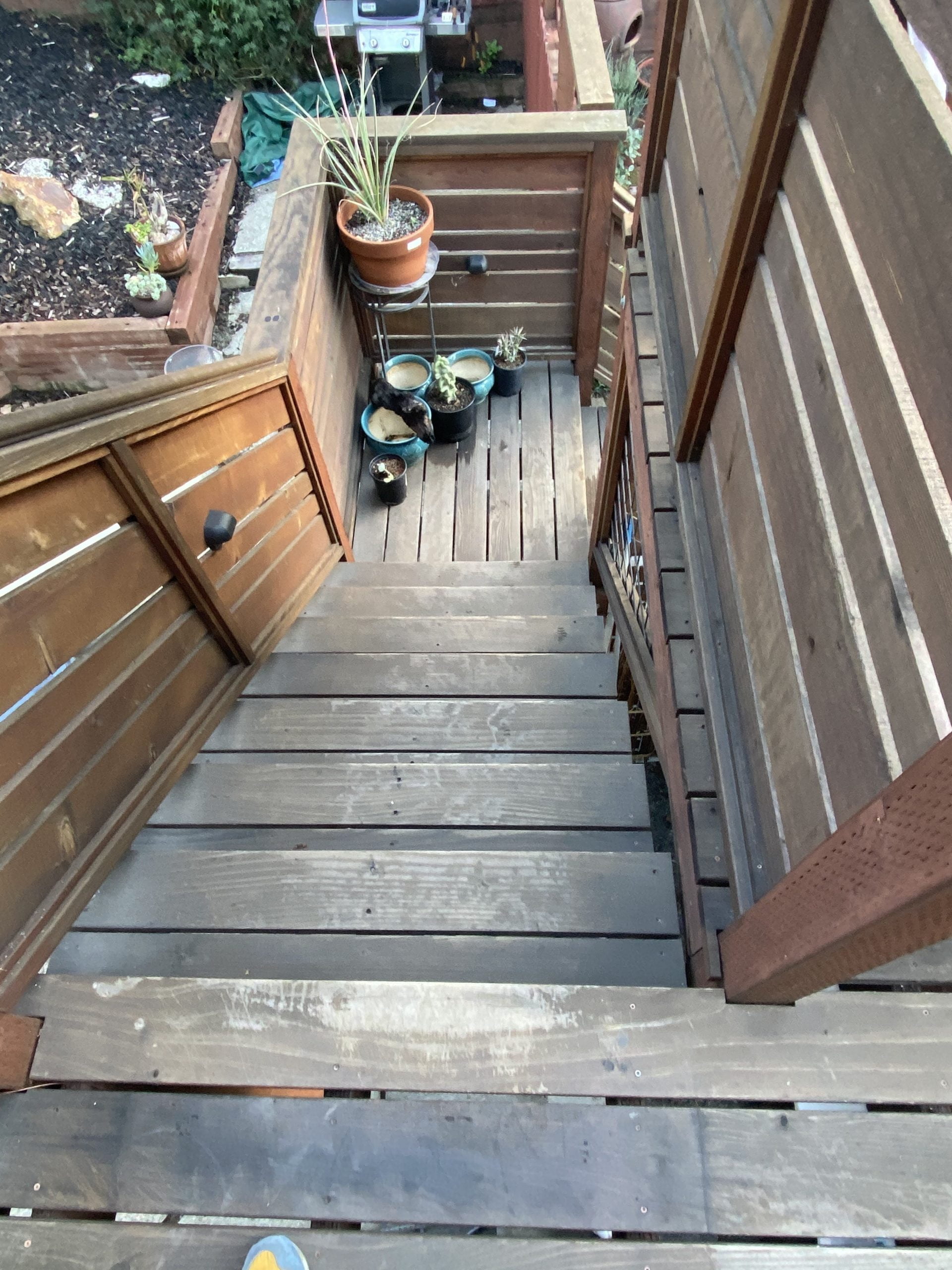

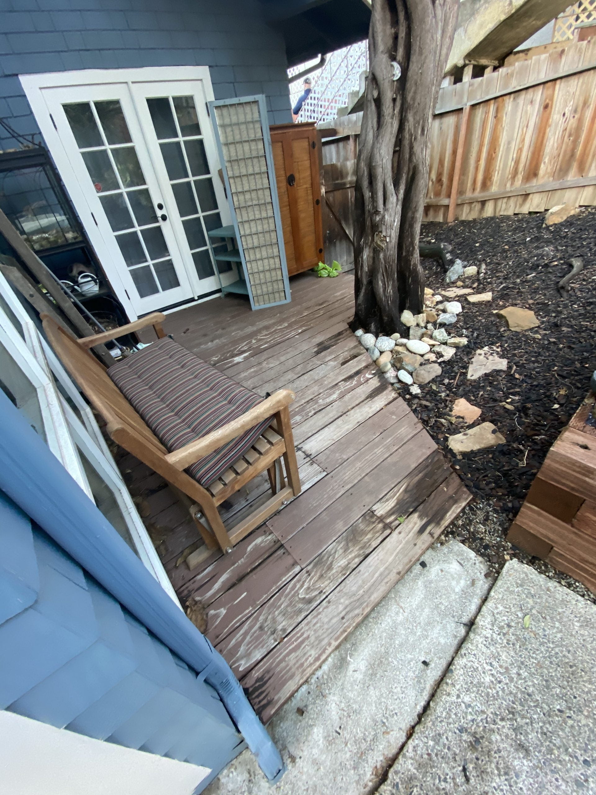

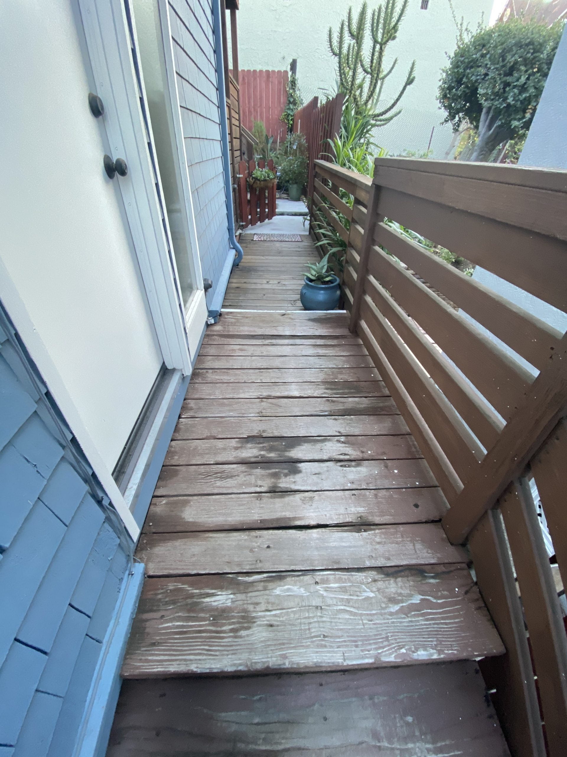

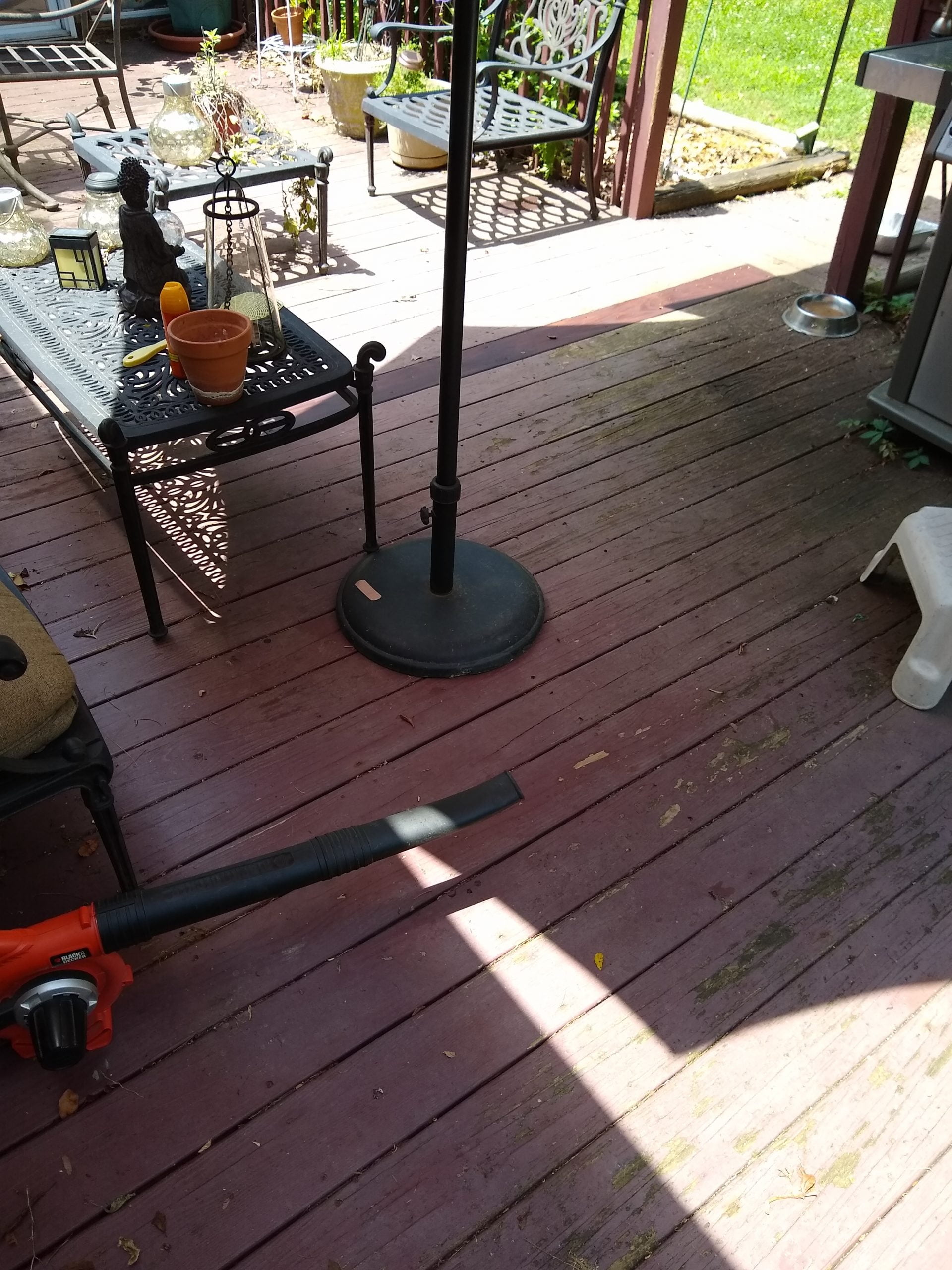

We’re moving into a new place and have never had a deck. The deck looks to already be stained or oiled but there are some black spots on the hand railing. It is coastal so I think due to moisture and sun damage. Do we need to strip the entire deck and restain?
Nate
Nate
Reply to  Nate
Here’s another picture.
