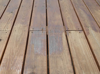

There are two reasons deck stain can turn out blotchy. The most common reason is overapplication of the deck stain. The other reason most people have their deck turn out blotchy is that they did not prep the deck properly before applying the deck stain.
  • The two main causes of blotchy deck stain are overapplication and improper deck prep before staining.
  • Overapplying deck stain prevents the product from soaking into the wood properly, leaving some areas tacky and uneven.
  • Oil-based deck stains are especially prone to blotchiness when too much product is applied and cannot penetrate the wood.
  • Uneven application causes parts of the deck to dry normally while other areas remain blotchy and sticky.
  • Proper deck prep including sanding and cleaning is essential for stain to penetrate and protect the wood correctly.
  • Always check the weather forecast before staining and ensure no rain is expected for at least 24 hours after application.
Why does overapplying deck stain make it blotchy?
blotchy deck stain and how to prevent itOver-applying deck stain keeps it from soaking into the wood properly, but it still dries somewhat. The liquid sits on the wood, unable to penetrate, particularly with oil-based deck stains. This means that parts of the deck could be dry while other areas are blotchy and tacky. This is the result of not applying the deck stain evenly and using too much deck stain.

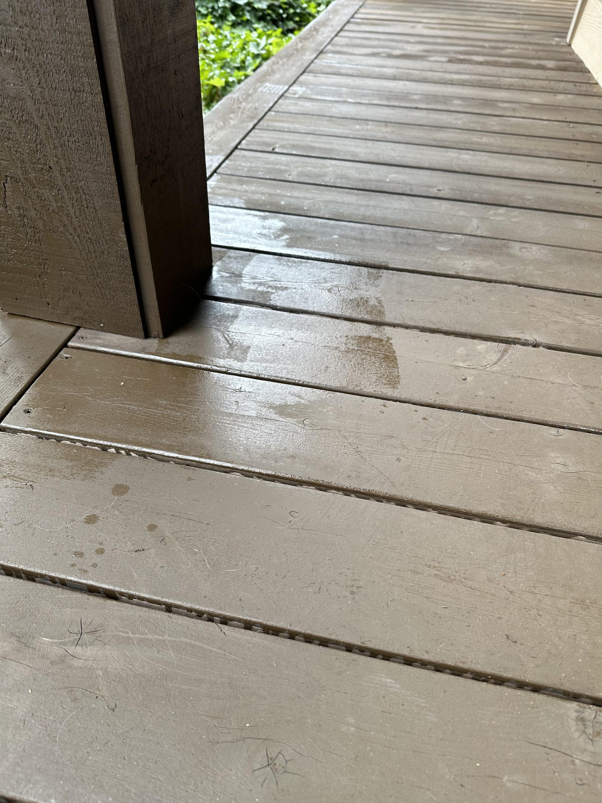

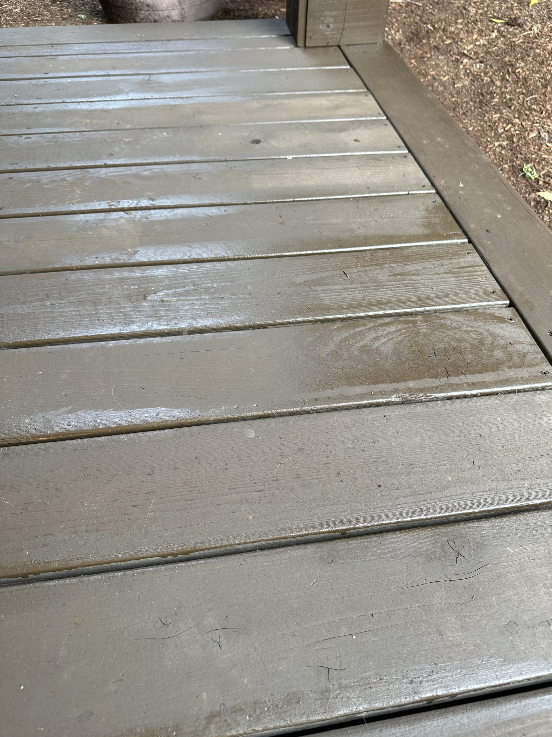

We just had our deck restrained, it was properly prepared before staining, they used oil based stain in a dark brown color, my question is now it looks bloctchy all over, like its wet but its not. So upsetting, what can we do to fix this ?? Any help would be great.

Hi, they used sherwin williams super deck oil based color stain. I will post pics. The main large part of the deck looks fine but the part that’s the worst is the wrap around part of the deck. Thank you

They didn’t remove the excess stain that didn’t absolutely Let dry and dry inconsistent and Flashes appear wet do to the increase in Shine on Parks of it. They appear to have Just Slapped it on top with a Heavy Loaded Brush or a Heavy Loaded Rolled then Spread with a brush. They Side of the boards reveal it was Only applied to the top and they just drip over and was like not back brushed or wiped to leave that drip pattern. Does look Solid too Semi Solid Satin. If that the Case maybe be Less labor for you or another crew to fix. If the Offered a Warranty on there work I would advise you use that before the year mark as most only offer a one year warranty on the work.
