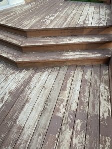

Why is my deck stain peeling?
Deck stain peels because it did not penetrate deeply enough into the wood. There are three main culprits:
  1. The most common reason that deck stain peels is that a solid deck stain or clear sealer was used. These form a film over the surface of the deck that cracks and peels with wear.
  2. Overapplication of solid deck stains can cause peeling within a few months or even weeks. Semi-transparent deck stains can also peel when overapplied.
  3. The last reason that your deck may be peeling is improper prep before applying the stain. You must apply deck stain to a clean and prepared surface or it will not penetrate properly into the wood, causing peeling.
Once the deck stain peels it must be stripped and reapplied.
