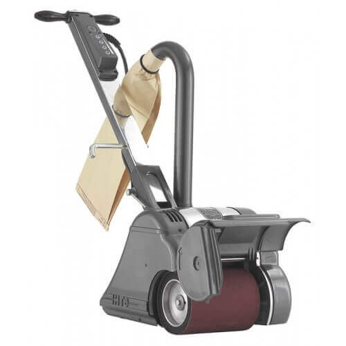

  • Power Sanders: Drum, belt, and hand sanders
  • Sandpaper: 60-80 Grit
Drum Sanding DeckMy Deck Sanding Tips

Use a Power Sander
My Pro Tip: Using power sanders will speed up the sanding process. Avoid circular sanders as they can leave swirl marks in your wood.

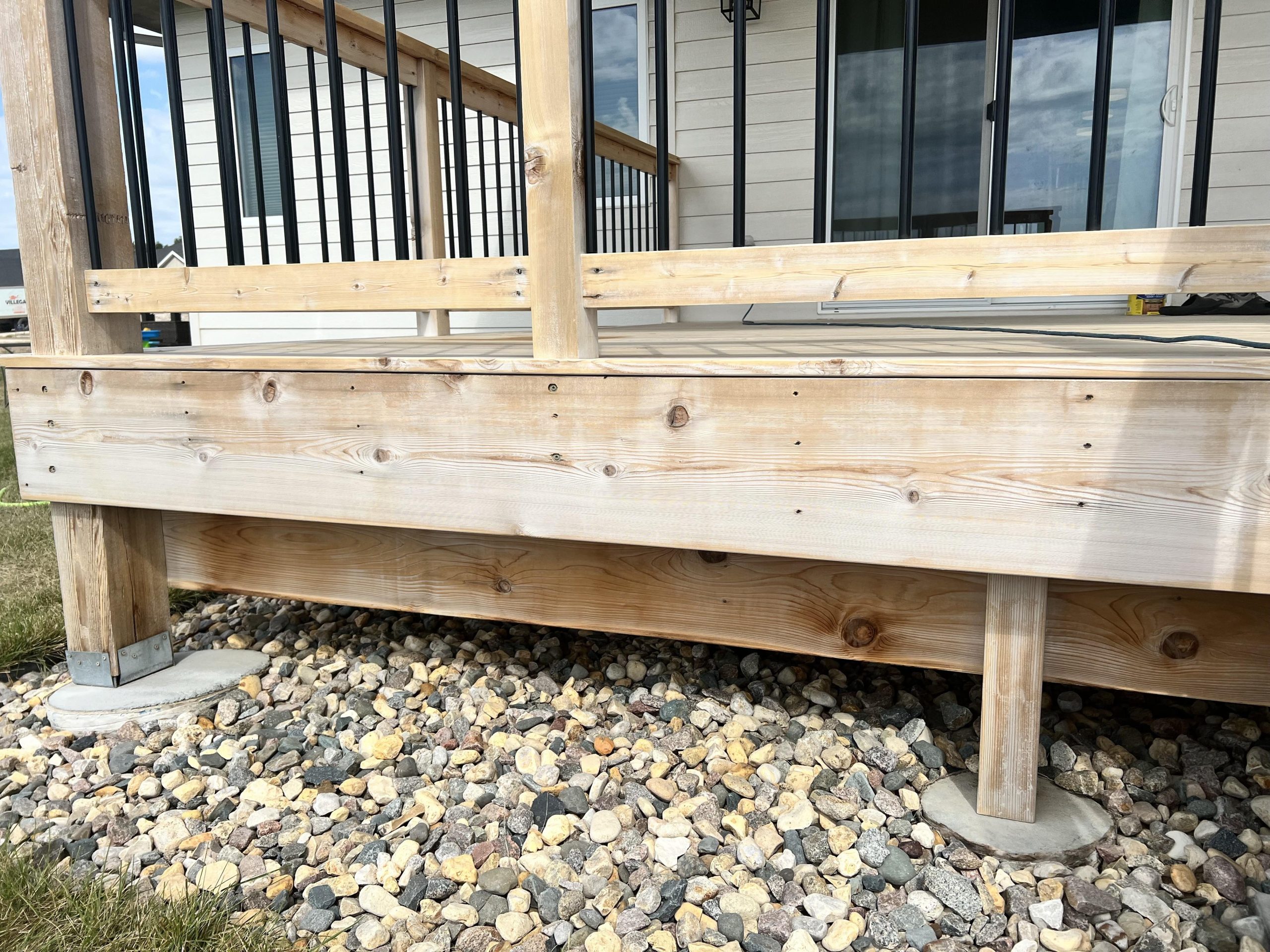

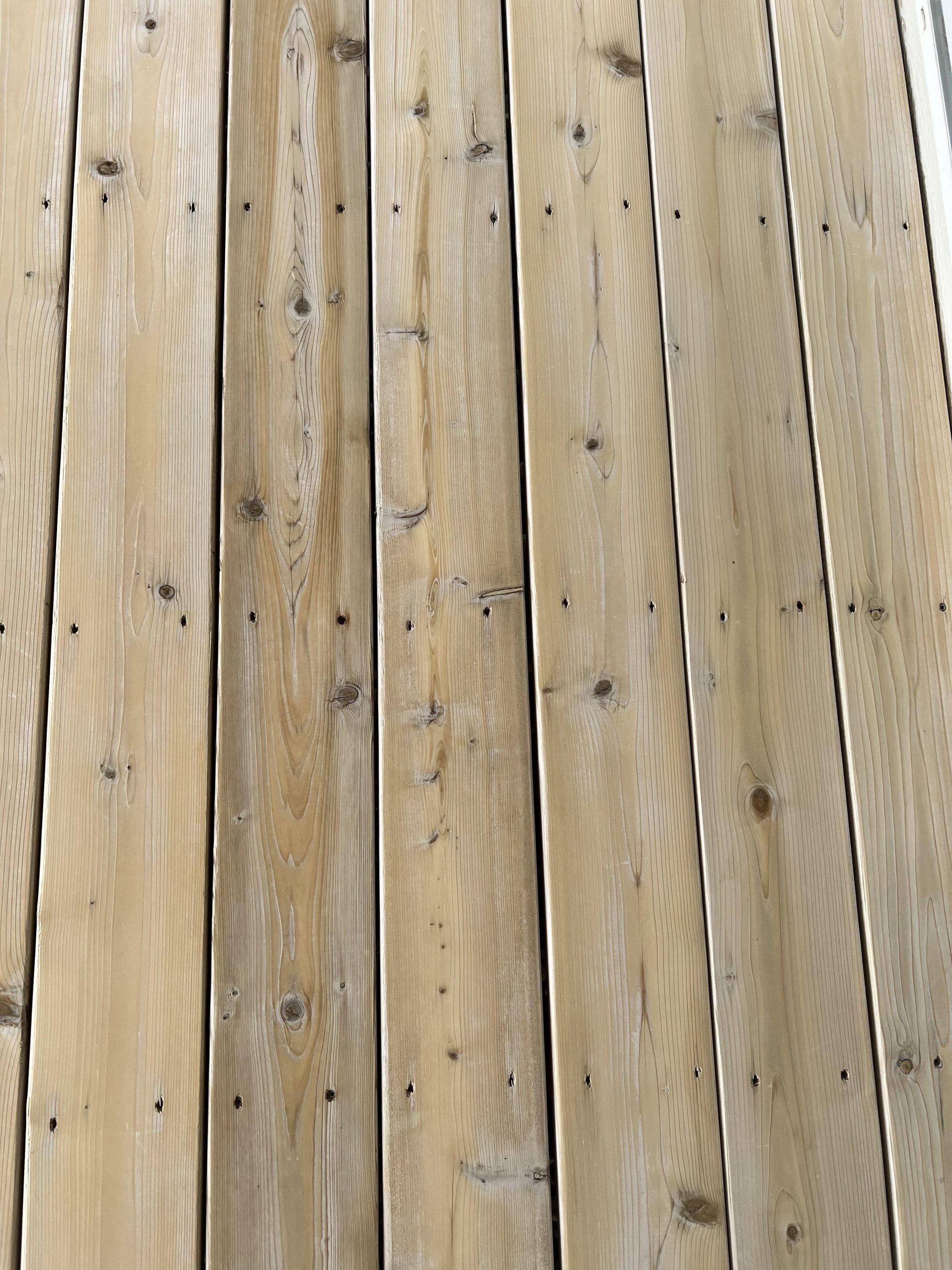

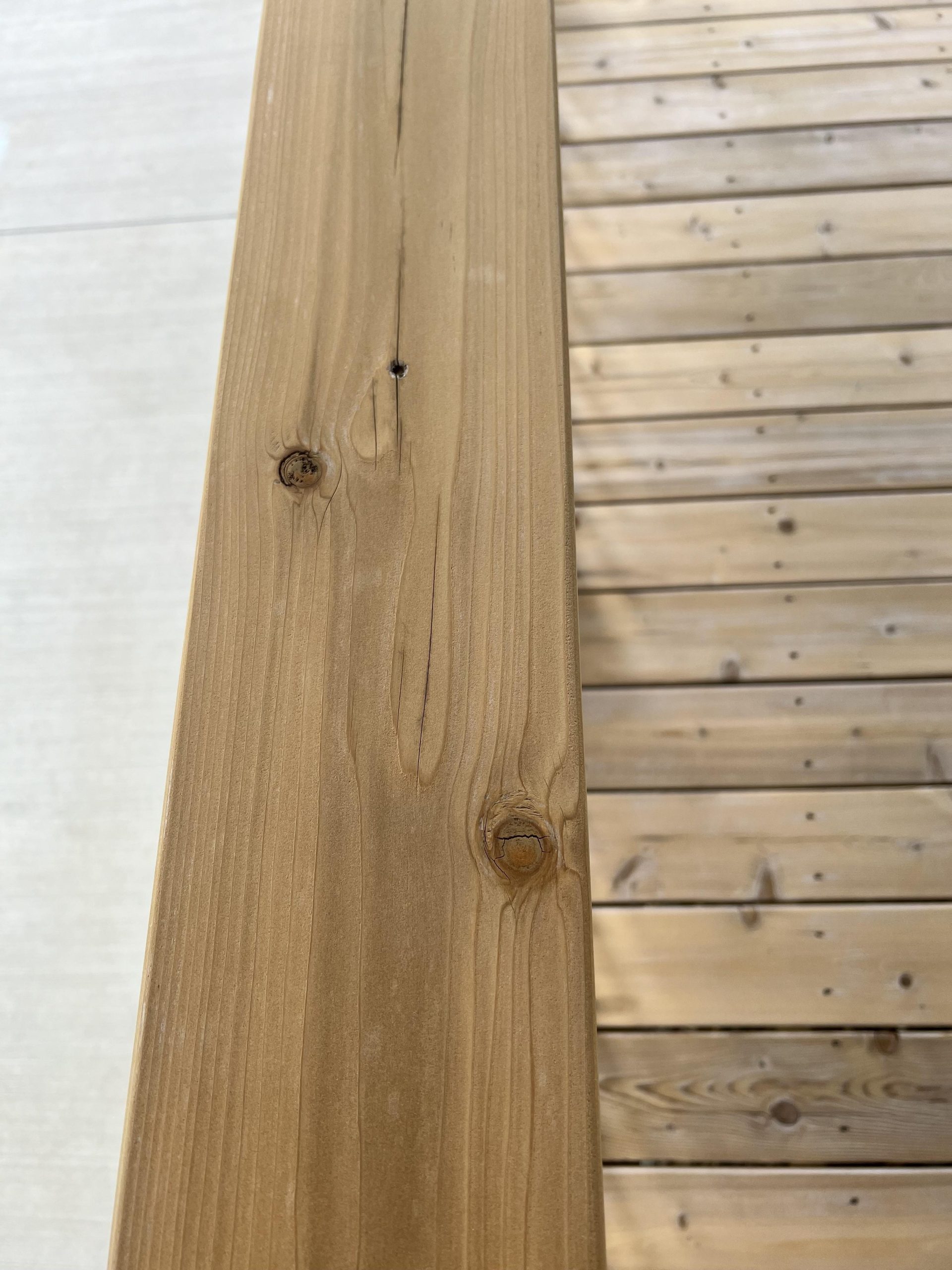

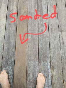

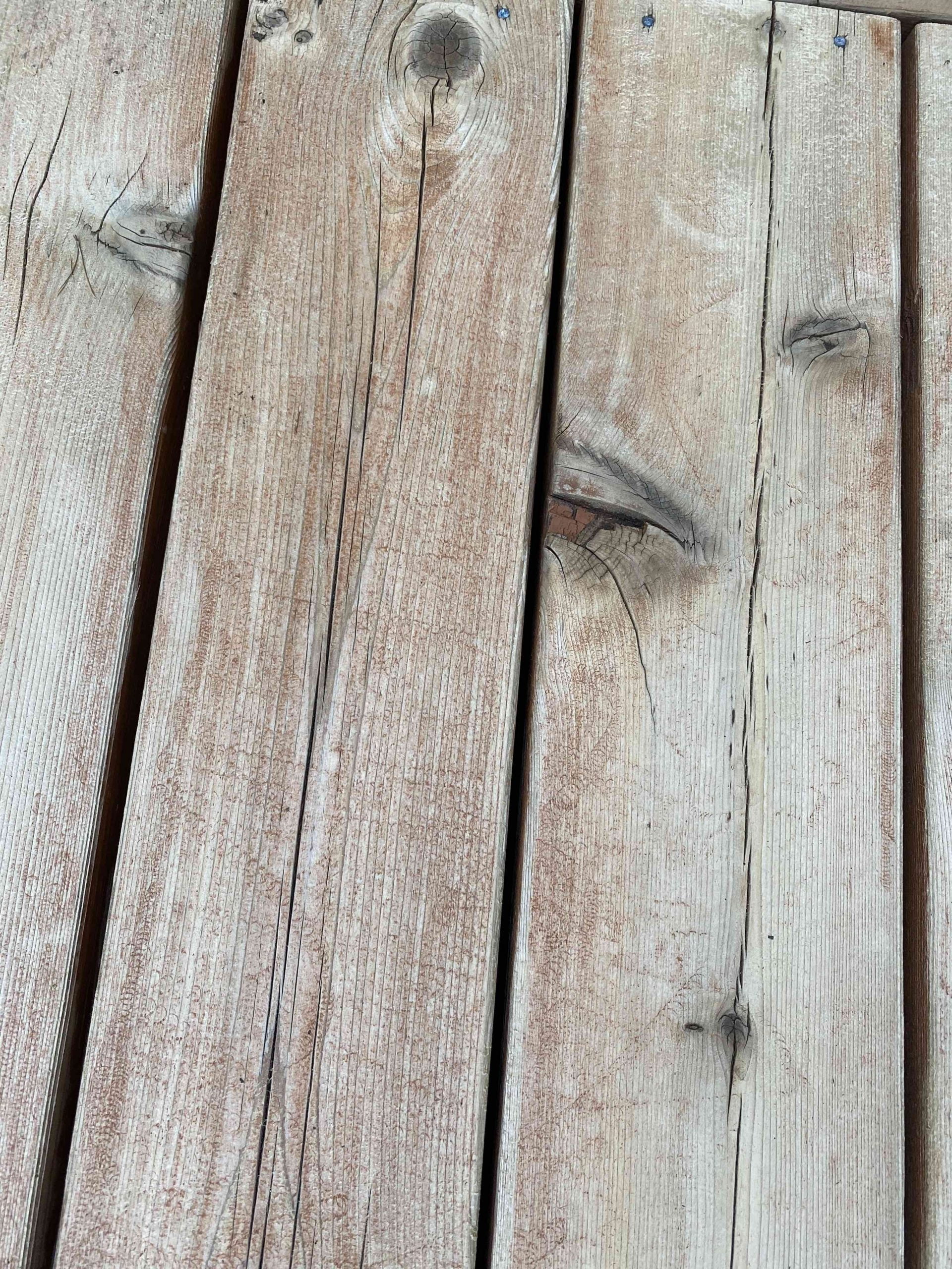

S year old cedar deck that was built last summer in South Dakota (extreme temperatures and both snow/rain). Last winter was fairly mild and we did not allow snow to sit on the deck but the wood had weathered and had small speckles of mold. We got around to prepping the deck for stain a couple weeks ago and am now realizing we made multiple mistakes. We first pressure washed then sanded everything with 120-220 (based on incorrect advice from a local hardware store- first of many mistakes). We then used a deck cleaner, and although we thoroughly washed after, we didn’t do the deck brightener until hours later. The wood then looked white or bleached in areas with some white fuzzies. So we started sanding with 80-180 grit to get rid of the white. Now after reading your sanding post, I believe we cannot stain as the pores are closed due to the finer grit, correct? What should we do about the white/bleached portions that are not fuzzy- Will it take up stain or do we need to sand it down to the raw wood as we had started to? The handrail is down to raw wood. It is mid September and I am worried about leaving it all winter again. It likely will not be nice enough to stain until at least May if we have to wait.
IMG_9823
IMG_9824
IMG_9825
IMG_9826

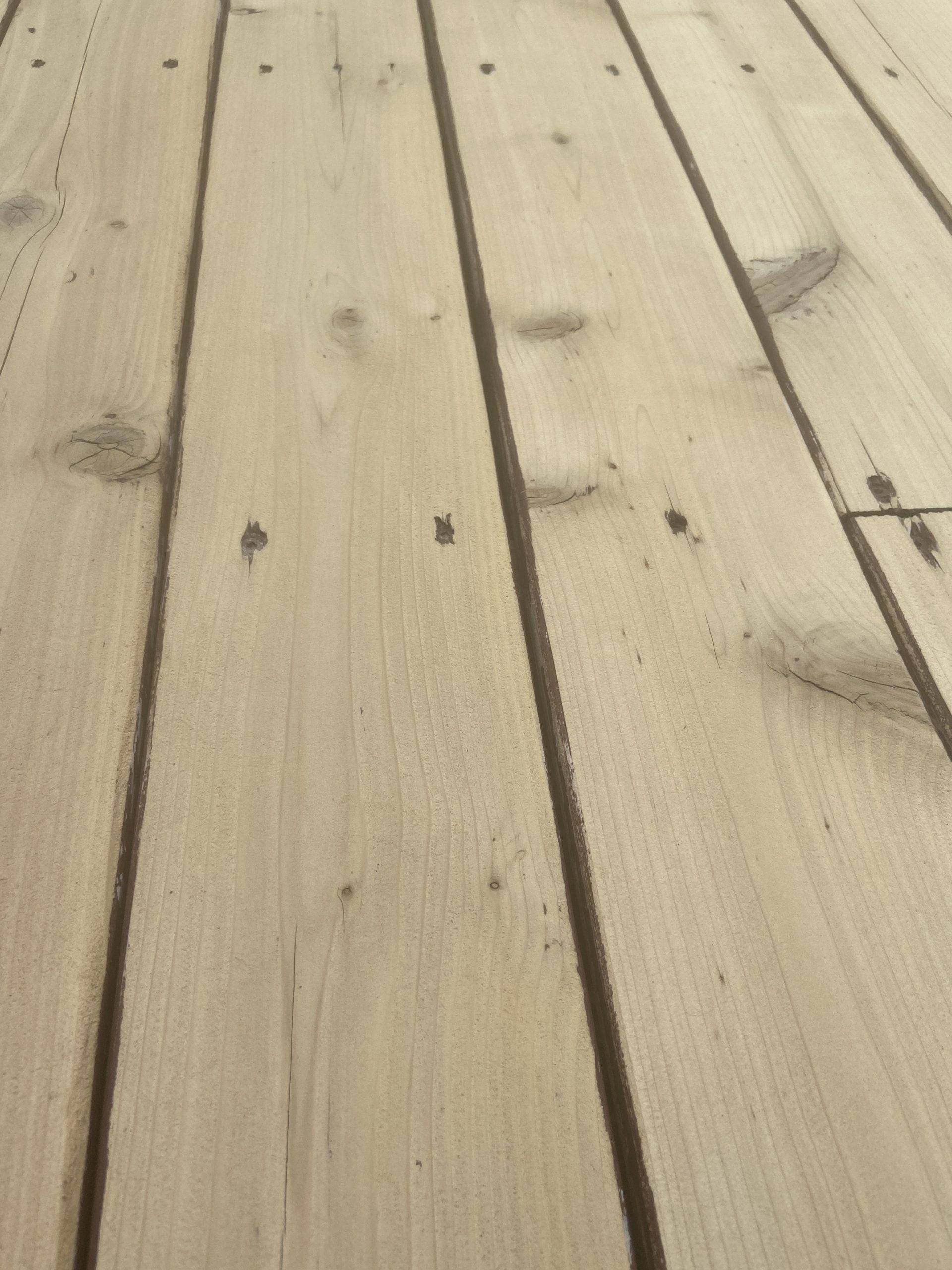

Hello, We have removed all the old peeling and stuck on paint/stain/goop…then I cleaned and scrubbed with OxiClean, rinsed many times over, in the rain. When the rain stopped, it was dark so I did the oxalic acid the following day. I treated and rinsed many times over, waiting for the deck to dry now, BUT….the wood has quite a lot of furry bits that were not there when I began cleaning. What do I do now???? Please help

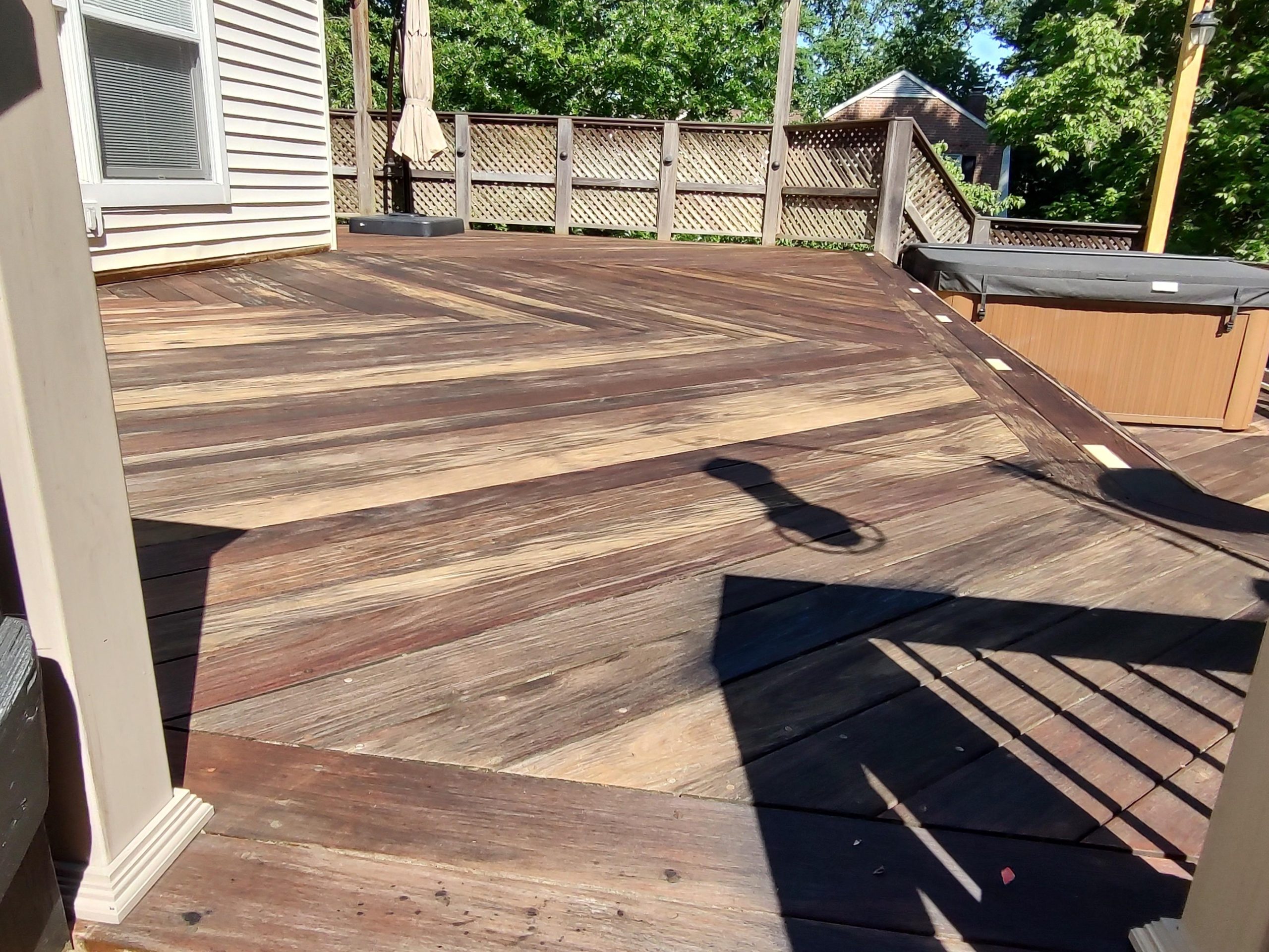

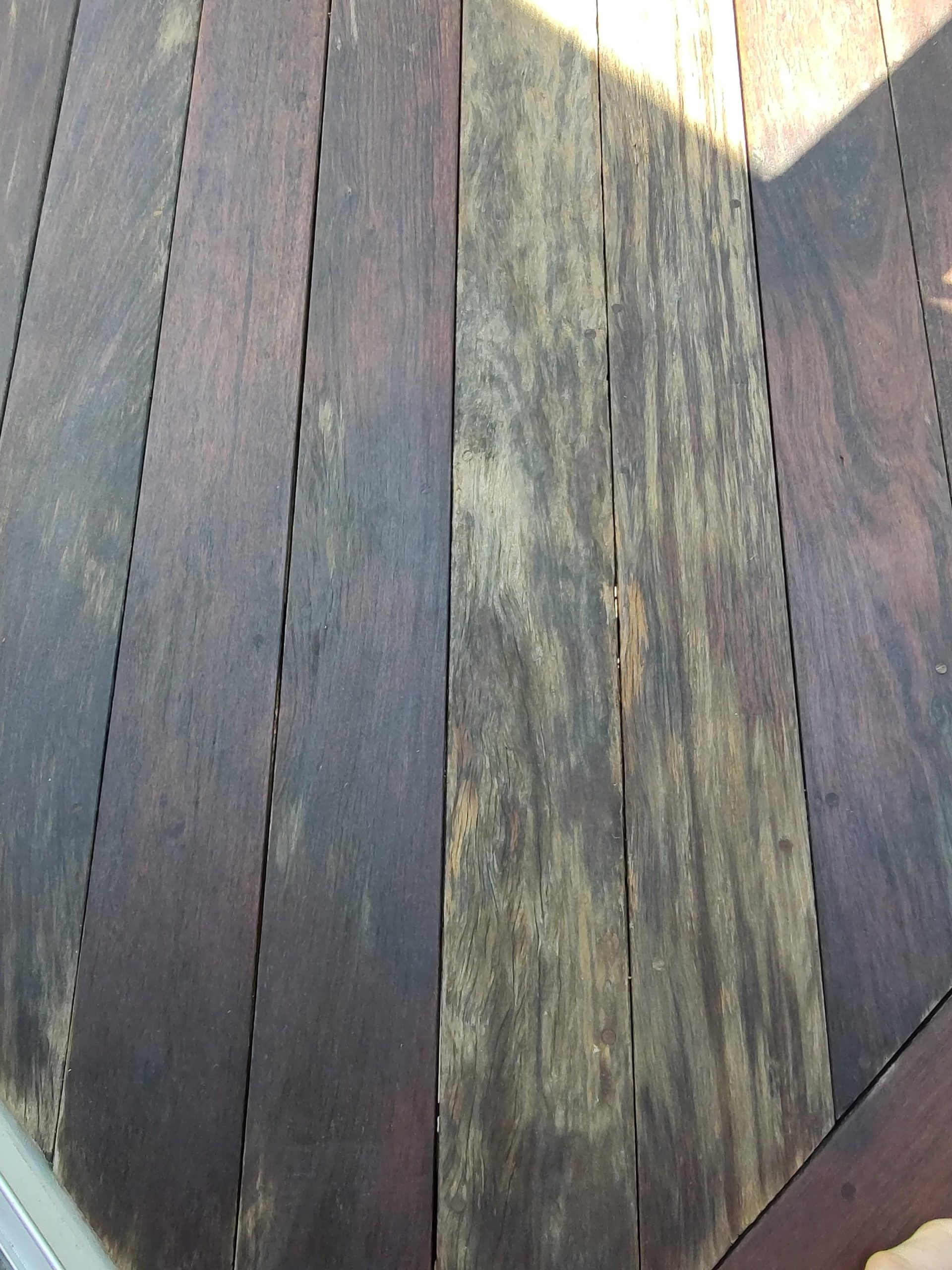

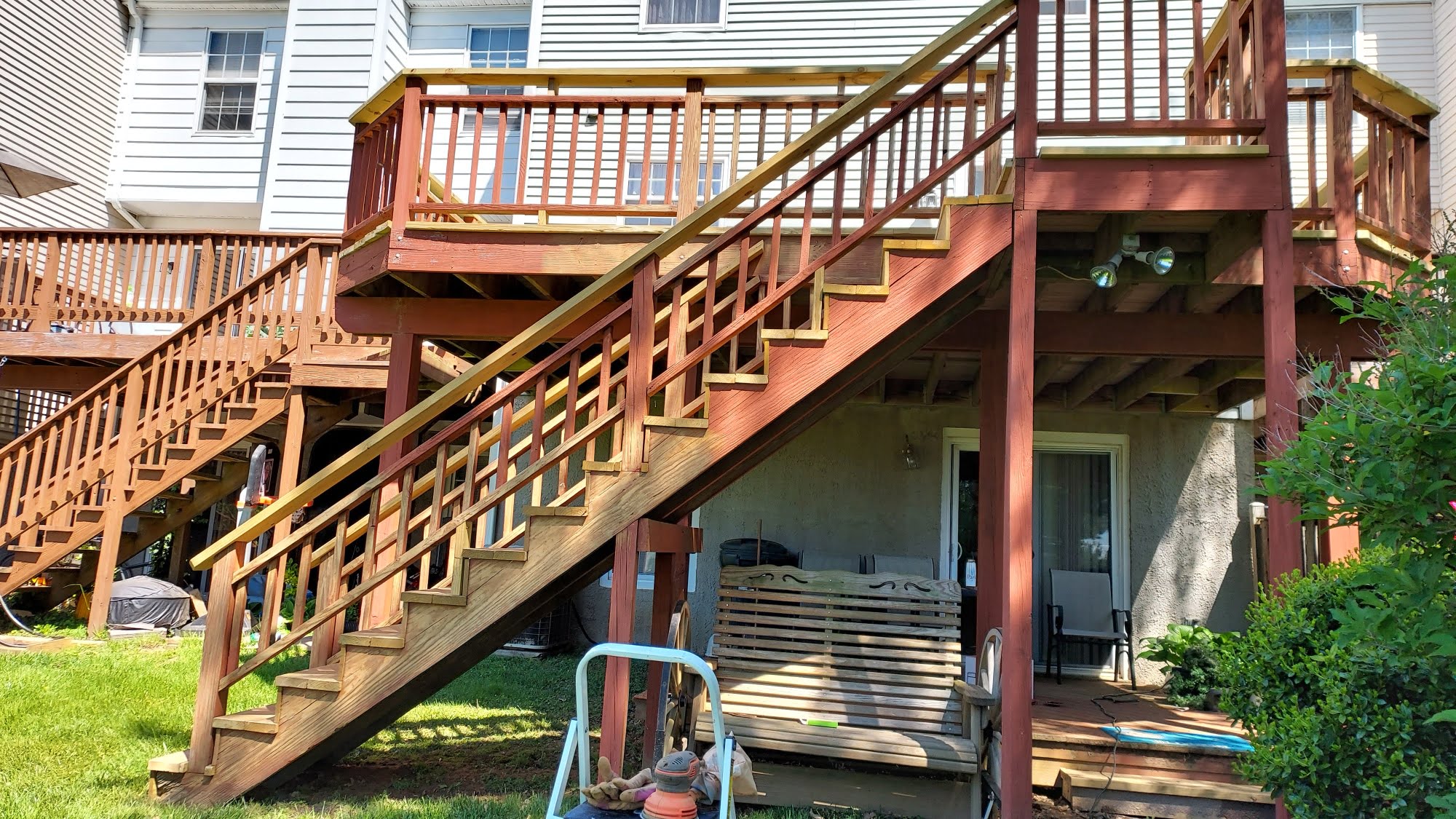

Company power washed unstained Ipe deck with just water ( I think) 10 days ago. The deck went from oxidized grey to blotchy white. They are waiting for dry weather to stain it with a natural colored oil. I took some 80grit sandpaper to some boards and took off the white blotches. Looks so much better. If they don’t sand will the blotchiness go away with the oil or do I need to sand it all off first?
If I need to sand, do I have to clean and brighten?
Oil? Are they any good? What do you recommend for Ipe
Ipe deck, 24yo, facing NE, 800sf still in great condition
Wooded Northern VA, half day blazing sun in summer, gets black slippery dirt when wet
Picture is after power washing. Company suggested Palm sanding with 120grit.
Thank you! in advance.
SB

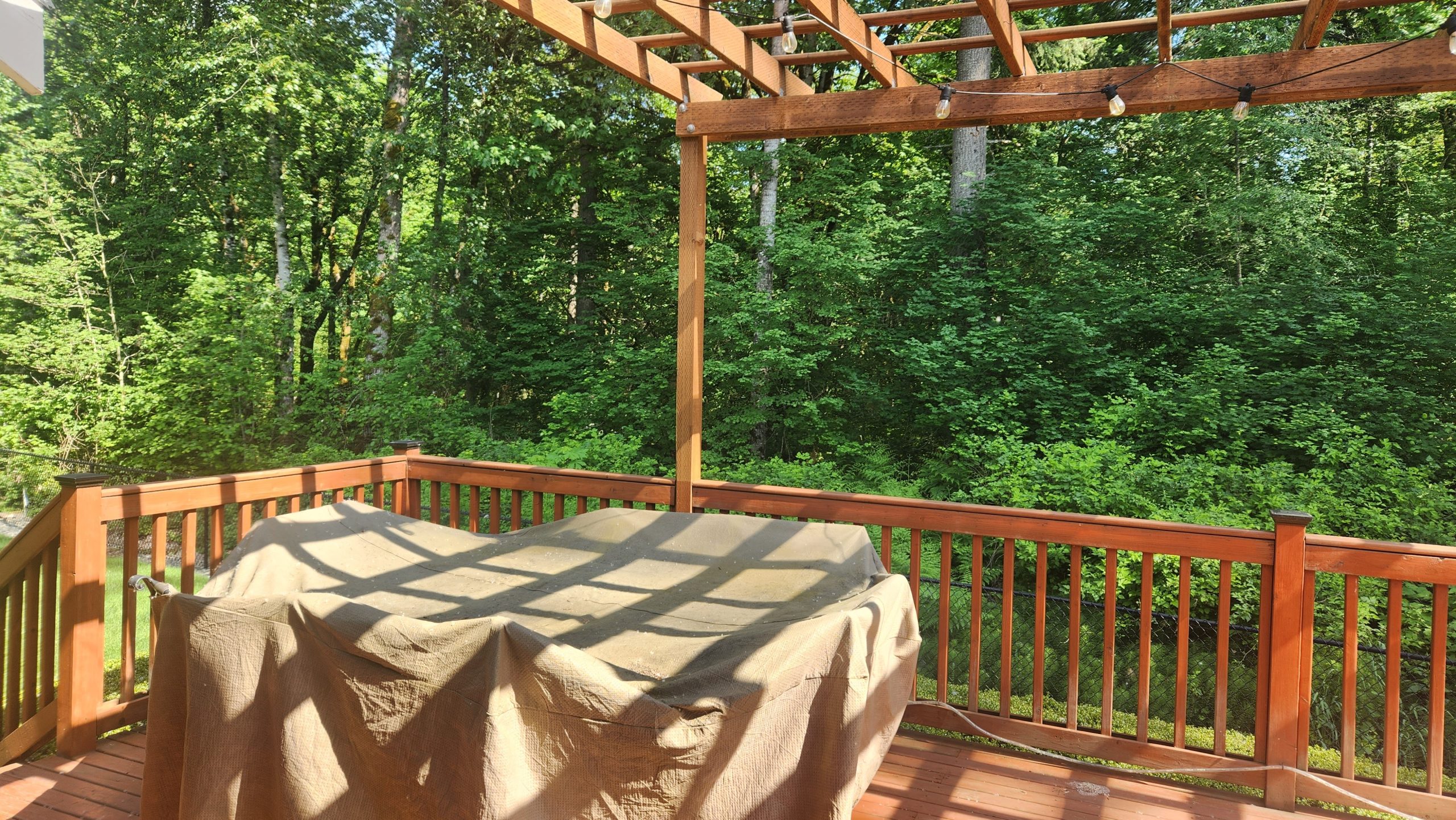

Semi-solid or solid for cedar deck in the Pacific Northwest?
Four yrs ago our redwood deck was restained with an inferior product that was supposed to be semi-transparent, but went on like solid. The color is an awful red. It hasn’t peeled but just looks blah. We are planning to restain/paint the deck now (along with the pergola)
I have decided to go with a semi-solid or solid to make it easier (I think!). What kind of product and prep do you recommend?
In which state is your deck located? WA state, Seattle area
How much sun/shade does your deck get? South-facing but on a greenbelt so sun in the summer
What type of wood is your deck made of? Redwood
Do you have mold or mildew issues? Very little on the underside of a couple of horizontal board of the pergola
Why/how did the previous stain fail? It has worn although, not peeled. It looks like orange paint.
What type and brand (if known) of stain did you use last time? HD Baer (contractor choice)
First photo (wet deck) is from 2021, the other two photos are recent

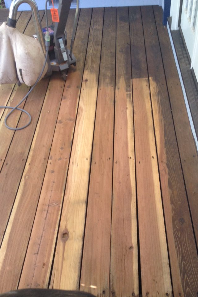

I had someone clean our new PT deck 5 days ago, then they came out and got paint splatter all over (long story). I decided to finish the job myself to avoid a long drawn out situation. I went out today to start trying to get the paint off and noticed the deck already looking discolored and see a lot of wood fibers coming off the boards. Pictures are of the deck as it looks now, and one section where I sanded to get the paint off.
Do I need to start all over by sanding, cleaning, and brightening the deck before I stain? It’s been weathered a year already (another long story). I appreciate any advice you may have. This deck project has been a total nightmare from the beginning.
Jason
Jason
Thank you so much for the reply! Do you think I should wash and brighten again or will sanding be enough?
Jason
Jason
Thank you! I might end up purchasing a new belt sander for this because of the large area. It would take FOREVER with my orbital sander.

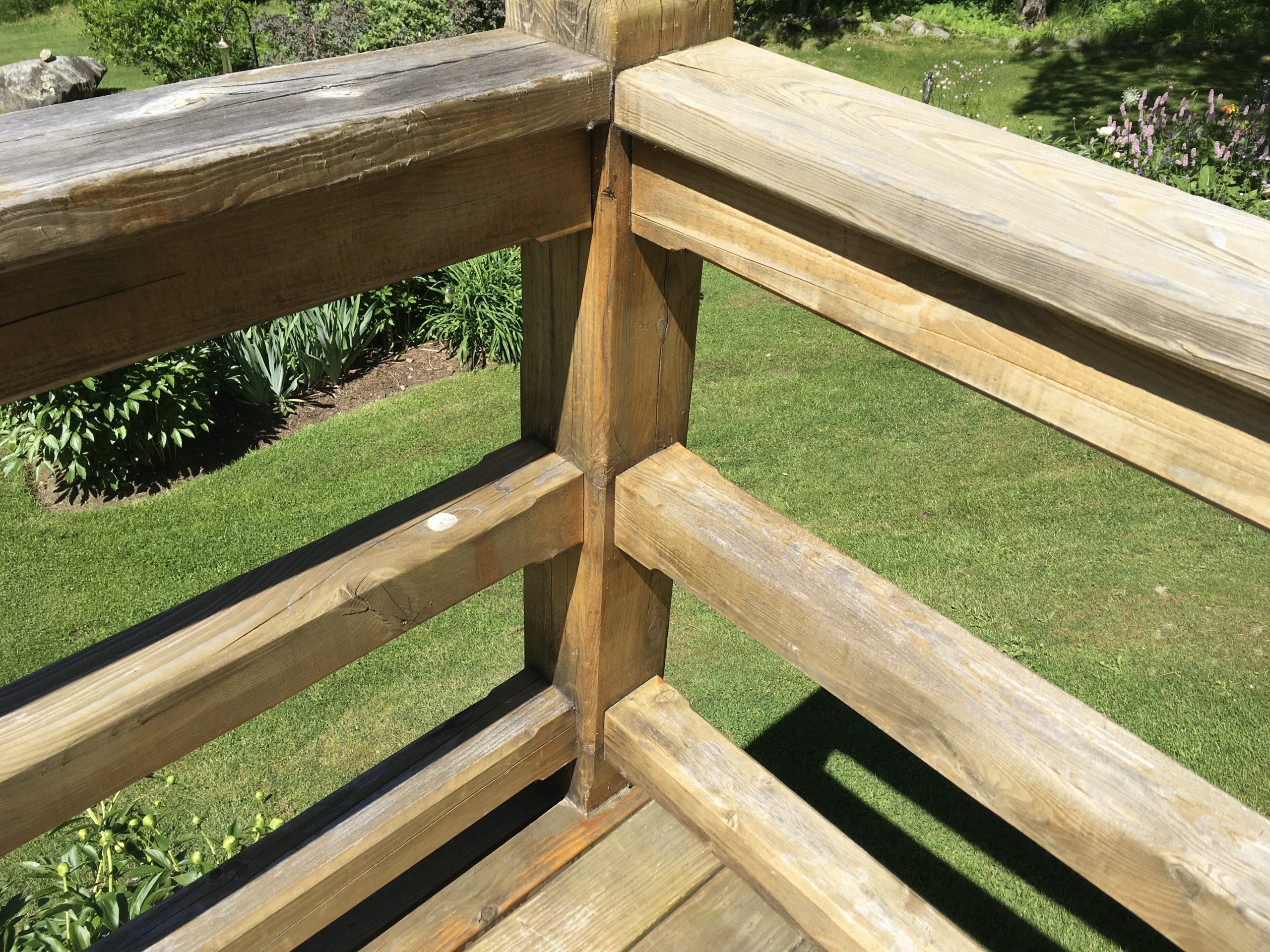

We are in Northern Ontario Canada. We built a new western red cedar deck in 2019. In 2020 I scrubbed the deck twice with Palmolive and oxy twice. After it dried, we stained the deck in the mid afternoon in the shade, with one coat of Olympic clear waterproofing sealant. We were told to expect two years because of the climate. Please see the attached picture. We are looking at staining again this year but want to make sure the preparation is correct including sanding. Thank you in advance
Venjayc@gmail.com
Venjayc@gmail.com
Thank you very much. We understand with red cedar, different colors and grains (if I have that right). We are seeing small fibers. I know pressure washing is a no no. Can I use a deck brush still for deck preparation?
Appreciate the help

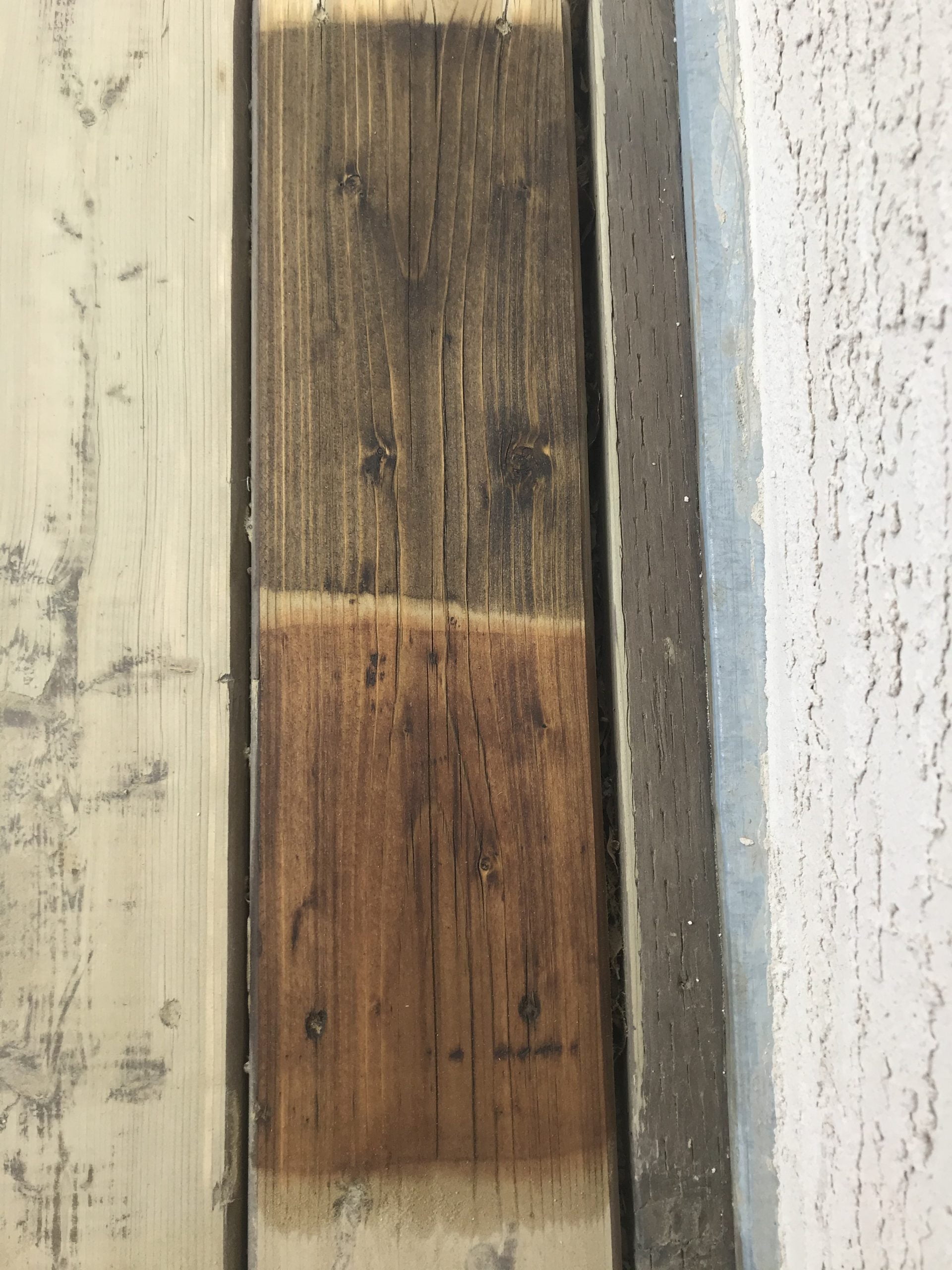

Thanks. I did a test area with the cedar stain and the darkish gray grain parts turned black, so looks like tigers stripes. Should i brighten the deck again or use a darker stain like pecan?

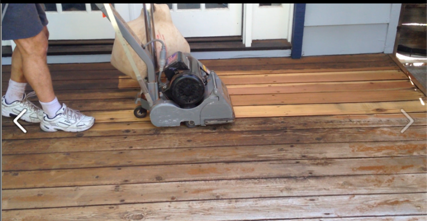

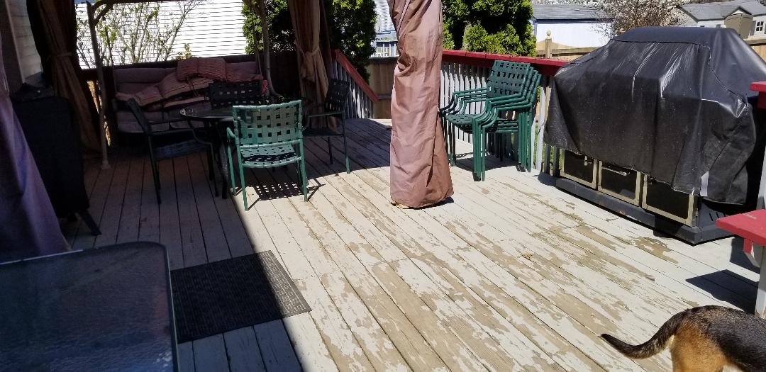

I have a deck and had some one come out and power wash it and it got all messed up. Sanded it today and added a coat of stain and I think I sanded to smooth. The stain did not take well. What should I do

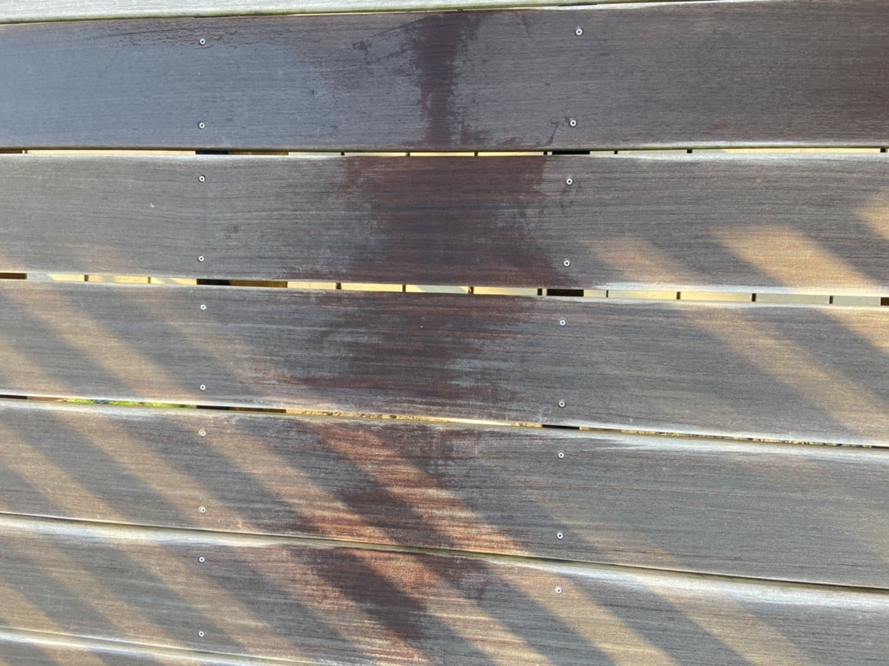

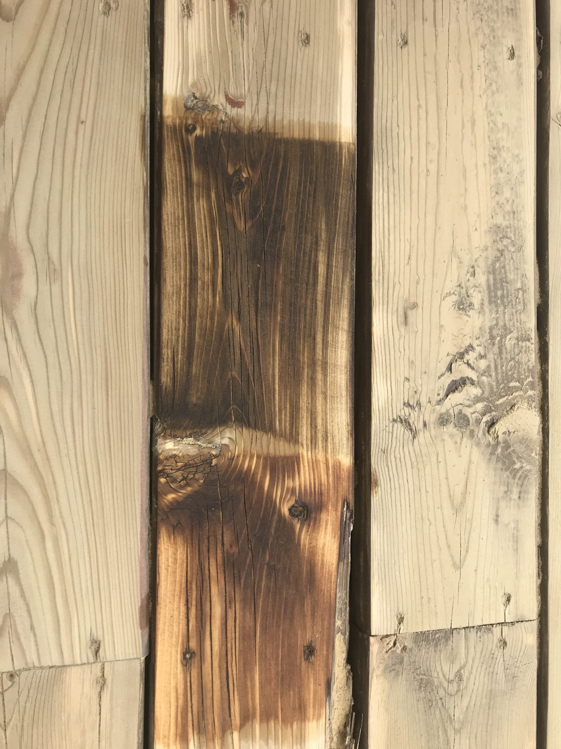

Brand new deck, aged 5 months, all sealed except my wife placed a metal plant stand on the unsealed deck and when we moved it it left a rust stained ring. My wife got out a palm sander and sanded the ring out but used the whole surface of the sander to do it. Now we have a two foot in diameter “whiteish” mark on the deck. My thought is to not stain it and let it weather for a few months to “darken” it up some, then seal it. What would you do?, thank you in advance for your advise

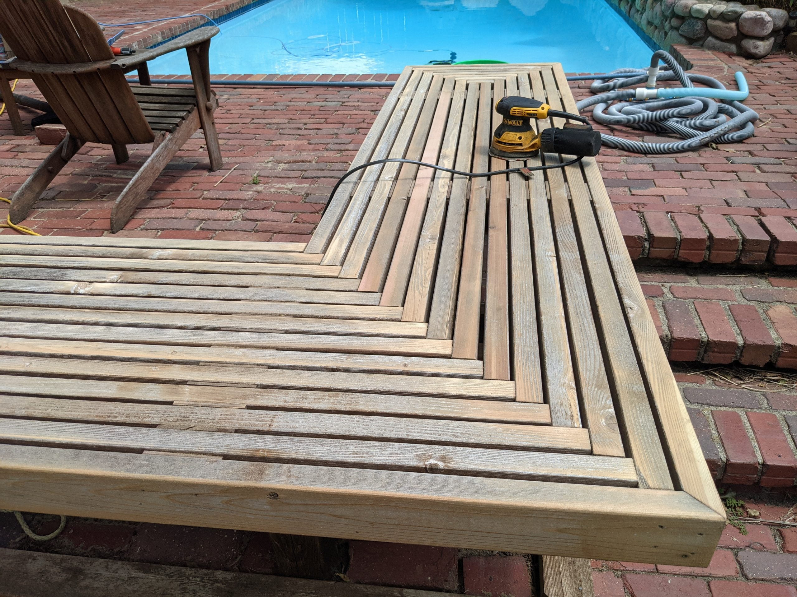

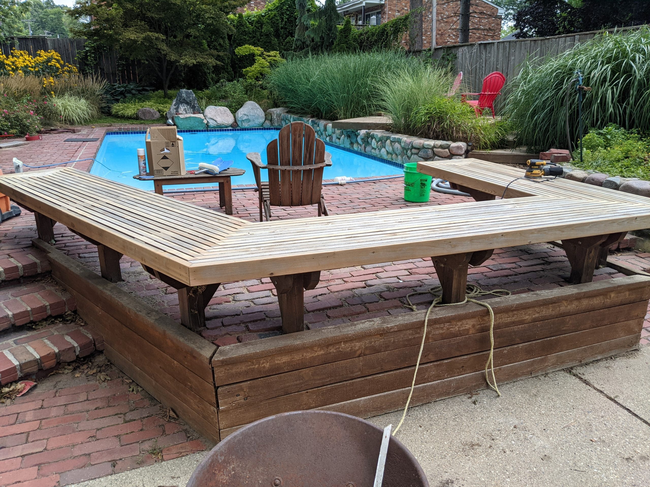

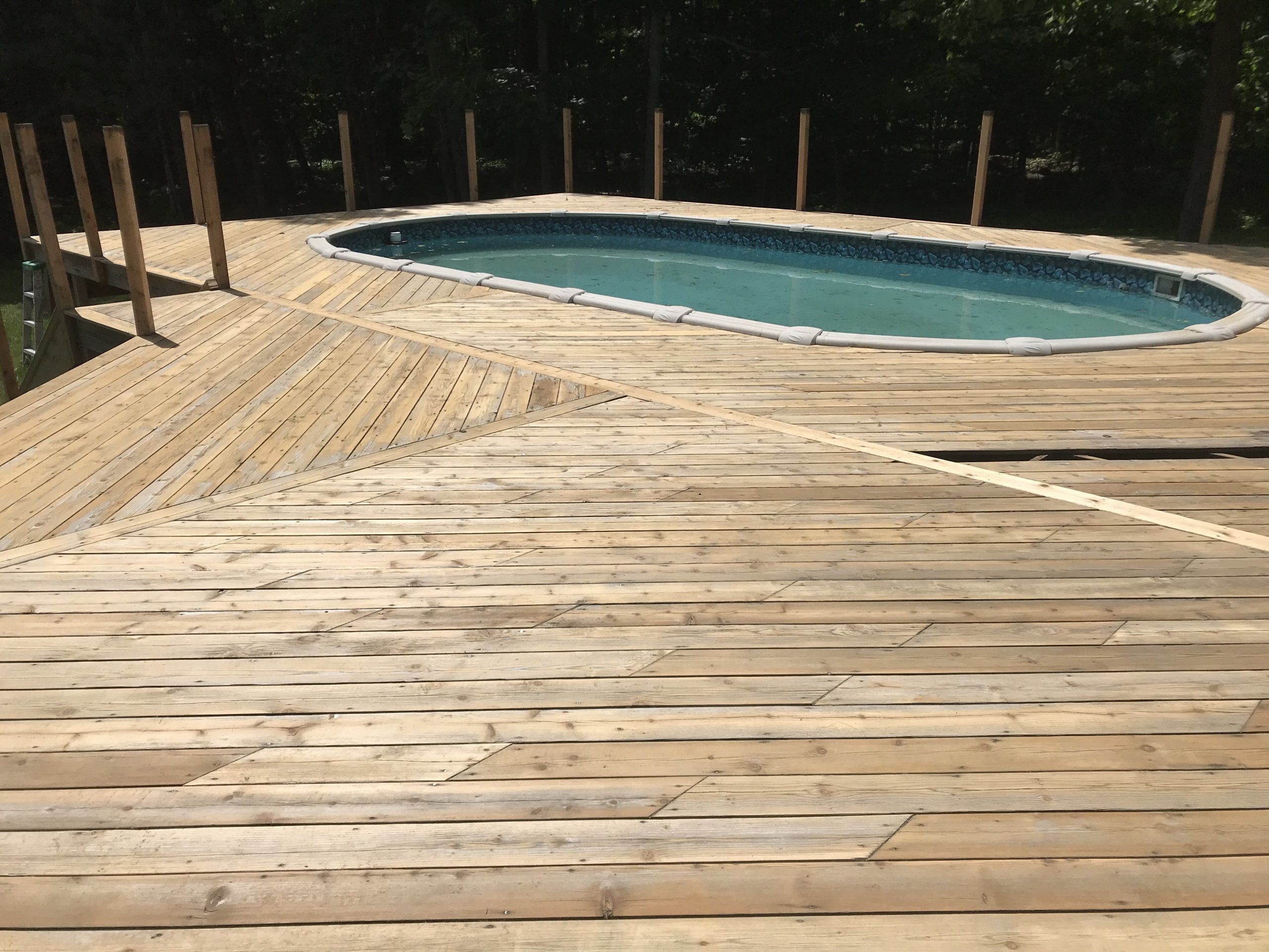

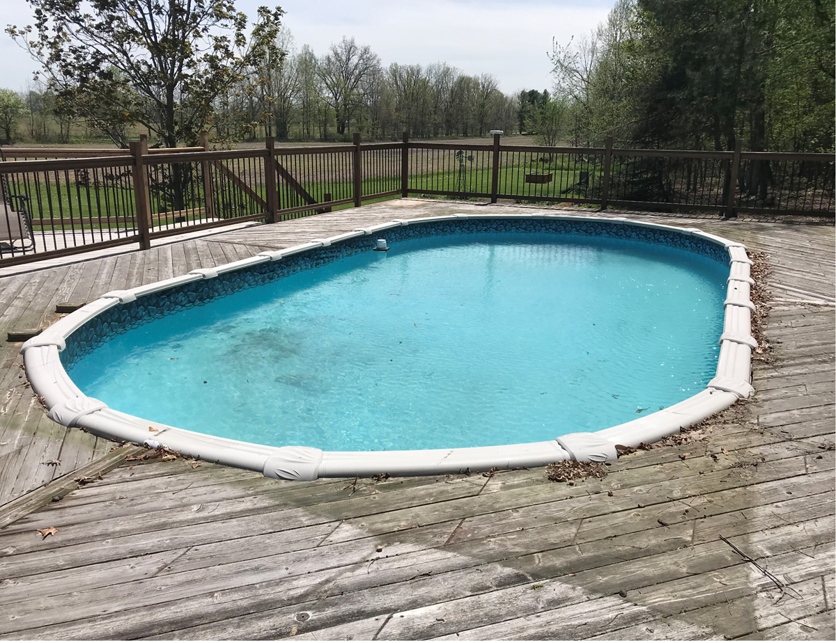

I built a cedar bench next to my pool last summer. I pre-treated all the cedar with Ready Seal before assembly. Now it needs retreating. I sanded it down in spots to correct minor height differences and remove a few sliver hazards. My plan is to clean it with Sodium Percarbonate then brighten it with Citric acid. I am just wondering if the cleaning and brightening will even things out, or will the sanded portions stand out? Thanks.

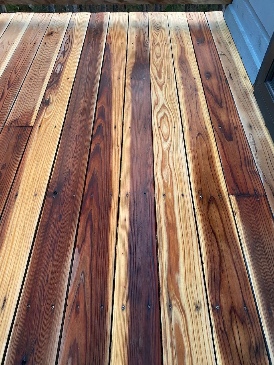

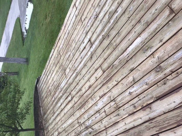

Hi, I’m hoping you can help me. I’ve just used the RAD stripper and brightener to strip the railing and spindles of the ugly Superdeck stain from a few years back. Railings/spindles are regular wood (might be cedar) but the deck floor looks a IPE hardwood. The ipe is natural color, it grayed out already and it looks nice after I’ve cleaned it. Unfortunately I’ve dropped some RAD stripper on the IPE floor and it stained it and it won’t come off. I’ve washed it right away with water but it’s still so ugly. Can you please let me know if I can fix this somehow ? Pls see picture. Thank you.
Nadia M.
Nadia M.
Sorry, picture didn’t upload before. Please see below, thank you.

My deck is approx 12 years old ipe mahogany.
I live in a wooded area which results in dirt/mold accumulating on the deck.
I am thinking of having the deck sanded being sure not to smooth it out too much and close all of the pores.
Every year or two since installation, I have methodically cleaned the deck following the cleaning/brightening routine. I have used a variety of products after the cleaning.
Those products were Australian Timber Oil and a couple of other products targeted at exotic woods.
I performed these cleanings and timber oil, etc. procedures doing each board at a time for a deck approx 24 x 12 feet.
My efforts have never been rewarded. The only time the deck looked good was when it was brand new and when it rains.
The timber oil, etc. did not produce an even color. i
Still, the ipe mahogany is extremely strong and I have not had to replace deck boards as in the past. this is good.
I would like to use an opaque latex stain to beautify this deck. However, this is not the proper course of action.
Is there any thinking “outside the box” that can help this situation. Such as, putting a layer of X over the top of the deck….like trex?
THANKS FOR YOUR CONSIDERATION AND SYMPATHY

What kind Of hand sander is the best to use on a deck?
Rick Willson
Rick Willson
Reply to  Carol
Drum sander. 8″ Home Depot. Done over 3,000 this way.
Justin Velazquez
Justin Velazquez
Reply to  Carol
I second the drum sander, and will add edger to the mix for the edges and railings. Doing a deck with a palm sander is CRAZY. Like cleaning your bathroom with an electric toothbrush!
Drum sanders and edgers have a bit of a learning curve. If you are going to do it yourself, I would recommend the YouTube channel “How to sand a deck.” It is a British guy, but he knows his stuff. One of his videos is a reaction to the top hits on YouTube about sanding a floor. His techniques are tried and true, and he demonstrates and explains the science of wood sanding very well. Best of luck!

I have sanded, washed and brightened my deck and am ready to stain (after 48 hours of dry weather). After removing the old solid stain, I found the cedar has an uneven “two-tone” natural color to it. I was planning on using a semi-transparent stain. Will that even out the coloring? I don’t really mind the two-tone, but I don’t want it to look like a mistake. Would it look weird to leave it?
Jayme
Jayme
Reply to  David
Oh my gosh, that wood grain is stunning!!!

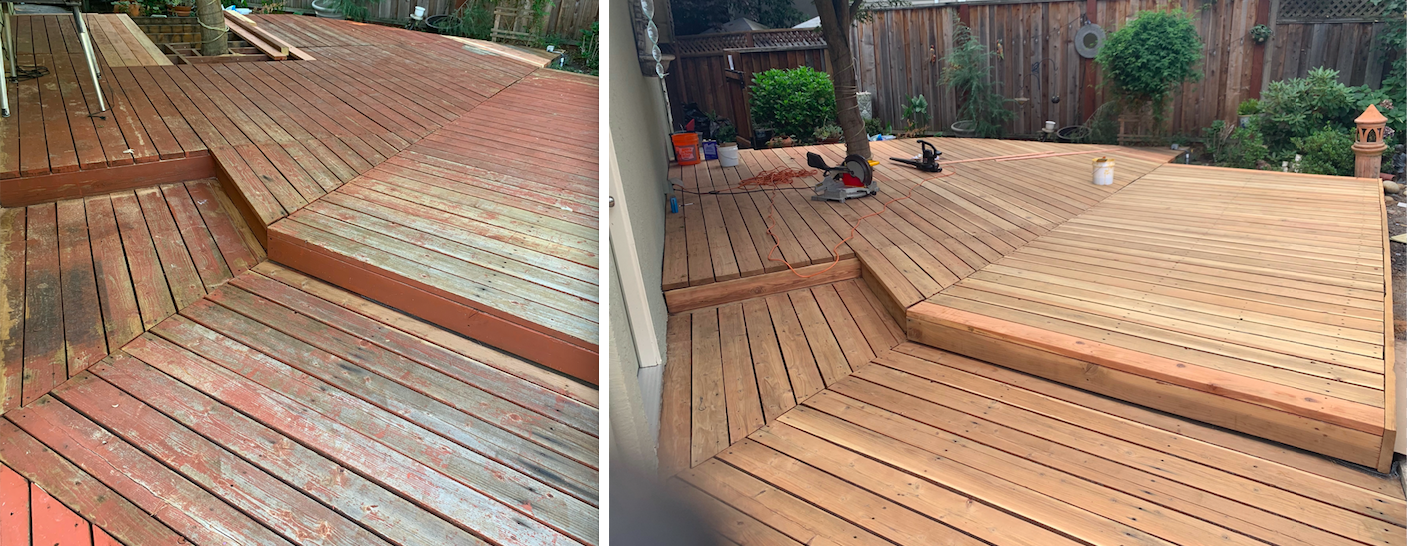

I’m sanding solid stain off my deck to prepare it for a semi-transparent, so I need to get ALL the old stain off. I hate stripping chemicals as I feel they are bad for the environment(I live in a mountain area). I’m using a palm sander, and, as it’s a slow process, I’m ok with that. It all going fine except the 6″ x 6″ support posts are pressure treated(The rest of the deck and rails are redwood) and the old solid stain has sunk down into the 1/4″ “cuts” in the treated wood. The palm sander doesn’t seem to go deep enough to get it all out without going through a huge amount of sandpaper. Is there a trick to getting that old solid stain out? I tried grinding with good removal results, but I find it takes too much of the wood away and leaves a very uneven surface. Not really the look I’m going for, but I’ll accept that if there’s no alternative. I guess I would be ok with using a small amount of chemical stripper on the pressure treated posts only if that would do the trick. I’m thinking I can probably control most of the runoff and keep it from going into the ground around my home. I’m using 60 grit sandpaper for the redwood portion. Would it be ok to go to a 40 grit on the posts, then sand again with the 60 grit? Can you tell me which of these methods would be my best option or suggest one I haven’t thought of?

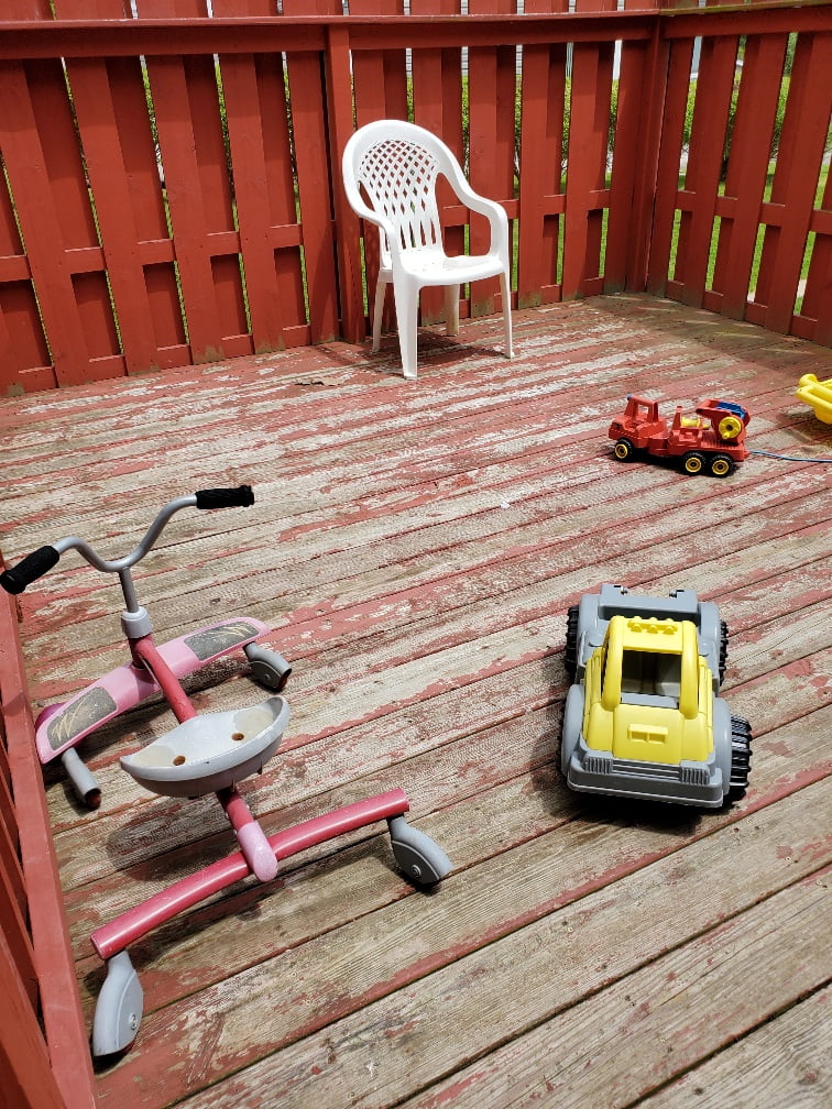

Sanded and painted 3 years ago with BEHR deck over. Peeling began so I pressure washed and scraped the old paint off. 50% of the old paint seems to be still be adequately adhered.
Should I continue to pressure wash and scrape until 100% of the wood is bare? Or can I paint over the old paint with BEHR deck over paint again?
Should I plan on doing this every three years or is there a longer lasting option? I’m also open to sanding if that’s a better option. I don’t mind putting money or effort in, but it is a 15 year old deck.

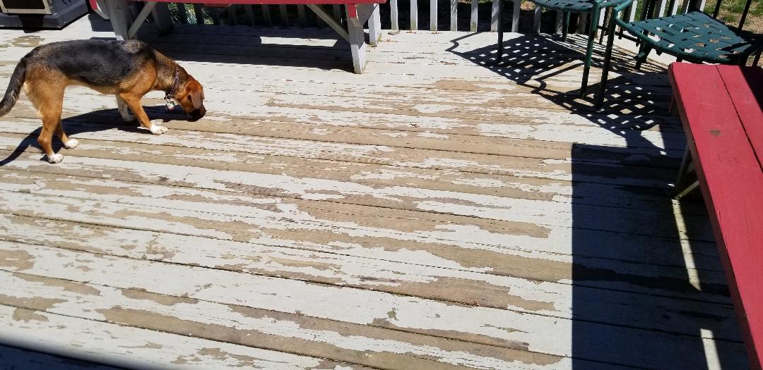

Here is a picture of the deck I was asking about it peels on floor boards and the hand rails any help would be great
Butch
Butch
Thank you do i use 60 grit 1st then 80 grit last how long do I let dry to stain

I have stripped and brightened my deck and there is still resemblance of the last semi transparent cedar stain on the deck that I’m replacing. Do I need to sand out the left over or will the new stain cover up the portions that are left over? I will be retaining with Armstrong-Clark transparent cedar tone.

gerard walker
Sorry, but 60 grit ain’t gonna do it. It barely removes any of the previous finish. 24 grit on a 4 inch belt sander. If using a 12×18 sander 20 grit. Then apply a deck brightener and it will help open the pores.

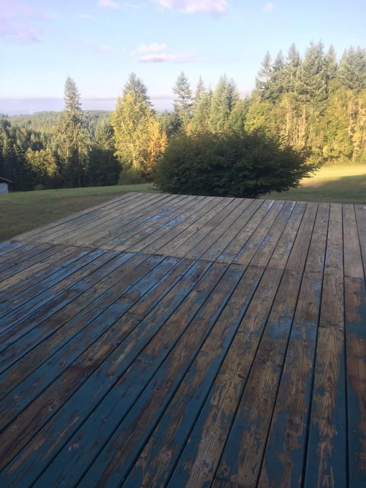

Need to strip the deck paint off my deck so I can refinish with an oil based stain. Deck surface has never been stained so the wood flooring should accept a stain after prepared. Which method is best… sanding or stripping? What is recommended for this paint (not stain) in a stripping situation?

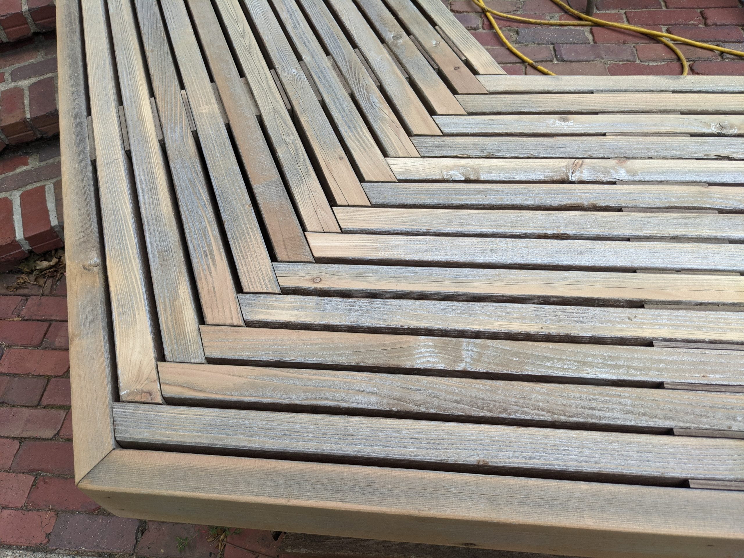

It’s me again😄 I stripped and brightened my cedar deck. It is drying now. Some places on some of the boards are fuzzy. Can I just spot sand with some 60 sand paper or must I sand the whole thing? If I can spot sand, would I need to brighten again?
