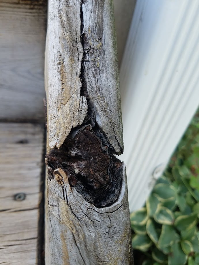

For severe damage like a rotted knot, Ranger Patch by Gulf Synthetics is the one product I’ll recommend. It’s an epoxy-based repair compound that bonds well to wood and holds up better than standard fillers outdoors. That said, even Ranger Patch must be top-coated with a solid color stain or paint to hide the repair — it will not blend with semi-transparent or clear finishes. In most cases involving rot, replacing the board is still the better long-term solution.

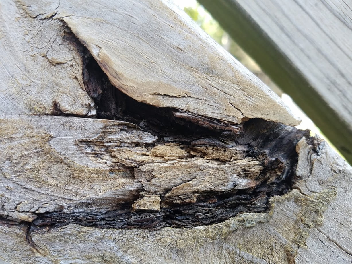

In rare cases where board replacement is not possible, a two-part epoxy can stabilize rotted spots or corner breaks. The catch is that it must be top-coated with a solid color deck stain or paint to hide the repair. Never expect epoxy to blend with a clear or semi-transparent finish. Ranger Patch by Gulf Synthetics is the epoxy-based product I use in those situations.

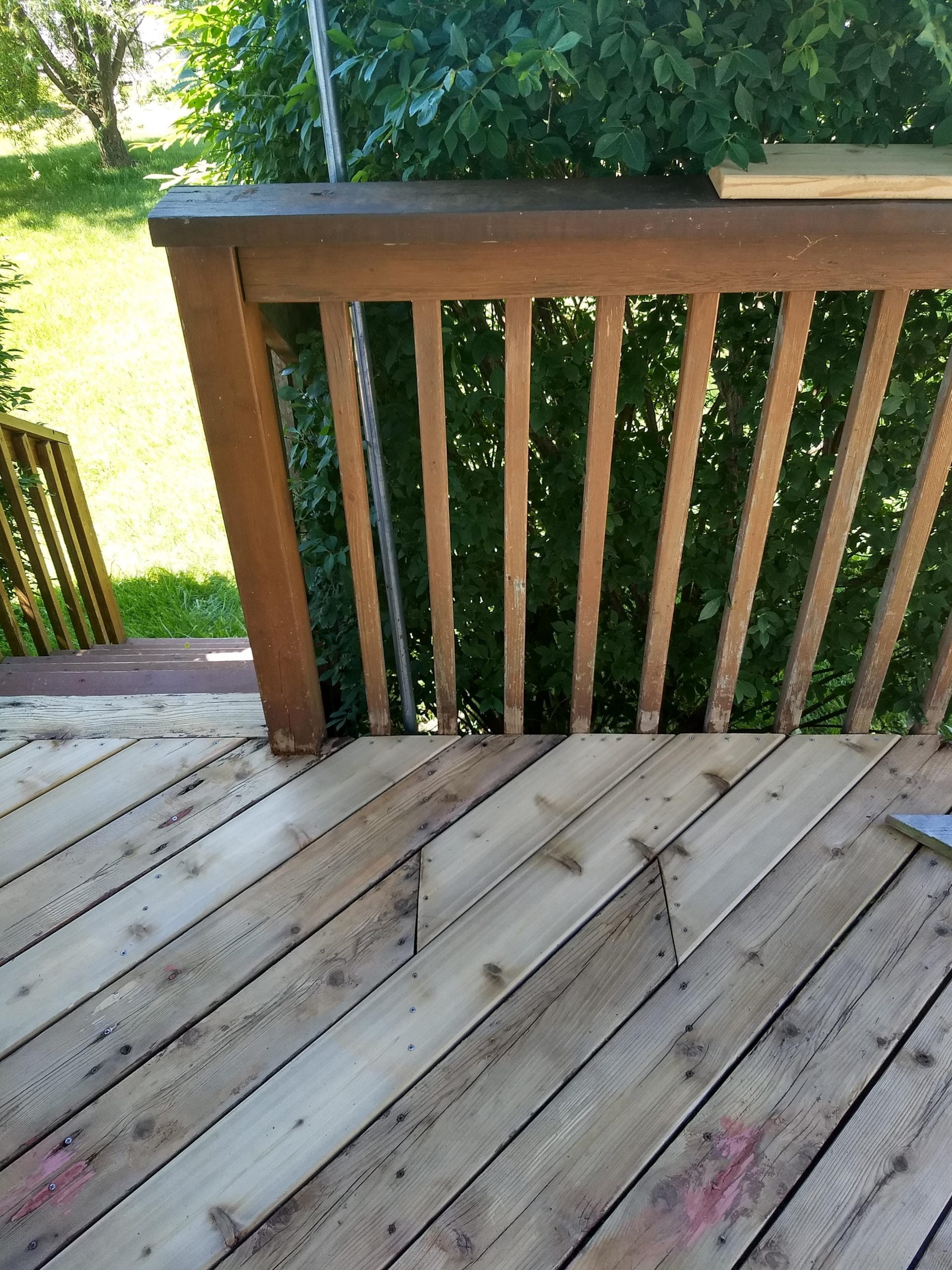

Can we cover up screw dents with wood putty on our newly installed patio? And stain it after! Contractor went overboard with the screws…
No, it does not work as explained in the article. It is normal to have screw holes on a deck.

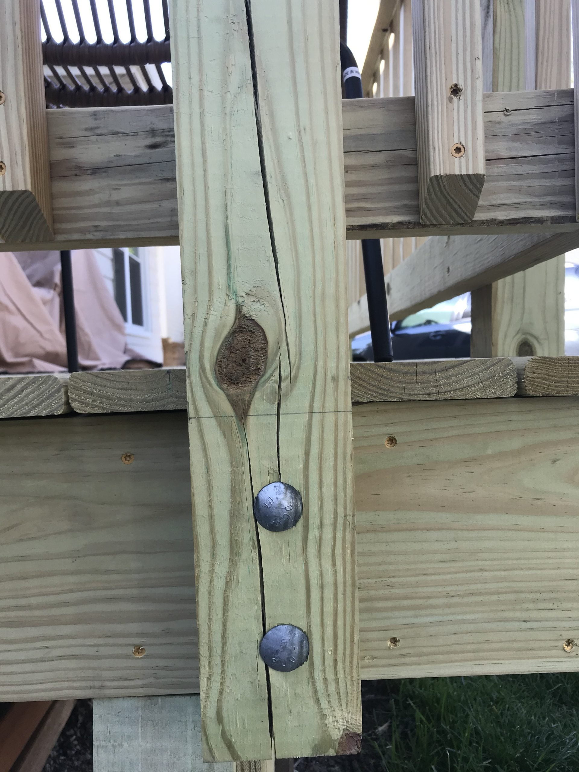

My pressure treated deck handrail posts have vertical cracks. I am concerned about rain getting in and rotting from the inside. Shouldn’t I fill the cracks or maybe try to get somekind of sealer inside?
No, leave as is. It is normal and not an issue to have cracks with exterior wood decking.

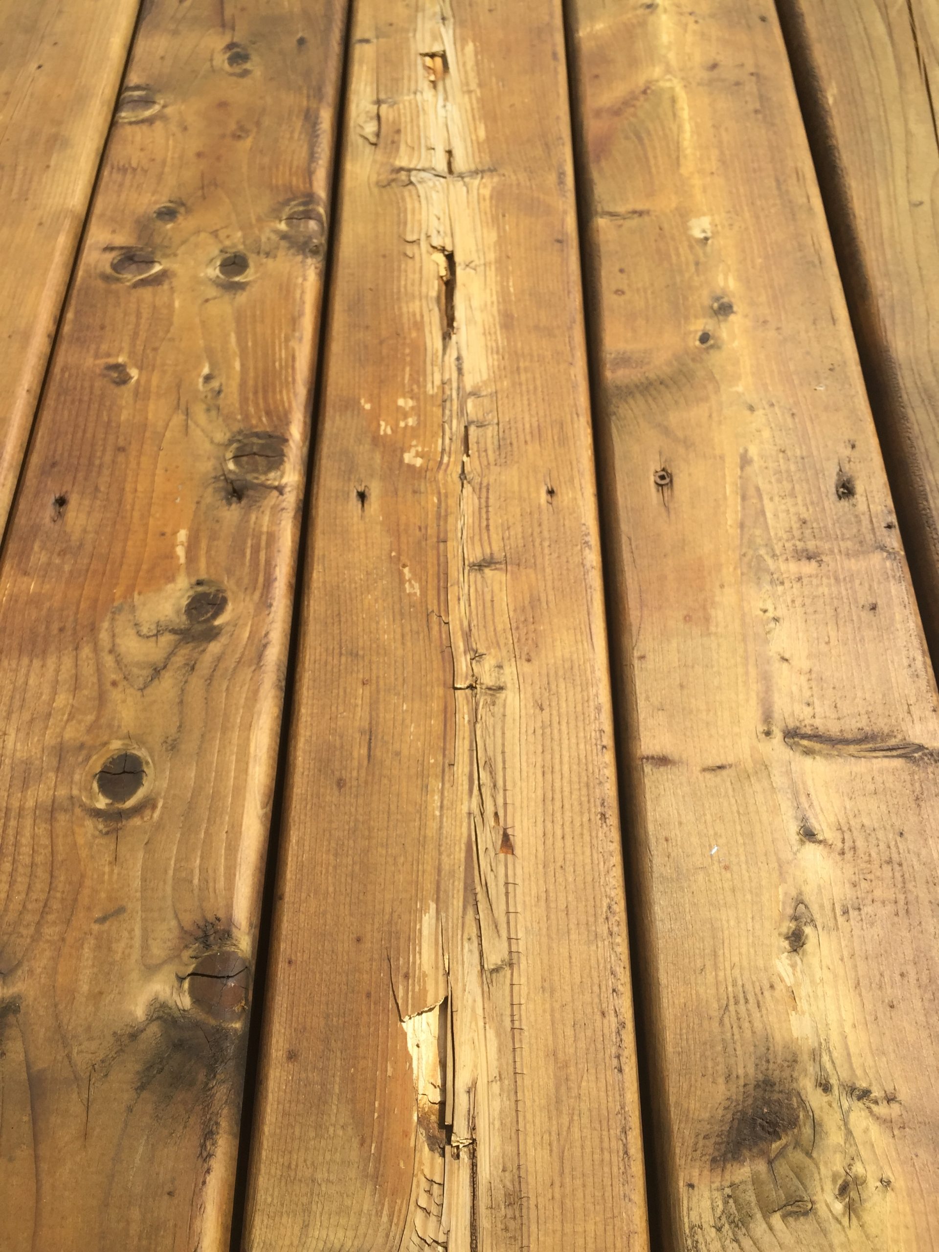

Have large chips at eyes. Big enough if you catch right barefooted can cut you. What can I use to fill? Or should deck company replace any boards like this?
Replace the boards.

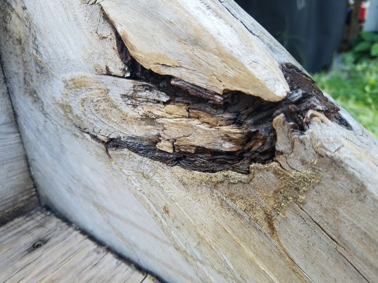

Attached is a picture from my previous question
I am replacing old wood on my deck. The joists have some splits about 1/2″ deep and small old holes that are soft/turning black. Before replacing planks – I am thinking of spraying some boric acid to prevent any rot; and filling cracks and old holes with a loctite PL MAX construction adhesive to keep water from pooling in the voids. The loctite product appears to be very strong and used in marine applications. Any thoughts?
Not sure how it will work it will not “stain” to blend, if that matters. The boric acid will not stop the rotting where it has already occurred, so replace those joists or posts as needed.

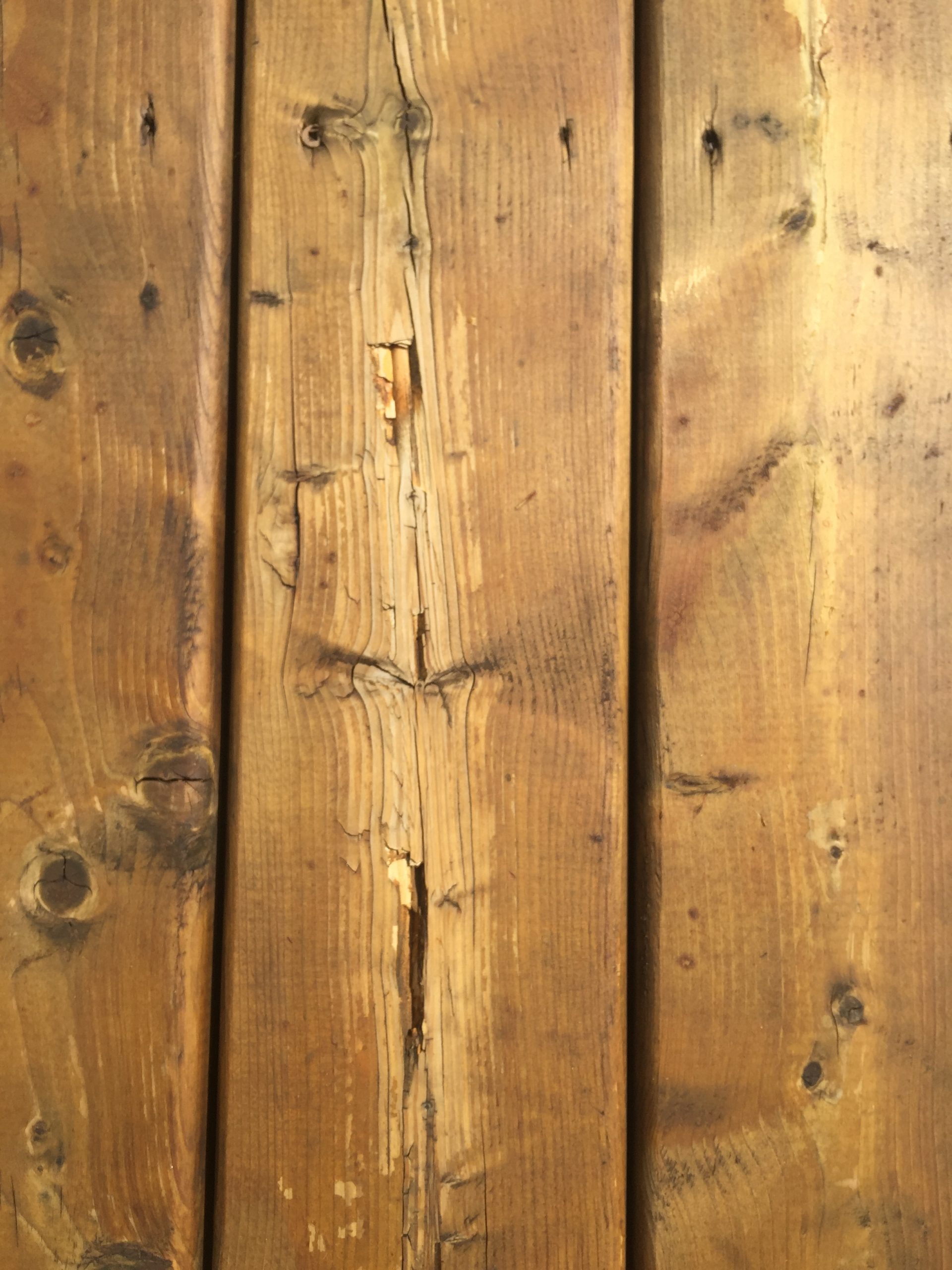

Attached are four. More to come
You should replace all our bad wood and rotting boards now as they cannot be fixed. Let the new wood weather until Fall after install. Prep and restain all with a solid color stain.

Even when it looks like this?
Yes, that is normal.

I have a deck project were there are some severe cracks on the main support posts. They are long and deep. Since fillers and caulk are not recommended, what can I do to prevent these cracks from getting any larger over time after I redo the deck…?? As of now, the deck will be re-stained with a dark brown colored stain. Also, I have read that you should not use colored stain on the floor of a deck but instead you should use a semi transparent. Is this correct…?? The homeowner wants the deck all the same. What is the best way to stain the floor so it lasts for several years….??
You cannot prevent cracks from getting any worse. If they are bad, then replace those boards. If you want a semi-transparent dark brown then look at TWP in Dark Oak or Armstrong Clark in Rustic Brown. Penetrating stains like those will not be prone to peeling like a solid stain. Just clean and recoat every 2-3 years,
Unfortunately the cracking is on the main posts and not the floor boards. The deck has a lattice roof and would be virtually impossible to replace without excessive cost involved.

What do you recommend for a knot that has started to rot? I see you don’t recommend fillers but worried to just stain this area like the rest of the deck.
Any help would be greatly appreciated!
See Permafill by Gulf Synthetics. It is not stainable with a semi-transparent stain but it will work to fill your issues with your stair stringer.

The top rail in this photo has been curing for 8 months and we are now ready to stain deck- photos show what happened to board over winter. If filler is not suggested, do you have any suggestions as to what should be done? Thanks for your time and great website!
Just leave alone or if really bad, replace the board.
Thanks 4 your response, hoping pics went thru. If we replace board do we wait several months to stain or stain now with the rest of the deck? Thanks again!
You could stain the new board now and then apply another coat to the new boards in the Fall.
No pics.
