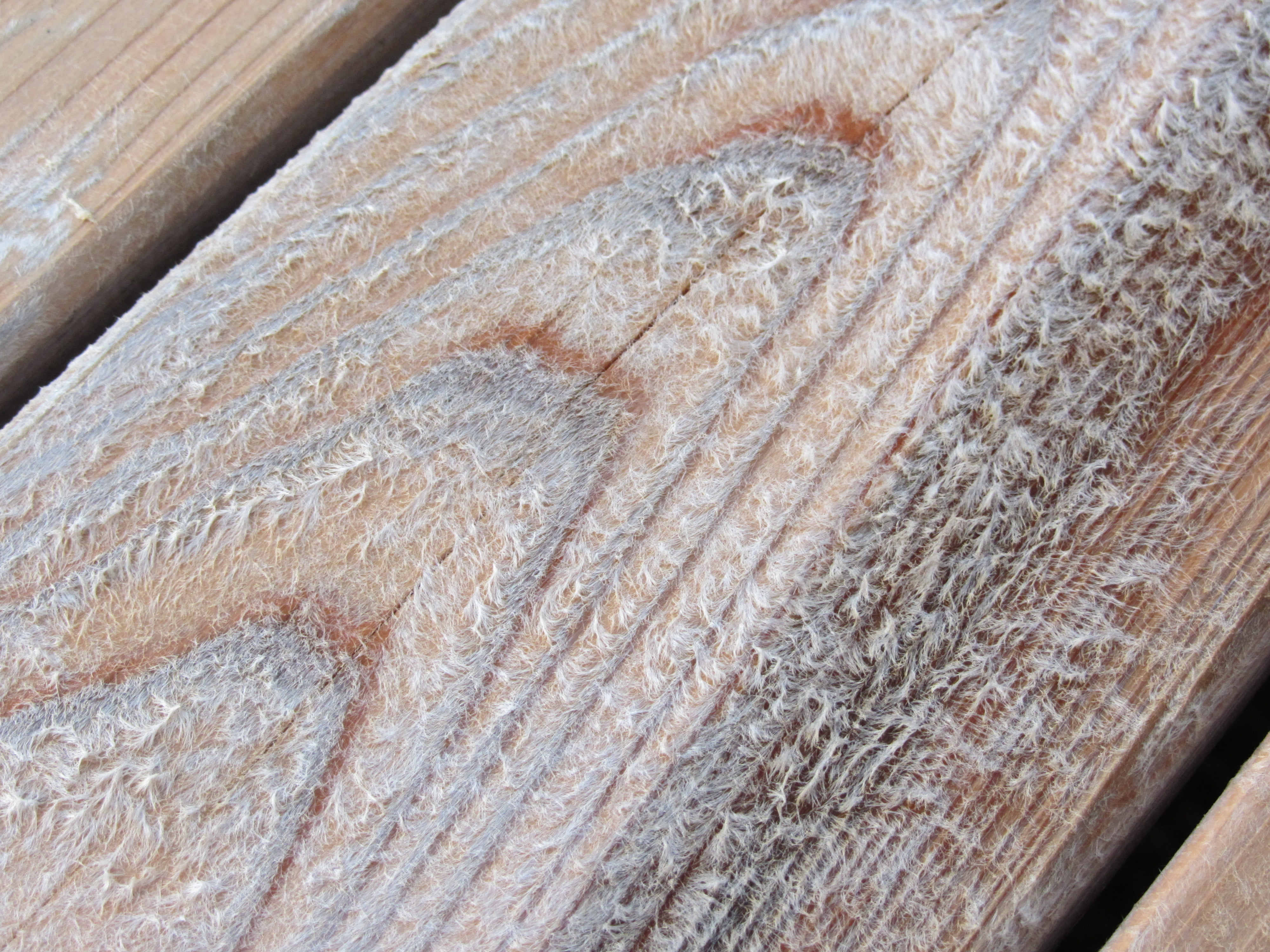

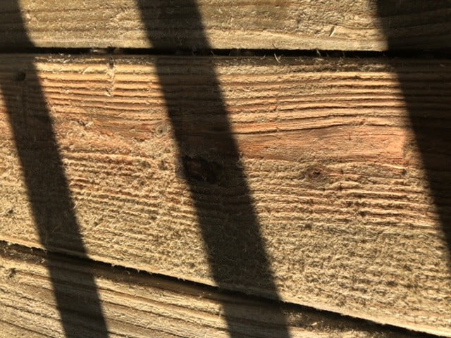

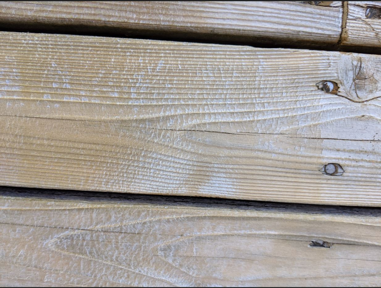

How to Remove Wood Fuzzies
If wood fuzzies appear after prepping, follow these steps to smooth out the surface before staining:
1. Rinse Thoroughly After Cleaning
  • Use a garden hose or pressure washer to rinse away any loose wood fibers.
  • Ensure the wood is completely free of excess pulp before letting it dry.
2. Lightly Sand or Buff the Surface
  • Once the deck is dry, gently sand or buff the wood to remove the fuzzy texture.

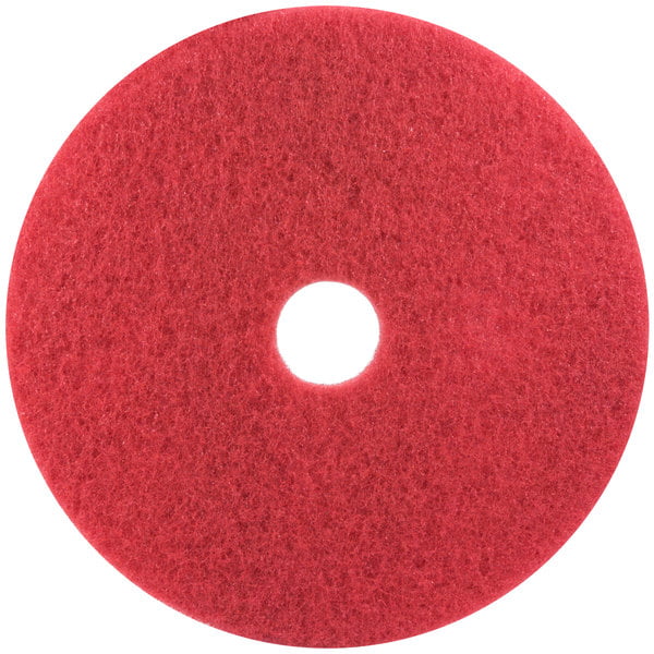

  • Use sanding buffing pads with a floor buffer instead of traditional sandpaper to prevent over-sanding.

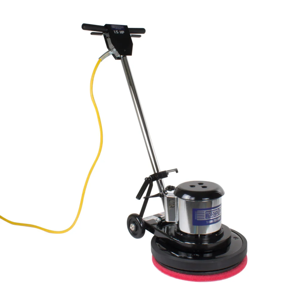

3. Use a Floor Buffer for Large Decks
  • Contractors often use a floor buffing machine (available for rent) with a sanding pad for quick and efficient removal of wood fuzzies.
  • A 500 sq. ft. deck can be buffed in about 10 minutes using this method.
4. Hand Buff Railings and Tight Areas
  • For railings and small spaces, use a handheld buffer or a handheld sander with a smaller pad.
💡 TIP: Never sand finer than 60 to 80 grit! See How to Properly Sand a Deck

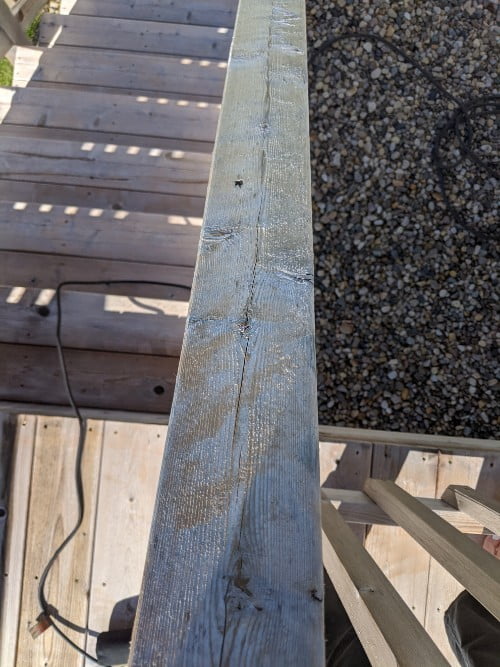

g girl
g girl

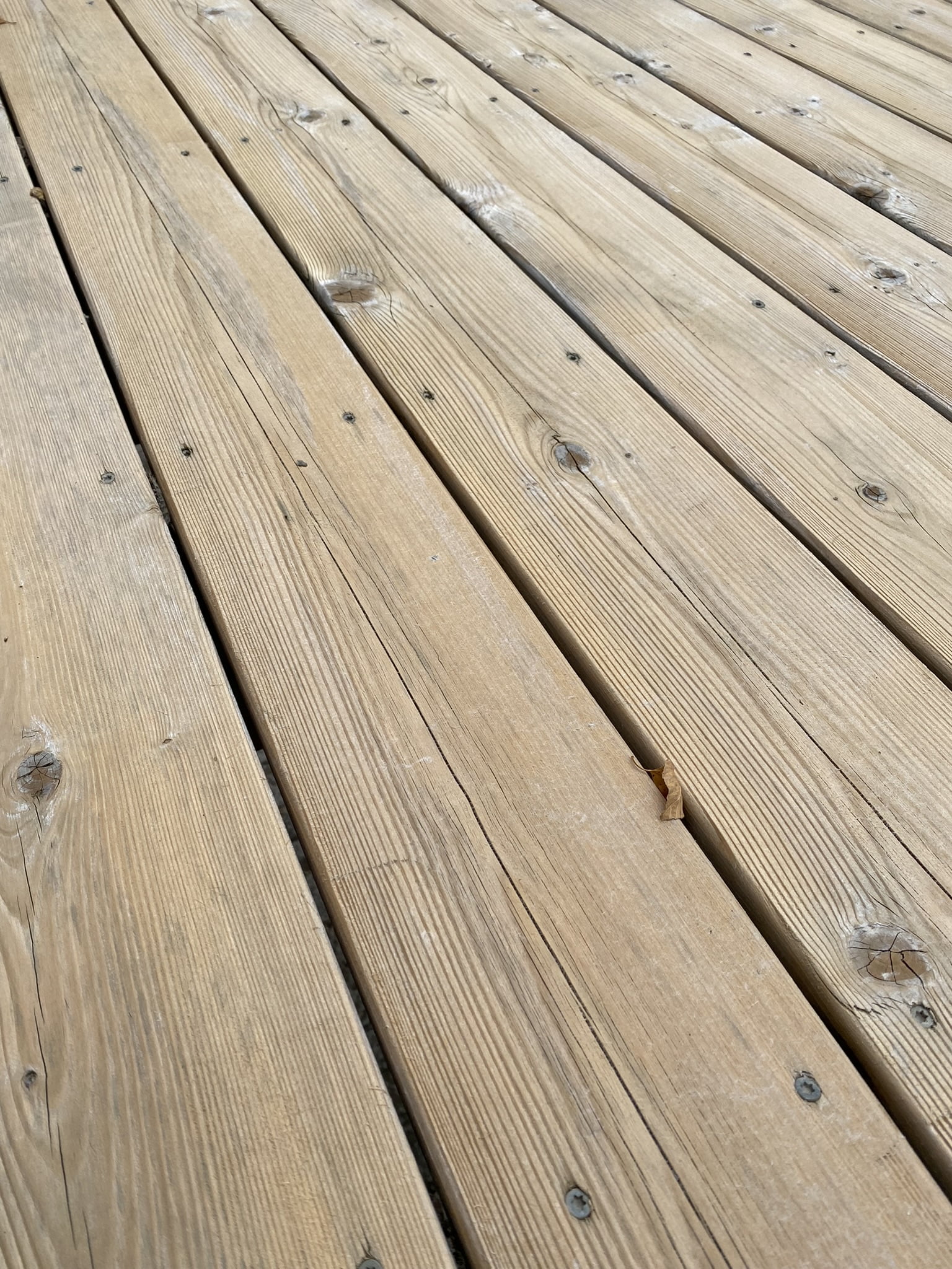

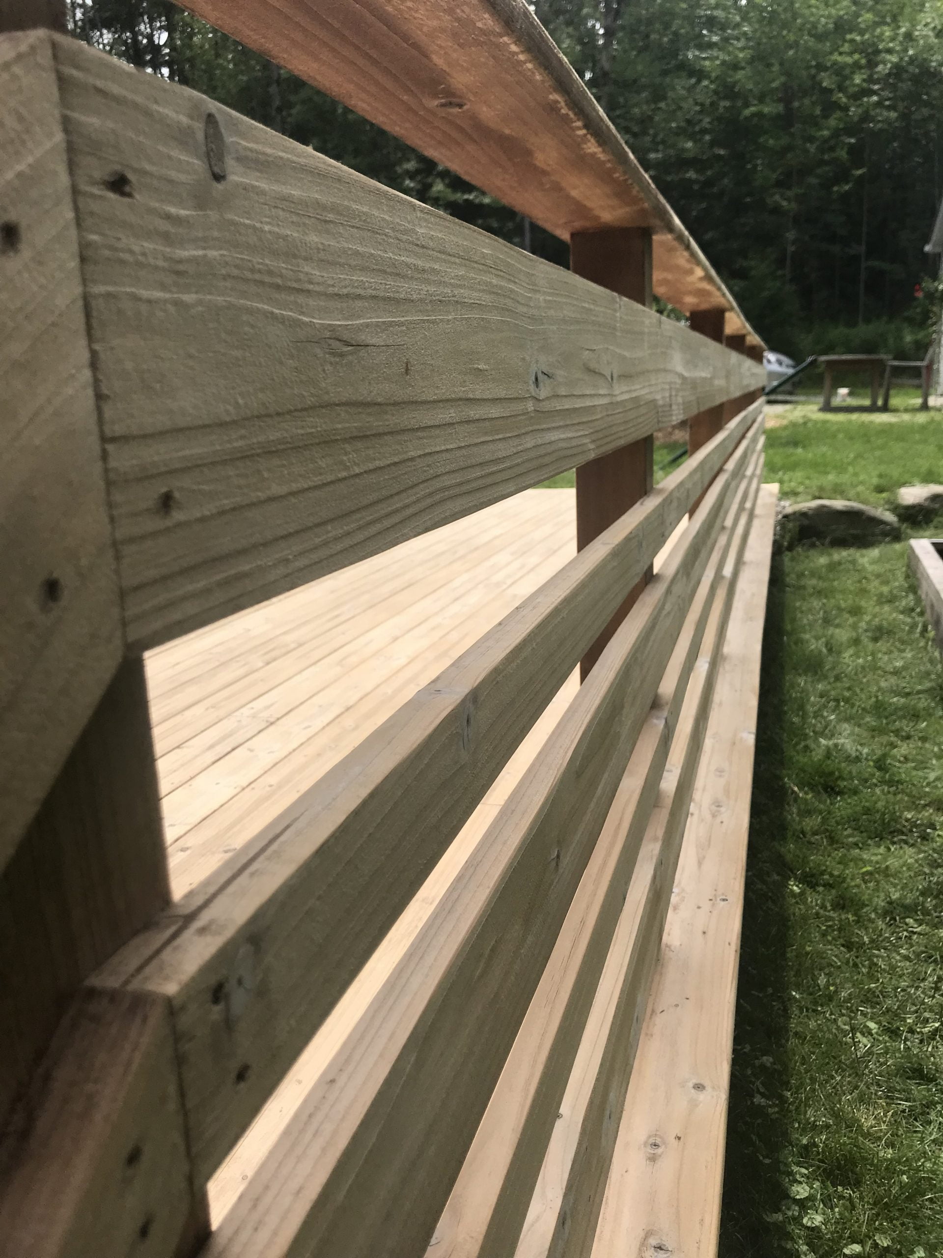

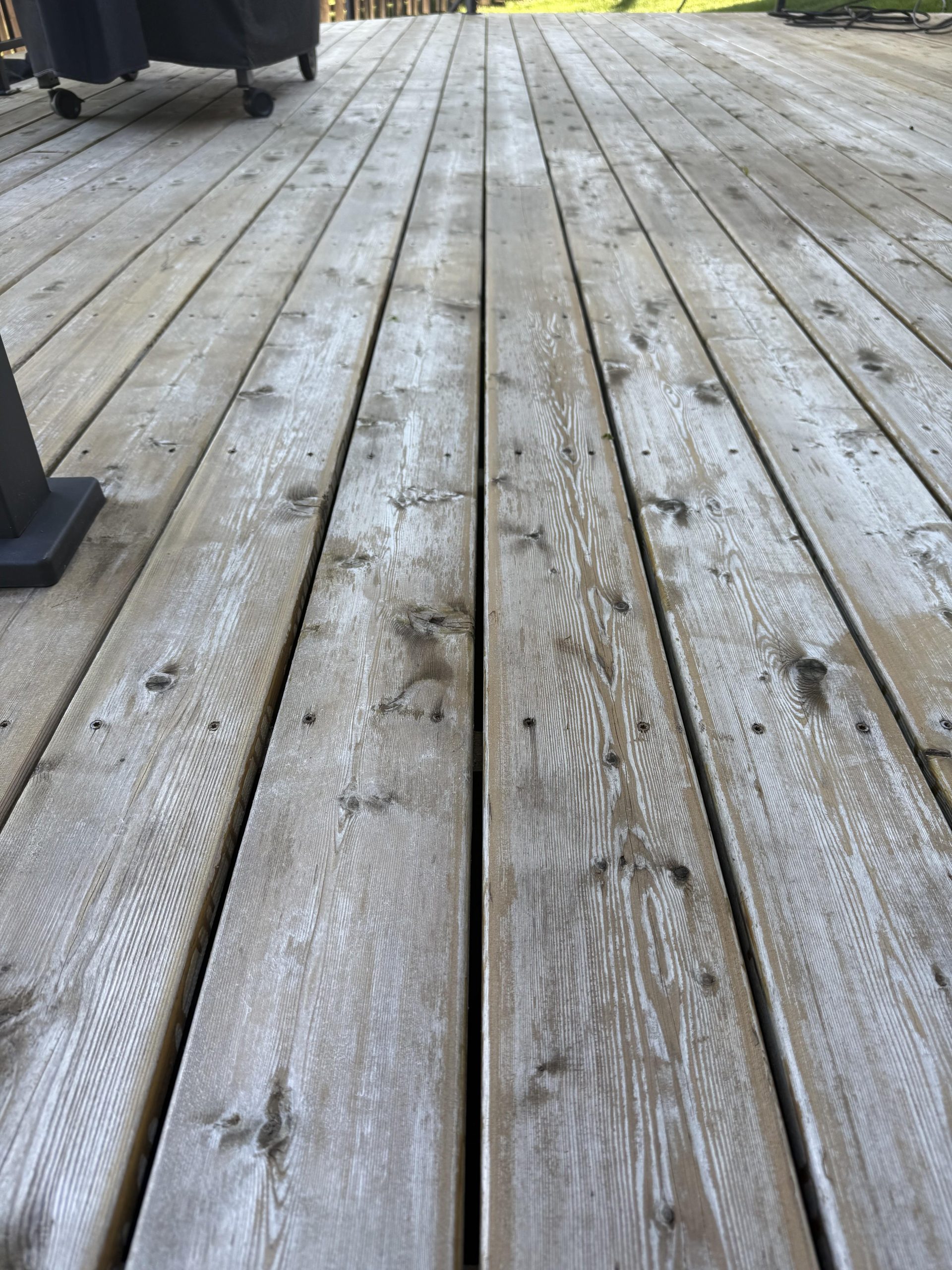

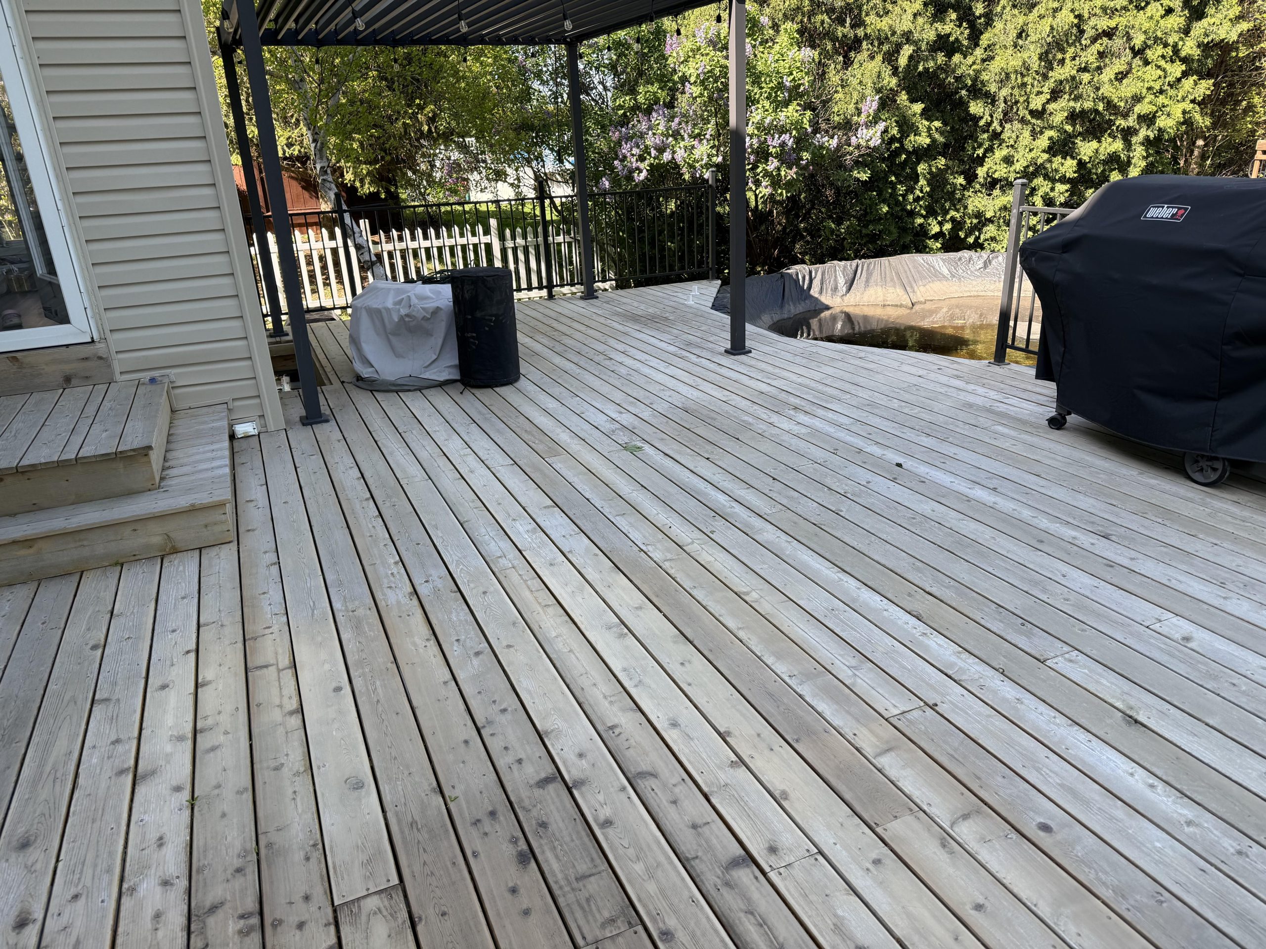

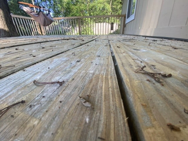

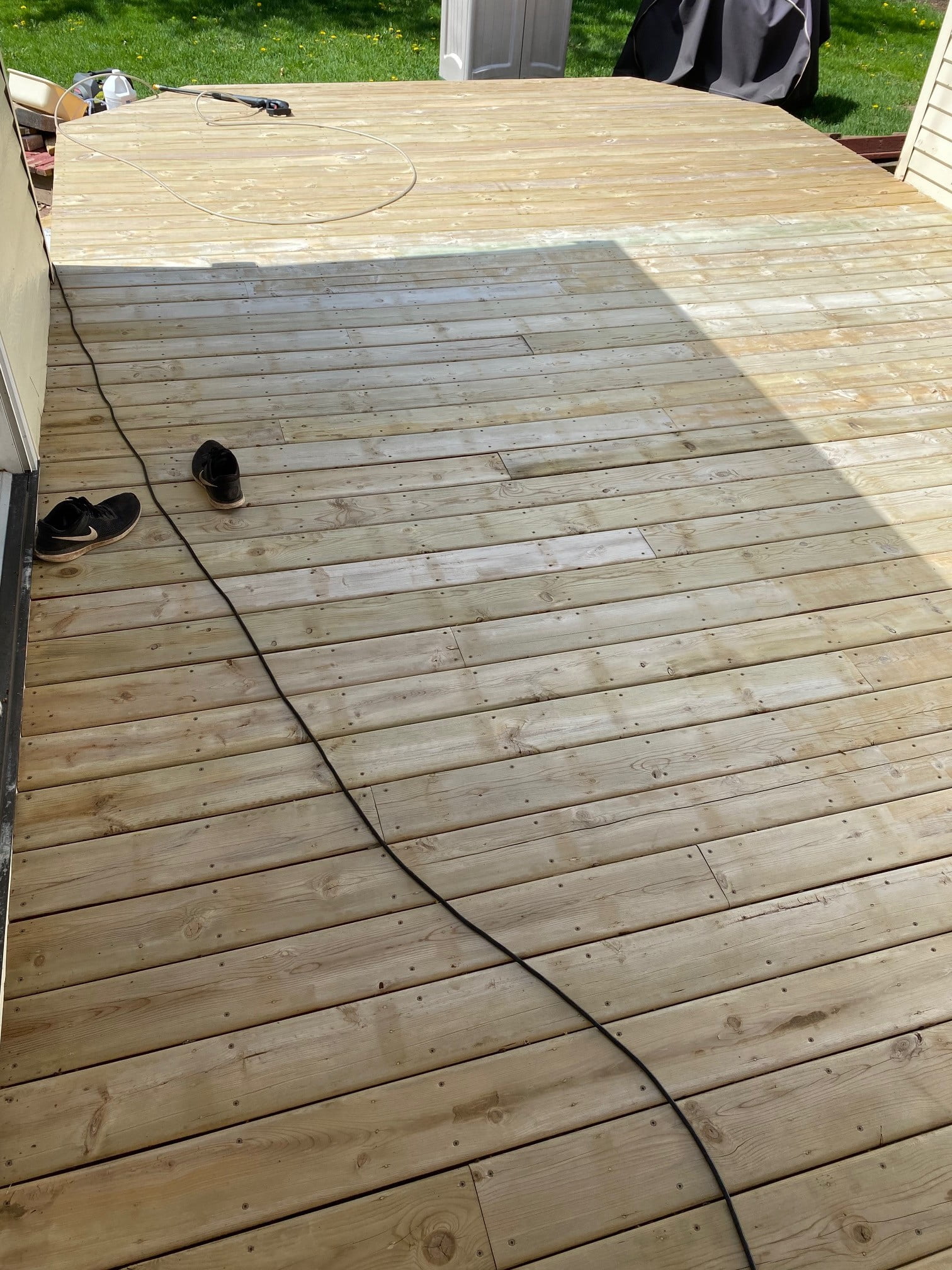

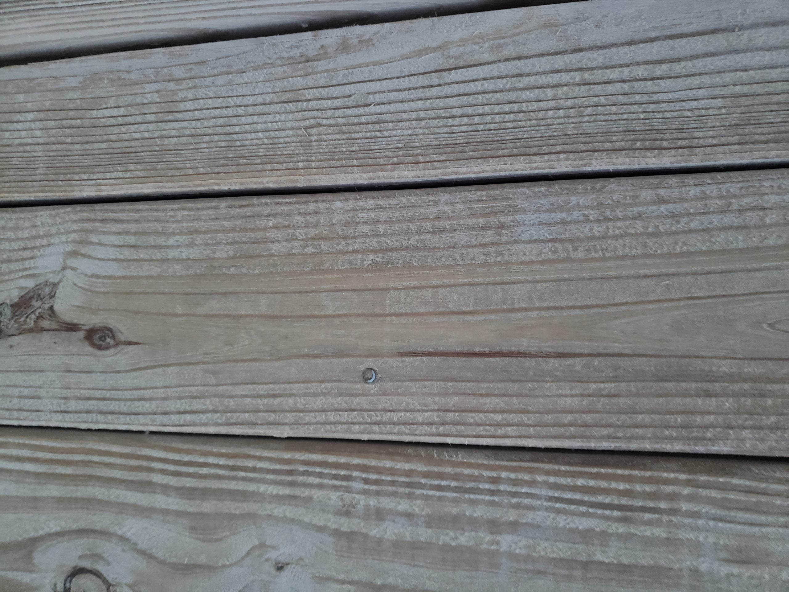

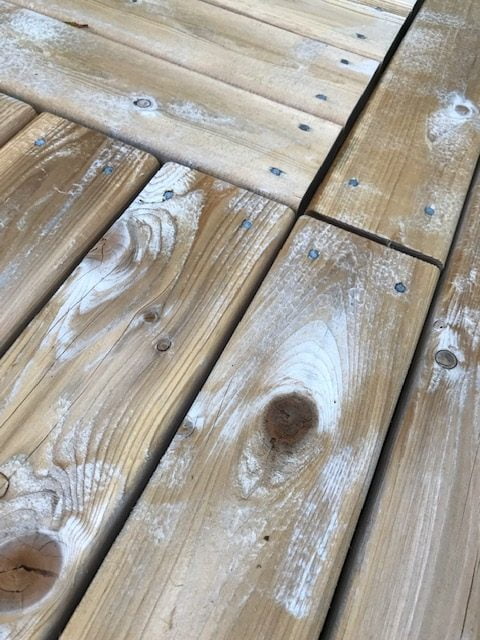

HI! I have been reading this website when my huge deck project started in 2018. First, pressure washers, in my experience, should be banned. They ruin wood, cause leaks in windows, split cedar, spelled, expensive, etc. I began with my Insurance underwriter and mortgage company writing me up for “unsafe deck due to no stair rails and some rotted boards. I did not know where to start. My deck was old redwood, 1200 square feet, electric, benches, speakers built by a talented carpenter in the 1980s before the now, 9 pages of deck code, chapter 507 of the IRC. I got estimates of up to 50,000 for a rebuild. Yikes. I studied your website, the code, Professional Deck Magazine, YouTube videos, the, bought tools. Cutting to the chase, after lots of rain, cold, heat, and Covid, I am at the end of rebuilding my deck to current codes. Did, I say, since the original deck had been built, 3 trees dumped leaves, algae, mold, and were never cleaned. I have, so far, spent over 15,000. on materials, including twp stain, brightener, cedar, pressure treated framing, hardware now required, copper naphenate, now required, and am, after 400 hours, almost finished. I hired a few helpers for a week to push the project along and had to redo their work. If you want your deck done correctly, study and stand over any carpenter that you hire or your inspection may fail. Wood, especially cedar, and forget getting redwood in the northeast, has become irreplaceable. Mills are shut down and those still in business are working at 50 to 25% capacity plus the fires on the west coast. I wrote this so that homeowners will take care of their decks. My neglect could have caused me to lose my house. Decks are high maintenance but make a house so much more enjoyable. I bought my house partly because of my deck and then took it for granted. Follow the great advice on this website. An once of prevention is worth a pound of cure!😎
3 months ago

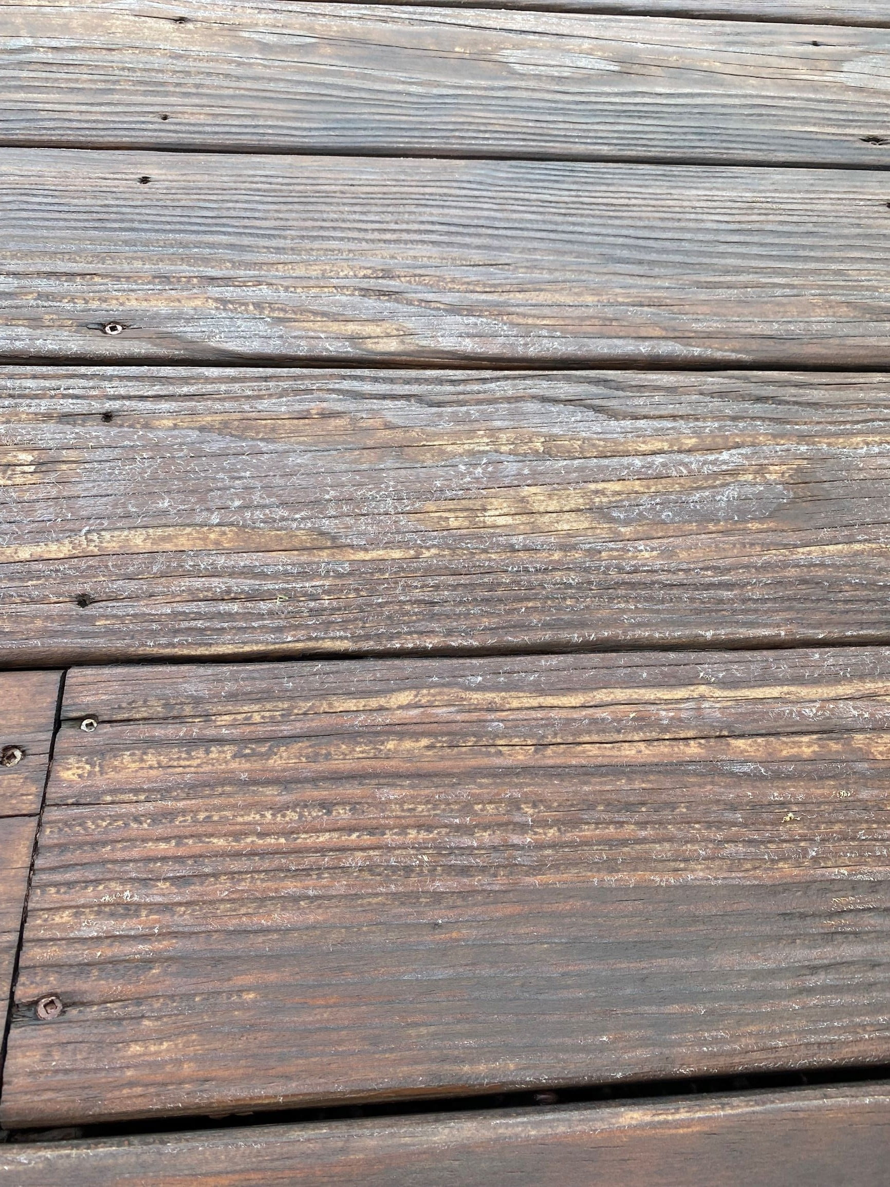

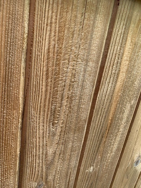

Here is another photo. There in mind I am taking these photos at night and I magnifying it a bit so it’s not severe like you showing your fuzzy wood photos online so maybe it’s not that significant but I know you said after cleaning a brightening not to resend so I don’t know if I should sand these loose fibers or not prior to stain application since I did already put down the brightener and cleaner

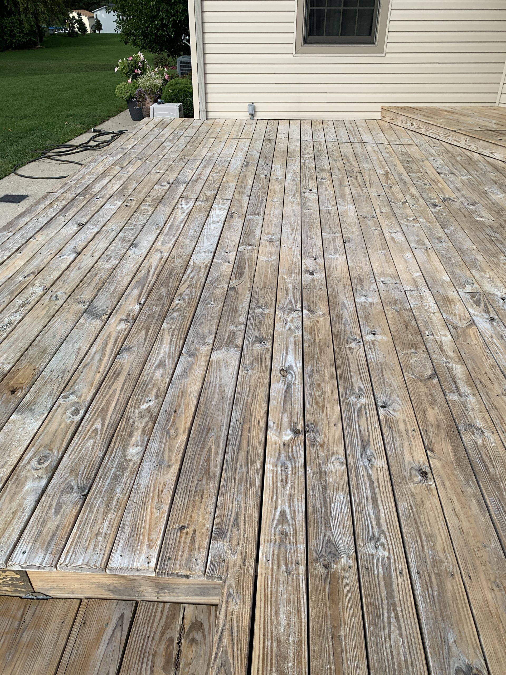

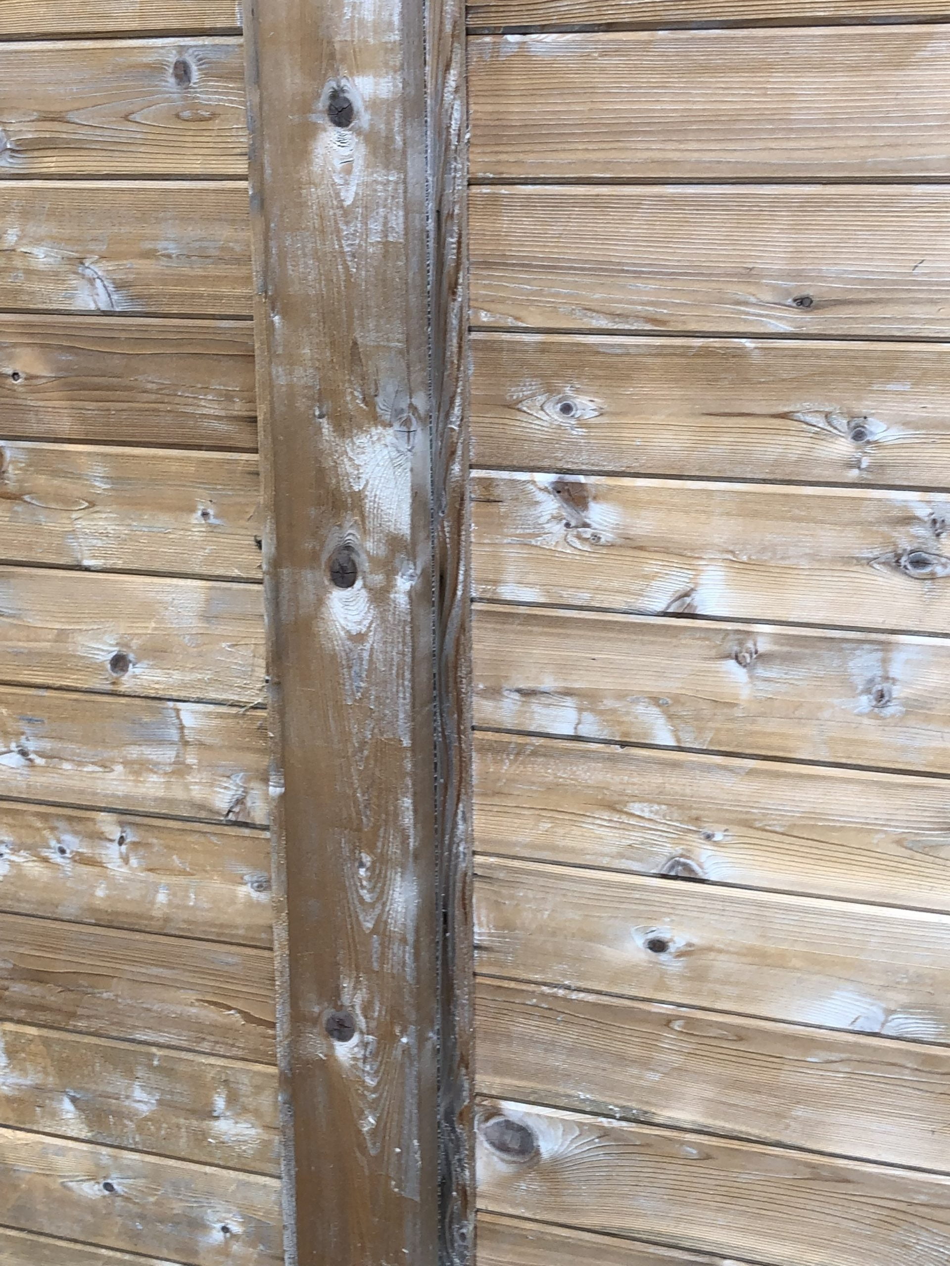

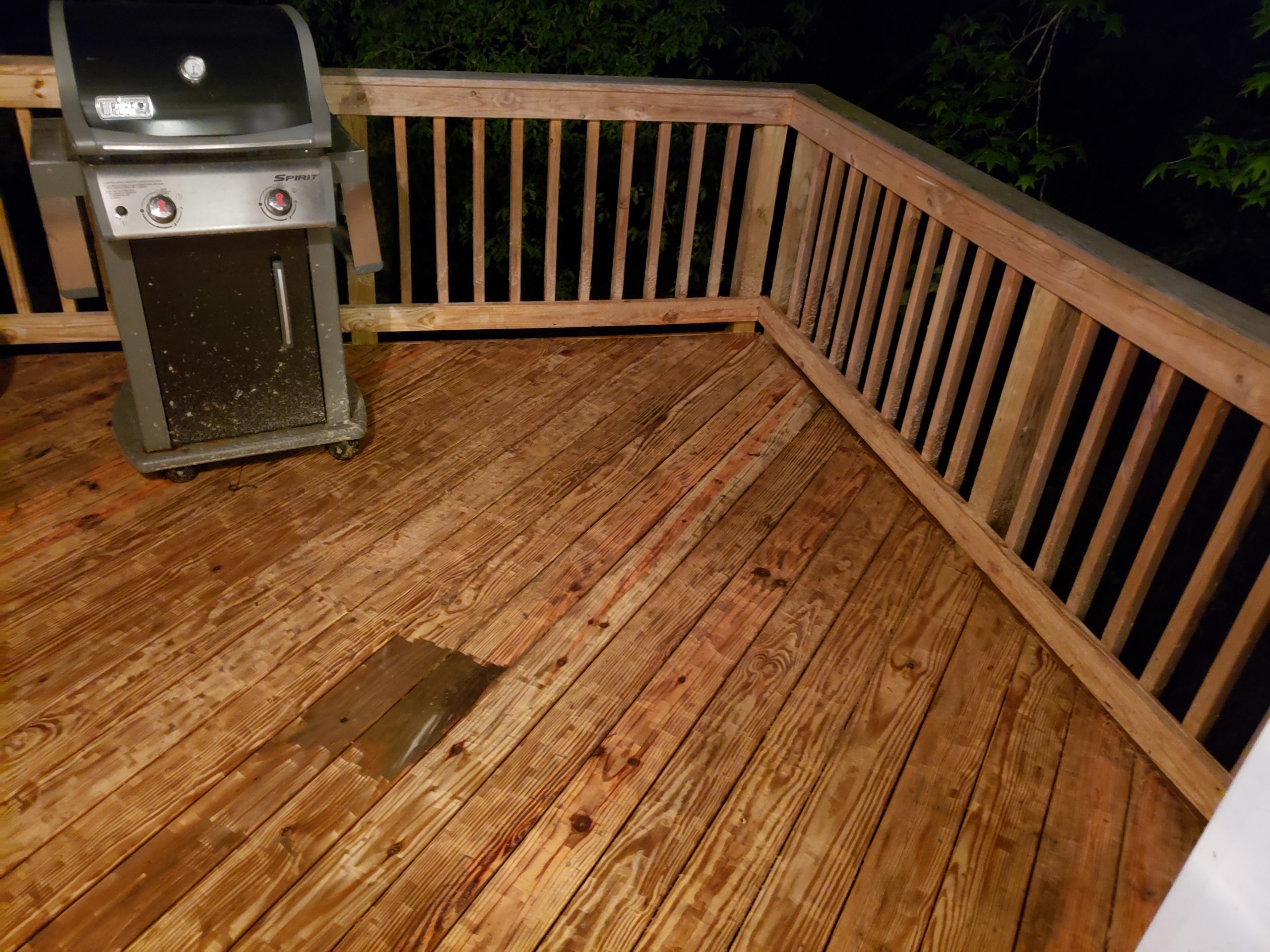

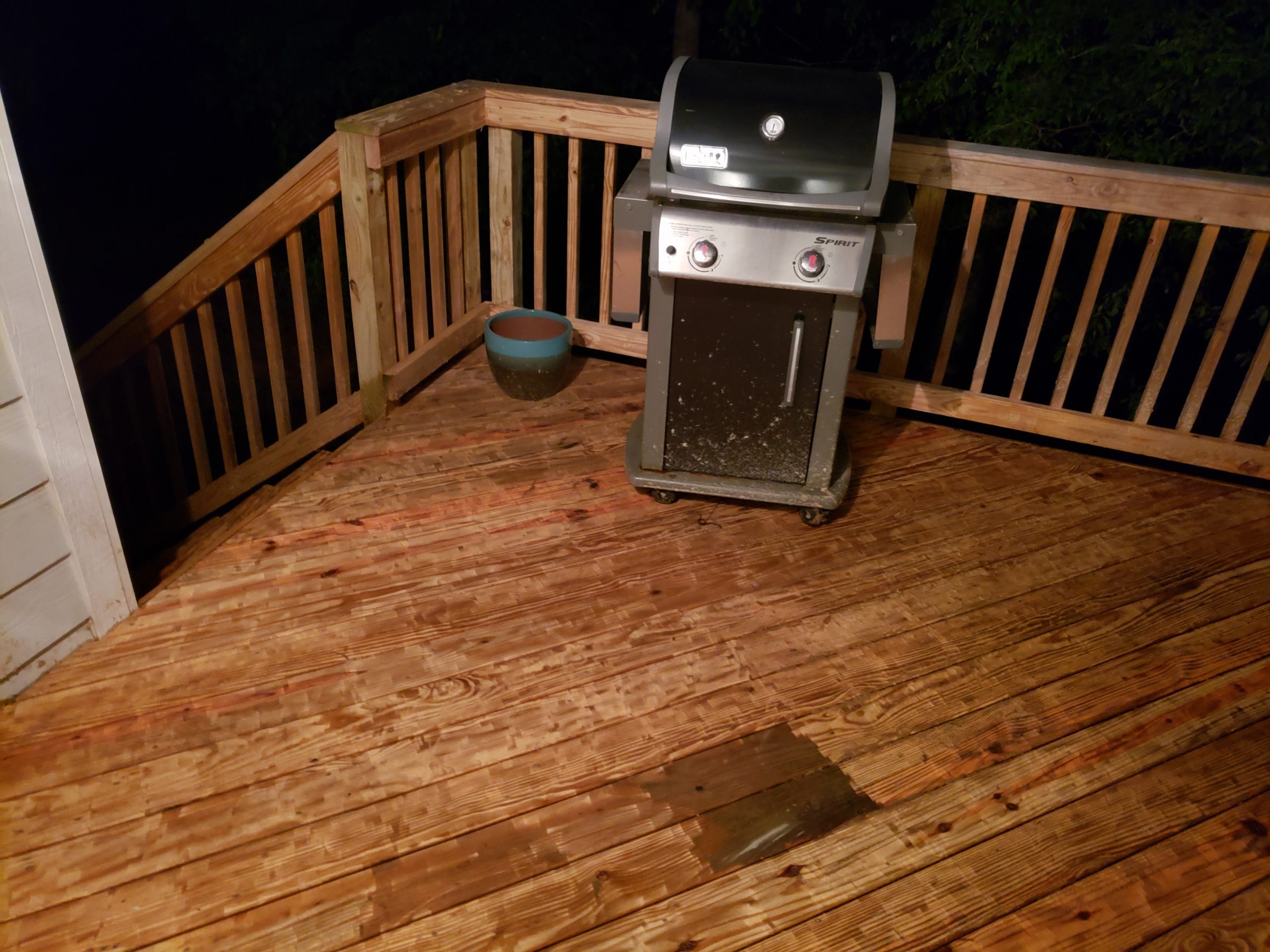

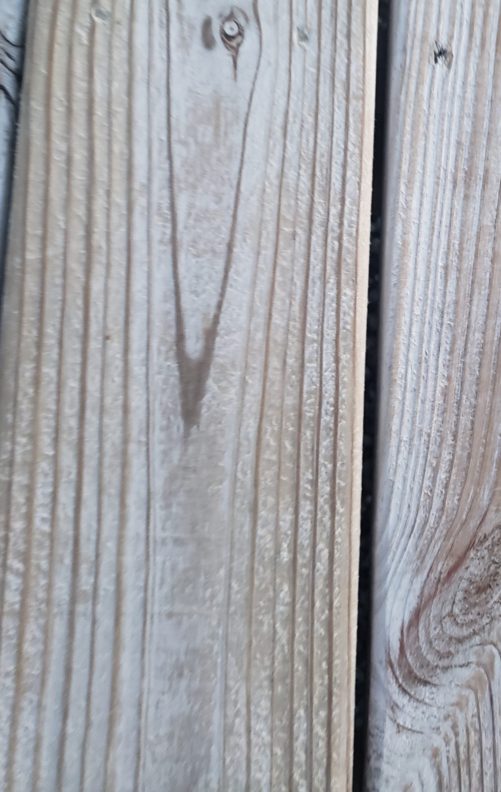

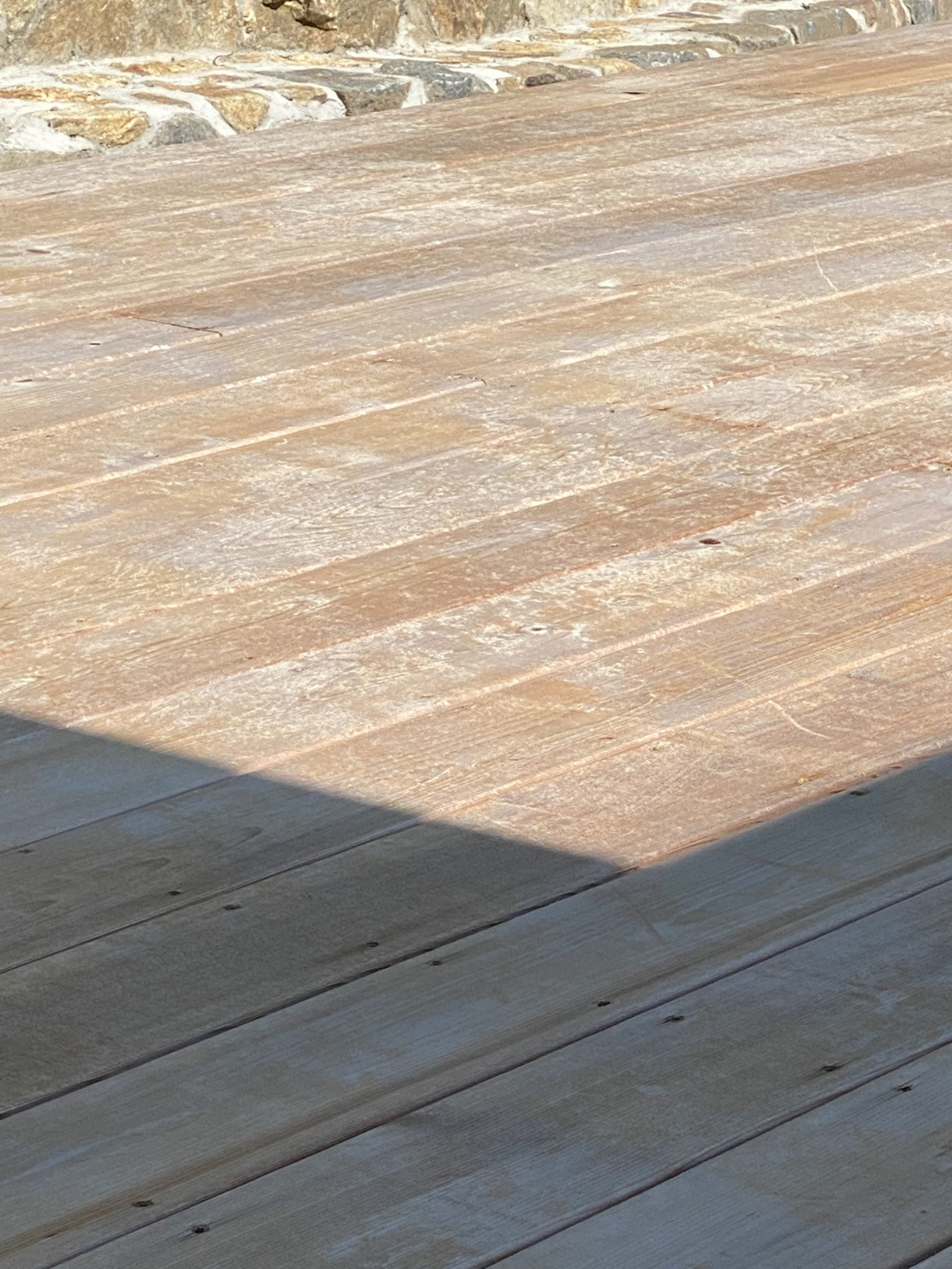

I wrote earlier about this but have another question. We are nearly finished with cleaning, still need to use brightener but the weather has held us up with high winds, we’re behind schedule and winter coming quickly. You said we could wait until spring but if the wood is raw, are there any options to.protect it until spring?
We are in NE Texas and our winters here are not usually too bad. Maybe one or two snows… some freezes. Its our boat house, over the water. Anything else we might need to do? Will pray for a few mild days, giving us another chance to finish. “C’mon Texas warm spell….”… Thx as always. Never had another website as helpful as yours. Unbelievable!

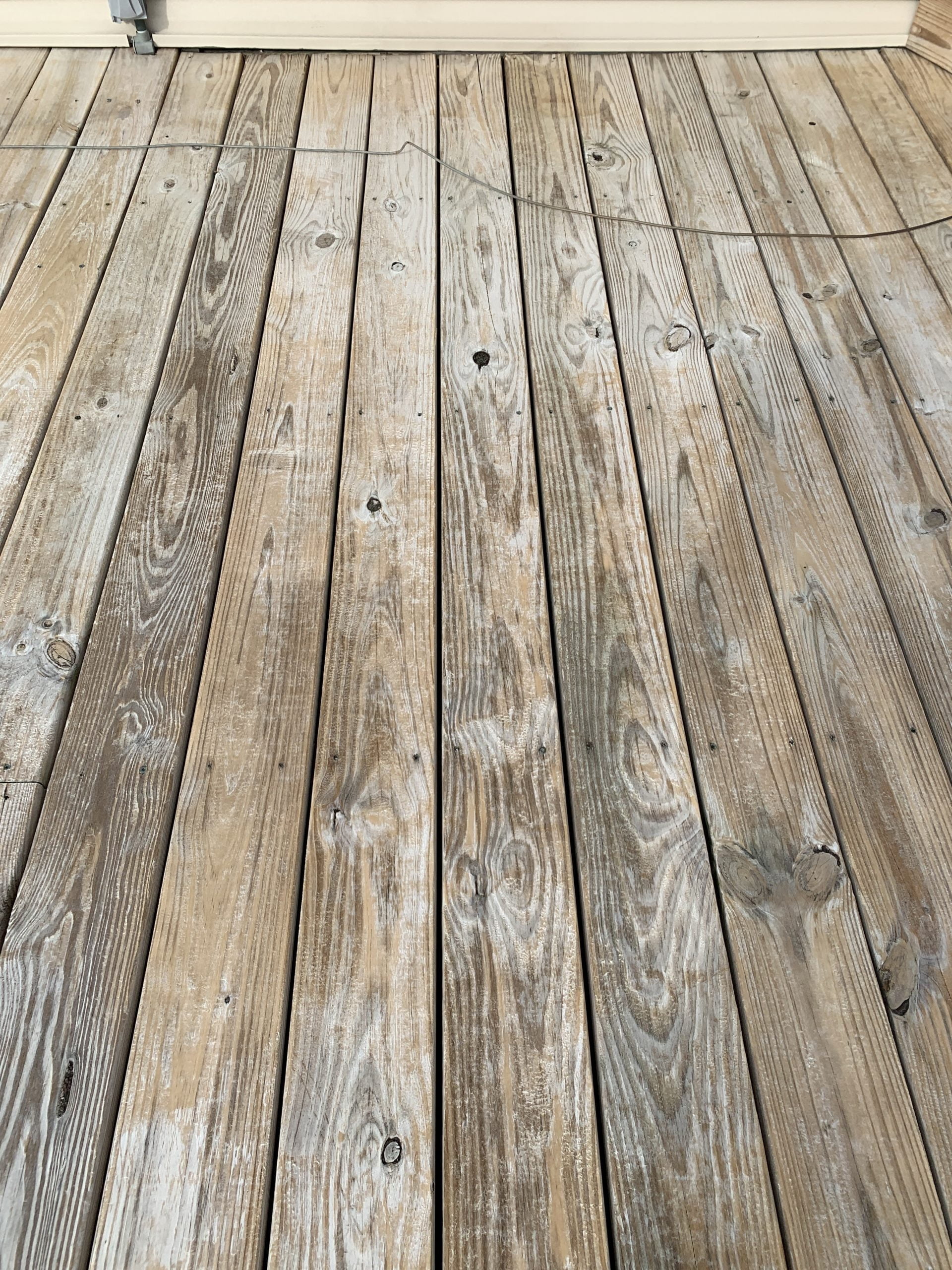

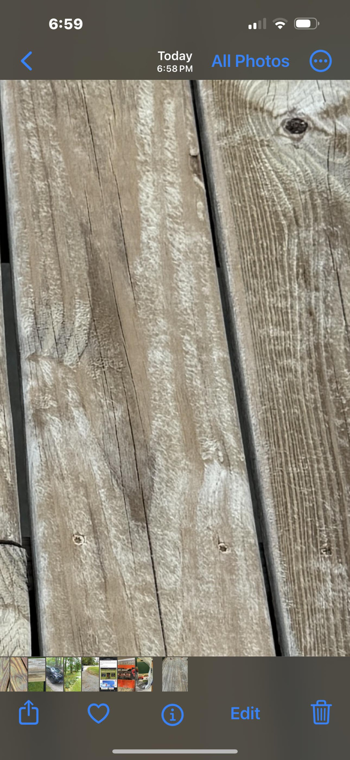

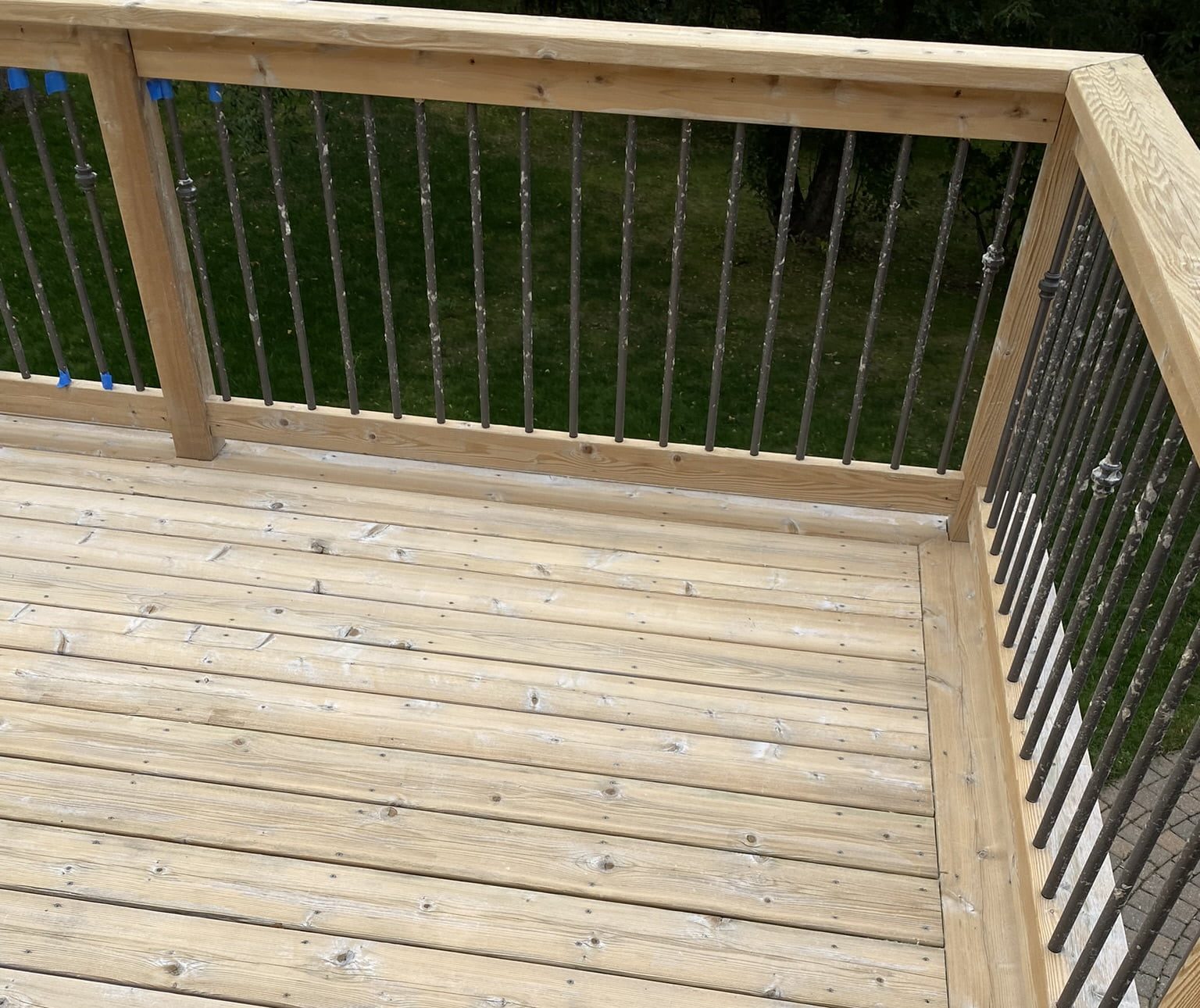

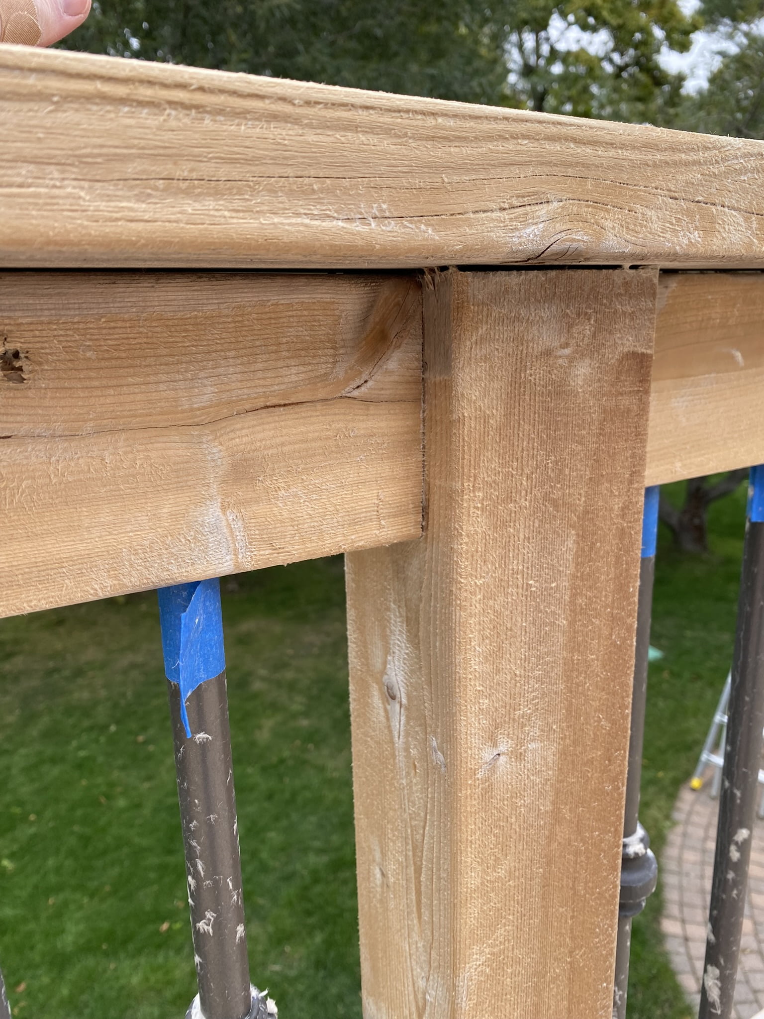

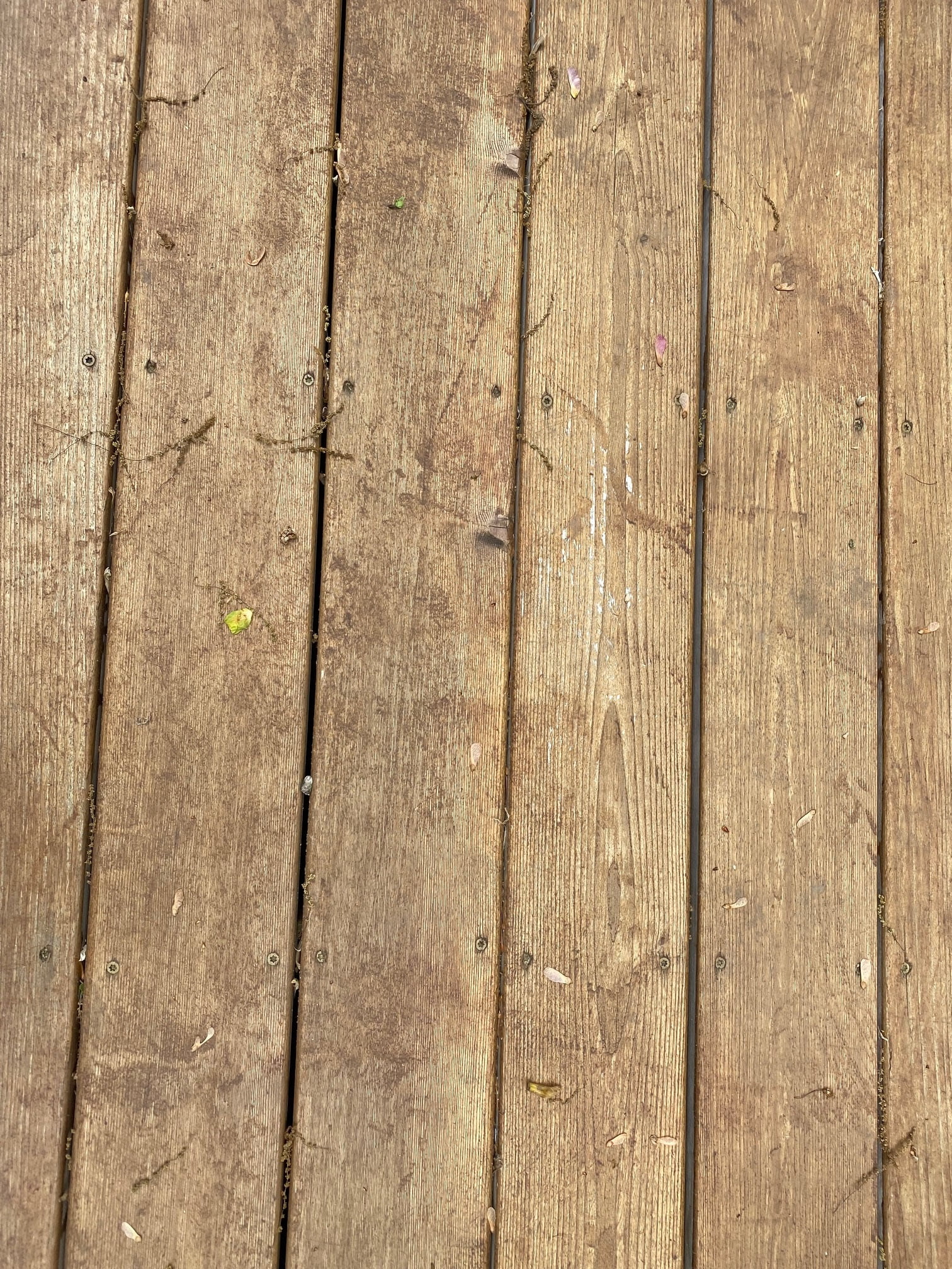

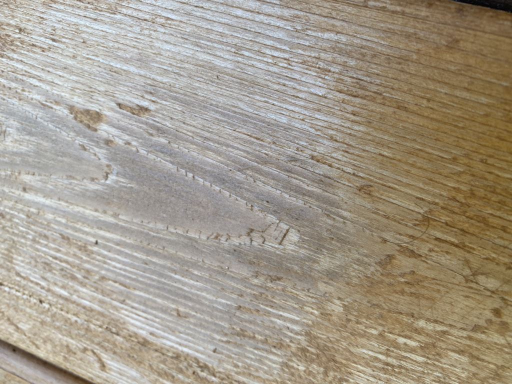

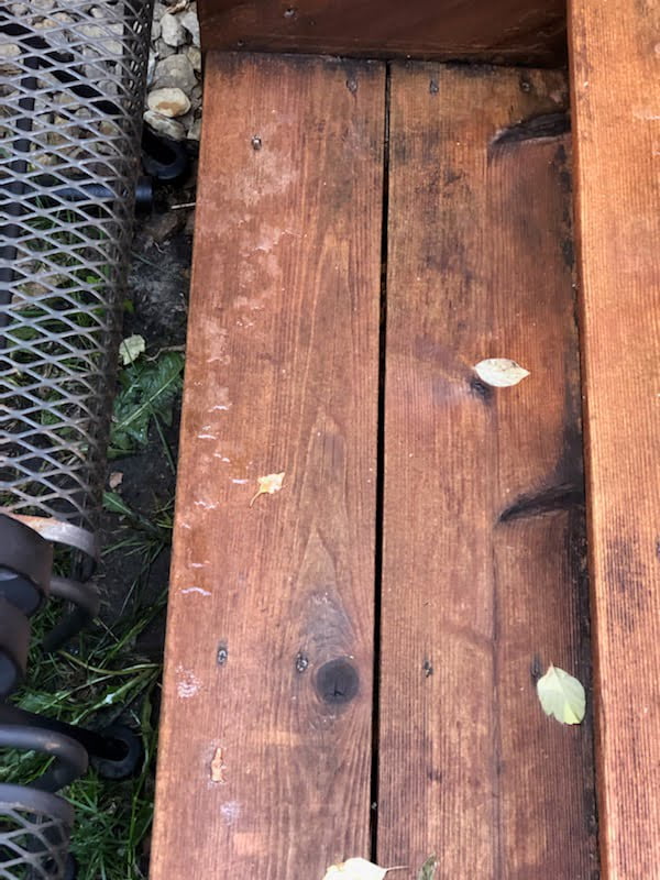

What do you do when you have fuzzy wood but when you sand, it greatly accentuates the planing marks? ( was sanding with a random orbital palm sander and 80 grit)
IMG_5072

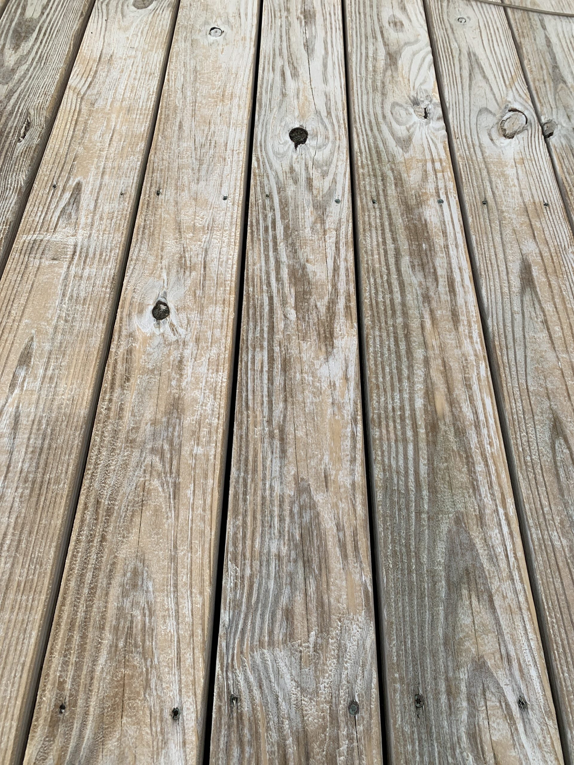

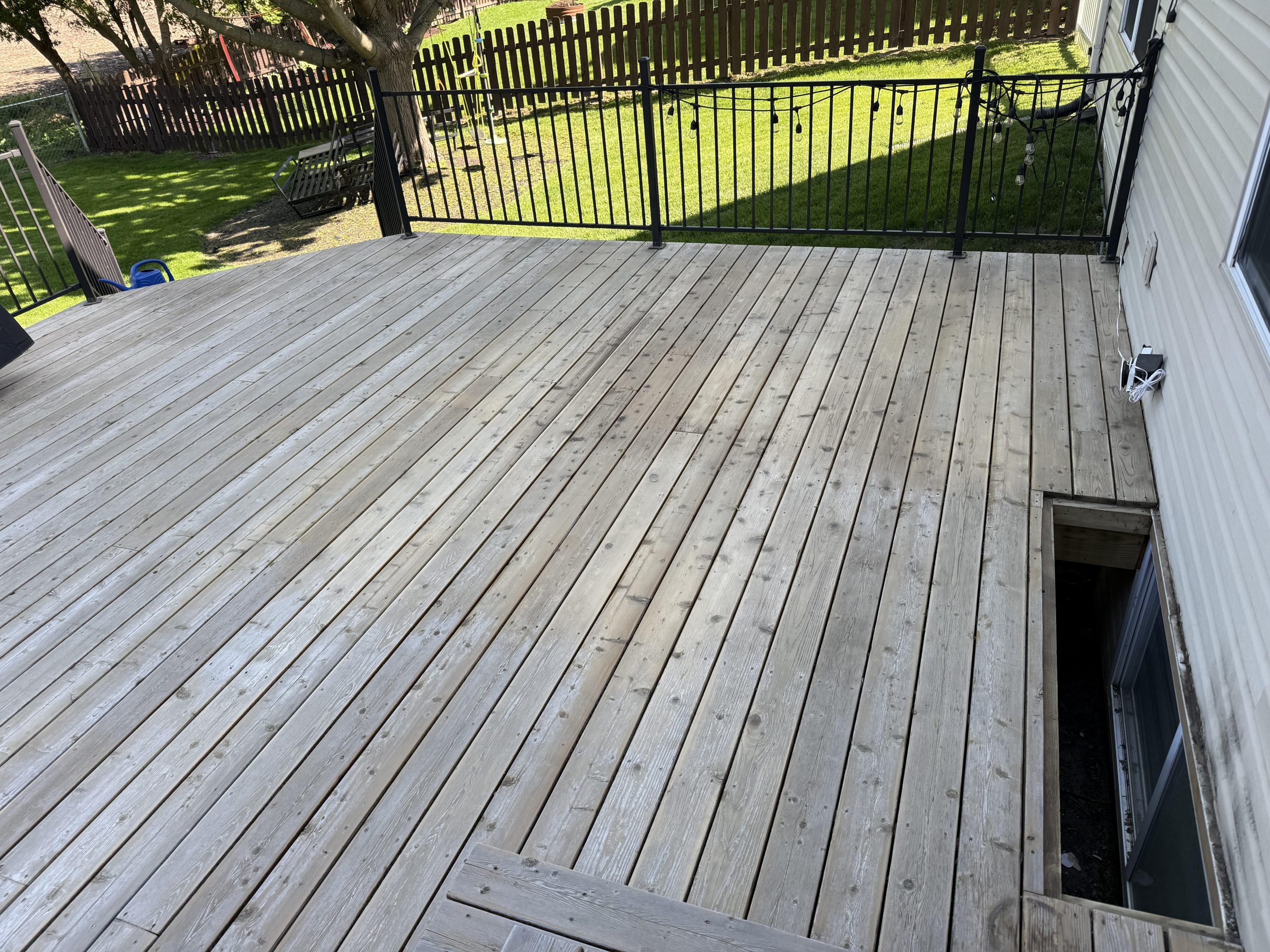

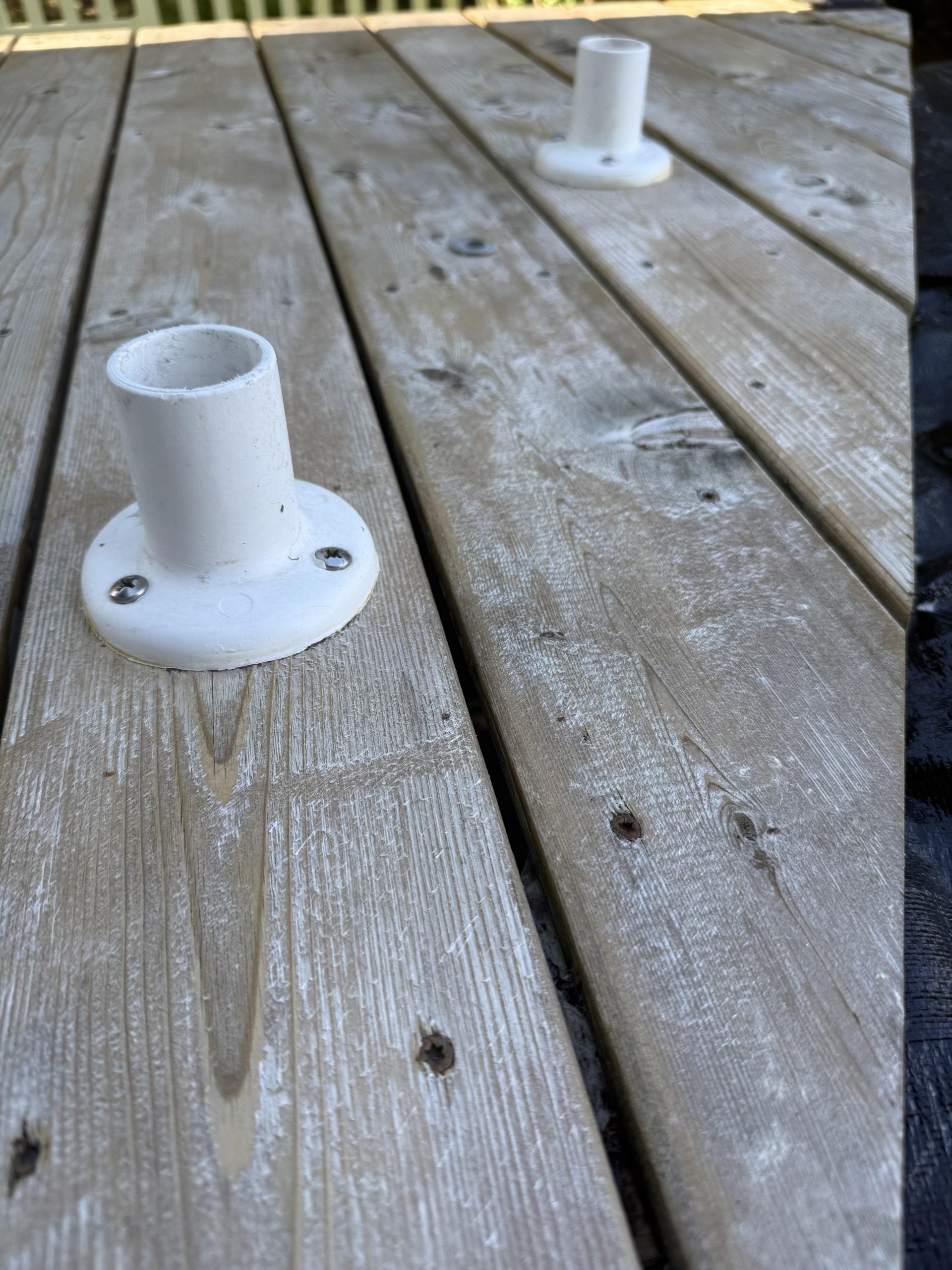

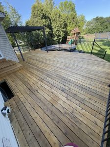

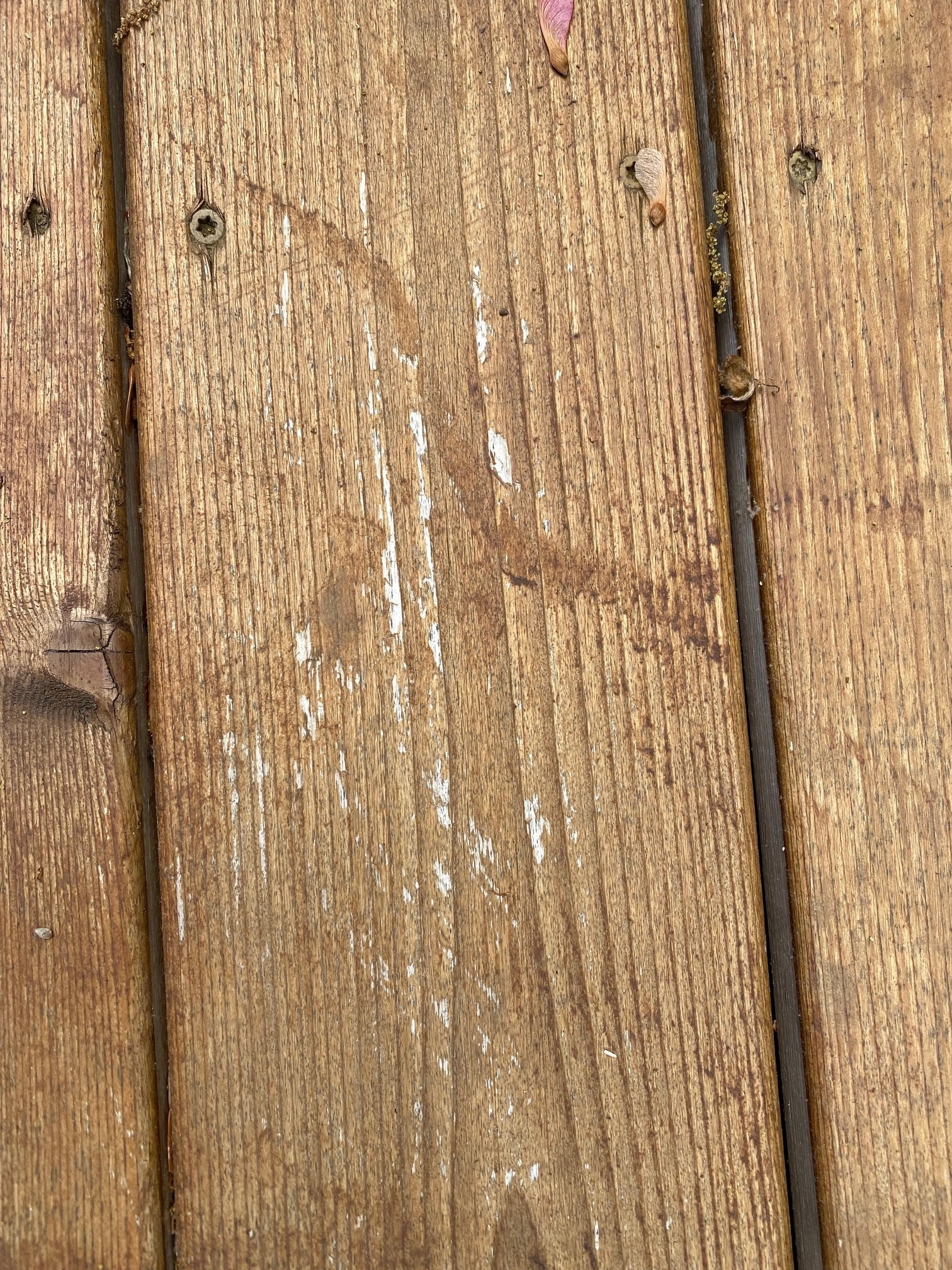

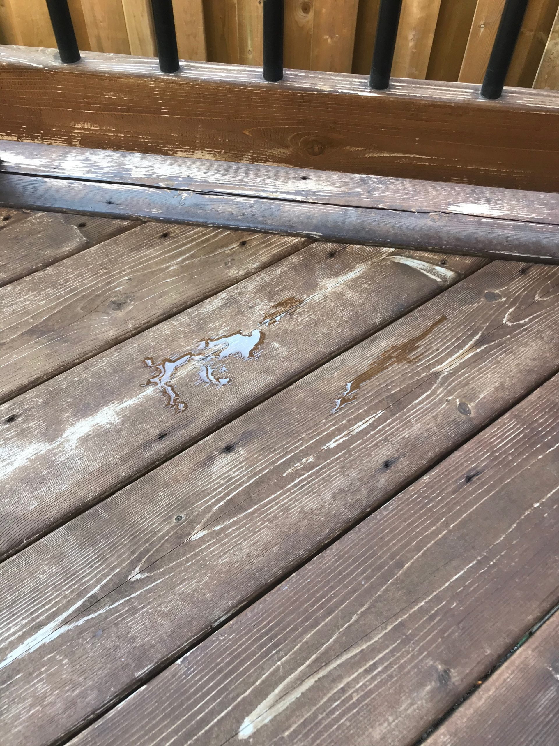

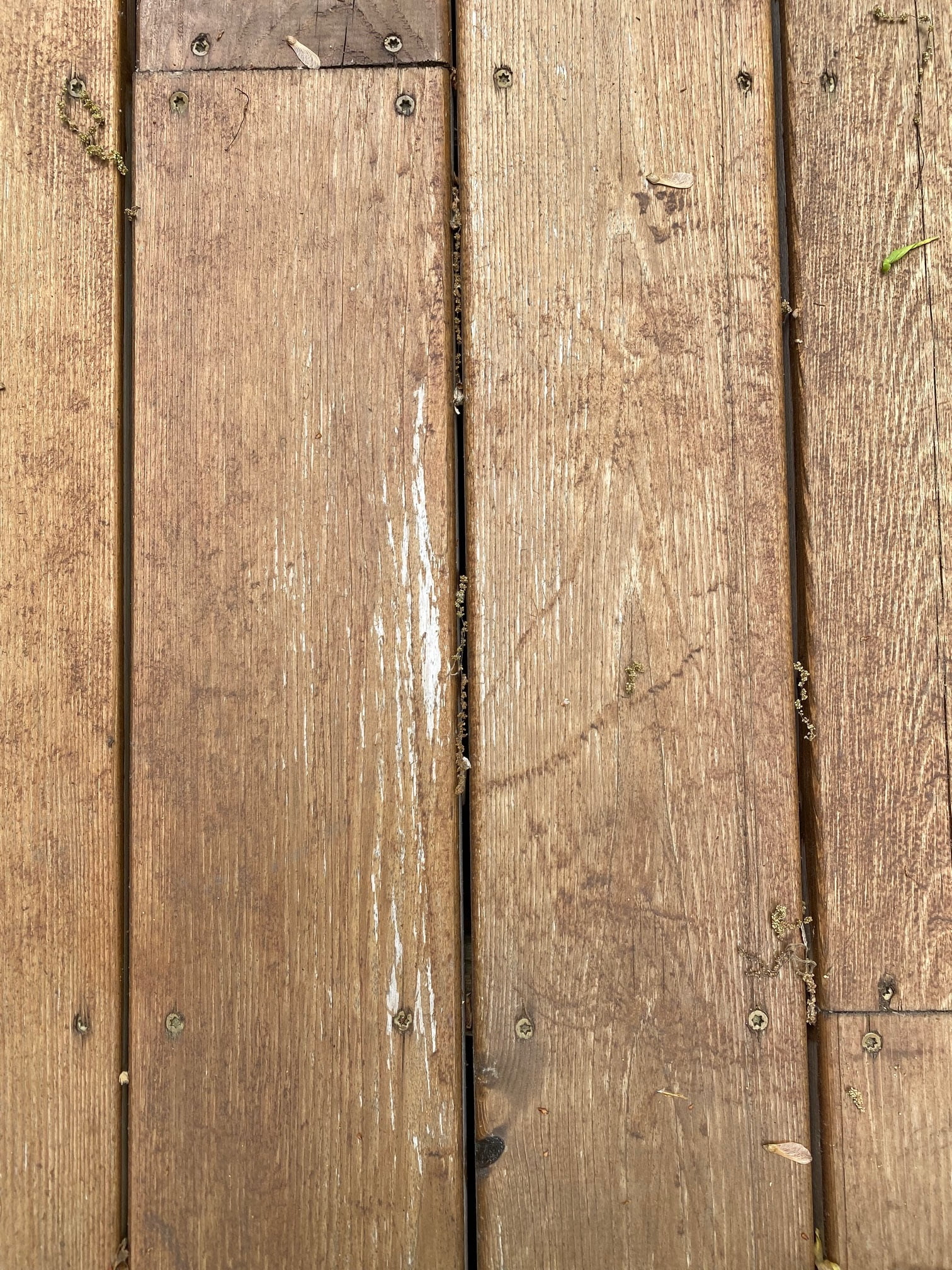

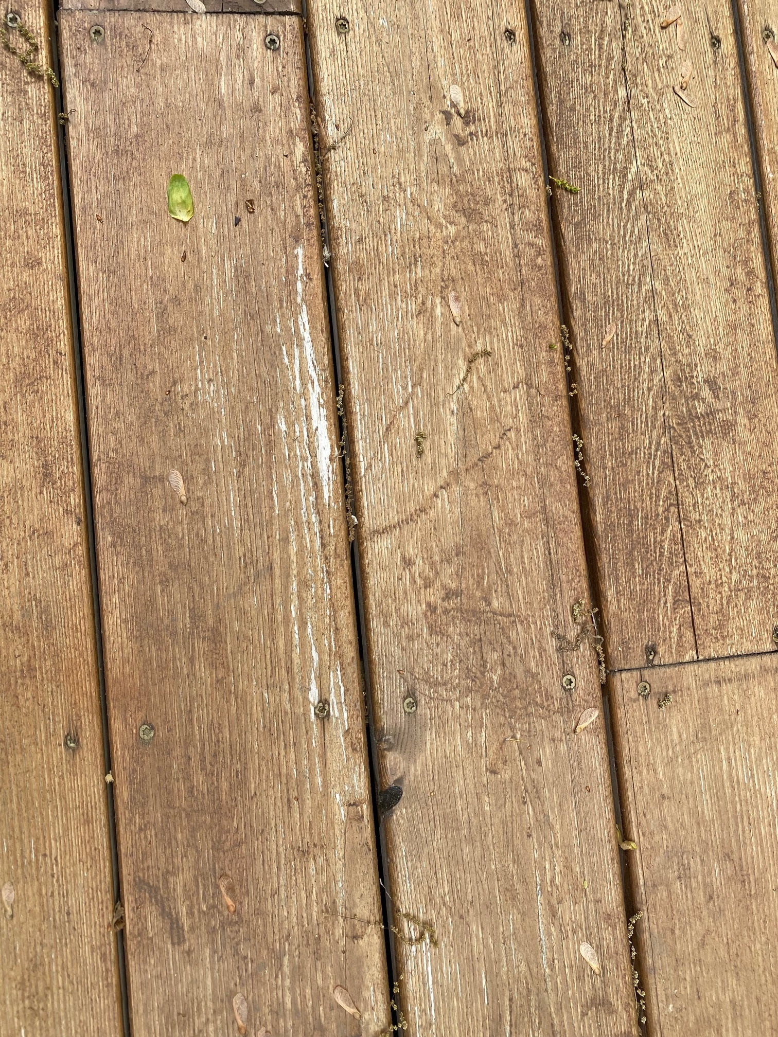

Hi Scott, I have a 3 year old cedar deck. It was originally treated with commercial waterproofing solution but it was a disaster, it all started peeling. I was ready to properly stain it, so stripped the old waterproofing solution with a render commercial buffer (and manual sander in tight spaces). I just used wood cleaner and power wash and I see a HUGE amount of fuzzies coming off during rinse as well as staying on visibly after wood is dry. I am planning on using C2 Guard stain in light color. Do I need to sand again the fuzzies away? So much work, I’m so frustrated, should I have cleaned and power washed first before sanding?
Eliza
Eliza
Pics1
IMG_2717
IMG_2718
Eliza
Eliza
Pics 2
IMG_2719
IMG_2720
Eliza
Eliza
Thank you! I did and looks much better. Do you have any experience with c2 guard?
Eliza
Eliza
I should have mentioned that some of the white coloring still is there in between the deep grain. Is it ok to leave as it since the stain doesn’t skin?
Eliza
Eliza
Sorry for the piecemeal, I looked back at picks after I sanded the deck (before cleaner and power wash) and it looked so much better. I have a small window of about a week before the next rain, I feel so demotivated after all theis work that my end result will not be great. Pics after sanding (before cleaner/powerwash).
IMG_2671
IMG_2670
Eliza
Eliza
This last round of pics are taken earlier than the originals I shared. I sanded the entire deck first and then used wood cleaner and power wash. I assume the back spots got removed by the wood cleaner but overall the white up damage looks much worse after cleaner and wash compared to what it looked like after I sanded.
Going back to c2 guard, what negative aspects were you hearing?
And thank you for your help, this is such an amazing resource for us!
Eliza
Eliza
That area is where my patio set sits that’s why it’s not as uv damaged as the rest of the deck. And yes it is power coated aluminium (but the leg pegs are plastic). So just to confirm, you don’t think the amount of I’ve damage on the original pics I sent needs to be fully sanded again and I can stain over that after wood is dry?
Eliza
Eliza
Not that I have noticed when prepping for the season last week but I will take another look. I’m ok with those showing, since there is so many other grooves in the wood. Thank you again for all the advice and knowledge.

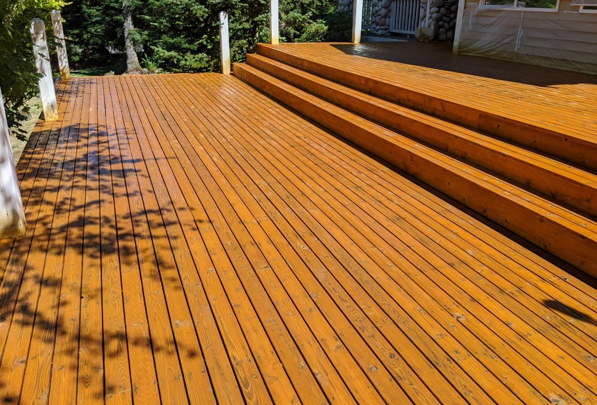

Eliza
Eliza

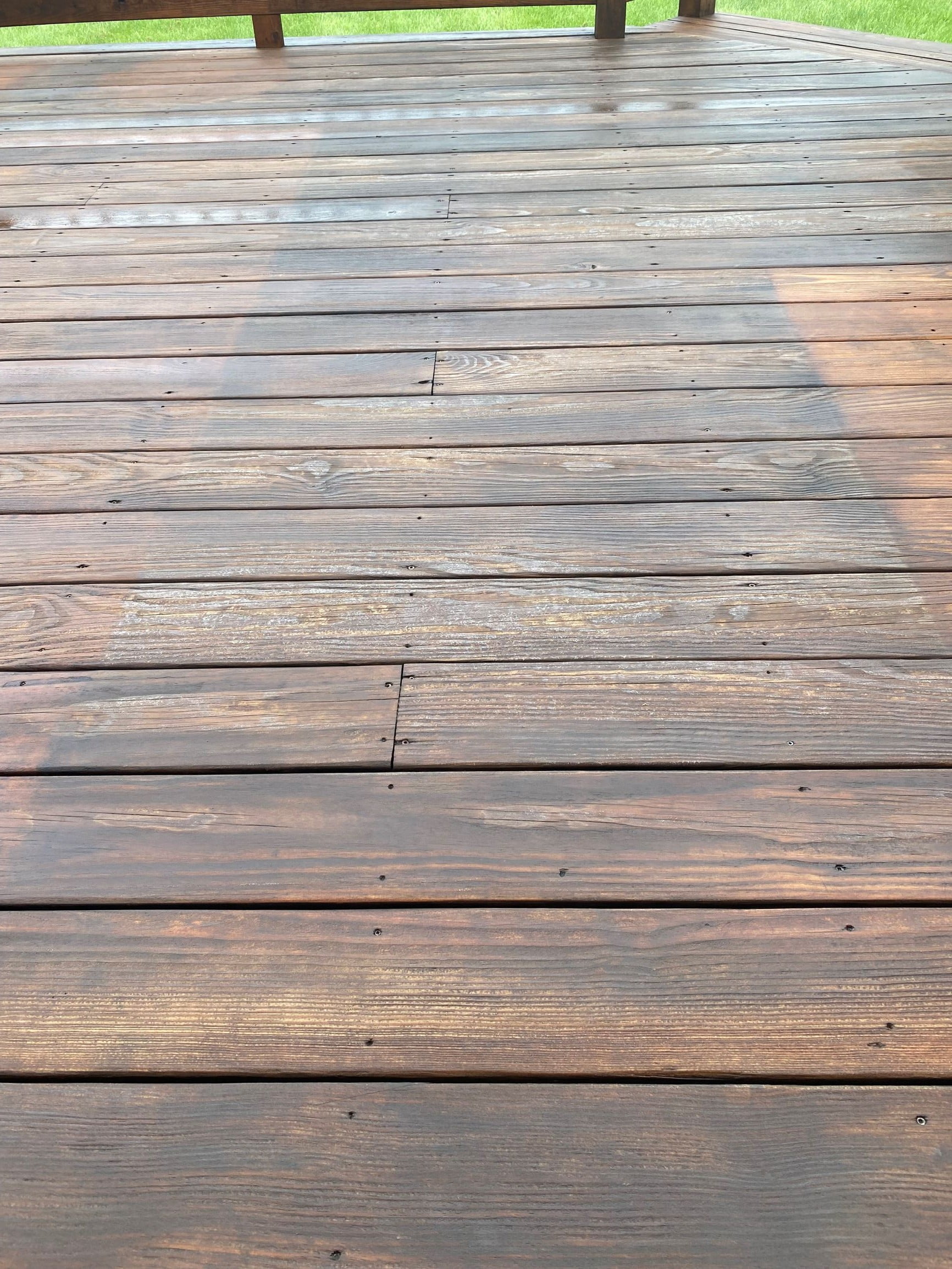

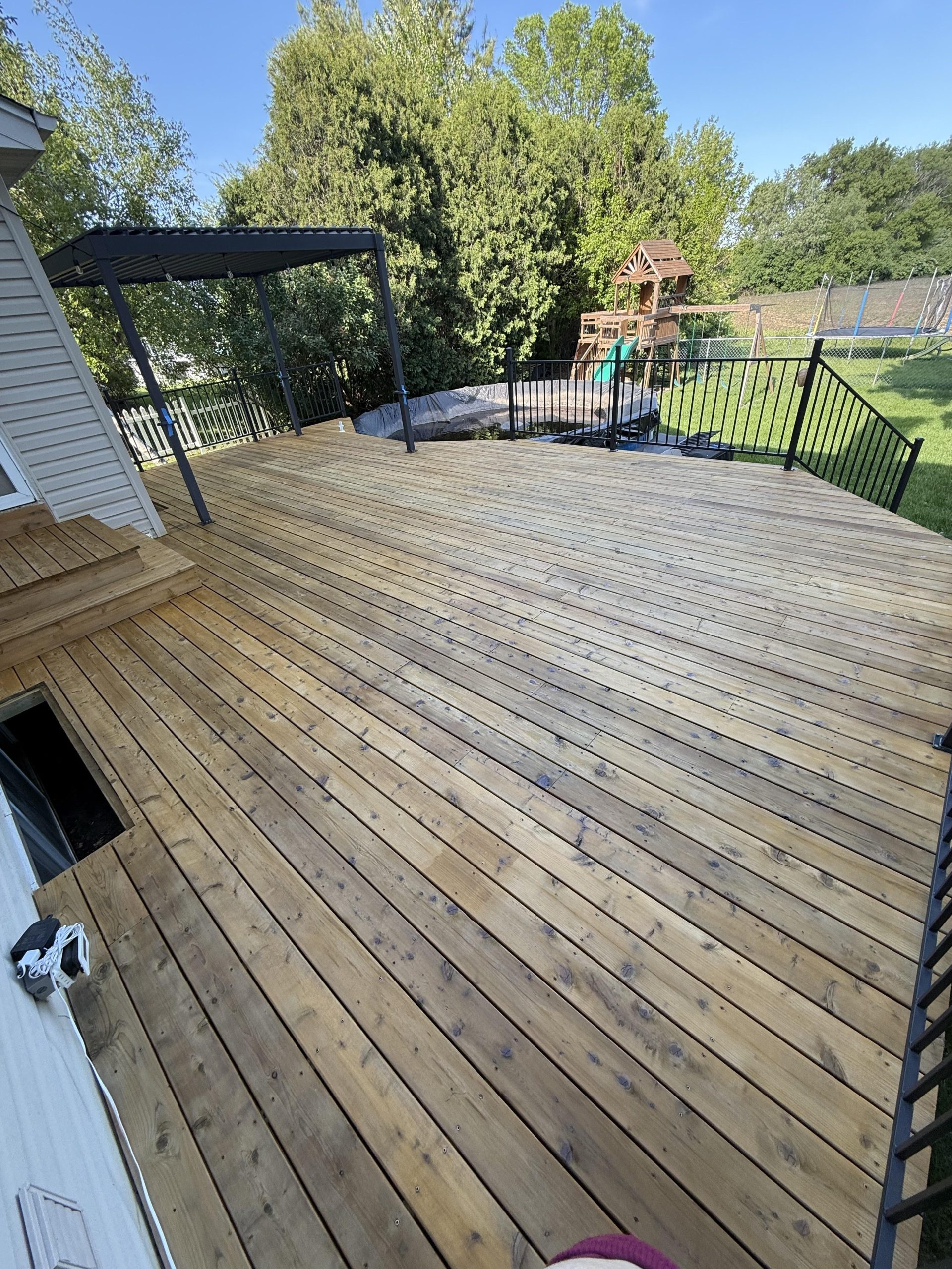

Wanted to share with you the final outcome. I’m very happy with the stain adherence after the extra cleaning and fuzzies removal. Thank you for your advice.

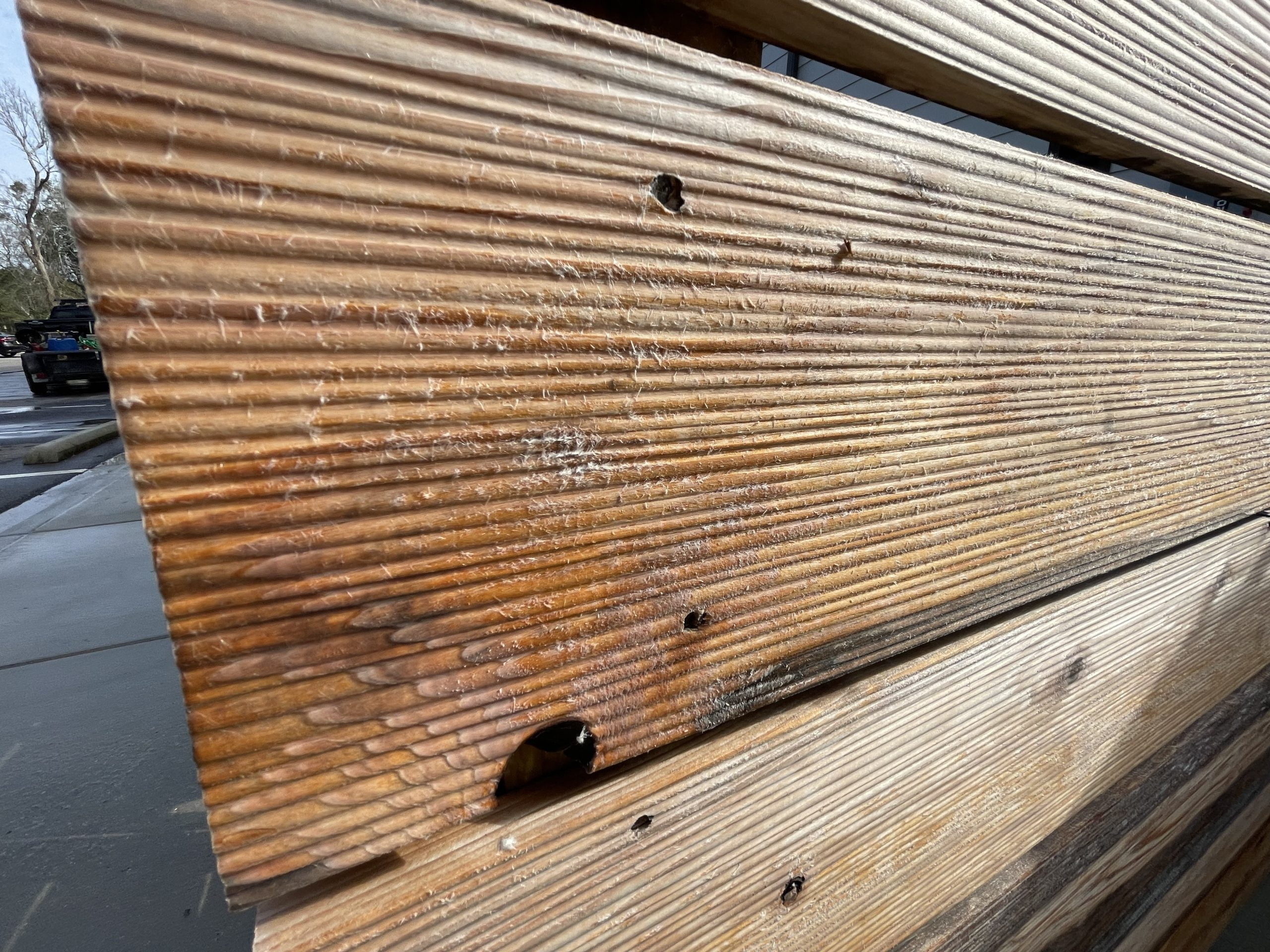

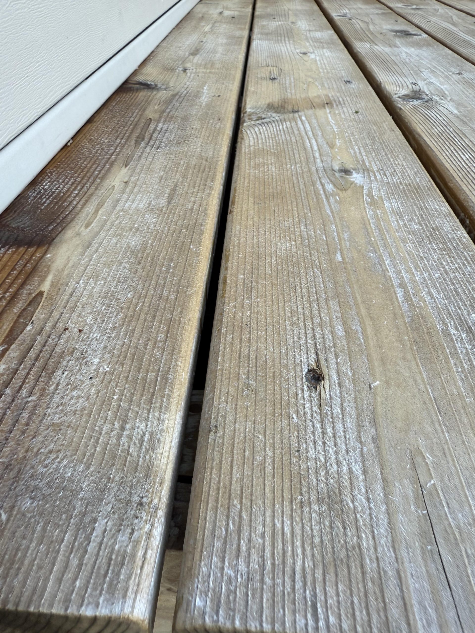

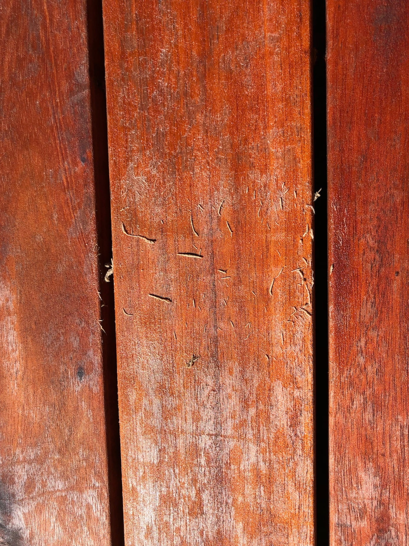

Any suggestons on how to remove the fuzzies with sanding down the machined lines found in MPG pine?

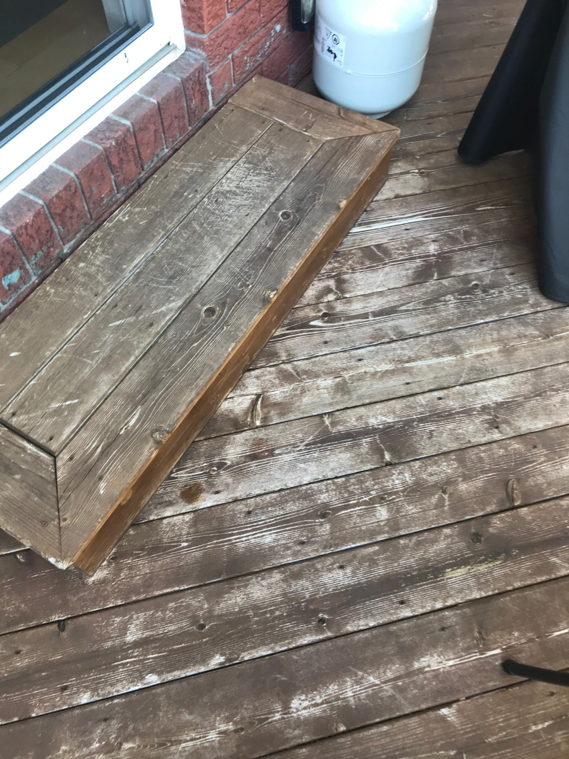

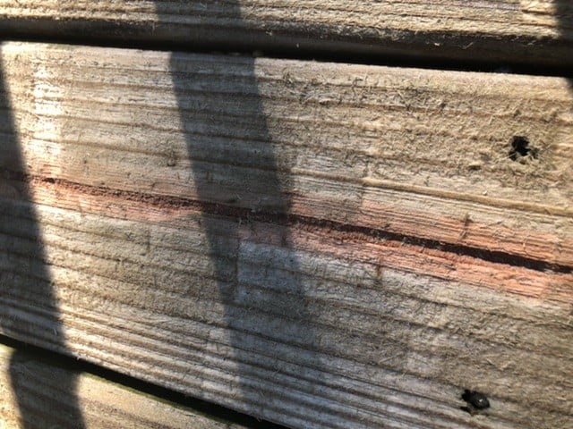

Hi. I RAD paint stripper as you suggested. Please see my previous posts. my deck now has no more of the behr stain but it still has dark spots. Can you show me how to remove the dark areas? Other than by sanding, that is. I know sanding works but I was trying to avoid that. I haven’t used the brightener yet. Here are before and after stripping pictures. Unfortunately the before was taken when wet and the after is when dry so not easy to compare.
IMG_9337
IMG_9019
Terri Rice
Terri Rice
Oh. It’s been 4 days since I stripped it. I wasn’t sure if I should clean it before applying brightener.

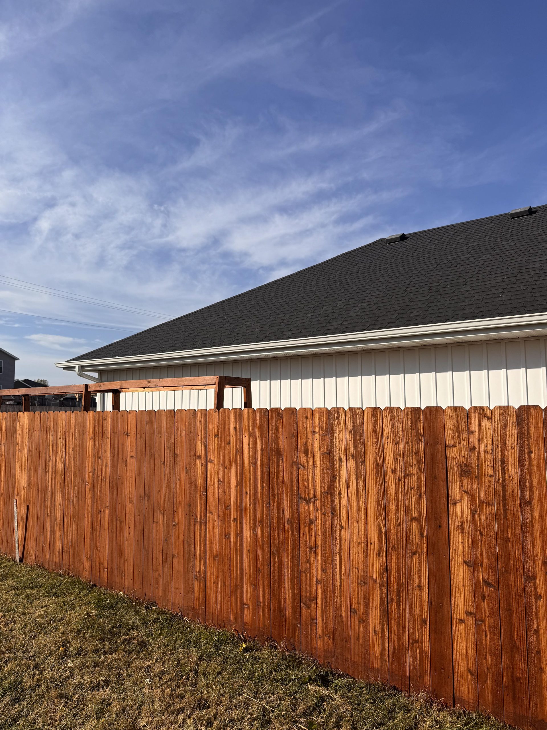

Avraam
Avraam

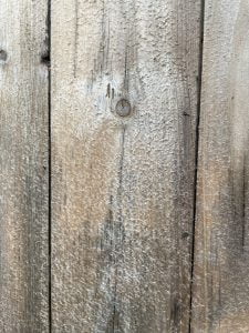

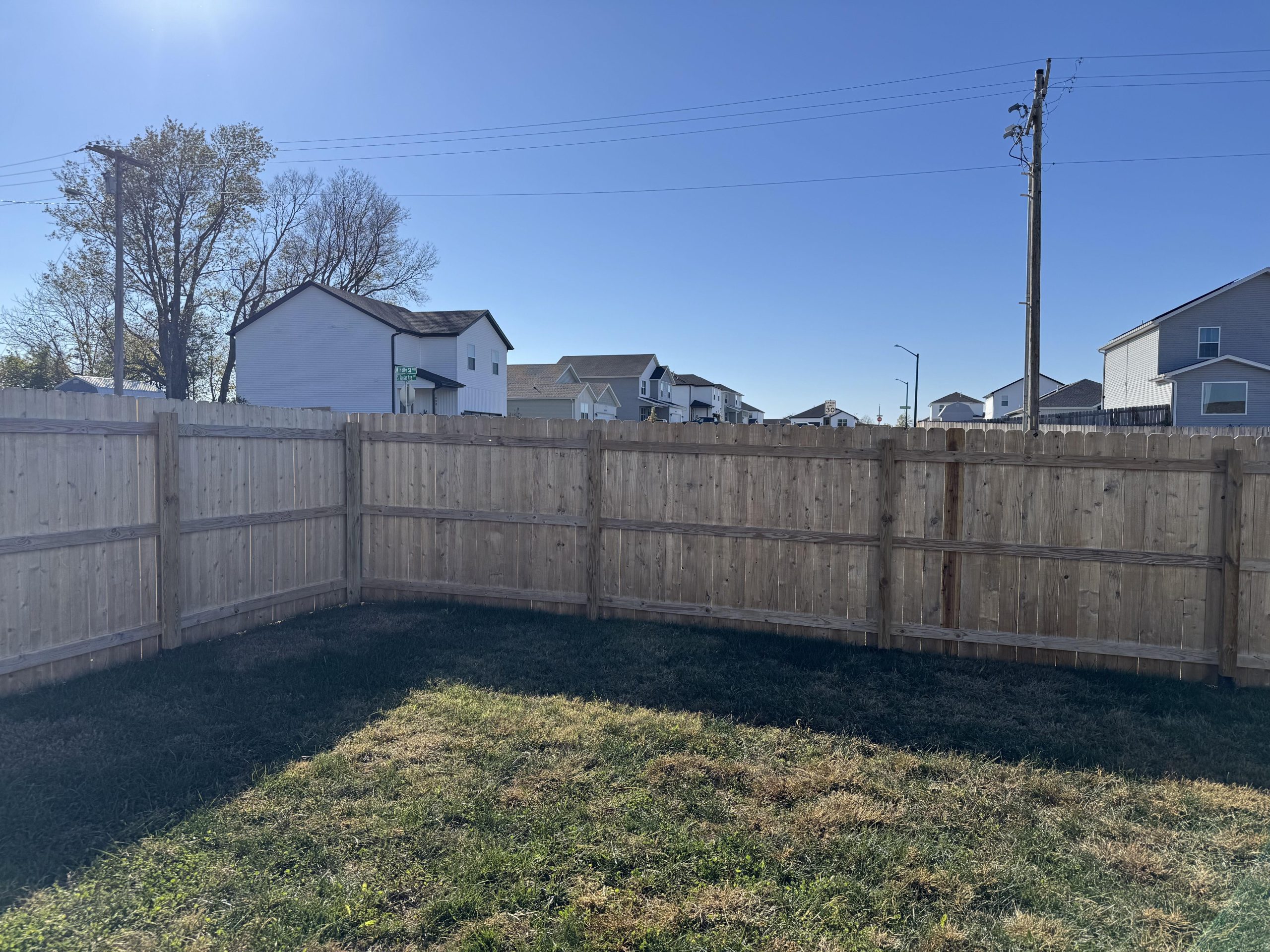

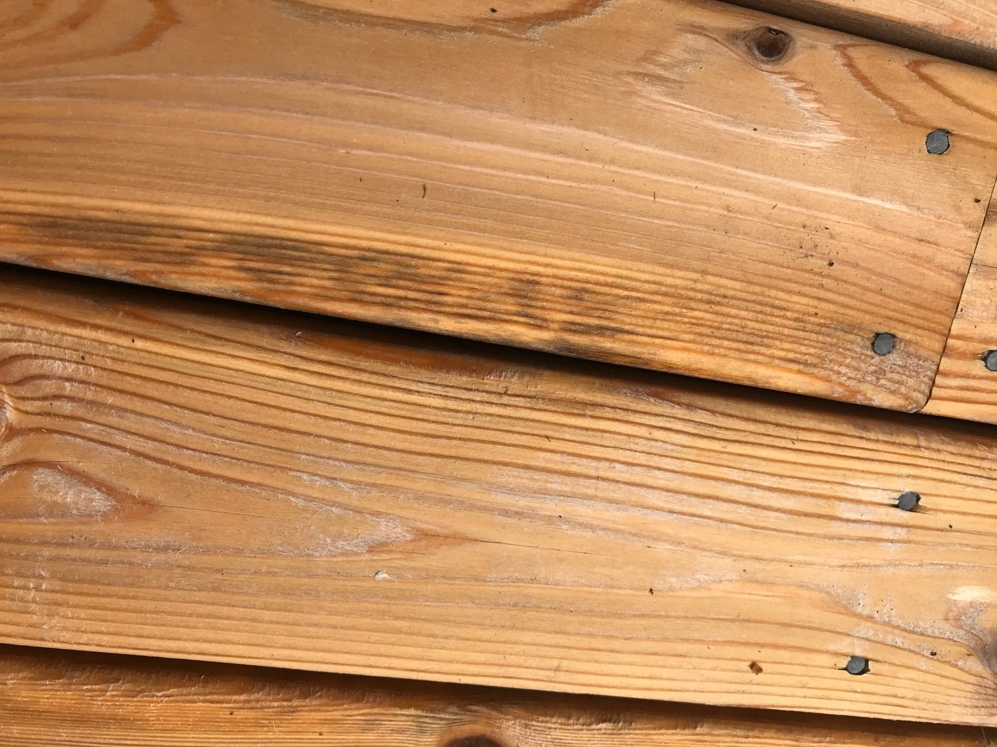

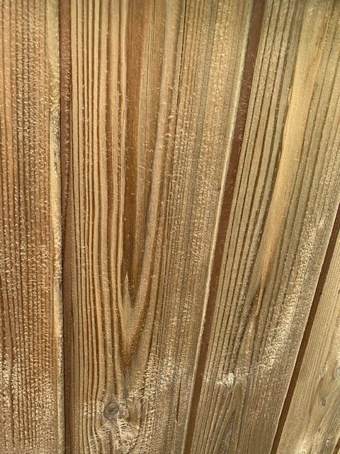

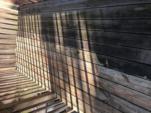

Hello! Somebody please help me with my fence. Doing this for the first time and definitely learning from my mistakes the hard way. This is about one year old fence. I cleaned it with 30 seconds outdoor cleaner, used the power washer to wash it out. I didn’t use any brightener(forgot about it at that time) which I totally regret now. I stained it after a week with semi-transparent oil based stain and it just looks so bad. Stain didn’t penetrate properly and I have no idea what to do now. Probably the best option is to strip it down, clean everything again and to use brightener. Will sanding make any difference? Is there anything else I can do to make it look better?
Will attach picture after it was cleaned and how it looks 3rd day after it got stained. Please help.
IMG_3136
IMG_1859
IMG_1861
IMG_1867
Avraam
Avraam
Thank you for your reply. I used Expert stain&seal, all the problem was in preparing the fence. What steps would you recommend to fix it?

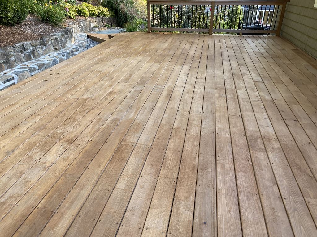

About 50% of my pressure treated 2×6″ deck boards are 43 yrs old. The other 50% are new board replacements installed 2 yrs ago. The boards are in a mixed pattern. The entire deck was cleaned with sodium percarbonate, brushed while wet with stiff bristled brushes.. Then pressure washed..A brightener was applied to a test area. No change in colorations. None of the wood has ever been stained or coated with anything.
Deck color now looks very good. Yes the 43 yr old boards are more porous than the 2 yr old boards. If I wet entire deck with water, all the boards become darker as expected with the older boards appearing slightly darker.
The various random colorations look rustic, quite interesting and pleasing to our eyes.
I applied your Natural color Semi-transparent from your sample bottle to a 43 yr old board & an adjacent 2 yr old board. Just used one coat only. Very happy with the look on both boards. The 1st photo is during daytime before stain applied . 2nd photo shows same boards with stain applied on the edge of 2 boards, however it was a night shot with flash and colors are not true.
If I coat the entire deck with 1 coat RAD Natural, when it comes time to recoat after a few years, must that entire coating be completely removed before applying a new single coat of Natural? It certainly would be easier if cleaning with your cleaner then light pressure washing would be sufficient before applying one new coat

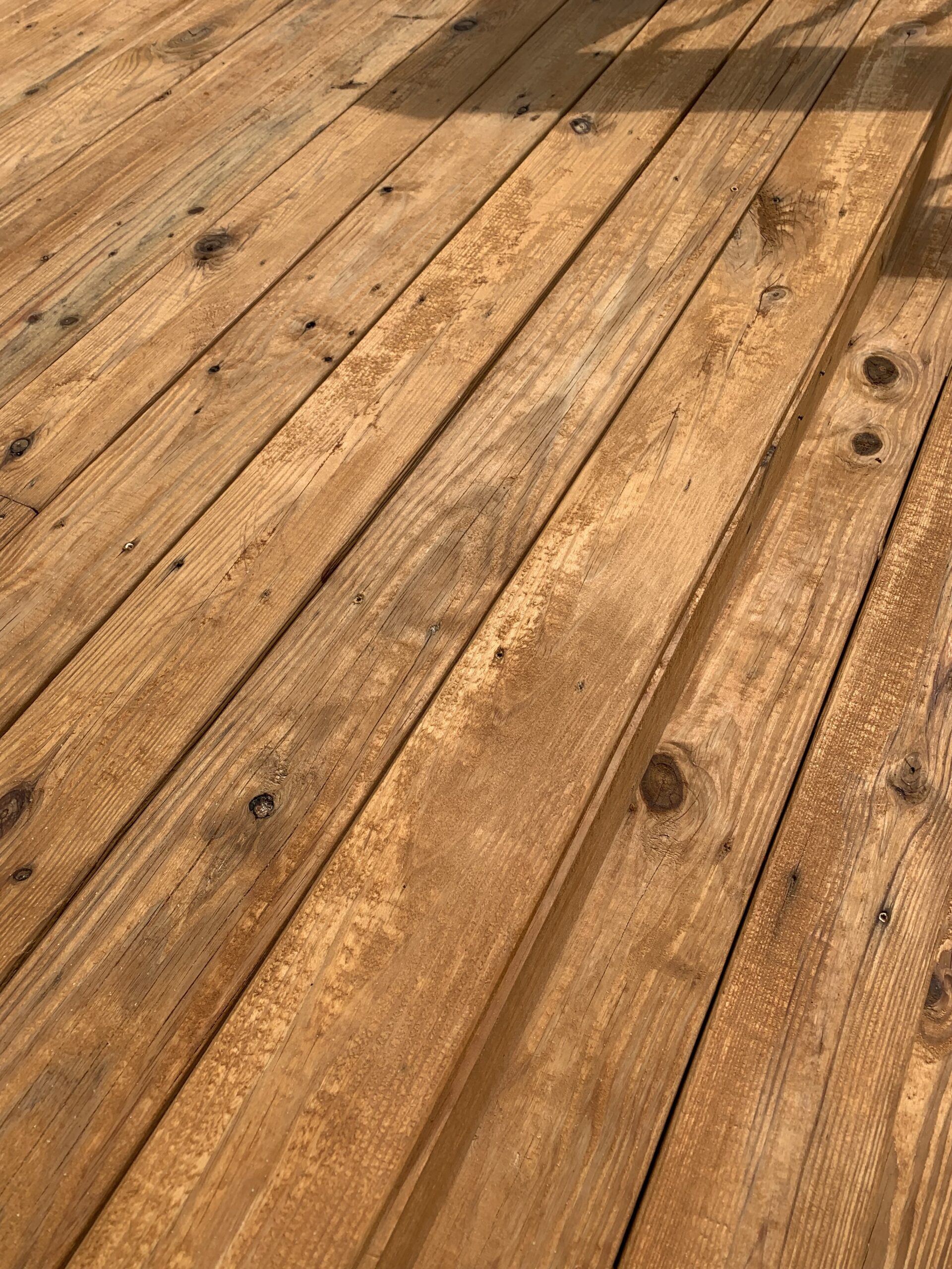

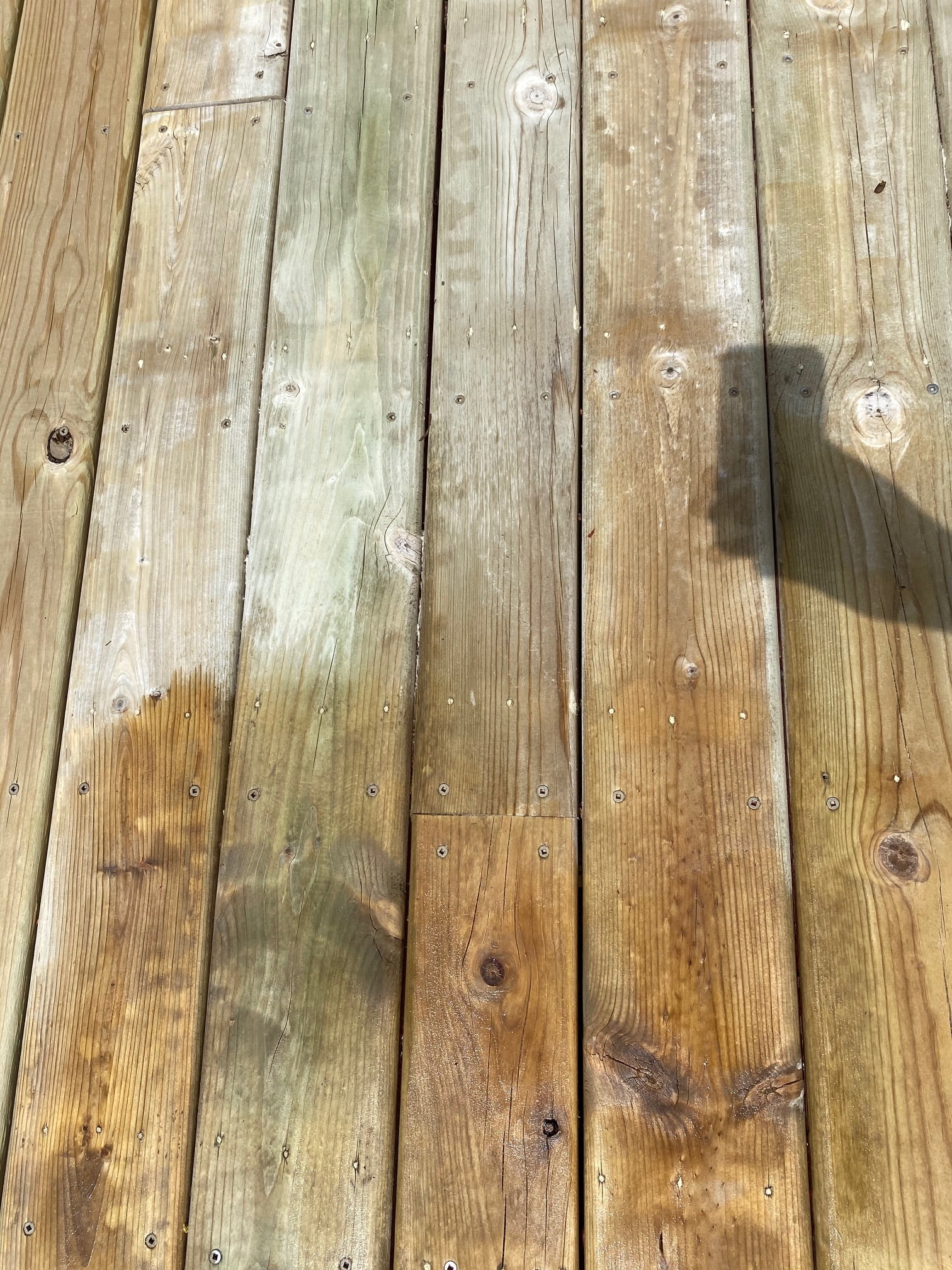

Hi I have a treated 5 year old deck. I cleaned it and it was really gray Menards said to use a stripper even though it didn’t have anything on it. Now it’s a disaster.i used the hose because i was afraid to power wash it but i don’t think it was powerful enough to get all the product off now it’s gray, clean and fuzzies everywhere. I probably should have power washed it but now what?
Cheryl Genson
Cheryl Genson
Hi here’s the pictures I’m so frustrated. I just want to fix it and be done.

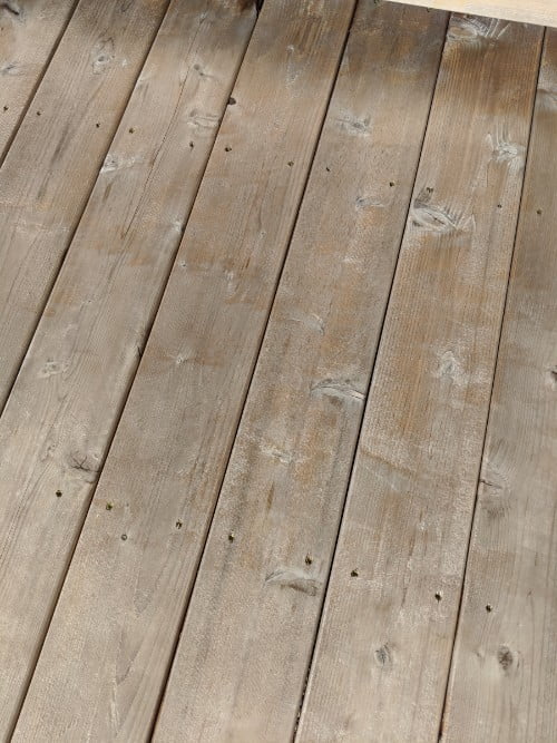

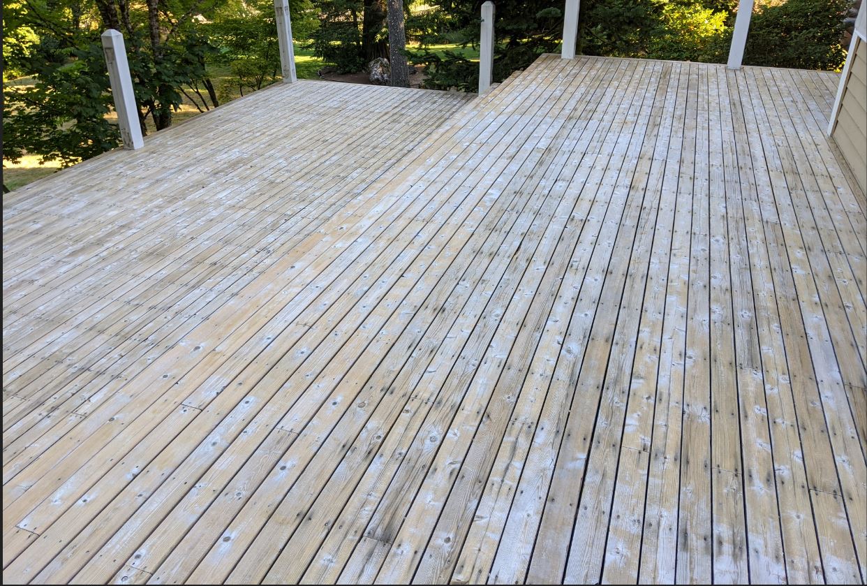

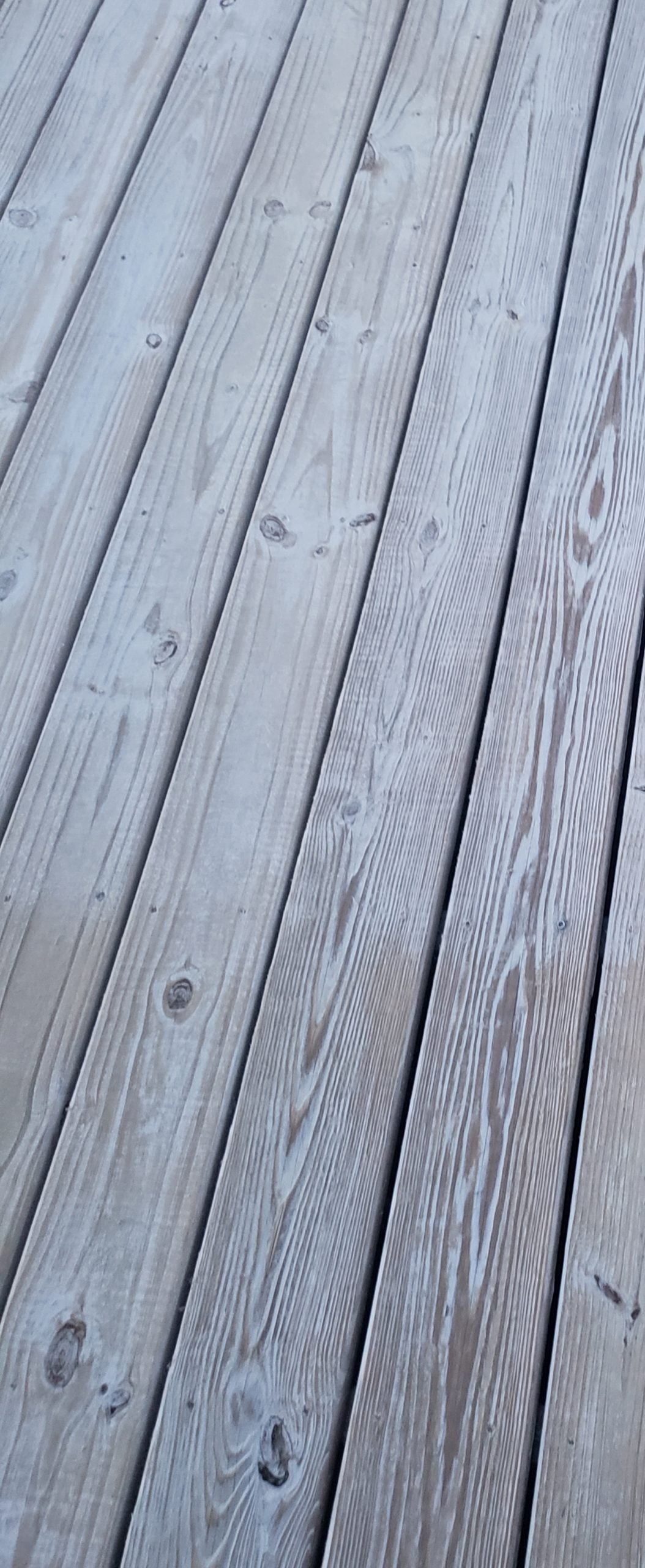

I pressure washed treated deck then sanded it. I cleaned with Valsoar deck cleaner. I had a entire deck of whitish residue. I have since pressure washed 2 more times looks much better. Valspar rep said use deck stripper and all in one neutralizer which I did. It is Better but still have some whitefish spots. Can I stain over them with Cabot Australian Timber Oil??? Or will they show thru. I have washed this deck so many times you would think the white woukd be all gone. Most are by the knots but there are some other spots. What do I do??? It’s on Eastside of house in Oklahoma..gets sun until 4 or so.

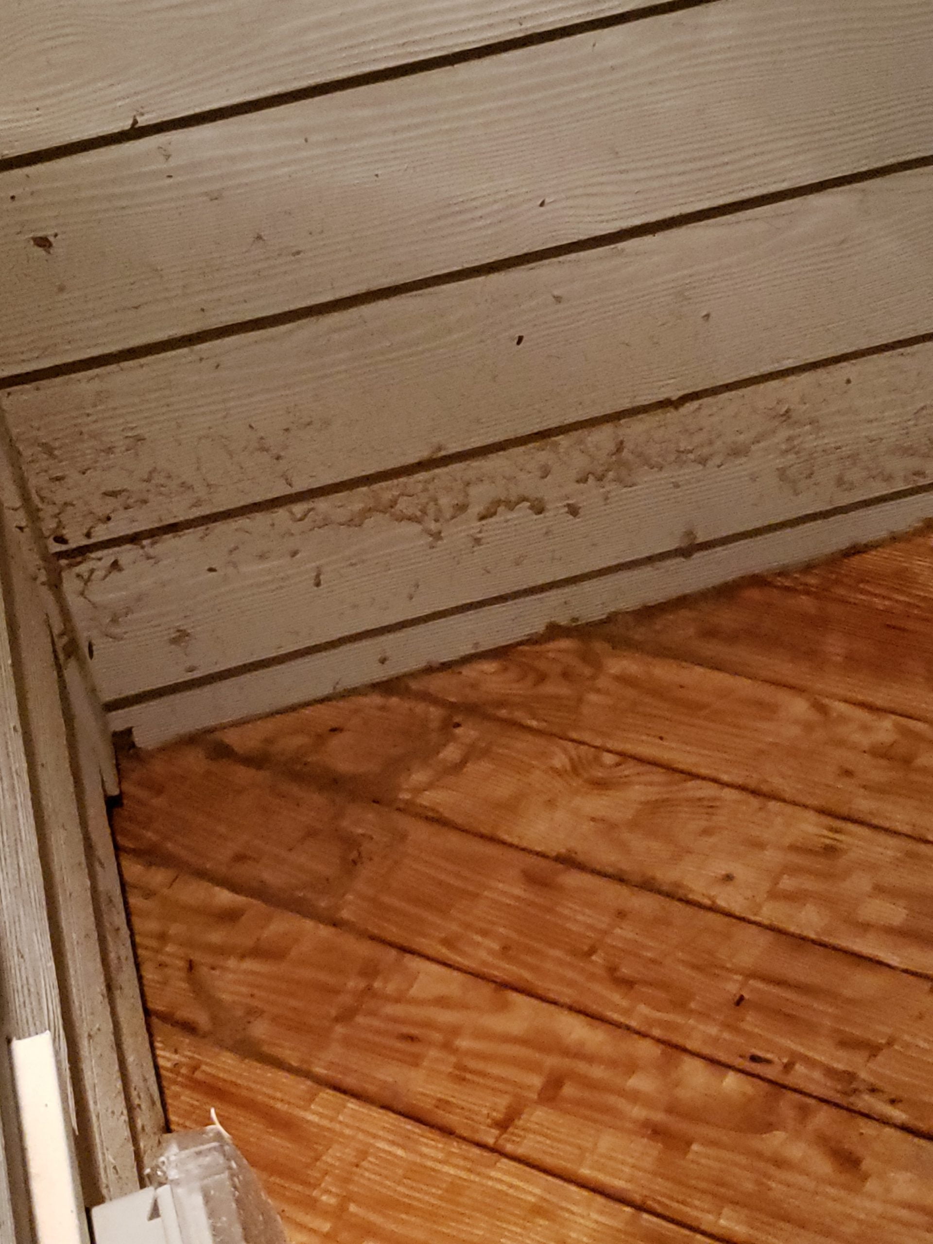

Beth
Beth

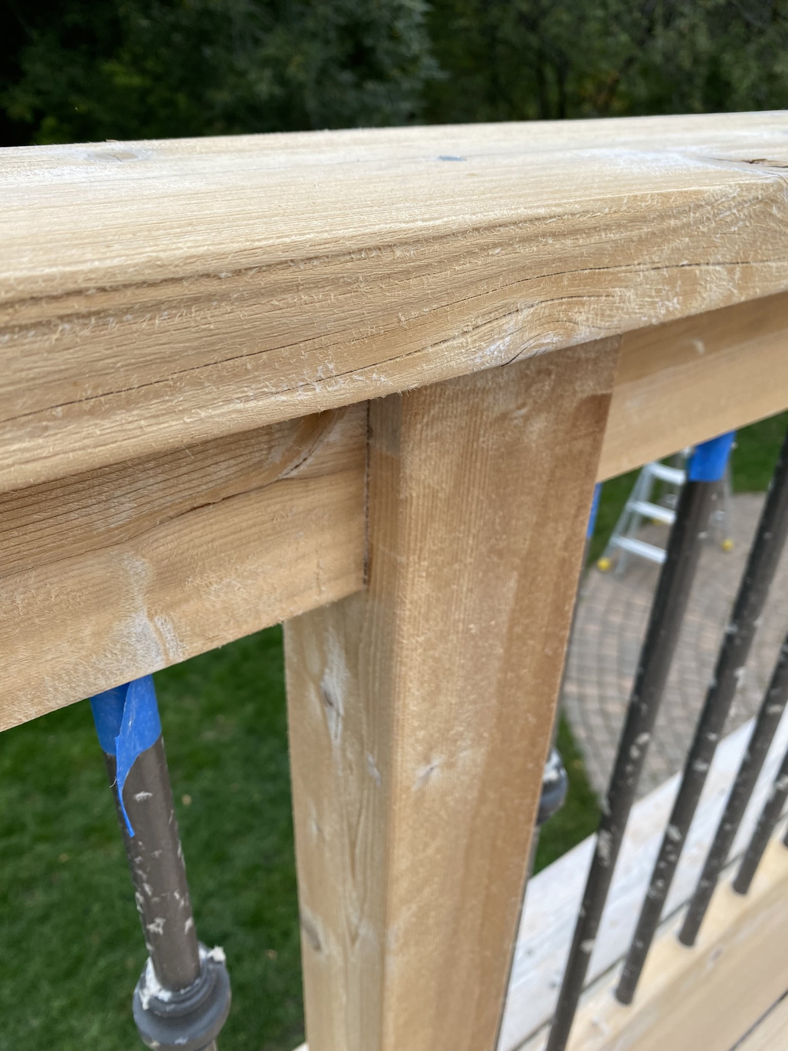

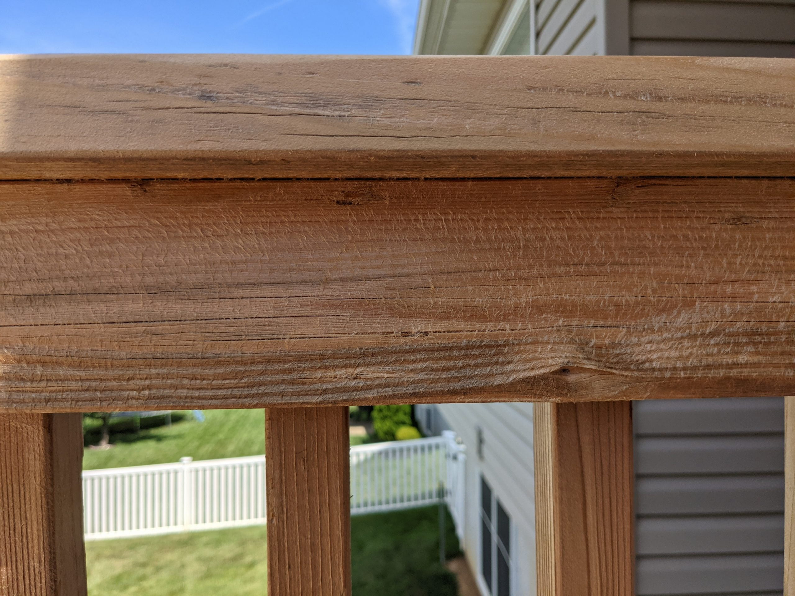

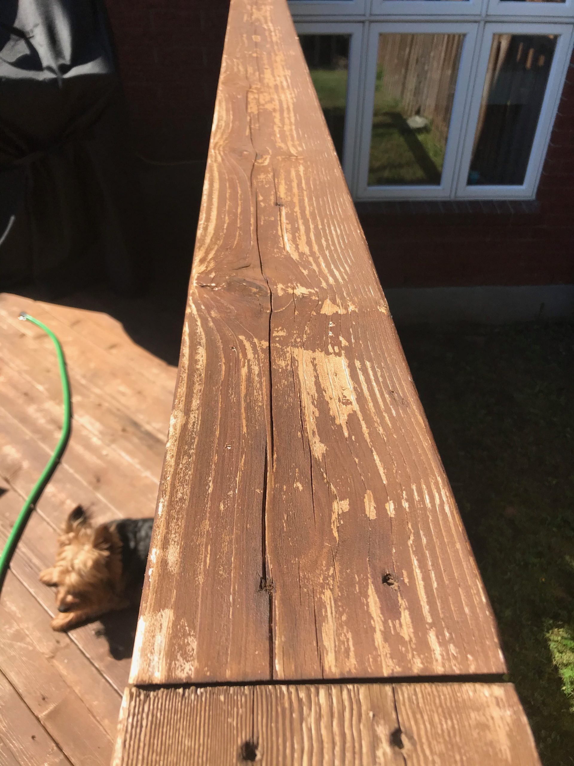

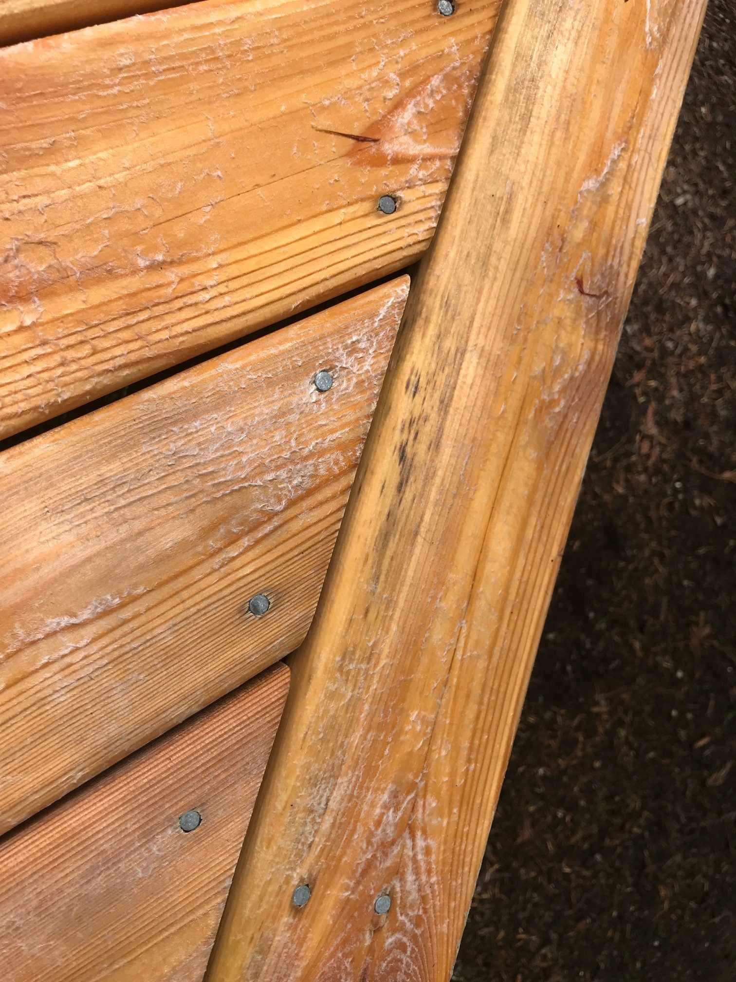

i just power washed my wood porch railings. it cleaned up nicely, but i have the fuzzies now. i plan on applying a solid wood stain + sealer. do i need to sand the railings before i apply the stain? the railings are 5 yrs old and this is the 1st time i have cleaned it. it is pressure treated wood that i never got stained before. i want to do it right, but, not looking to make extra work if not necessary. Also, should i apply 2 coats of stain?

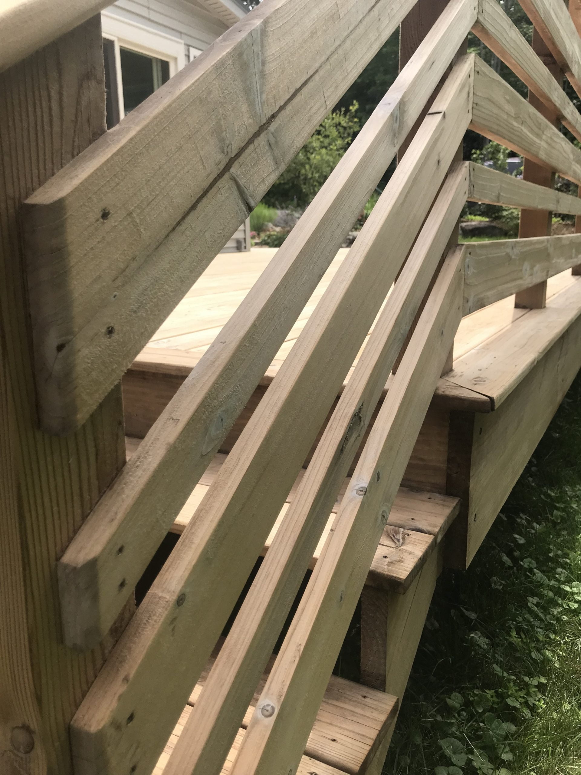

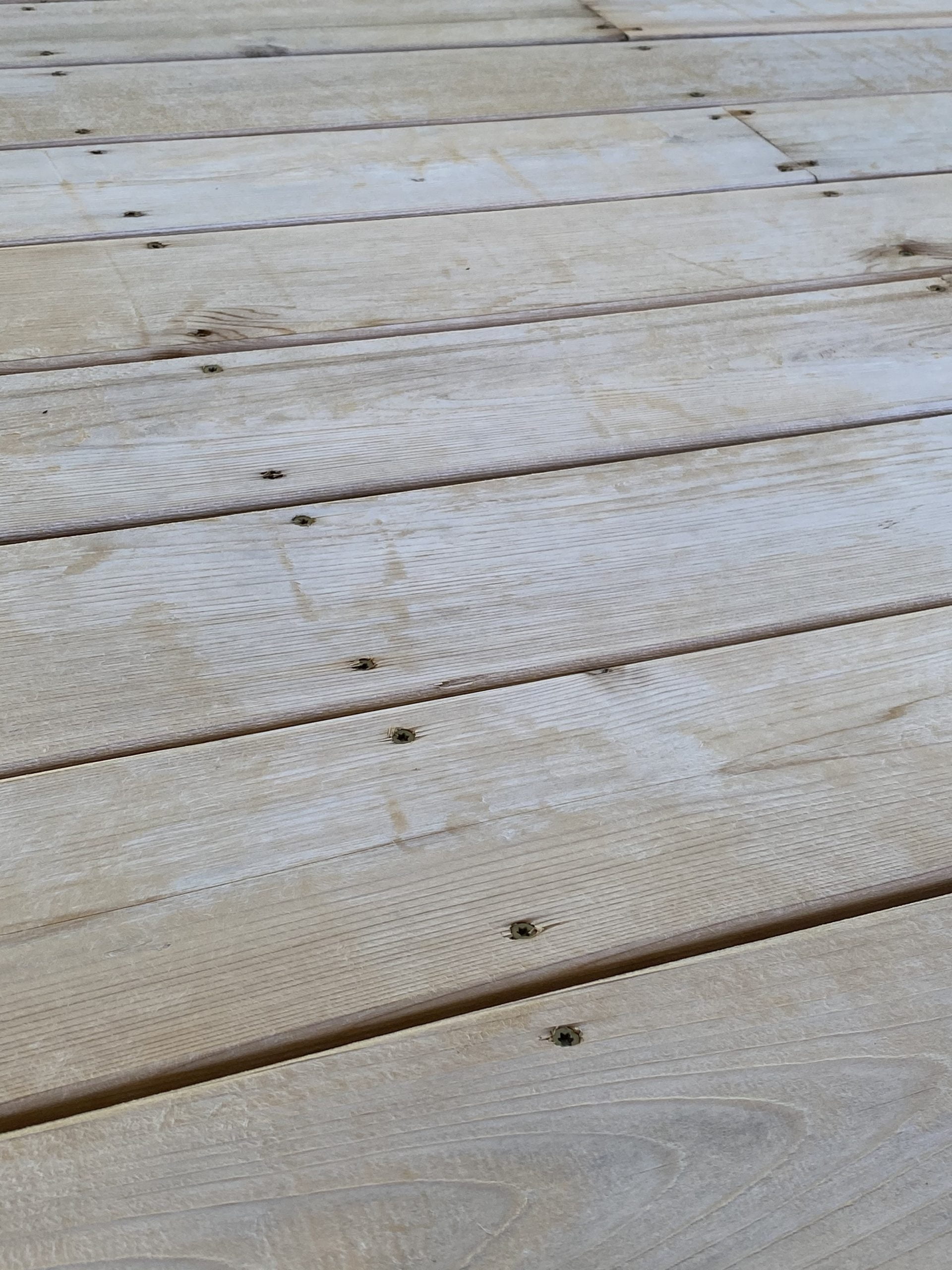

Hi. We had our contractor stain our deck. New wood, PT pine (had weathered for 8 months), full sun. They sanded and then used Restore a Deck cleaner and brightener, waited a week for the elements to cooperate, and then stained with TWP 100 Cedar 101, one coat as the TWP website says. We followed everything per that website, but it came out splotchy and uneven. Please advise what might have happened and how it can be fixed. Thank you. (attaching pictures for help)
Becky King
Becky King
Thank you for your answer. Does “grayed” mean it had actually turned a grayish color? Ours had not, it was actually much lighter than when built, like the sun had bleached it out… I was actually wondering if we needed to brighten but did so per their website’s instructions.

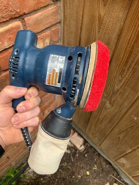

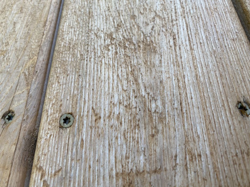

I tried this technique this weekend using a Clarke Ultra Speed Pro 1500 and red buff pad. Even with light pressure the pad was leaving the red coloring on the deck from the pad. Any thoughts as to why this would be? Ultimately I had to use an Osborn brush which removed the coloring and fuzzies. Thank you for this website. Incredible resource

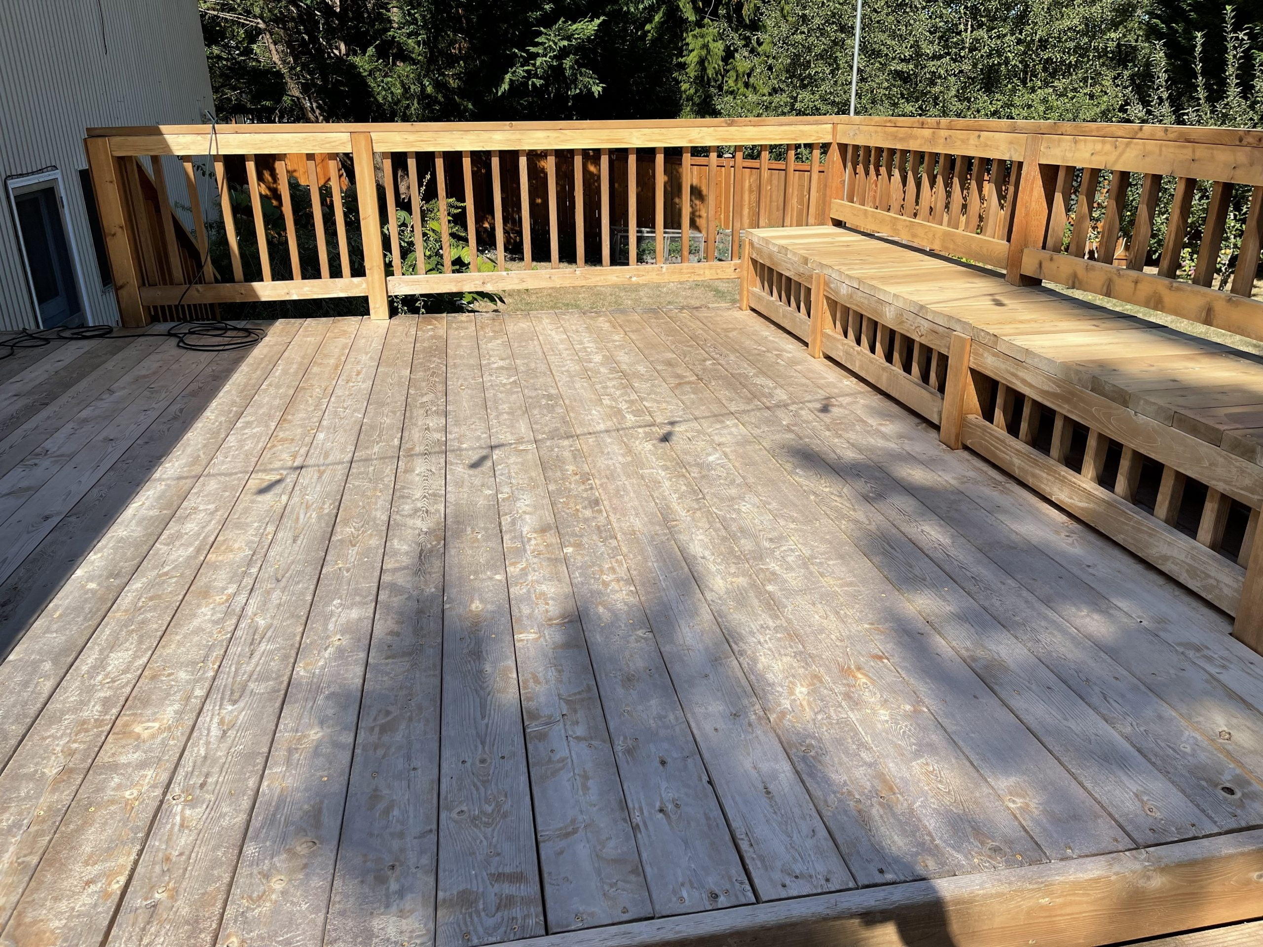

Kiln dryed cedar deck & railings, how long should I wait before staining with A/C semi-transparent? What about prep and best way to apply?

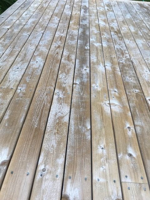

Now that it’s dried, the fence is almost white. Did the oxalic acid not neutralize? or do i need to go rinse harder? i’ll attach some photos, please help me! this is a commercial contract i’m trying to secure for flatwork and the fence was just a one time addition but now i’m worried!

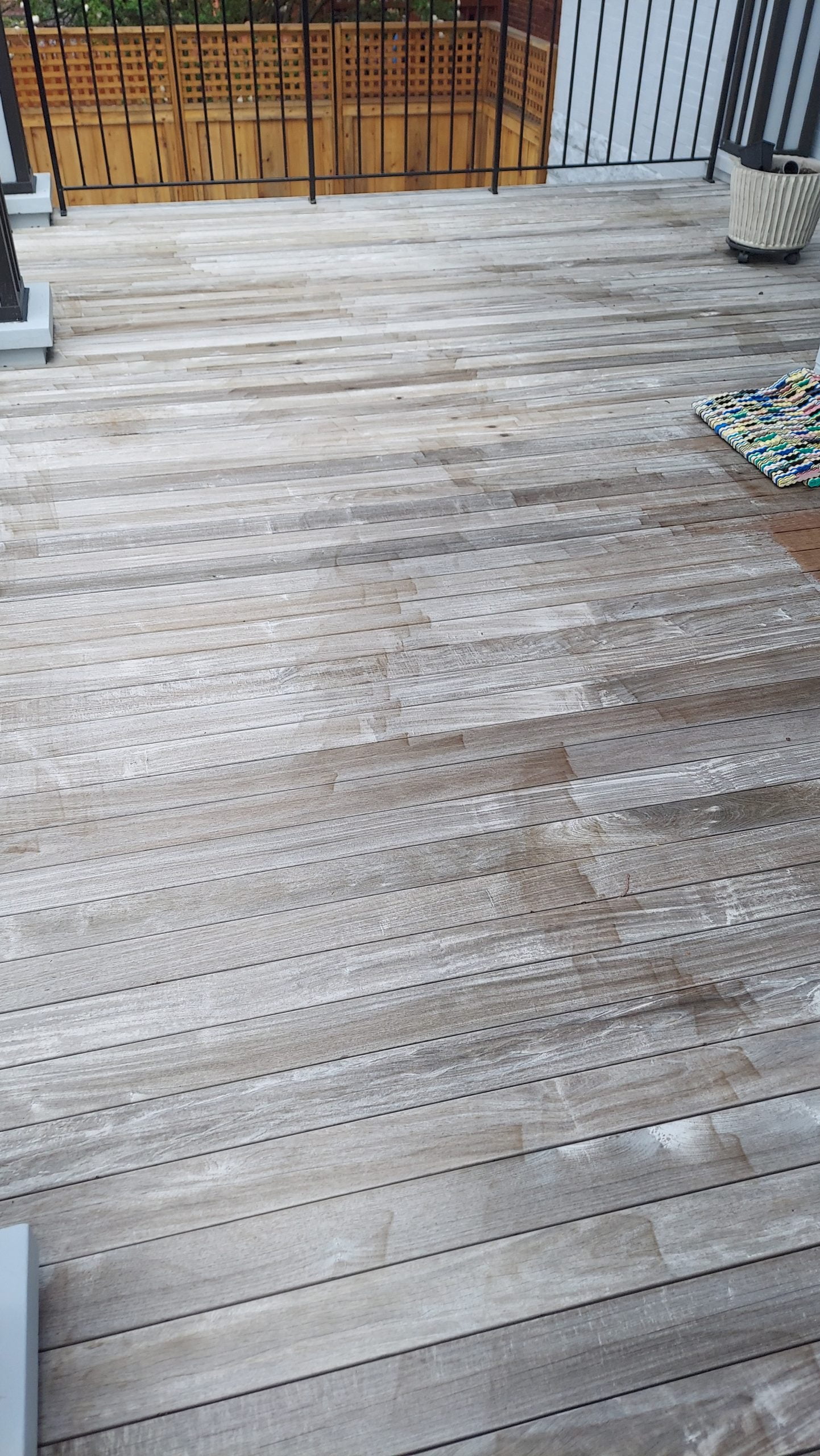

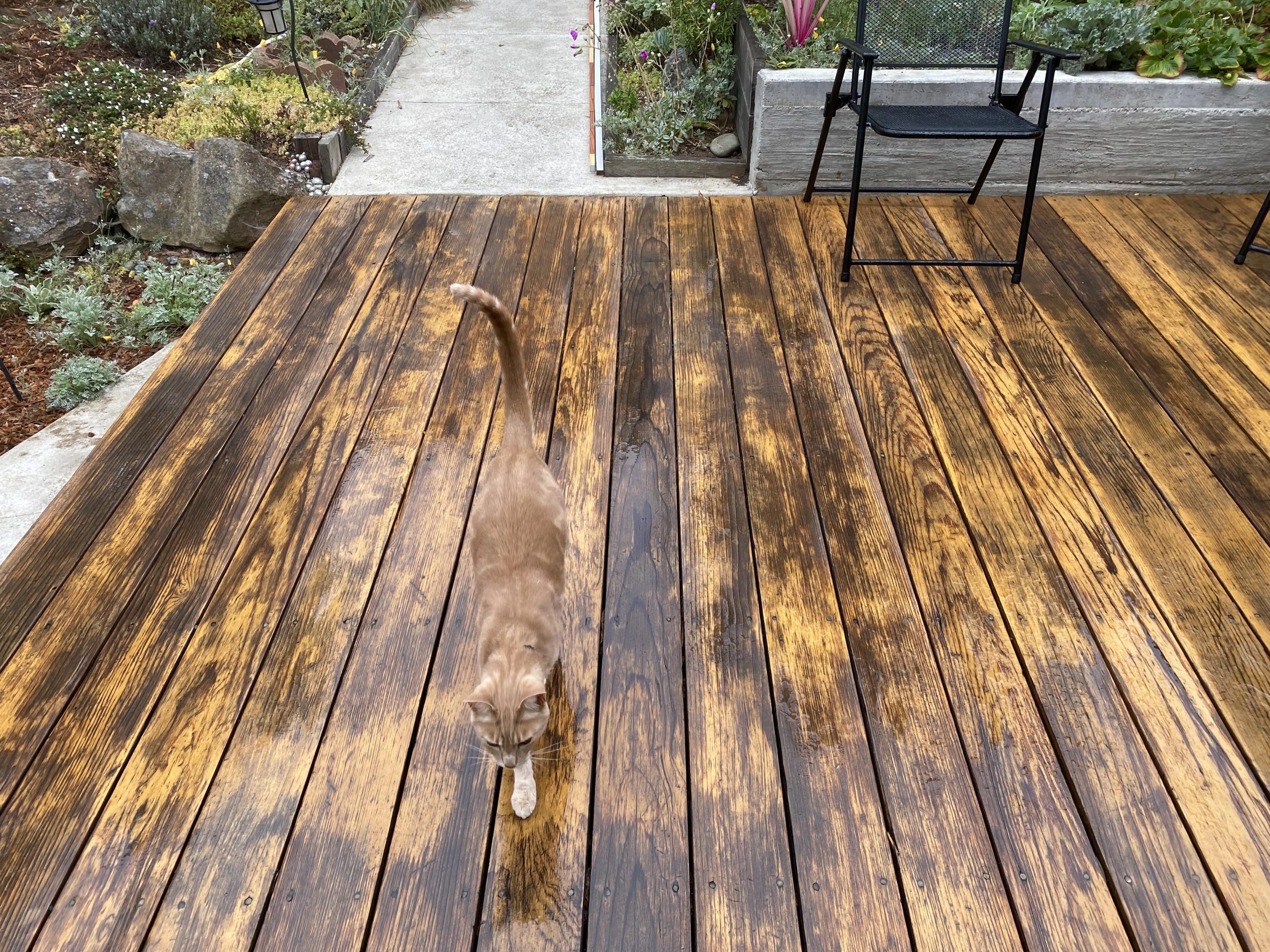

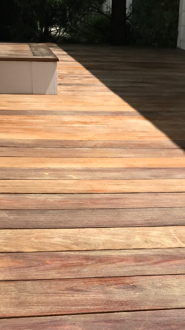

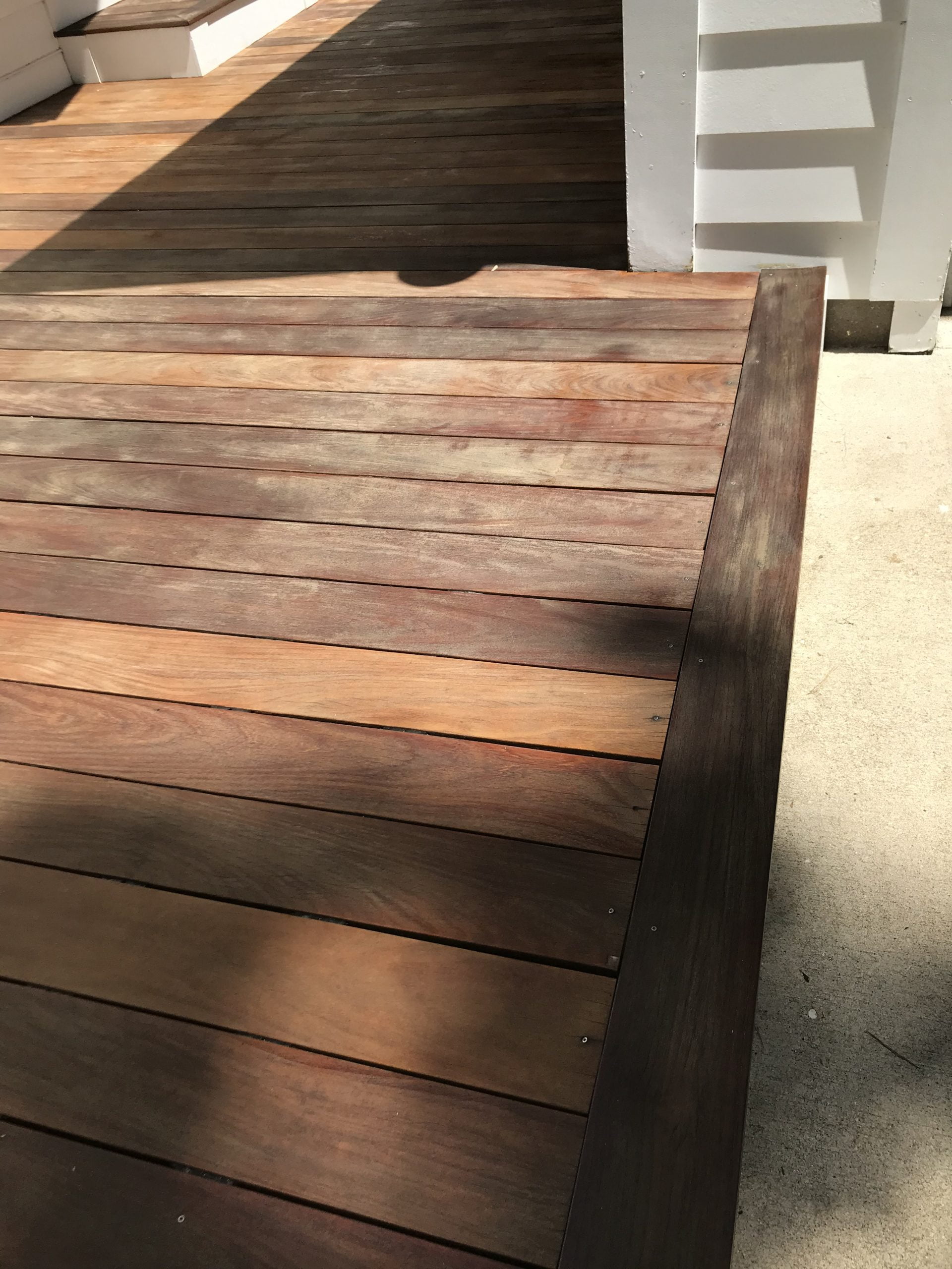

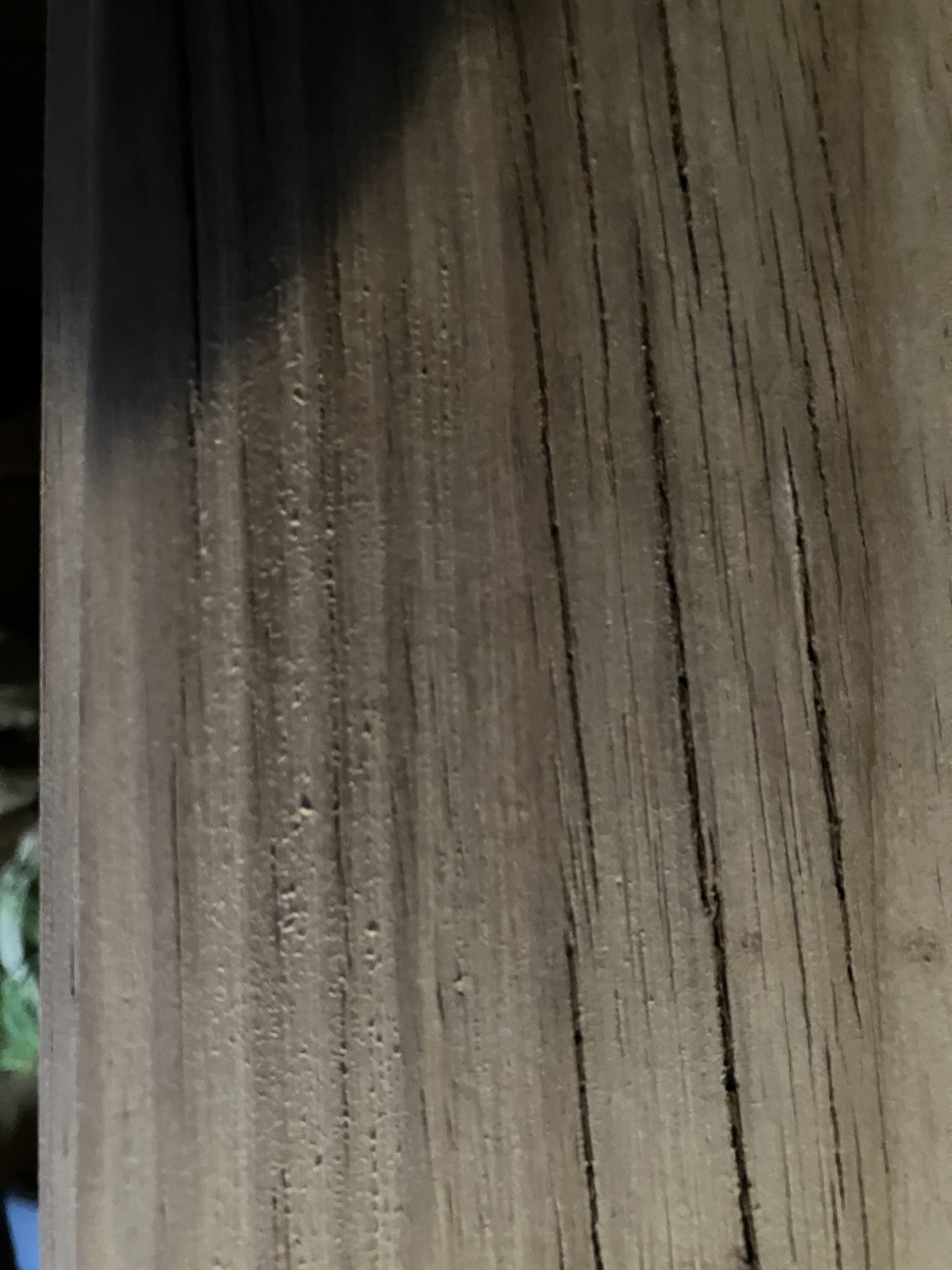

I had my large IPE deck power washed and it turned a yellowish color with fuzzies.
What caused it to turn yellow?
Can the yellow be removed?
How do you remove the fuzzies as well?

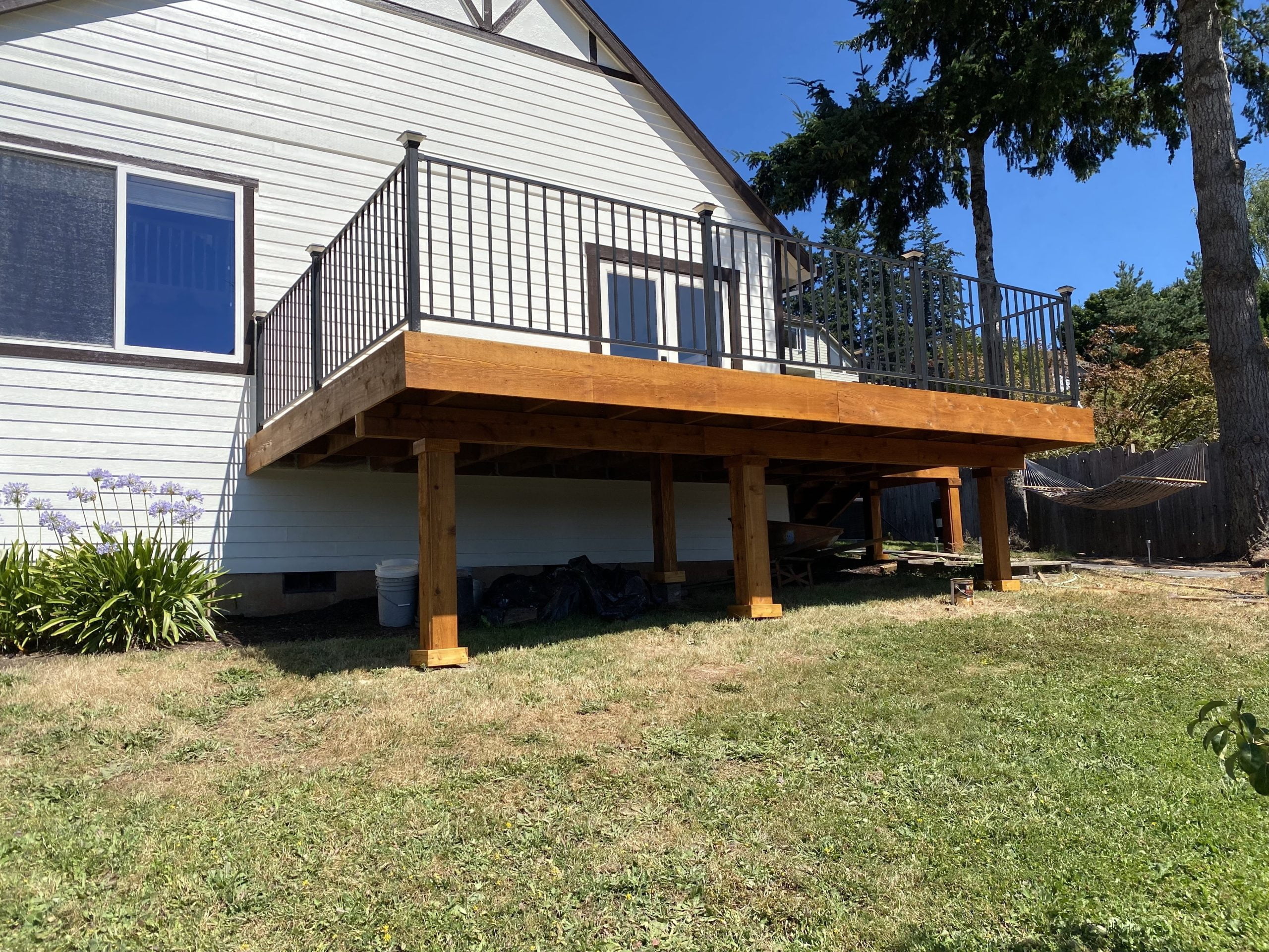

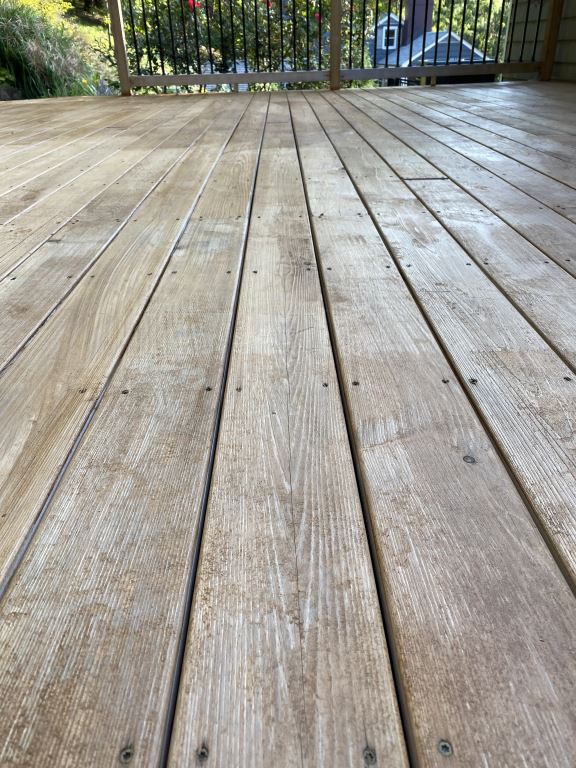

Hi Scott. Cedar deck exactly 12 months old. Let it weather for a year. It’s on south side of house so received lots of sun. After using cleaner and brightener it looked great. And then lots of fuzzies showed up after it dried (see pic). I didn’t sand at all. OK to go ahead and use TWP cedar stain now? Or should I sand first? Thanks !
André M
André M
Thank you ! PS when you say “new wood” should only get one coat of TWP, how do we define “new”? 3 months old? 6 months old? 12 months?

Thanks Scott ! Your website is truly invaluable, thanks for all that you do. PS the deck turned out great I think (used TWP 1500 cedar, one coat).

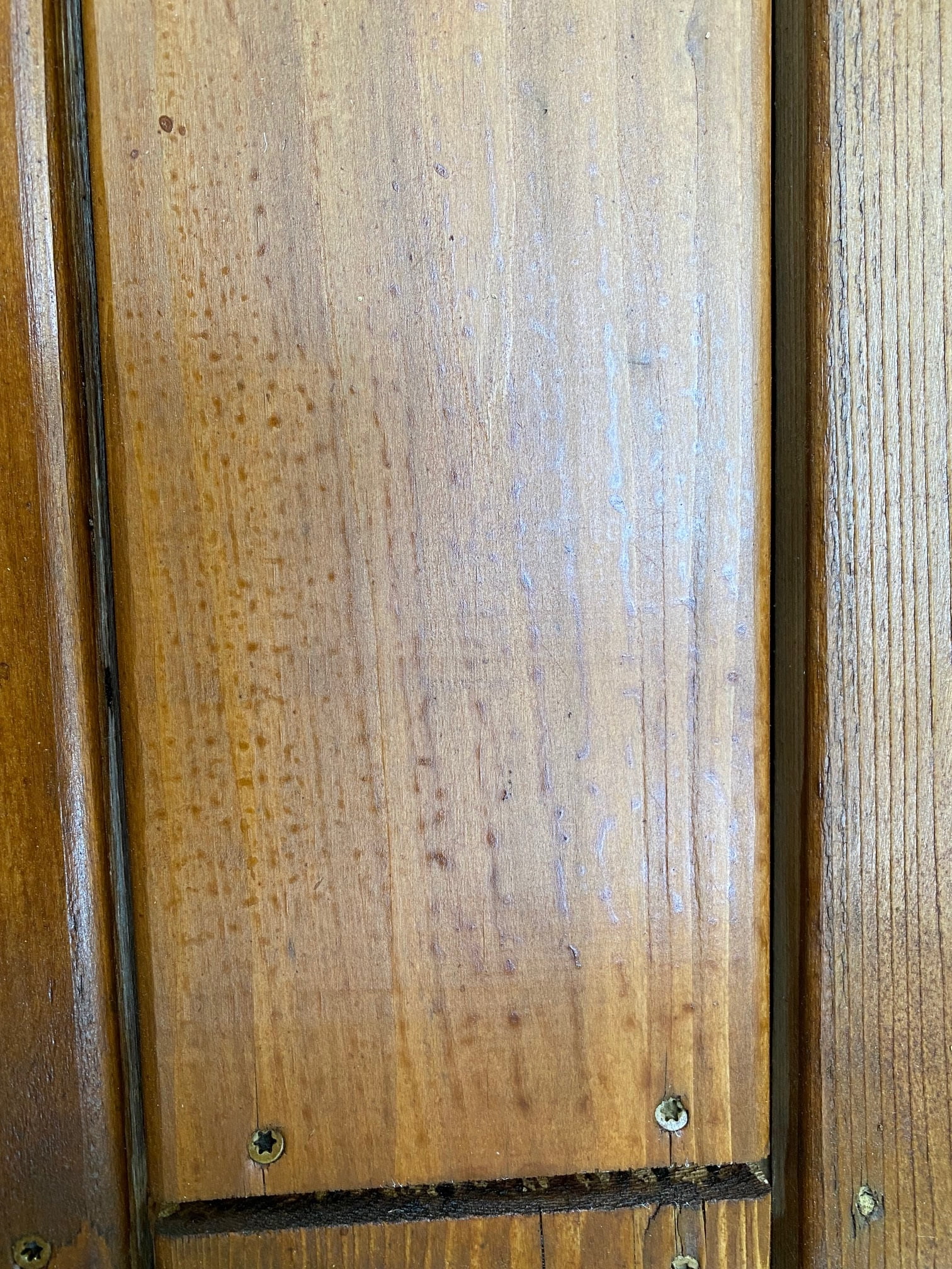

Hello – refinishing vertical barn doors, looks like rough cut pine wood. I used RAD stripper + brightener. There are some fuzzies left on the doors. I plan to use RAD semi-transparent light walnut finish.
Should I try to hit these with 60-80 grit palm sander or go directly to stain? Or maybe try to modify the buffing pad from above to fit on orbital?

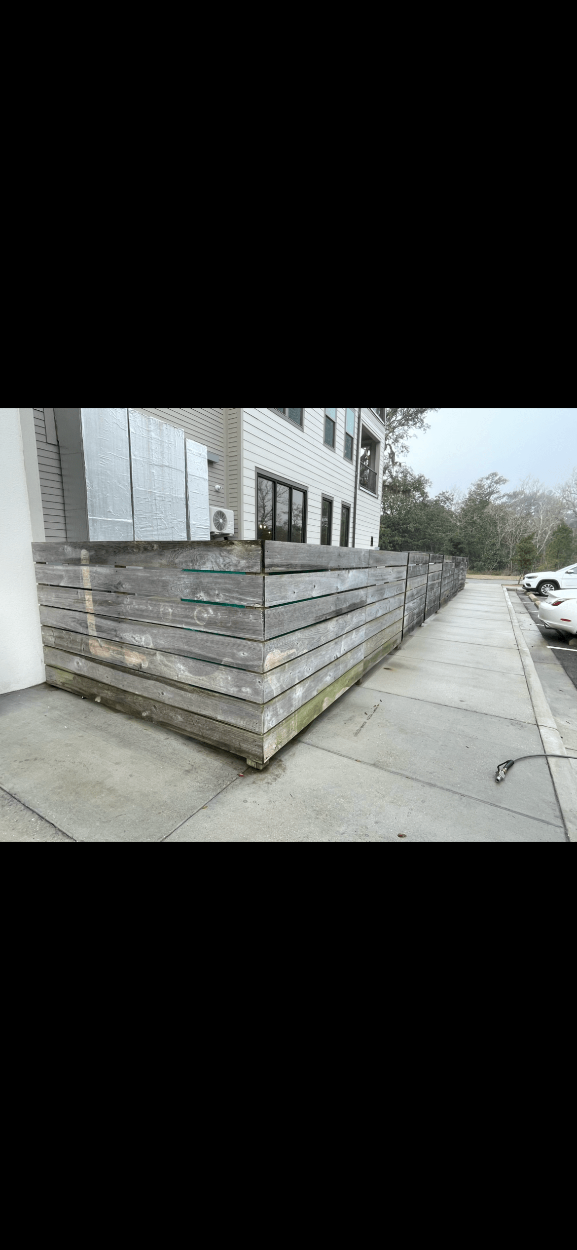

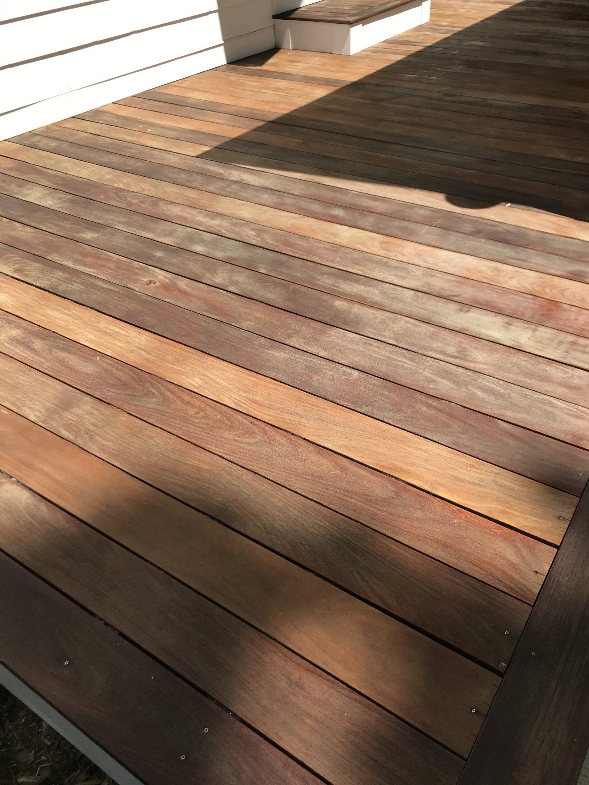

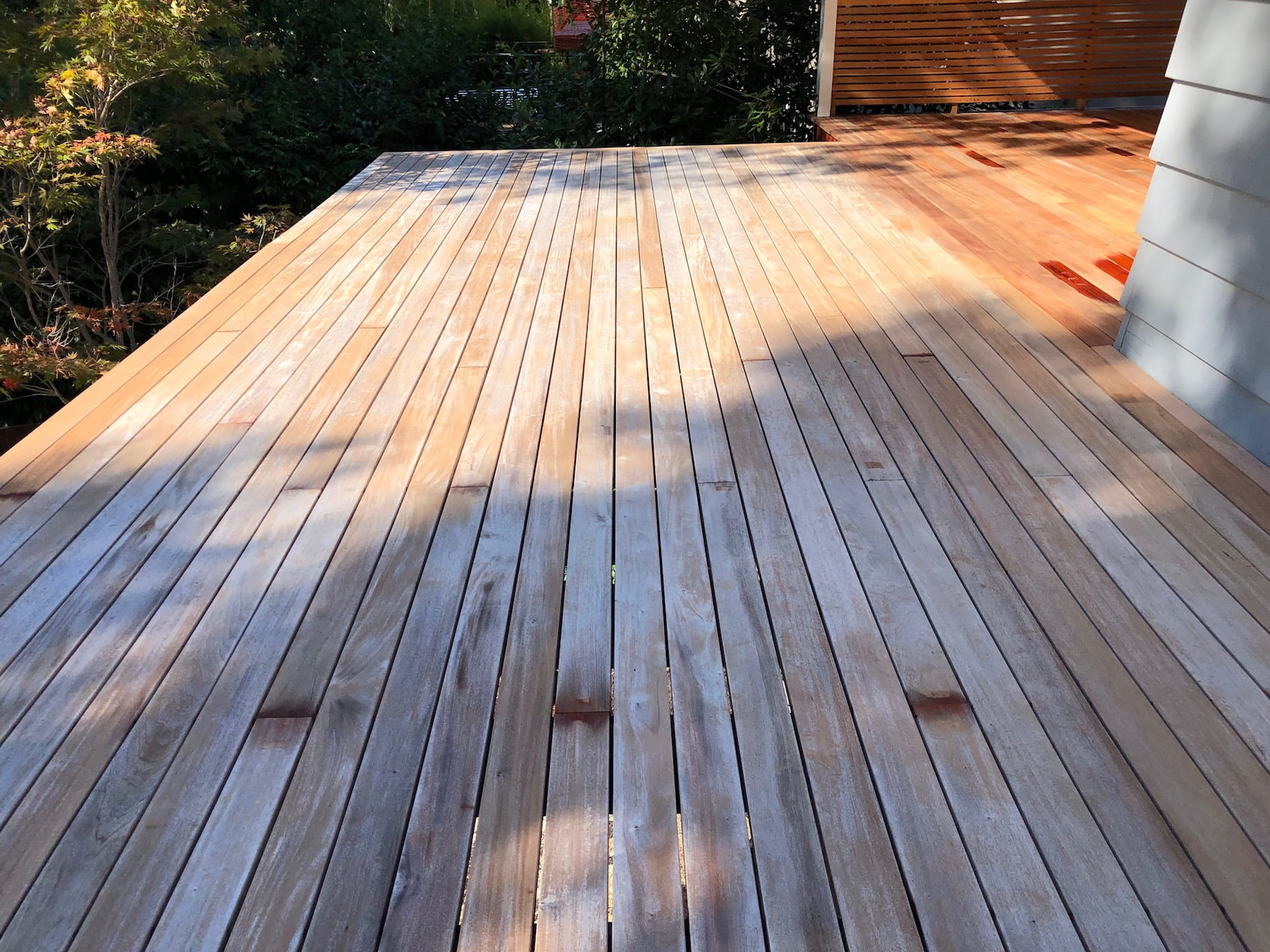

I have a customer that had another company come to clean an ipe deck that we installed several years ago. It was never stained and had no finish applied to it. This other company seems to haphazardly power washed it. It now has all sorts of white streaking and obviously visible signs of power washing. I have used the 2 part cleaner and brightener previously but I’ve never gas to address this type of damage. Wondering if I will need to sand this all out or not

I am a Painting Contractor, and refer to this site frequently. Thank you for many years of sound advice! I am preparing to re-stain the sunny front of an old Victorian. The house may be old, but it has merely 12 year old, pristine 3 1/2″ wide cedar tongue and groove all over the front from a complete remodel. I could not find the old stain can the previous contractor used, but the existing stain sure looks like a latex, slightly-colored transparent stain on the surface, probably Arborcoat. The stain is almost all gone on the sunny front, with occasional little crystals of stain sitting up on the surface. I am not looking forward to making the pristine wood fuzzy when I strip! Also, the cedar profile, though not fuzzy, is no longer smooth, as the ‘ribs’ of the grain protrude, likely because the latex stain failed so long ago that the wood weathered down. I like the look, but I think using a sanding sponge after stripping and using a a wood brightener are sound advice. Will the stripper remain the vertical surface? I’m alternatively considering just sanding and brightening, without the stripper, but then the profile may not look so great. Thoughts?
There is a protected entry stairs where the walls are also stained, but the stain looks perfect here, except for the beginning of the entry, where the boards start out weathered, due to the sun reaching the beginning of the entry. Will I even be able to strip the sound protected area?
There is a big ipe deck we are not touching, except they want the ipe fence cap painted. I see the specs call for 2 coats oil-base primer for painting ipe, followed by 100% acrylic paint, and prayers!

Do you have any recommendation of what floor buffer to purchase. I am not a big fan of renting any large equipment. Alternatively would a drywall sander do it? Thanks.
b3ll0v1c
b3ll0v1c
I saw you also recommended a sanding pole in other posts. Sanding poles are mainly made for drywalls and tend to swivel a lot which makes it difficult to keep it straight on a deck board. I tried. Any suggestion? Great site, BTW, very useful!

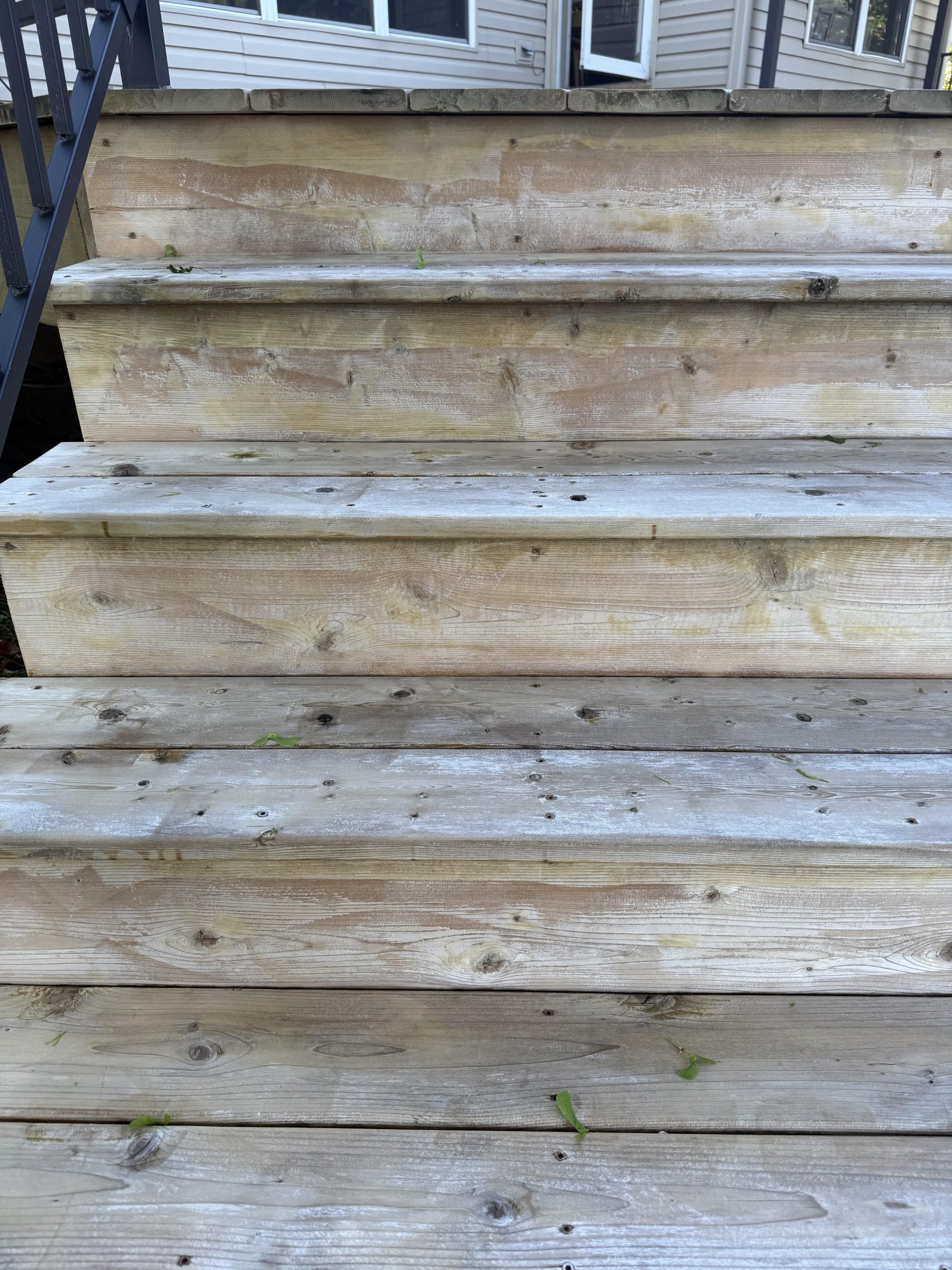

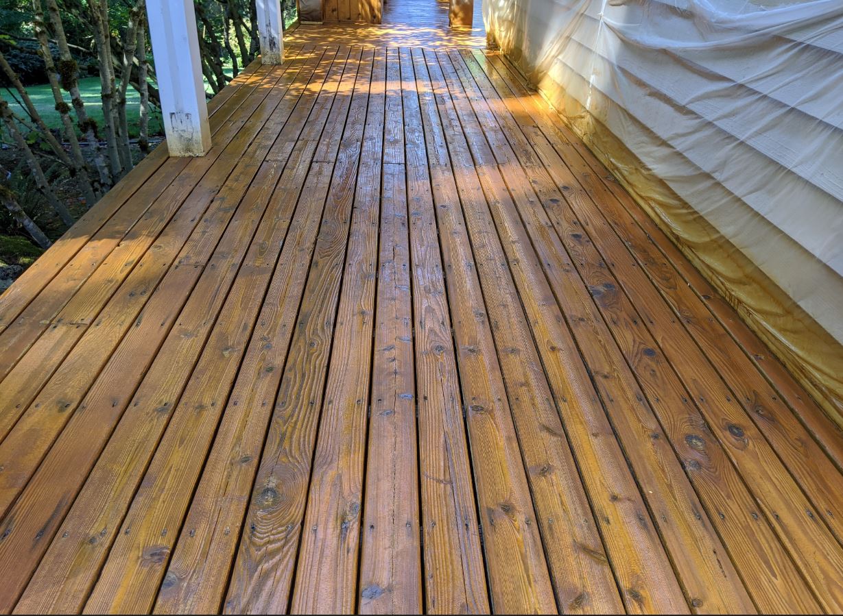

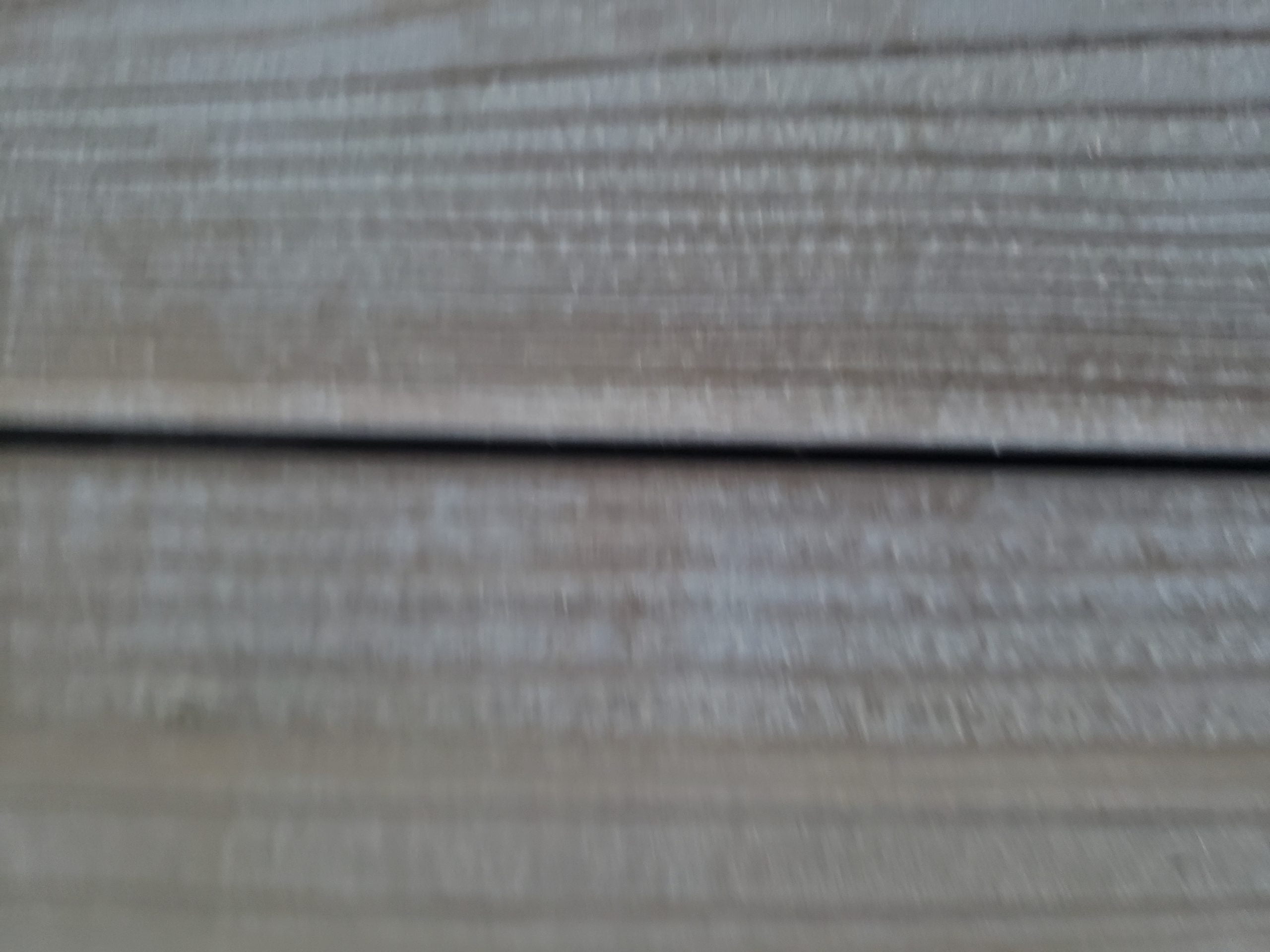

Hey sorry last question! So here’s what the deck looks like after cleaning. I posted 2 pics. The first is direct sunlight thr second shows how 1/2 of it looks out of direct sun. I’m sanding it next. As you can see it’s not grey or darkened but mostly a washed out pale yellow to whitish tone. It’s odd because later in the day or out of direct sunlight the deck looks really smooth and clean but in direct sun hitting different parts of it throughout the day you can really see the patchiness. My question is, after sanding off the fuzzies, will the brightener help bring the wood back to its more natural deep cedar tone and even out the patchiness we see or does that really matter if we’re re staining with a semi transparent Pecan pigmented penetrating oil stain like TWP?
Ben
Ben
Sorry here are those pics to go along with my last question….

I have cleaned ( with BEHR All in One Wood Cleaner) and power washed (not on hardest setting) our cedar deck and the deck boards look great, however the walls look like cedar with grey patches…I am wondering whether to stain or seal the deck boards and if I should wait to do the the walls to let the red grey a bit to catch up to some of the grey patches? Or do I need to try and clean the walls again? I do like the look of cedar but want to know if I need to let this go to get back to the beauty of the wood
The cedar deck is about 5 years old but does not get much sun as I live on a ravine and this deck butts up against the it.
Here are some pictures of deck boards wet and dried/the walls dried after cleaned and power washed and the setting the deck butts up against.
Donna
Donna
Donna
Thank you sooooooo much!!! This is super helpful information as the deck is very large 15X40 (in my opinion 🙂 and we love living on the ravinebut do not like what it has done over time to the cedar deck…I will absolutely follow your expert advice and do this today…very much appreciated and I might utilize this site again when it comes to the next step of to seal, oil or to stain?

I sanded by deck with 80 grit to remove 2 coats of solid stain a month ago. I blew off the sanding dust and washed deck with a garden hose. The wood looks clean with no stains or mildew on it.. I plan on using RAD cleaner and brightener, if needed, before using RAD solid stain on the deck. I have several concerns.
1 Do I really need to use a cleaner and brightener if I am using a solid stain?
2 I read that the cleaner will cause furring and I would have to buff all of it off. I am elderly and have no one to help me. Also I have no way of renting a buffer and transporting it from the rental place. How can I prevent furring so I do not need to do the extra work?
3 If I need to use a cleaner and brightener can I still do it after the deck has been sitting without any prep work done on it?
4 I can not stain the same day if I do the prep work. Is that ok?
5 Do I need to use a pressure washer or can I use a garden hose with a strong spray nozzle?
Attached is a picture of the deck after sanding. There is some spots where I could not get the old gray stain off. I would appreciate any help you can give me.

I have a new clear cedar deck that is 4 months old. I did a restore a deck cleaner and brightener. It had a lot of the white fuzzies on it so I tried a buffer but that didnt do anything then i tried power washing it gently (not too close to the wood) and made sure it was rinsed really well. It did look good when wet so the next day I put 1 coat of restore a deck semi transparent cedar stain temp was 70 deg no sun. it is a large deck. This is what the entire deck looks like the next day.
What do recommend I do? should I put another coat on it, etc?
Also can I wait until spring time since it is fall now?
Thanks Harry
Harry White
Harry White
thanks will the remaining fuzzies go smooth with time or will the spring cleaning help get rid of them?
These are what it looked like prior to the final pressure wash. there were still a lot there though before i stained?
i read if it look good when wet they it was ok the fuzzies are mostly cosmetic?

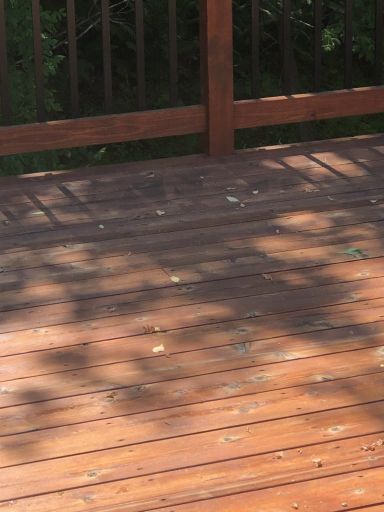

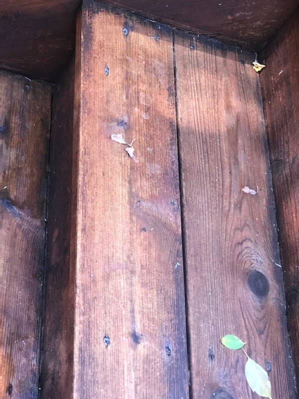

Hi, your tips worked. thanks….Deck is finally restained and looks nice. except for one issue.
It is a large deck and 1 place (of course right in front of the door) has a 2 foot section where i didnt get the excess stain off.
it left little stain dots. plz see my picture.
what is the best way to remove this?
I read to wipe it with lint free range and paint thinner and then lightly reapply?
but they didnt give details like how long to rub it, do you clean the thinner off with water and let dry before you reapply the stain etc…. thanks harry.

Hi again, I’ve called a couple of rental places and they haven’t heard of sanding buffing pads. Anything else you can tell me so I get the right pads? Thanks.

Hello, we had a 13′ x 17′ red cedar deck installed in July 2015, it looked gorgeous and smelled even better! August 2016 we were finally able to stain and protect. We power-washed the greying off deck (perhaps a little too aggressively), then used “C2 Guard Waterproofer Ultimate Wood Protection” (this stuff is NOT cheap at $115.00/gallon). It was recommended by our deck builder, so we bought it. The application is a “wet on damp” procedure, then second coat goes on while first coat is still damp. It took 2 gallons and looked good. We didn’t get all the areas around the edges, posts and sidewalls done because I ran out of energy and C2. Fall of 2017, I was about to protect the rest of the wood that wasn’t done the previous year, but someone insisted he had to power wash (again too aggressively) in order to have “everything looking the same”. Took another 2 coats of C2 after the power wash, and looked only ok this time. Fall 2018, floor of deck doesn’t look too great, so another light power wash and another gallon of C2. Fall 2019, you guessed it, another power wash and another gallon of C2. It is only on the horizontal areas though – floor of deck, top of the railings, and bottom of spindles that are looking crappy, the upright areas look great. Here we are fall of 2020, and after reading copious online Q&As, we are hesitant to sink more $$$ into this deck with C2. If you think we should stay with C2 Guard, we will. We have already put 6 gallons of C2 Guard into this deck and it looks horrible, but what to do? I would love the deck to all look like the vertical areas, but not sure how to get there. We did a water test yesterday and it beads in most places, only a few spots where the water sinks quicker, but not too quickly.
We would appreciate any insight or suggestions. Attached are photos of the current ugly deck, and 1 from 2018 showing it’s not looking good.
Isobel
Isobel
I was rather afraid you were going to say that 🙁 OK, well we now have a project for next spring! Where to buy the RAD and TWP 200 in Canada and how much will we need for the 13×17′ deck? Do we have to do the upright areas that look nice or just the horizontal ugly areas?

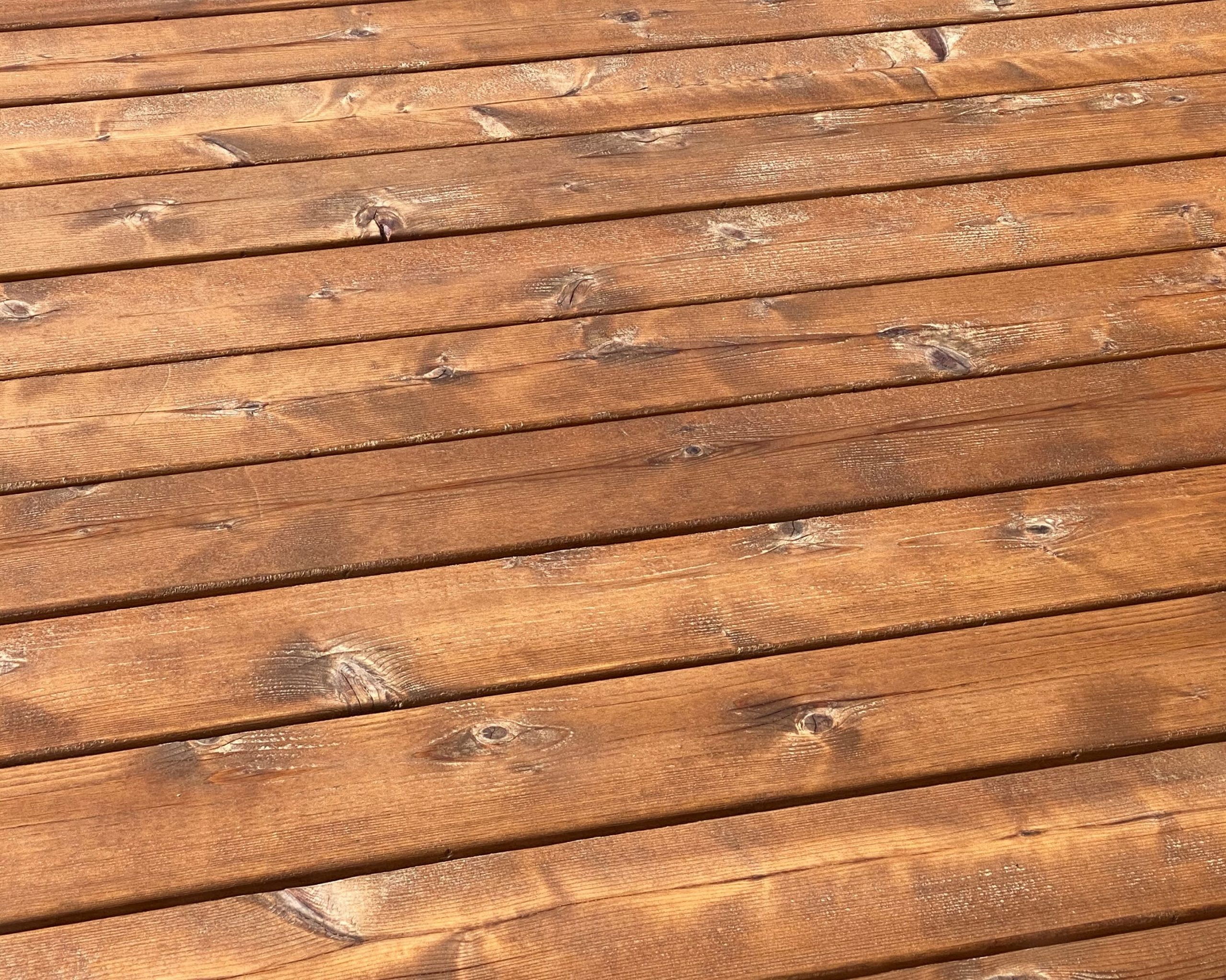

mike
mike
I’m having some troubles with furring on my deck after i stained. the deck is about 2 years old now.
I power washed then used a strip and stain remover, washed with a garden hose. Then used super deck Revive and brighter then washed the deck again (all shirwin willamns products). I then noticed deck furring. I used 150 grit sand paper paper sanded everything down. I stained the deck with oil based superdeck transparent stain. It looks horrible. the deck has fuzzy spots everywhere. Before i stained i thought i took care of all the deck furring. Any suggestion of what i should do next?
Do i need to start over and strip / revive the deck again?
Can i stand then re stain those spots?

My husband power washed the deck and we now have a lot of fuzzes.
I plan to rent a floor buffer so whats the best way to tackle this project?
Should I buff the deck first, then brighten then stain?
Amelia
Amelia
Do you think I could skip the brightening step. I will attach pictures.

Do you have a picture of the machine I should rent because when I search it on Home Depot website it brings up about 40 machines

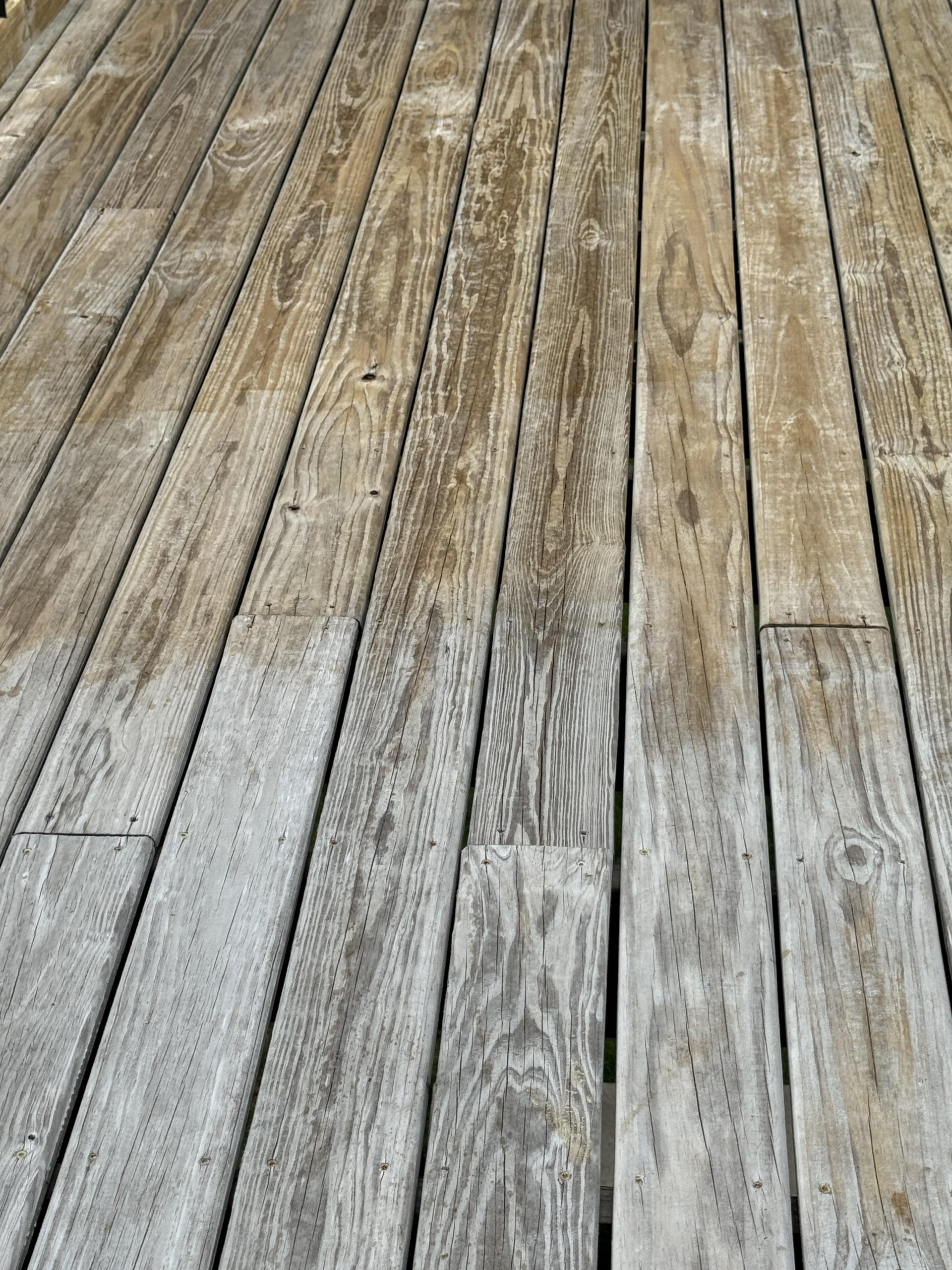

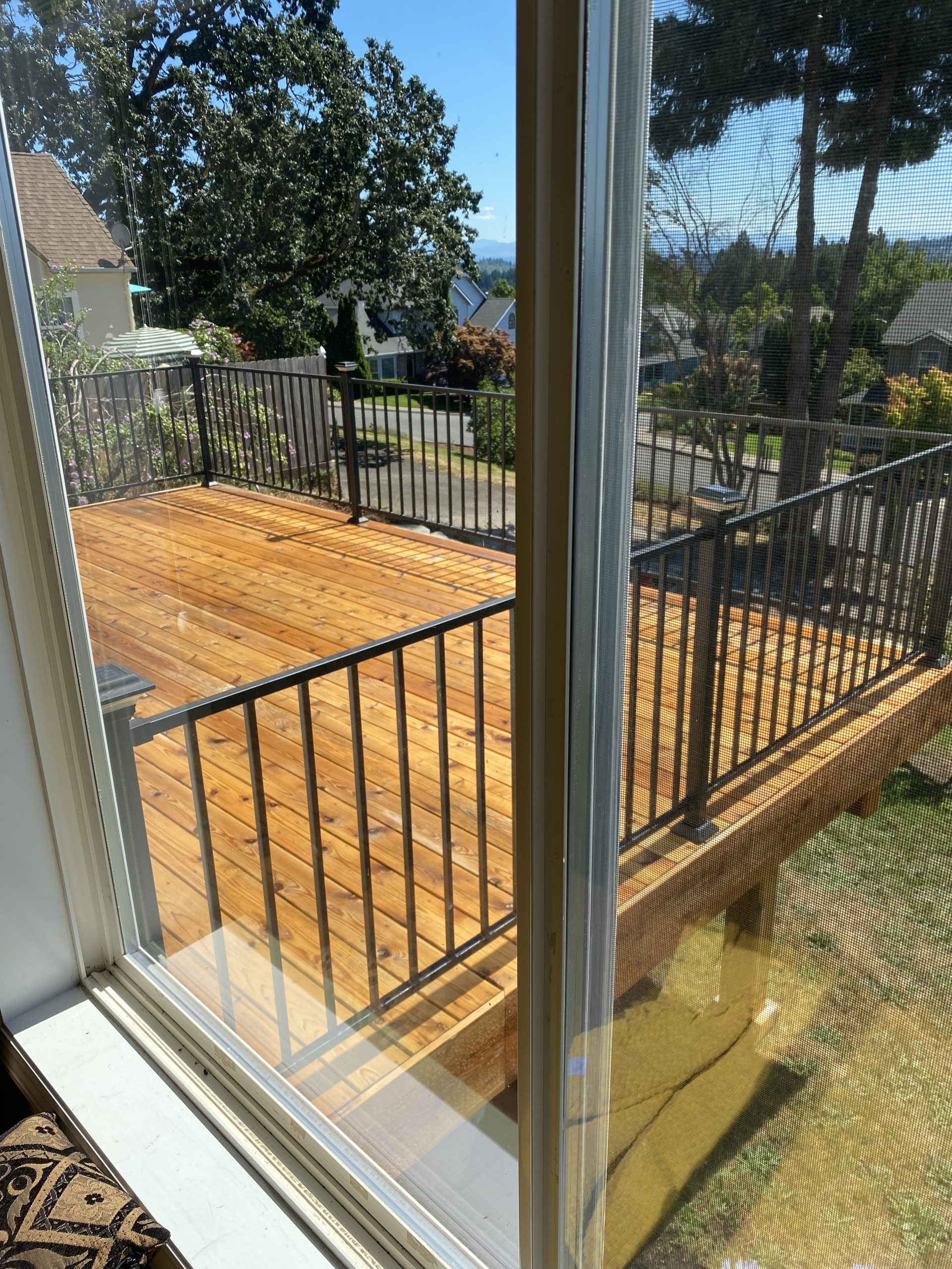

Refinished a deck for a customer and ended up with horrible mess of furring that I didn’t notice until AFTER the oil based product was put on! I really thought I studied and read and talked to enough people to know what I was doing…..To prep I stripped with Valspar deck stripper, rinsed thoroughly with sprayer (not pressure washer) and could still feel a “slime” (supposably no other product was needed to neutralize it, just water) so I called the customer service no# for the valspar and they said just rinse with True Green Cleaner to neutralize it. Five days later (today) I went back to stain it and noticed a slight furring so I sanded it lightly with a palm sander 60 grit. I didn’t think the slight amount left was anything uncommon so I applied the oil transparent and within half hour it began drying horribly. What now? I assume wait several day for it to dry ? and re-sand with ? and then lightly wipe on some more oil stain ? maybe ? OMG I’m in a panic.
Teri Jo LaChonce
Teri Jo LaChonce
oh my… why wouldn’t I just be able to sand/buff it as is then restain it? knowing the stain will only stick to any particles of wood that have been stripped via the sanding process.
Teri Jo LaChonce
Teri Jo LaChonce
I treated it as if it were any wood project: the first coat needs a light sanding to smooth it out, then re apply a top coat. Yea, diff. product altogether but worth a shot. It worked excellent. So far. Seemed to be drying down good. I went very sparingly on the “second” coat… a 400 sq. deck only used about 1/5 of a gallon.

I have moderate fuzzies after stripping & brightening a 30+ year old cedar deck. More fuzzies on the vertical paneling and railings/spindles than the flooring, for some reason, so a floor buffer won’t help. Planning to stain with TWP 100.
After reading through most of this Q&A, I am still left wondering:
1. Why not just cut a 17-inch buffer pad down to 5-inches and glue to a random-orbit sander disc?
2. If that’s an option, which color buffing pad — red or white?
Rob
Rob
Will do.
One other related question…
I did a quick test by hand, buffing a small area with a Scotch-Brite pad (which I think is similar material), and while it did remove a lot of the fuzzies, it also left the wood surface glossy.
This makes me wonder if the buffing left the wood less able to absorb the stain.
There are a lot of comments in this thread about brightening after sanding, but I got the impression you don’t brighten after buffing.
So question is, do you find that buffing negatively impacts stain penetration? If yes, do you normally re-apply brightener to compensate? If no, I assume I just buff and then rinse with water.
Rob
Rob
OK, so I spent $7 on the 17-inch red floor buffer pad at Home Depot, cut out a 5-inch circle and glued it with Gorilla Glue to a sanding disc for my random-orbit sander.
A few observations:
1. It was very easy to do and technically worked as a hand-held buffer. See photo.
2. It seemed quite a bit less aggressive than the Scotch-Brite scouring pad, which I’d say was more effective but also left a more glossy surface.
3. It took off the most egregious fuzzies fairly easily, but left a lot. See middle board in photos. This may have been my technique as I did not apply a ton of pressure.
4. Perhaps a lot of the “smaller” fuzzies are just normal raised grain that I shouldn’t have been worried about in the first place?
5. For the railings, a light hand sanding with 80-grit was just as effective if not more so, but also took off quite a lot more wood.
Overall, not really sure how much difference it will make. In my case, most of the boards didn’t have as many fuzzies as the one in the photo, so the results weren’t really that noticeable.
Perhaps the experts here could comment on #4, above?
Thanks to everyone here for all the guidance. Hope this is helpful.

How did it turn out? I had very minimal furring on the deck, I mean, I had to crouch down and REALLY look to see ANY… but I lightly sanded it down “just to be safe” yet after applying an oil base stain it looks horrible and I’m in a panic! Oil, so it’s going to take quite a while to dry (assuming my solution is to buff it down after it’s dry and try to re apply stain and hope to hell it does something.) IDK. I’m a painter not a deck refinisher but was talked into this project. I did a lot of reading and calling and it seemed pretty simple and just common sense. Yet, here I am.
Rob
Rob
I had mixed results. Mostly it looked good. In some cases it was noticeable but not really terrible looking. In just few spots, it looked kind of bad. Seemed to depend a lot on the differences in the wood. It’s a 30+ year old deck and seems to have had some of the wood replaced over time. The stain absorbed very differently in some of the boards.
I’m sure the experts here could comment more intelligently. I’ve never done this before either, and frankly was surprised at how many landmines I ran into during the whole process, so I can emphasize with your panic (though in my case, it’s my own deck, and I would say overall I’m satisfied with it despite some of the imperfections).
Rob
Rob
Yes, I should clarify that overall it does look great and I am very happy with it. You have to be closer or looking with a critical eye to see the imperfections, and frankly I am probably the only person who will ever notice them!

Refresh: deck had rain on it 3 hours after being stained
Now has spotting. Can it be touched up after it dries or can a light coat of stain be applied?
The reply was to start over. Could you clarify in detail?
Would touching up or lightly coating work?
Karen Carlson
Karen Carlson
Central Mn. Powerwashed deck. Let it thoroughly dry. Applied semi trans stain with brushes. A sudden burst of unexpected rain came up 3 hours after we finished.
This mornind there are water spots in some areas especially where the deck was shaded.
How to proceed with getting rid of spotting???
Karen Carlson
Karen Carlson
Do you mean strip stain? Can we let it dry and touch up spots? Can we put on a light coat of stain over all floor surfaces?
Karen Carlson
Karen Carlson
Pictures of spotting
Karen Carlson
Karen Carlson

So we are cleaning 3000 sq ft of fence and getting the furries. Can we just use semi over it or do we really need to sand? 😕

We recently built our house/deck coming up on 2 years. First time power washing it and I’m wondering if we were too rough, I’m afraid I took too much off. It’s a cedar deck and kind of looks uneven..and there are some fuzzies. After power washing, used a deck cleaner and scrub brush, and now sanding. Will it look good with just a sealant on it or should i do a semi-transparent stain?
Brittany
Brittany
Reply to  Brittany
Pics
Rose
Rose
Help! My husband pressure washed our new untreated unsealed deck staircase including steps and railing. He did so to the point that he etched patterns into wood and knocked out some knots here and there. Wood is fuzzy and covered with splintered wood fragments hanging to wood. Plus loose wood shavings all over floor/steps. He thinks his next step is to stain and thinks this will fix all. I am telling him it needs sanded then gently rinsed free of sawdust. Then stain.
Willie

Yesterday I cleaned my deck with Olympic All -in-one deck cleaner. I scrubbed the deck with a brush while the cleaner was still on it. This morning I noticed a lot of fuzz. I sanded the deck with 80 grit but still have some fuzz left. The pictures below are after sanding. Do you think I should use scrub sand pad on it or do you think it is ok to stain. Thank you advance for you help.
Willie
Willie
Reply to  Willie
Photo after sanding. Sorry can’t send more because the other pictures are over 4MB
Willie
Willie
Reply to  Willie
I adjusted the size of the photos to fit.
Willie
Willie
Reply to  Willie
Pics
Heather
Heather
We cleaned our cedar deck and Re happy with results. We do have wood fuzzies. All we want to do is apply water seal, not a stain. Can we do this over the fuzzies?

Yesterday I cleaned the deck with a bleach-based wash before discovering this site. When the deck is dry, there are parts that appear with splotchy, white patches. But they mostly disappear when I get the deck wet (pictured). Do you think I should go over this again with the Restore-A-Deck cleaner, or is that not necessary?
My next steps were going to be to use the Restore-A-Deck brightener/neutralizer and then a semi-transparent stain. I’m located in Wisconsin and the front half of the deck is in sun most of the day, where the back-half is in sun probably 1/2-3/4 of the day as the sun moves across the sky. The front half of the deck are new, pressure treated boards that I added last year. The back half are the old boards that I flipped and sanded before reattaching. Not sure what the best stain might be? I assume there will always be a bit of a color difference between the old and new boards, but I would prefer a semi-transparent stain, or even a fully transparent stain if it has the UV protection. Thoughts?
thelilpups
Hi there,
I was directed to this excellent article because I need to remove a fair amount of white fuzzies and some residual oxidation (now white vs. gray) from a brand new cedar deck that aged over the winter and then was treated with a cleaning solution and power washed. My takeaway from this article and the discussions that follow is that I’m best off renting a floor buffing machine. At Home Depot I assume this is a orbital “Floor Polisher” as opposed to a “Square Buff Floor Sander”? If this is correct, what color of the 17″ pads do I need? In this discussion I have seen pictures of the red pads but also a mention of the white pads. It doesn’t seem to matter if they are 3M or Diablo as the color coding seemed to be universal? Also, is there any danger of leaving circular marks with this Floor Polishing / Buffing machine?
In addition, I still have a little mold in a few spots. Should I carefully spot treat with a 50/50 bleach solution using a paint brush then rinsing after 5 minutes to avoid damage to the fibers?
Lastly, I plan on brightening, then allowing to dry before staining with a semi-transparent TWP Cedar-tone. Is this the correct final order?
Thanks in advance. Great website!
Lee
Reed
Reed

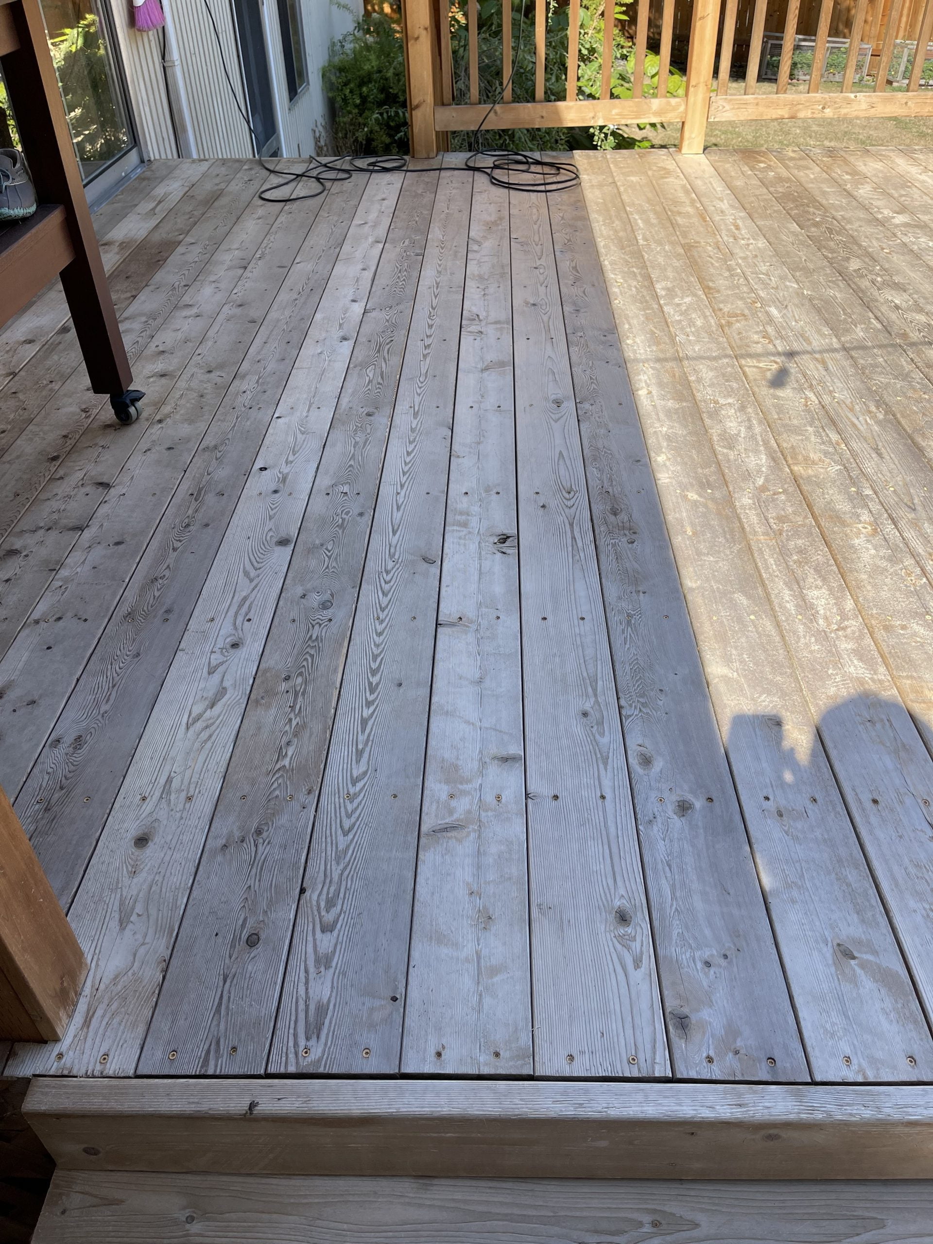

Piggybacking off this comment because it seems to mirror my situation perfectly. I had used a cleaner, but didn’t presoak the deck first because the deck wash I had got didn’t tell me too. I then didn’t let it soak for 3-5 minutes like the bottle said because I was concerned it was drying to fast with the direct sunlight and the hot day. So while I scrubbed it with a stiff bristle brush my wife helped keep the deck wet. Then rinsed it off.
I did NOT use brightener because I didn’t think I needed that (didn’t research much, thought I just had to clean and stain). So, after letting the deck dry I was presented with fuzzies and white residue which I thought was from the cleaner. So the next day I took a orbital sander by hand with 180 grain grit across the entire deck. But still have white spots near the knots. You can see the spots in the picture.
I’m also curious about the dark brown/black spots, but I’m guessing it is because I didn’t let the cleaner sit long enough to work. Sanding those dark spots didn’t change the color.
So my question is, do I hose down the deck with water and apply a brightener or do I just stain over it (plan on using Cabot Australian Timber Oil Natural). The white spots vanish when the deck is rained on or wet, so hoping I can just stain it and be done now that the fuzzies are gone.
NOTE: First picture is after my sanding (current state of deck). Second picture was taken last fall right after the deck was installed for comparison.
Reed
Reed
So I can sneak by with just wetting the deck and applying brightener?
Also, the pic I previously posted apparently wasn’t a current picture. These two are. I’m concerned the white stuff is residual cleaner that is embedded into the wood.
Reed
Reed

We have cleaned our deck with Jo Max deck cleaner, and rinsed using a power washer. Most of our deck we replaced a year ago, so the top of the deck was not that oxidized. We did not replace the steps at that time and when we cleaned the steps we had furries. We have sanded those out, but on the older wood there are powdery bleach spots, Sanding has helped mitigate some of the bleach streaks, but not all. How can the bleach streaks be removed before we put on the sealer?

I just stripped and brightened by my cedar deck over the weekend but have fuzzies I want to take care of. Can I just sand the deck w/ 80 grit to remove them. Also, do I have to ‘re-brighten’?

I power washed my deck without using a cleaner. By the looks of it I still should use a cleaner correct? And then sand it to get rid of the wood fuzzies? What would happen if I didnt get rid of the fuzzies prior to staining and is it ok to wash the deck multiple days prior to staining?
Ashley
Ashley
Should I also scrub the deck while the cleaner is on it? Is it ok to not drain the deck for 5 days-week after it is cleaned?

We followed the advice above and used a floor buffer to remove the fuzzies. It worked amazingly well on the floor. We were very thankful for the advice. Now we need to do the railings and spindles. What do we use to get the same results?

I cleaned and used defy brightener on my 14 month deck today. Hosed off between applications and after brightener. A few hours later the boards under a roof look fine but the boards that are always exposed to sun/weather have many that just look way to white. Do I need to redo any or all the prep or will these stain appropriately.
Ron Harp
Ron Harp
I don’t have a way to post photos, but it looks just like Joe Baker’s below only somewhat less bleached out look. I was sold on Ready Seal Light Oak mostly due to ease of maintenance and re app down the road.

Okay we change stain on our log home from sikkens to Wood guard they stripped the house with stripper and power washer then sand it some of it and now I added stain well it is furring what can we do they claim it will lay down in a couple weeks from the wood guard

Had a spot where it appears cleaner soaled into wood and didn’t rinse away, resulting in a spot where sealer failed, what is the best remedy?

Great – so something like this buffing pad should work? I went to HD yesterday and they didn’t have smaller versions of the buffing pads used on larger orbital floor sanders or buffers. Thanks!
Dale
Dale
Ok thank you. Looks like I’ll need to rent a floor polisher from HD for the day since it appears those types of buffing pads aren’t available on hand orbital sanders.
