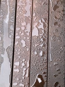

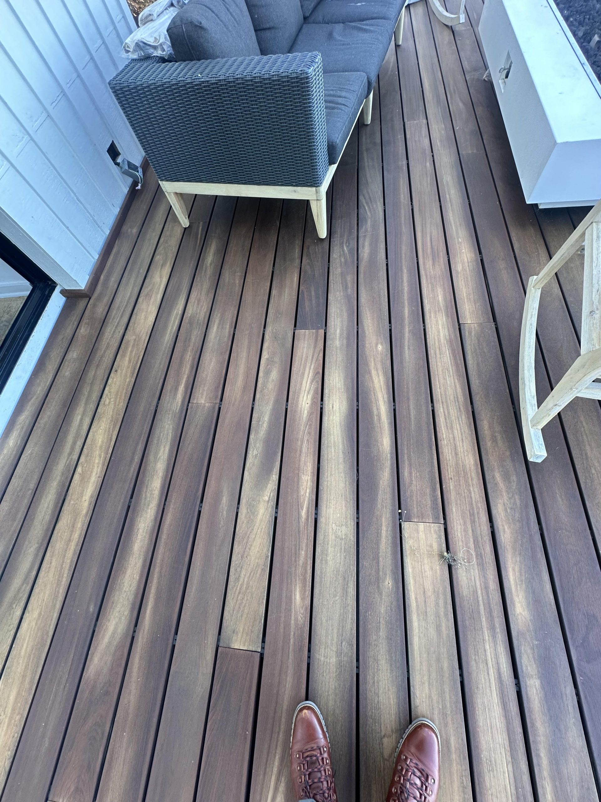

I followed the directions and used Restore-A-Deck stripper and brightener to prepared a 10 year old IPE deck which was previous stained with Flood CWF-Hardwood stain. The temperature is 55 day and 50 overnight. I applied Armstrong-Clark Mahogany with a stain pad and it looks very even when done. Now overnight it seems to be absorbed unevenly to show a lot of wood grain. The stain still not dried and came off if wiped. Should I wipe more stain to the lighter area?
Try applying another coat to one board only end to end and see how it dries over the next couple of days.
Now about 20 hours after the first coat and it started to rain (in San Francisco) and the rain will continue for the next 3 days. I covered the entire (10×13) deck with heavy plastic and will try another coat after dry weather returns. Will let you know how it works.
Uncover it. The rain will not bother it and it needs to cure out.
BTW, after applied the stripper, I used a Palmyra stiff brush on the IPE and a lot of slimy stuff came off, much more than I expected since the old stain from several years ago seemed to have nearly all wore off. After brightener and thorough rinsing/drying, the wood felt very rough. Did I damage the IPE by working too hard on it?
Doubt it but possible.
It has been raining constantly and I never had a chance to try another coat. However, when the deck got wet again some color returns (see photo below). As soon as it dries up, it went back to the faded color above (now with a bit more red tint). I suspect the cool weather slowed the curing and the rain (started 24 hour after staining and continued for days) washed the stain away. What is the acceptable weather condition for the oil-based stain? Is Day 56 / night 48 / no rain for 5 consecutive days OK? Or I better hold off until next summer when it consistently stays above 60 with no rain.
Spring would be better. Clean first.

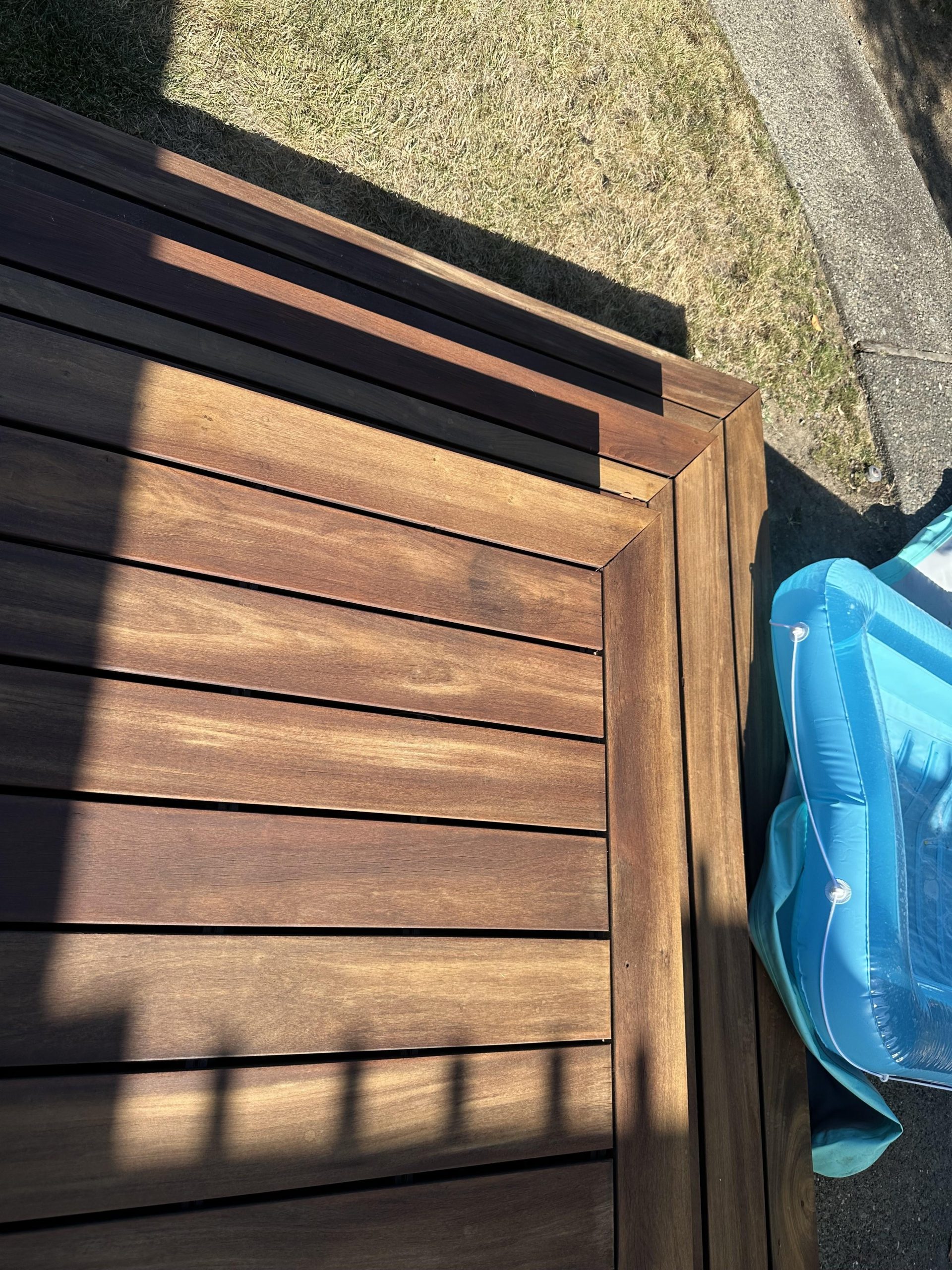

I applied the sample of Mahogany to my 15 year old IPE deck. Prior to application, i sanded it smooth and removed all of the previous stain. The Mahogany was too red, do you have a recommendation for a “medium brown” color? Thank you
Try their Amber color. Or possibly a mix of Amber and Black Walnut.

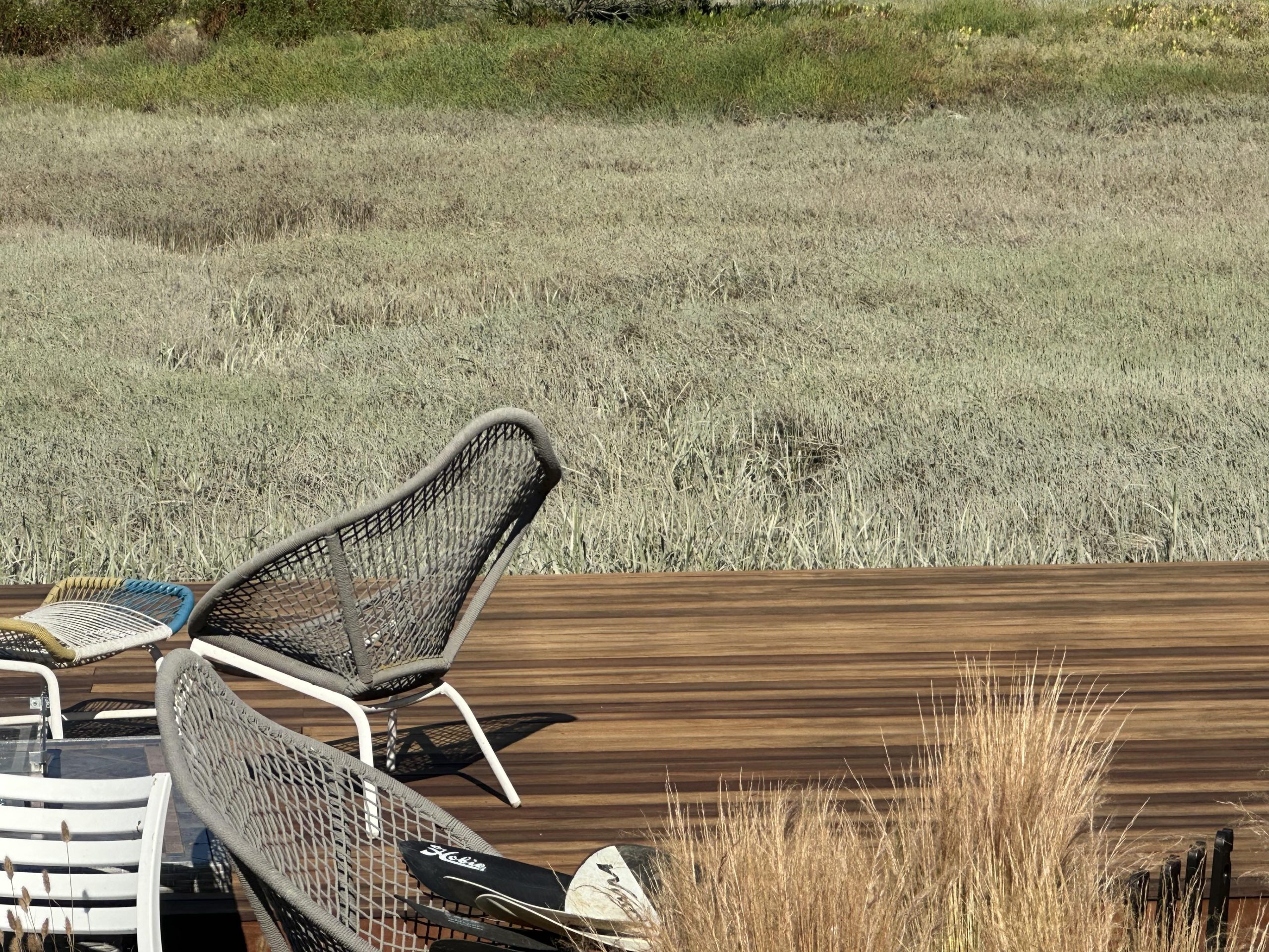

We recently purchased a house with about 1400 sq ft of ipe decking/dock located on saltwater in SW Florida. Decking is ~15 years old and is totally grey and dry. I don’t know if the prior owner always left it natural or just ceased maintaining any stain many years ago, but it does not appear to have any color or finish whatsoever. Should we use the RAD stripper just in case it was previously stained or sealed many years ago, or is the RAD cleaner sufficient? Do you recommend RAD wood stain or A-C hardwood stain for the ipe after it is stripped/cleaned/brightened? Looking for a fairly light, natural color (understanding that a lighter stain will fade faster than darker stain). Thanks.
Use the cleaner, not the stripper. Either the RAD stain or the AC stain would work for this. Amber for the AC or Natural for the RAD.

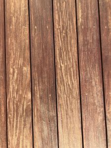

Thank you. One last question. I have stripped and brightened with restore a deck, amazing how good the wood looks. Now waiting for right window with weather to seal.
There are 2 or 3 spots where the old product didn’t fully come off. If I used 60 or 100 Grit with hand sander do I then need to brighten again or can I just vacuum up / wipe off and I can still finish?
If you spot sand then the stain while probably take lighter in those areas. Not always a good idea.

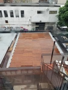

Installed 2×4 ipe tiles few weeks ago in Montreal Canada, supposedly they’re raw but top grade from Bolivia.
The installed picture is after a rain and i love that color but it reverts back to natural after it dries.
Now the more sites i read the more contradictory information I get on how to get that color and whether i should’ve applied it before exposing it to the rain and sun (I’m afraid i already see some splitting/checking i didn’t see beforehand)
Any advice i should do at this point to avoid more checking and get that nice color?
New wood has to weather and be prepped: https://www.deckstainhelp.com/staining-a-new-deck/
Once this is done, prep and stain with Armstrong in Amber color for the look you want.

Hi .. I inquired on your site on May 22, 2018 about a southeast facing IPE deck in LA area w direct sun and summer heat. I had been using AC Mahogany but inquired if there was anything that lasted beyond 9 months. The advice was to use the restore a deck cleaner and brightener instead of sanding as the prep.
We did all this per instructions and then reapplied the semi transparent AC-M 2 days ago. It looks very blotchy and uneven . In some places the stain appears to have not adhered . There is no lustrousness to the stain. My painter says “I told you I should have sanded”.
Last displayed Photo 4 ..(761)is the old stain applied in 2014 with a rich look that rivals some of the pictures on your site .
Photos 1,2,3 are of the deck which was stained 2 days ago w pads and wiping off the excess after restore a deck cleaner and brightener was applied a week earlier ..
Do you have any comment why it does not look like your pictures of an AC-Mahogany stain ?….or for that matter even my pictures of my deck years ago with the same stain with sanded prep?
Thx so much for your site and feedback
