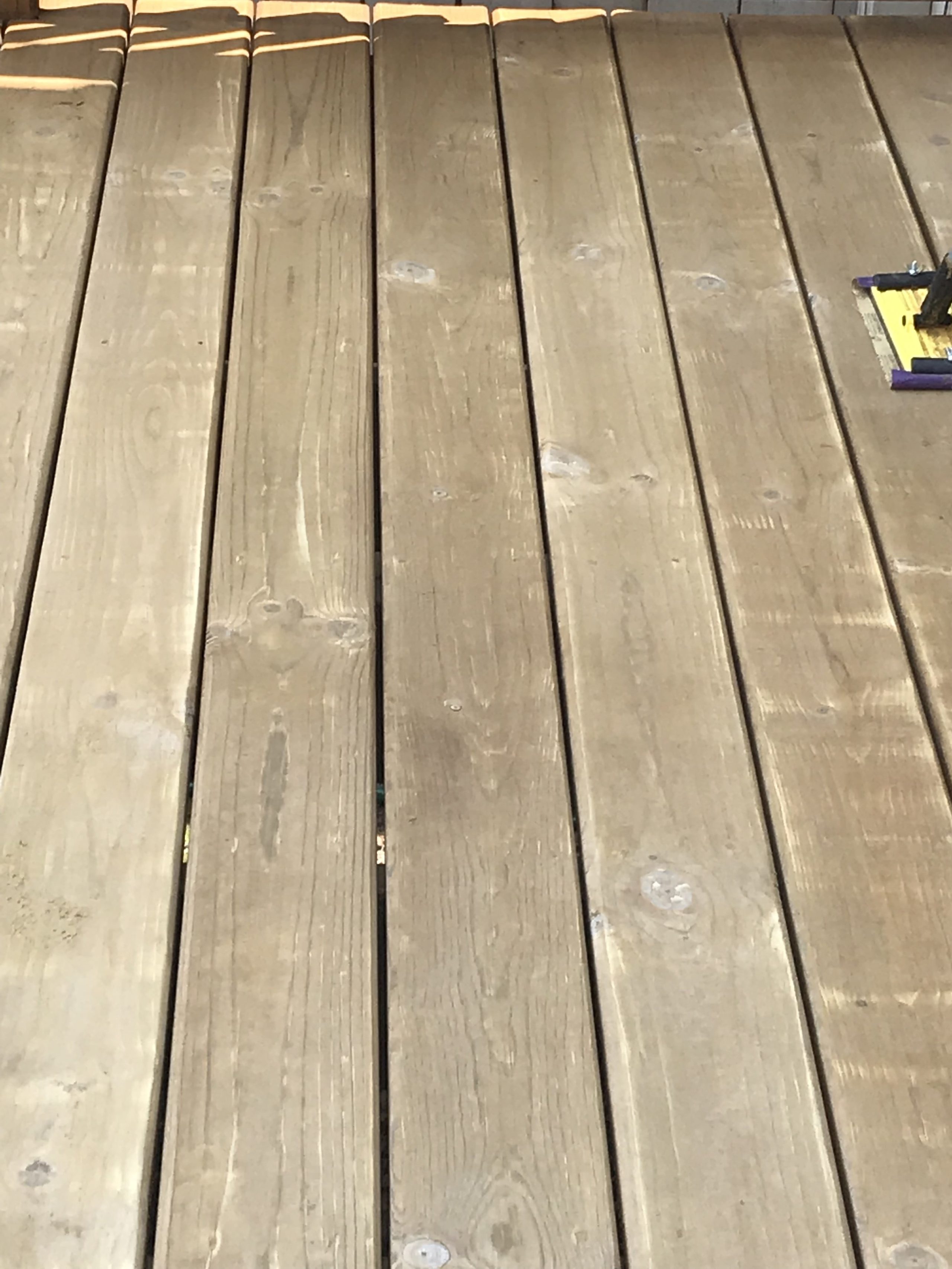

Deck after stripper and brightener

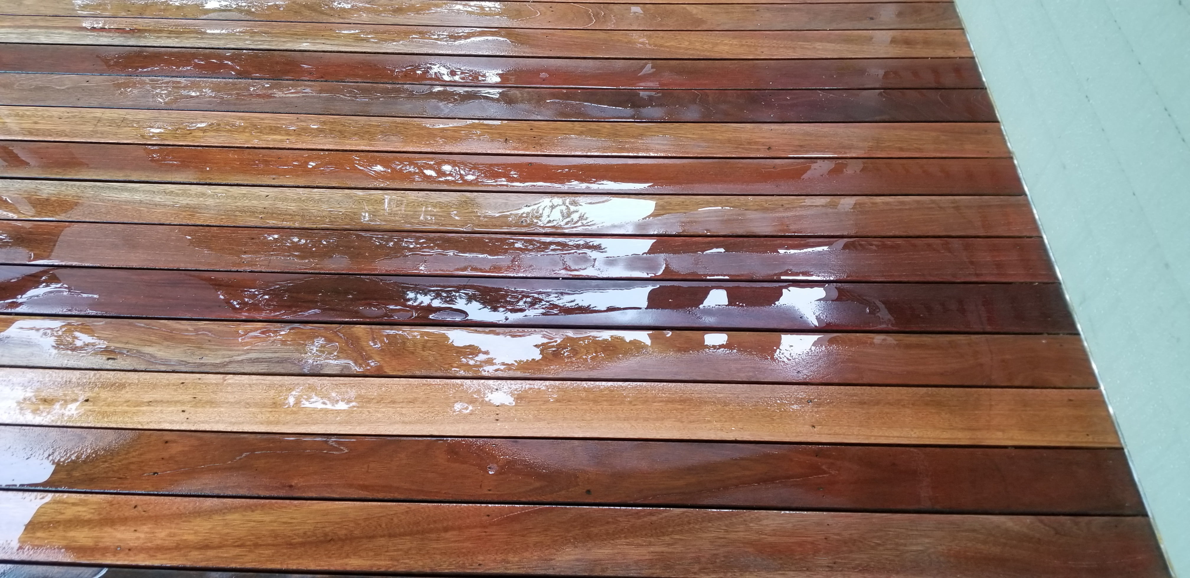

My backyard ipe deck has been stained with Deckwise Ipe Oil. And my front porch, which is also built with ipe, has been stained with Penofin Brazilian Rosewood Oil For Hardwood. They both looked beautiful for a while but now grayed due to time, sun exposure and the rain here in Pacific Northwest. For a better color retention I might want to try a different brand of stain like AC Hardwood Stain. If I decide to switch to AC, for prepping should I strip the old stain with deck stain stiripper? Or just deck cleaner will do? (followed by brighterner) Any sanding required?

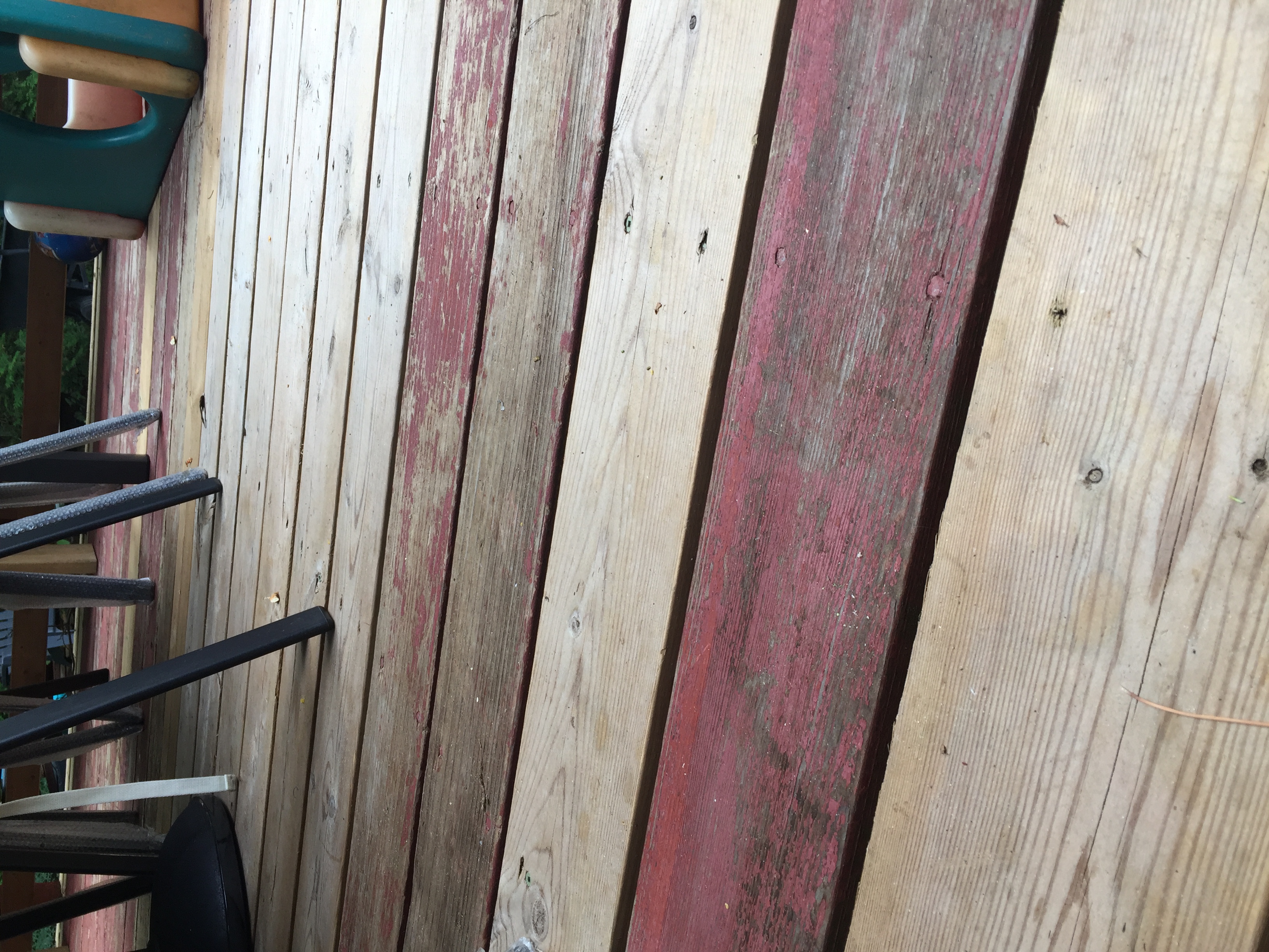

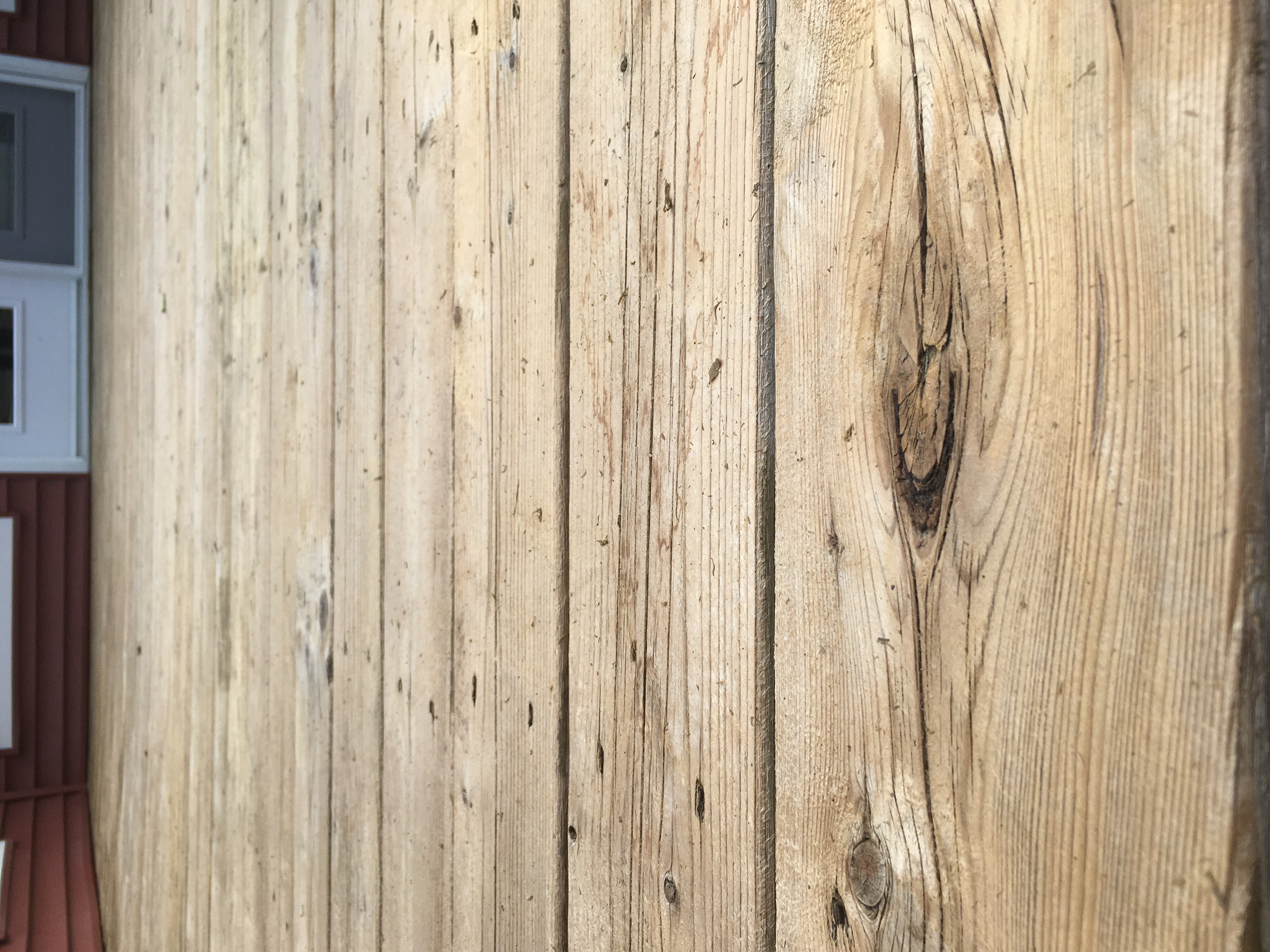

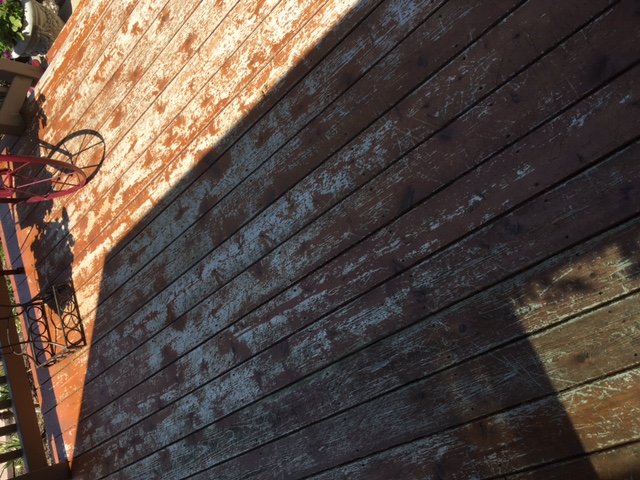

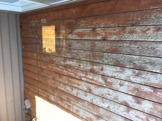

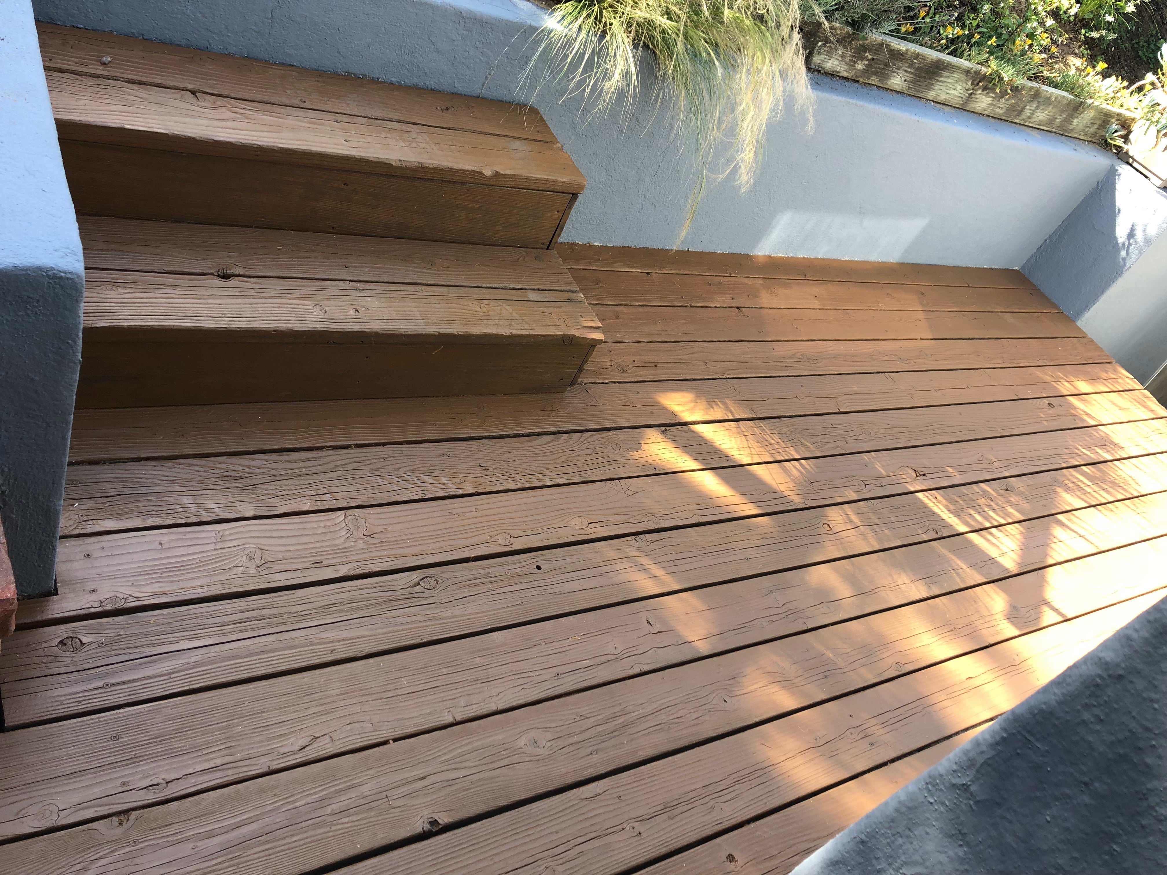

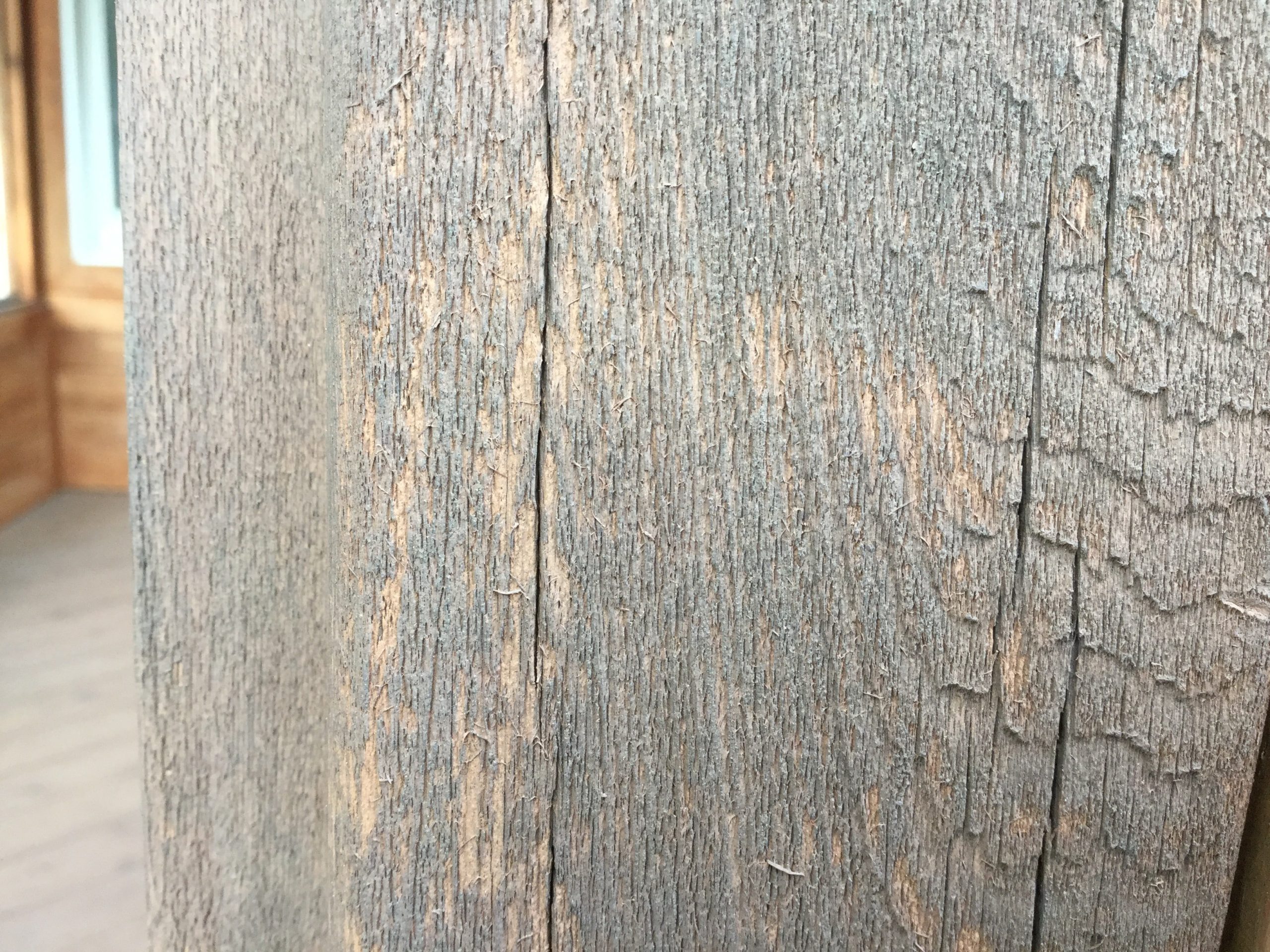

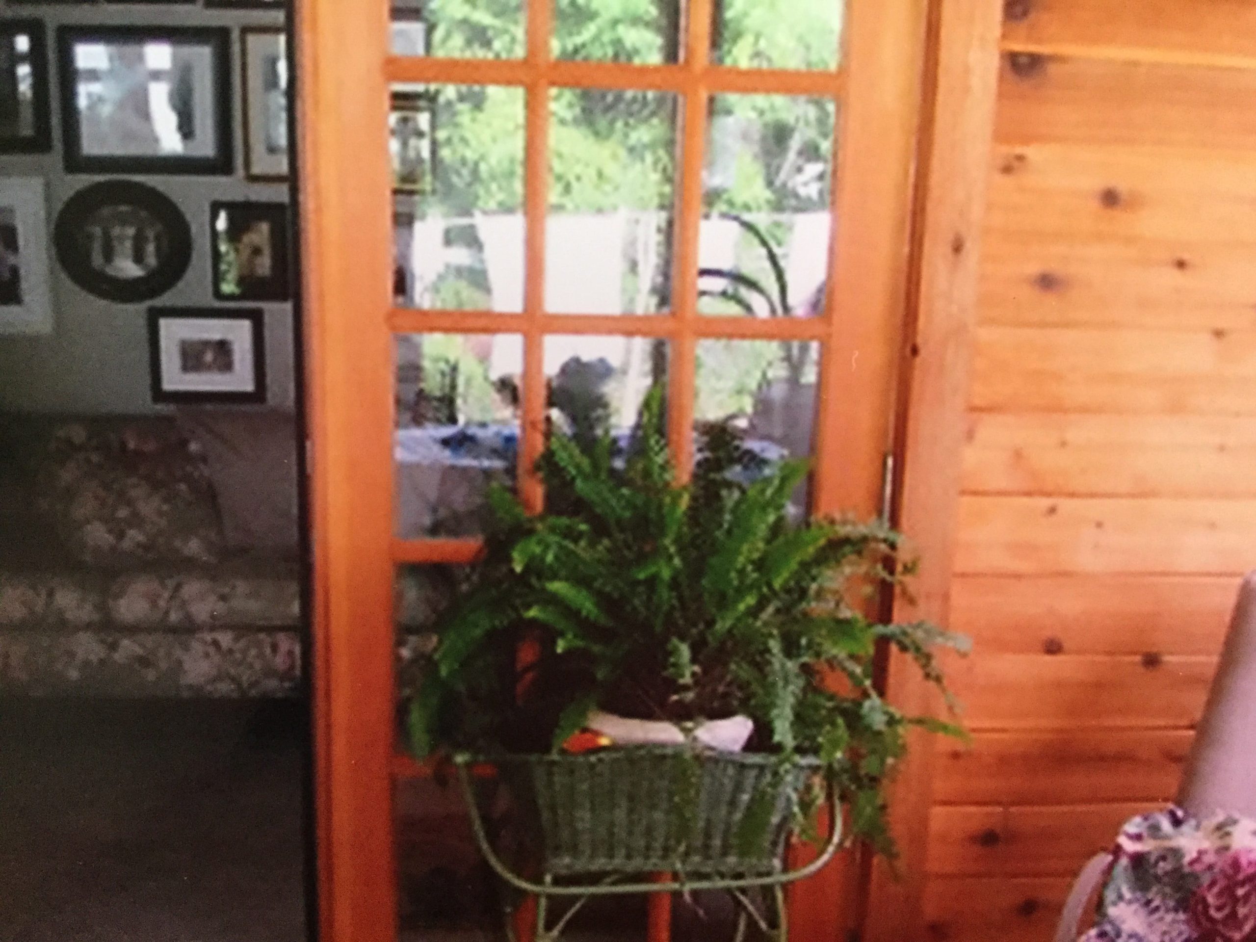

I’ve got a cedar porch, about 12 years old. We had it stained at least four years ago wit Cabot semi-solid oil finish stain and as soon as the job was completed, I thought it looked terrible….just so dull and flat. I want to redo it now and am so confused about what to do. Is there any way to brighten up the wood, like how it was when the porch was first built? We are also planning to re-stain the interior, which hasn’t been touched since we built it. At least it still looks fairly close to how it looked back when we first built the porch, although there are water stains. How do I remove those? The floor, stained four years ago, is also just dull! No luster to the wood. Strip? I just want my porch to look like it did when we built it…wishful thinking?
Indoor pic taken 12 years ago.
Other pic is of the exterior now.

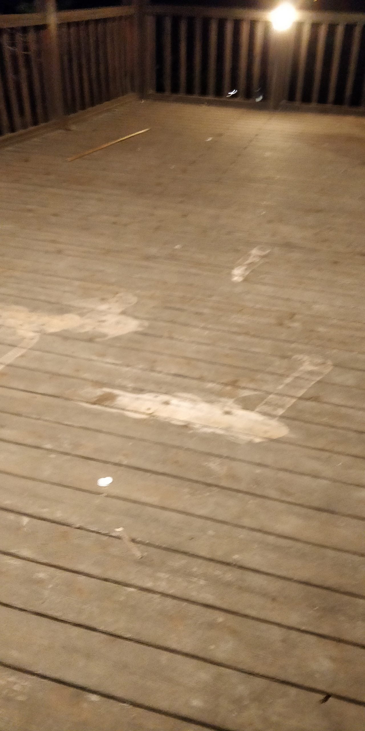

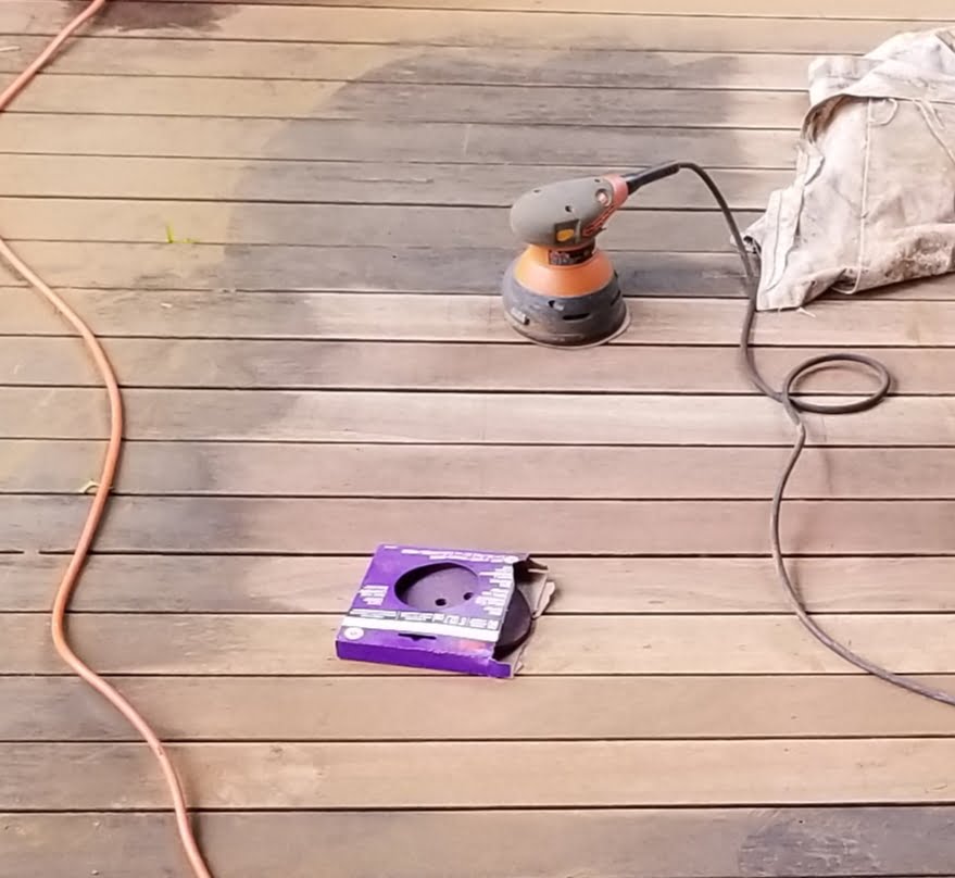

I’m stripping a deck of unknown tropical hardwood using 60-80 grit sandpaper on a random orbital sander. The deck was done years ago with Cabot’s Timber Oil that turned black. My plan is to use either an oil based stain or tropical wood specific oil to show off the wood decking once I have removed the Timber Oil.
After hours of sanding I rinsed off the deck to remove the dust and look for water beading on the wood, which I saw.
Would it be a good idea to give the hardwood a dose of deck stripper, and brightener, to remove any residual Timber Oil lurking in the wood, or should I re-sand the areas where the water isn’t absorbing immediately?

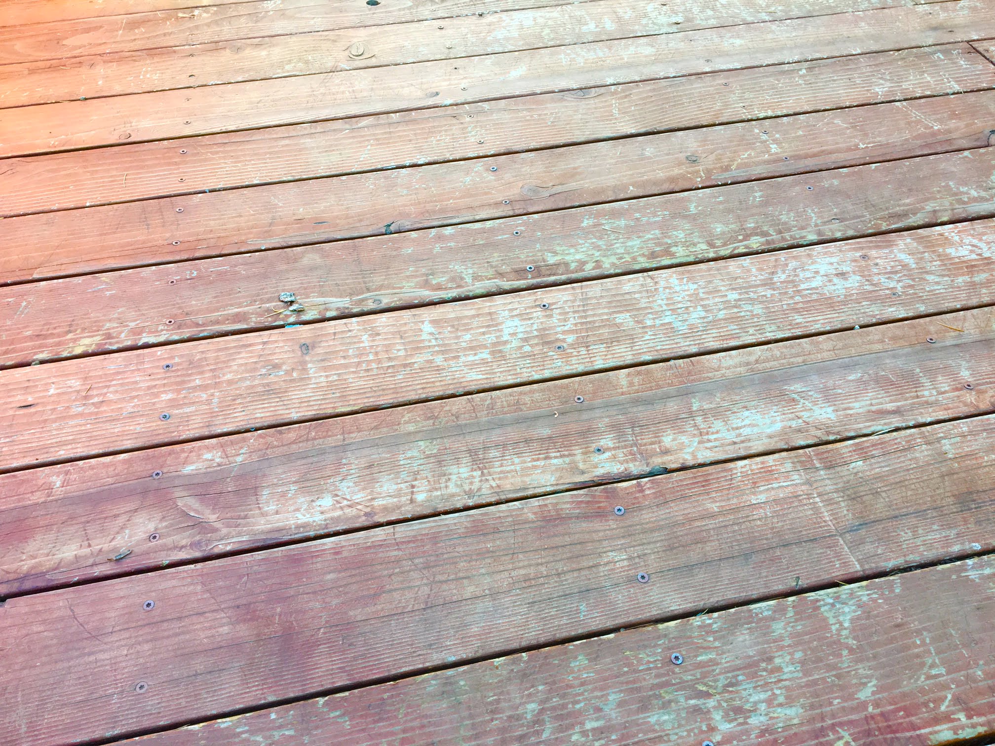

Ive removed the old stain with stain stripper and power washer but now have wood fuzzies. Is this normal or did I ruin the wood? I plan to sand after another 2 warm days to let the deck dry and remove any remaining stain that was stubborn. Hoping I can sand to repair any rough areas as well. Then I plan to use a semi-transparent Oak tinted water based stain, but want your suggestions on the best stain to reduce future maintenance as I’m not eager to do this again any time soon! Oil based? Solid? What would you use?

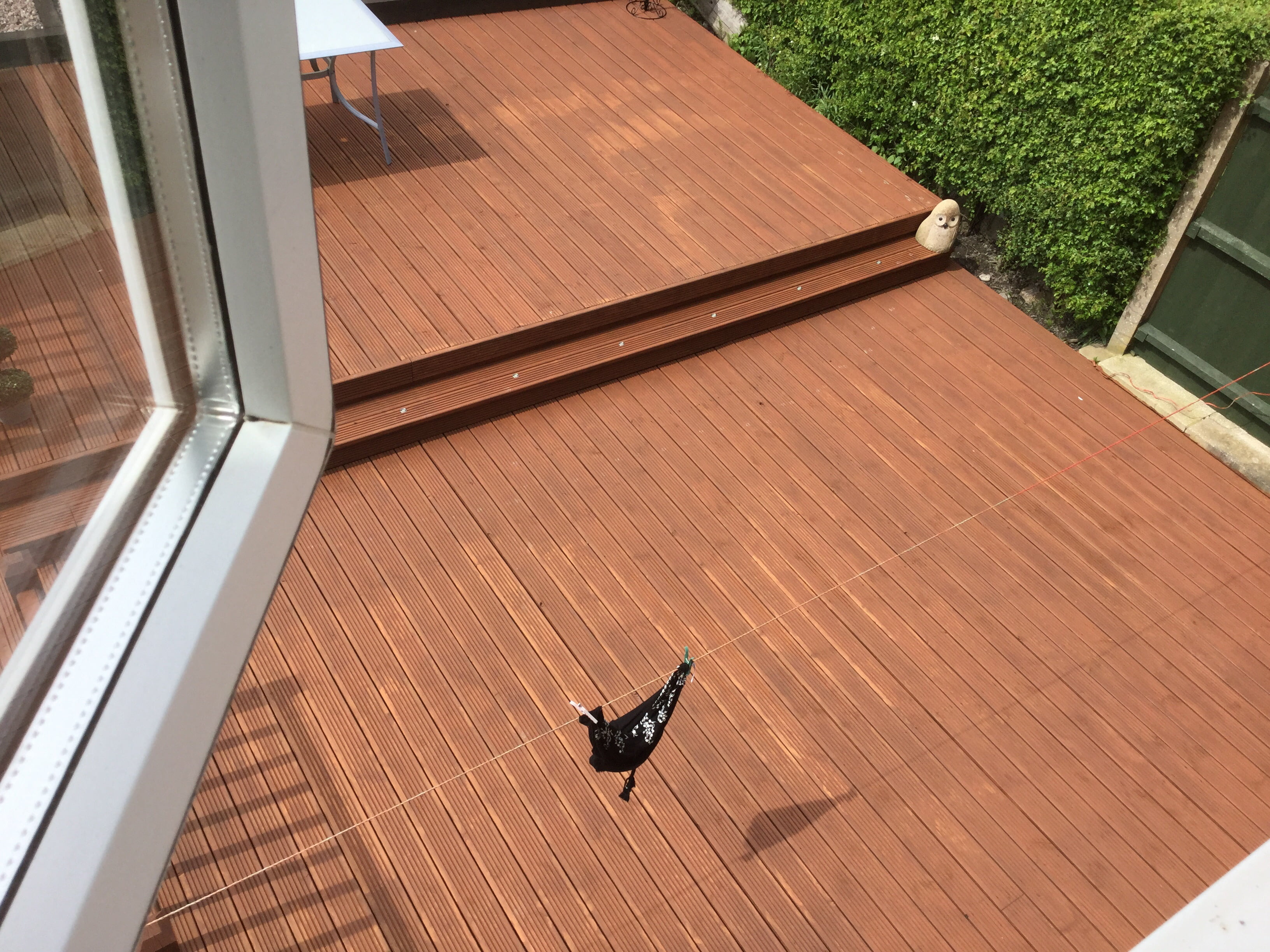

My husband restrained the decking at the weekend , on,y trouble is he used the wrong tin!! And ended up using the shed and fence paint by mistake, then a few days later it rained and now some of it has washed off and it looks a mess, would it be ok just justbgo,over it all with the proper decking stain or would it still stay patchy, any help or advice would be greatly appreciated
Tracy
Tracy
We originally used Cuprinol and that was what we were going to use agai, the colour was cedar falls

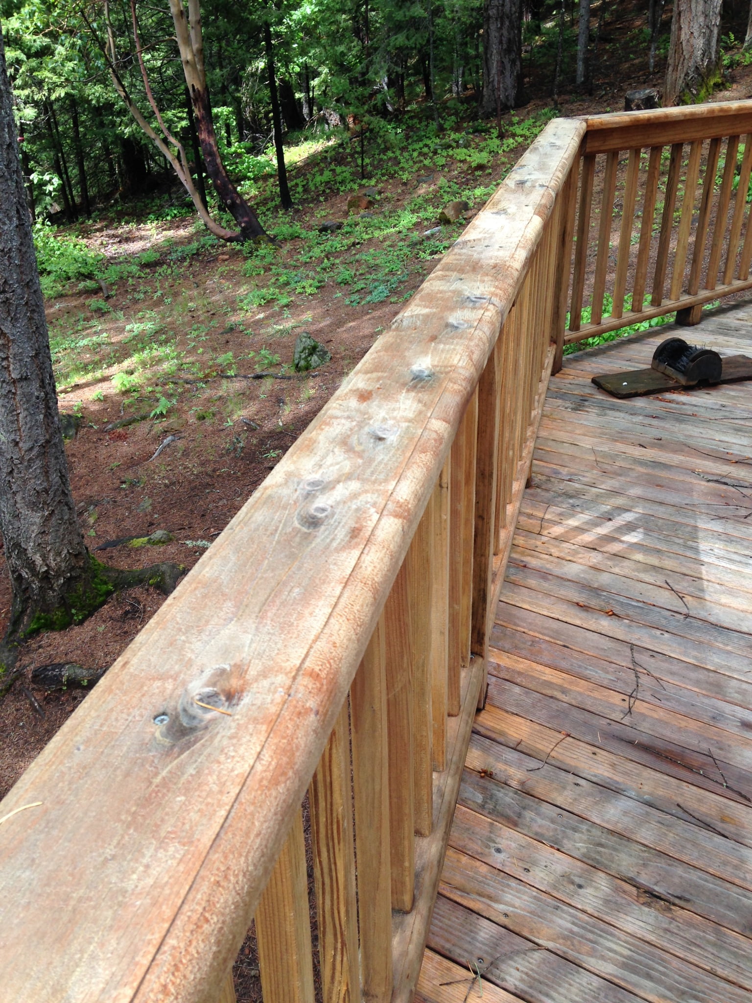

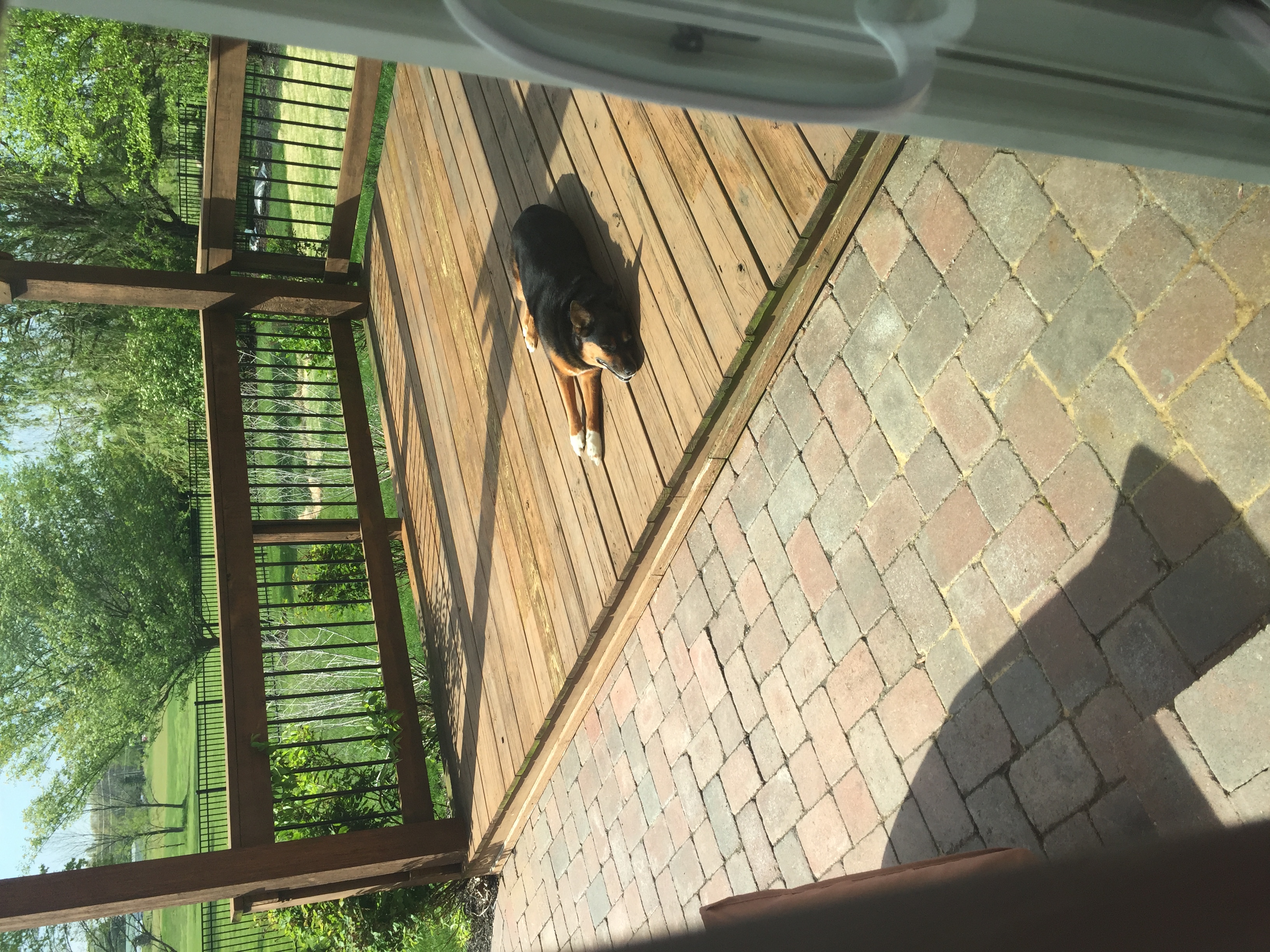

What about stripping a second floor deck that sits over part of t he first floor roof? Do I need to some how cover that section of the roof under the deck before stripping?
Also, what kind of stripping do you recommend? See the attached picture of the deck now. Also, I don’t know if you can tell the type of wood it is and if you can also recommend a type of stain?

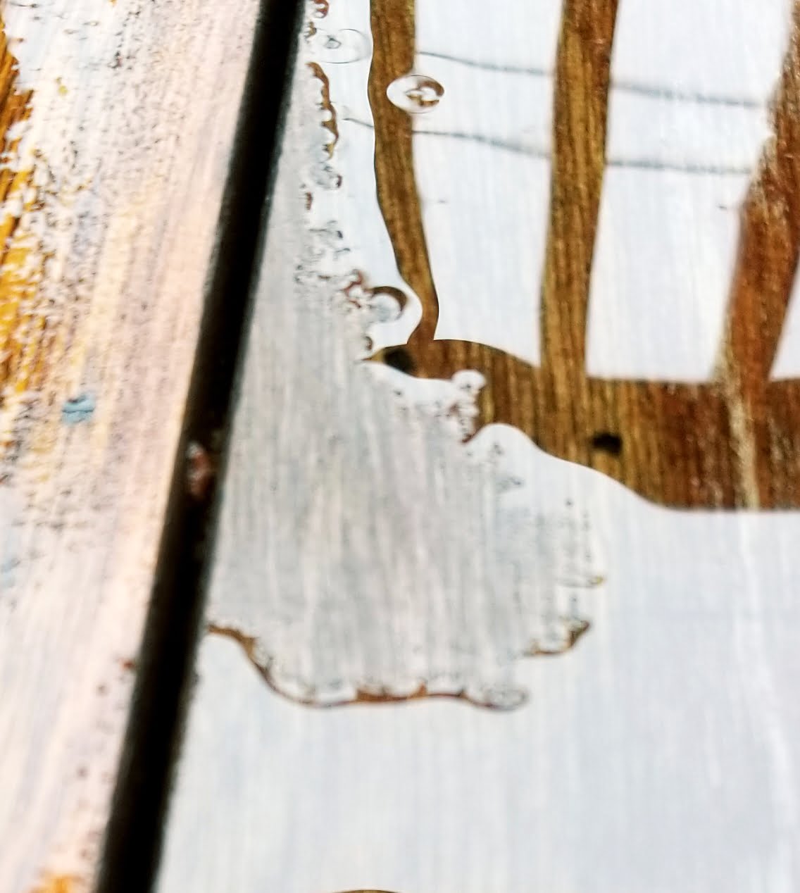

Thank you. Pics attached. Here are pics. What do you think on removing the Acrylic?

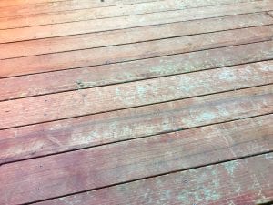

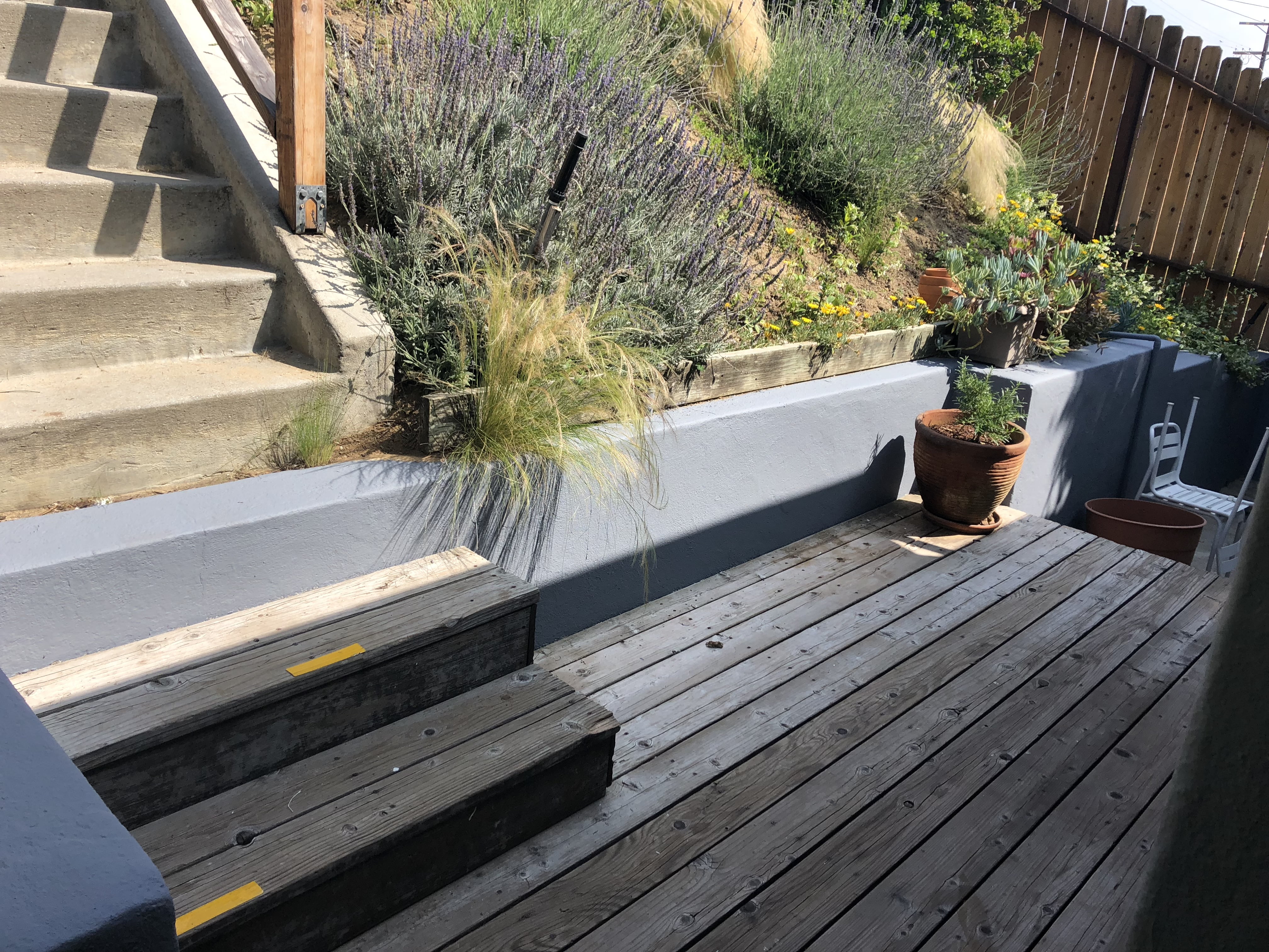

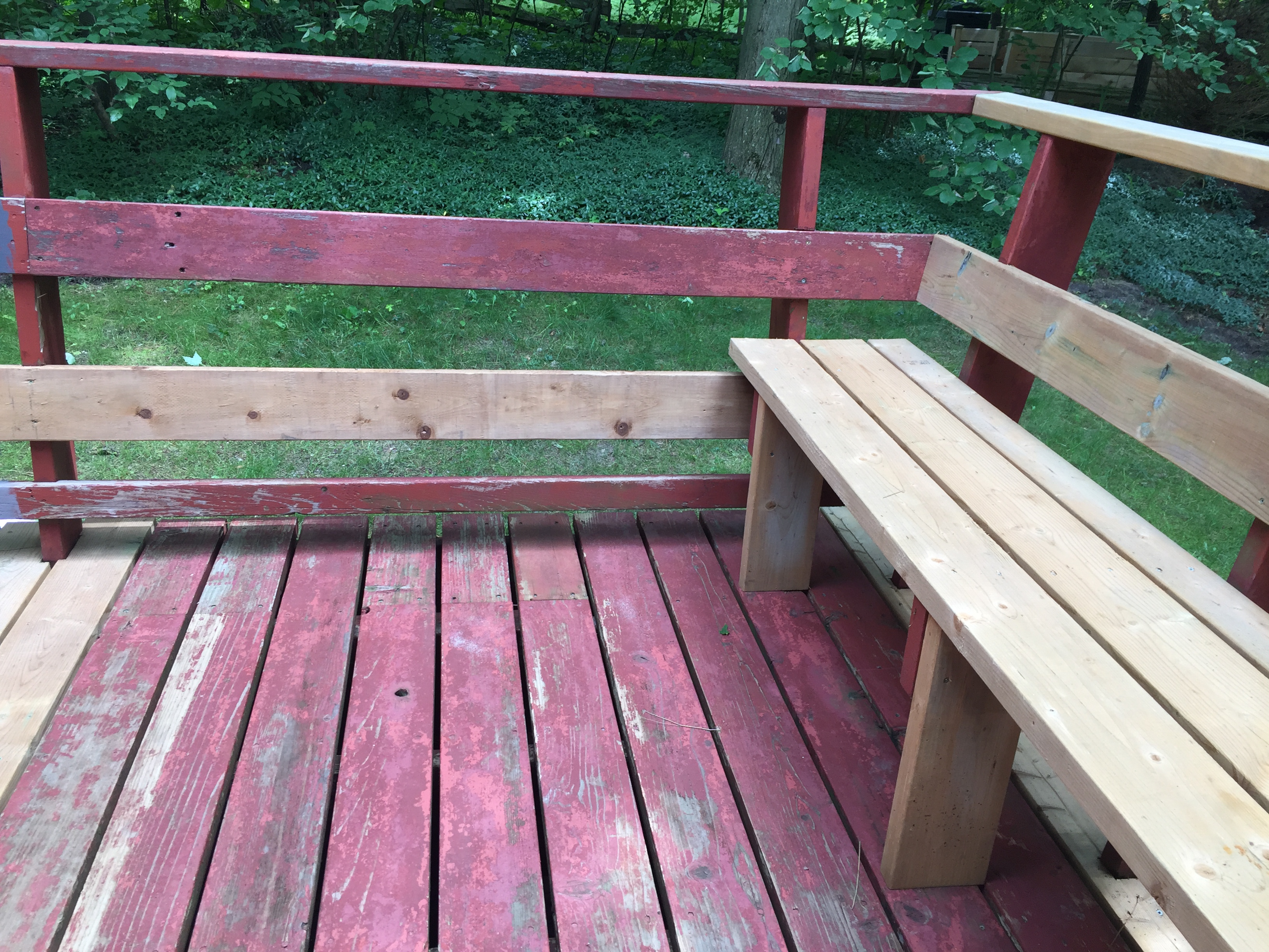

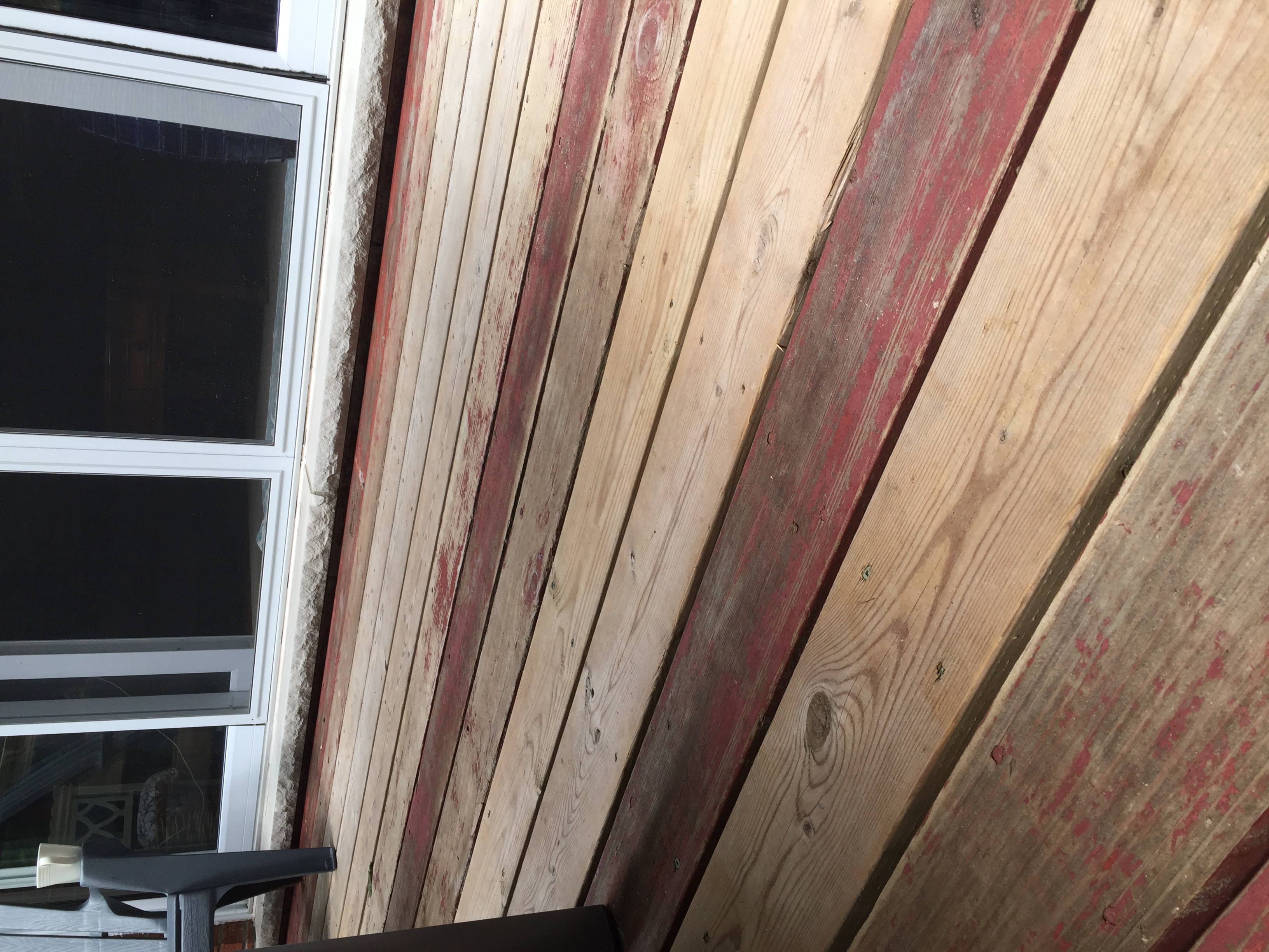

We are trying to remove deck stain that was done (most likely quite a few years ago) by the previous owners of our home. There is visible dirt and stain we need to remove so that we can re stain the deck. We have also replaced a few boards last year and stained them and it did not match well – which is part of what started this whole project. What is the best way to remove the stain and dirt? Should we power wash and then sand? Is it okay to just power wash? Or just sand? I powerwashed a small area and it removed some of the dirt and stain well and then was creating grooves in the boards in other places. Recommendations of what to do and/or products to use would be extremly helpful!!
Katherine
Katherine
This is the best picture I have at the moment.

I'm not sure if the product I need to remove is a paint or stain . does it matter ?

My cabin is rough-sawn cedar and needed a new coat of stain. First stain we used was too dark, so used Superdeck Stripper to remove it. The paint store said we shouldn't need to apply the brightener because the stripper took the wood much lighter than the rest of the house, yet the lightest stain we could find (Superdeck natural) takes the wood too dark again. Would the brightener prevent this ?

We built our IPE deck last year and used Penofin. I was not happy with the stain, since every time it got wet it left stains behind. I would like to use IPE Oil this year. Do I need to strip the deck before, or is a cleaner good enough? Thanks a lot
