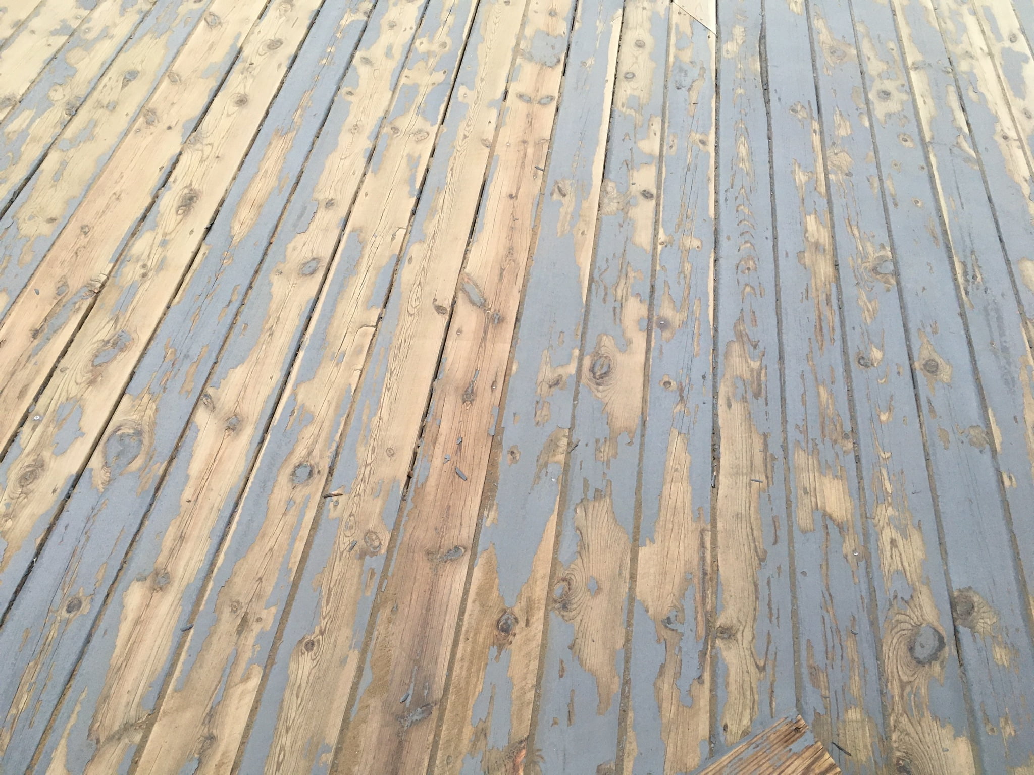

Hello I just love your website you have been very informative in tackling my Deck questions.
I have a dilemma, I have poor quality deck Buhr Deck over on my deck. I stripped it with HD 80 and power sanded it with 20 grit paper with these results. This Deck over simply refuses to budge. I’m attempting more stripping using Buhr Deck stripper today.
My question is since my deck is gray, same color TWP 100 I purchased, plus TWP gray is semi solid base could I apply this stain over the little Deck over that remains on the deck?
Dennis
Dennis
Dennis
Thanks for your quick reply, I will proceed removal as suggested. You stated staining over Deck over was not advisable, if I have to resort to a NON stain product would you have any recommendations?

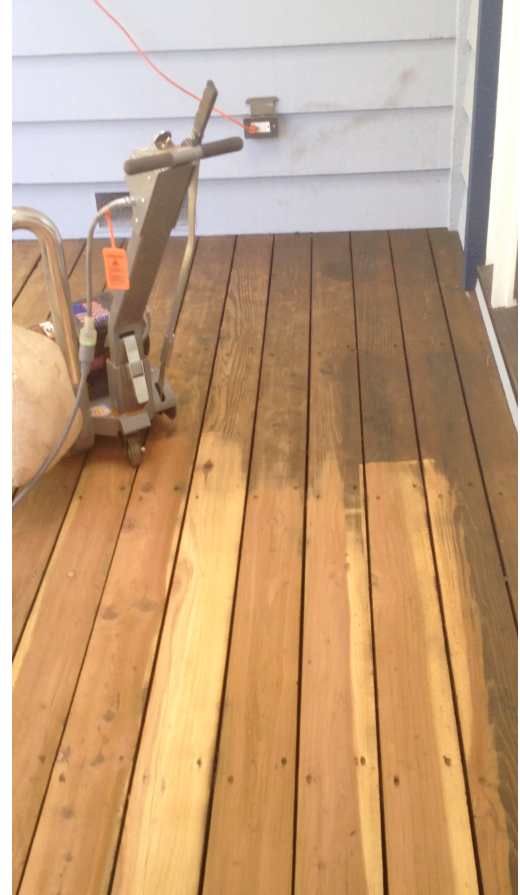

Drop to 16 grit. You can drum with a slight angle. Move the machine slowly just don’t stop obviously. It might take awhile but you’ll have a plained brand new deck.
Never use strippers. Ive done over 2,000 decks this way. After edging rent a squar-buff (rental place or some Home Depots). its a 12×18 huge orbital sander you walk with. 80 grit will do the trick. Ive drummed deck 5 times worst and started with a 45 degree angle.
Rick
Willson Deck Restoration
