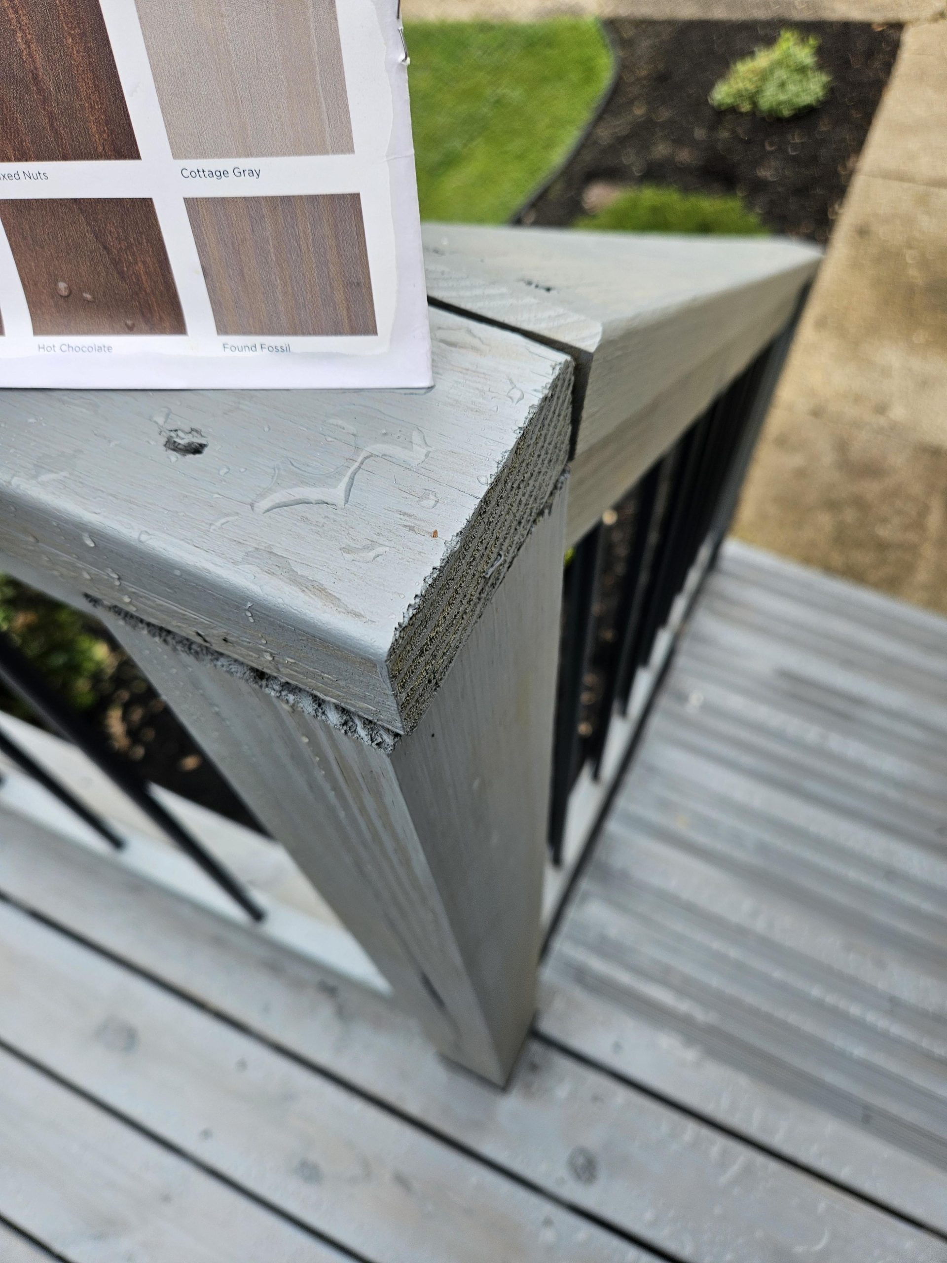

I had a new pressure treated deck build last year. The company came back and stained it with a semitransparent stain this spring. The stain was either not mixed correctly, or the chart sample was way off, and the color is just awful. They want to make it right. Do I have need to go with a solid stain to cover? Paint? How do we proceed?

It was Valspar Found Fossil.

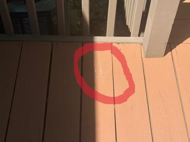

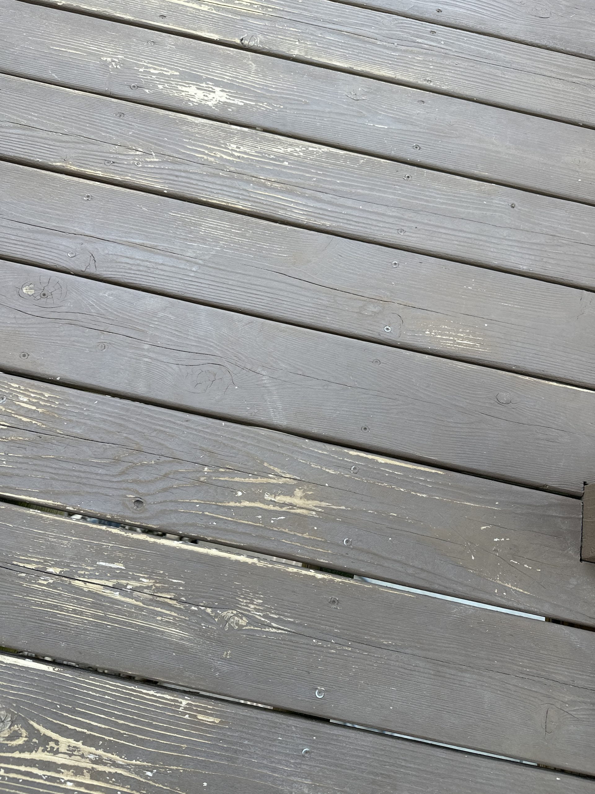

Hi Scott, I desperately need to re-stain my pressure treated wood deck. Previously I used SW solid stain. My deck gets full sun and is connected to our pool. I’m thinking I need to use the RAD paint/solid stain remover, sand it, then brightener and RAD solid stain. My question is… my house is on a well and bc we’ve been so dry in NC, my husband does not want to tax our well by using a pressure washer so I’m thinking of just stripping smaller spots at a time and using the garden hose to rinse it off. Do you think this would be effective? Then my plan was to sand the wood (since lots of bare feet are out by the pool,) and then do the brightener and stain. I’d love to hear your thoughts if this is a good plan. Sorry the pics are not great. Thanks so much, Billy
IMG_3757
IMG_3756

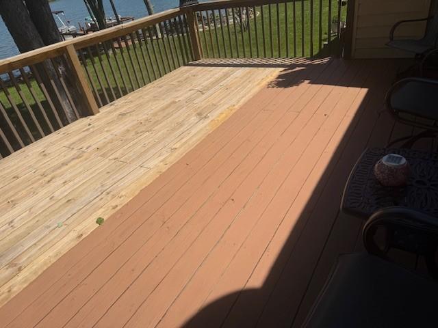

Hello, I have added on to my existing deck last summer and I am now ready to reapply the same colored solid stain from restore-a-deck. I plan to use the cleaner and brightener from you as well. The stain on the old deck is 5 years old and still looks pretty good with the exception of a couple small areas ex. in the pic. Do I have to use your stripper as well?
Thanks, very happy with your product.

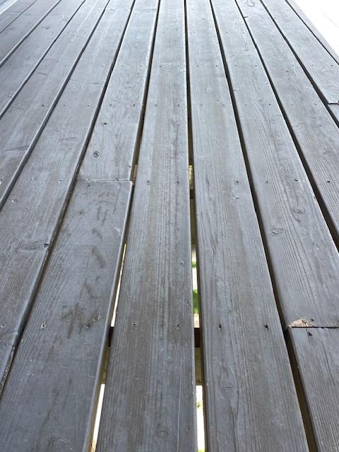

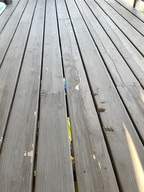

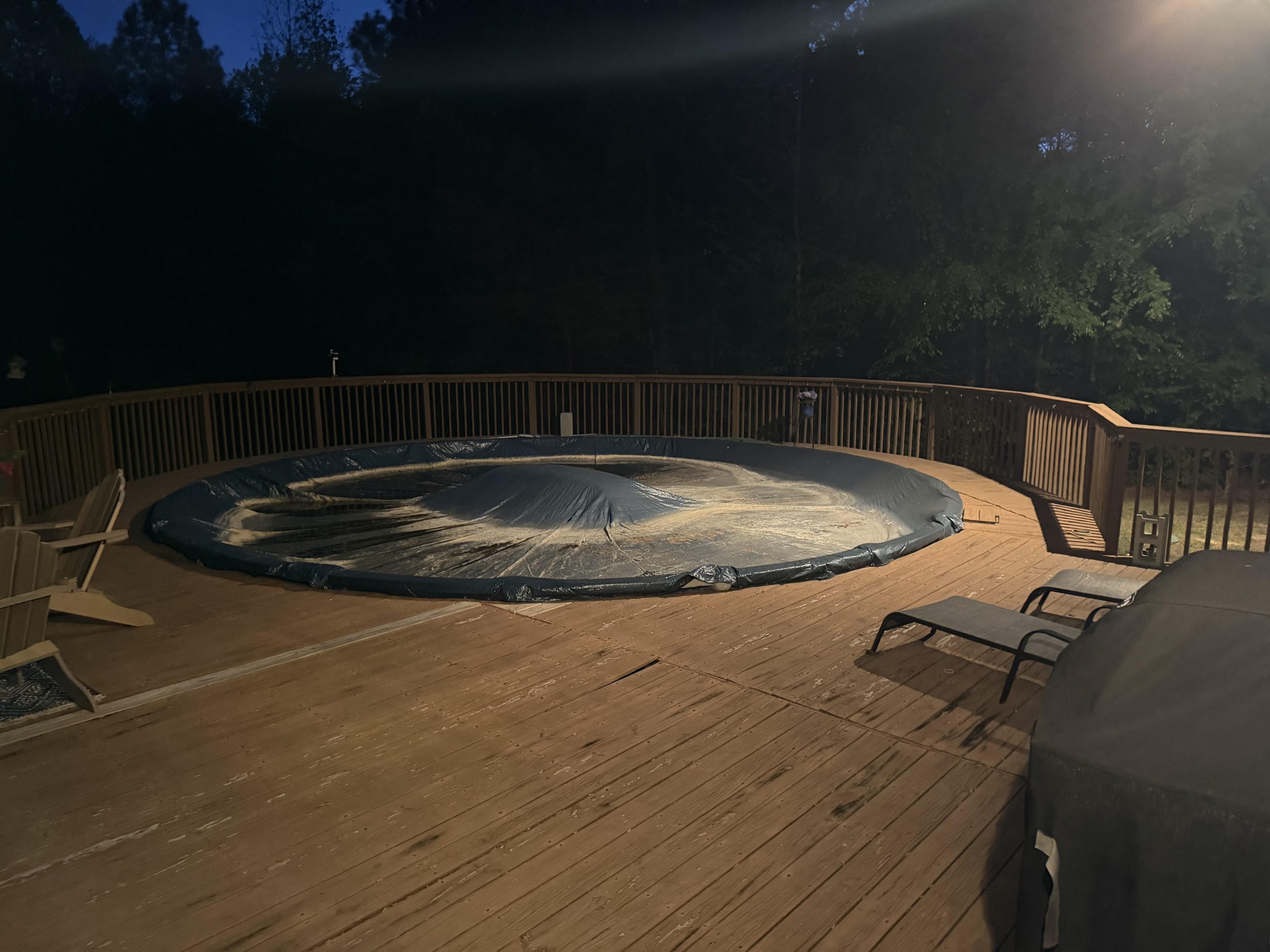

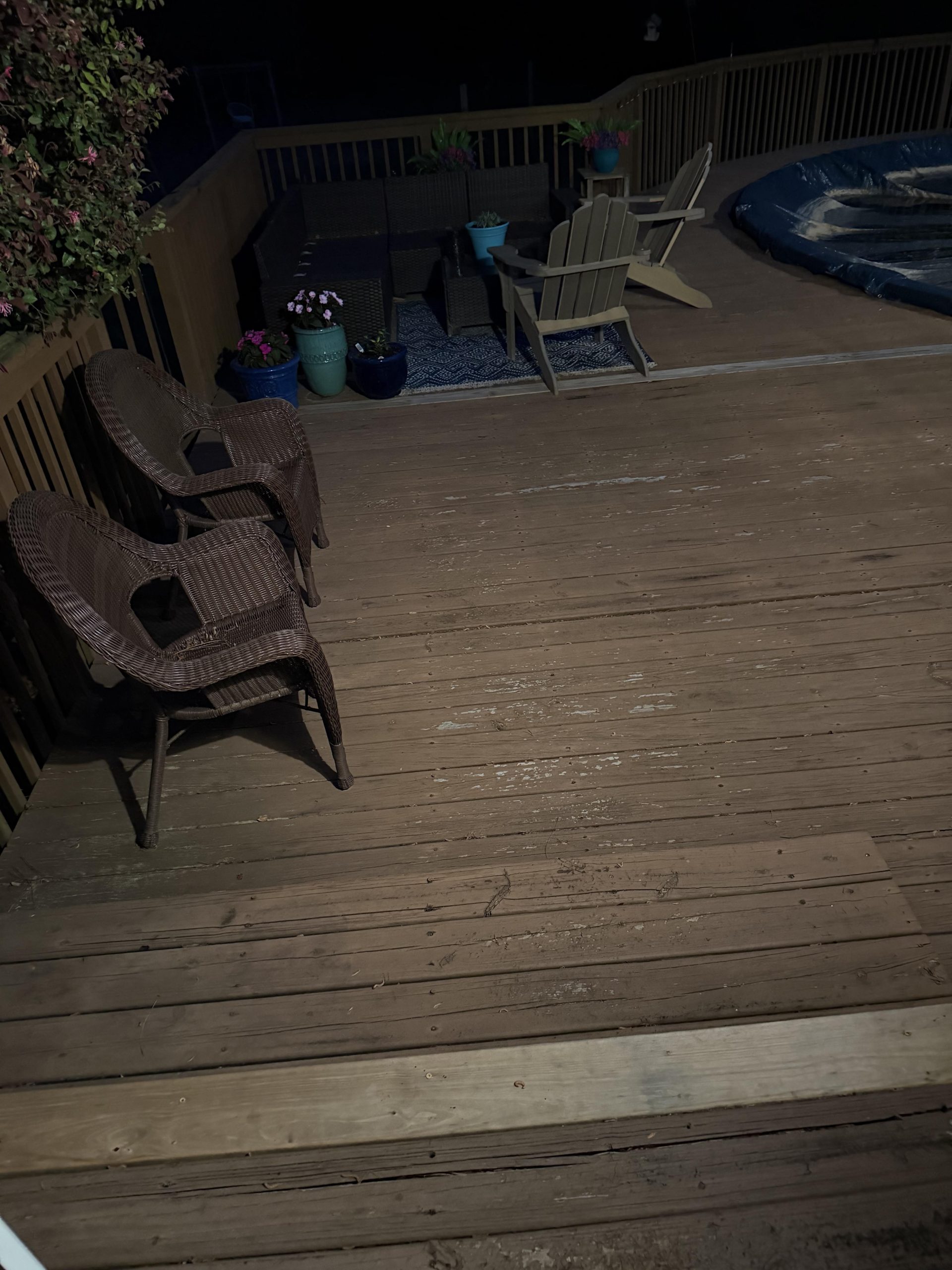

I have 6 year old Flood Solid Color Stain on my 12 year old redwood deck. The deck gets full sun most days and wraps the house and is about 20 feet above ground level. We have lots of landscaping and garden beds under the deck so I am concerned about using any stripper that will damage plants. There are some peeling areas that I can spot sand to smooth out but I’d like to know if I can just use a good deck cleaner (which one?) to clean and then reapply same solid stain? Do I need a brightener after cleaner if I’m not stripping the wood and I am reapplying a solid stain that completely covers wood grains? Or do I need to sand entire thing? Thank you. Photos attached.
IMG_9110
IMG_9109
IMG_9108
IMG_9106

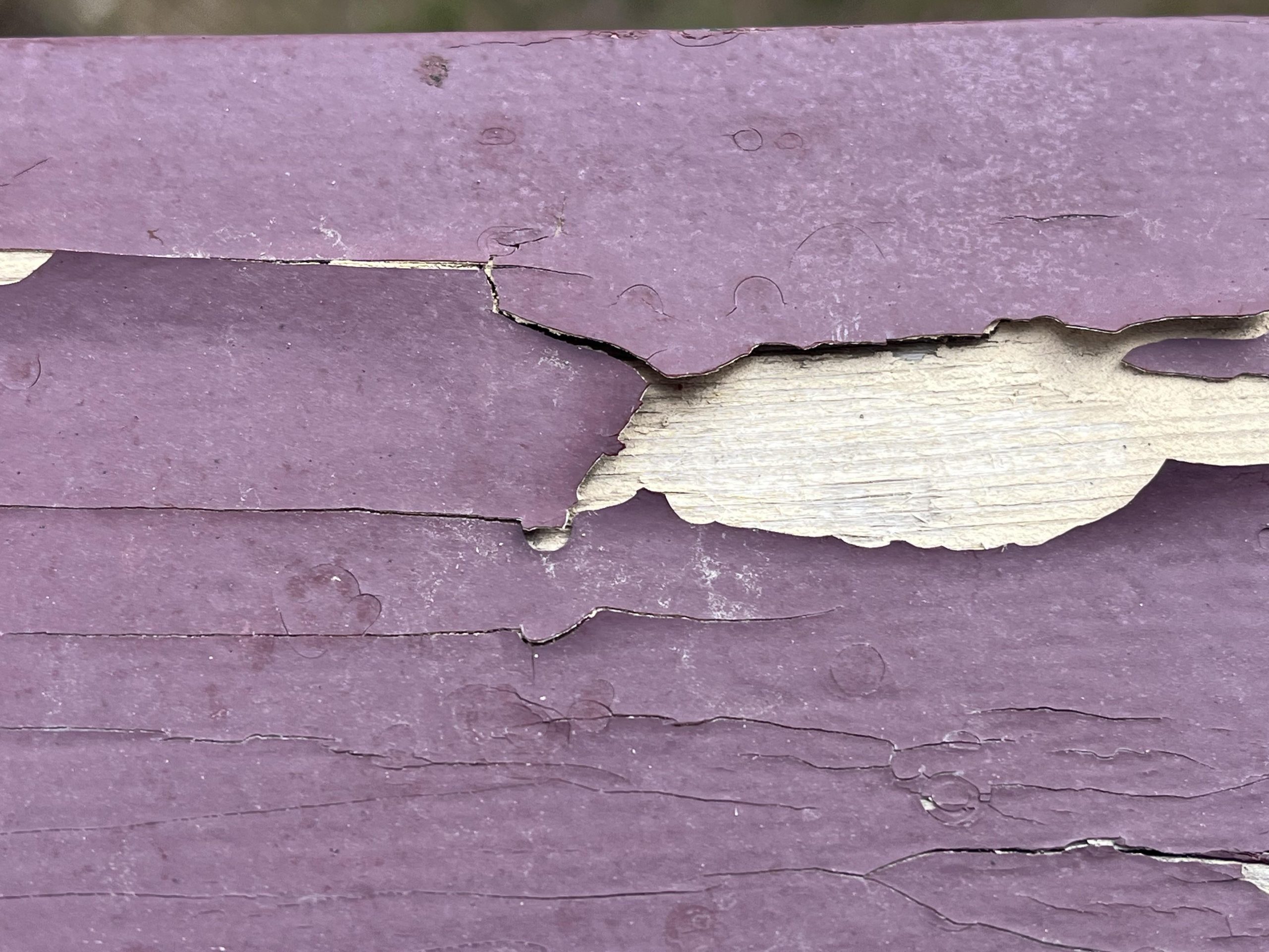

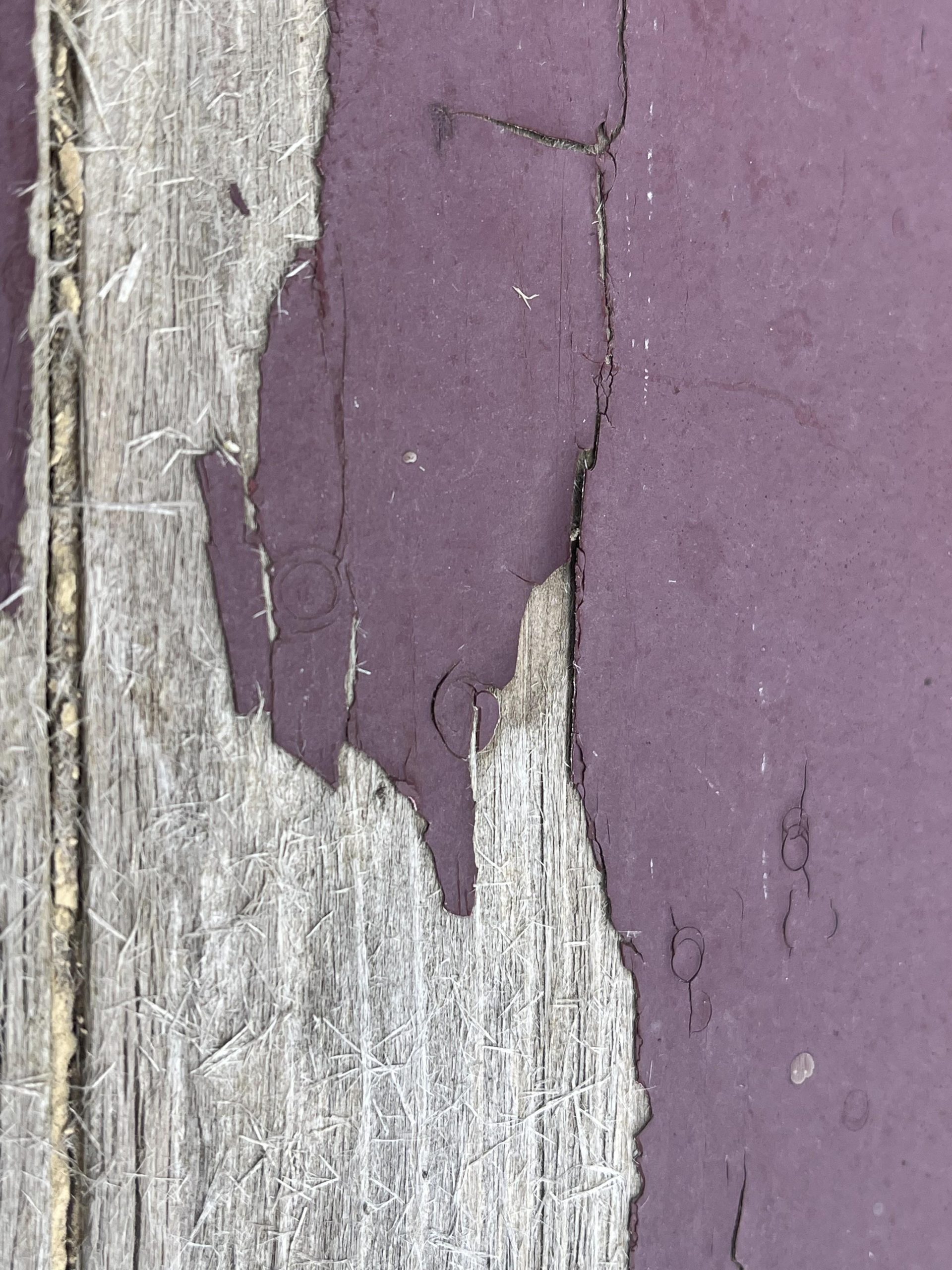

  • I purchased a home where the previous owners used either an exterior paint or even possibly an interior paint on the railings. It’s been about two years since they did this and now it’s peeling off.
  • can a solid stain be used to paint over the rails once it’s been stripped of any peeling and power washed
Les Simon
Les Simon
Reply to  Les
Here are some pics of paint peeling on my rails
IMG_1017
IMG_1015
IMG_1013

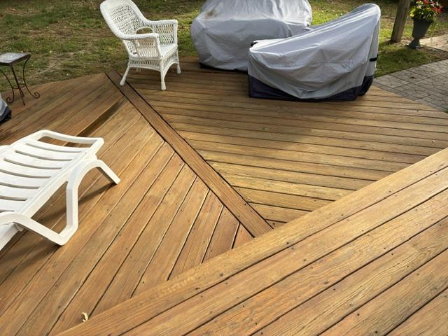

Solid stain applied 3 years ago and looking at applying the same product and color. I’ve power washed and sanded. Is this ready for stain?
