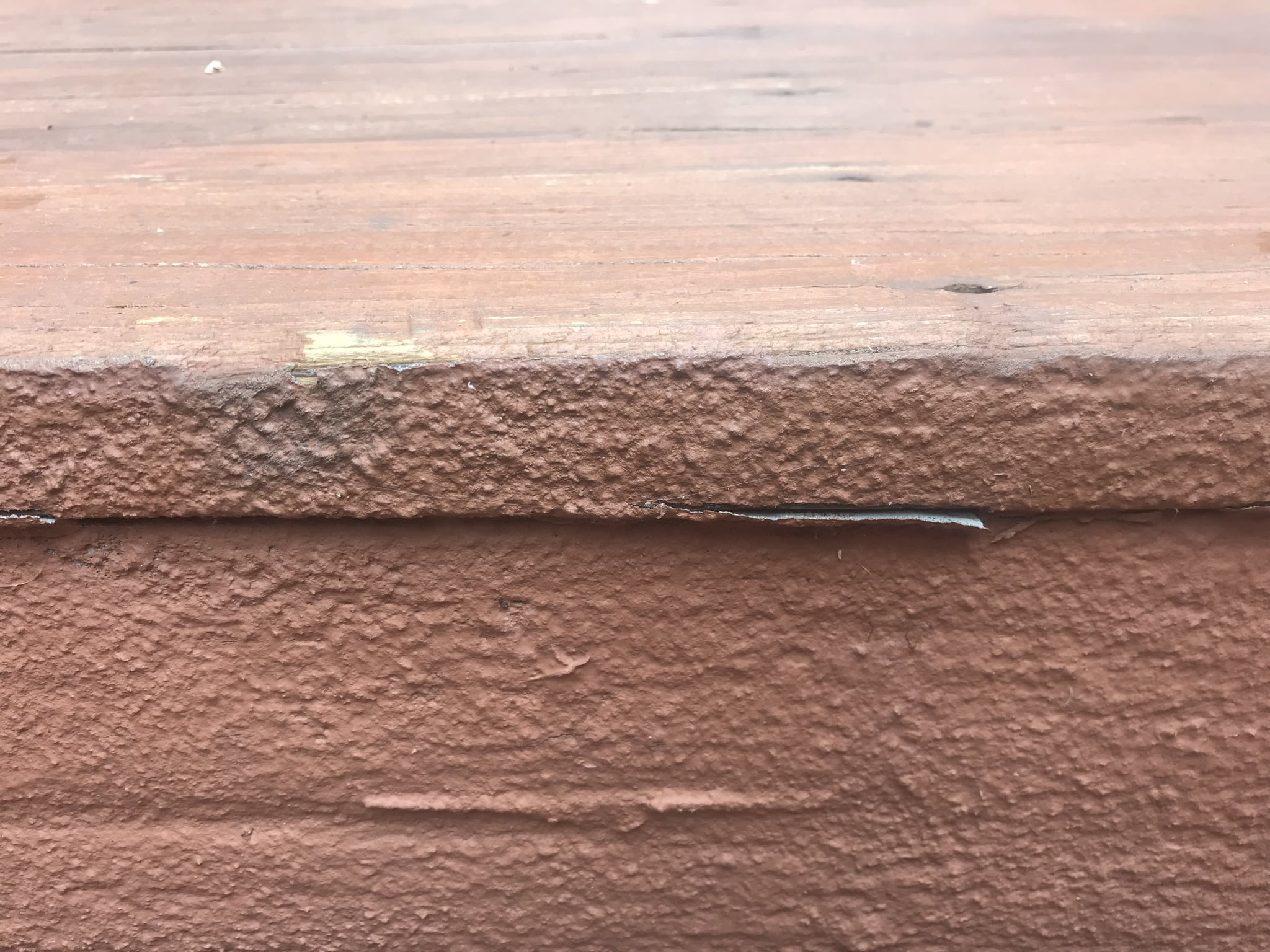

Synta (Rust-Oleum) Restore showed some wearing in the high-traffic areas and between the decking boards. The (Rust-Oleum) Restore did not seem to adhere to the boards as the finish curled up here.

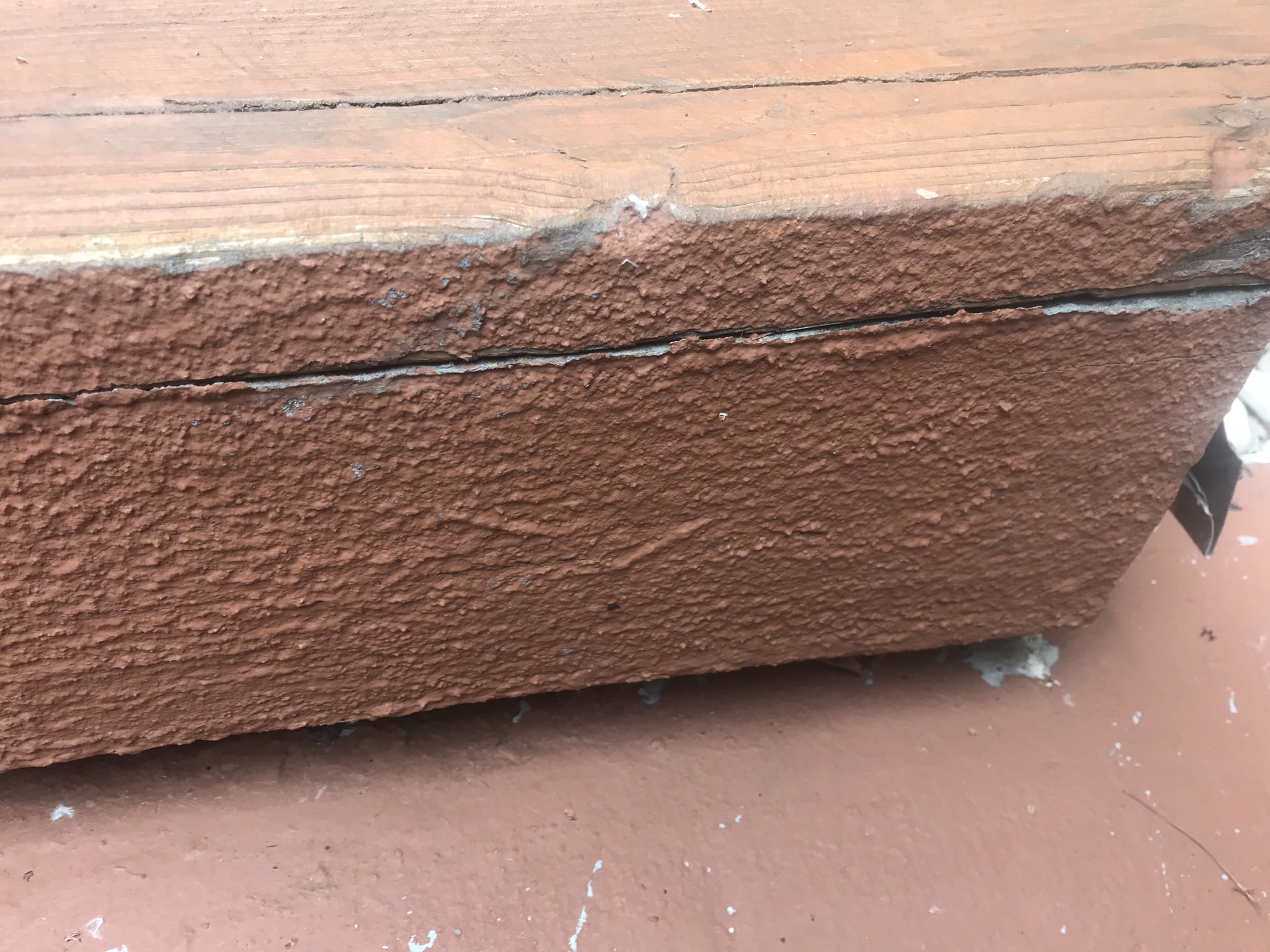

Heavy scraping to remove the peeling stain would be required before applying another coat. Conversations with the manufacturer on product failure were difficult. They blamed the peeling on poor prepping of the wood, even though we followed their online instructions.

Rust-Oleum Rock Solid (Deck Restore) Customer Photo Issues

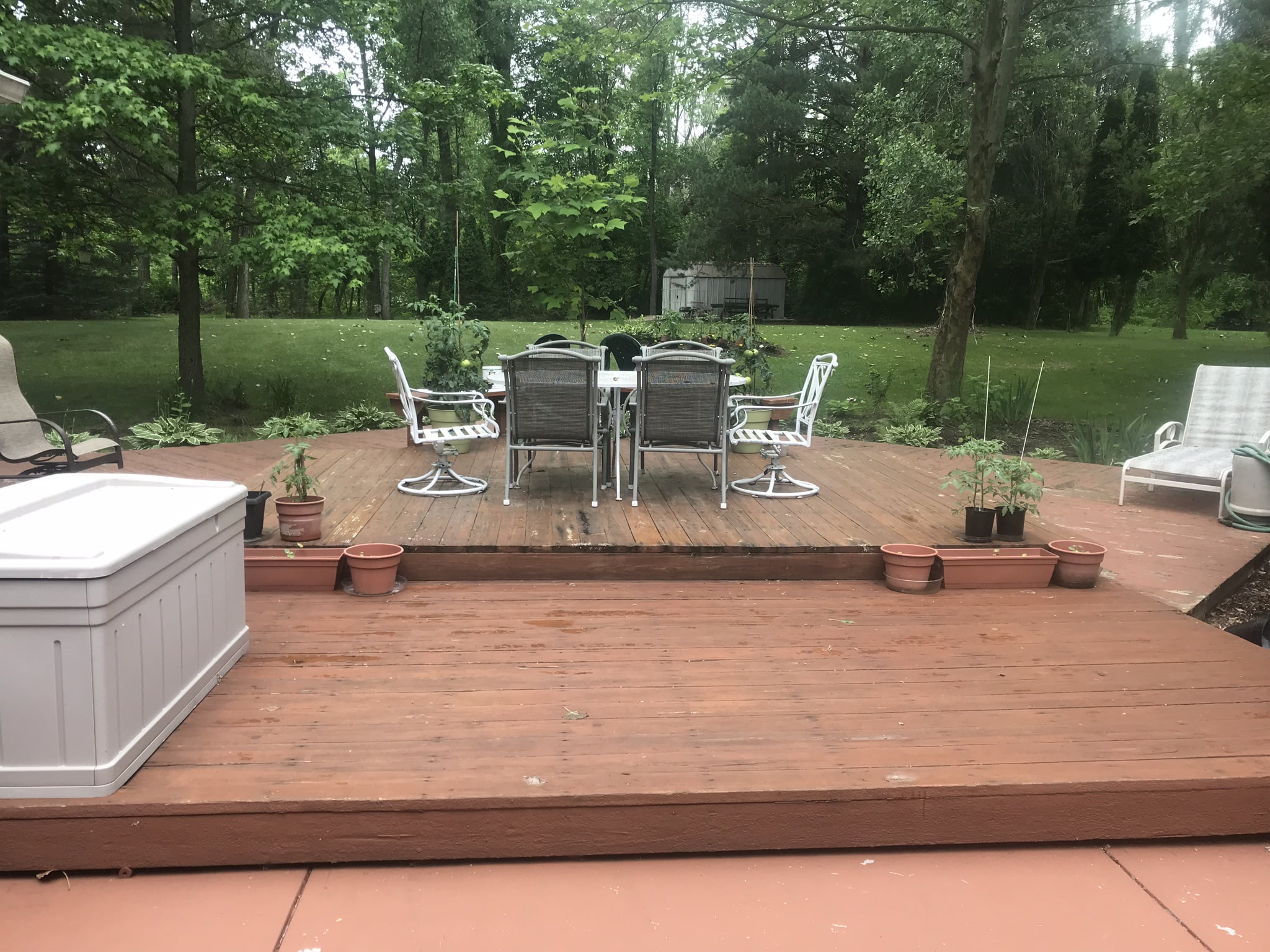

Deck Wood Type: Pressure Treated Pine Dock
Deck Square Footage: 600 Square feet
UV Exposure: Southern exposure. Full sun
