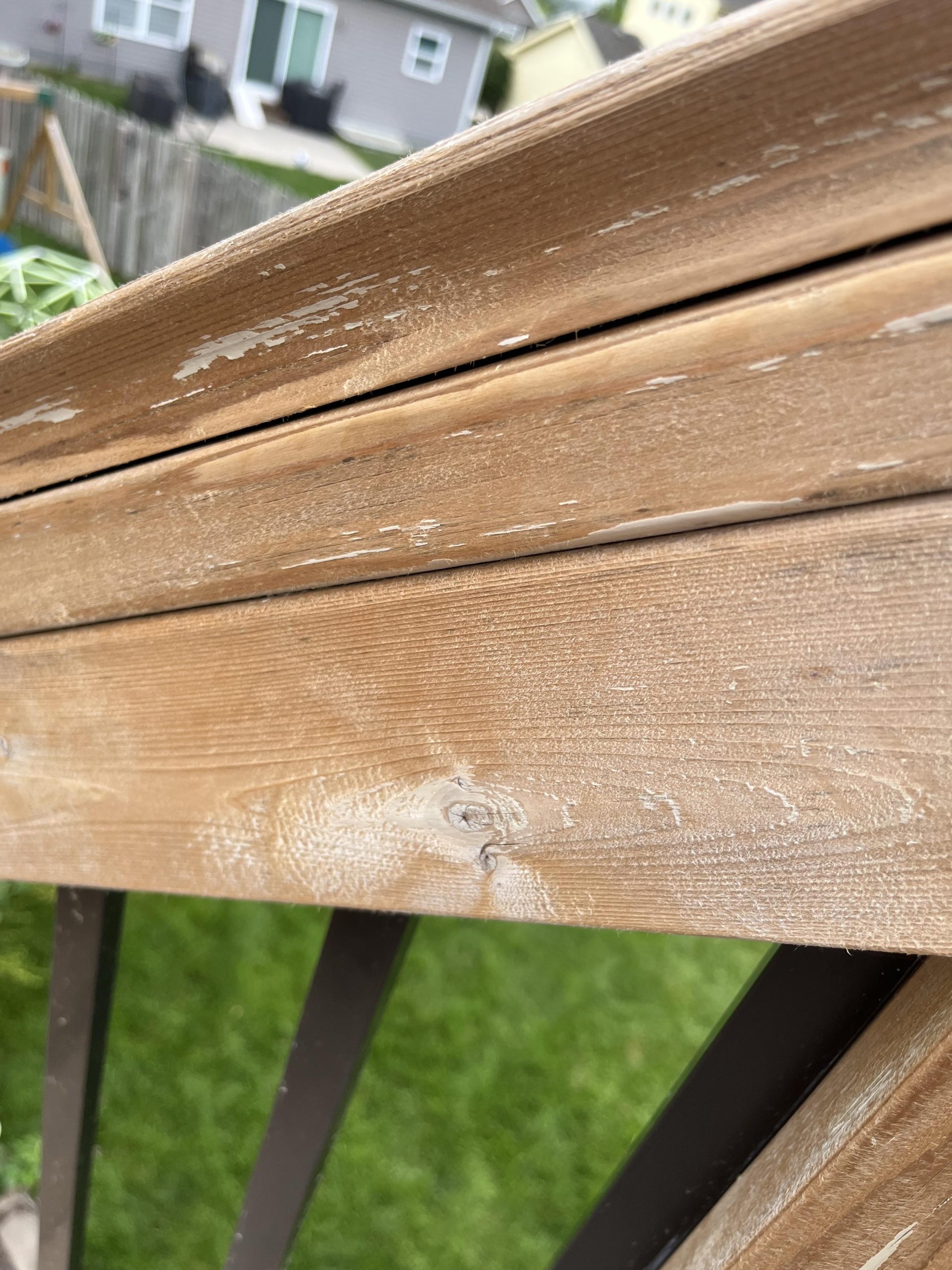

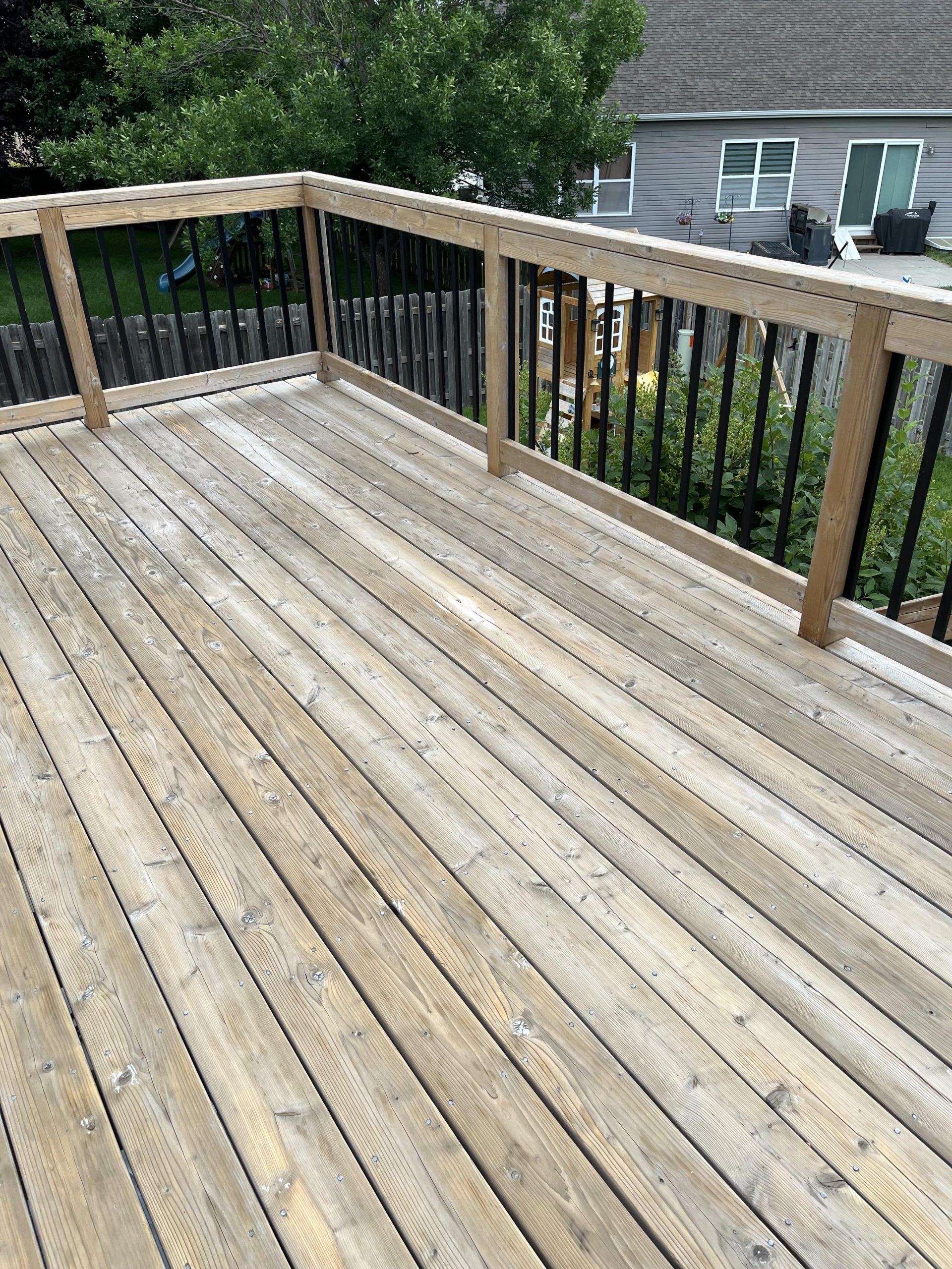

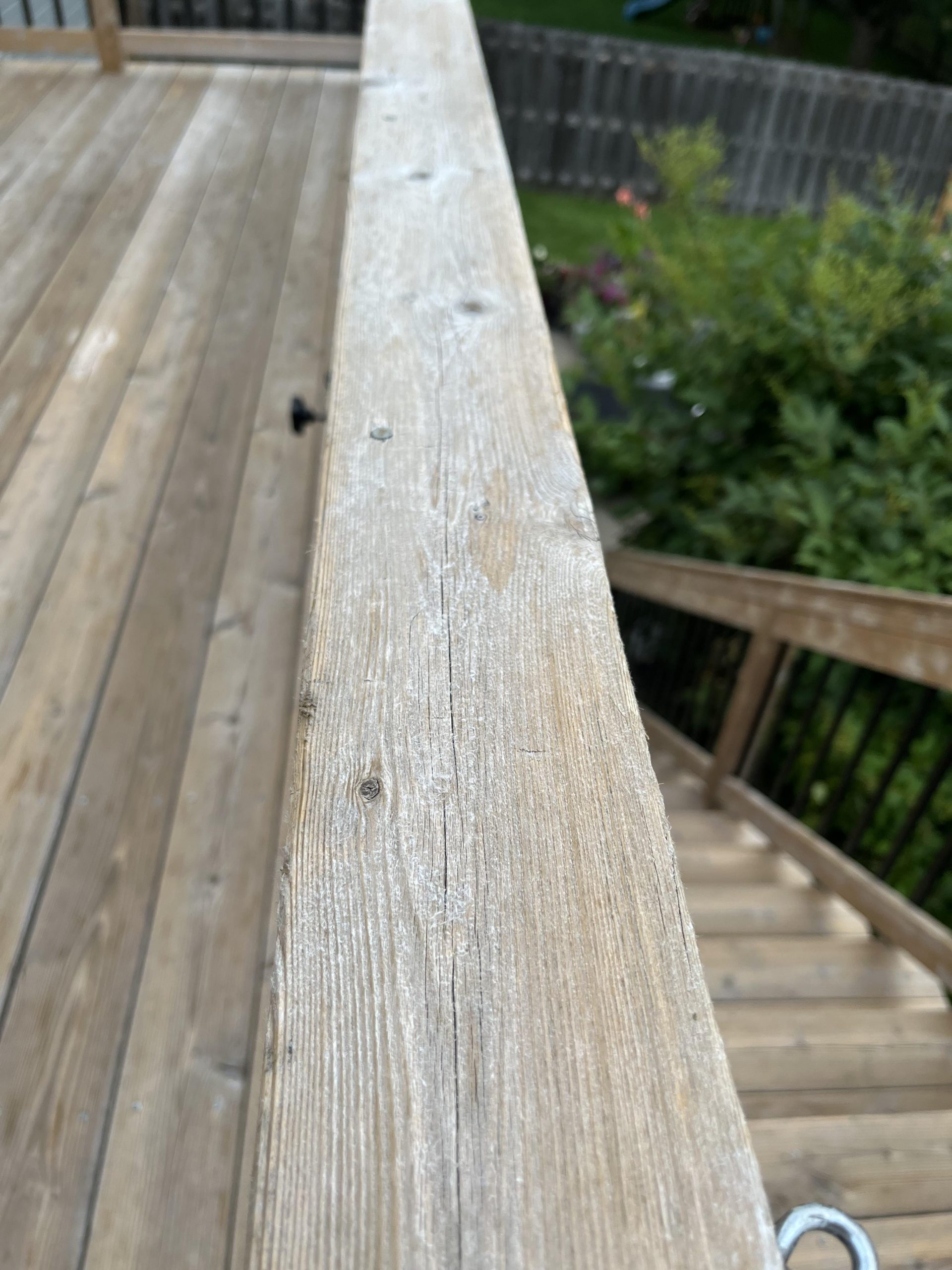

I am just had my deck power washed and the painter made a mistake and believed our previous stain was not a semi solid stain, he is now suggesting either sticking with a solid stain or stripping the previous semi solid stain. The previous stain was Sherwin Williams SuperDeck Semi Solid White Birtch, the power washing removed a good amount of the previous semi solid stain, however, the new semi transparent stain is not soaking in. Which wood stain stripper should I buy to finish the removal of the previous finish? Power washing did a pretty good job but there is still some blochiness present etc.
Add some pics for prep help.
The power washing took a good portion of the semi solid stain off. However it’s patchy and still has a residue.
It looks pretty good so far. Finish the job with the RAD Stripper: apply it, let it dwell 20–30 minutes without drying out, scrub with a stiff bristle brush, then rinse with the pressure washer. Once it is uniform, follow with the RAD Brightener, rinse, and let dry 48 hours before stainin
Would the stain stripper suffice here or are you recommending the solid stripper product?
The RAD Stripper (stain stripper) is the right product here for this since most is removed.
