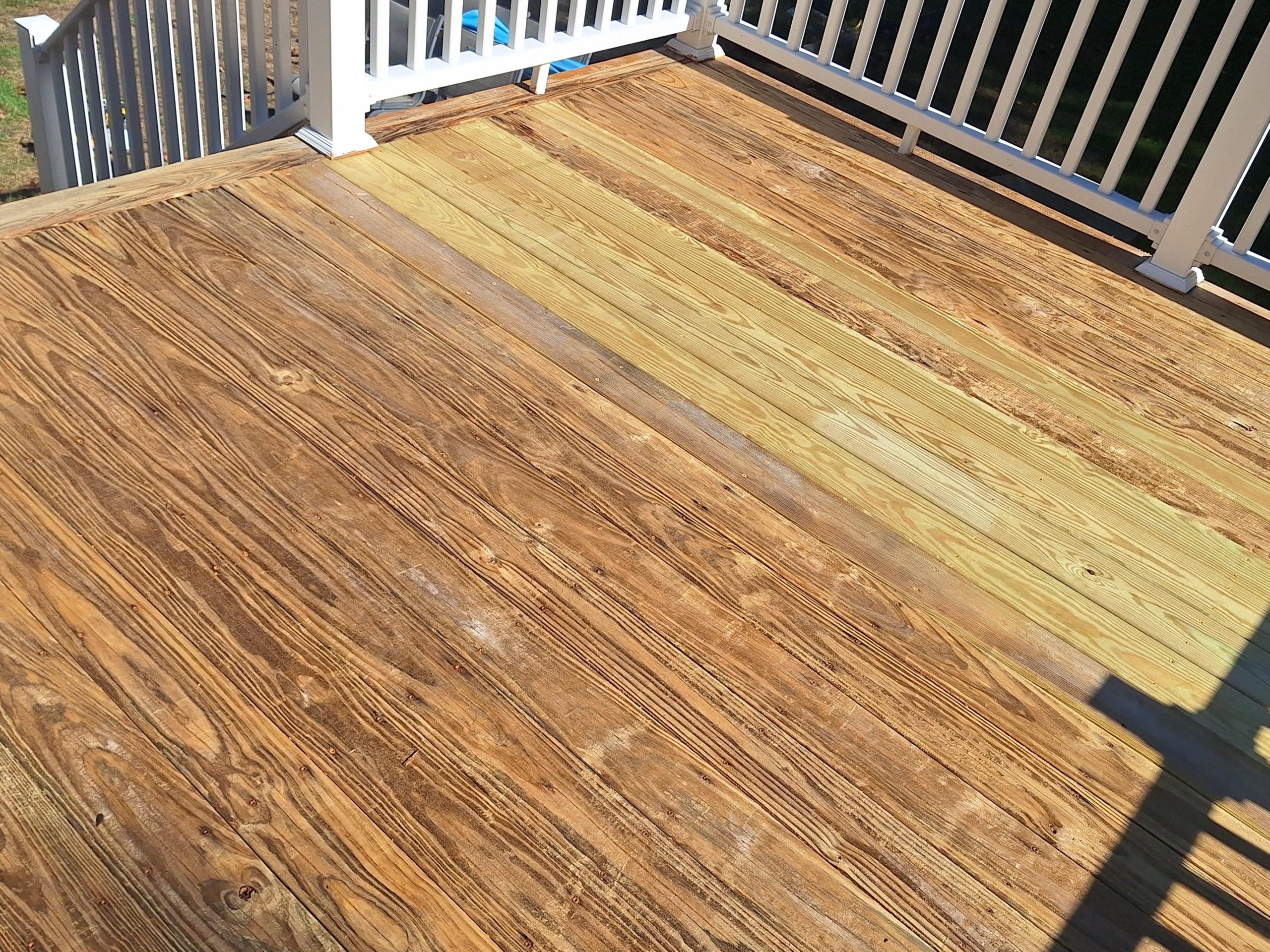

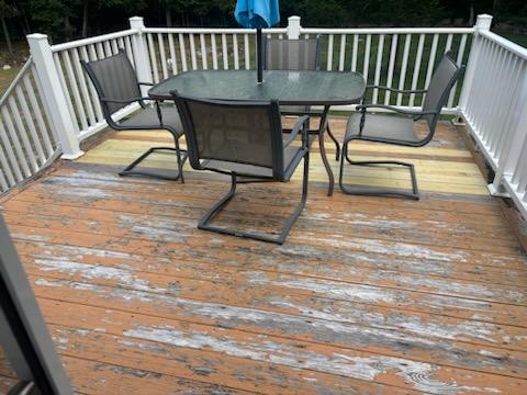

Hey there used behr premium stripper on a solid stained deck that was chipping all over used this product with a hard brush and a commercial power washer took all the stain completely off down to bare wood ,in my opinion the product worked amazing no issues I think as long as you follow the procedure it will work great
Worn wooden deck with peeling stain, outdoor furniture including a table and chairs, indicating the need for effective wood care products like Behr Premium Stain and Finisher Stripper.

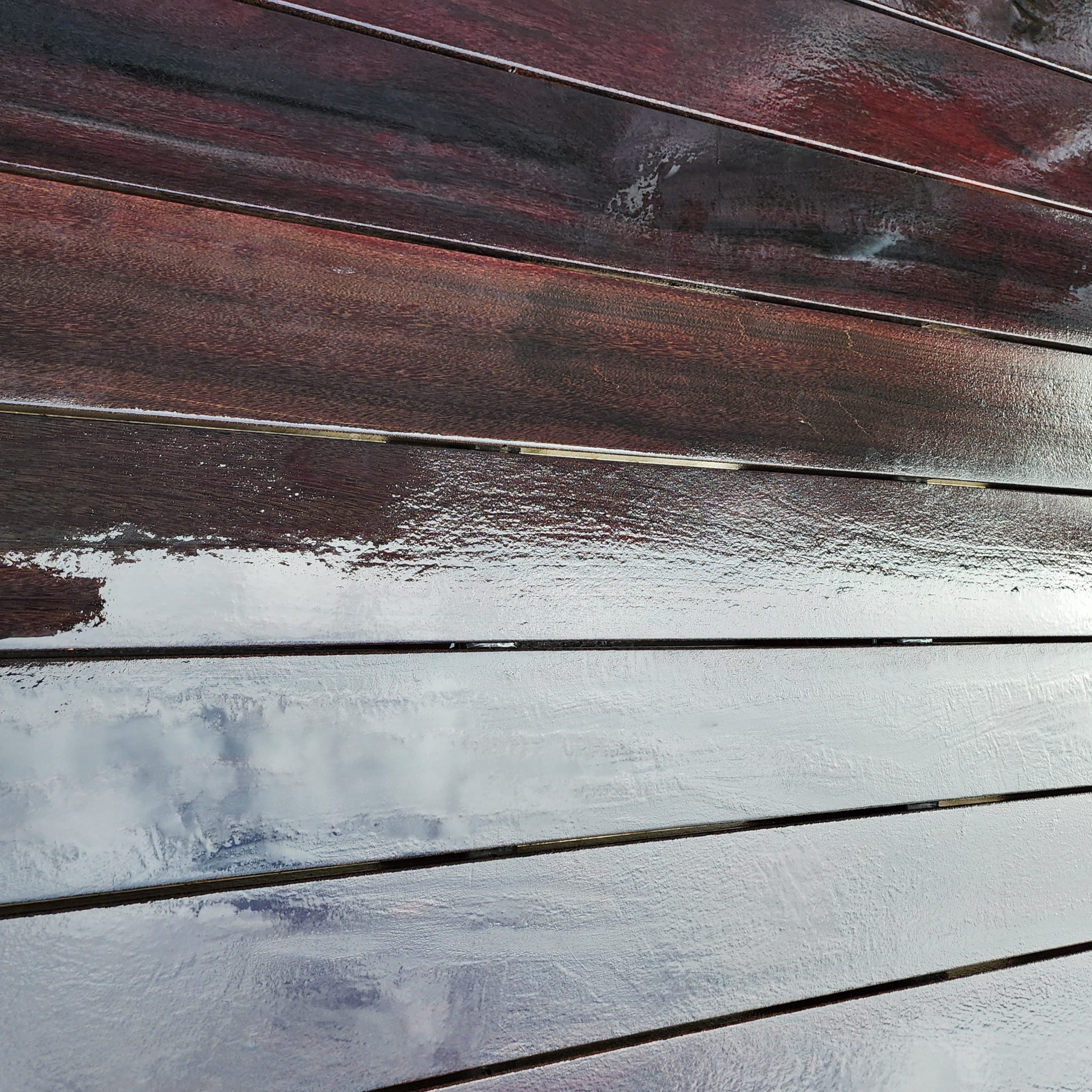

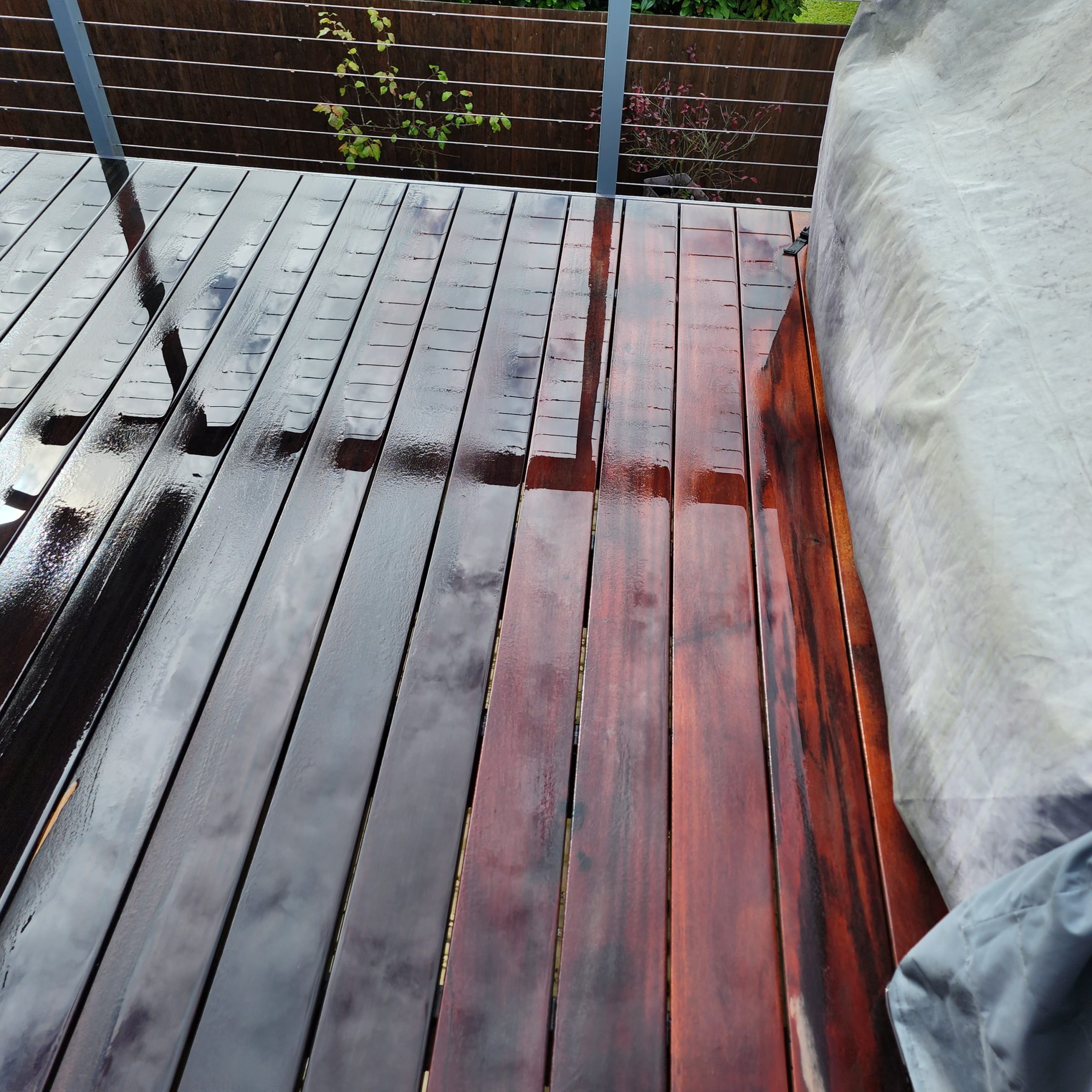

Gary Zukowski
I used this deck stripper and it darkened tigerwood after use and left a film residue on deck boards that I cant get off. Can you offer any advice as to how to get this film off? I have tried the restore a deck cleaner, brightener, penofin stripper, pressure washed it, nothing gets it off. I have heard sanding doesnt work, I am desperate. I started using penofin stripper and got 2/3 of my deck done, looks great. It was a sunday, and store that sells penofin was closed, and weather window was short, so I went to home depot and bought Behr, since it had same main ingredient. Half the deck looks great, the way it did when I resurfaced it twice before, half of deck looks dark, gritty with a residue left on boards, and is slippery to walk on when wet. PLEASE HELP ME, WHAT PRODUCT CAN I USE TO GET THIS CRAPPY PRODUCT, ESPECIALLY RESIDUE FILM OFF. AM REALLY DESPERATE
Deck boards showing uneven staining from Behr Premium Stain and Finisher Stripper, with darkened and glossy areas contrasted against cleaner, natural wood tones.
Deck boards showing darkened tigerwood with glossy film residue, highlighting issues after using Behr Premium Stain and Finisher Stripper.
