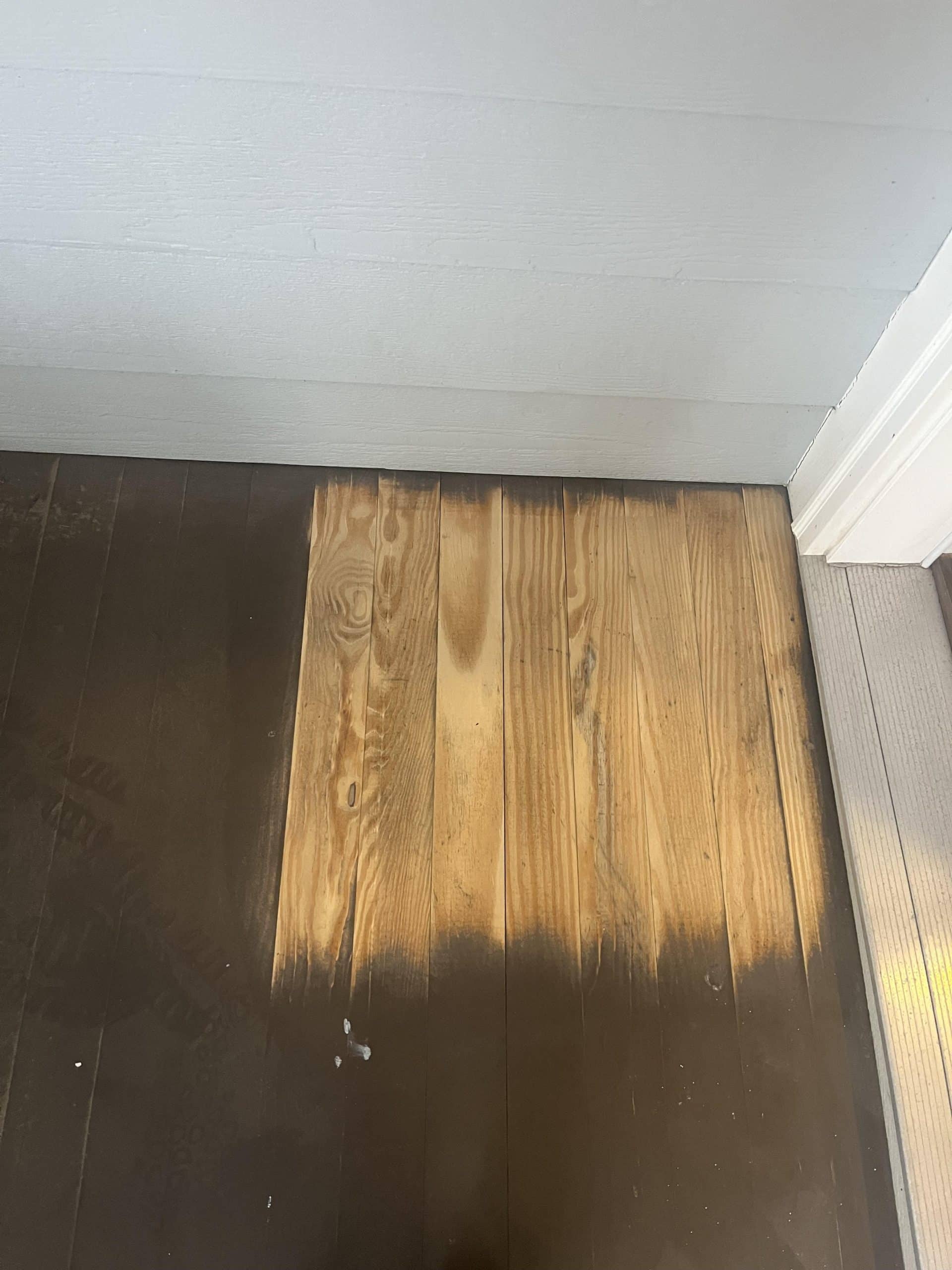

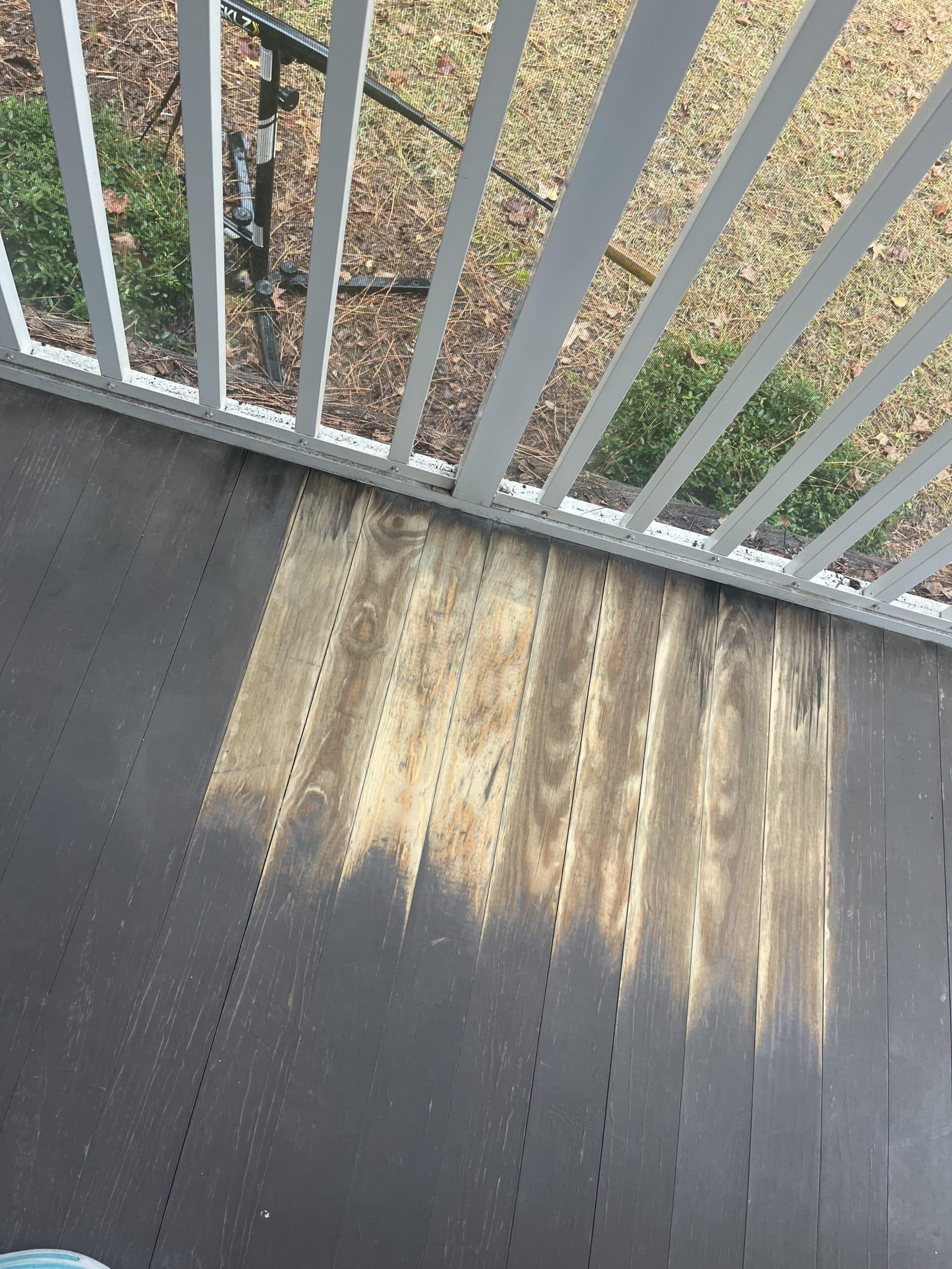

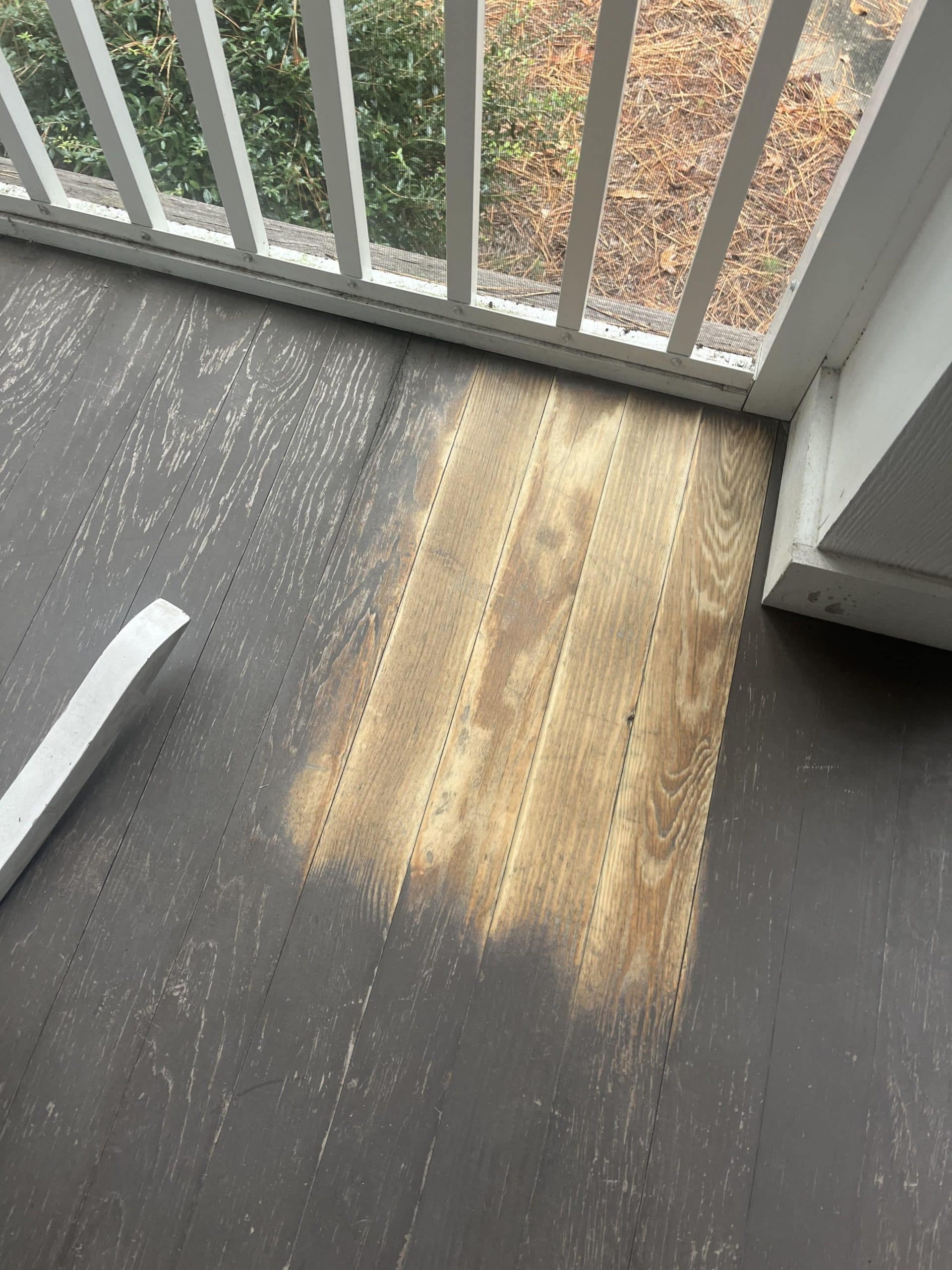

Clean or Strip Your Deck
Clean or strip your deck using products intended for this purpose and follow the manufacturer’s instructions. Apply the appropriate prep products and agitate the surface thoroughly by scrubbing with a firm brush in the same direction as the wood grain.
After scrubbing the surface, wash with moderate pressure using a power washer around 1500 to 2000 psi. Immediately after cleaning or stripping, rinse thoroughly and apply a deck brightener, which is often called a neutralizer. The brightening process helps open the pores in the wood and neutralizes any remnants of the cleaning product you previously applied.

So I stripped my deck today and then applied the brightener but during the application my sprayer failed and I had to apply in an alternate fashion doing so caused me to not have enough to put brightener everywhere. I had wanted to stain tomorrow but now not sure if I can. Is there a substitute product to use or ok to skip the brightener I did pressure wash after stripping. I could stain most and go back to the 2 areas if I need to order more brightener.
It may not stain evenly if you don’t brighten all the wood evenly.
So since the unbrightened areas are 2 sections that are very distinct can I go back and brighten them ? 1 is steps the second is a strip that in its own section and if yes do I just mist and apply the brightener ?
Yes, you can brighten them. Just apply and rinse off when done.
