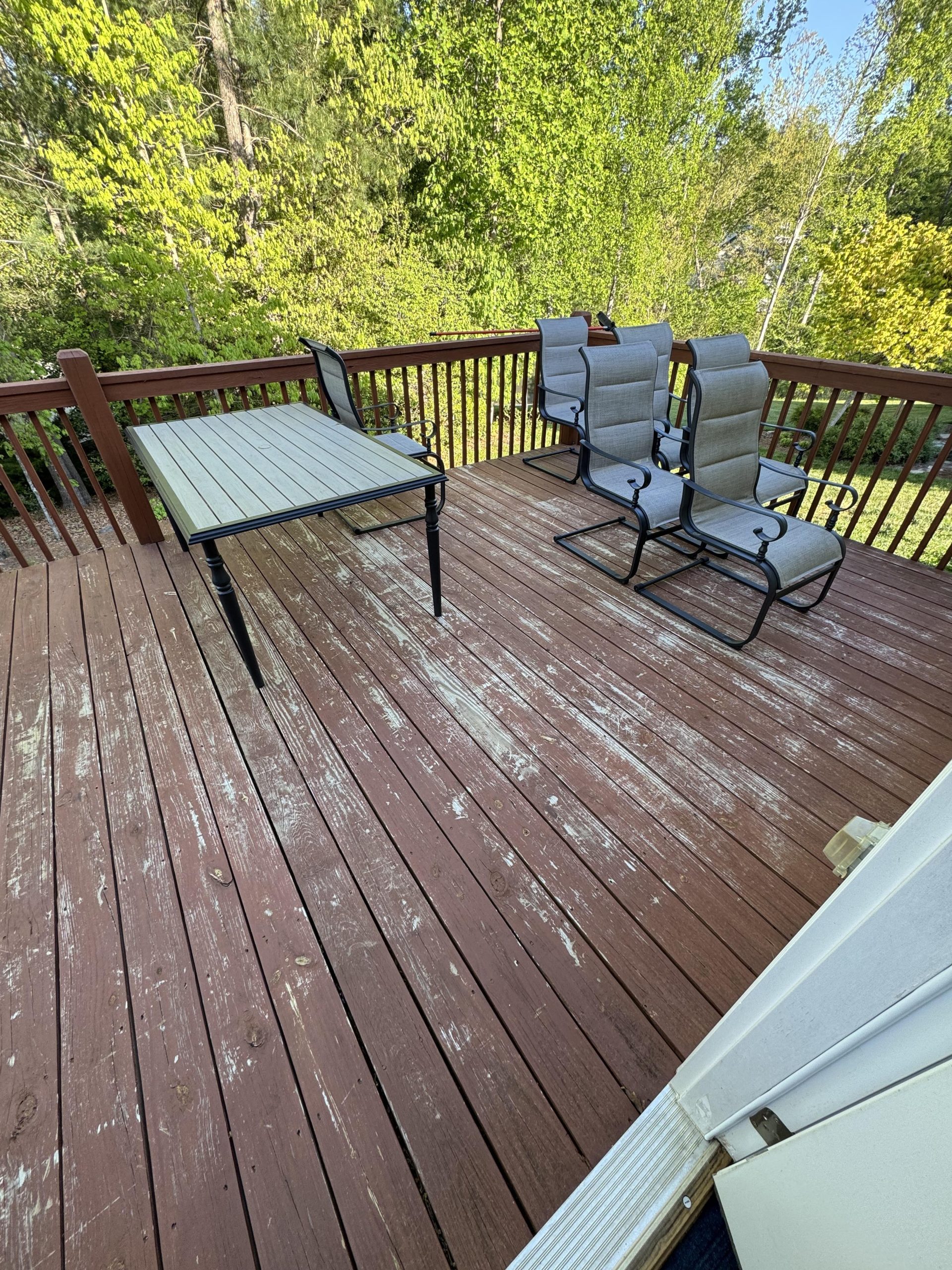

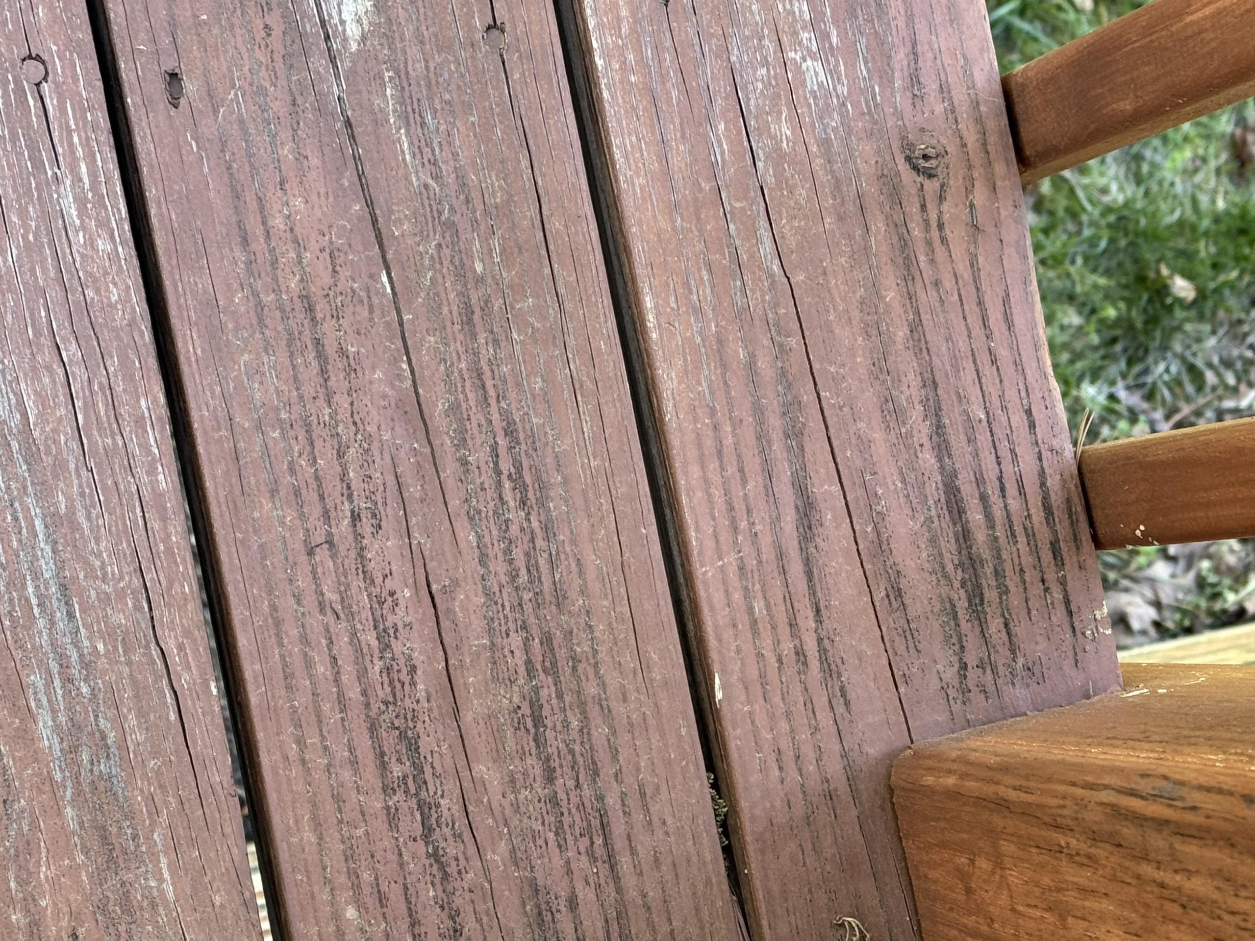

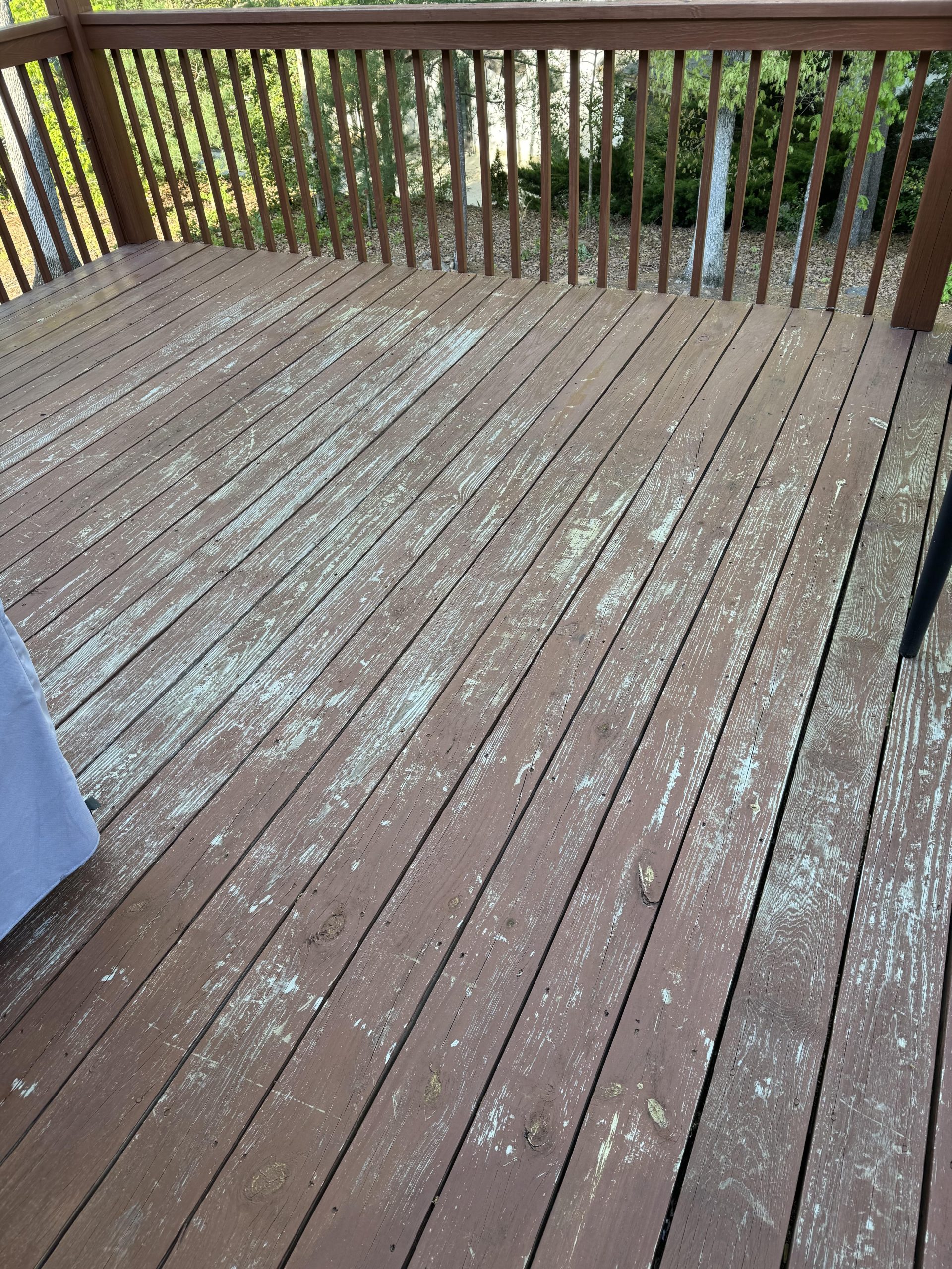

We purchased a home that is 4 years old with a deck that has semi transparent stain on it. There are many areas that have worn off of the deck floor . I planned on restaining and We purchased the exact brand, color, etc station that is already on the deck but I am now wondering, is this ok or must we first remove the old stain?
Varies based on how it has worn. Add some pics in the comments for more help.
Here are the pics. I think most of this is from the sun. (We live in the south).The was some wear when we moved in, but it has gotten worse and we really don’t use the deck a lot. Also the deck is on the west side of the house and within the grain some areas of the deck there are black areas that I am assuming is mold but I’m not sure. I have used deck wash on it before and it is better, but I can’t get all of it out. I have never used a pressure washer on it though.
The stain is currently on the deck is Valspar. Not sure if that’s a great brand or not. I also think that the previous owner applied to stain on pressure treated wood before it was ready. Just a suspicion.
Valspar is a poor stain brand, and instead of penetrating, it films on top of the wood. This is one reason why it has worn unevenly. It is also not truly semi-transparent, but more opaque. They lie about this in their description:
https://www.deckstainhelp.com/valspar-one-coat-stain-sealer-review/
You should fully remove it down to the bare wood and use a true penetrating semi-transparent stain, such as these:
Thanks. I had a feeling it was garbage stain because I suspect it was either the builder that applied or the homeowner that didn’t know any better. I’m older and not really able to get down on my hands and knees. Can you suggest a way to remove that stain? I really do appreciate your help. I wish we were close to your area so I could just hire you to do it. Lol.
Not easy to remove this since it is filming and resembles a more opaque stain. You could try this stripper kit with both additives:
https://www.deckstainhelp.com/product-category/restore-a-deck-stain-stripper-additives
or use the RAD PaintStrip:
https://www.deckstainhelp.com/product-category/rad-paintstrip-paint-solid-stain-stripping-gel/
Thanks. Although I hate to do this, if I just reapply over the old stuff will the with areas show through? I hate to put lipstick on a pig by using the same product, but I’m not confident that I won’t do more harm than good or even do damage to the wood by doing it wrong. There isn’t anyone in our area that I can hire to do it.
Yes, it will look bad and even make it harder to remove when needed. Search “deck restoration contractors nearby” on Google.
Thanks. I will do that.
