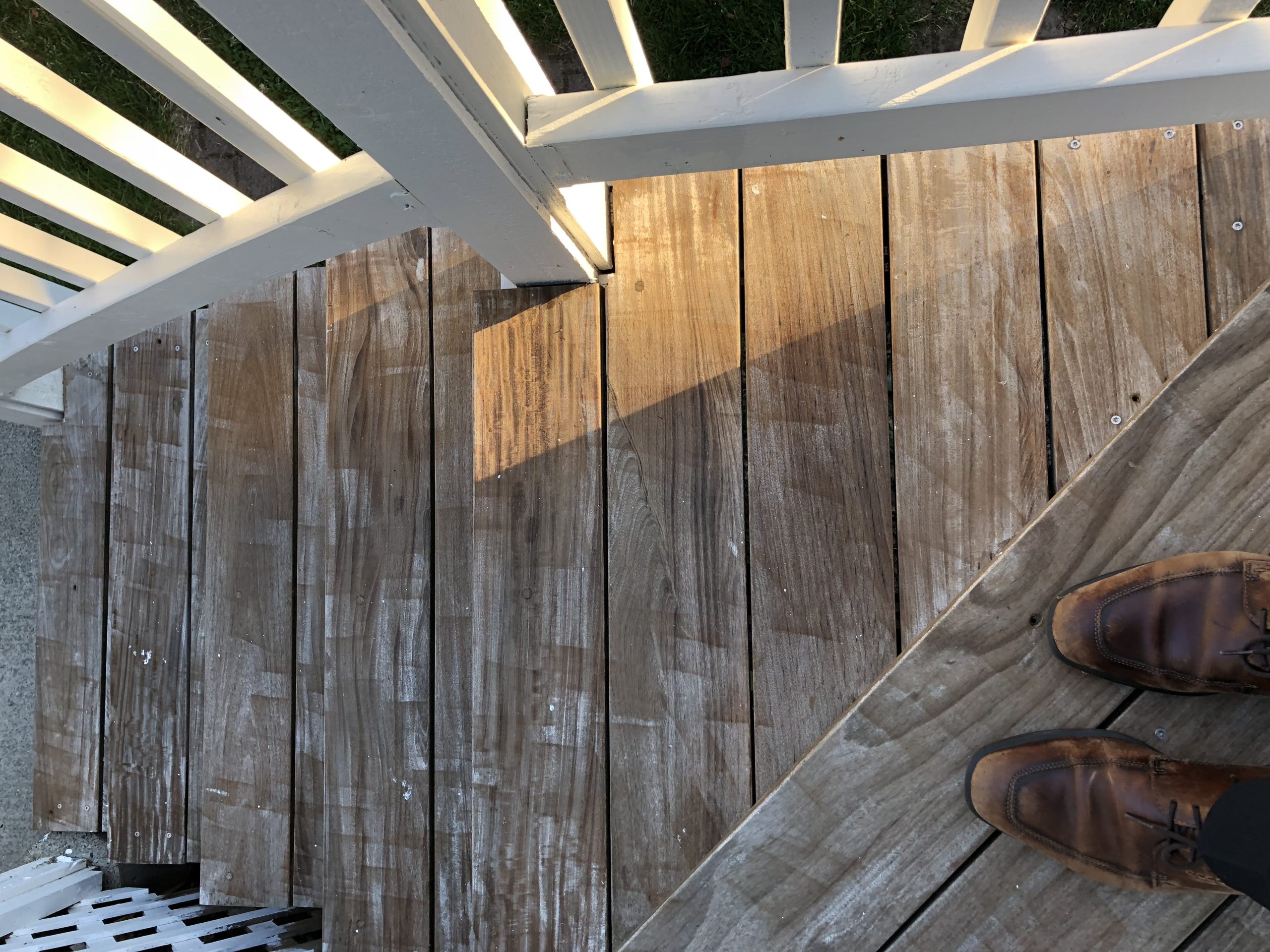

I am trying to restore a neglected ipe deck. it had 2 different, probably incompatible stains on it. I have several concerns. I used the RAD stripper, followed by RAD neutralizer/brightener. There were “fuzzies” on the wood where it was previously too aggressively power washed. I sanded the wood to remove the fuzzies, with partial success. Do I need to wait and re-brighten before staining? I also have black streaks in some areas that are still notable despite 3 strippings and neutralizing. Is this a black mold? The wood has also cracked. Is there anything I can or should do for this? I live in central MN and the deck is on the north side of the house where mildew is quite a problem. I love the color when it is wet. Recommendations?
PS The RAD neutralizer said to wash down for 20-30 minutes, but didn’t clarify what size area that was for. I did my deck in 4 sections, rinsed each section for about 30 minutes per directions, and then realized that i’d rinsed my 13×13 ft deck for nearly 2 hours!!
The black marks look like internal water stains and will not come out. Cracks are normal on exterior wood, so just leave them as is. I would not worry about the fuzzies that much as they stain just fine. For the RAD Brighener or any brightener, apply to all wood and then spend 20-30 minutes rinsing all wood after.
Go ahead and stain.

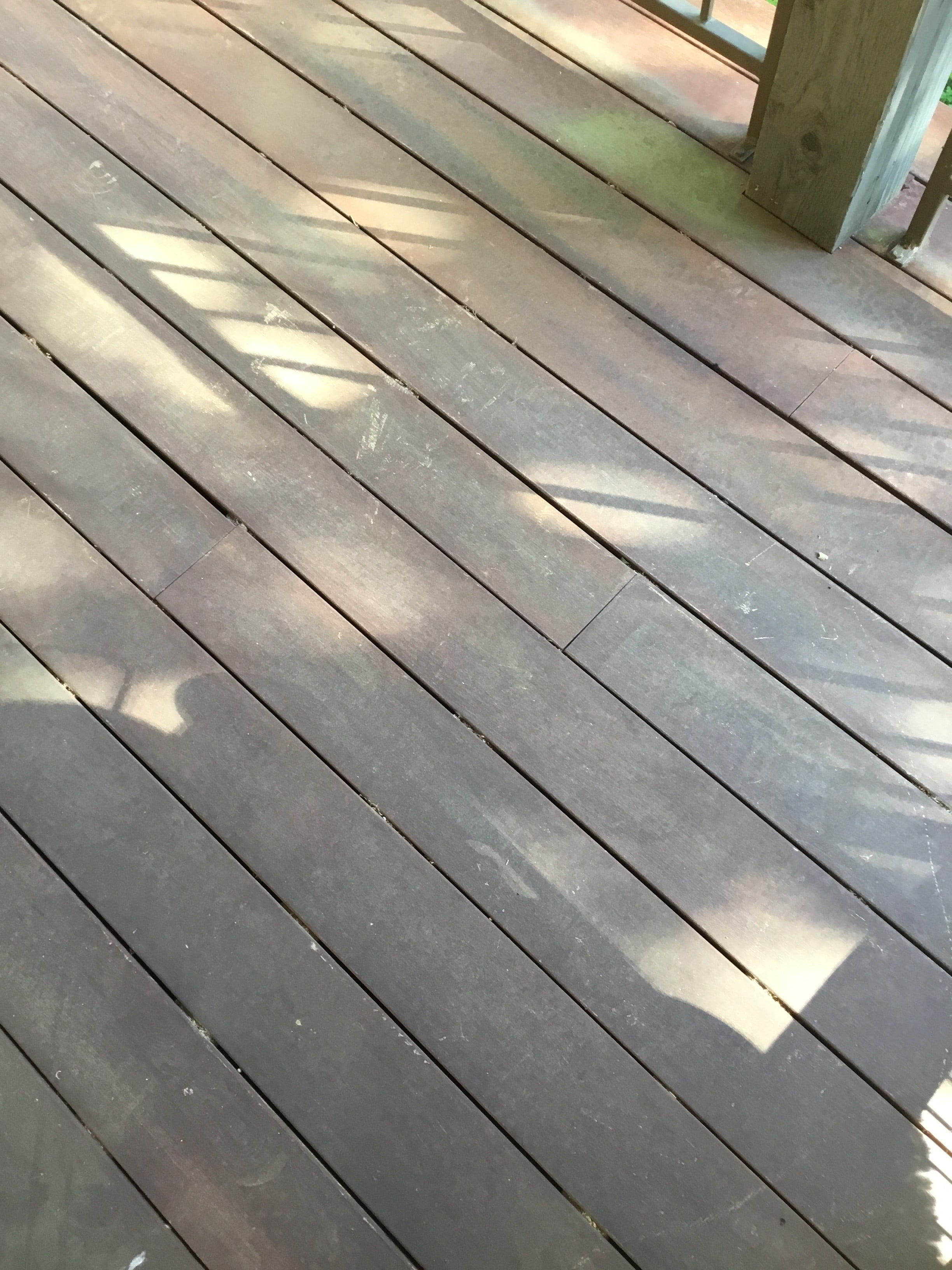

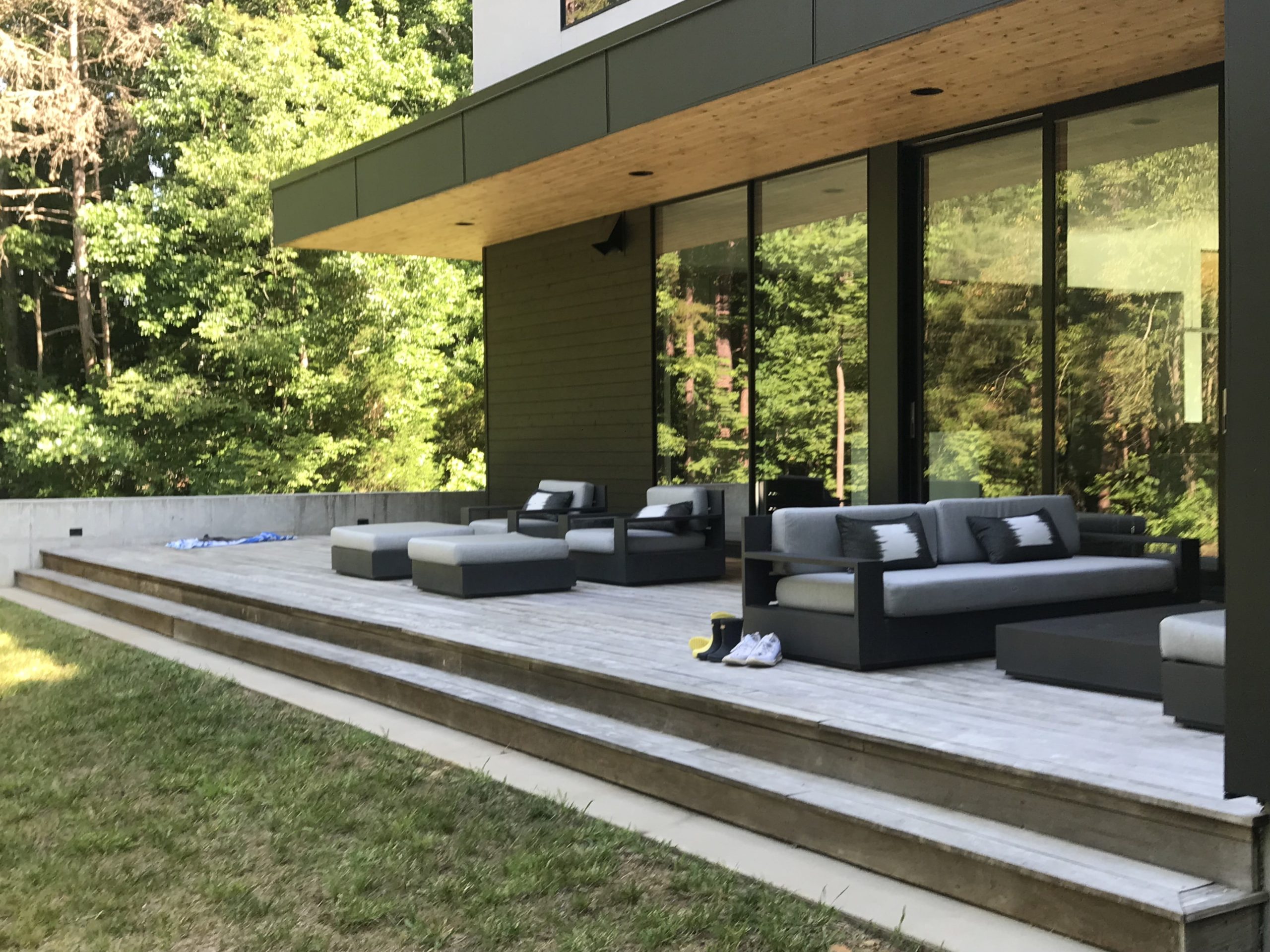

We had our deck powerwashed close to the wood a few days ago and plan to stain using either RAD or Armstrong. I have attached 2 photos of the deck + a 3rd photo of the porch ceiling which is the color we’d like to restore to.
A few questions please:
1) Do you think we should use RAD stripper + brightener first based on these photos? Unsure if the deck has been stained in the past.
2) As for the stain, do you have a recommendation on which color for the RAD semi-transparent stain to match picture #3? We were thinking Natural.
3) If we go with Armstrong instead, do you have a color recommendation?
1, It would not hurt.
2. Natural is similar to a clean wet look so that would be closest.
3. Amber

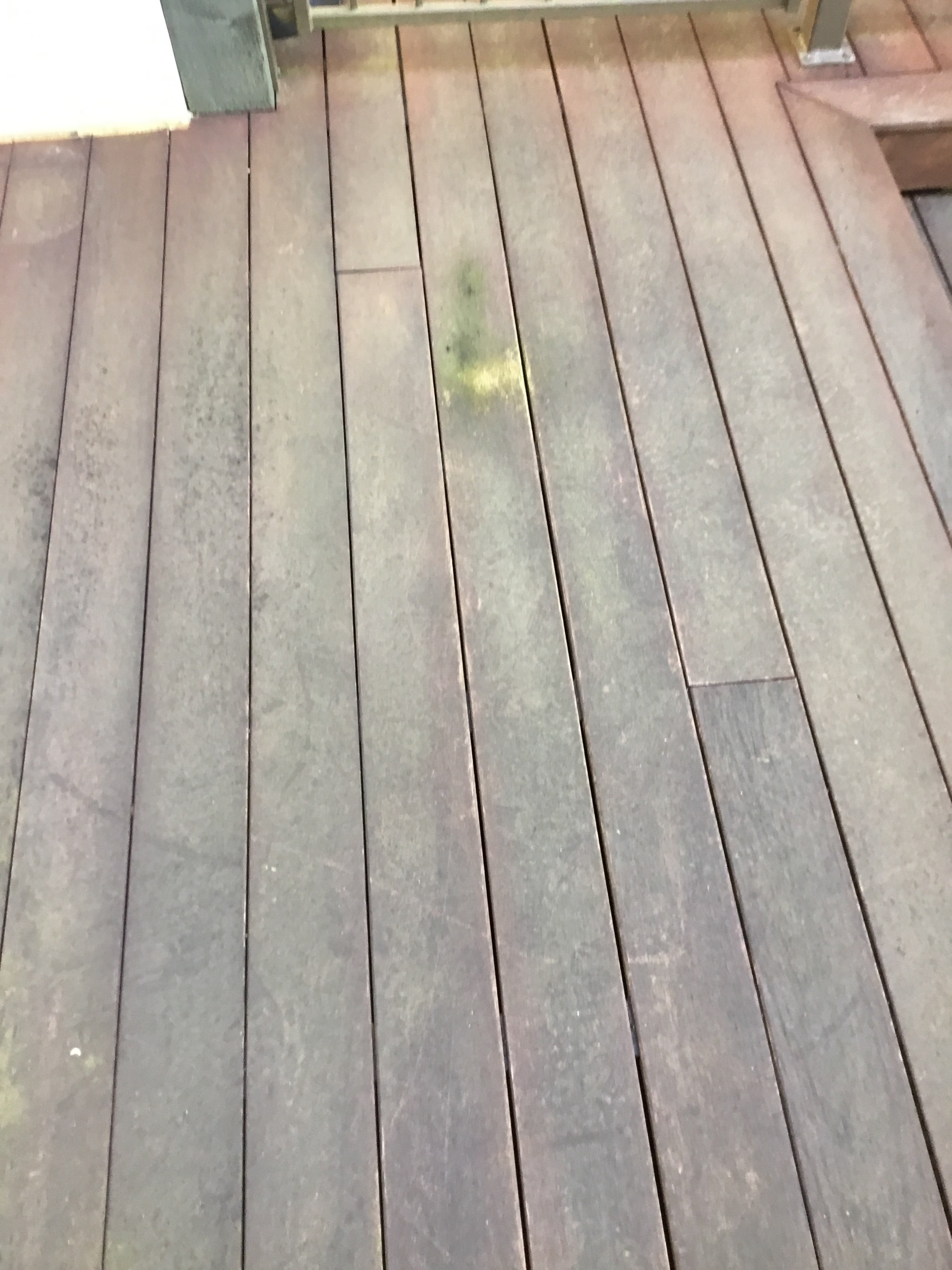

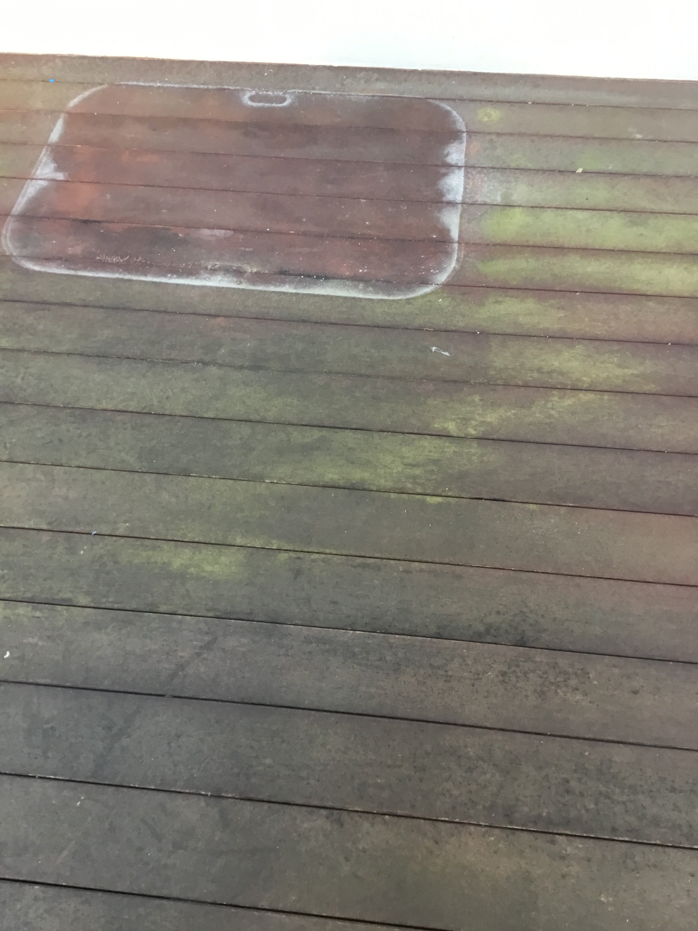

Looking for advice on next steps on prepping ipe decking. We are refinishing a neglected section of decking. So far, sprayed and scrubbed with sodium percarbonate, rinsed and 1x treated with oxalic acid. There are a lot of light spots from flower pots along one edge (photo is wet state after acid). Would it be better to apply acid one or two additional times or sand to try and blend light spots?
Is there an old stain on the deck? If so, it needs to be all stripped off and then brightened. If it is just wet, then send a picture with the wood dry.
The deck only had it’s mill finish on it and that was 10yrs+ ago. It was weathered and silver colored prior to Sunday’s treatment. This is a photo from today, after it dried.
The only way we think you can even it all out is to power sand it evenly with 60-80 grit paper.
Thanks for the advise. I just want sure if some additional acid (maybe citric) would help help prior to the sanding. I appreciate the input.
No, doubt it will but you should use a wood brightener after the sanding is done.

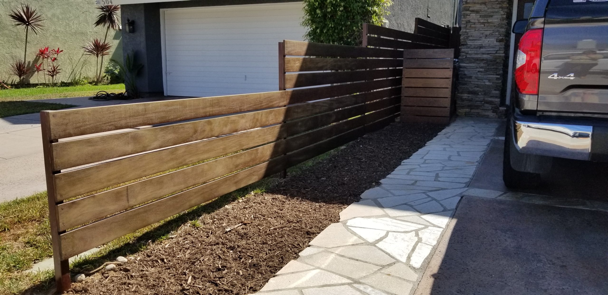

Is there anyway to stain IPE to achieve the driftwood gray color it gets when left out in the weather untreated? We have enough IPE to build a small set of stairs in a room with with white oak flooring and are trying to get the color of the IPE to compliment the oak which has a bit of a driftwood colored wash. Thanks!
You could try a gray-tinted stain. Look at Restore A Deck semi-transparent stains.

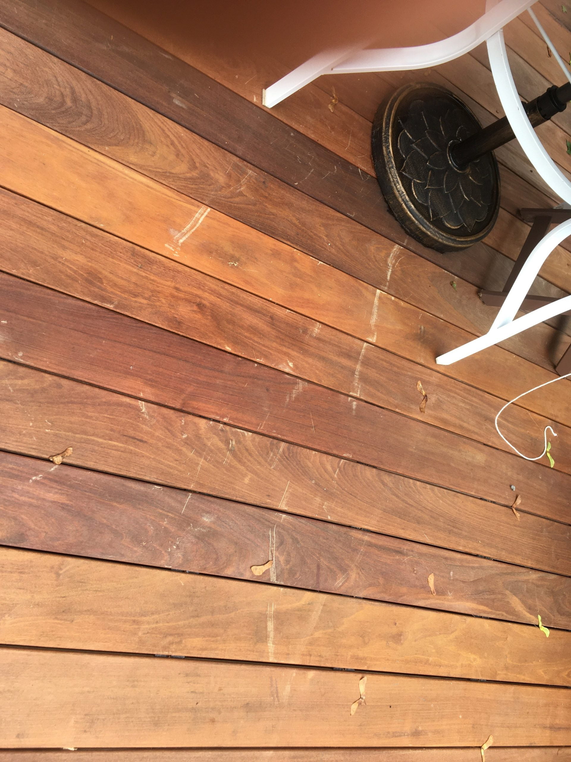

Hi – My new and newly stained ipe deck surface scratches if you breathe on it. I followed all your excellent advice, used restore-a-deck to prep it,both bleach and cleaner, had enough dry days to stain, waited for a while to put furniture on it… and it seems every time something is dragged, I get a surface scratch. Some of them big and ugly. I don’t think the ipe itself is scratched, but it’s sure discouraged me from ever staining again. I keep reading you can’t scratch these decks.. but in my case it’s a mess. What did I do wrong? I used Messmer IPE hardwood natural stain.
Could be that the Messmers did not cure correctly? Post some pictures.
Here you go. Some from furniture movement, some from soap with some bleach, the big wear spot I have no idea.
sorry, pix didn’t load. Will post one at a time
bleach stain
You used “bleach”? You cannot use bleach on deck stains.
No, I did not use bleach. While pressure washing the house, the lovely gents who are painting the house dripped a little of the soap/solution which i assume includes bleach or a lightener of some kind….. I guess i used the word ‘bleach” inaccurately. This was the result. In another spot like this, prior to staining, I had similarly dripped a little of the restore-a-deck part 2 mixture that lightens the deck. That left a lightened mark like this that never smoothed out when the rest of it was done.
They used something in their cleaner that “bleached” out the deck stain.
furniture moved
It looks like you are dragging it and actually denting or gauging the wood in this picture.
yes, this was the work of lovely gents who are painting the house.
I would wait until next year and then strip and brighten all and then use a stain that is not as “soft” as the Messmers. The Defy Hardwood Stain or Restore A Deck Stain in Light Walnut.
thanks! The painters have suggested sanded and patching… but I worry that will look worse. Interesting to hear Messmer’s described as soft. Good to know, thanks!
unknown source
The same thing happened to me and yes it was cured. This is just what IPE does. I moved some furniture on it too. Penofin oil was used on my new deck. Furniture was put on the deck one month later. Also when it rained it left water marks. Its been a year now and I have to decide what to do. Someone told me to try Deckwise cleaner and brighter then their IPE oil.

We have a 2 year old unstained Ipe deck. I love the grey color but would also like to oil/stain it for longevity (and I believe it helps with wet spots/stains?)
What product should I use?
Clan and brighten for prep. Stain with Restore A Deck Stain in Light Walnut or Armstrong Clark in Amber.

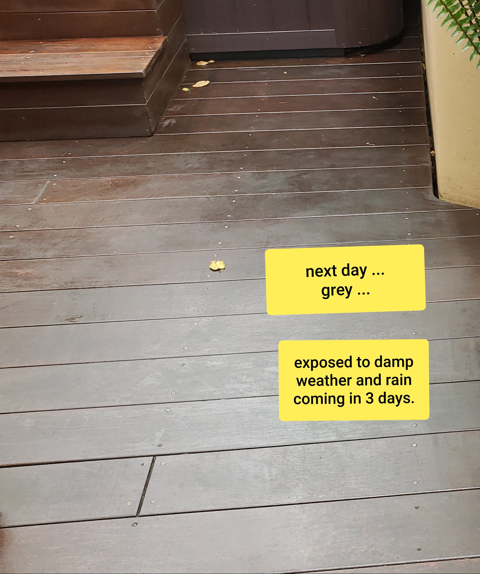

I refinished my Ipe deck yesterday and today we ended up with cold overcast skies. I used Wolman F&P, which is the same as 3 years ago. The moisture is graying the finish before its had a chance to dry. Any suggestions? Am I doomed to have to do the entire process all over again? If so, can I switch to the Defy?
You will need to sand off with a power sander 1005 to fix this. After that is done, lightly clean for the final prep before switching to the Defy Hardwood.

What will happen if I don’t finish the ipe? Am I cutting it’s life short? If so, how much will I lose by not finishing it?
I Dont mind the grey look and prefer to not use any chemicals as I have a small child that plays and sometimes eats off of the floor.
Would it be an option to wait 4-5 years to apply a finish after my daughter has grown up a bit? Would that extends it’s life or would it either be too little too late or too late to apply a finish at all.
Any thoughts would be appreciated!
Thank you again for this great resource!
Try Defy Hardwood Stain. It is eco-safe and easy to maintain. Better to start maintaining now than later.

I have a realist my small porch and the builder used IPE for the flooring. I pressure washed it the other day and left some pressure marks in some areas (Whoops). Can I sand the flooring to get the marks out before I restain? If so what grit would you recommend?
Do the marks show when wet with water? Picture, please.
Yes, just a little darker. We were trying to clean the wood prior to staining.
You still have old stain showing. Best to strip and brighten this to give it a more uniform appearance. Try the RAD Stripper/Brightener products. Only sand lightly if needed after.
