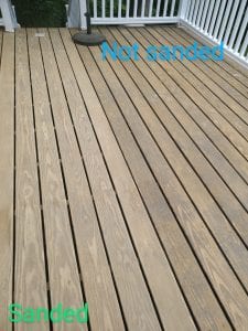

- Clear the deck. Remove all furniture, plants, grills, and decor so you have full access to every board.
- Power wash the deck. Remove dirt and loose coatings. If there’s an existing finish, use a deck stain stripper first. Be cautious with pressure settings on softwoods like cedar to avoid splintering, and let the deck dry at least 48 hours before sanding.
- Secure loose boards. Hammer down any protruding nails or tighten screws so they don’t catch the sander.
- Sand the main areas with 40 to 60 grit. Use a belt sander or drum sander for large flat sections, working with the grain.
- Refine edges and transitions. Switch to an orbital or palm sander for edges, railings, and tighter areas.
- Detail sand tight spaces. Smooth out corners and areas the larger sanders can’t reach.
- Finish with 80 grit. Do a final pass over the entire deck for an even, smooth surface that still accepts stain well.

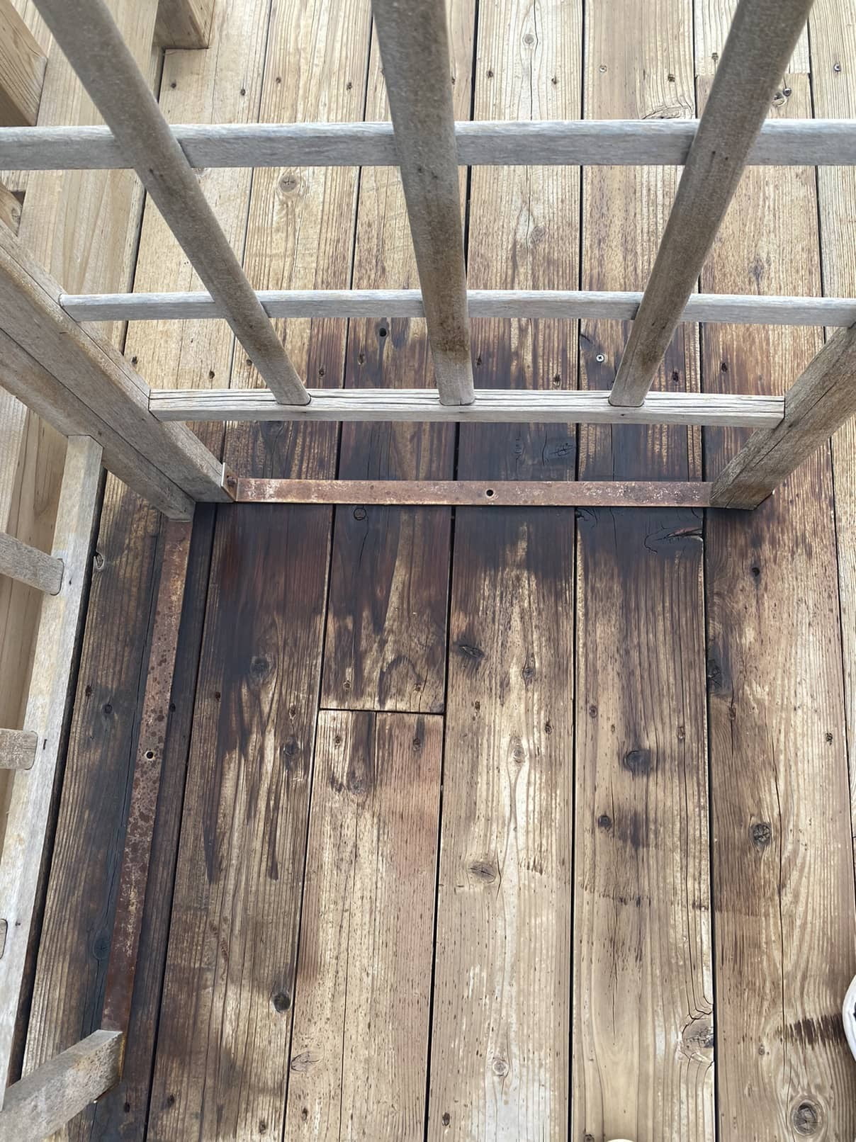

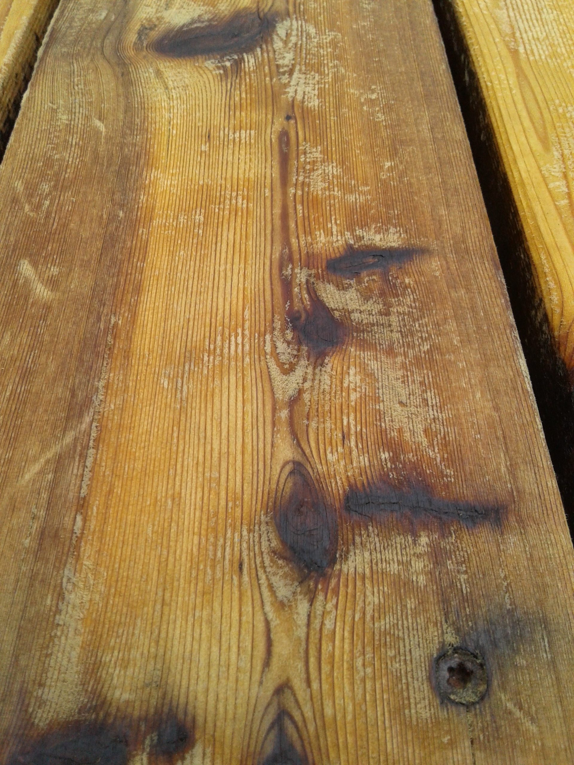

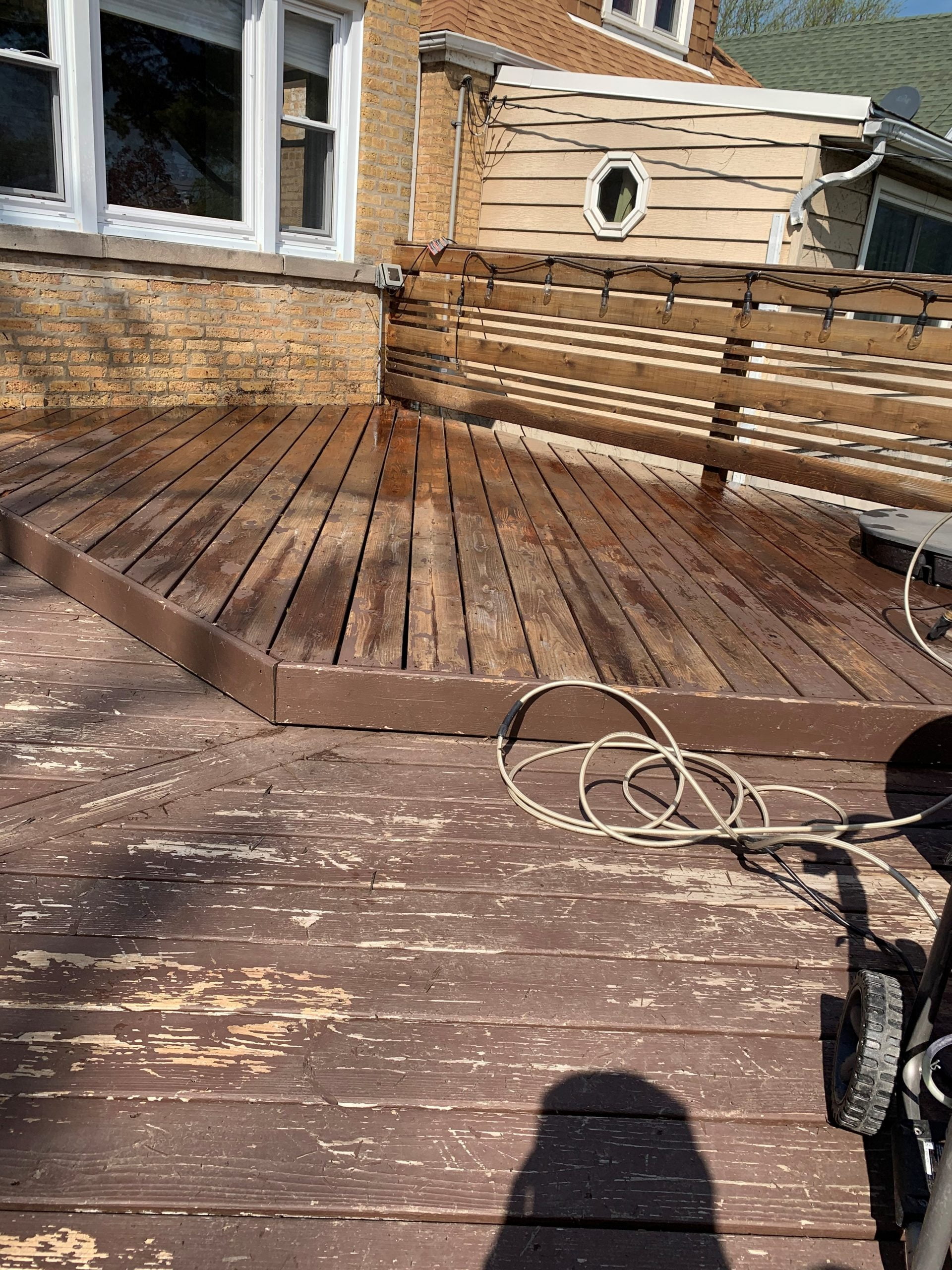

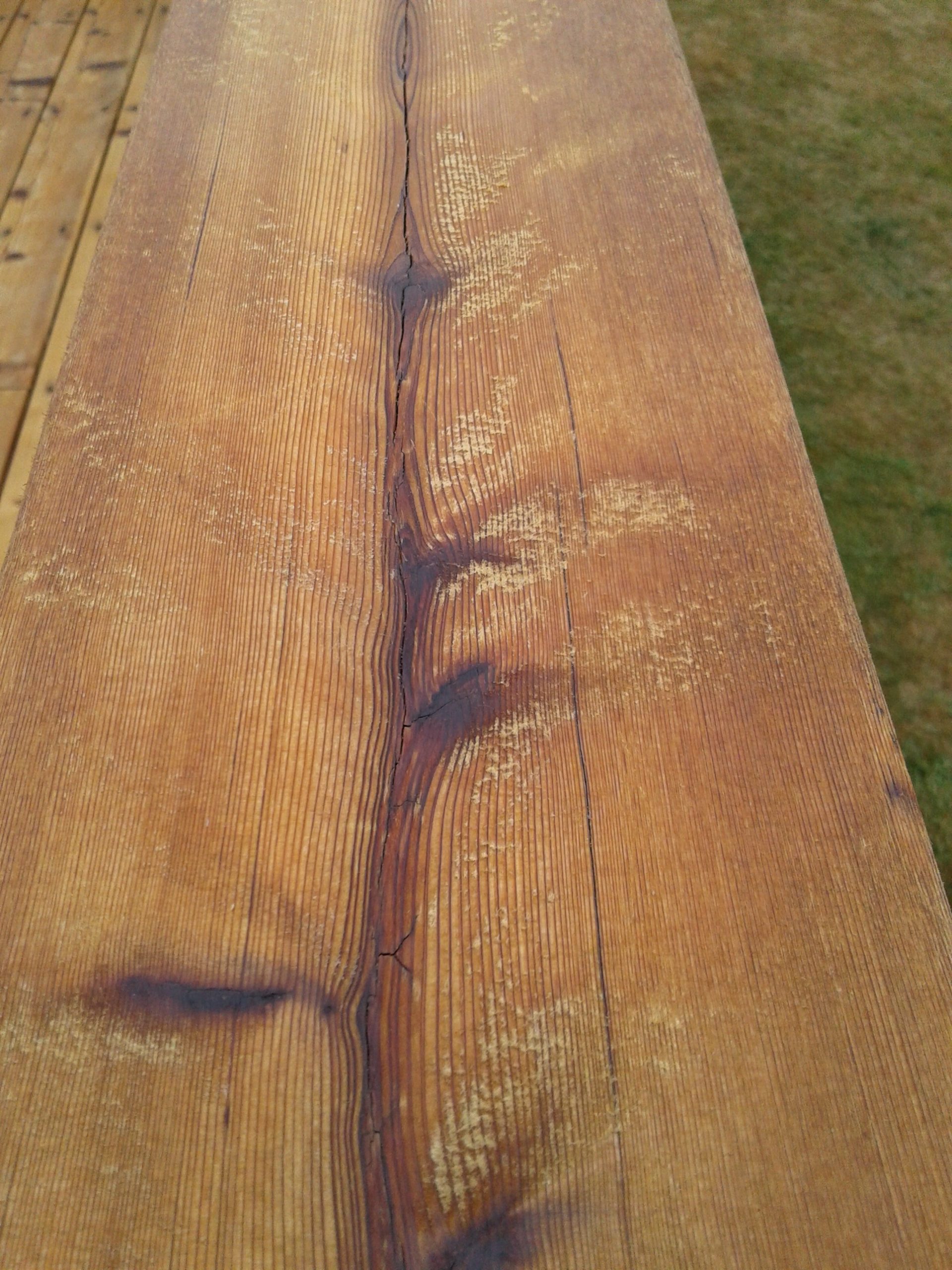

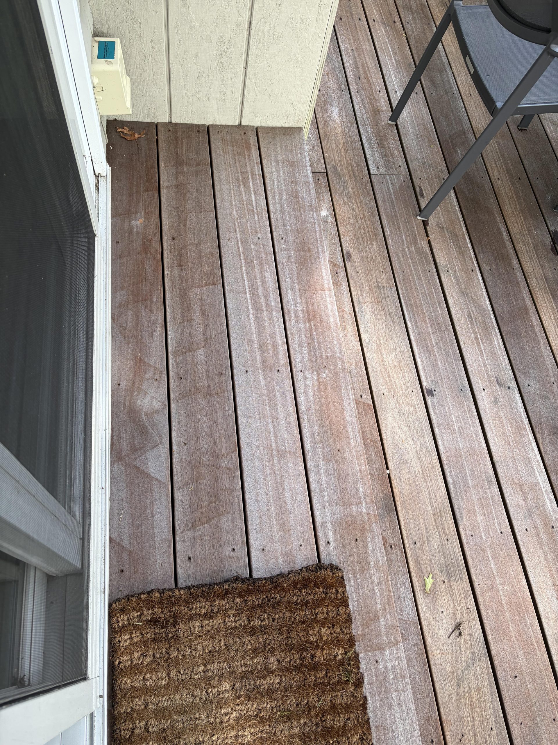

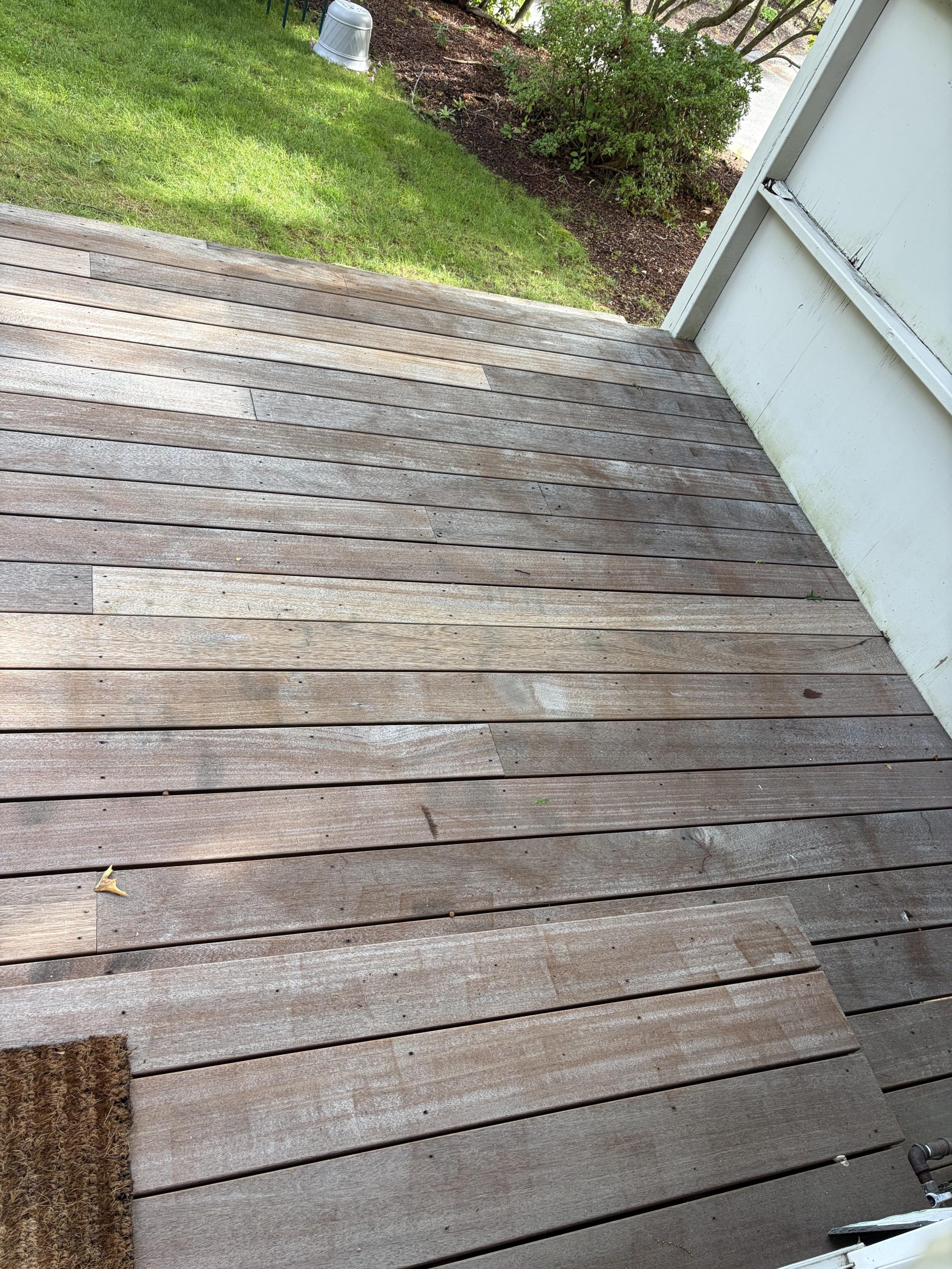

Hello Scott. A neighbor/handyman incorrectly powerwashed my 3 year old Ipe deck. He used an angle brush and a rotary one. Now I have visible lines and circles. Ugh!
How do I fix? I just ordered a wood brightener (oxalic acid based). Thoughts?
The only way to fix this is to sand those marks out:

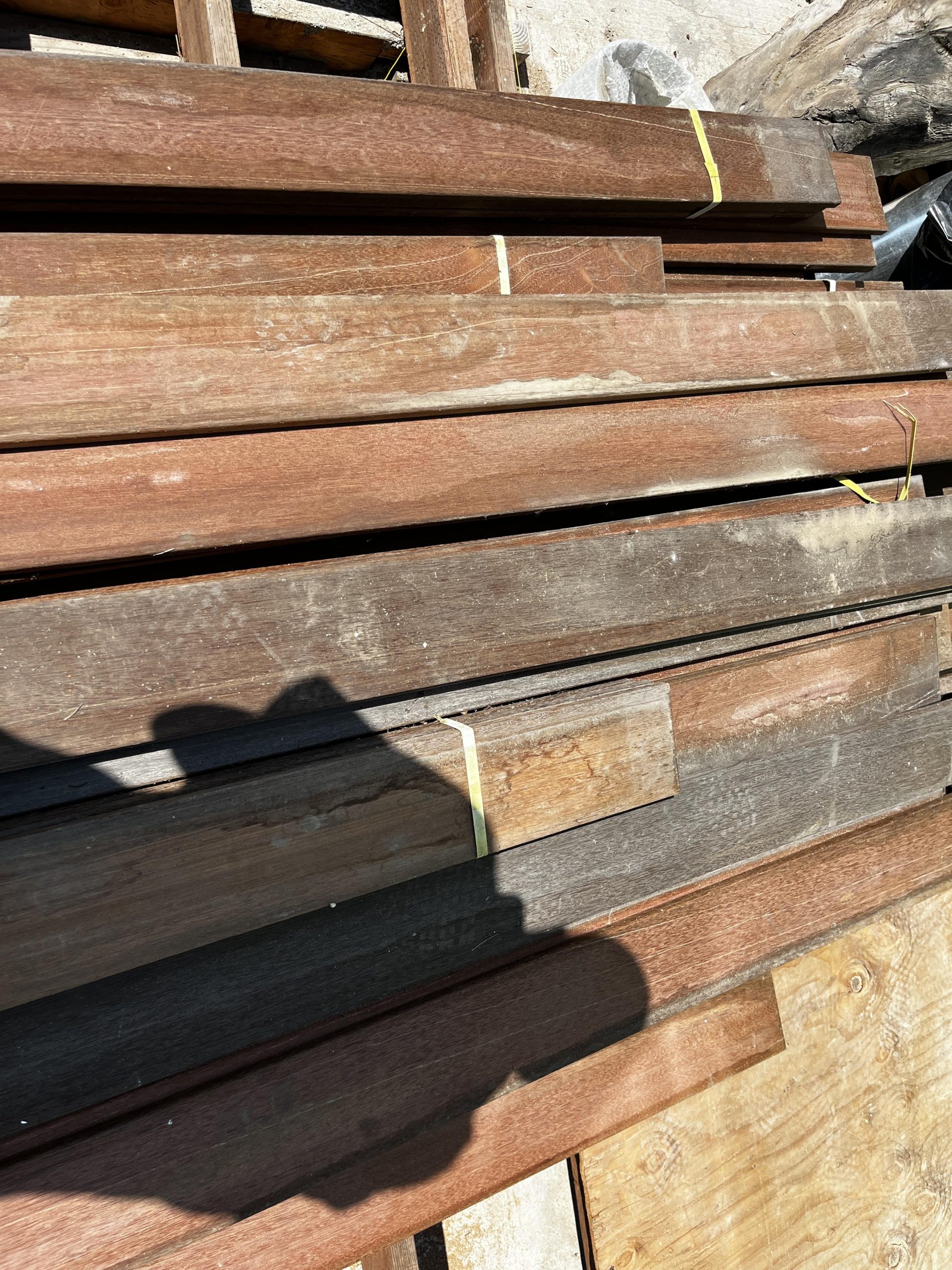

I have deck boards I’m finally ready to use, they have sat in my backyard for 5 years. What course of actions should I preform?
Install the deck, let the wood weather, and then prep to stain.
Really cause I asked same question on a Facebook deck club and they said I should sand it with 80 grit and oil it, install and oil it again, cutek extreme was recommended
Yes, it is normal to wait and prep, but it does vary based on the stain brand you end up choosing to use and what the manufacturer of that brand suggests.
Manufacturer recommends messmers
Messmers suggests a few months of weathering and then the prep, same as we do. From their TDS.

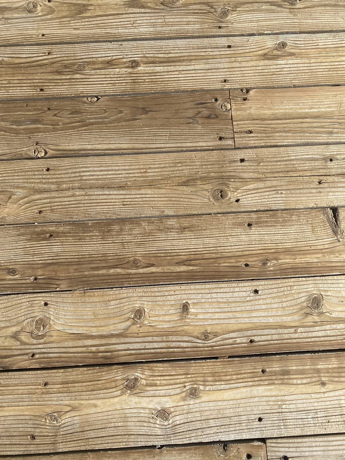

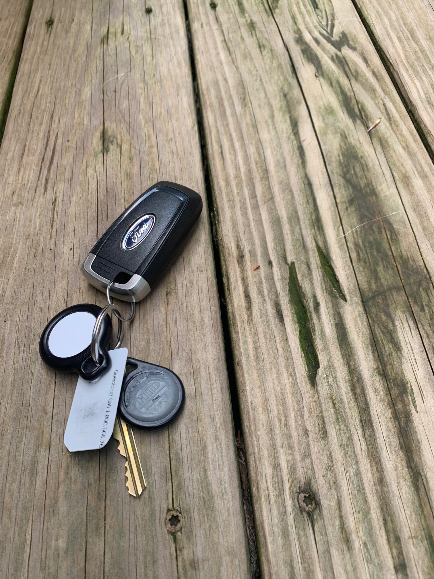

I have a 30 year old pressure treated deck previously has semi solid stain on it. It has been power washed and sanded. It still has some of the stain on the deck especially where the nails have been pounded in. What do I do not to remove all the stain so that I can restain it evenly?
Pictures?
I do not have access to do pictures. I do not want to spend another $100.00 to not get the deck the way that looks good. I tried a stain, but it was so blochey I had to power wash it off. I am desperate for any help you can give. Thanks
Sorry. Not possible to help with prep advice without seeing pictures of what needs to be removed.

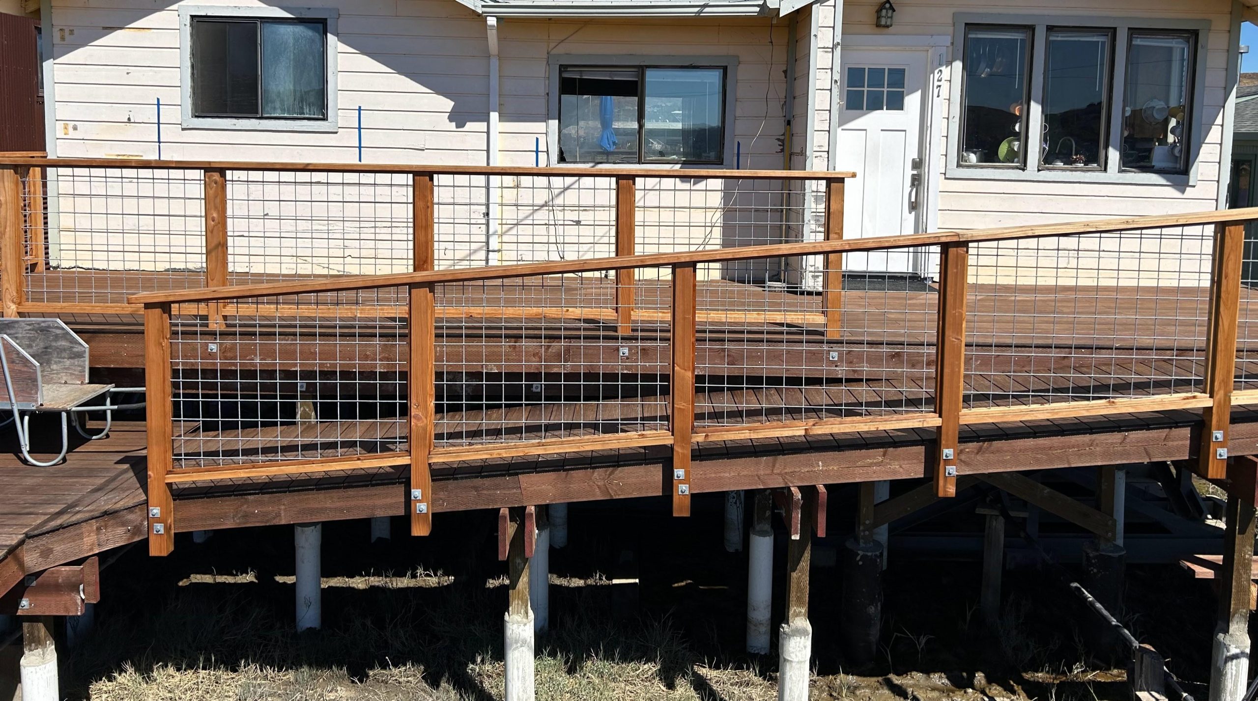

We have a small house by the water of the SF Bay sitting on a marsh .Without trees for shade and with direct exposure to marine winds and elements, it is a pretty challenging environment for wood finishes.

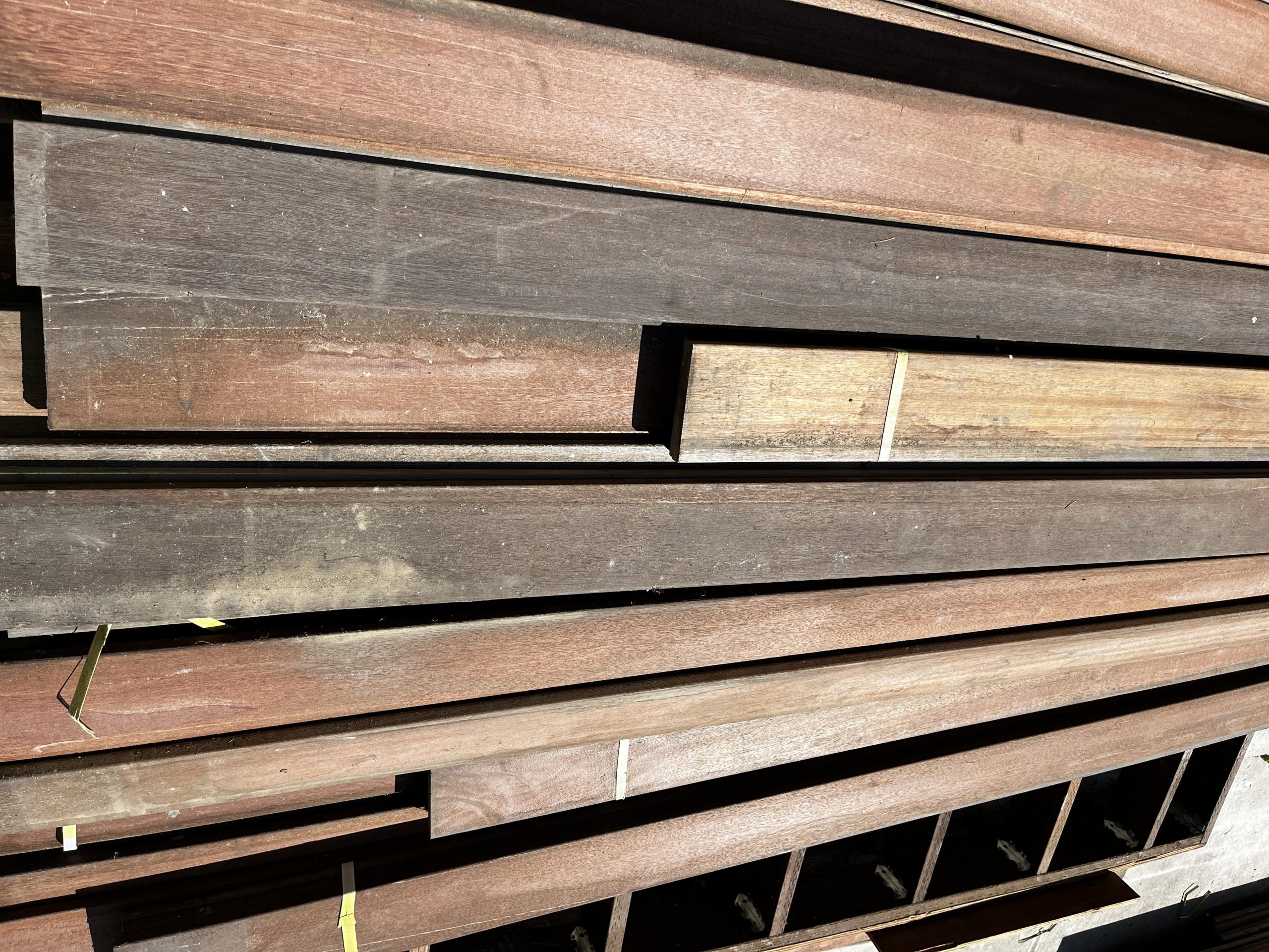

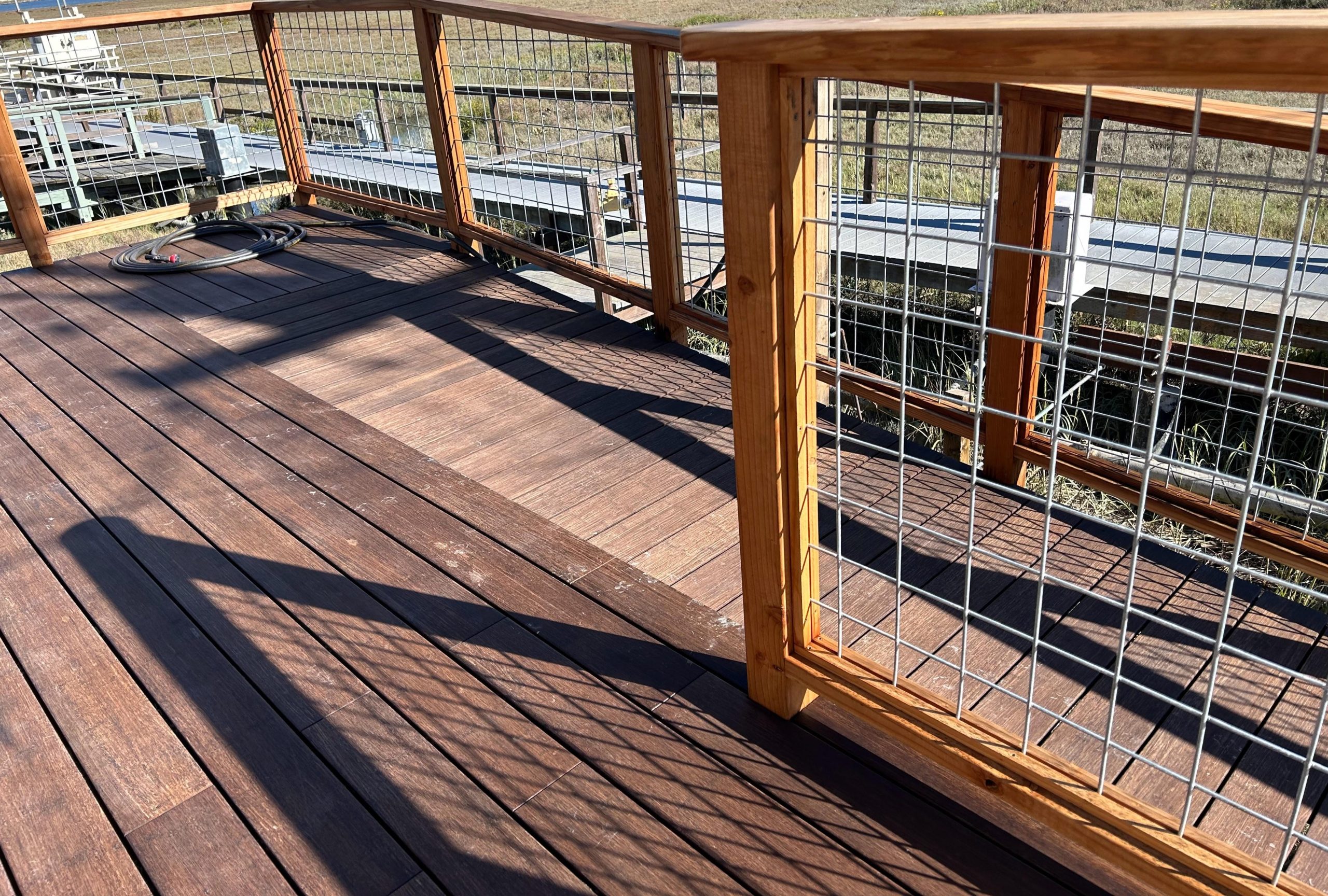

We just had a new deck and ramp installed which has MOSO thermally modified bamboo decking, with heart redwood posts and railings.
We presume the ipe-like decking may be ready to put an initial finish on? Use a hardwood finish product? Lightly sand and/or just use cleaner/brightener before finishing?
What we should use on the railing posts and top boards, and whether to sand the redwood before finishing it (what grit?)
Decking installed late June 2024 and redwood handrails installed August 1.
We will be leaving the country for some months and probably not returning until late summer or fall of 2025.
Thanks for your expertise and experience .
Clean and brighten all wood. Use a hardwood stain for all wood (it can be used on the redwood). No sanding should be needed.

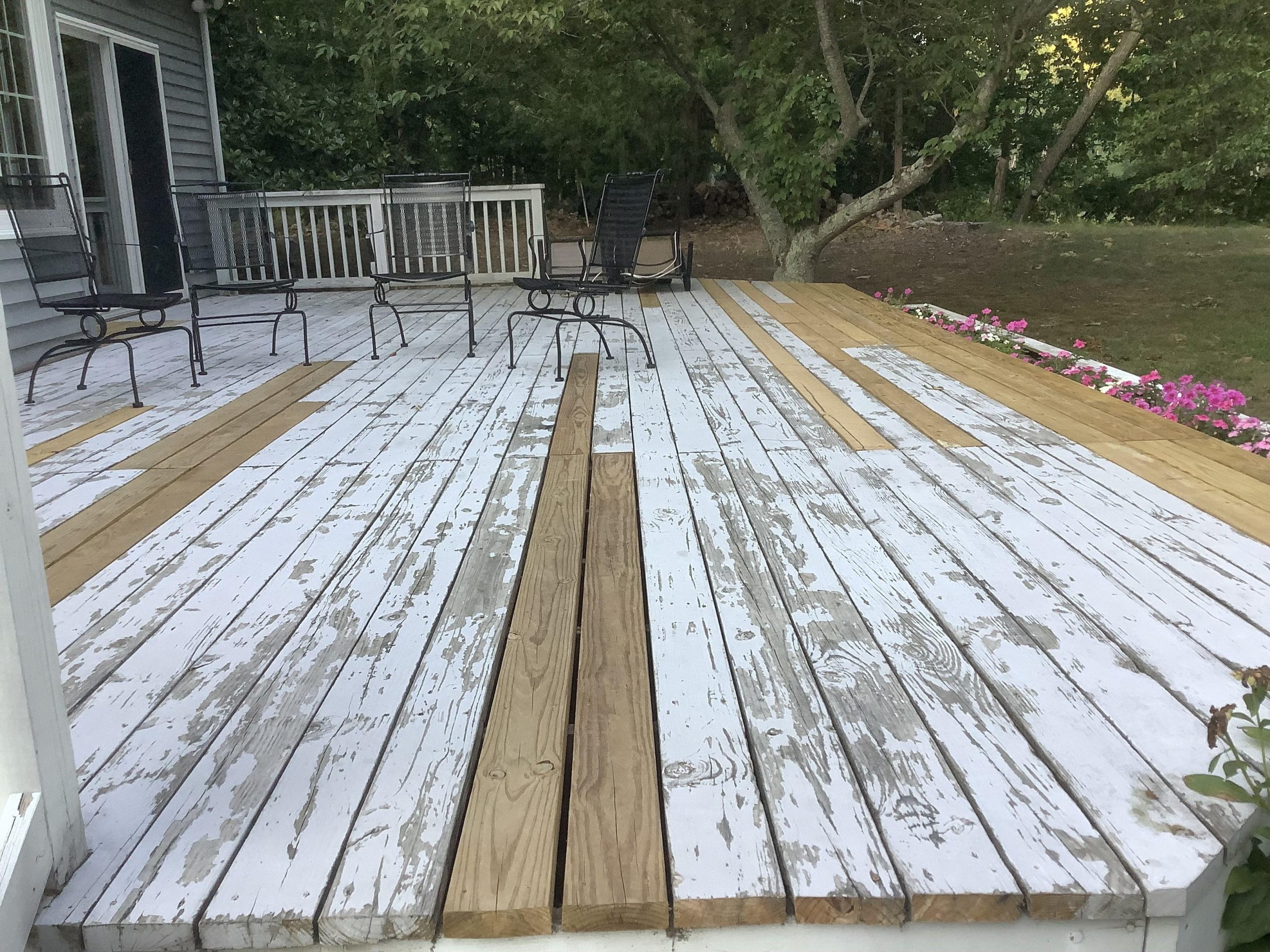

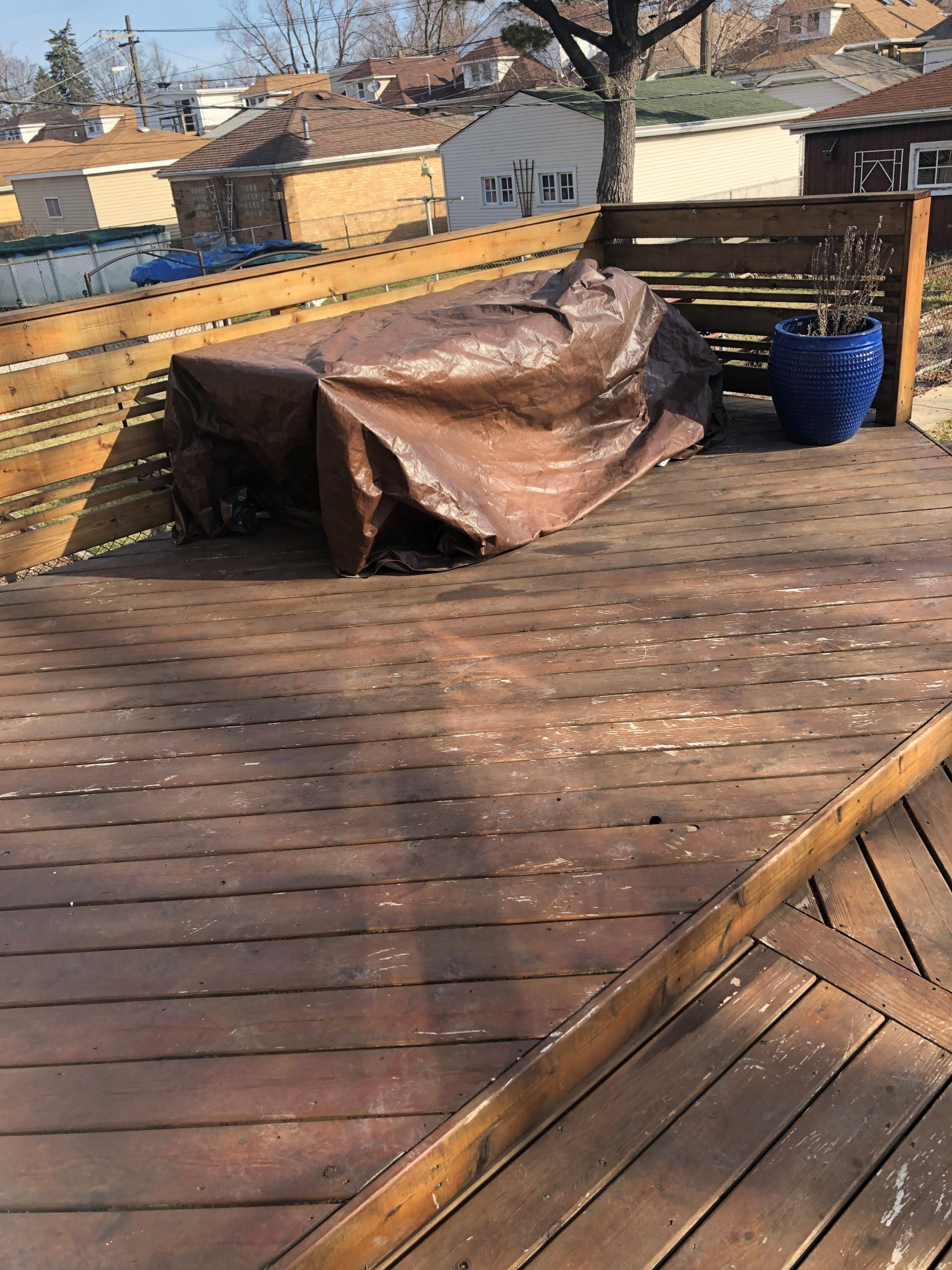

I have a large deck with solid color stain that is worn off and peeling off in places. A mix of now stained areas and bare wood on each board. I have replaced some boards. The “boards” are actually 2x6s. I want to sand the deck. What floor sander is best to use, an orbital sander or belt / drum sander?
Are you removing 100% to switch to a different opacity stain or reapplying a solid stain?
Scott,
I found your questions about refinishing, see below. To answer directly I am thinking of replying a solid color, as I understand that is supposed to be the most durable?
Some new wood otherwise 15 years old see picture
Some solid color stain remains
As above thinking the same.
Ben Moore arborcoat waterborne exterior stain, solid color
see previous question
Some mold? Narrow gaps caused water retention and rot. Replaced boards and tried to open gaps.
Water retention I think. Thought we had go adherence initially but didn’t last two years.
Should I clean? Strip? And sand? And in what order? Should I wait to restrain given the replaced boards?
See this for tips on reapplying a solid stain:

I have a 830 sq ft redwood deck that is mostly covered. It was possibly treated with a semi solid stain that took over a month to dry 10 years ago. Now it is peeling and worn. I live in the high desert of Arizona. Can you tell me the best was to prep and stain and what products to use for this environment? I think I would prefer oil based that would dry.
We would need to see pictures uploaded in the comments for any prep help.
Here are a couple of pictures of my poor deck. Thanks, Patricia Hamel
You will have to power sand if you want to remove it and use an oil-based stain. You cannot strip it off and you cannot apply over it with an oil-based stain.

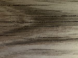

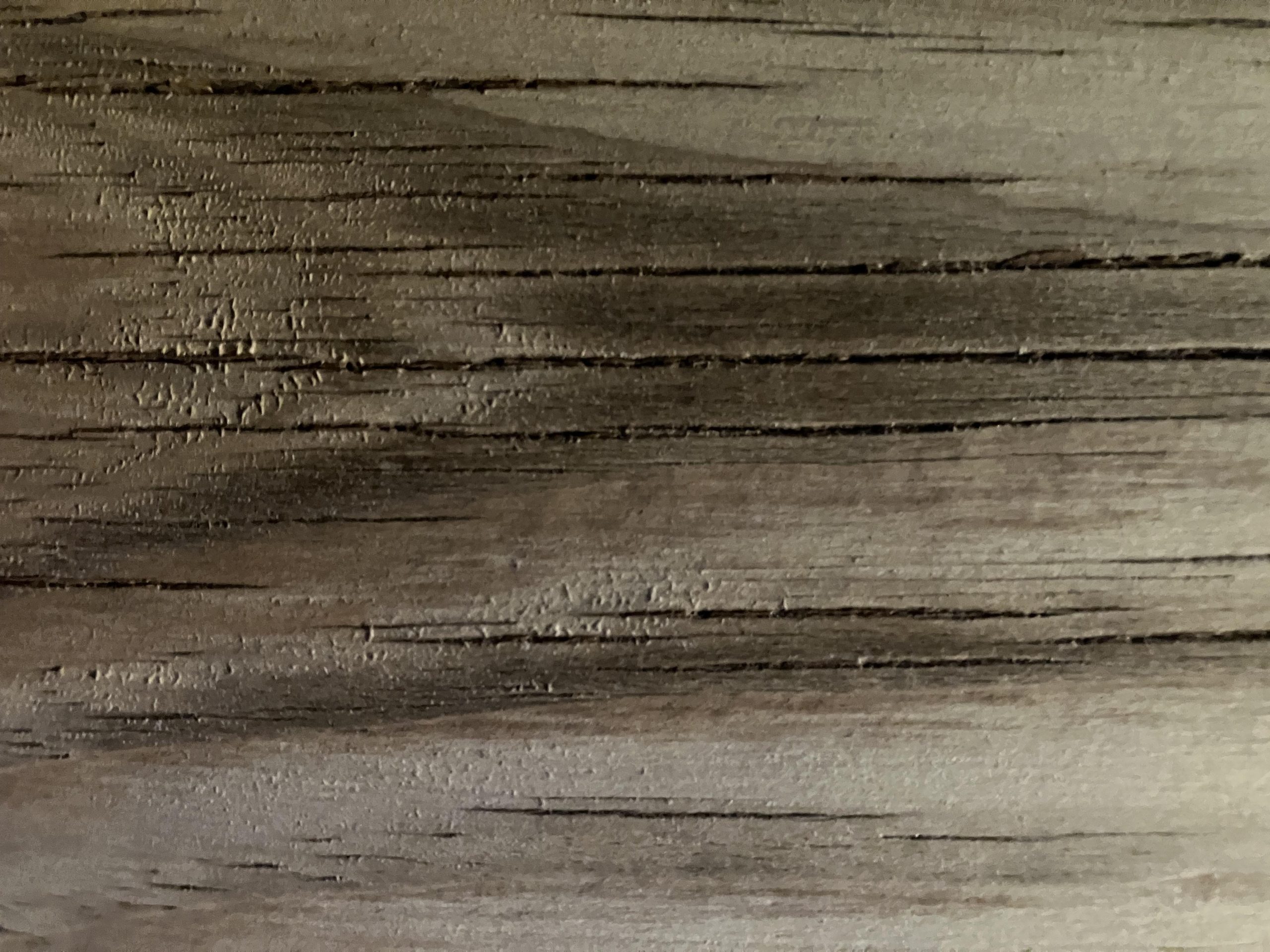

My husband and I used Restore A Deck stripper (to remove last summer’s oil based clear coat) and brightener. He washed the deck with the pressure washer too. We let it dry for three days and then applied Outdoor Defense Oil (which is made from tung & pine oils and zinc).
Now we have a TERRIBLE case of the furries! It looks awful. See attached photos. We are wondering what our next steps should be.
Thank you in advance!
We appreciate any suggestions!
Strip and brighten again and then lightly sand to remove the fuzzies: https://www.deckstainhelp.com/wood-fuzzies-furring-on-deck/
