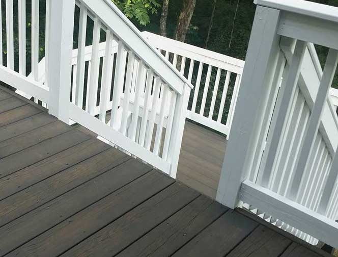

Hi, thanks for your post! Do you know what stain was used for the picture in the third row on the left? (The one with the striped mat on the ground). It’s such a lovely colour

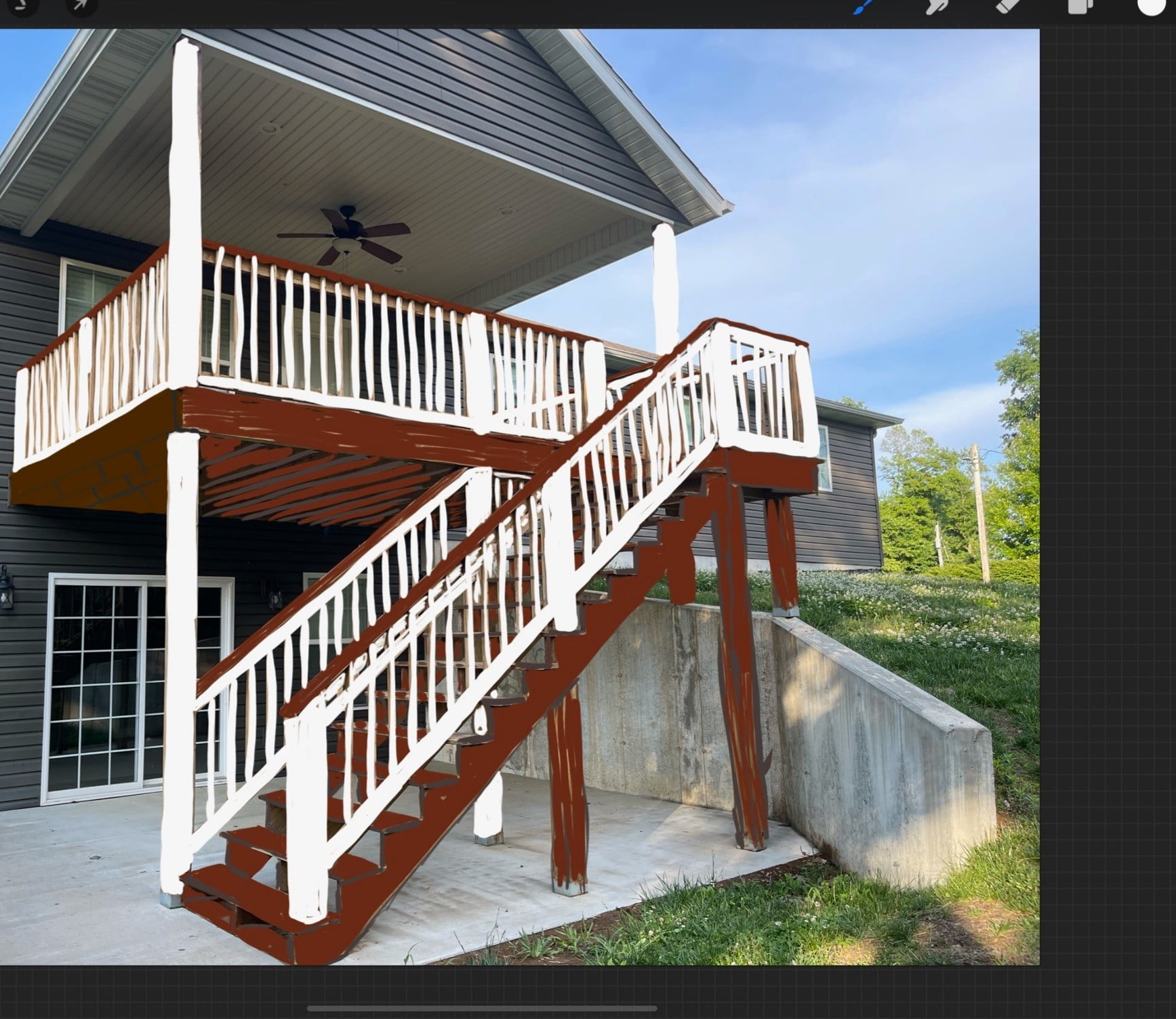

Hello! We love some of your two tone stain decks but are having trouble with ours as the layout makes it funky to us! Could you help if we sent a pic??
This is the deck. We colored it on an iPad to see what it would look like. The brown isn’t the color we are using but it shows sorta what it would look like. My wife and I are struggling with the pillars especially the two white ones. We can not find a way to do those that looks good. We have colored them multiple ways all white, part white, part brown multiple different ways and all brown. They probably look the best all brown. Any thoughts on how you would do this deck two tone ? Our colors are probably close to these colors.
https://images.app.goo.gl/qz4j1UdmAfueoQ2o8
Two-toned deck with brown flooring and white railings and pillars, showcasing design options for outdoor spaces.
What is the reason for that? This is good information to have. We were considering the white as just an accent color.
Ah. I am still learning all of this. My wife is concerned about the posts being difficult to clean if all white. Do you expect or know if that will be an issue?
So to ensure I’m confirming what you’re saying with all verticals.
All spindles, posts, and then the banisters near the spindles would be white? Floor, railing on top and steps would be the brown?
Is blending in with the house trim a good thing? Not sure I understand that completely. Sorry if I’m asking too many questions. This is our first house and we actual had problems with our original stain. The entire deck is having to be done for a second time.

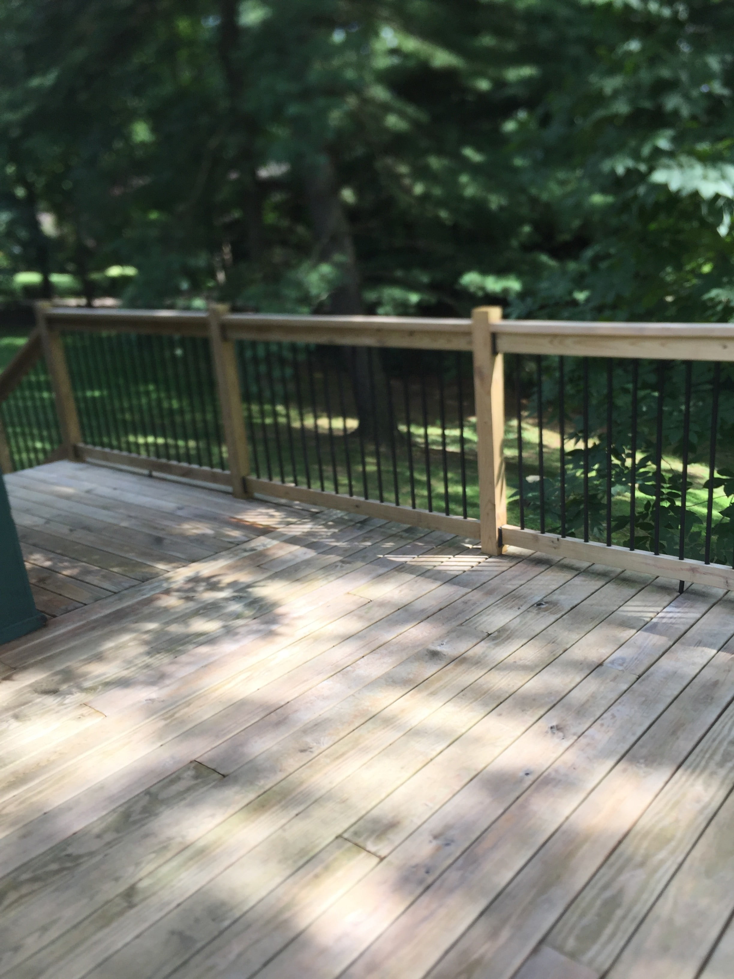

Am thinking about staining my year old non stained deck 2 tone. I am thinking g about using Armstrong nature oak semi transparent on floor and their cedar semi transparent on the railing. Do you think their will be enough contrast between the two to look right
Two-toned deck featuring natural wood finish on the railing and dark stained floor, set in a lush green outdoor environment.
Two-toned wooden deck showcasing contrasting colors, vertical railings, and natural surroundings, emphasizing aesthetic appeal and integration with home design.
Wooden deck with vertical railing, showcasing potential for two-toned staining, surrounded by greenery, illustrating outdoor space aesthetics for homeowners.
Deck with wooden railing and black metal balusters, surrounded by trees, showcasing a two-toned look suitable for enhancing outdoor aesthetics.

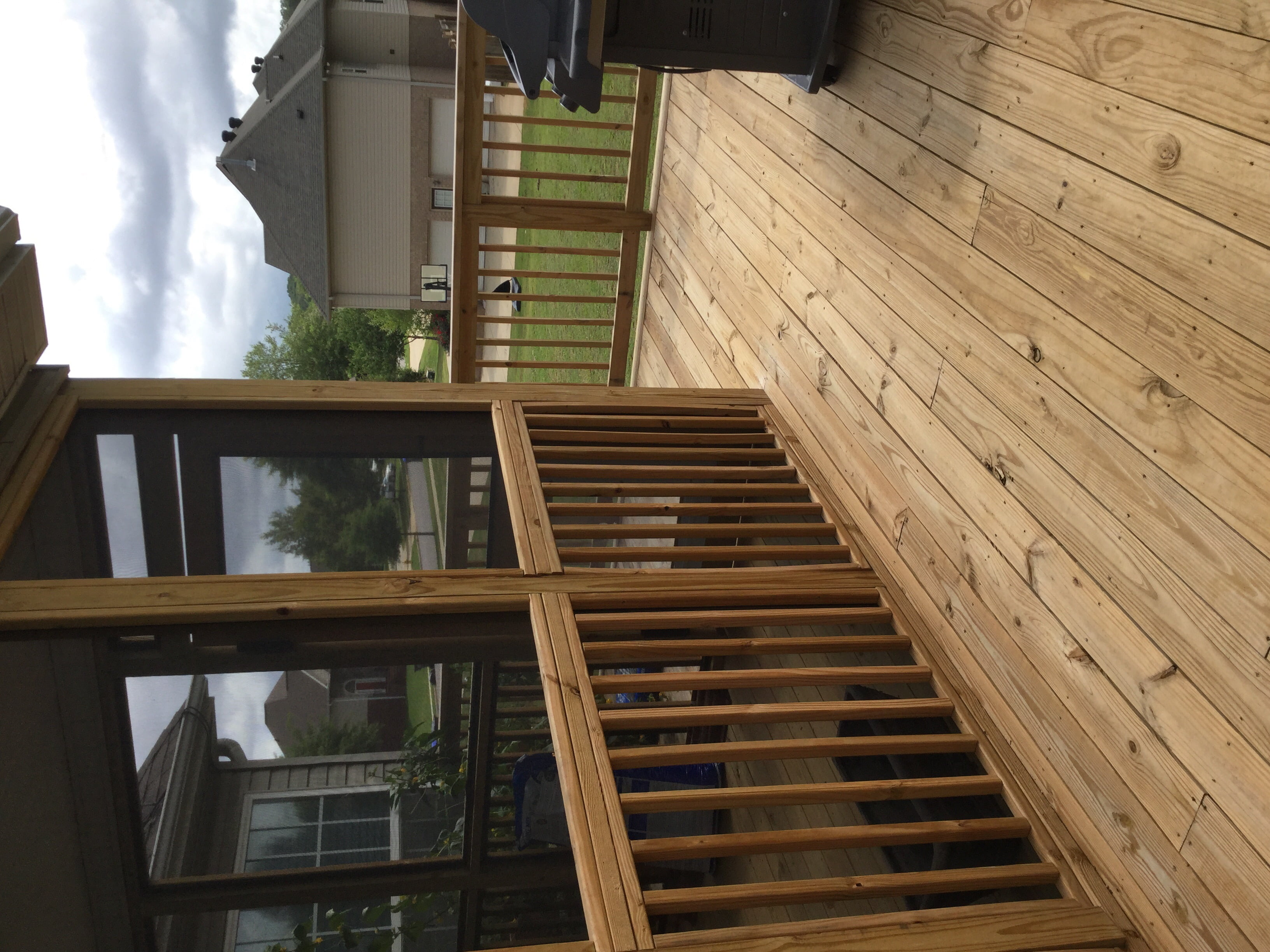

New deck installed last fall, allowed to cure through winter and spring, now time to stain. Trying to decide all one semi-transparent vs. a two-tone since the design of the deck would look nice that way. Considering a darker stain on the “frame” and verticals and a lighter stain on the 45 degree pieces. I don’t want to use any solid since both colors will be on the horizontals. Thoughts? Recommendation on brand and color? I plan on cleaning and brightening either way.

I was leaning that way. I think it would look cool (see picture), but I don’t know that it would be worth the trouble or if the different stains would age differently causing touch ups to be done at different times on the different colors.

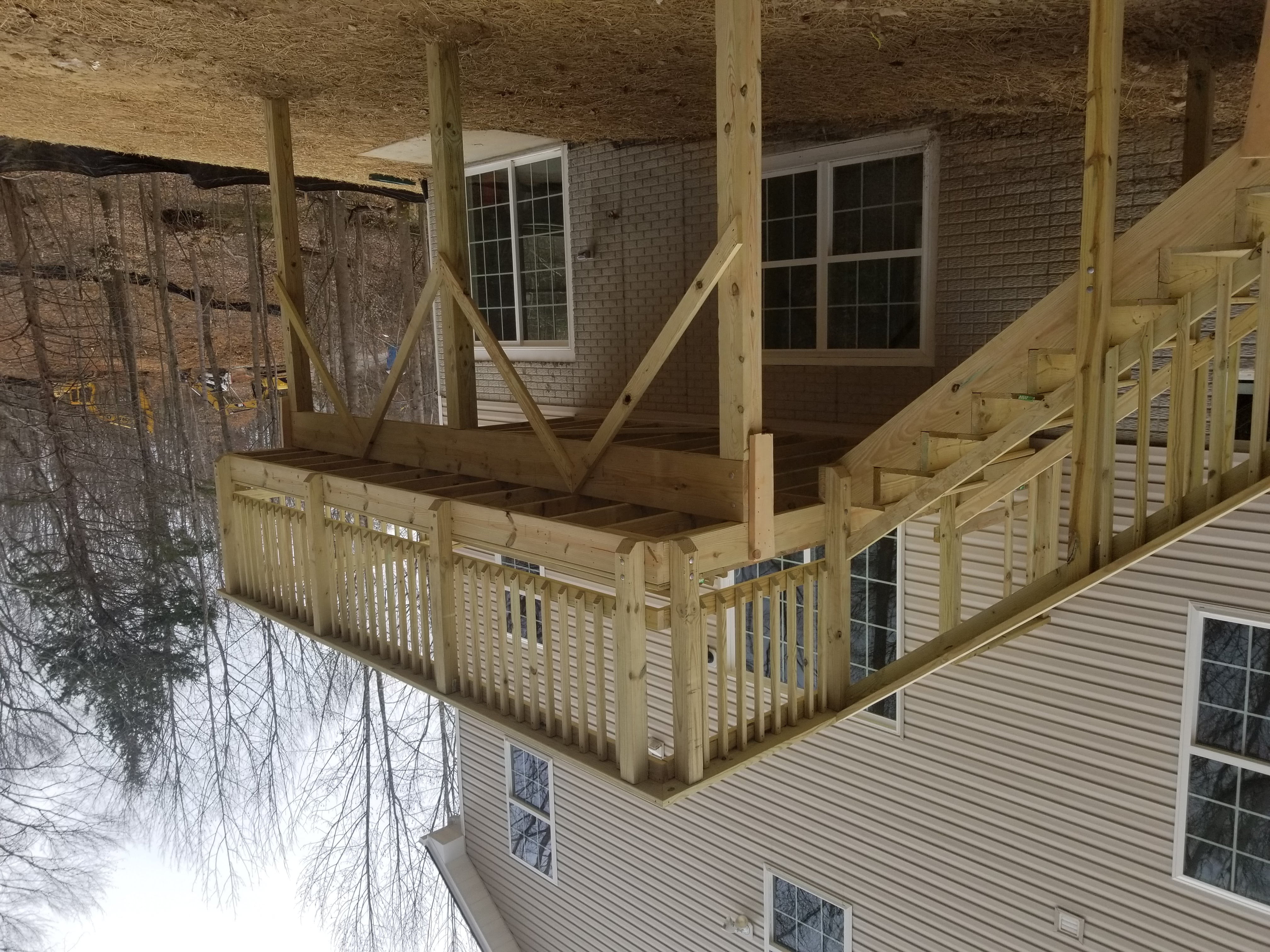

Hi, we’re purchasing a new home in northern VA and the deck is being completed this week. It will get a little sun in the morning and then be shaded the rest of the day. We’ll be following the advice we’ve seen here (waiting 2-3 months and using proper prep, cleaner, brightener). We are interested in possibly doing a two-tone deck; the house is beige with white trim. A couple of questions:
1. We would do the railings and spindles in white but I’m not sure what else. The railing are mounted to the sides, not the top. Our thoughts for the horizontal deck was a darker shade of brown in either semi-solid or semi-transparent.
2. Semi-transparent vs. Semi-solid. Thoughts? Do they hold up equally well?
3. The stairs and supports. I assumed they would be in the darker color but unsure. Basically I’m unsure how to make this look good in two-tone.
Thanks for any input.
