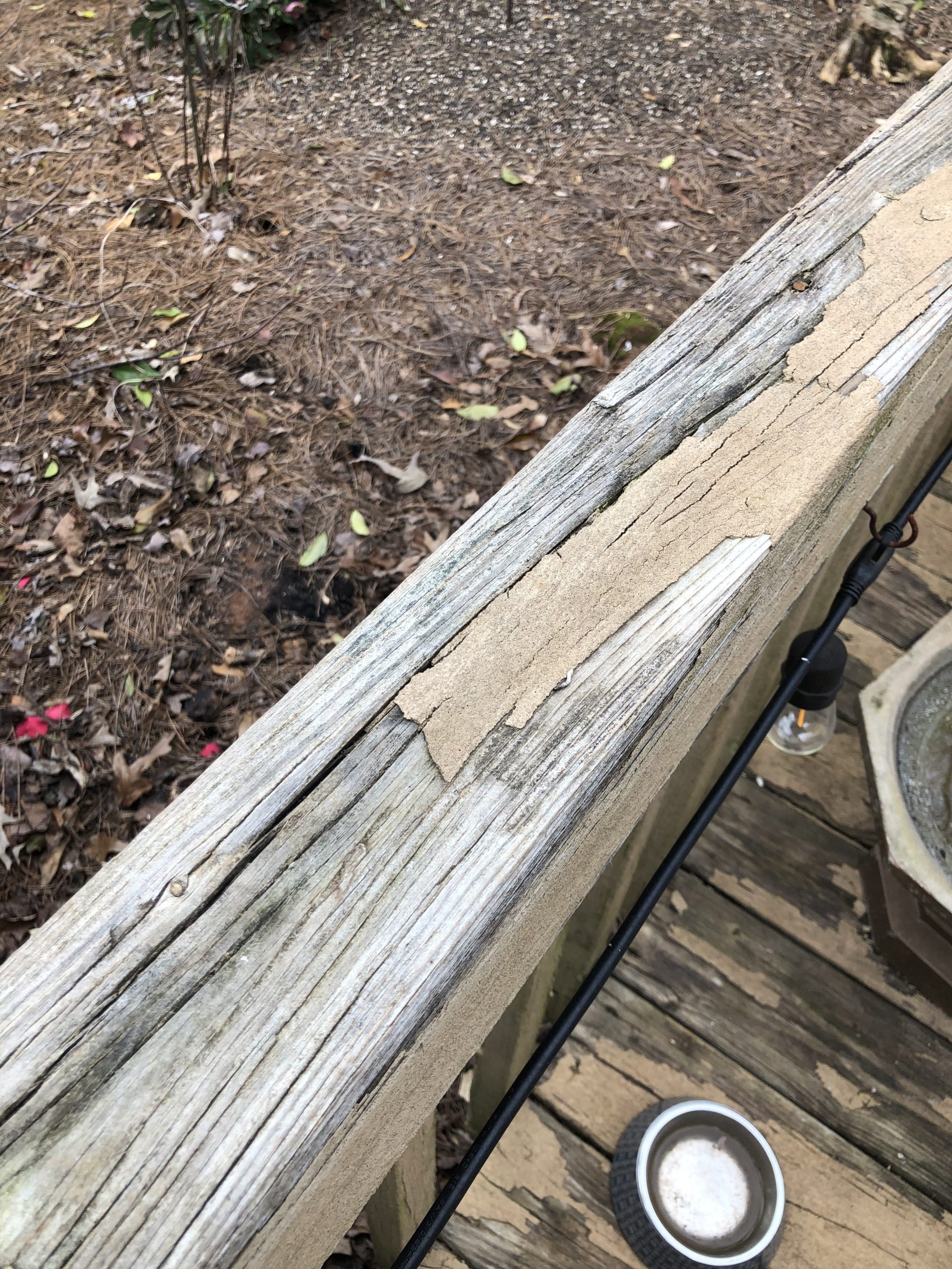

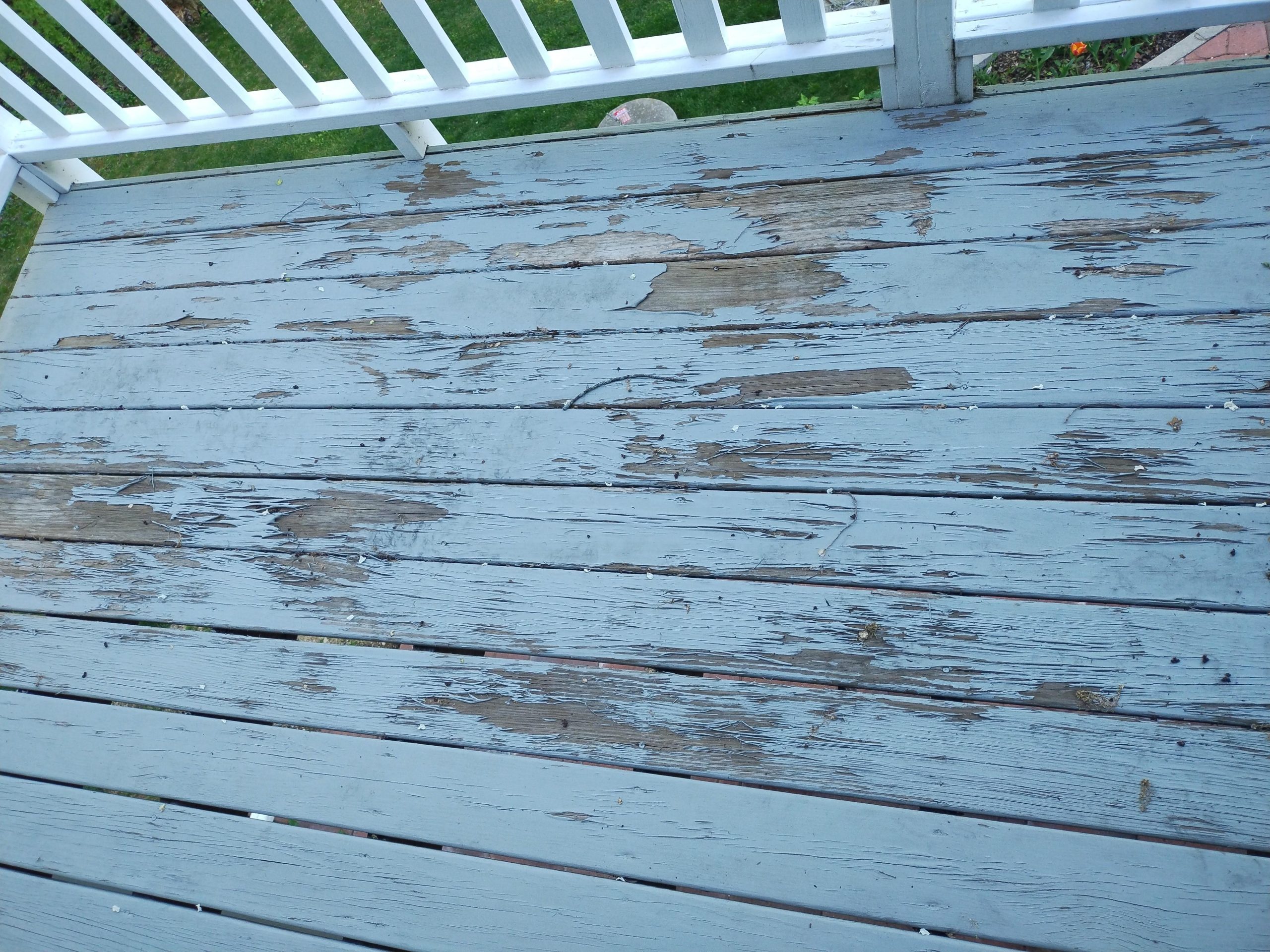

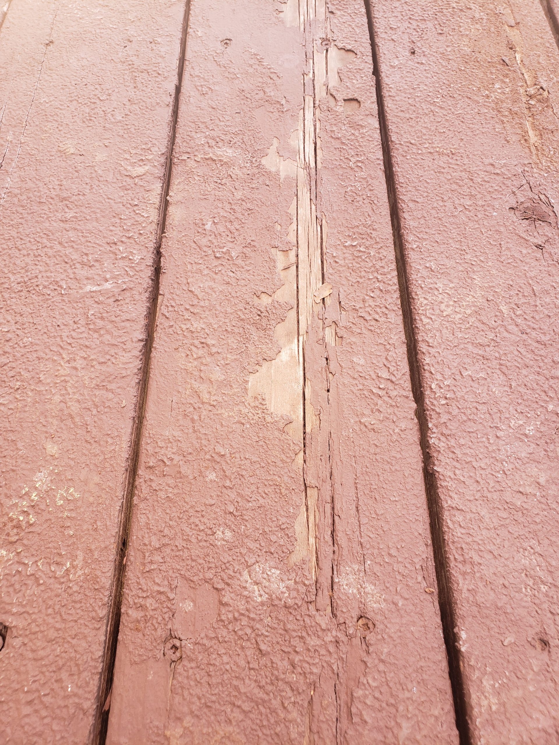

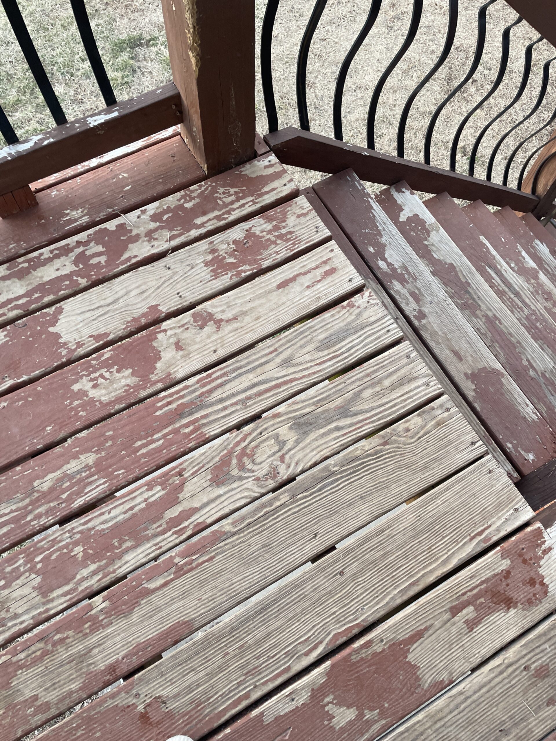

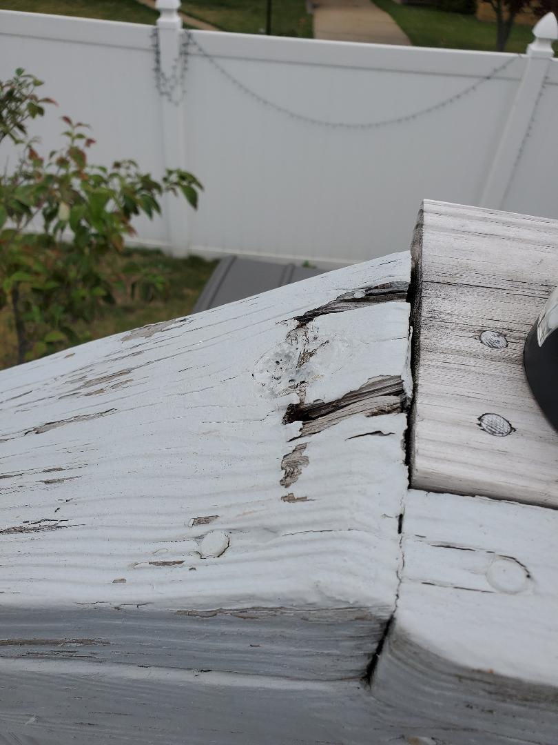

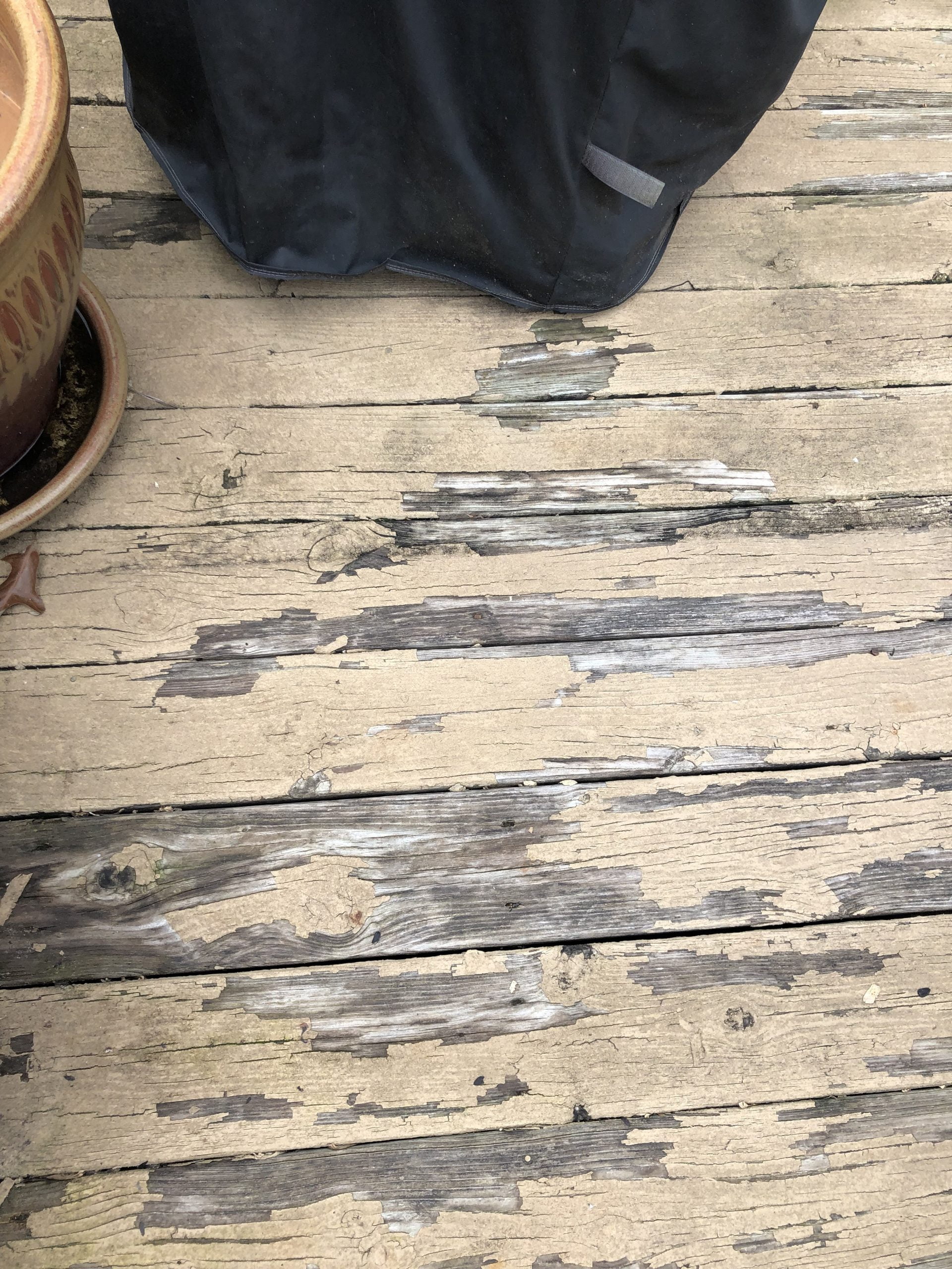

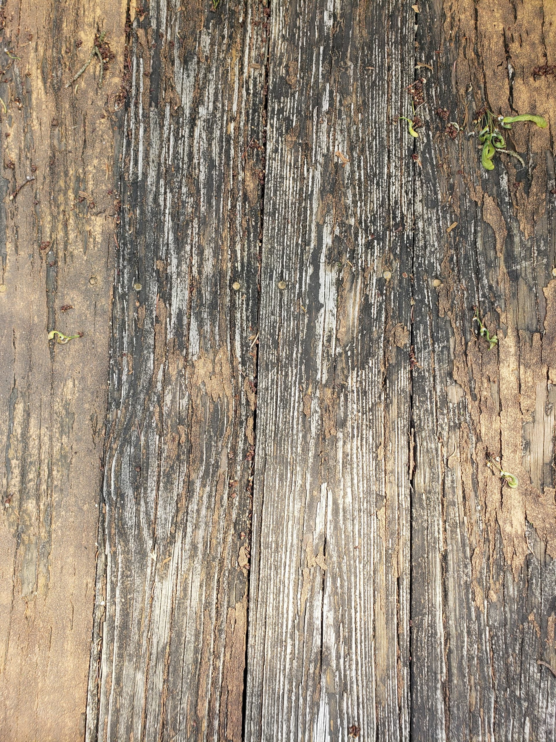

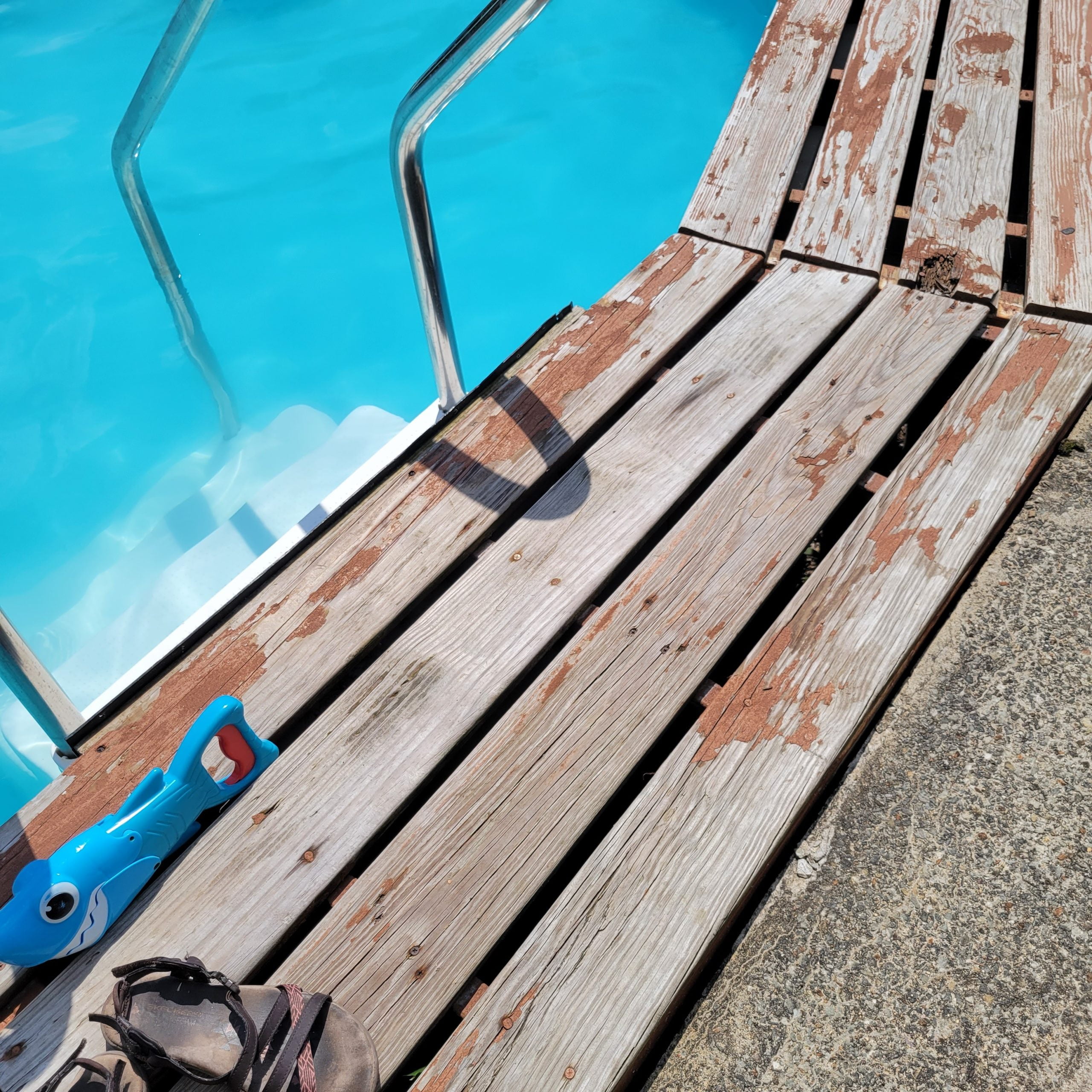

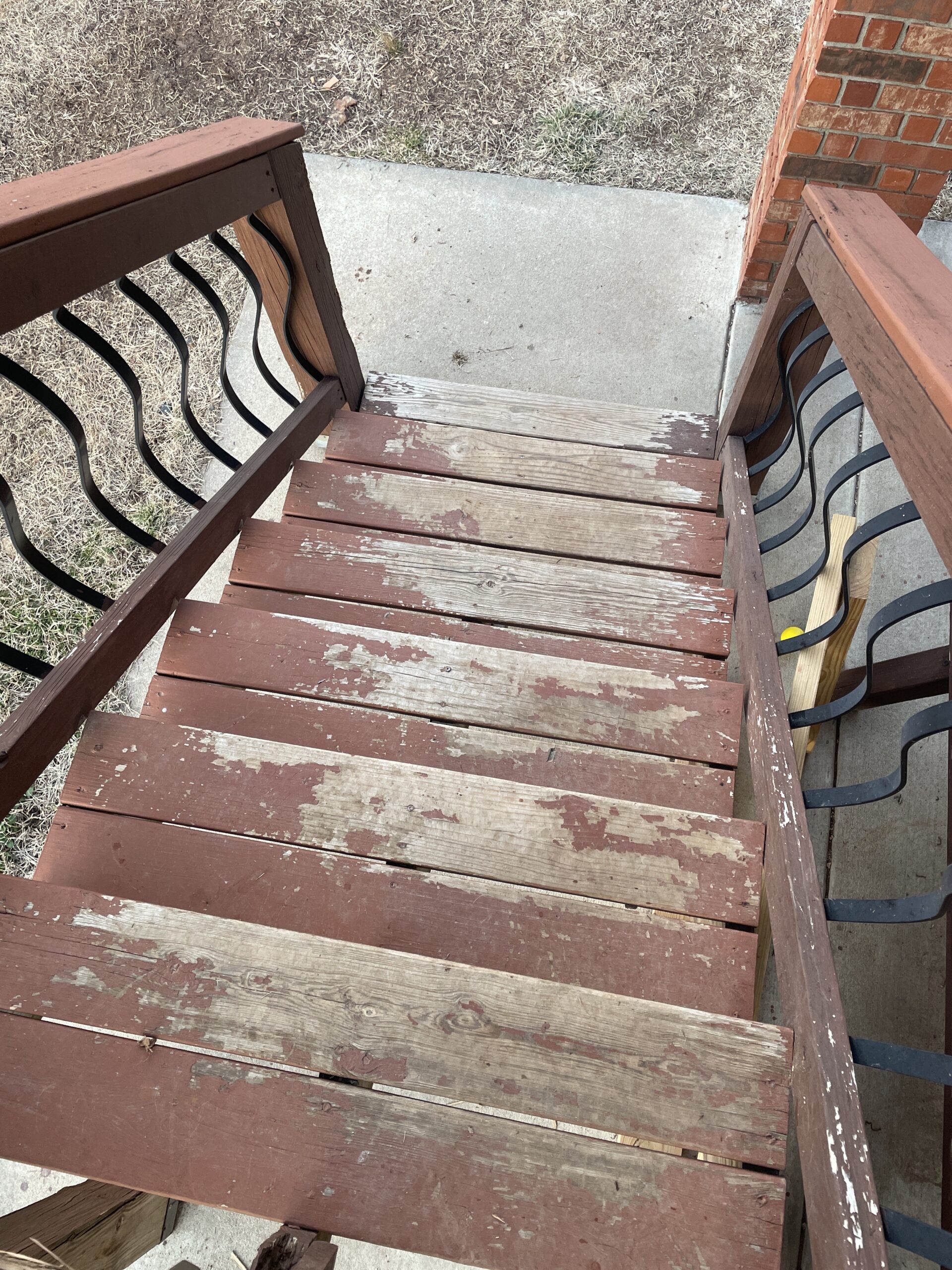

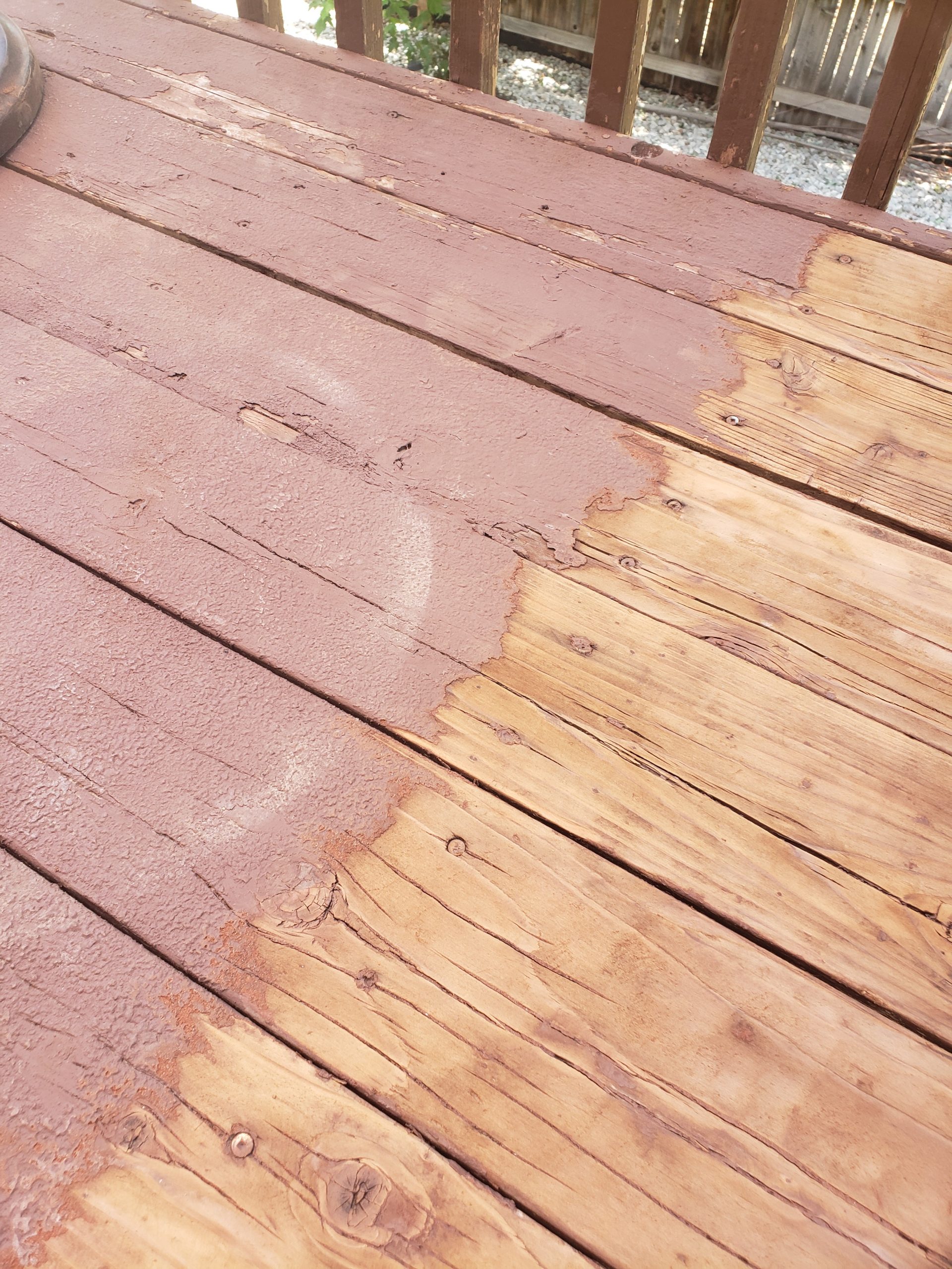

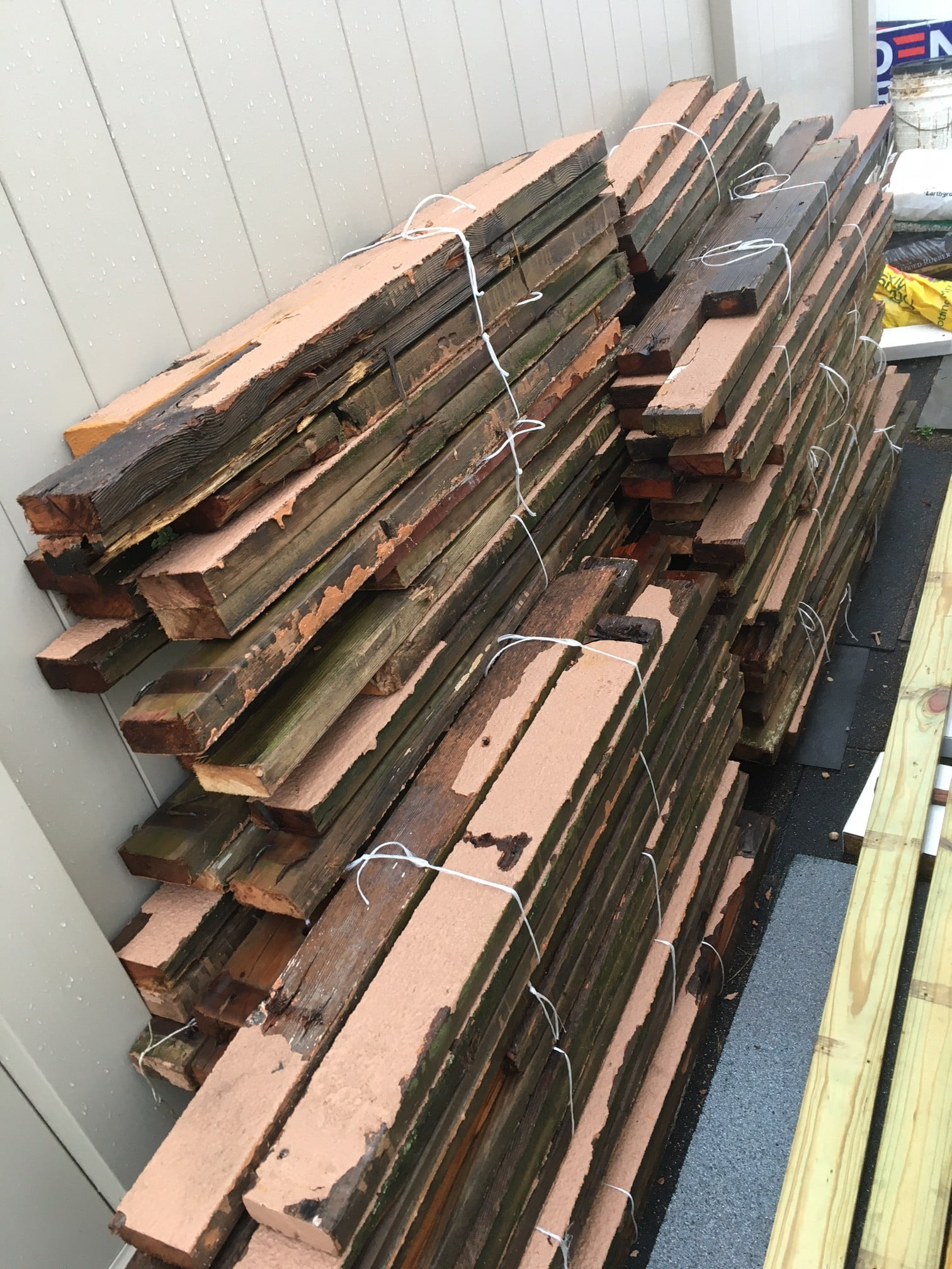

My deck has gone into disintegration mode year after year. My neighbor had the same problem however mine is 3 times the size and we have benches on 2 sides and 2 set of stairs. Today I hired a man to replace everything on the top deck up the benches at a heavy price and repair the rotted back steps. The benches are starting to rot now. He told me that the product was Restore and that it is like placing Rubber over wood and does not let it breathe. It suffocated my deck. My husband cannot do the repairs since his Lyme disease several years ago and every year I would worry that my tiny grandchildren were going to fall through the boards. When I googled Restore I was shocked to see there was a class action against them. I actually paid a guy 1000 to paint the deck both stairs and all the planks around it. I feel if I had known sooner I would have saved receipts, taken photos and been prepared. What a nightmare.

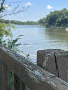

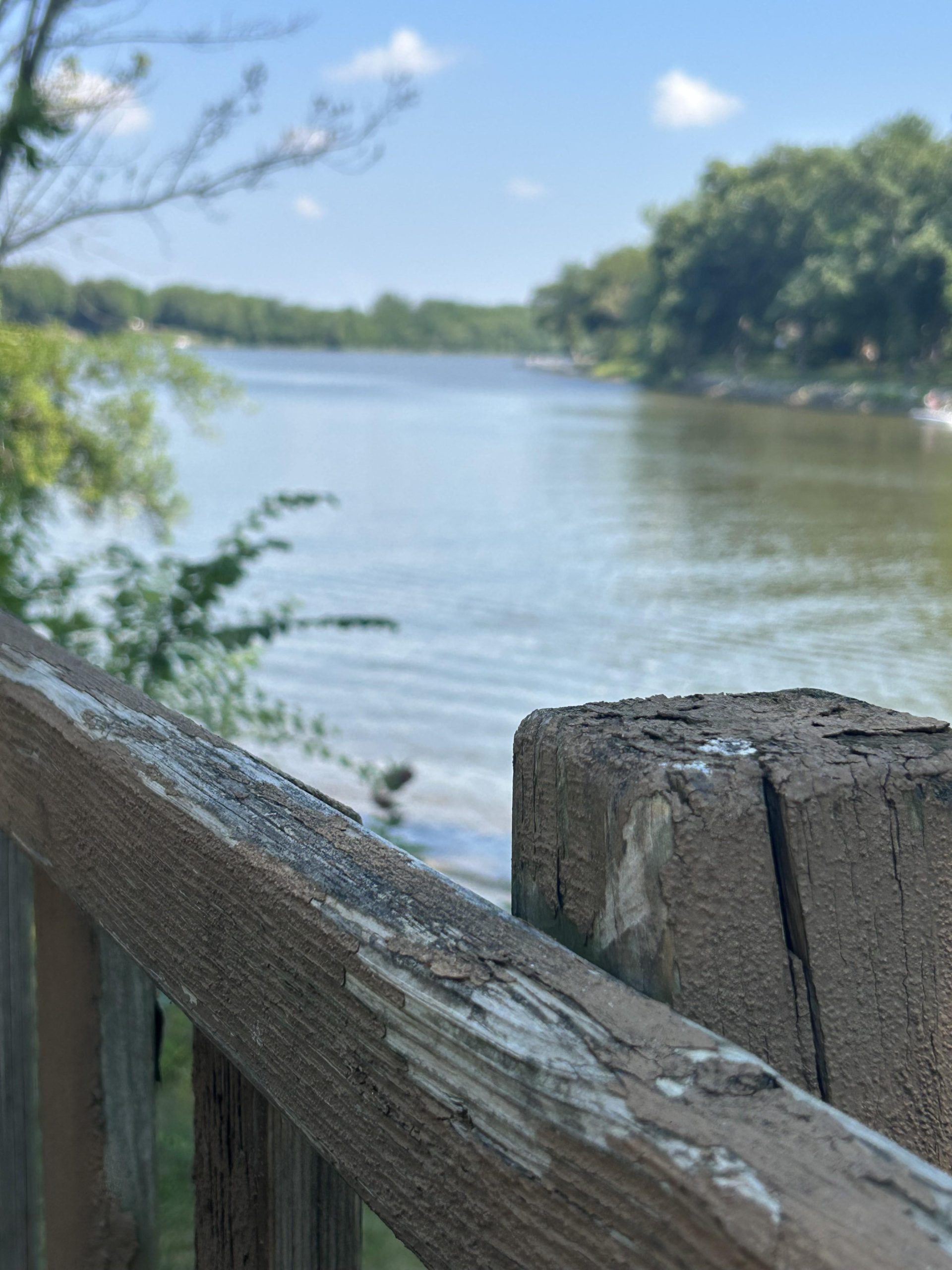

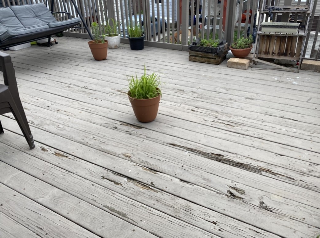

We dragged 5 gallon buckets by boat to our cottage on an island. Paid workers to help us. The thick paint was so hard to work with that I woke up with sore hands. It peeled so badly that we had to replace the boards the next summer. We still haven’t replaced the railing. We didn’t know about the class action suit or we would have participated. This company is awful. Thanks for the follow up with new brand. I wouldn’t want anyone to go through what we did

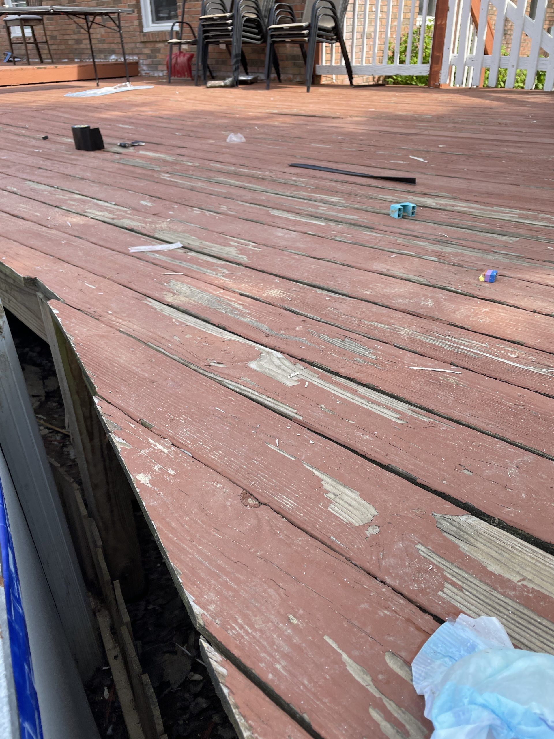

We used rustoleum rocksolid less than one year ago and it is peeling up, disintegrating, and basically junk. we spent around $600.00 for ten gallons. The deck now looks worse than it did before we painted it. Too bad there’s no way to get our money back. I went with this product because I believed Rustoleum has a good reputation. Never again. I am thoroughly disgusted

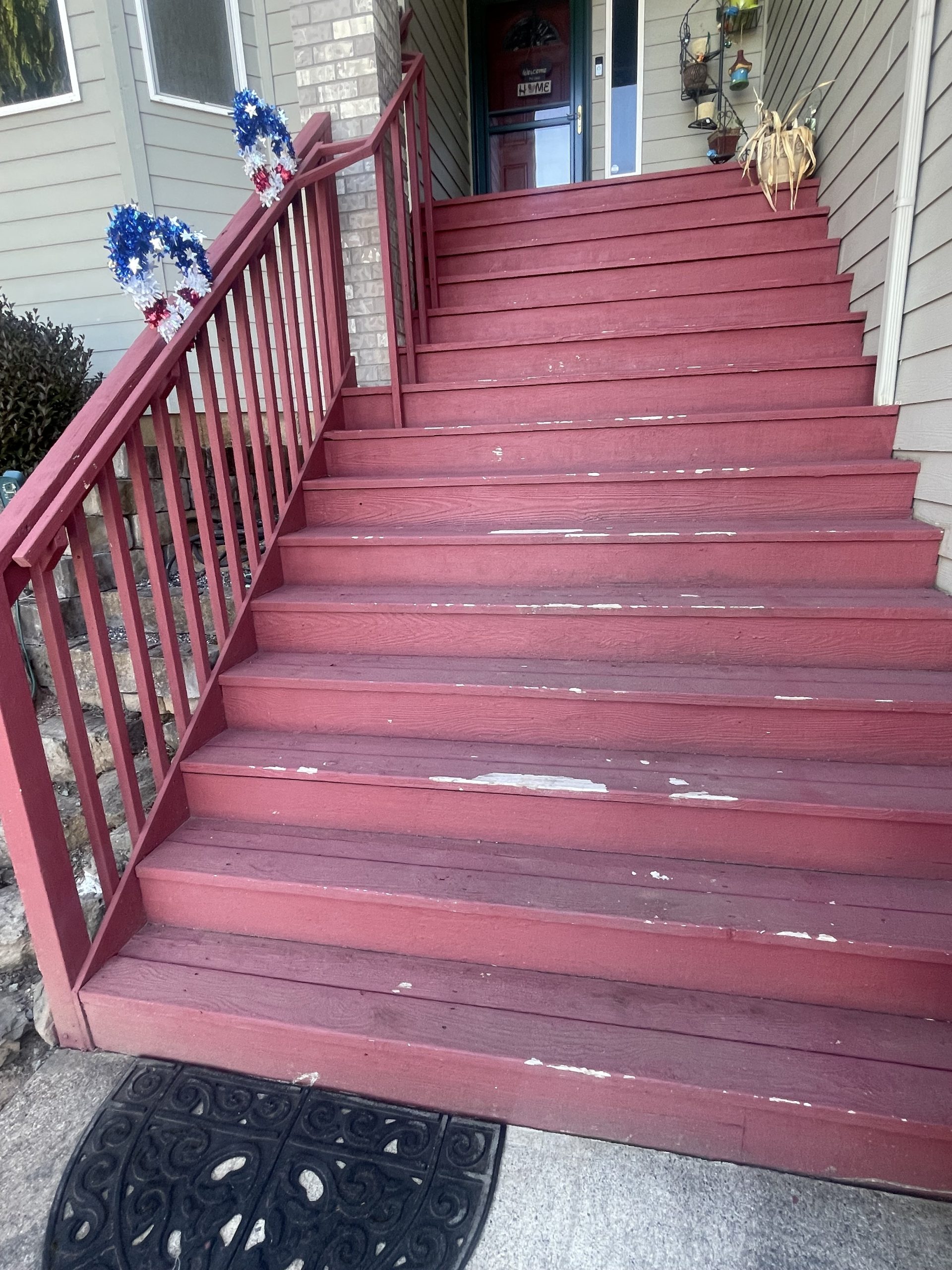

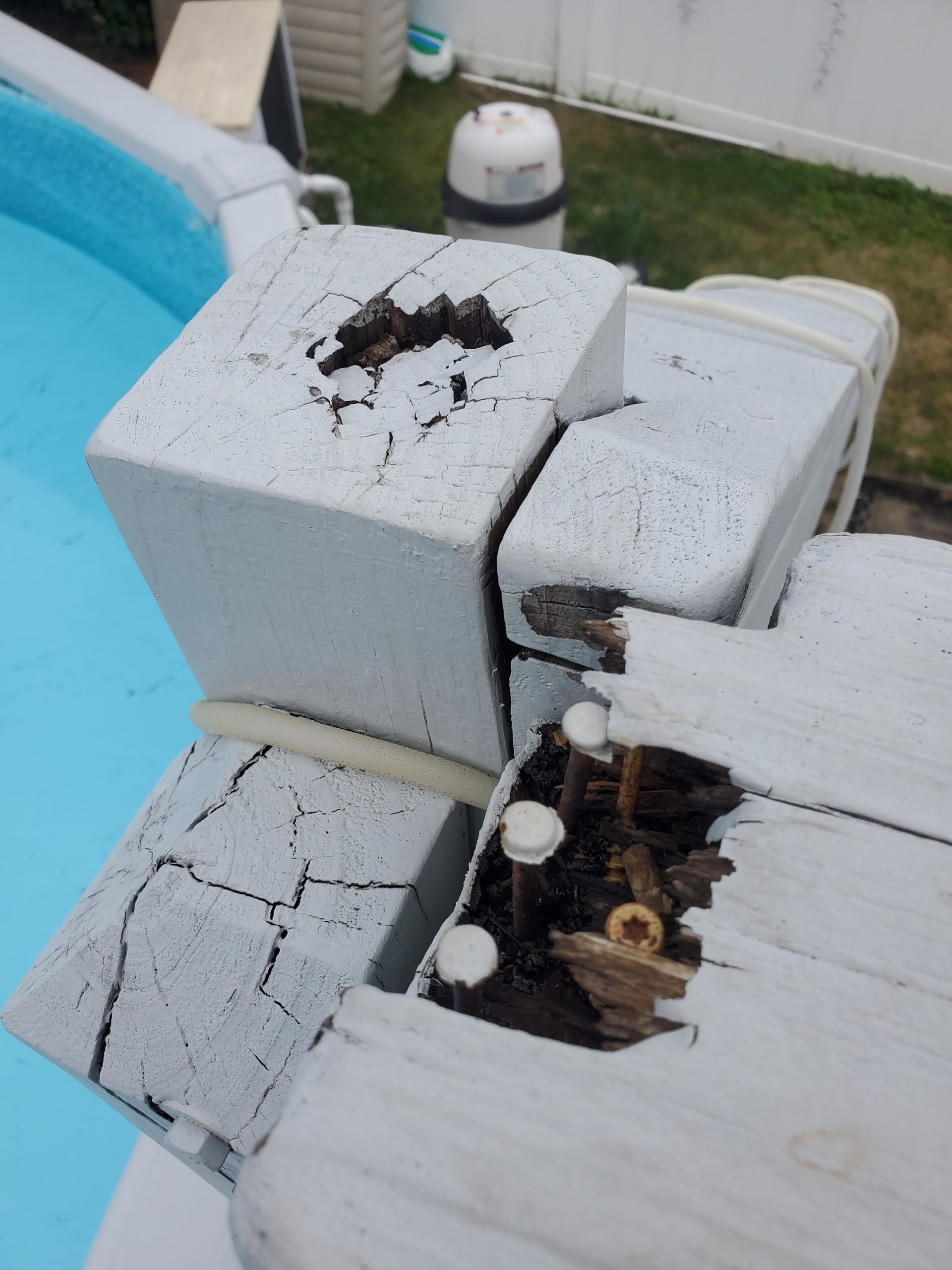

We applied Restore to the stairs on our deck. The product is peeling and caused several of the stairs to rot out

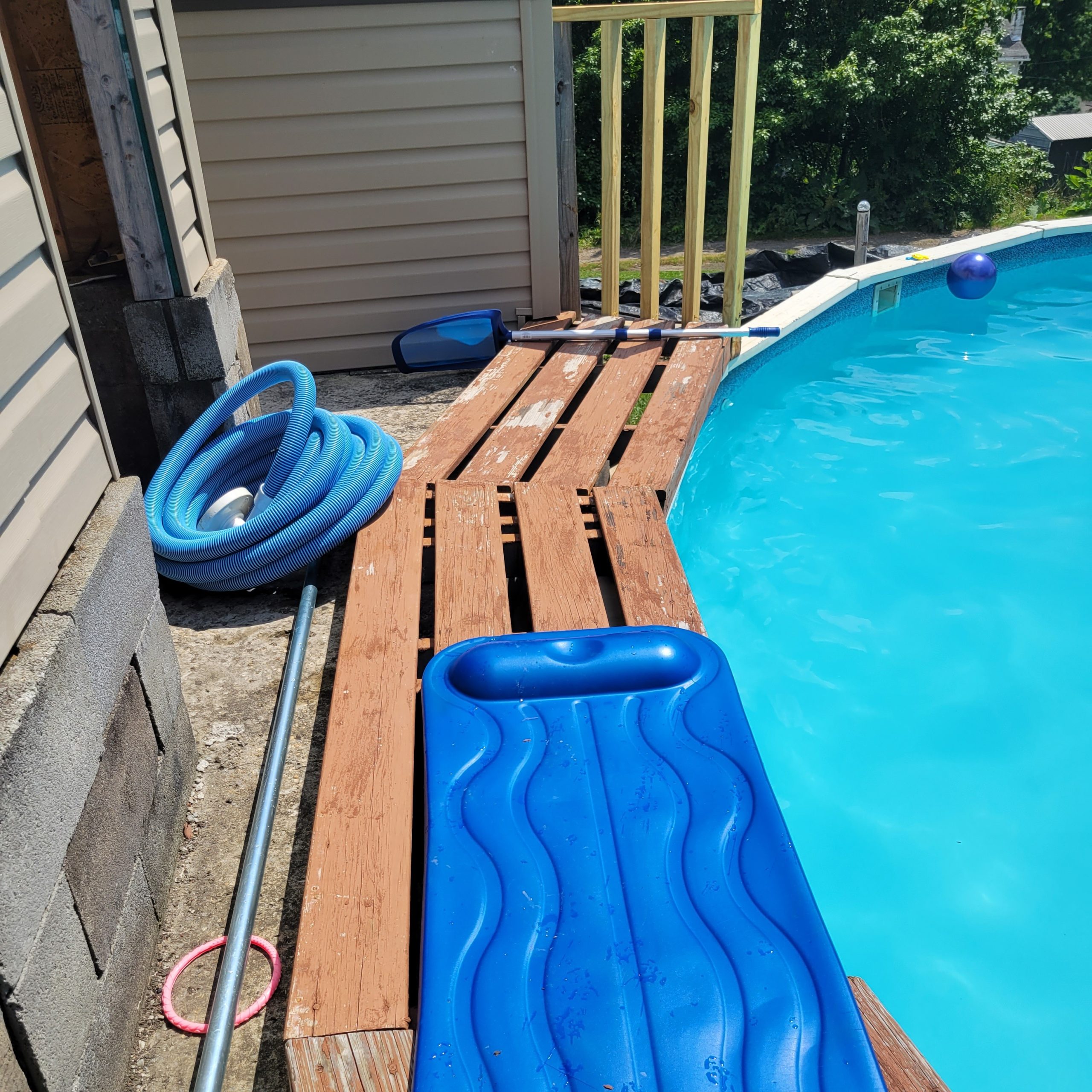

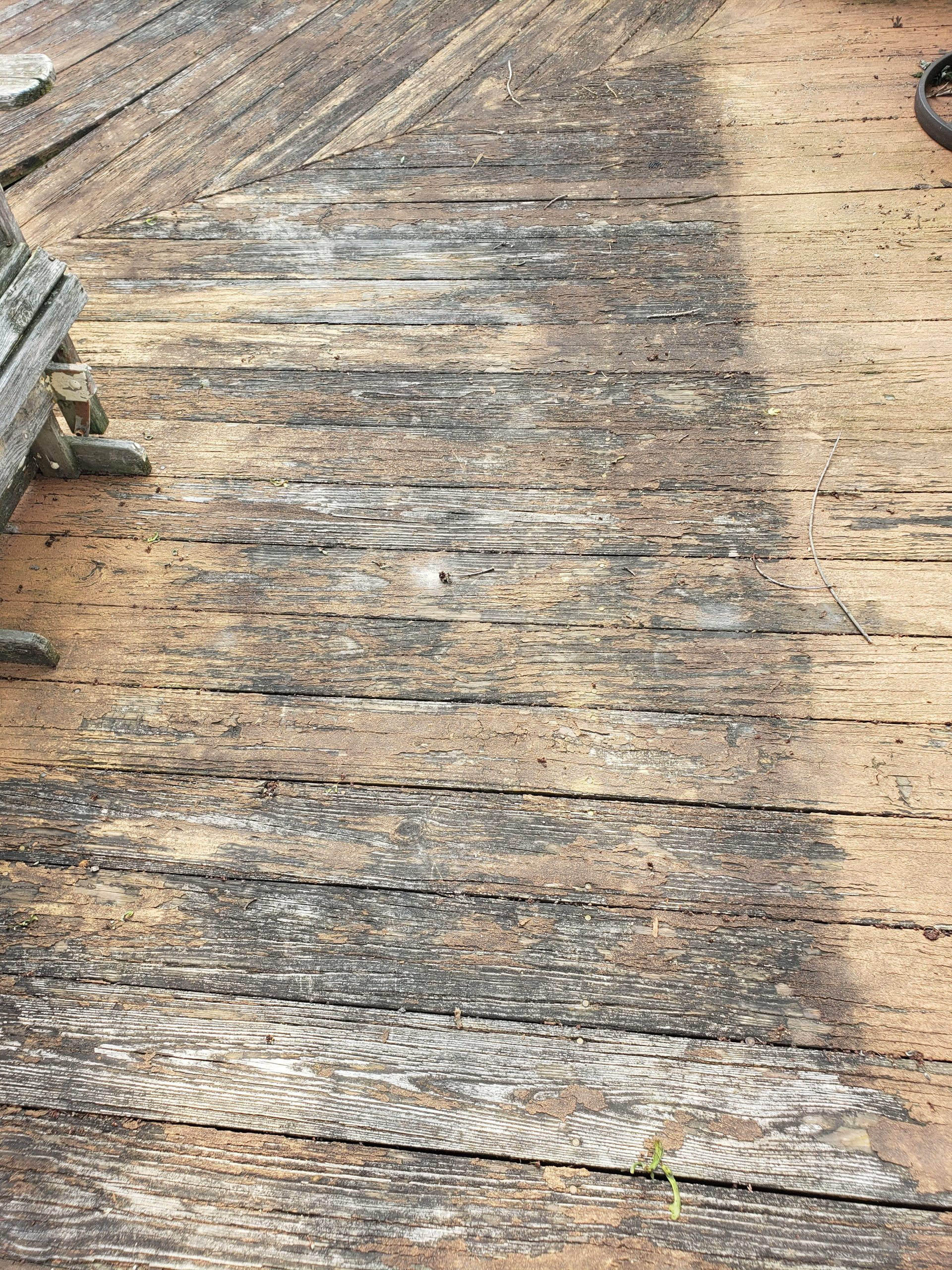

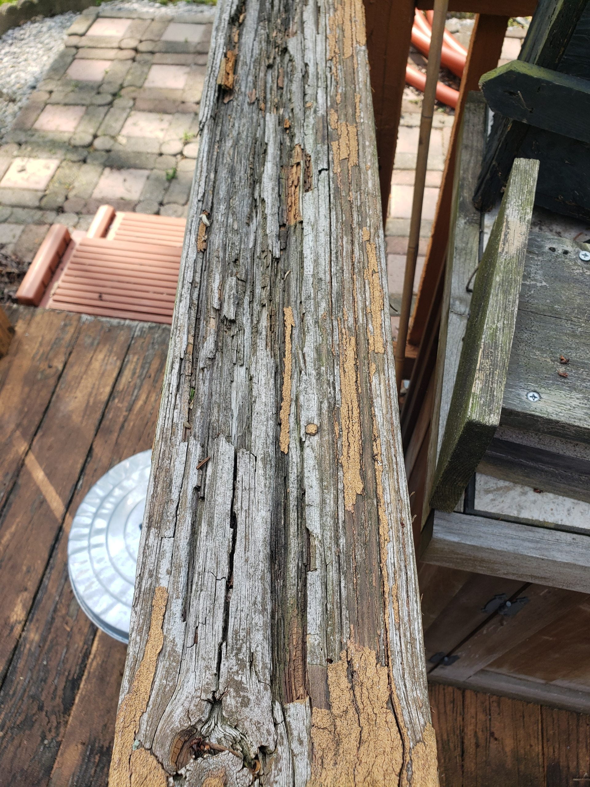

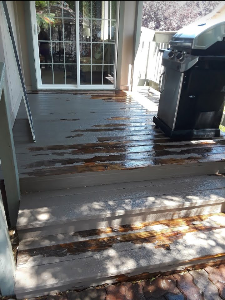

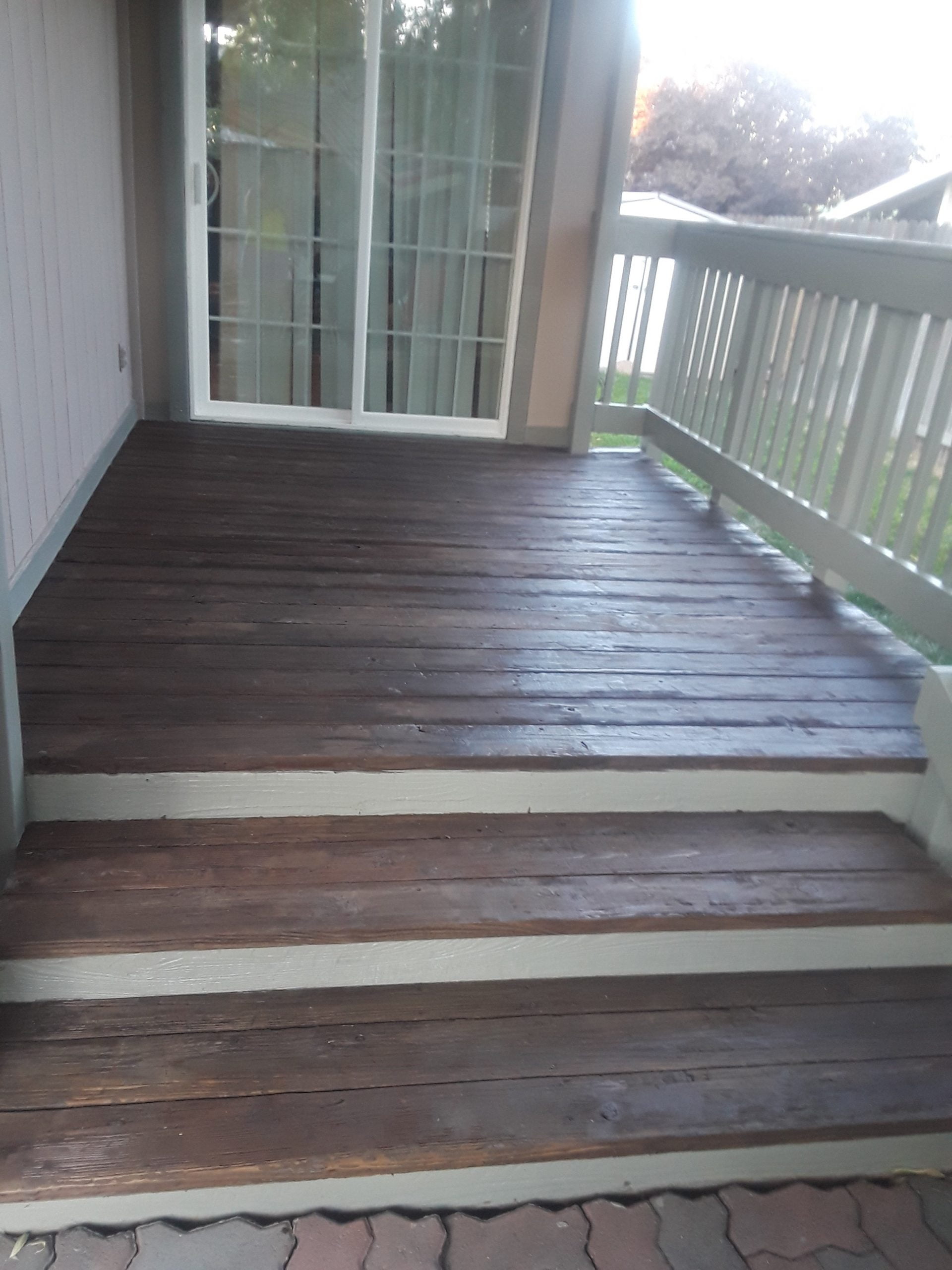

Worst ever product, trying to clean off our deck, the before and after cleaning, its just horrible. Does anyone have any suggestions?, we are thinking we might have to replace? Never thought it would be this hard to get off…. DO NOT USE!!!

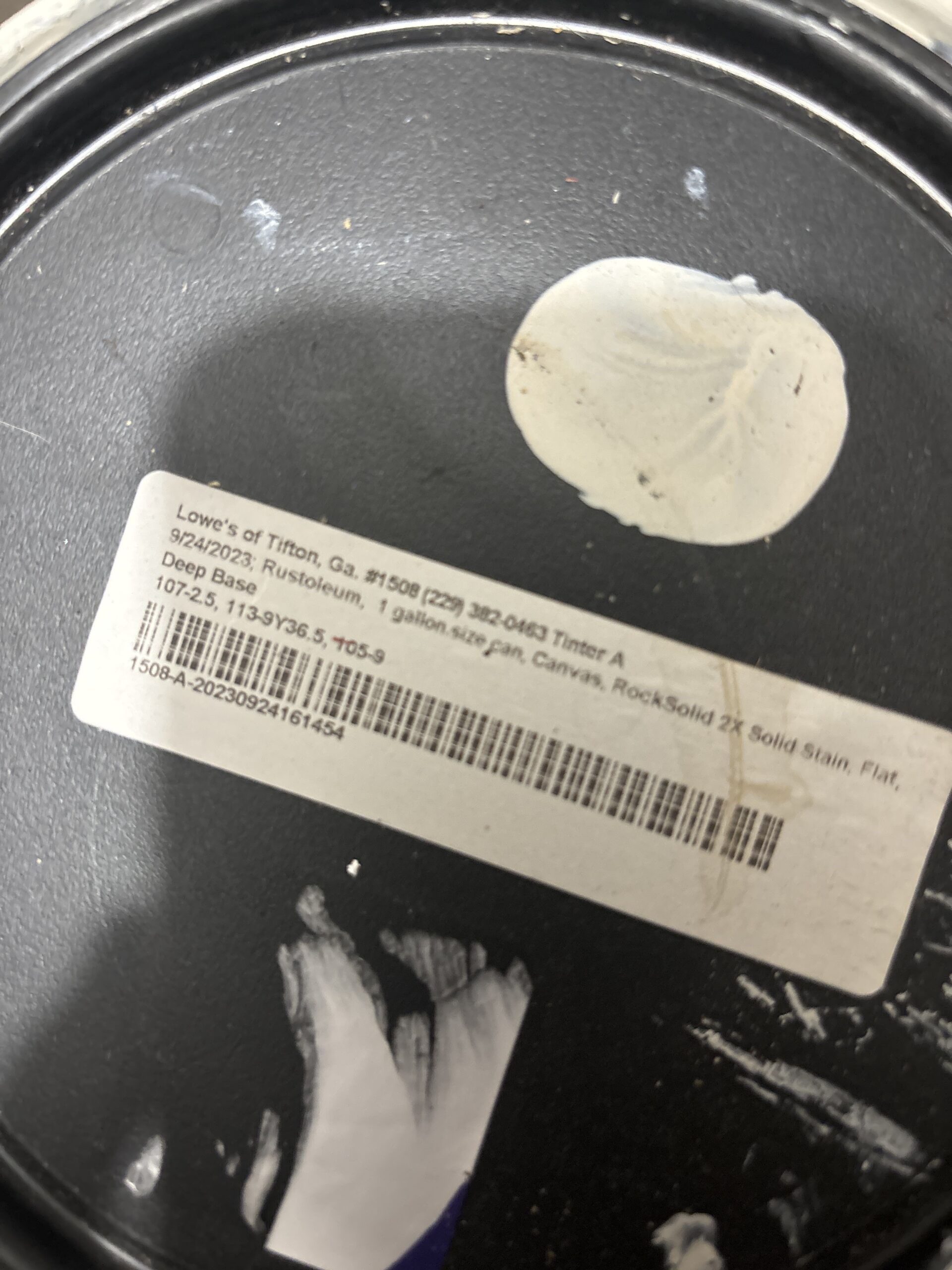

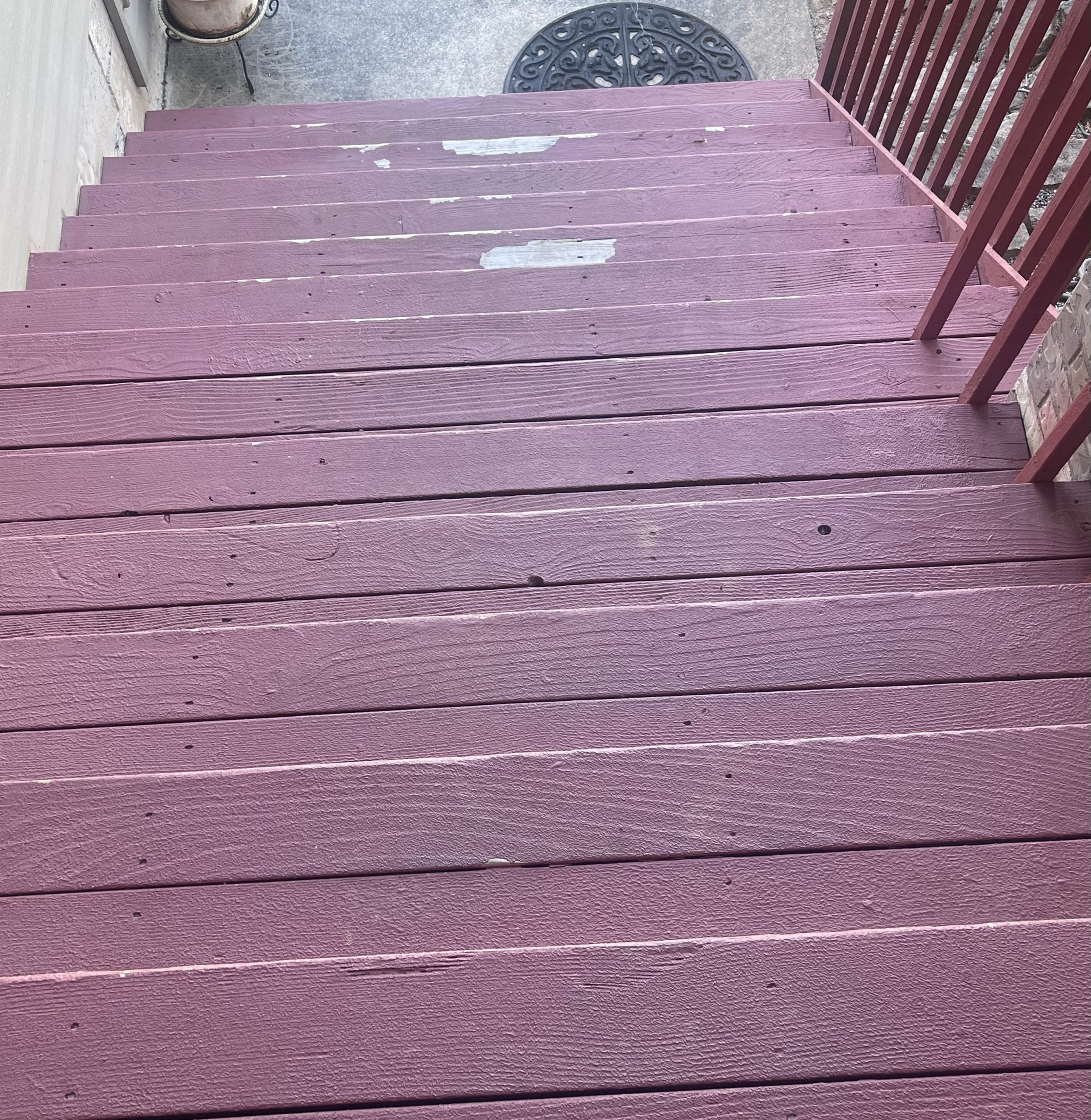

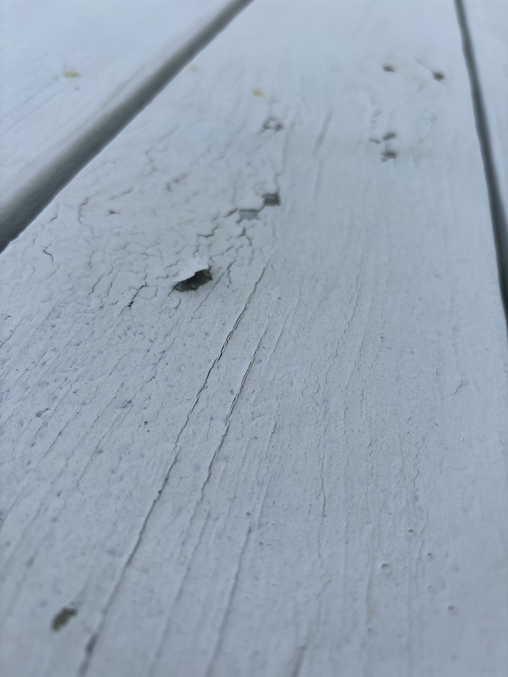

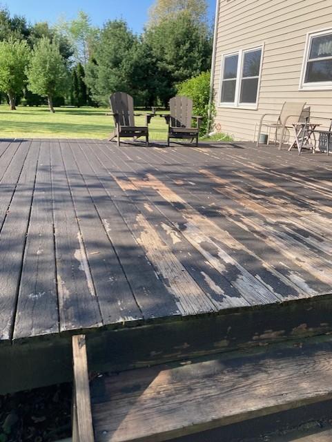

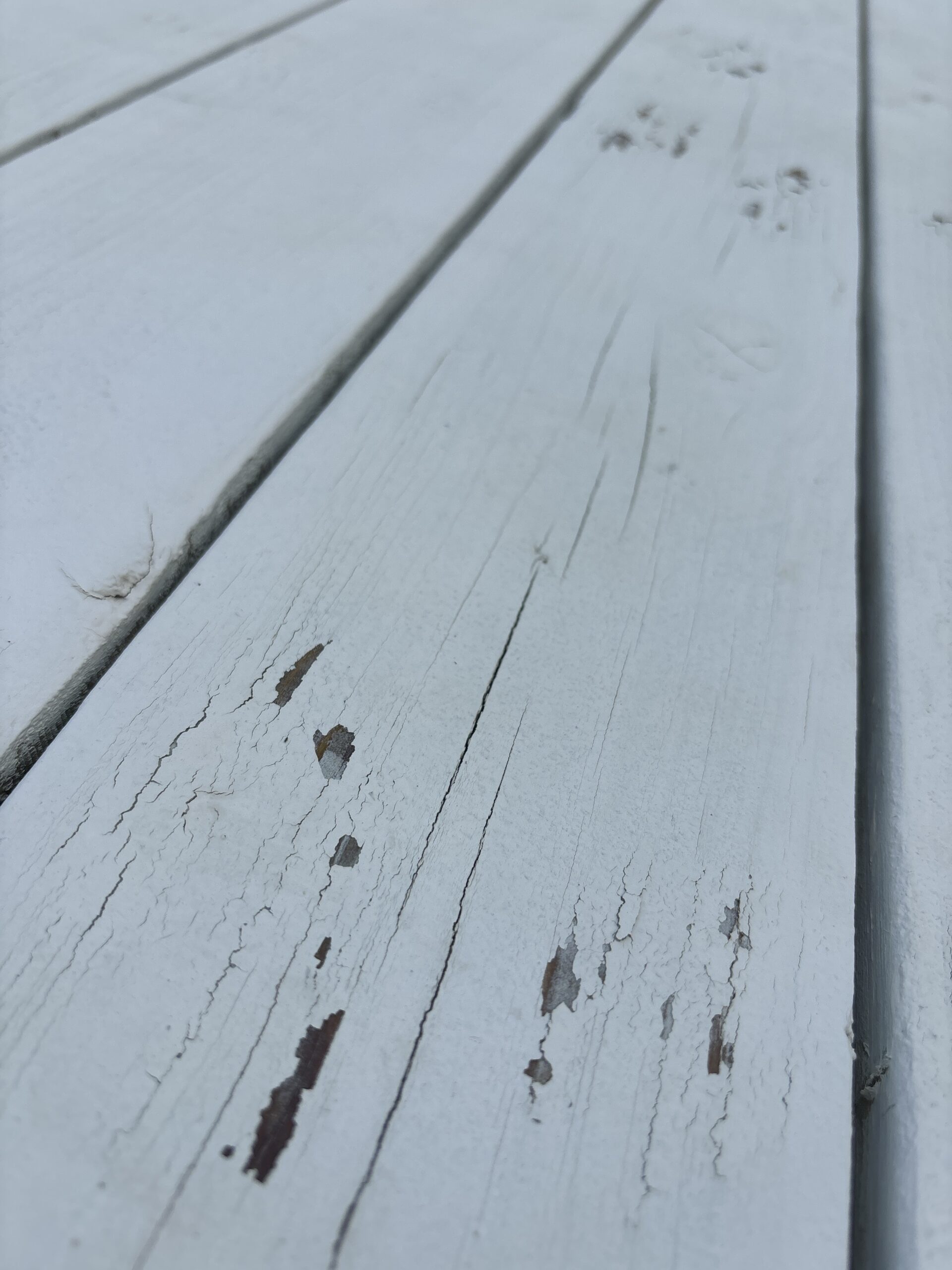

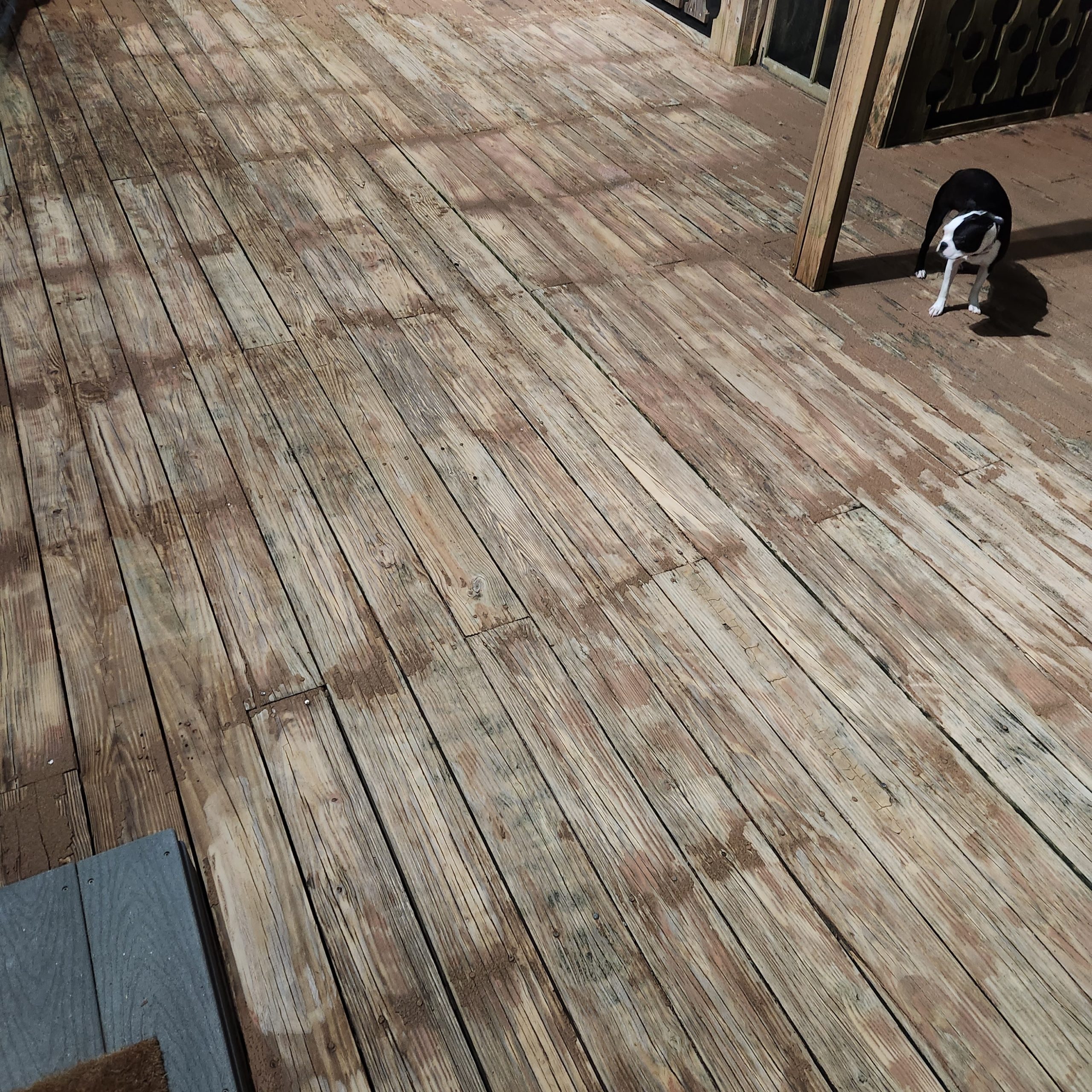

I painted my four year old deck because my wife wanted a grey color. I bought 6x because I had no visible cracks. Did what it said including sanding all four decks. That was last spring and spring it is ruined. Painters told me it would have to be sanded and scraped and don’t use Rock Solid again. I have four decks done. What a waste of many hours of time and money. Check photos

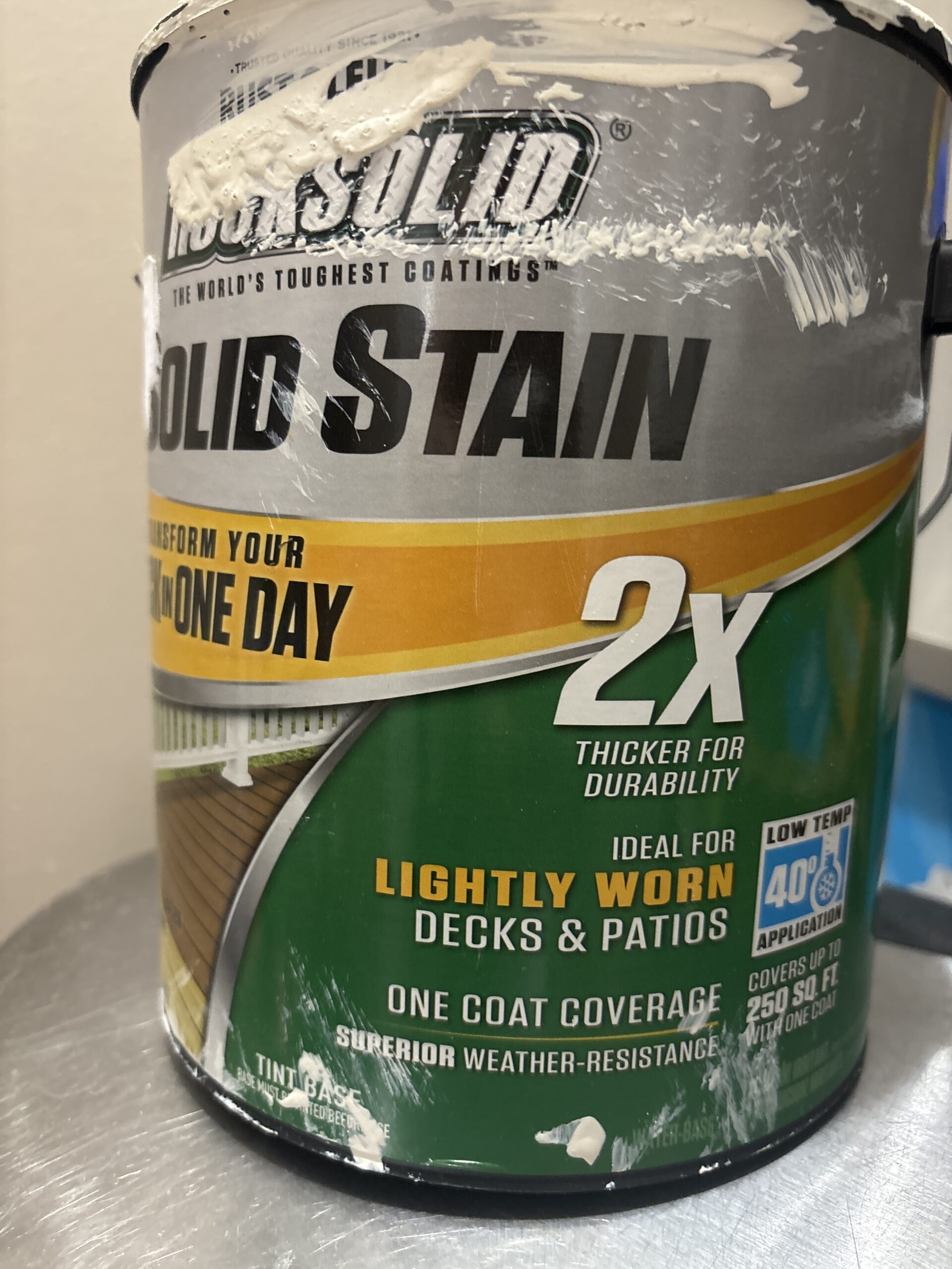

Our experience with the Rust-Oleum Solid Stain 2x for lightly work decks has been all but pleasant. The deck is fairly new so we let it weather & age for about 8 months. It’s March 2024 and we JUST applied it fall 2023. It’s already chipping and cracking in several places. We followed the directions completely when applying and even used the “recommended” Rock Solid deck & patio cleaner AND the deck start wood primer. Unfortunately we’re left with a mess that’s going to cost a fortune to repair because apparently this product is trash. Too bad they can’t reiemburse me. Any suggestions on what product we can use to cover this disaster up would be much appreciated!!

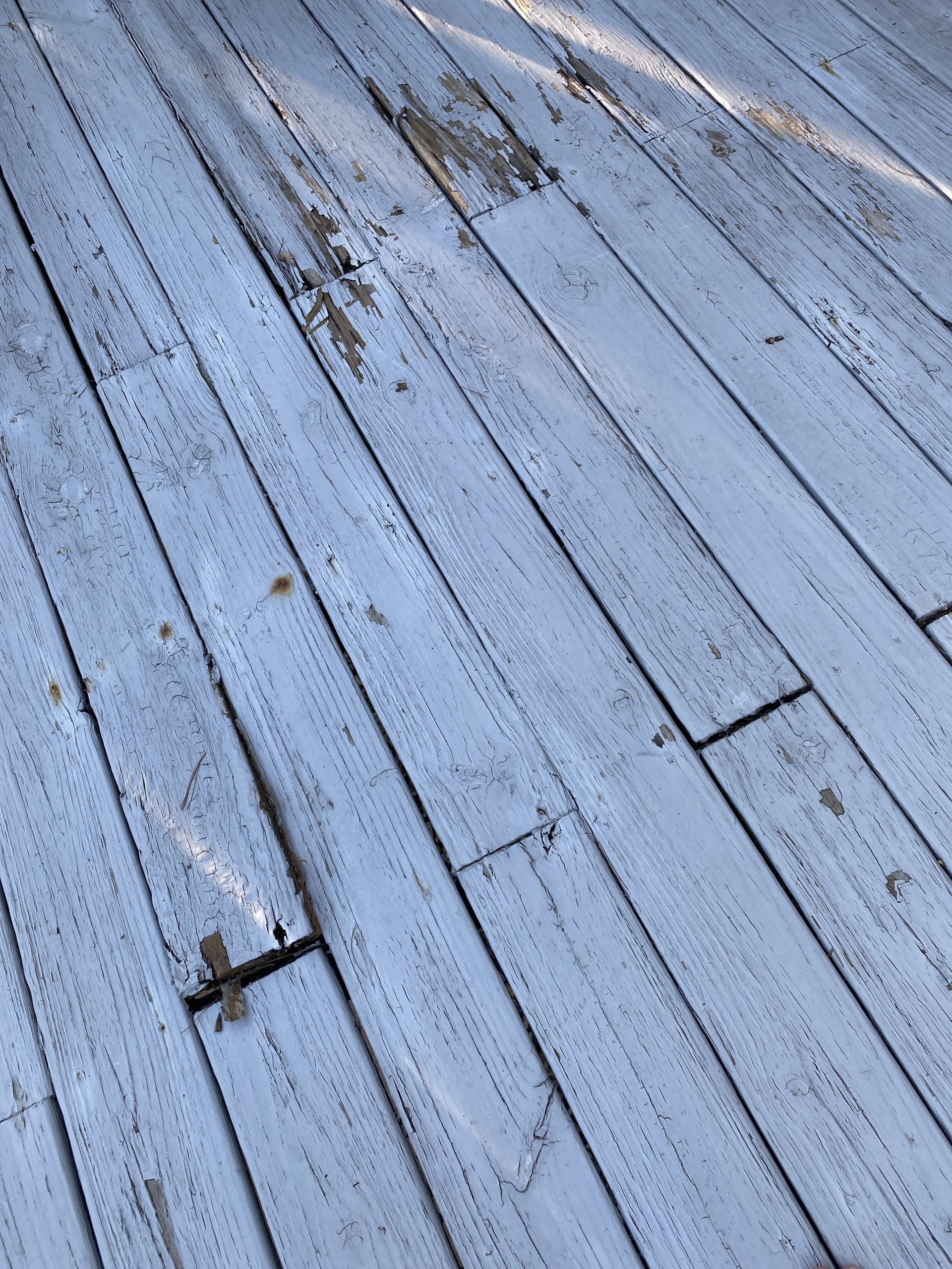

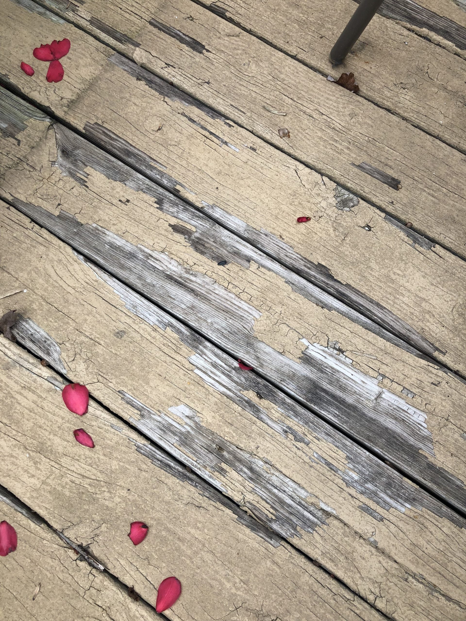

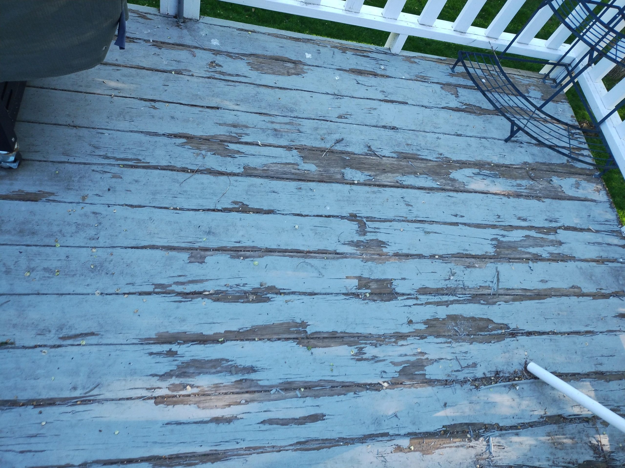

This is unacceptable!!! Paid a lot of money for the product to prolong the life of a 2 year old deck and now I’m going to have to start replacing and repairing!

Failed miserably after 3 years. Cedar wood under the 10X became constantly damp resulting in the 10X peeling as the wood rotted away. Had to replace every deck board at my own time and expense with Trex. See pix of all boards being torn up and the condition of the boards.
HATE RUSTOLEUM RESTORE ! ! !! !

I finally found a product to remove this awful stuff! Jasco paint remover works on synthetic products! It still takes a ton of elbow grease, product, and power washer, but here is my success story!!!

Jasco paint remover actually worked! I posted my before and after pics, pending approval. I still had to power wash for a significant amount of time, but it worked!
