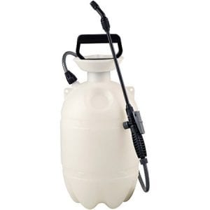

Two different types of deck stain sprayers are typically used. Pump-up sprayers are the most common and can be used with most transparent, semi-transparent, and semi-solid coatings. They will not work with solid deck stains or paints. They are reasonably cost-effective at $50 to $150 and can be used multiple times or cleaned properly when done. They will also work with your prep products.
The other stain sprayer option is an AIRLESS Paint Sprayer. These sprayers work with all wood and deck stain types. Much more costly, They can cost $500-$2000.

We suggest Chapin Deck Stain Sprayers if you are looking for a pump sprayer. They are the best options and have the highest quality. If you are using an airless sprayer, we suggest Graco sprayers.
