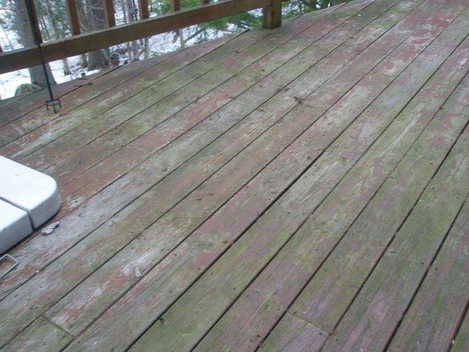

Sun Damaged Decking
Old Wood Decking

Wood decks can be a beautiful addition to any property but can become an eyesore when neglected. Sun and water damage occurs when a deck is neglected for too long. The wood loses its natural oils and becomes very dry and porous. Cracking, splitting, warping, and graying are all signs of an old deck that has not been protected against weathering.
