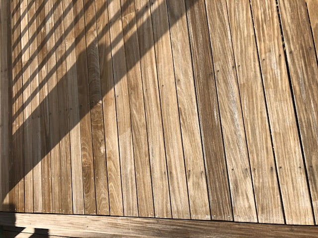

What is the recommended treatment for an untreated deck two years in?
Clean and brighten the wood for the deck and stain with the AC.
Here is a pic of the current condition of the wood.
It looks good to stain.

I have an IPE deck in Connecticut, western facing with sun from 10 am on.. I have used the Penofin product in the past, loved it when first applied, but then it turns black.. Stripped the deck last year. This year cleaned and brightened it. Looking for a product that won't turn black which would you recommend.
Heidi, I have the same problem with Penofin, it turns black every year, a real pain. Called Penofin they told me I was doing something wrong, I used Penofin last year applied it in the spring when the temp was less hot when I used it before, it turned black. I'm switching this year and trying the Armstrong Clark. was wondering what you used.
