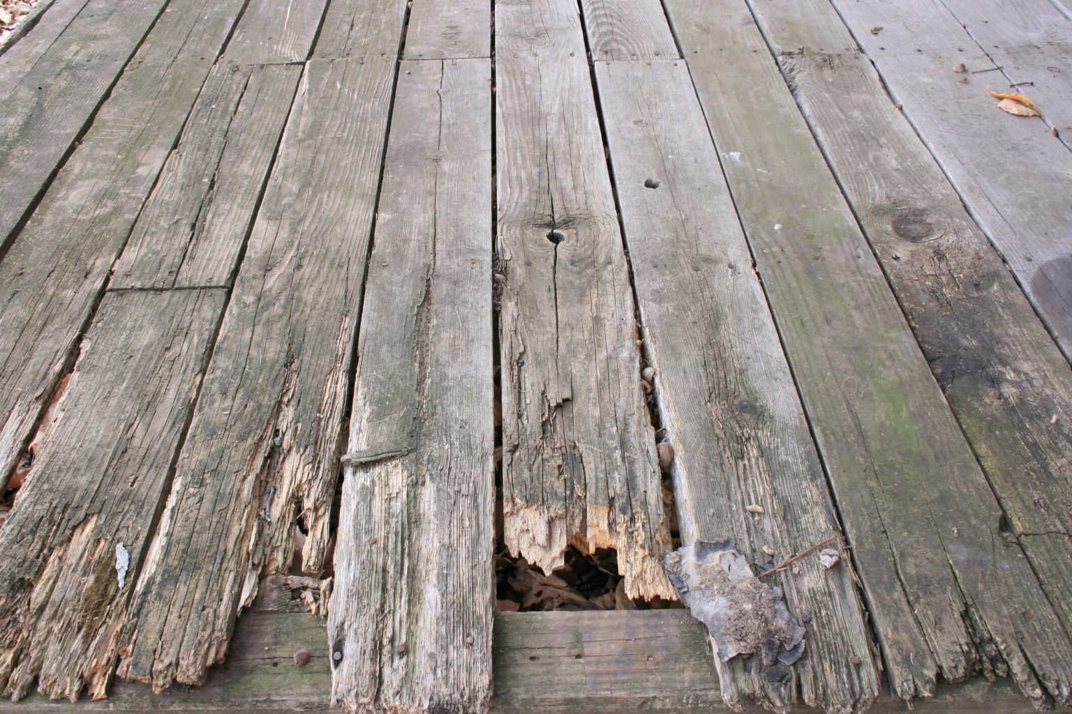

#1 Repair the Old Deck
Do a thorough look over for any rotten boards and replace them. Check for loose boards and railings and tighten these up as well with decking screws or galvanized nails. Check the foundation and decking supports for any structural damage.
My Pro Tip: Boards rot from the bottom up, so look under your deck for signs of wood rot.
