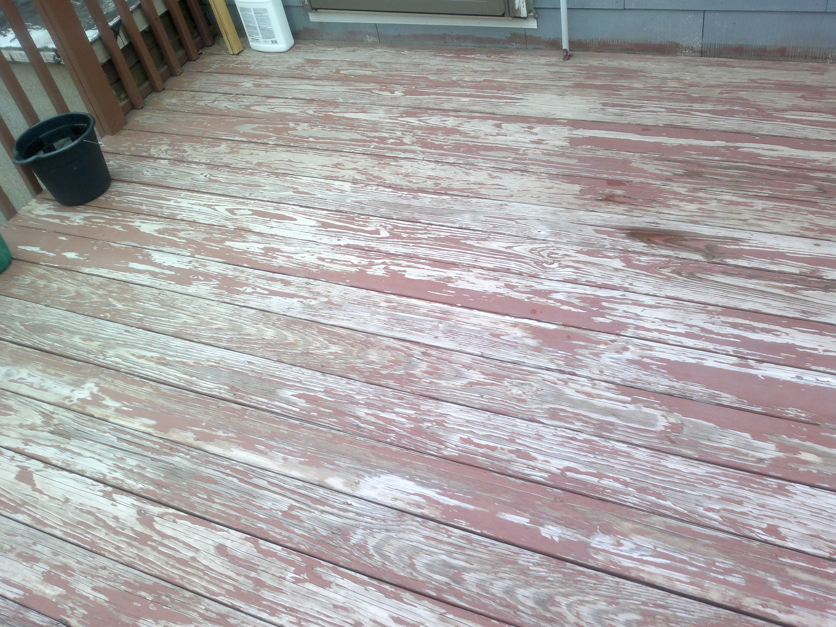

I have an old deck that paint chip off for more than 7 years. What type of stain should I get, how many grid sandpaper
Post a picture please of the current conditon so we know how to prep and what type of stain to use.

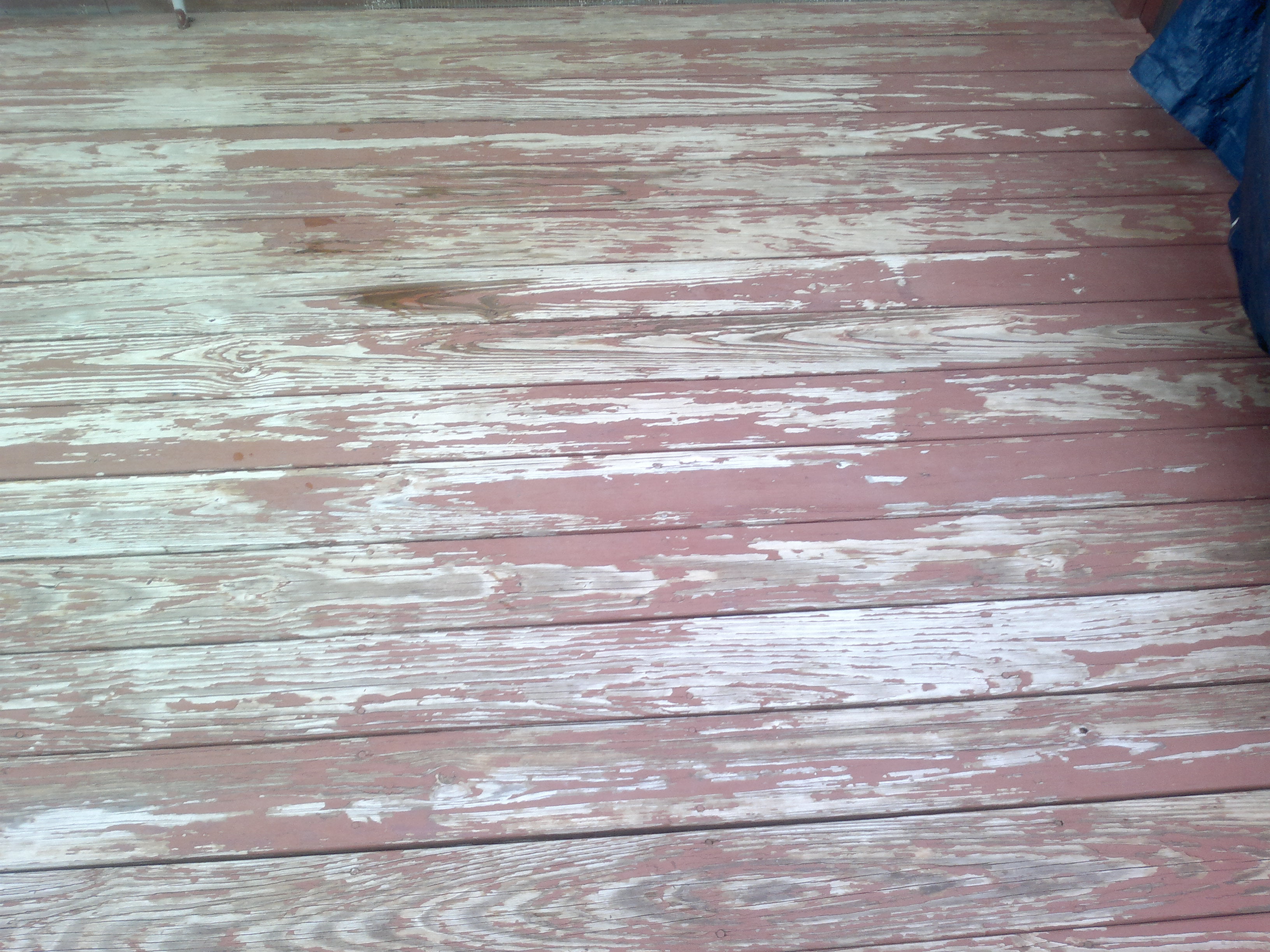

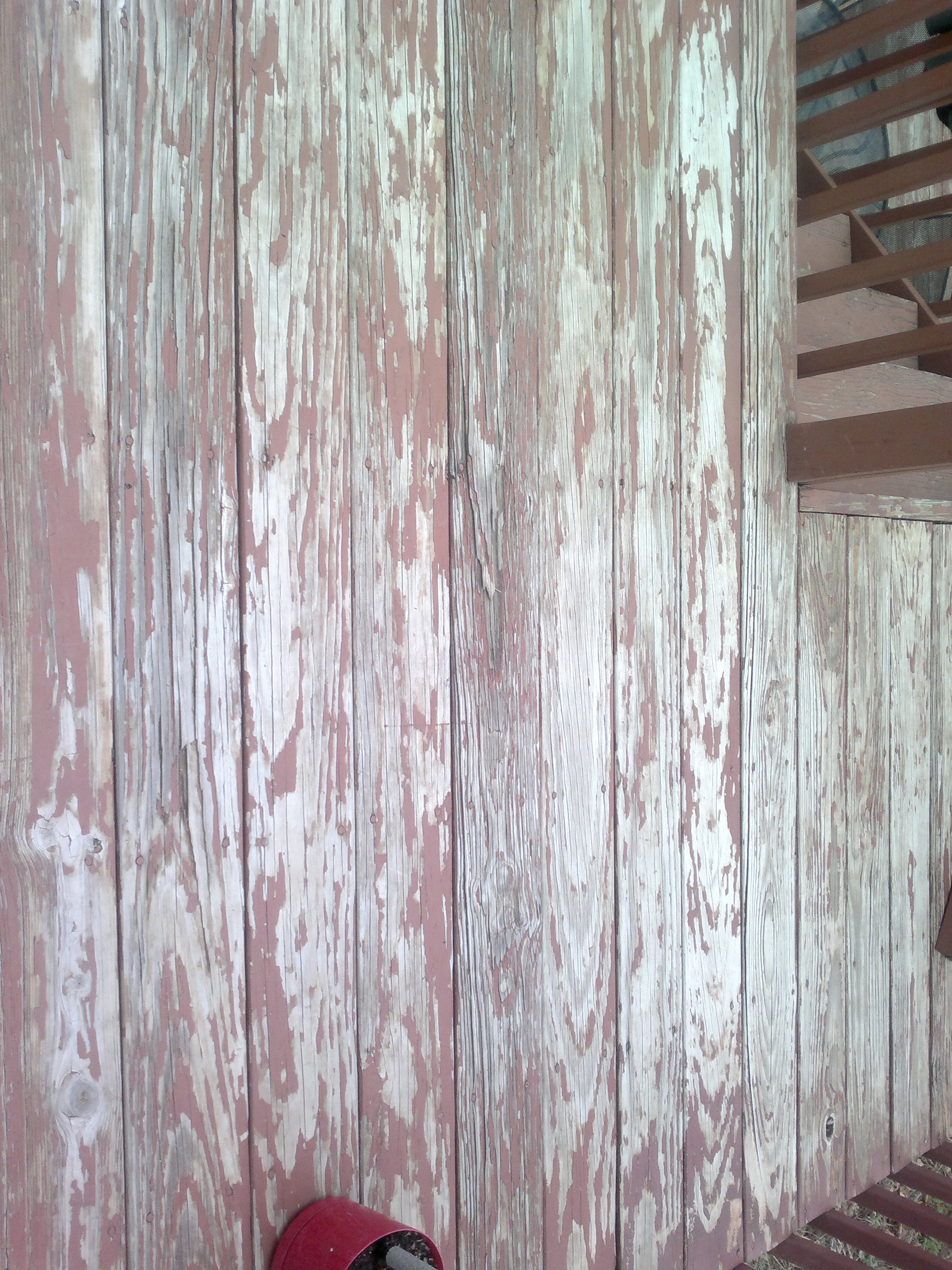

I powerwashed my old deck that was previously steined. The majority of the previous stein has been removed but the spindles and parts of the upright railing stein didn’t come off. Can I put a new coat of stein over the old stein? Also the deck was steined a red color can I use a darker color over the spots that still have red stein? I hate to replace all the spindles but would be easier then sanding them all down.
What type of stain is on the wood? Please post a picture.
Not sure what stein. It was a solid red
You will need a solid stain again to cover this old stain.
I have just power washed our very old deck. The deck was stained, but now after cleaning, half the stain is gone and half is still there in patches. Will have to sand all of the deck or can I stain over top of old stain?
Strip or sand so all is removed.

I have power washed my painted deck and it removed more than 90% of the old paint. I want to stain it next. Will the stain cover the paint that didn’t come off? If so, what type of stain should I look for?
The only thing that will cover it is a solid color stain. Since you are 90% there, why not remove the rest so you can use a semi-transparent? Less chance of peeling with a penetrating semi-trans.

I have a question. We just bought a house probably about a month ago and the deck the gentlemen we bought the house from just put the deck up at the beginning of this year. Its about a 500 sq foot deck around a pool. Most of the wood is still the original color but a lot of areas are starting to turn a light grey. We live in NY and its going to start snowing soon here. The days are about 50-60 and nights about 30-25 a lot of rain though we only get a day or two break in the rain. What can we do to get this grey off the deck and be able to stain in the next day or two? Can we stain over the grey? I would like a clear or maple color stain. thanks ahead of time for your help.
You cannot stain over the gray. You have to prep with a deck cleaner and wood brightener. Might want to wait until Spring to do the prep and staining.
