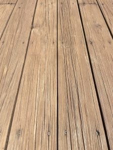

Have a 17-year-old pressured treated pine deck on a freshwater lake in Florida. Full sun and humidity year-round. Was treated with Olympic Maximum clear oil-based sealer 2 years ago. We wanted to go with a semi-transparent or solid stain. What’s the best products/process to restore? Does it need to be stripped, or just pressure washed and cleaned?
Strip and brighten for prep. Try the Restore A Deck Stripper/Brightener Kits. Stain with one of these brands: https://www.deckstainhelp.com/best-semi-transparent-deck-stain-reviews/
Thank you for the quick reply. The wood is very dry and it doesn’t appear there is any of the previous sealer left. Do we still need to strip it?
There is definitely stain in your pictures on the wood so yes, you must strip it off.

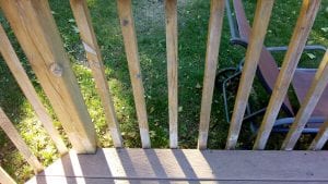

Photo for review.
Pressure wash for prep and use a solid stain for the rails: https://www.deckstainhelp.com/what-are-the-best-solid-color-deck-stains/

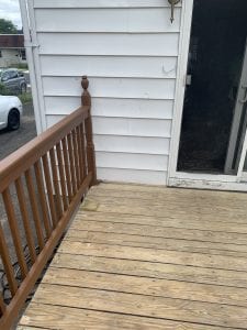

After pressure washing, there is still a lot of old stain left on railings. Does this need to be stripped off before using your products? Do I have to mask around deck to protect siding, doors, etc. or is it washable?
Yes, it should be stripped or sanded to be removed before using a different brand. No need to mask, just pre-wet and rinse any overspray right away.

OK…pics below of how redwood counter looked after built & sealed May 2018, last week looked gray, then I sanded, but still have light gray stripes. Good and smooth…do I have to use BOTH the Defy Wood Cleaner and Brightener..or, can I just use the Cleaner? Then which brand of sealer or stain should I use?
Thanks sooo much!
Use the Cleaner and the Brightener for prep. Use the Defy Extreme Stain after.

I have a pressure treated deck railing that was installed two years ago. About 5 months after that is was partially stained using a white solid stain. I have the stain that was used originally and want to finish it, but am wondering if i can just finish staining. I was just going powerwash. Any suggestions would be greatly appreciated!
Use a deck cleaner while pressure washing. Brightener after to neutralize.
Thanks. Any brand you recommend?
See this: https://www.deckstainhelp.com/restore-a-deck-cleaner-system-review/

This is where I need help. I have an old weathered deck in good condition. I have power washed it. It appears it has not been stained previously. It is treated wood about 12 yers old. I want to apply a solid stain. The paints store has recommended I apply Fresh Start, a sealer prior to applying the stain.
Anybody have an opinion on this approach? What about using a brightener too?
Thanks for any thoughts on this project.
You cannot seal before a stain. The stain will not be able to soak in. A brightener would have no effect. Try Flood Pro Series Solid Stains.
