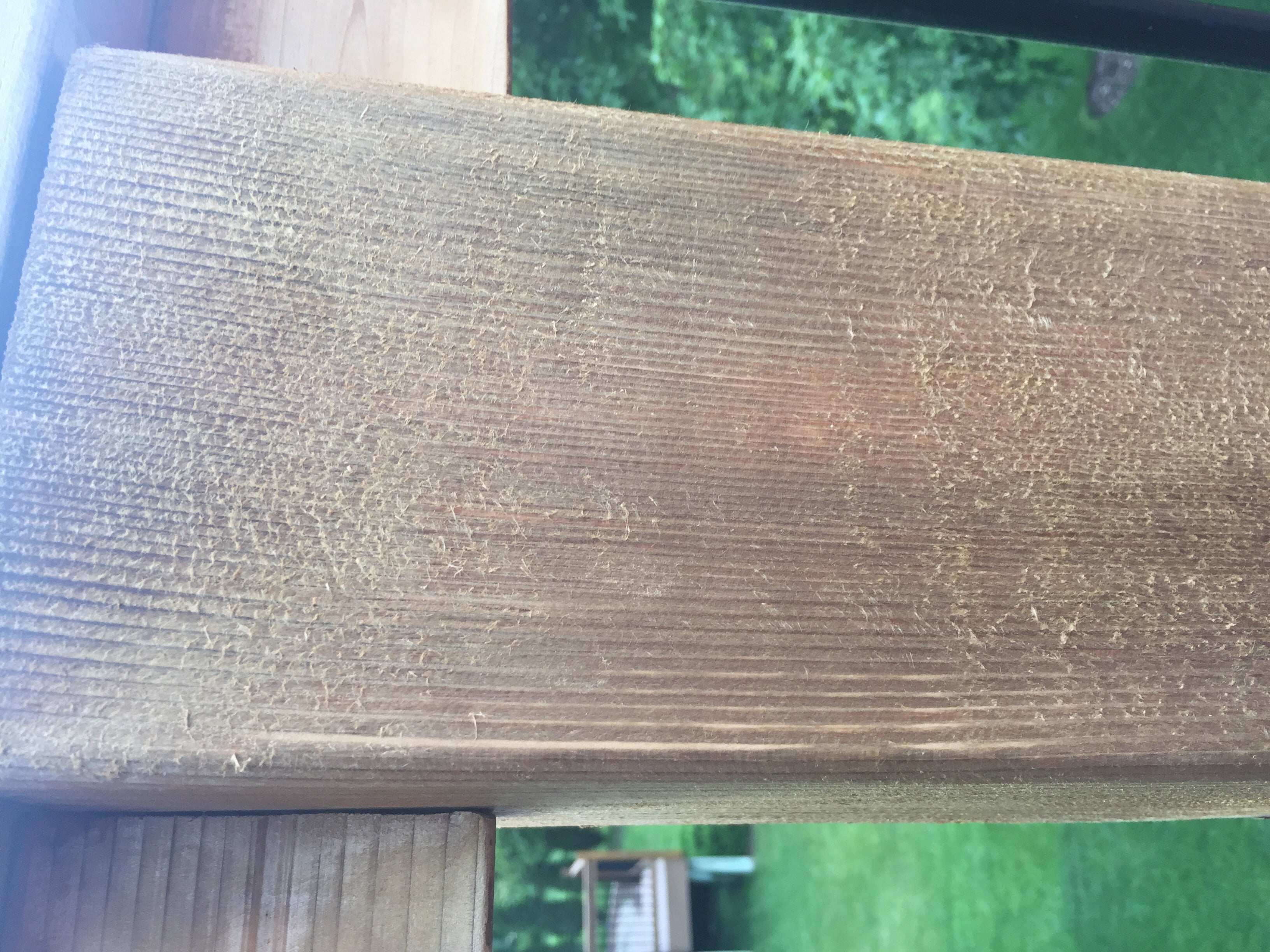

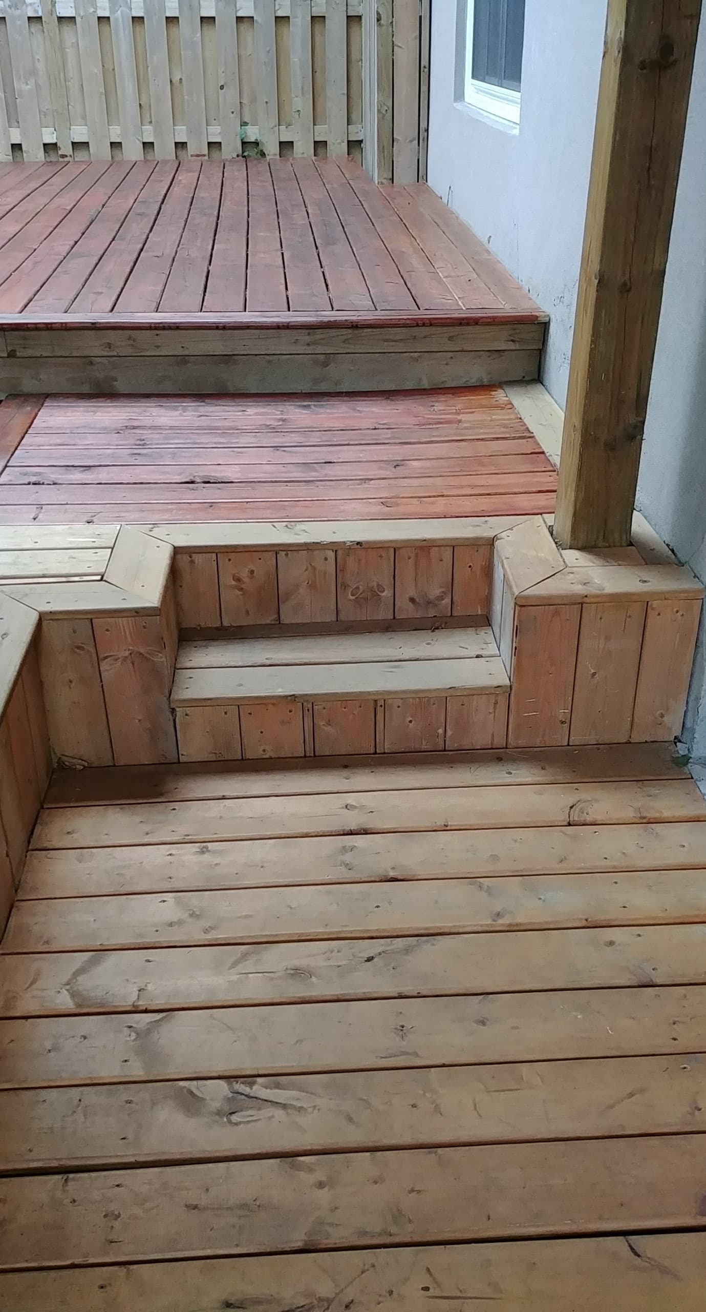

I power washed my deck and then sanded with 80 grit, but in the photo it looks like I haven’t gotten it all. The previous owner used Olympic stain, I plan on using the same stuff. At this point, does it look bare enough to just put down the new stain? Or do I keep sanding? It’s pain to get up, and it sounds like stripper won’t work.
Allen
Allen
Thank you. I am considering using Restore a deck stain stripper, would you recommend this to remove the remaining Olympic stain? I also plan to follow it up with a brightener.

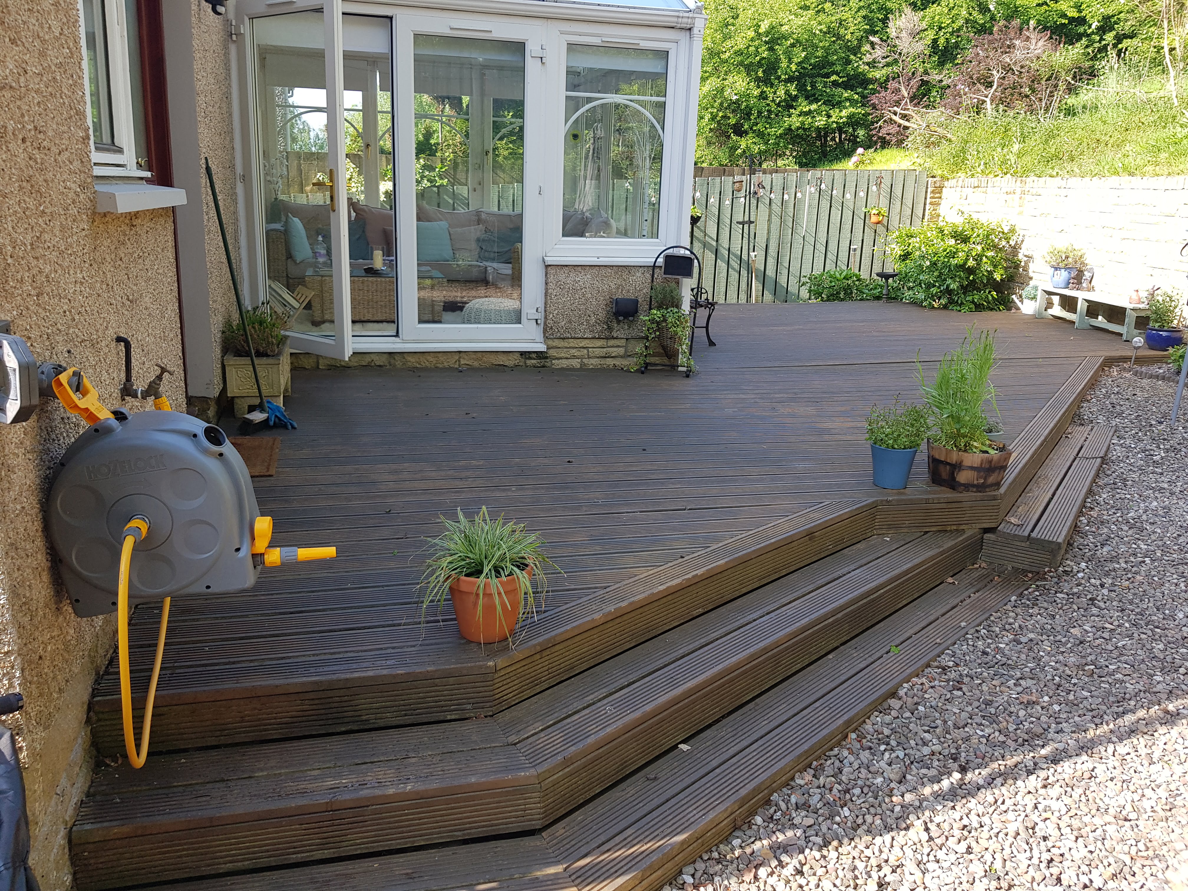

I have recently moved into a house and want to strip and redo the decking. I have no idea what they have used to treat the wood, any ideas from these photos?
I have bought some Ronseal Paint Stripper – will that do the job?
Many thanks
Reply to  Tom
Photo 1
Reply to  Tom
Photo 2
Please let me know if you require any more
Thanks, can you still power sand when the wood is grooved?
Thanks, will power sand be effective even though the wood has lots of grooves?
Thanks for the advice – at least I know not to waste my time trying to remove!
Apologies for all the posts, they were not showing before.

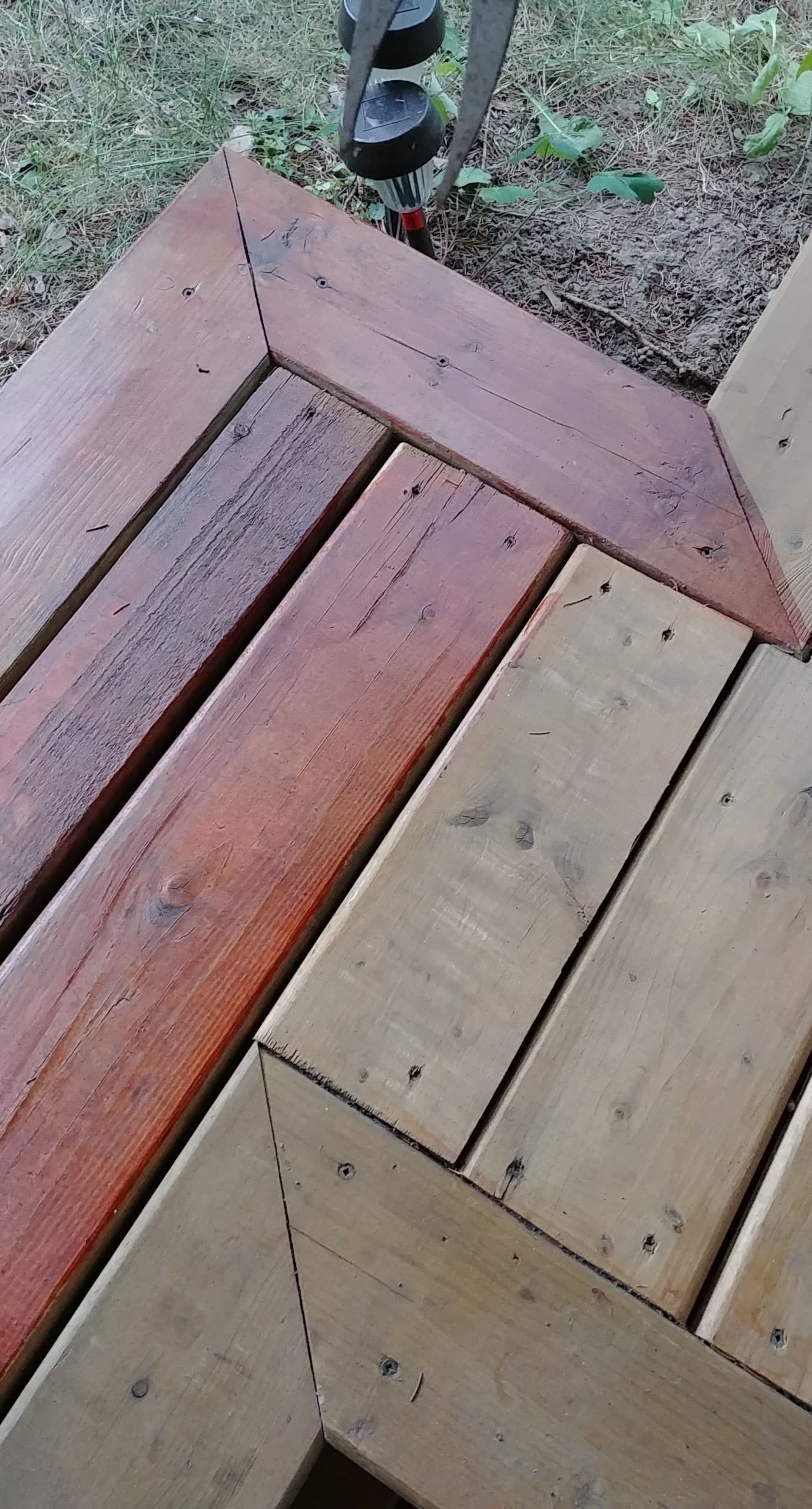

Just bought our house. Some of the deck is being entirely resurfaced with new wood. Some areas are decent for a few more years. One area had a solid stain on it that looks to be very old. Most of it came off with pressure washing and scrubbing using a deck cleaner. Some areas still need scrubbed some more. See attached photo. I have two issues:
1. We bought a stain/sealer (Olympic Maximum Pearl Gray) and tested it on one support post. We do not like the outcome. I will be using Cabot Australian Timber Oil instead. How can I get this post back to clean again? It was just applied last night and I plan to TRY to strip this tonight. Since this is freshly applied, would a deck stripper get this off pretty easily still?
2. Some areas that did not completely clean from the old solid stain will be scrubbed and pressure washed again. I’m still not sure it will all ever come clean since it’s so old and deeply set in the wood. Since a lot of the stuff that did not come off is up high in the air, I’d love to find a chemical that will remove this so that I don’t have to scrub high stuff dangerously. Any ideas how I could possibly avoid significant sanding efforts?
Any help is appreciated and thanks for all the previous help this site has given me over time. It has been extremely helpful for us!
Jesse
Jesse
UGH….I had a feeling. Thanks for the help!

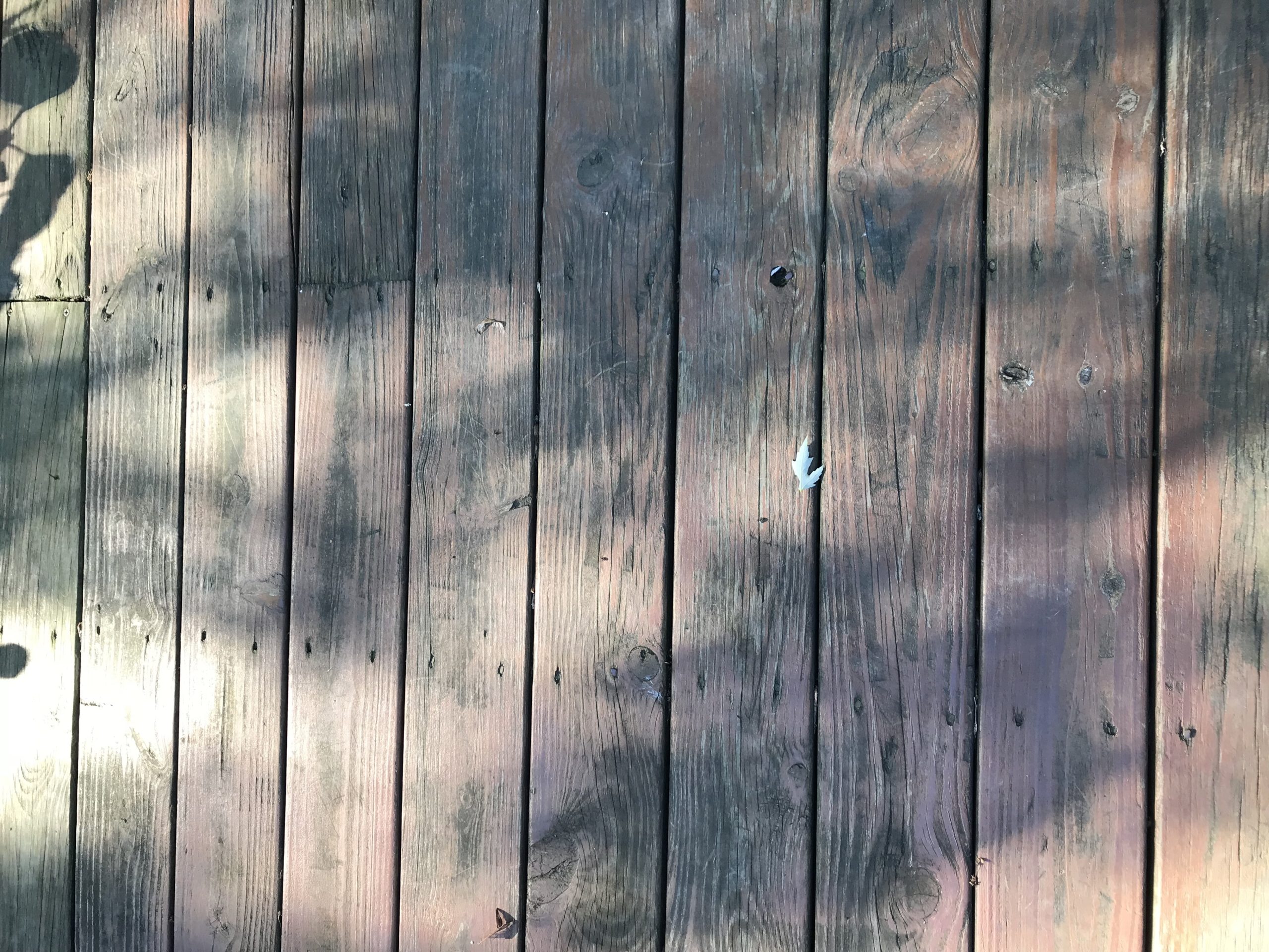

Hello, I have a deck with an unknown prior coating. Not sure when prior homeowner last stained.
My plan is too strip, brighten and stain with Flood Pro Series Solid Cedar.
Do you think it will require sanding as well?
Here are some photos that may help.

We just stripped out decks and rails with pressure washer. From the looks of it, we need to sand it for all the new rough spots peeled up with pressure washer. Then water seal. Do you have any other suggestions??

We redid our deck last year….sanded and stained, looked great. This year we scrubbed it with bleach and applied stain before it was thoroughly dry. Mistake! Now do we need to strip it, add brightner and re stain? In that order?
Super deck transparent
In the end, we stripped, brightened – let it dry for a week – sanded and stained…..results, an amazingly beautiful deck. We live in Washington State and after researching stains for the Northwest we used Armstrong-Clark semi-transparent stain and Andre extremely happy with it. Thank you for helping; it certainly was a lot of labor that has paid off.

We started staining our deck this week and hate the color. It was not at all what we expected. Is it possible to remove it with it being newly stained and not old?
Melissa
Melissa
This is what we used. I don’t have a pic of the deck. But it turned out an orange red color. We did not finish so it’s only the first coat sprayed on and still has a lot of unstained wood showing through. Any hope?

We are using beauti-tone 100% acrylic semi-transparent stain. I have attached pictures
Jas
Jas
It was supposed to be a dark (really dark) stain that still shows wood character. The spots where it stripped like it was supposed to looks like brand new wood
