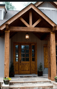

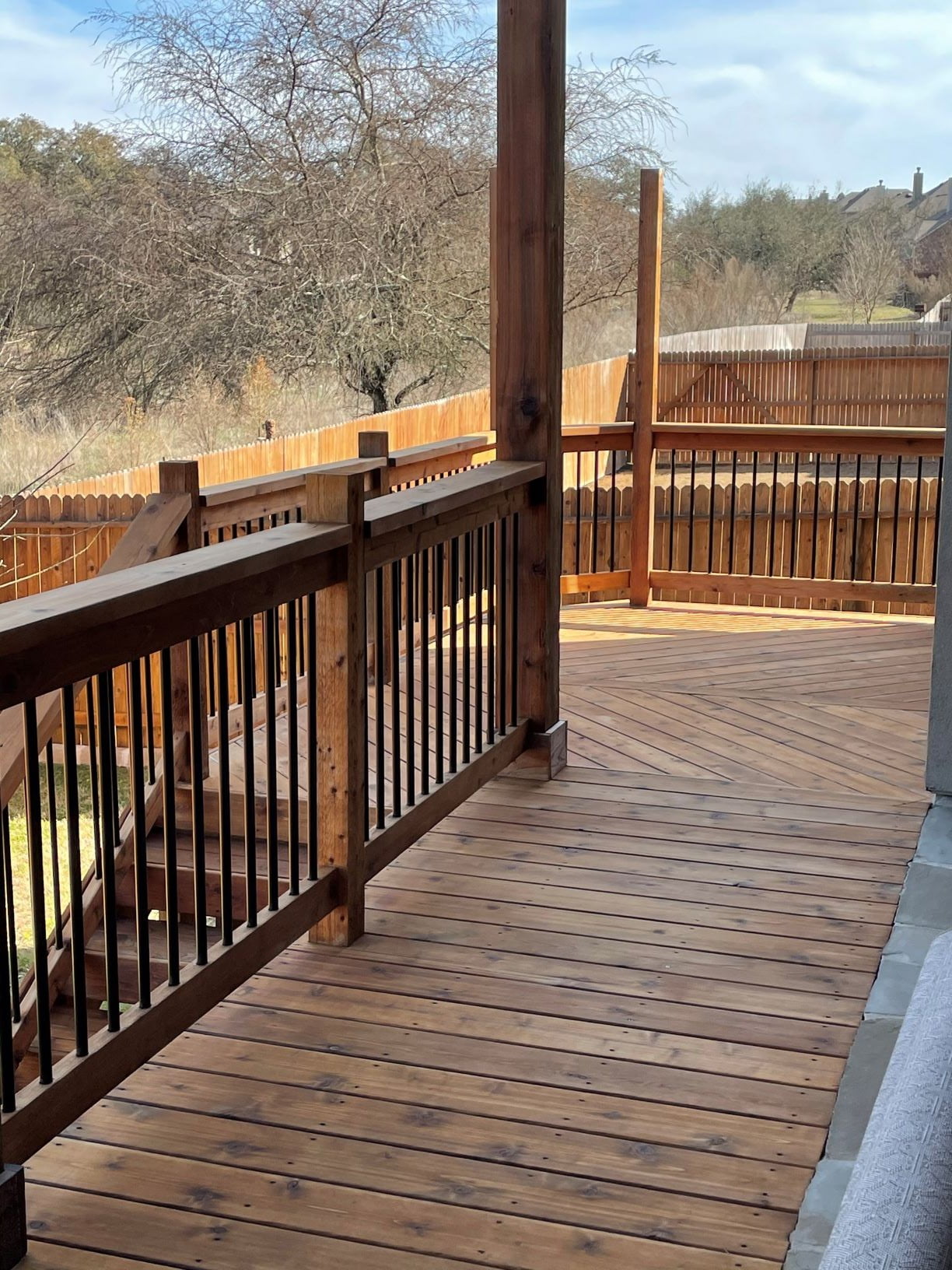

Some of our favorite stains for rough-cut lumber include natural tones like rich, chocolatey browns, honey hues, and redwoods. However, if you prefer a more opaque look, consider a solid gray or blue stone to create a beachy vibe or black and charcoal for a sleek, modern look.

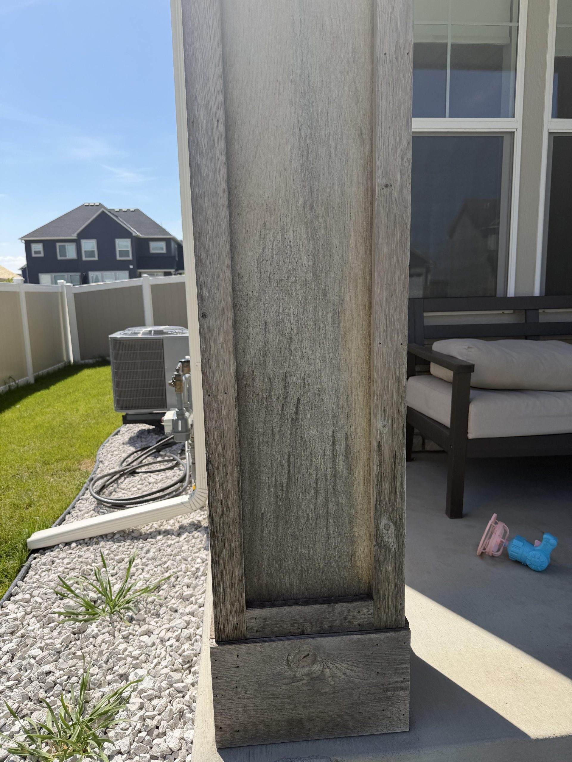

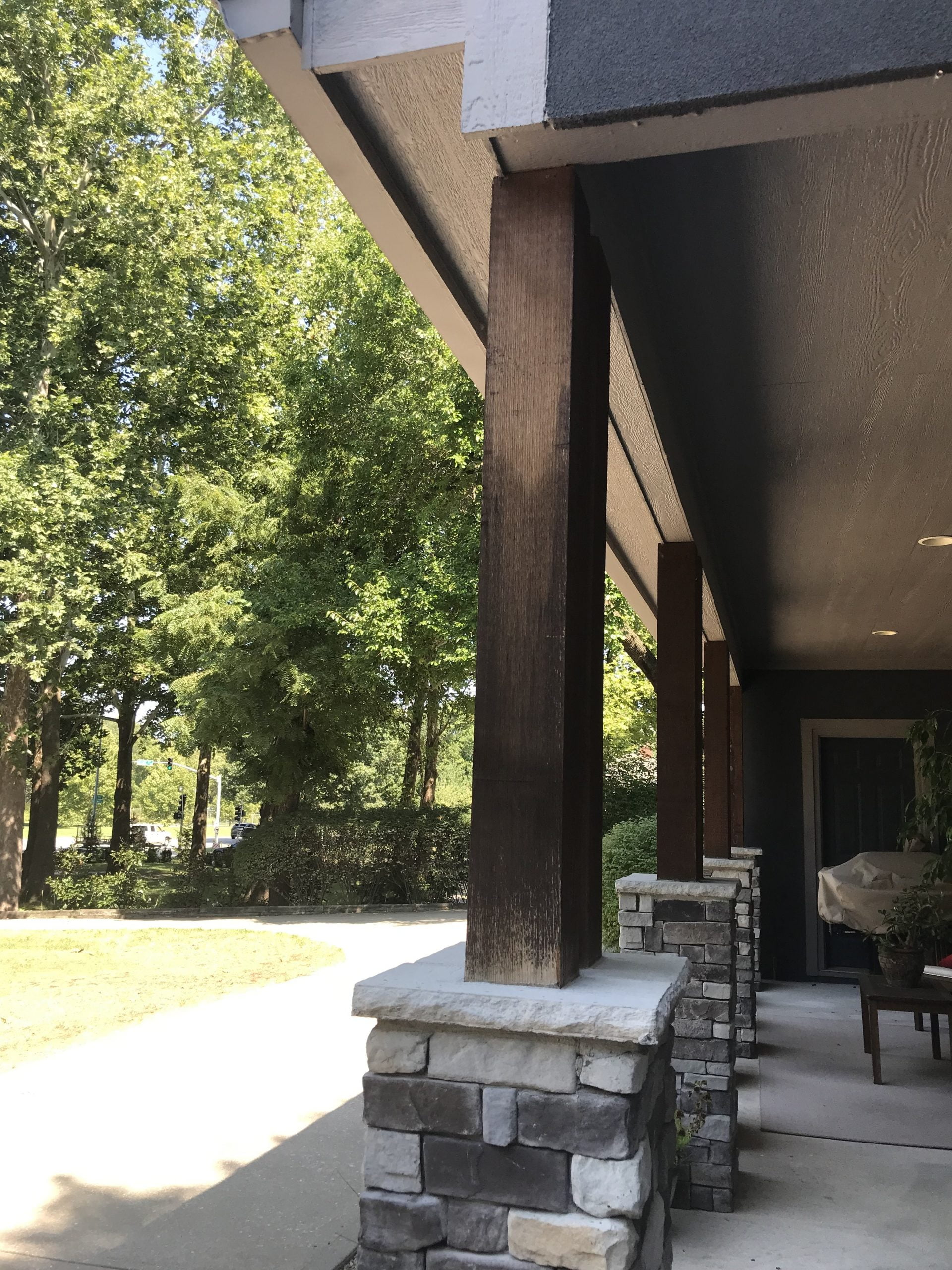

What kind of brush would you recommend when cleaning rough sawn cedar exterior pillars? I just ordered some restore a deck cleaner and brightener and do not want to risk damaging the pillars by using the wrong type of brush. Thanks!
Much easier and more efficient to lightly pressure wash then scrub.
If you scrub, use this. https://www.deckstainhelp.com/product/restore-a-deck-staining-brush/
Thank you! So power washing is okay with rough sawn cedar? I’ve attached some photos. Some sections are in pretty rough shape so I don’t want to damage them.
Yes. You use it as a rinsing tool after applying the cleaner. Wash about 8-12 inches away from the wood with the fan tip.

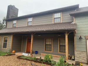

Thank you for your publication! We just put up a simple 2 car garage and sided it with rough cut hemlock. In upstate NY buildings left to weather naturally turn blackish, more so as it gets closer to the ground. I’d really appreciate a suggestion that with some maintenance will preserve the natural color and prevent the blackening. Thank you
Look at the Restore-A-Deck Semi-Transparent:
or Armstrong Clark:
https://www.deckstainhelp.com/armstrong-clark-wood-deck-stain-review/

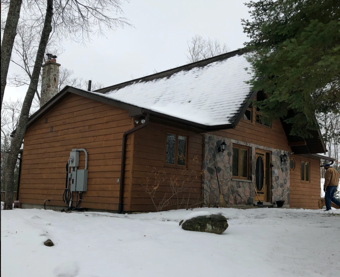

We purchased a 40yr old rough cedar sided home near Blue Ridge GA. Previous owner didn’t do anything in the 6 years they lived there other than apply clear sealer but they’re unsure what was used. It’s got some lighter spots and areas where nails can be seen but overall just needs a refresh. No mildew visible, only dirt and pollen. Do we pressure clean or soft wash? Then approximately how long until we can reseal? What products do you suggest? We prefer the transparent/semi look vs solid. We have paint sprayers, do you suggest we use them or to hand brush? Thank you for your guidance.
Post pics in the comments for prep help.
Thank you. Sorry, I thought I had.
You have a semi-transparent stain on the wood, not a clear one. If you do not know what was used prior, you will need to remove it and start over with a new brand of stain. Post a close-up of the wood so we can offer tips on how to remove it.
Thank you. The last owners said they applied a protective clear, that’s all we know, but we don’t know what kind or brand. These are 2 different sides of the house, before and after pressure washing.
It’s still rough, so apparently it hasn’t been sanded previously and we like that. We’d like to protect it and keep with the transparent stained look. Any help/steps are appreciated.
Use the Restore A Deck Stain Stripper with Booster and the Gel additives. Apply, wait about 20 minutes, and pressure wash off. Do it in sections and repeat until done. Brighten all after. As for the stain, use one of these brands:
Thank you, we appreciate your expert advice. Sounds perfect for our job.
Just curious, how is it obvious that there’s no clear on it currently? It looks shiny in some areas, like the back wall under the rear covered porch that doesn’t get direct sunlight. The prior owner is a widow and unsure what her husband used but thought it was a clear coat. Thank you for educating us for this job and future maintenance.
It is clearly a tinted (brownish cedar color) stain, and you cannot apply a clear coat over a wood stain, it would peel.

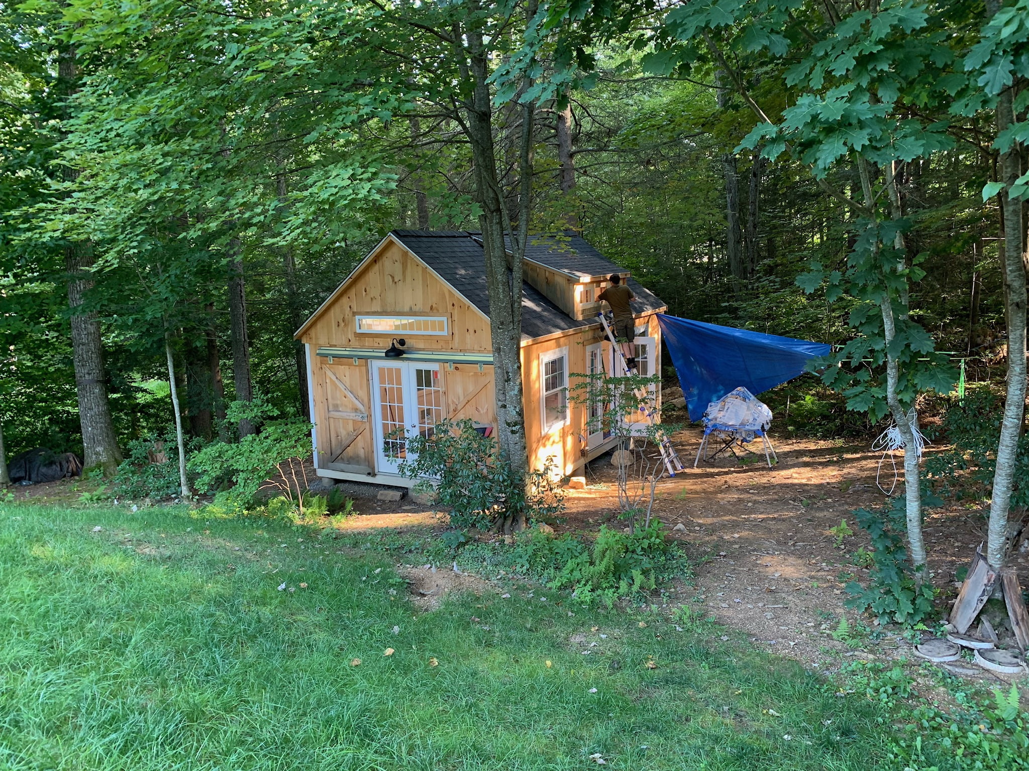

Just finished building an outdoor shed using rough cut pine that was cut and milled on our property. Would like to preserve the rustic new wood look, but not sure what kind of stain to use. Natural probably, but water or oil based?. Something mildew resistant is a must. It is very woodsy and damp here in the Adirondack Mountains of New York with long winters.
Use Restore-A-Deck Semi-transparent stain in Natural color. It will work better for mildew and mold prevention.

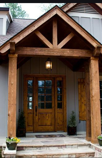

What stain did you use to get the “dark oak on rough cut lumber” picture above? Thanks!
It was TWP in 100 or 1500 Series.

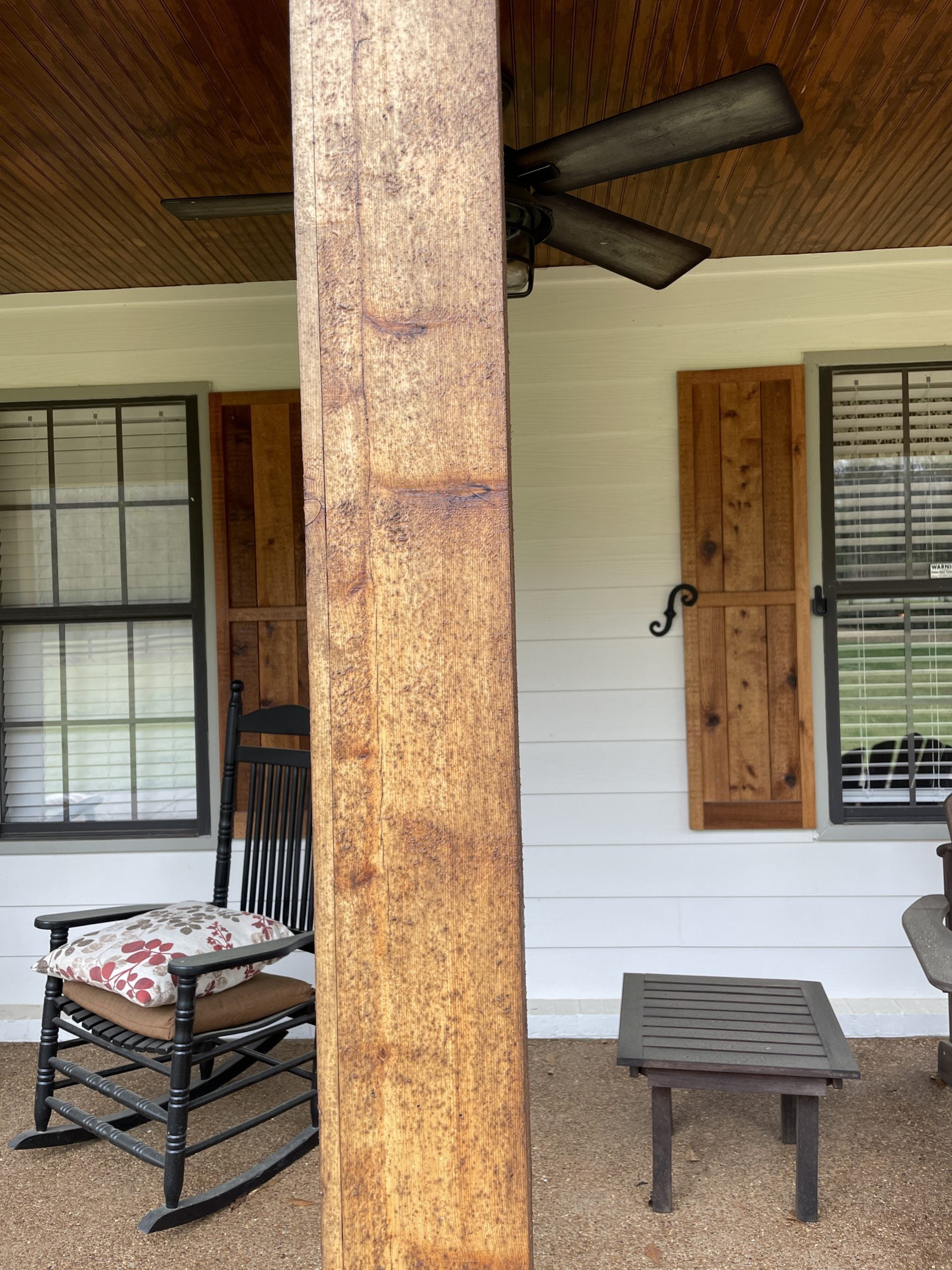

I’m curious to what color stain was used in the attached picture from your website?
We have had such a hard time finding a stain color we like. Everything we think we like ends up being too dark.
We will be staining our 10×10 rough sawn post along with our knotty alder doors and shutters.
All and any help would be greatly appreciated.
Looks like a basic cedartone color on rough sawn cedar. Colors will vary from wood species so it may not look the same on your wood.

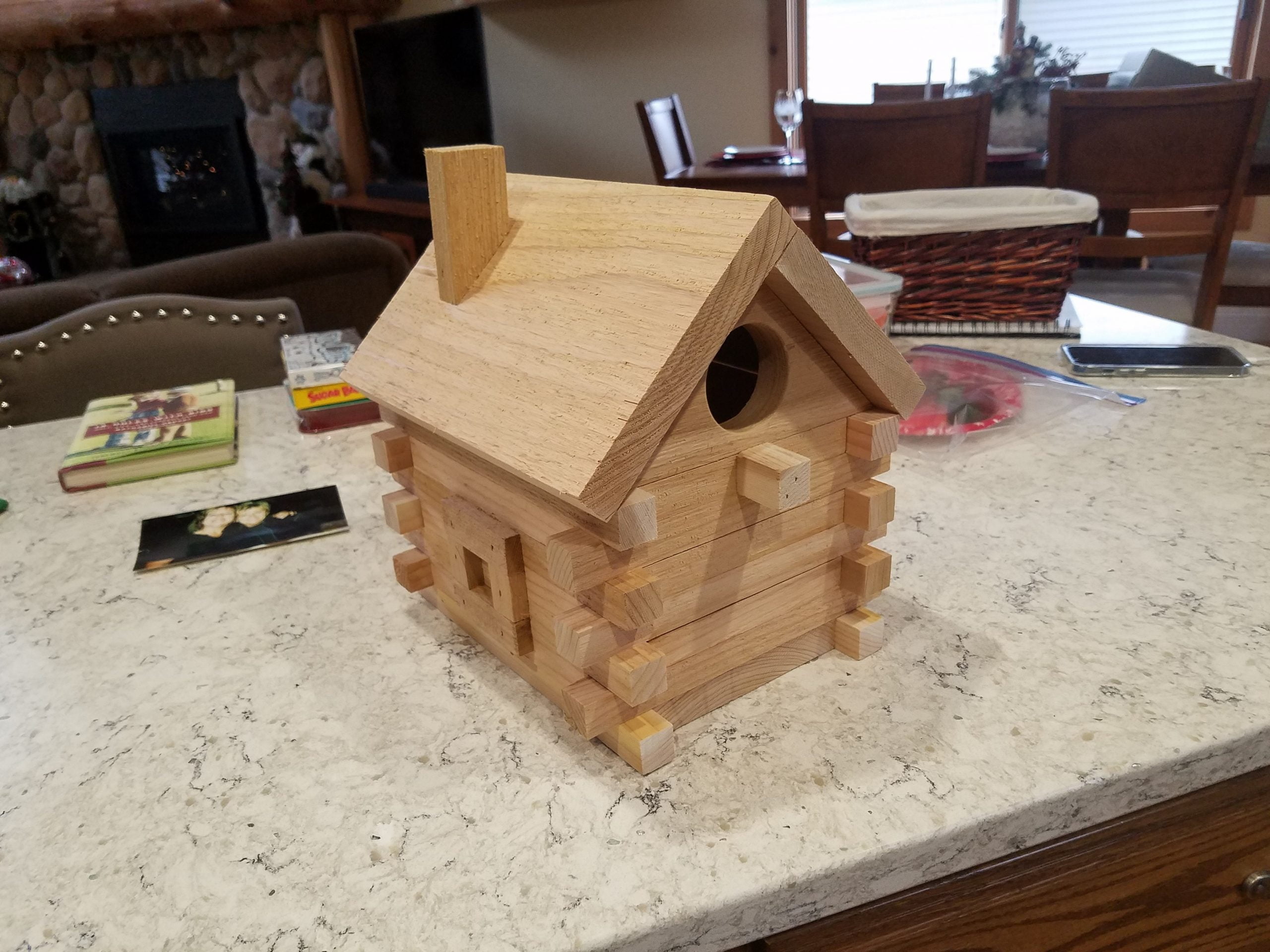

I have gifted hand made rough sawn cedar birdhouses to family and friends for Christmas. They are asking my opinion as to the best way to seal and protect them for outdoor use. Can you help???
Frank
Try one of these top stains: https://www.deckstainhelp.com/the-5-best-deck-stain-reviews-and-ratings/

I had a treehouse built for my daughter back in the Spring. The siding is rough sawn poplar and has started to gray so I have decided to clean and stain it and found your site while attempting to figure out how to best proceed. Would you recommend Restore-A-Deck to clean and prep the surface? Would any of your top rated stains work well for this project? Since the treehouse has weathered, should I consider a solid stain instead of a more transparent one, keeping in mind that I do want it to look as natural as possible but also fresh and not mildewed? Would I need to use a different type of stain for the deck and posts, which is made of pressure treated wood?
If you are willing to answer all of these questions, thank you so much in advance!
Yes, use the Restore A Deck products for prep. Do not use a solid stain. Use Restore A Deck Semi-Transparent Stain or TWP Stains.
