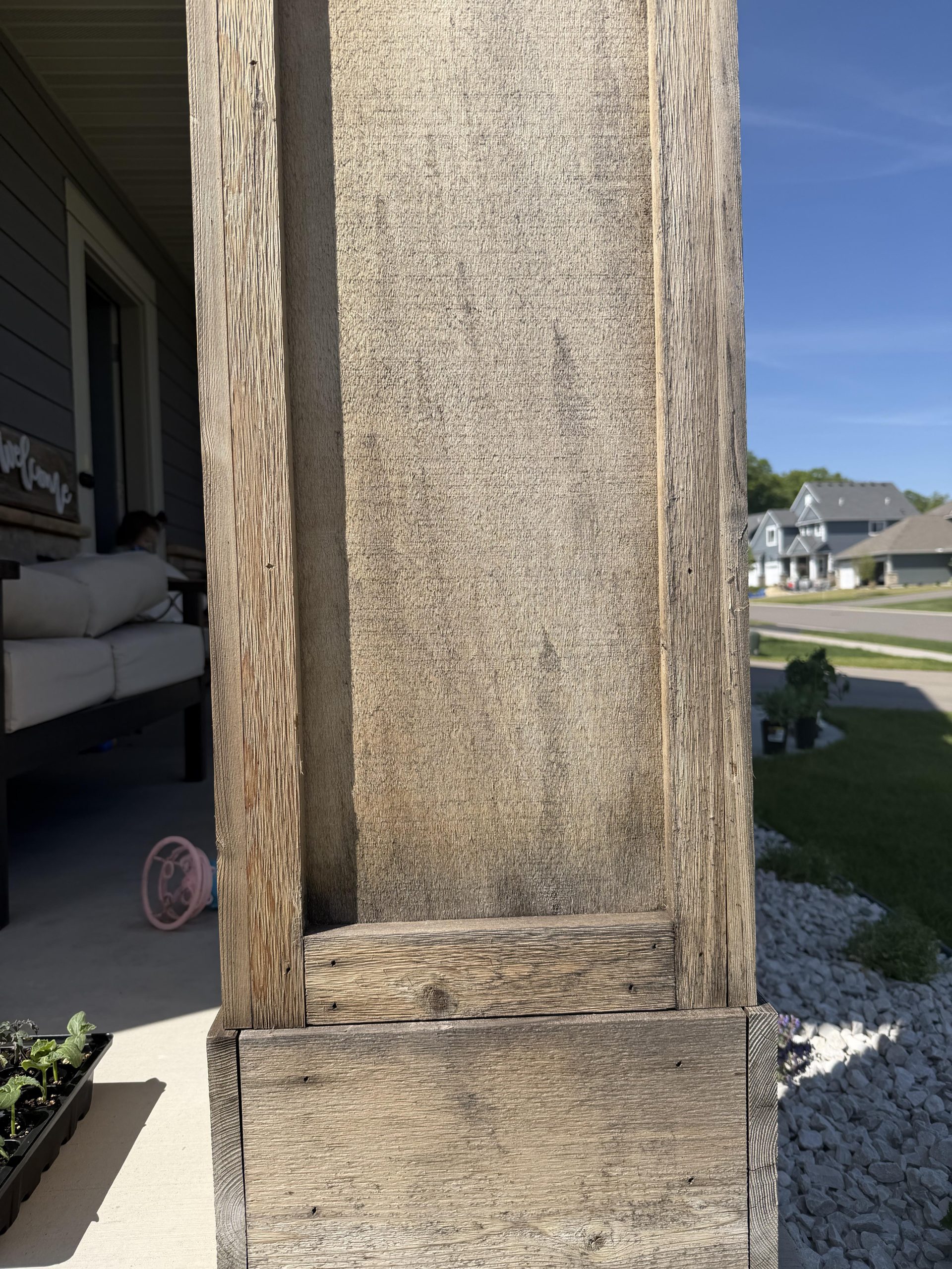

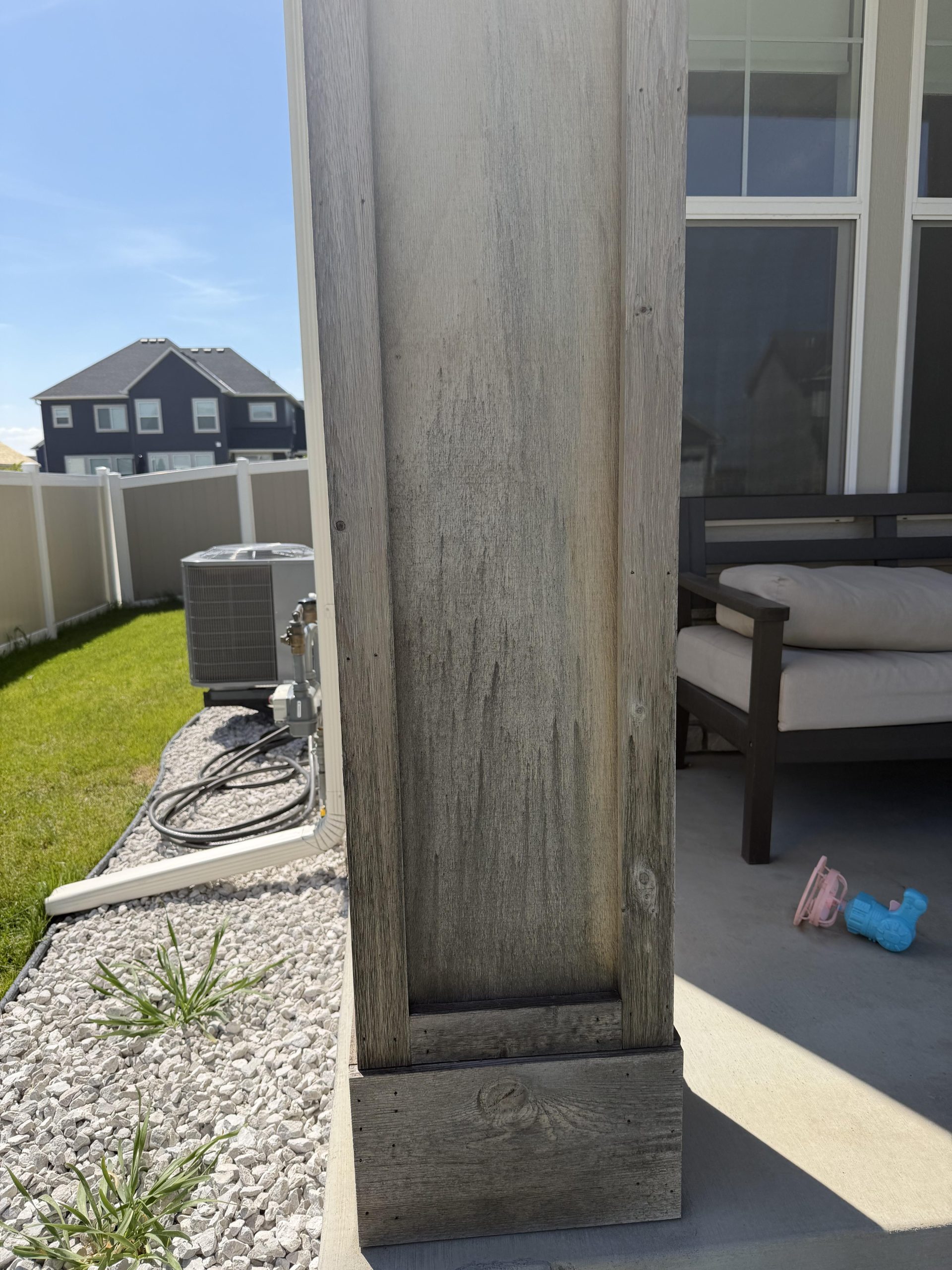

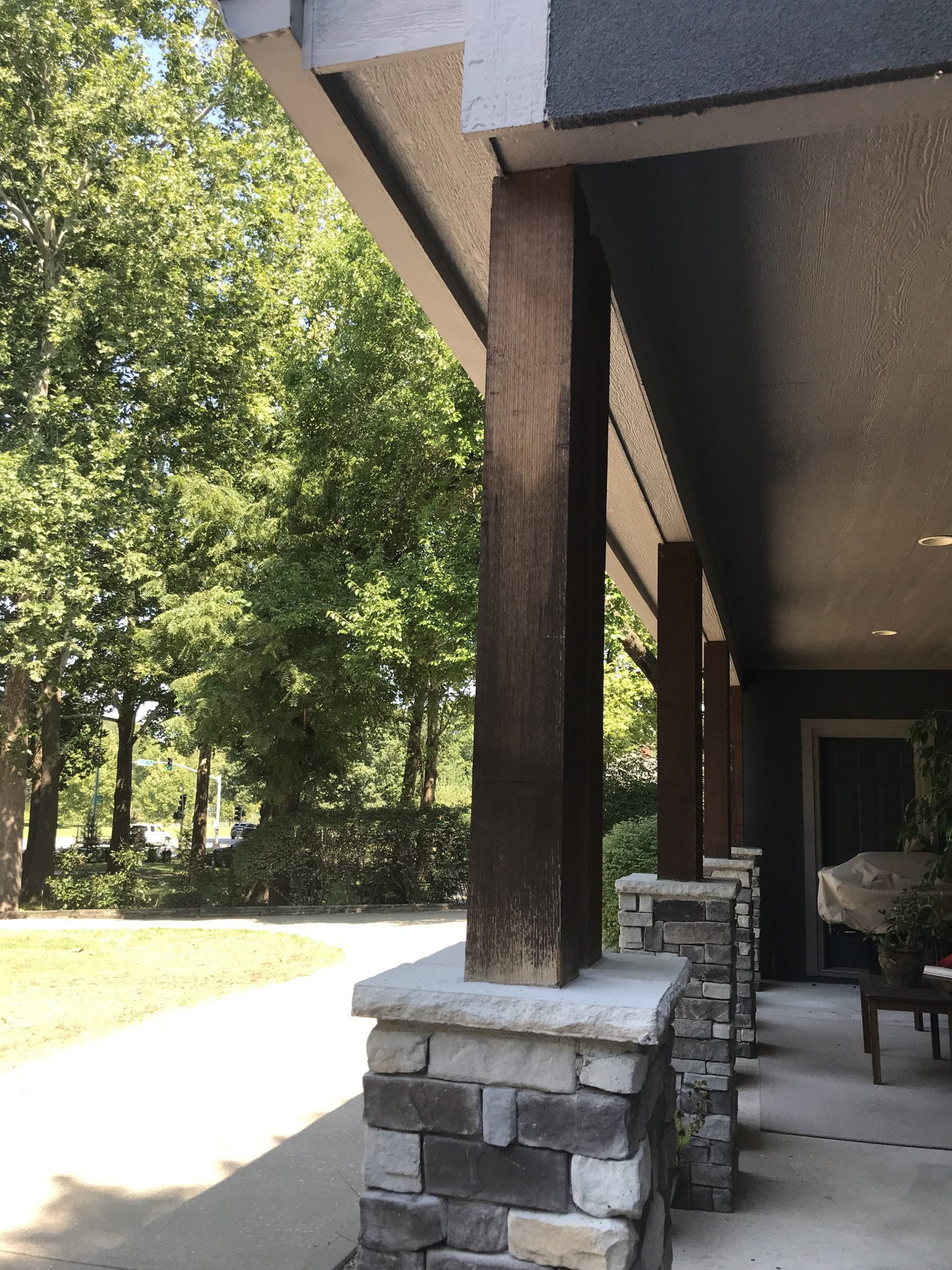

What kind of brush would you recommend when cleaning rough sawn cedar exterior pillars? I just ordered some restore a deck cleaner and brightener and do not want to risk damaging the pillars by using the wrong type of brush. Thanks!
Much easier and more efficient to lightly pressure wash then scrub.
If you scrub, use this. https://www.deckstainhelp.com/product/restore-a-deck-staining-brush/

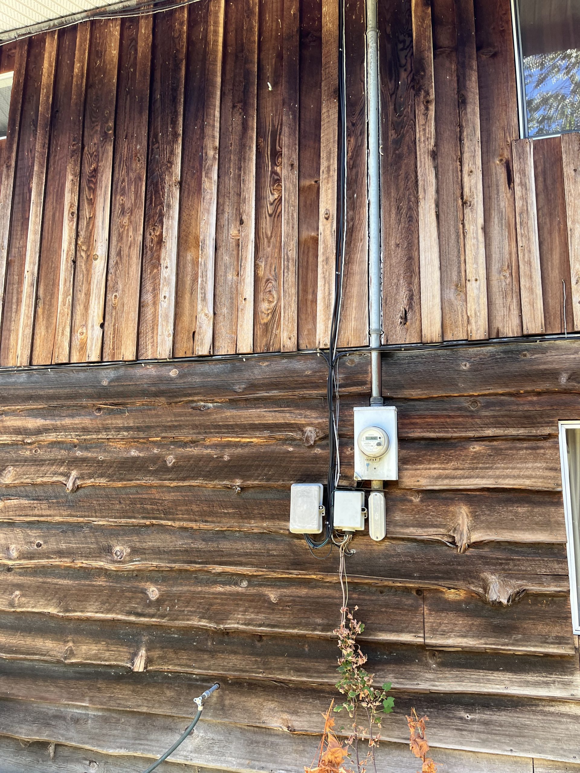

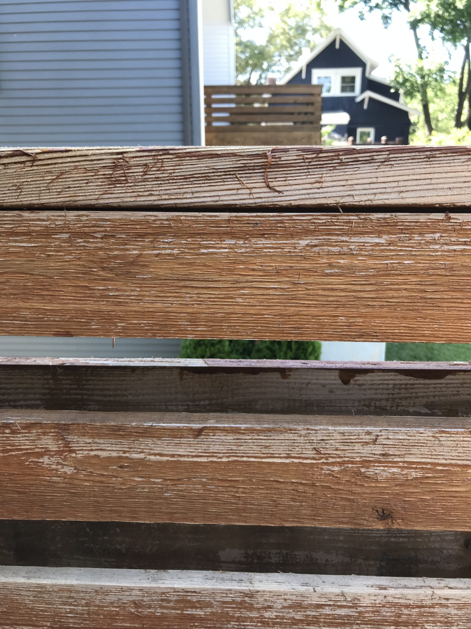

Thank you! So power washing is okay with rough sawn cedar? I’ve attached some photos. Some sections are in pretty rough shape so I don’t want to damage them.
Yes. You use it as a rinsing tool after applying the cleaner. Wash about 8-12 inches away from the wood with the fan tip.

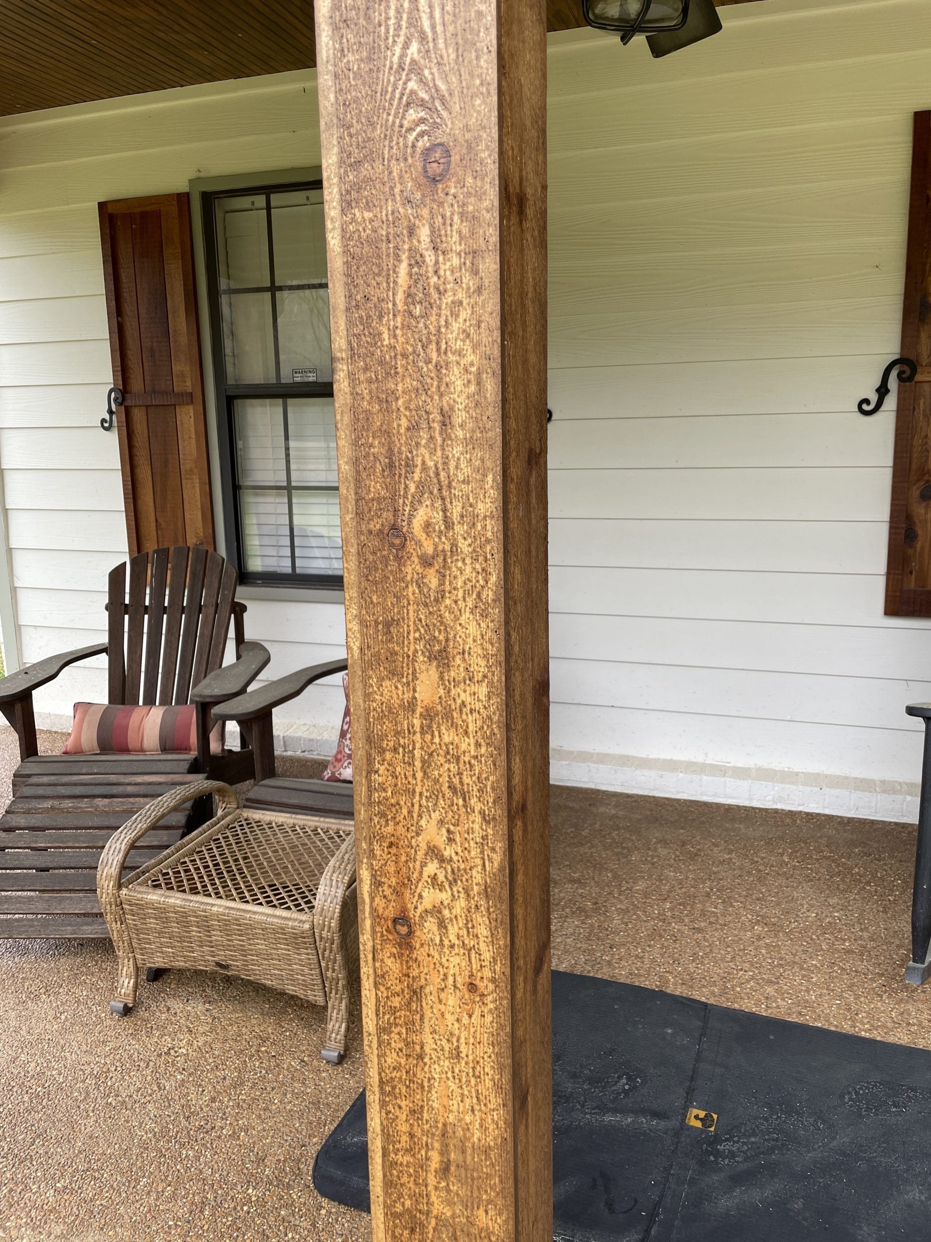

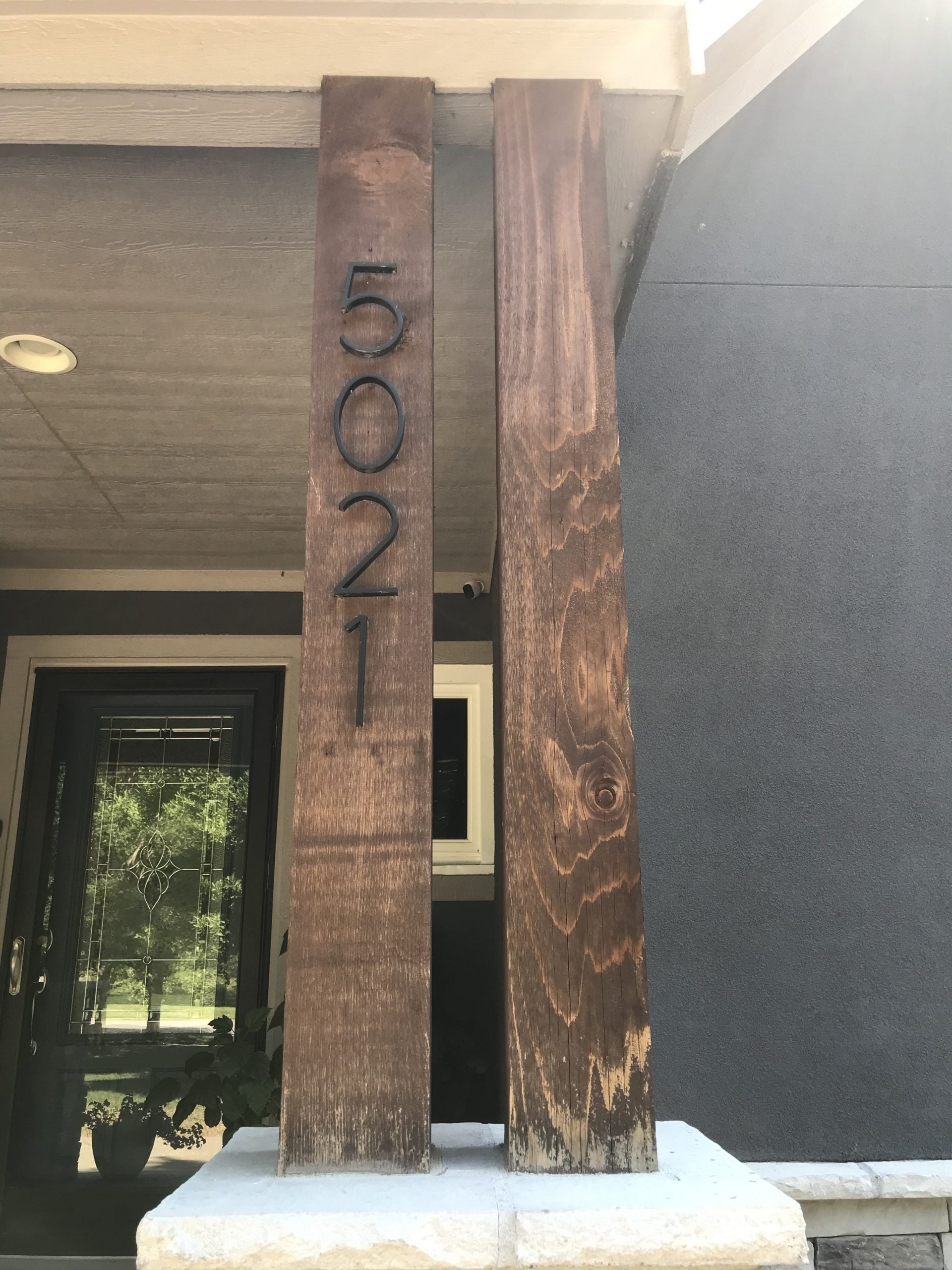

We have rough cut columns and rough cut wood on the ceiling of our porch…..I have used minwax natural penetrating oil stain on them but it just looks like such a flat finish….is there anything I can use to add some kind of sheen without it flaking off…..I pressure wash every year or so to keep the wood protected but I want a little sheen to it…. Is there something out there I can use without flaking? Thanks so much.
Minwax does not work for exterior wood, and you cannot add a shiny coating to exterior wood, as that leads to peeling.
What would you suggest using on them?
Any penetrating exterior wood stain. You will need to remove the minwax first.

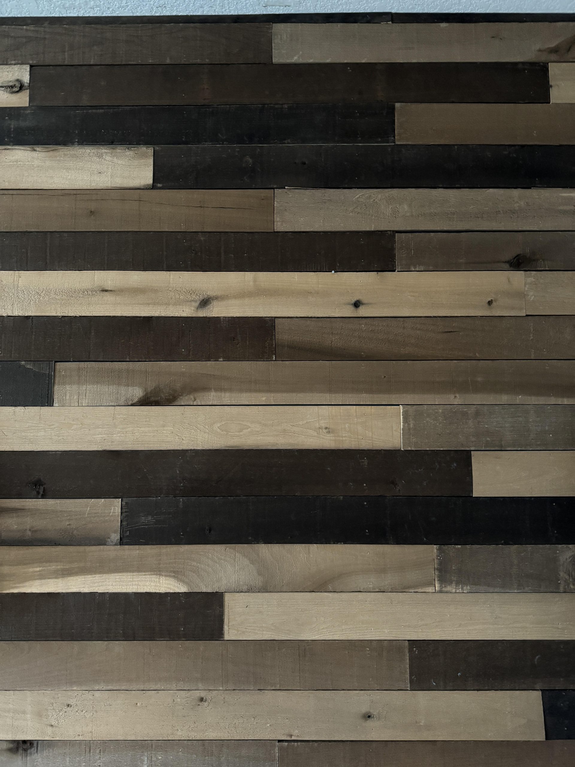

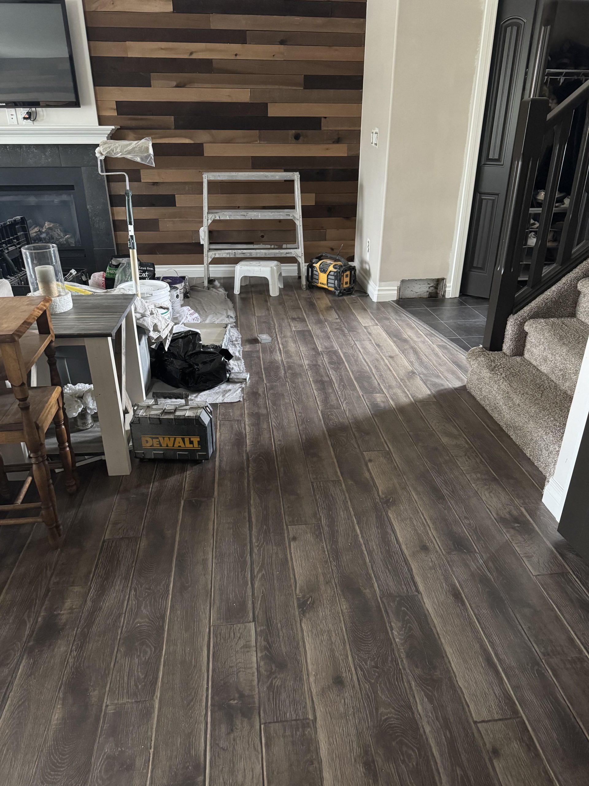

So glad I came across your page. I had a question about some wood accent walls we did in our house a few years back. We ended up going with this because it was cost effective. I want to know if it’s possible to stain this wood or use a wood conditioner to alter the color to more of a cooler undertone ? It looks different in natural lighting . Any tips would be appreciated! Thanks .
Sorry, our products and advice are for the exterior only. We do not know of anything that will work for this interior wall.

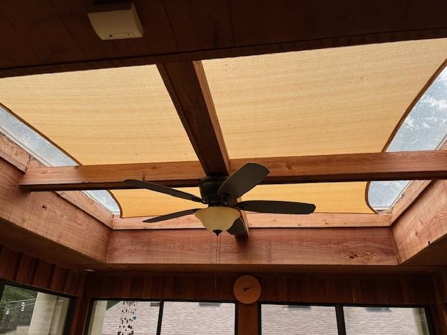

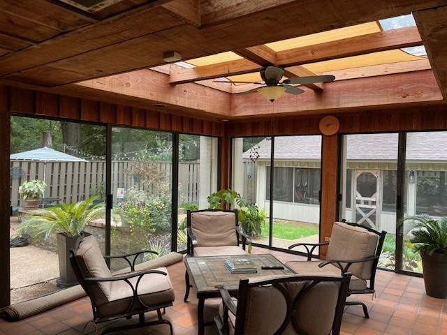

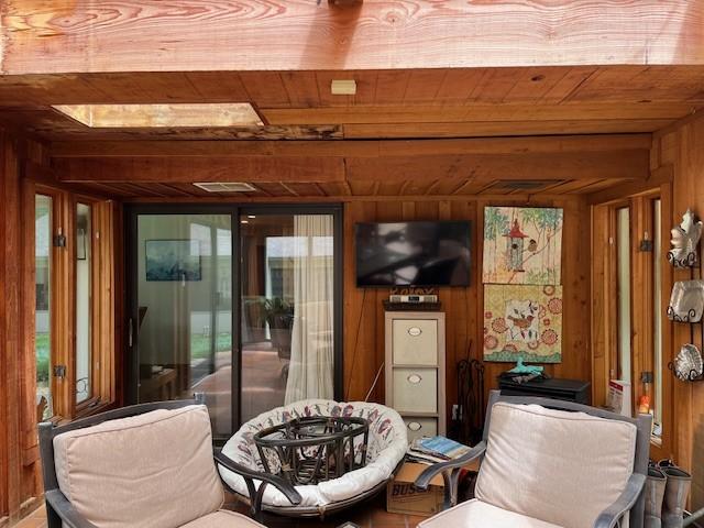

Hello Scott,
I live in a mid-century modern style home that had a sunroom added to it many years ago. The sunroom is 13 ft x 18 ft.
The walls and ceiling are rough sawn cedar with a red tinted stain on the wood. The room is mostly sliding glass doors on 3.5 of the 4 walls and it has a big clear hard plastic bubble in the center of the ceiling.
Many years of sun have faded the stain unevenly over the years. It’s time for a refresh of the entire room but I don’t want to keep the RED stain.
I’d like to change the look and feel of the sunroom to a light to medium taupe color but still keeping the rough sawn look and feel of the wood along with the transparency of the stain.
How do I prep/clean the surfaces?
95% of the surfaces are vertical and it’s on a conventional foundation attached to our main house with a tile floor so I’d prefer not to use a power washer.
How do I get the stain results I want with the current state the surfaces are in?
The only way I know to prep this (correctly) is to pressure wash with a stripper and then brighten, which is not feasible in your scenario. Too much water and potential damage. You cannot sand rough-sawn and not sure if applying over the current stain will achieve proper adhesion and results. The latter may be your only option and hope it works. Maybe test spot? BTW, exterior semi-transparent wood stains do not come in taupe colors. You would need a custom mix, and it will become more of a solid stain.
One more question…
What is the best method to apply the stain to this room’s walls and ceiling?
Thank you for the response!
Exterior stain pads or brushes. Tarp well, as it will drip.

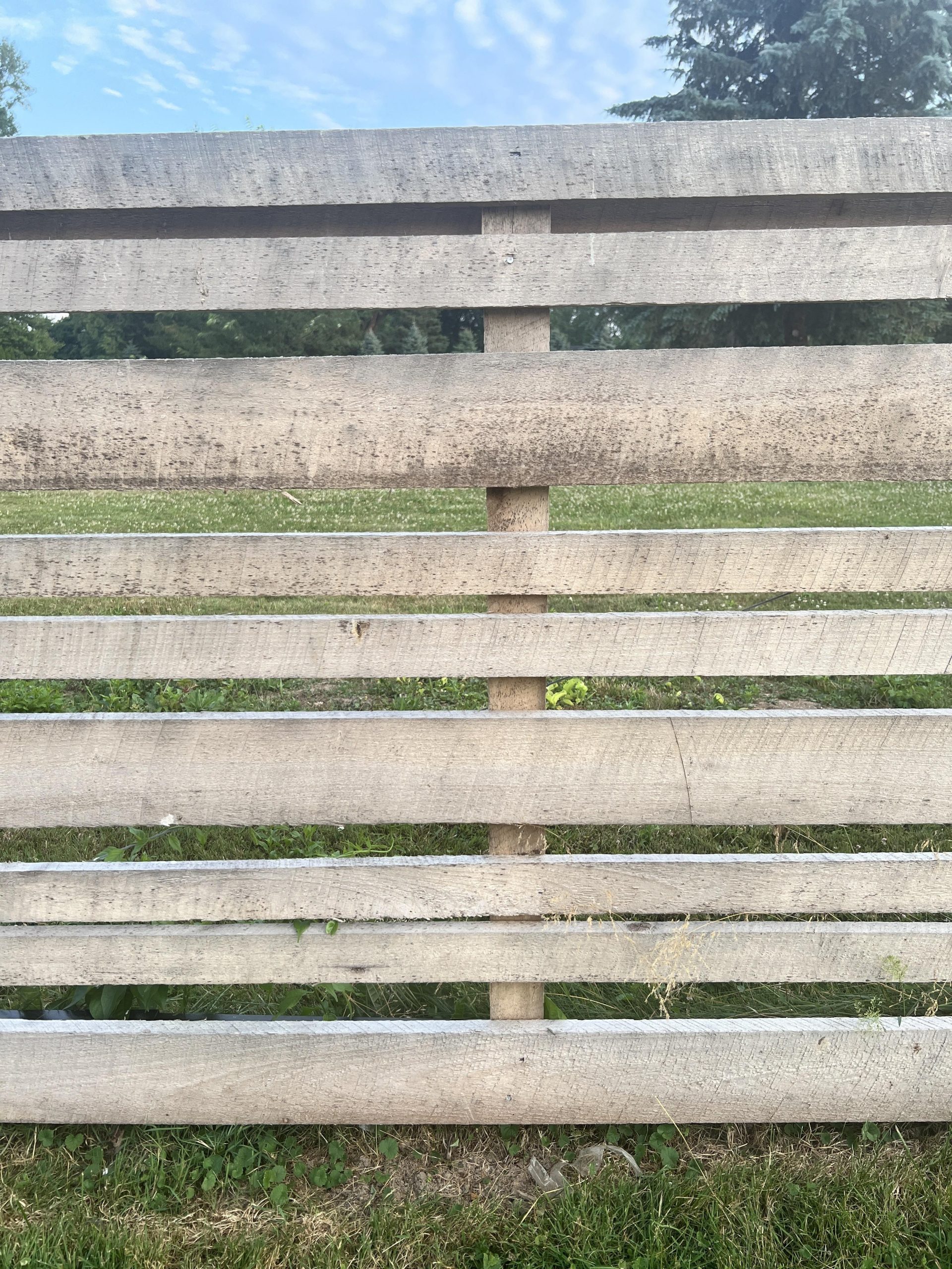

Hi! I built a fence last fall with new rough cut poplar wood. I am now ready to stain/seal after letting it dry over the past 6-8 months. I read your advice above but wonder what type of prep I need to do. Is my wood considered ‘new’ or ‘weathered’? I had planned to do either a semi-transparent stain or just a clear sealer. I have been looking at SW Super Deck product but concerned about all the comments about peeling. I plan to apply with an airless sprayer. What product do you recommend? Thanks!
Clean and brighten for prep. Use Restore A Deck Stain or Armstrong Clark stain.

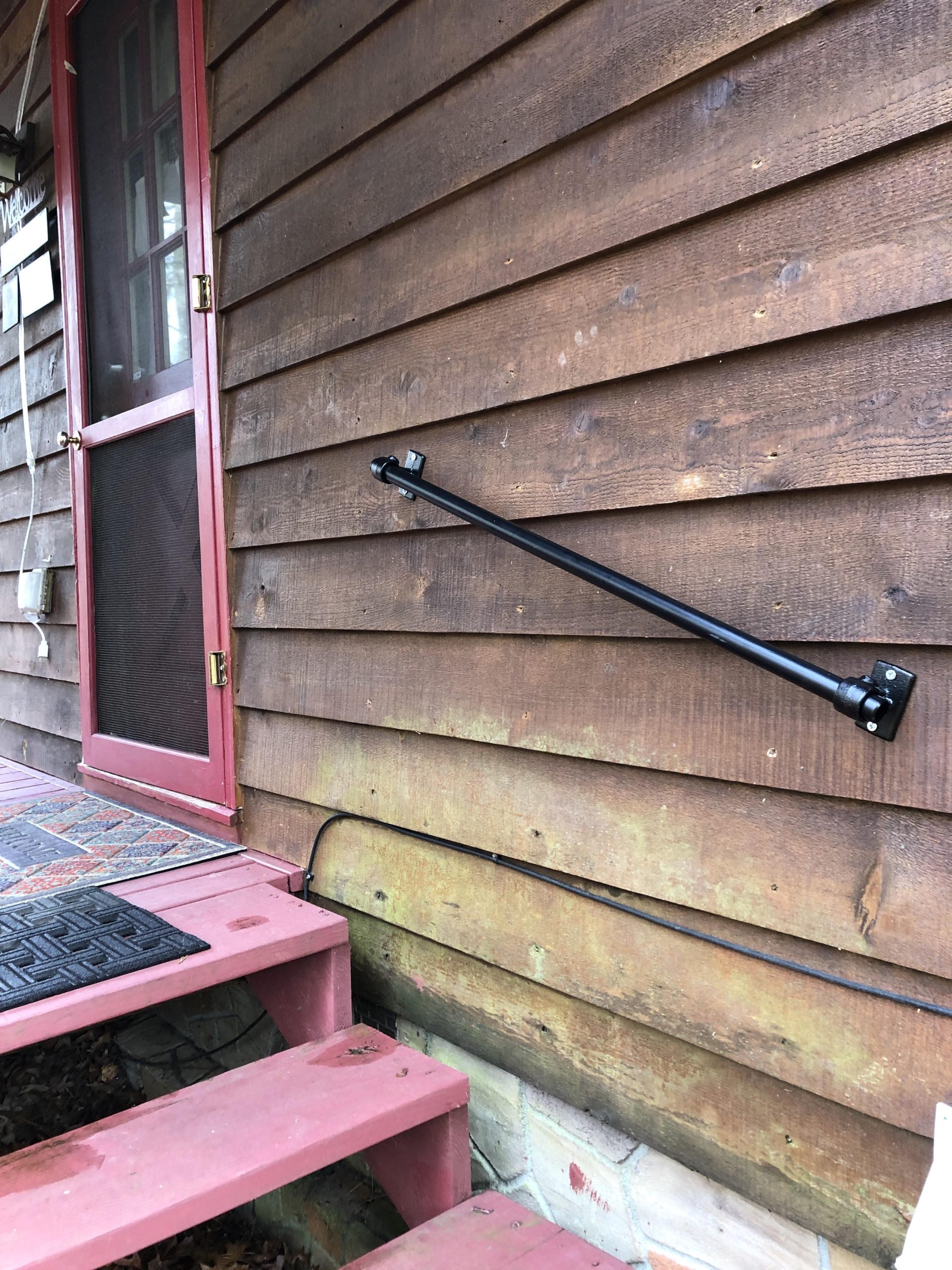

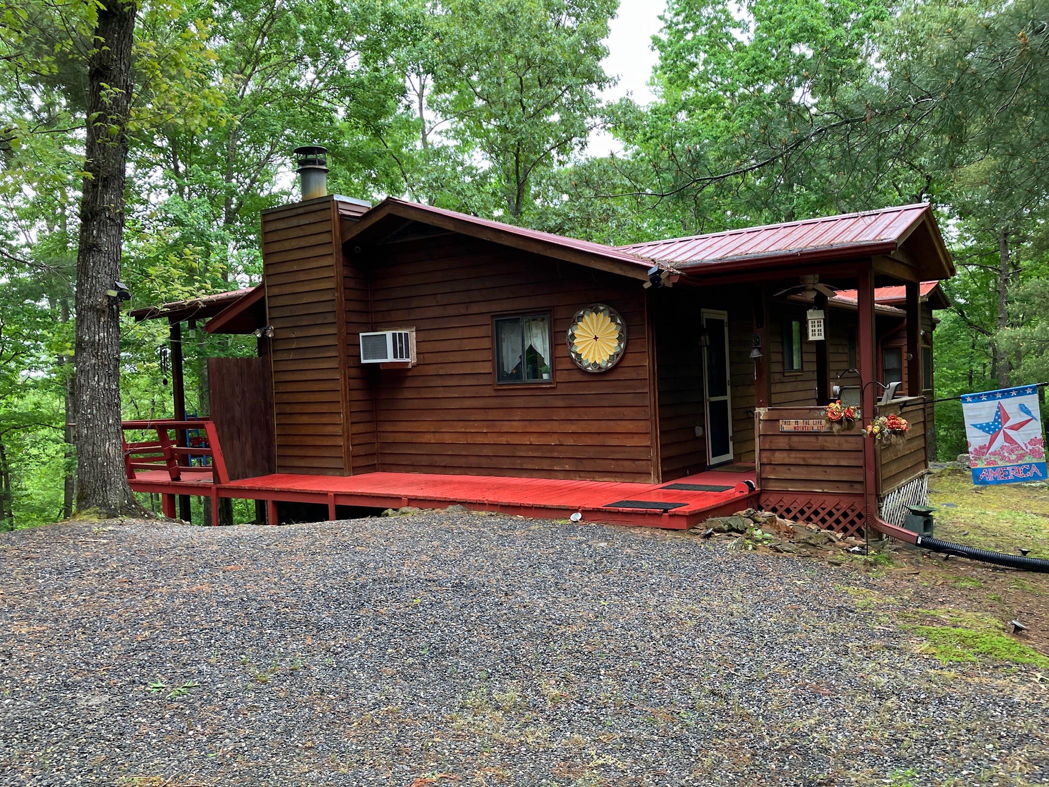

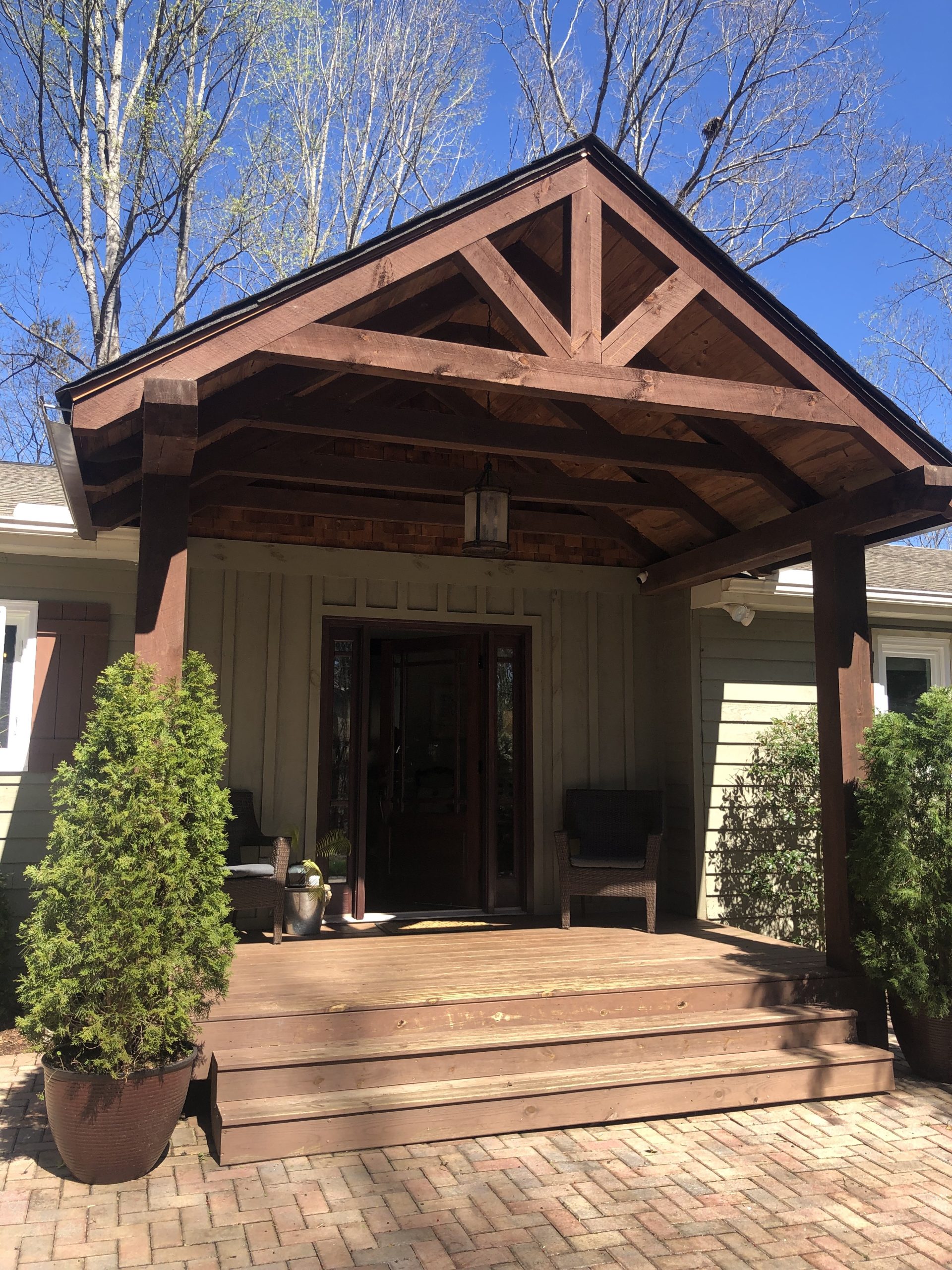

We purchased a 40yr old rough cedar sided home near Blue Ridge GA. Previous owner didn’t do anything in the 6 years they lived there other than apply clear sealer but they’re unsure what was used. It’s got some lighter spots and areas where nails can be seen but overall just needs a refresh. No mildew visible, only dirt and pollen. Do we pressure clean or soft wash? Then approximately how long until we can reseal? What products do you suggest? We prefer the transparent/semi look vs solid. We have paint sprayers, do you suggest we use them or to hand brush? Thank you for your guidance.
Post pics in the comments for prep help.
Thank you. Sorry, I thought I had.
You have a semi-transparent stain on the wood, not a clear one. If you do not know what was used prior, you will need to remove it and start over with a new brand of stain. Post a close-up of the wood so we can offer tips on how to remove it.
Thank you. The last owners said they applied a protective clear, that’s all we know, but we don’t know what kind or brand. These are 2 different sides of the house, before and after pressure washing.
It’s still rough, so apparently it hasn’t been sanded previously and we like that. We’d like to protect it and keep with the transparent stained look. Any help/steps are appreciated.
Use the Restore A Deck Stain Stripper with Booster and the Gel additives. Apply, wait about 20 minutes, and pressure wash off. Do it in sections and repeat until done. Brighten all after. As for the stain, use one of these brands:
Thank you, we appreciate your expert advice. Sounds perfect for our job.
Just curious, how is it obvious that there’s no clear on it currently? It looks shiny in some areas, like the back wall under the rear covered porch that doesn’t get direct sunlight. The prior owner is a widow and unsure what her husband used but thought it was a clear coat. Thank you for educating us for this job and future maintenance.
It is clearly a tinted (brownish cedar color) stain, and you cannot apply a clear coat over a wood stain, it would peel.

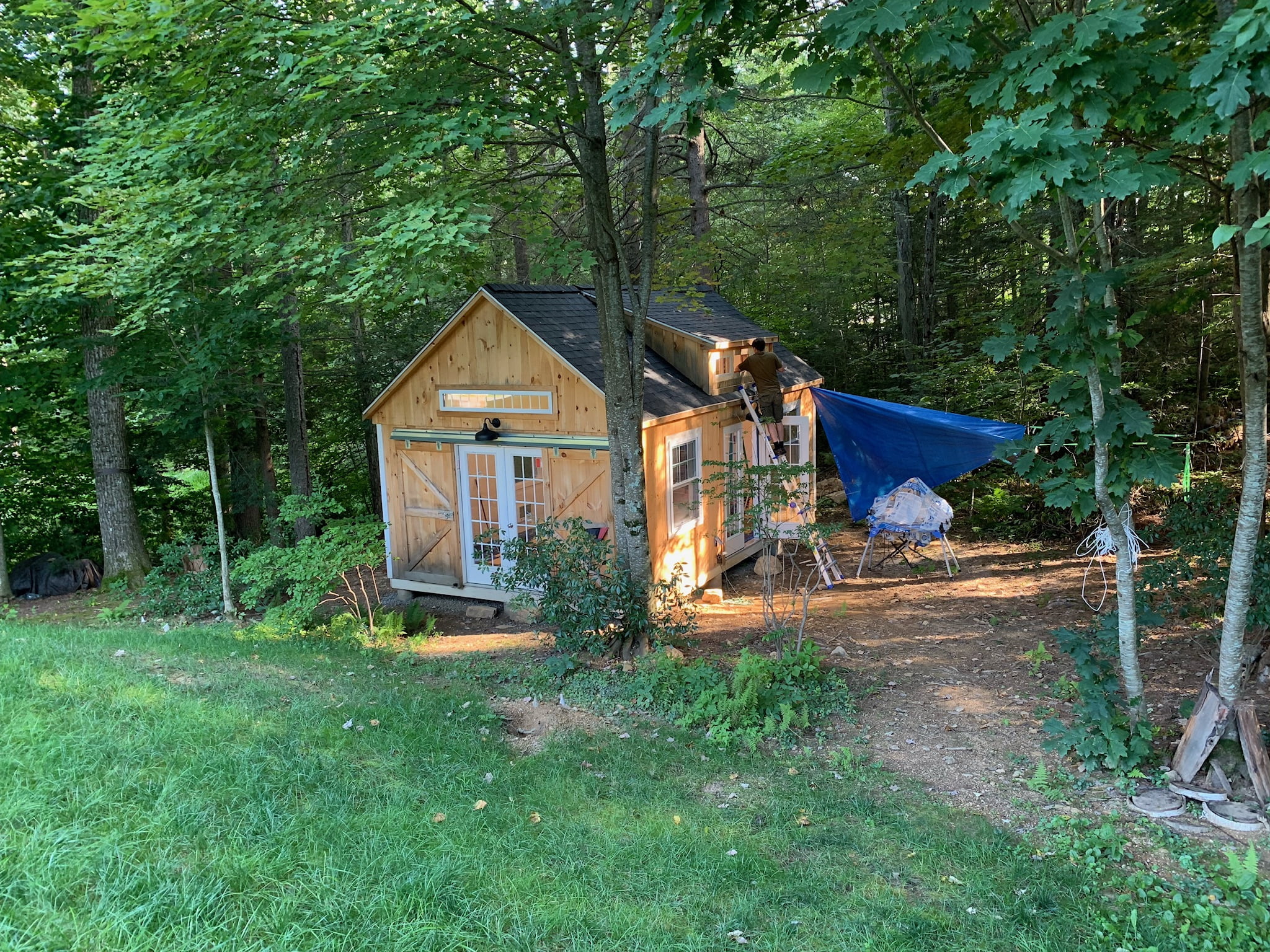

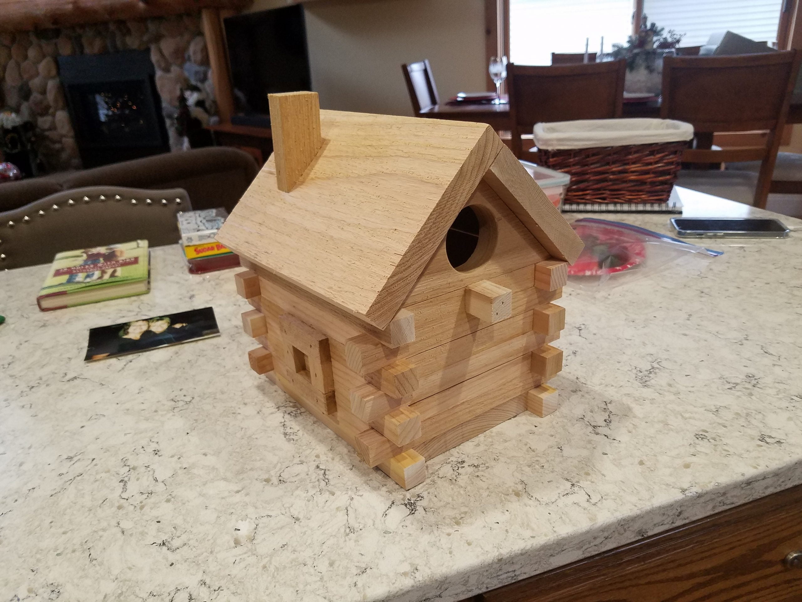

Just finished building an outdoor shed using rough cut pine that was cut and milled on our property. Would like to preserve the rustic new wood look, but not sure what kind of stain to use. Natural probably, but water or oil based?. Something mildew resistant is a must. It is very woodsy and damp here in the Adirondack Mountains of New York with long winters.
Use Restore-A-Deck Semi-transparent stain in Natural color. It will work better for mildew and mold prevention.

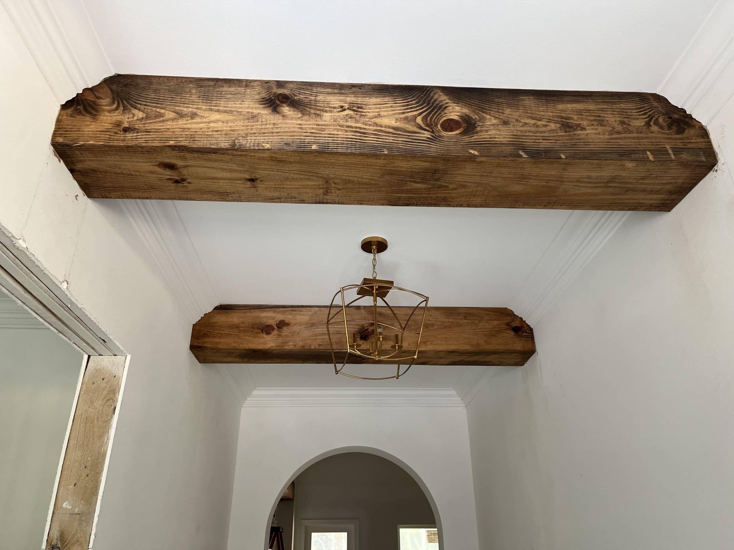

What stain did you use to get the “dark oak on rough cut lumber” picture above? Thanks!
It was TWP in 100 or 1500 Series.

We have the typical red cabin with green roof and trim. Even the Anderson window trim is green. I’m tired of this look.
can the red be stained a different color without sanding the entire cabin? It is rough sawed siding with knots.
We would need to see some pics to answer this properly.

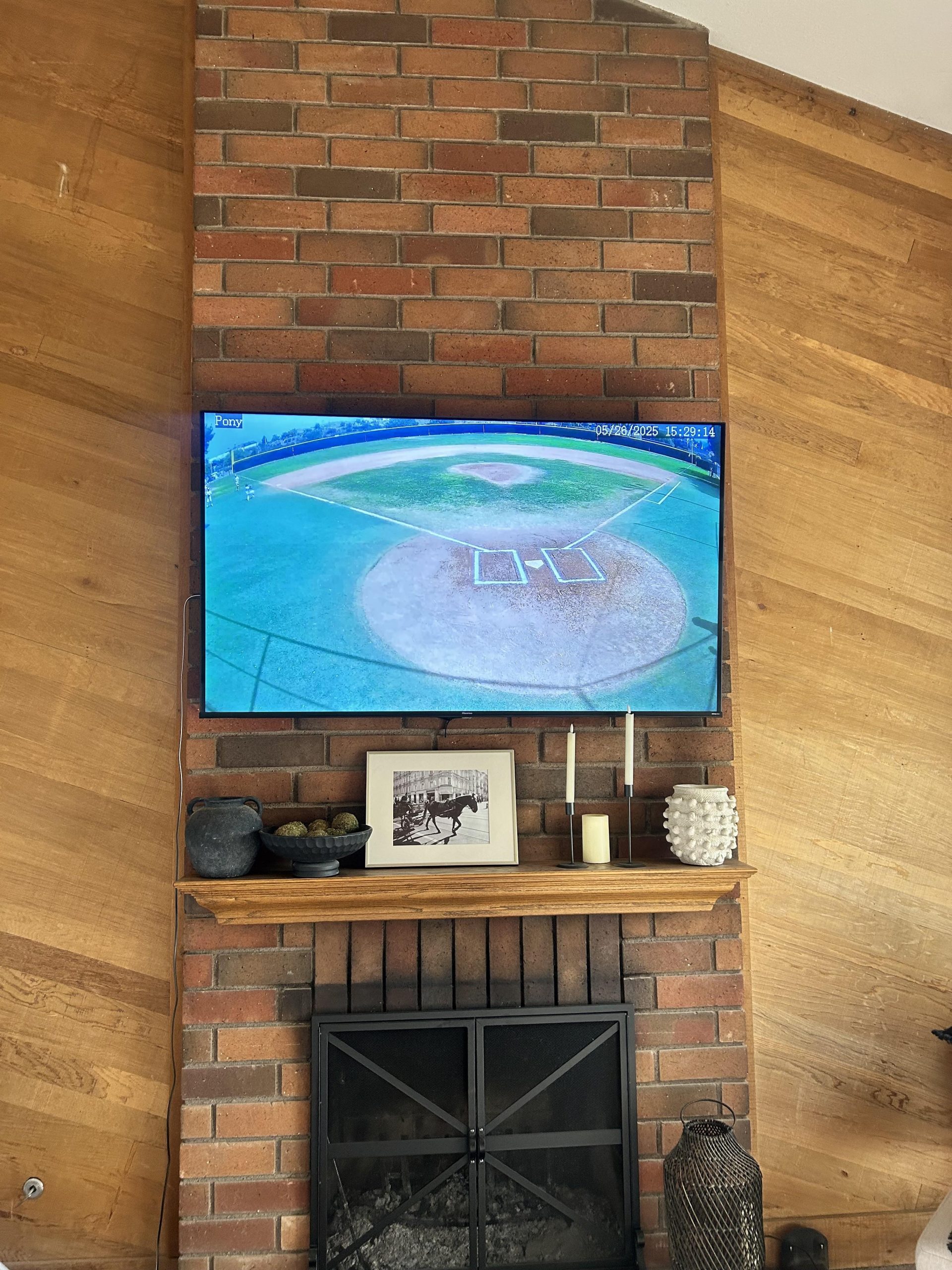

I have rough sawn pine mantle and fireplace sides. We put Minwax semi-transparent oil based stain on. It’s been 4 days and there are still spots that look damp/tacky. We had fans on it trying to get it to dry, but still the same issue. Is there any way to speed up the process?
Sorry but no idea. We only work with exterior stains. Minwax is interior use only.

I just had a 4 season room installed on the. Ack of my house. They wrapped the beam with rough sawn cedar. Do I need to seal it or can I just leave it? Being it won’t be in weather will it turn gray or black over time?
Can you upload a picture of it?
We bought a house with cedar siding on parts of the exterior… we don’t know what kind of stain, seal or conditioner has been applied. We just finished using a cleaner and pressure washing it, which removed a lot of dirt. It looks dry and old still, what can we do to freshen it up and give it a healthier look?
Post some pics.

Help! Part of our home is rough sawn cedar which was painted with a semi transparent acrylic stain by previous owner (our best guess – we do not have the can). A contractor power washed it to remove the stain with limited success. About 50% of the stain is gone; some of the remaining stain is peeling in thin ribbons. My husband says if you sand the rough sawn cedar it will destroy its character. However, he would like to coat this with a semi transparent Oil base stain for easier maintenance going forward. Everything we’ve read said you have to completely remove the old stain first. How can we successfully remove the old stain before coating the rough sawn cedar with a semi transparent oil base stain?
Post pictures.
Here’s a photo
Try the RAD Striper with both additives: https://www.deckstainhelp.com/restore-a-deck-stain-stripper-booster-thickening-gel-review/
Apply stripper and wet for an hour making sure it does not dry out by misting if needed. Pressure wash off. Repeat if needed. Brighten all when done.

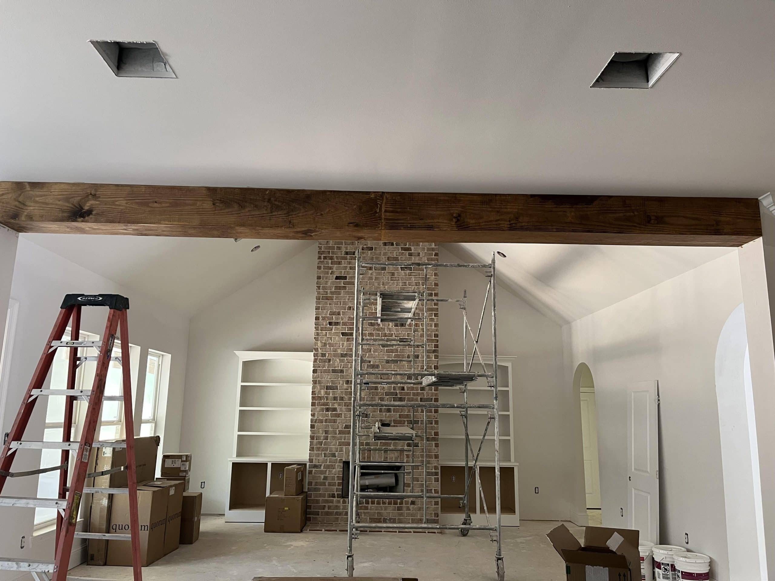

We purchased rough sawn pine boards from our local saw mill to make faux beams for the interior of our home. The pine is a Florida pine. We have played around with stains, even mixing them, but the boards absorb and they become way too dark or going light they look Orange. Is there a way we can get a medium brown tone?
Try a stain that is medium to dark brown.

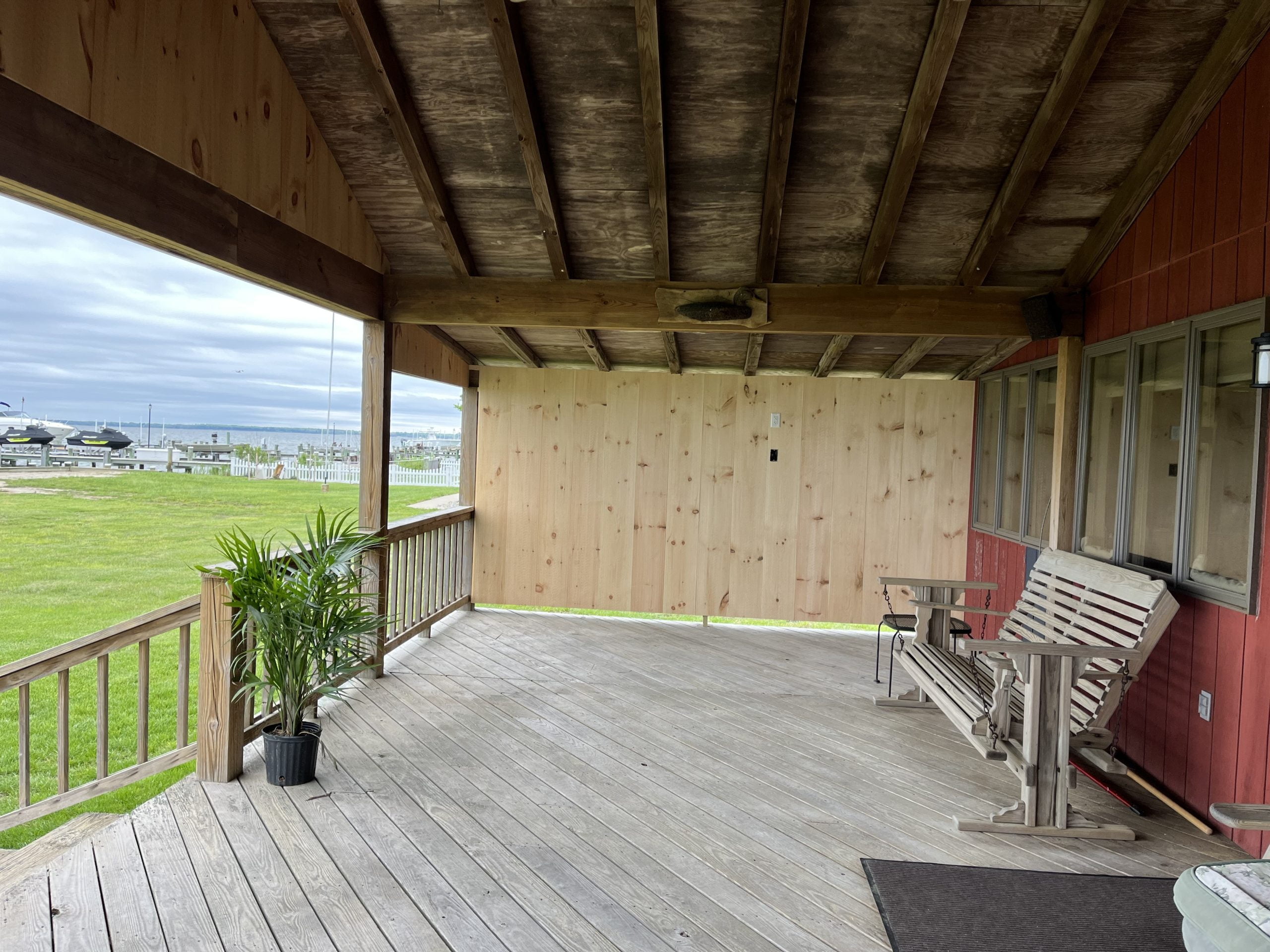

Our contractor installed rough sawn north white pine barn panels on our opened covered deck. We are on the water so it will be exposed to salt water spray. What should I use to seal and protect the natural color? Thanks!
Try TWP Stains or Restore a Deck Stains.

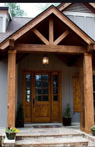

I’m curious to what color stain was used in the attached picture from your website?
We have had such a hard time finding a stain color we like. Everything we think we like ends up being too dark.

Looks like a basic cedartone color on rough sawn cedar. Colors will vary from wood species so it may not look the same on your wood.

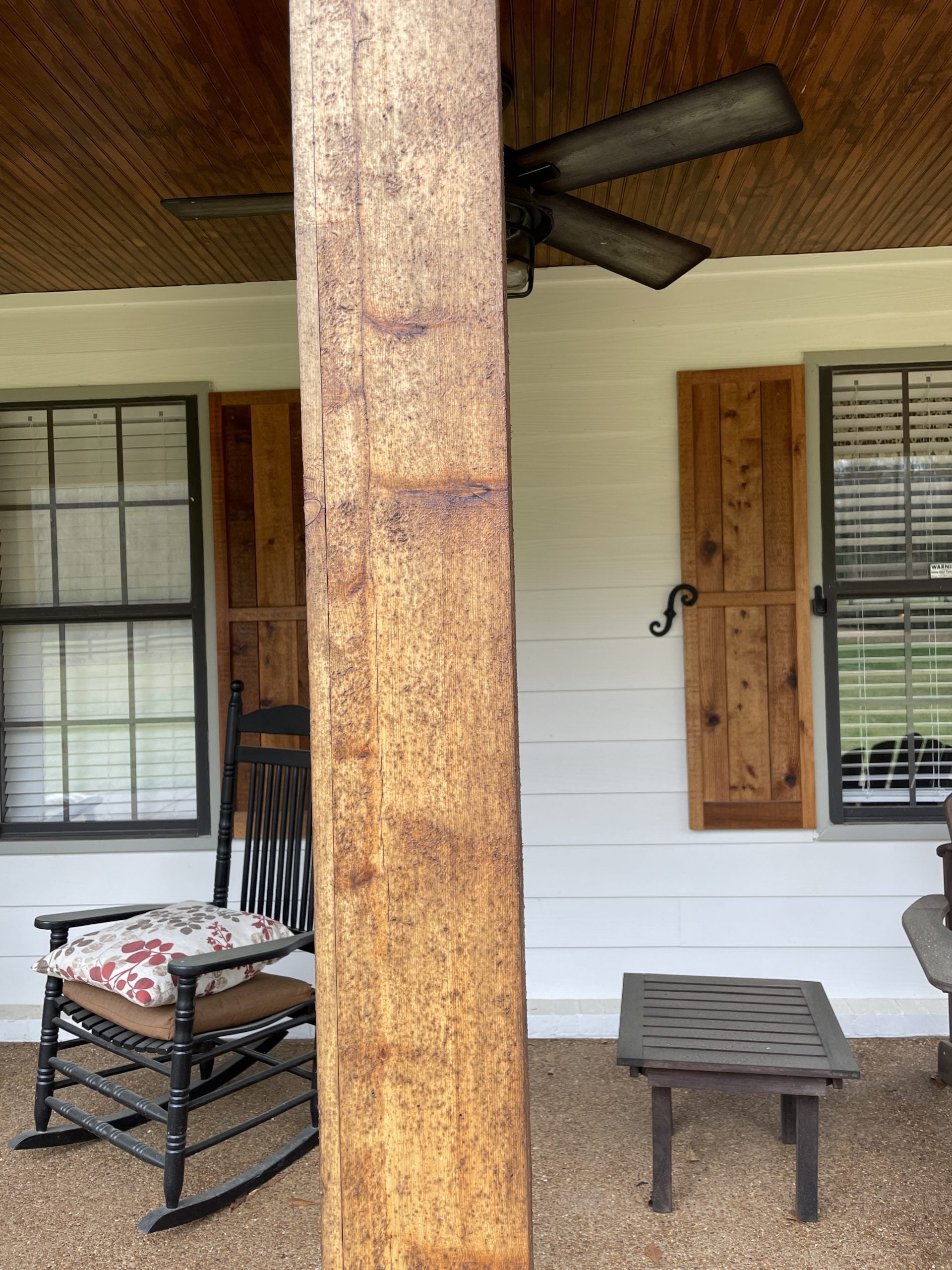

We just installed cypress post on the front of our house. Before we could stain them they started mildewing. Do I need to do something before I stain?
You should weather, prep, and then stain:

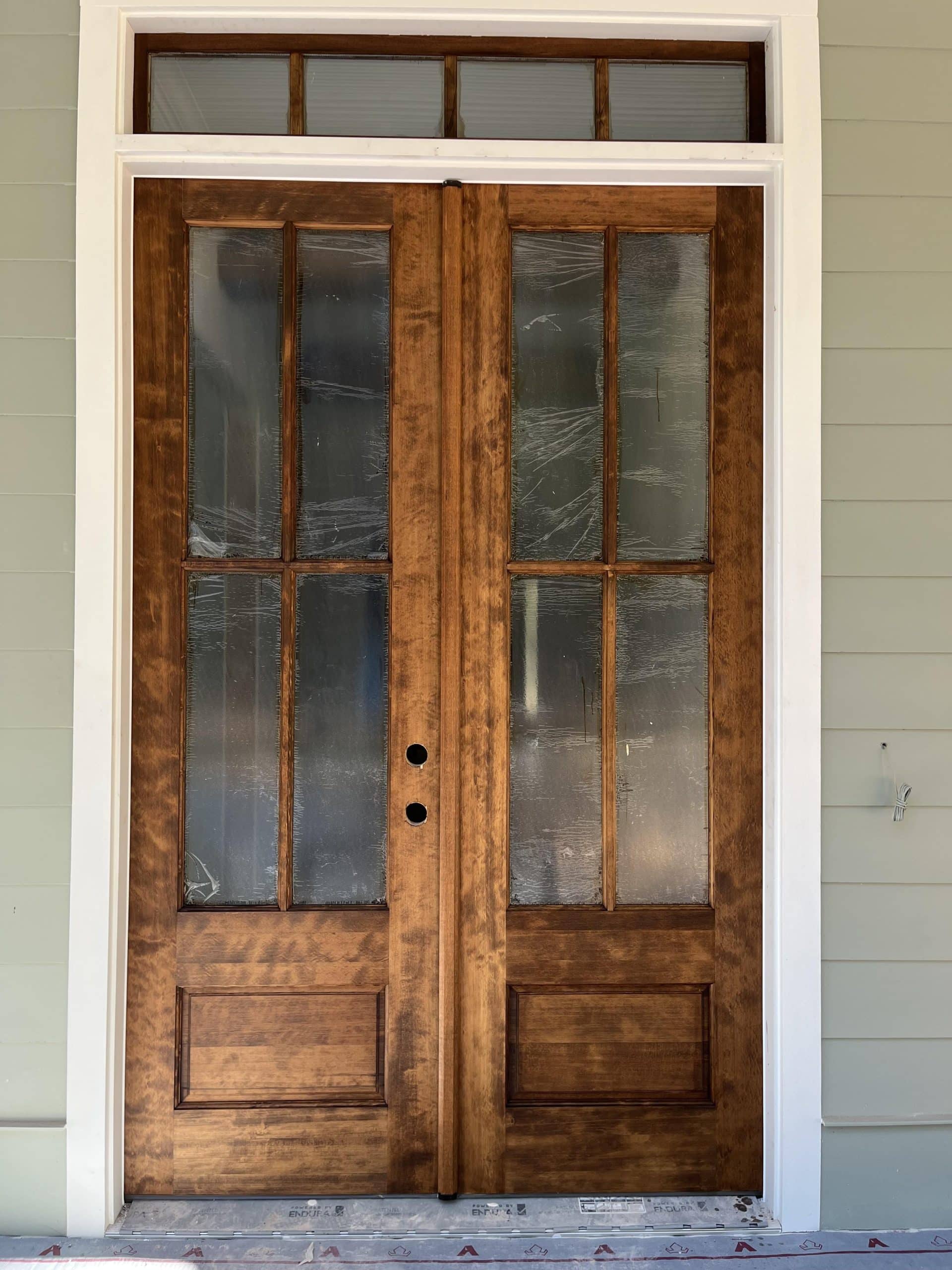

How about using same product (TWP dark oak) on an entry door? FIR species.
Would it need to be too coated with a polyurethane or some other product?
TWP should not be used for entry doors and you cannot top coat it with a poly or any other sealer.
What brand again is shown as dark oak ? 3rd from top
TWP Stains.

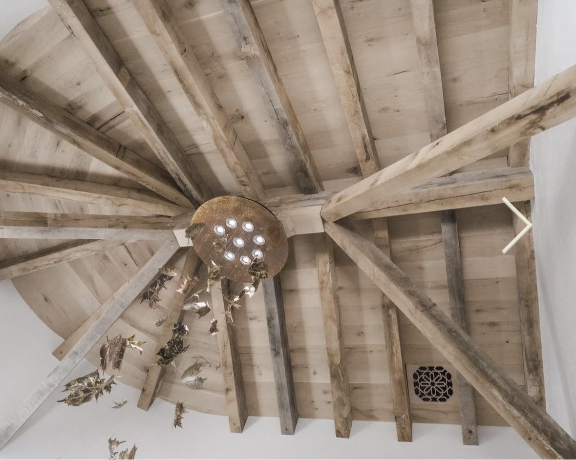

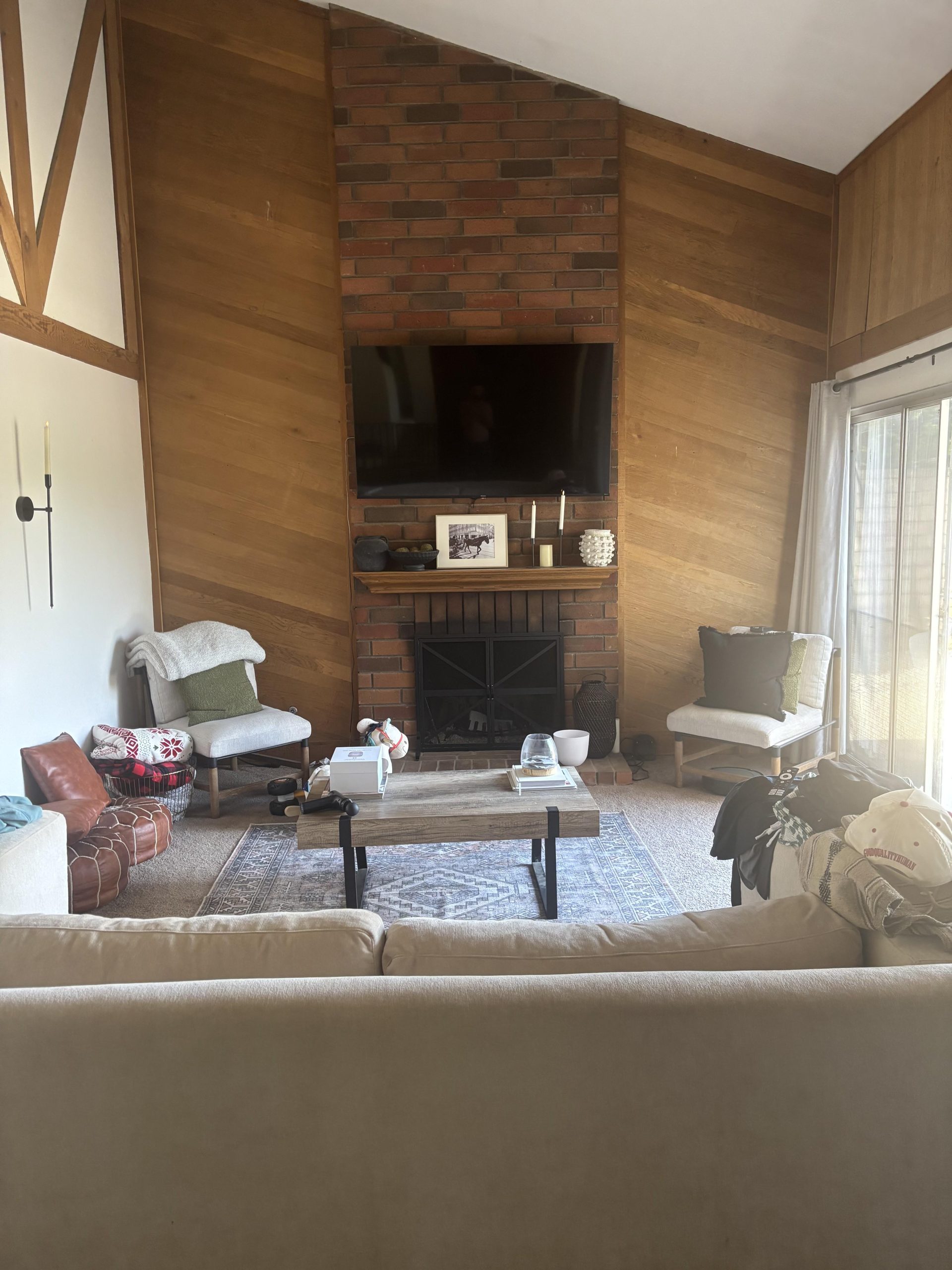

Hey, I have a question! We have rough beams in a vaulted ceiling of the great room in our house. They are painted white. We’d love to stain them a dark walnut color to match the fireplace. Everyone tells me this “will be a lot of work” because the white painted beams need to be sanded down first. Is there an easier way? Is there a faux stain – paint that we could put on top of the white painted beams?
No other way besides power sanding and that will be hard and messy.
Ok any product you like most for painting over white beams to give it a more natural walnut type finish? I keep seeing gel stains…
Sorry but no idea.

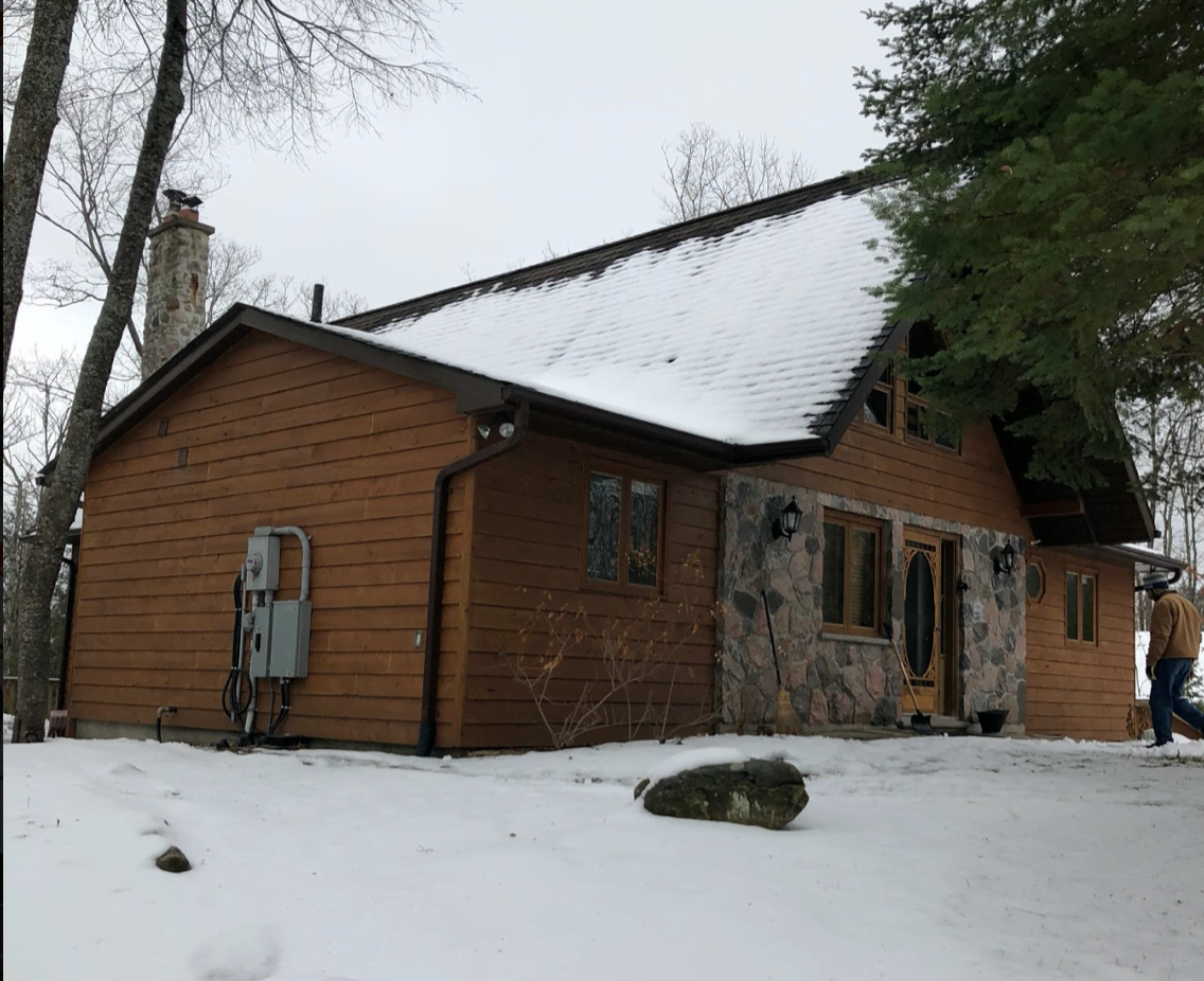

We have a cabin in northern Michigan that was sided with rough-sawn live edge spruce about 15 years ago. While it has slowly turned several shades of gray, I’d like to stain it a semi-transparent or semi-solid tan color. Would this even be possible considering 15 years of weathering, and if so, would we have to powerwash it first? What other intermediate steps would we need to do? What brand of stain would work best?
Yes, it is possible. Use the Restore A Deck Cleaner/Brightener kit while pressure washing and then the TWP Semi-Solid stain. It will look great! Post some pictures when done!

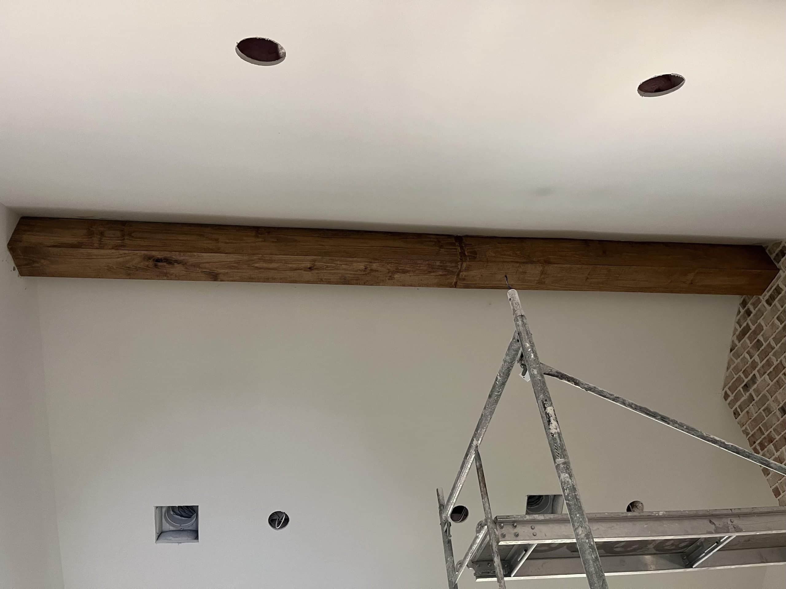

I have rough sawn ceiling being installed and would like a brown color such as the brown on the far left in the ad above how can I achieve this look ?
That is a Light Walnut color. It is brown with a hint of red. Might want to try some samples from Armstrong Clark Stains or Restore A Deck stains.

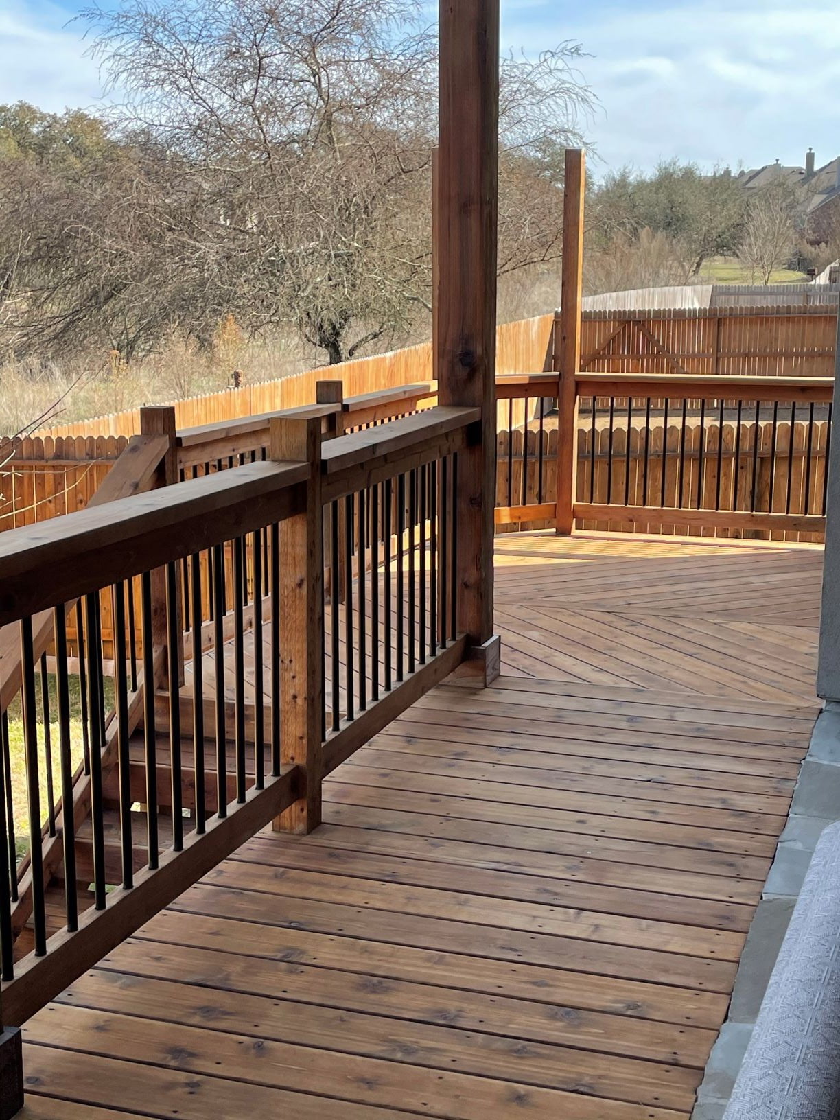

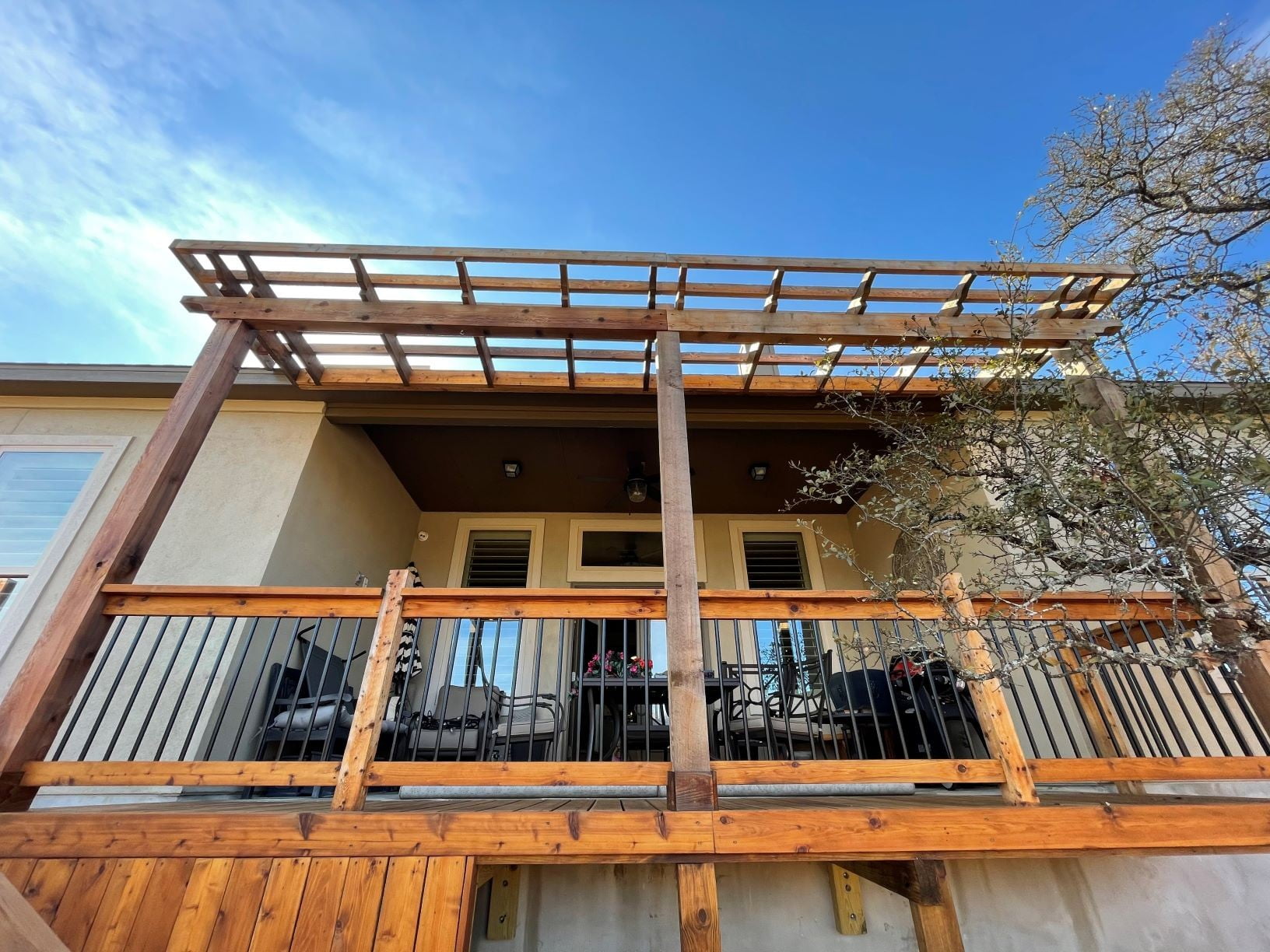

I had my newish deck and arbor stained a few days ago by a local professional company and the arbor looks really bad to me. Can you tell me what you think they did wrong? The deck is all smooth cedar, but the arbor is rough cedar. Before they stained, they cleaned and sanded the entire deck, but not the arbor, at all. However, it appears to me maybe they didn’t use enough stain for the arbor. I provided the stain to the company and it was the Armstrong Clark, in which we mixed Natural Oak and Natural Tone.
The deck flooring looks pretty good, even though they didn’t properly stain the edges of boards, but I do notice a little stain comes off on my socks when I walk on it. It’s only been a few days though since they stained, but I hope that goes away soon. It’s not tacky though. Do you think I should have them go back and stain the edges of the boards? Is it important that they do so?
Please let me know what you think.
Add another coat to the arbor. No need to stain edges of the boards.
What would you recommend for cleaning then maintaining cedar posts? They get lots of sun. South facing with full sun from noon until the sun goes down.
Try the Restore A Deck Prep kits and thier semi-transparent stain: https://www.deckstainhelp.com/restore-a-deck-wood-stain-review/

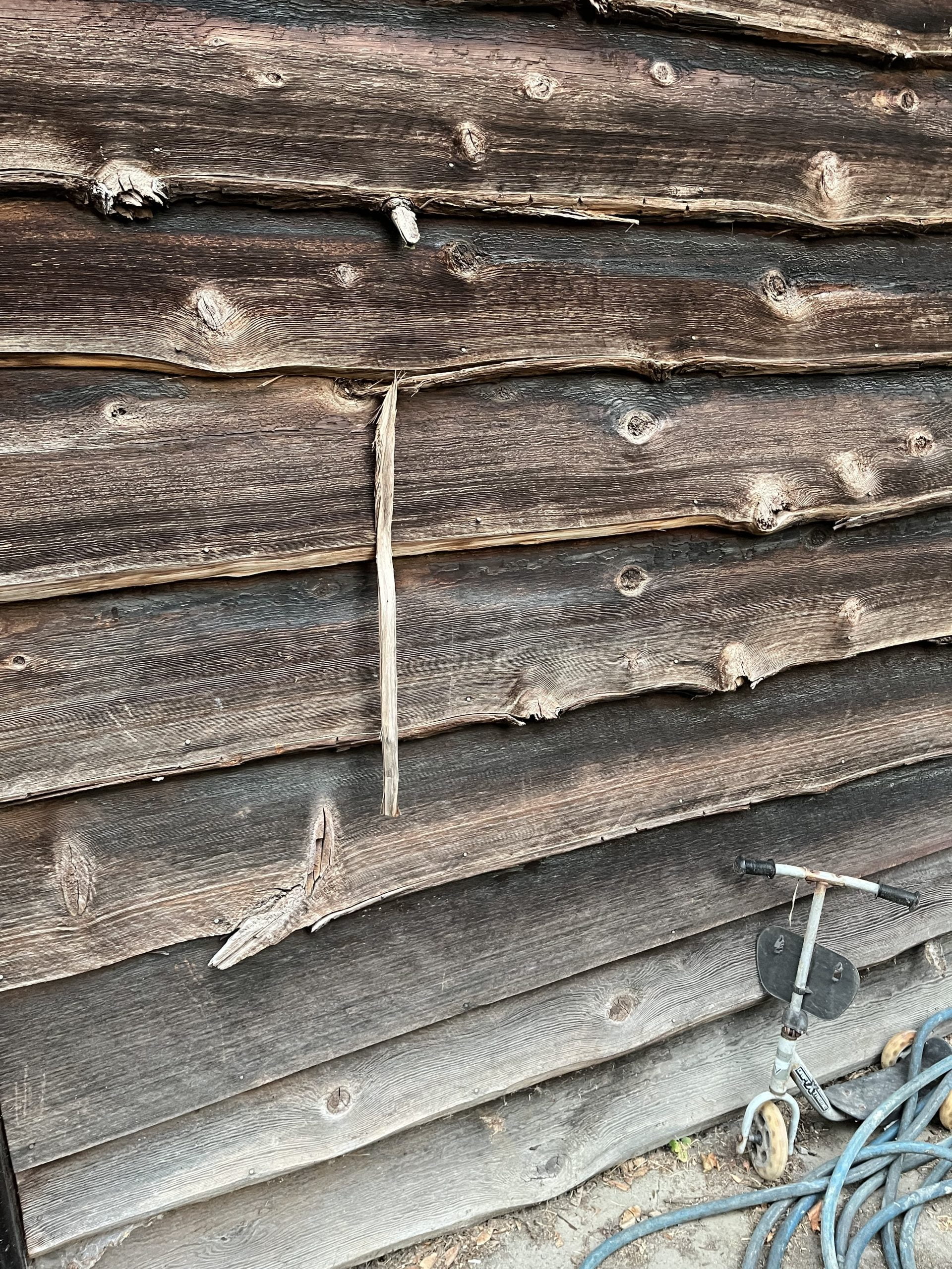

My house is rough sawn cypress board and batten. We used a oil stain on it 20 years ago and parts have greyed and other parts are the red color. Would we need to pressure wash the entire house and then stain? When we stain what would be a subtle red color that looks like a cedar red? Thanks in advance.
You would have to prep all the wood and remove the current stain. Post some pictures so we can help with how to do this.

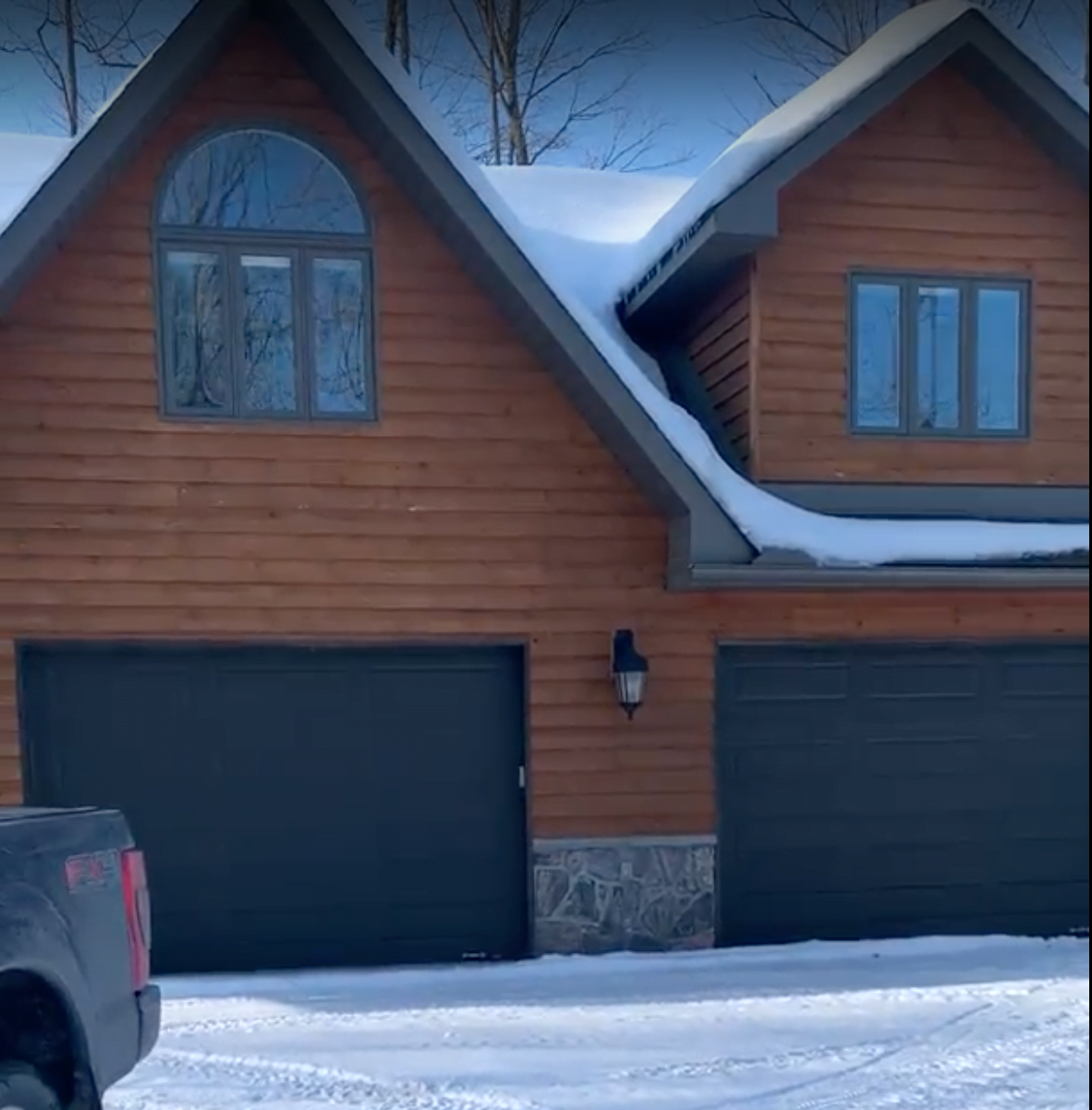

What stain do you suggest for spraying new board and batten siding?
Rough sawn or smooth?

I am using rough sawn 1×6 pine planks for a ceiling in my cabana. It will be sheltered from rain of course but is an a outdoor environment. I need advice on what stain will be very light colored and protect the wood. I plan to seal both sides and the ends to prevent shrinkage.
Try Natural Color in the Restore-A-Deck Semi-transparent stains or TWP in Honeytone.

I have gifted hand made rough sawn cedar birdhouses to family and friends for Christmas. They are asking my opinion as to the best way to seal and protect them for outdoor use. Can you help???
Frank
Try one of these top stains: https://www.deckstainhelp.com/the-5-best-deck-stain-reviews-and-ratings/

I had a treehouse built for my daughter back in the Spring. The siding is rough sawn poplar and has started to gray so I have decided to clean and stain it and found your site while attempting to figure out how to best proceed. Would you recommend Restore-A-Deck to clean and prep the surface? Would any of your top rated stains work well for this project? Since the treehouse has weathered, should I consider a solid stain instead of a more transparent one, keeping in mind that I do want it to look as natural as possible but also fresh and not mildewed? Would I need to use a different type of stain for the deck and posts, which is made of pressure treated wood?
If you are willing to answer all of these questions, thank you so much in advance!
Yes, use the Restore A Deck products for prep. Do not use a solid stain. Use Restore A Deck Semi-Transparent Stain or TWP Stains.
