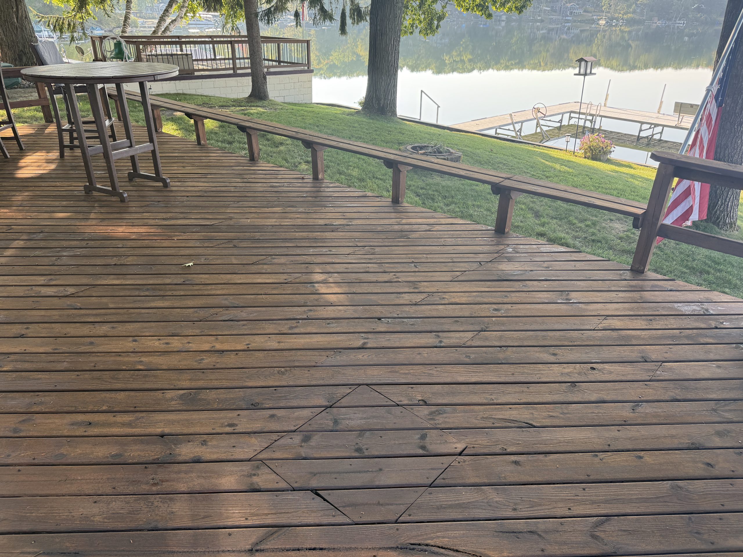

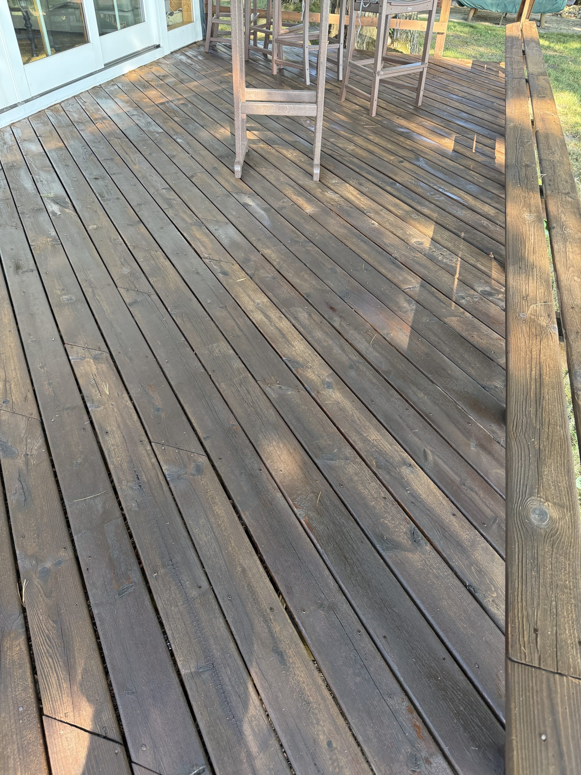

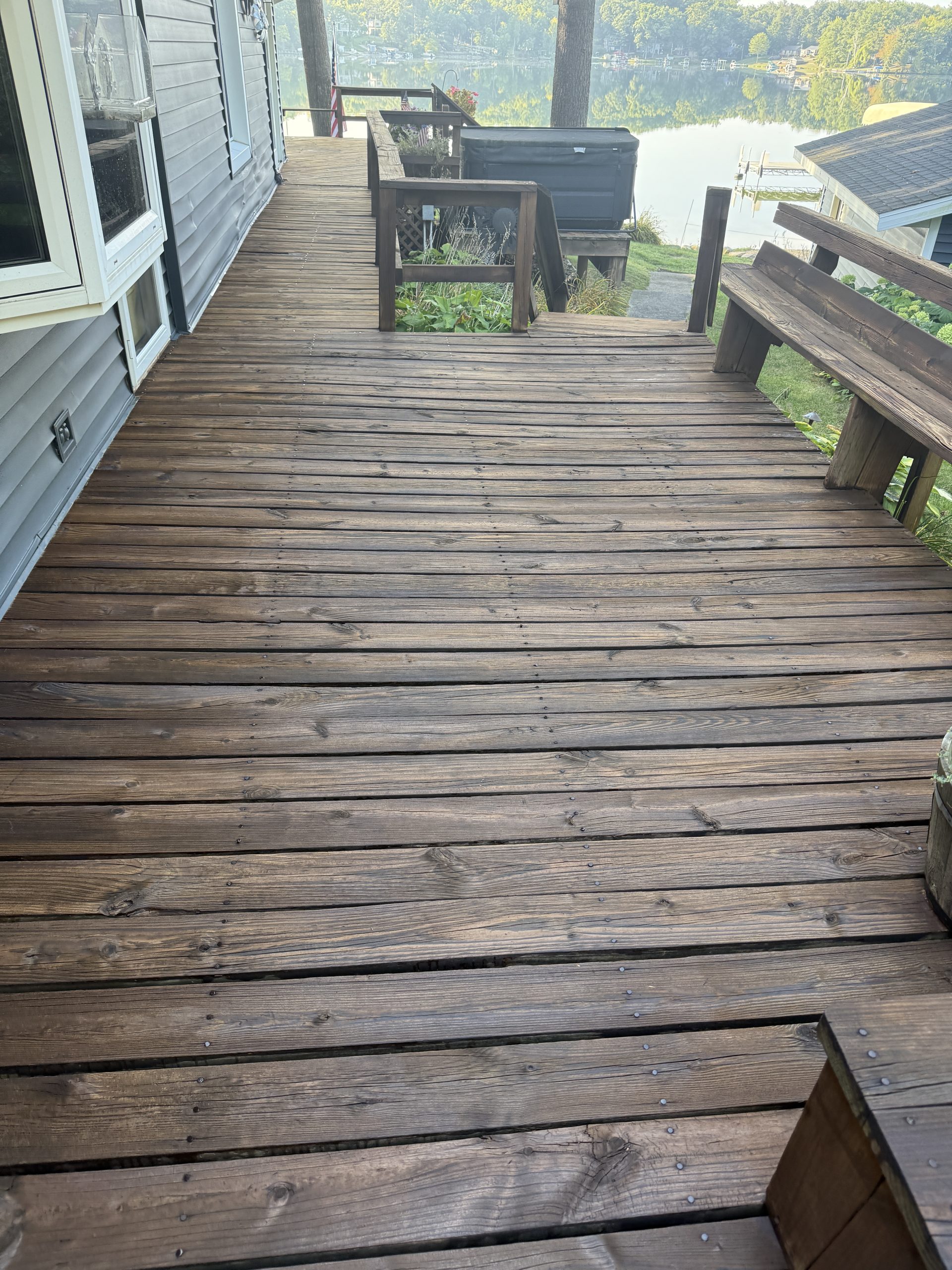

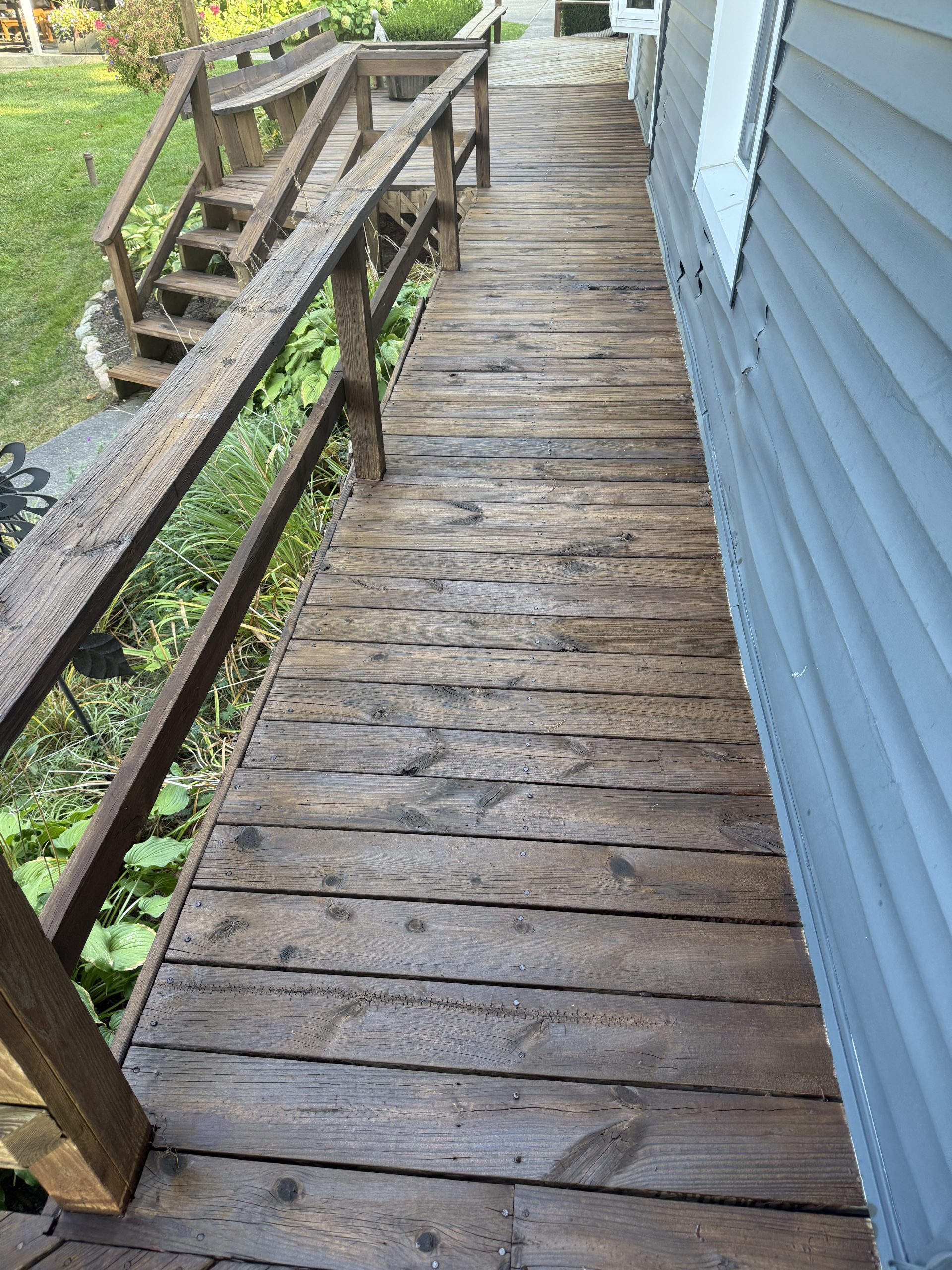

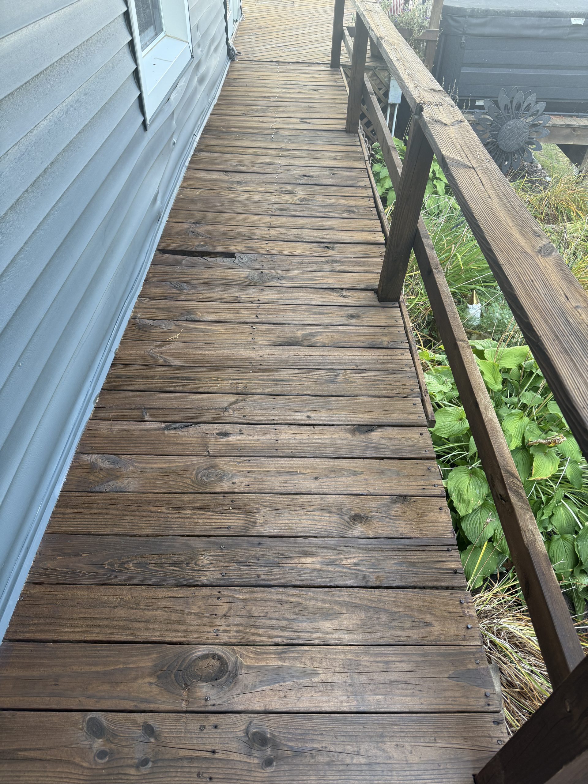

1. Appearance After Initial Application: 9
I prepped the deck using the Restore-A-Deck Stripper and Brightener before applying CUTEK® Extreme with a Walnut Colortone after several days of drying. The deck had previously been finished with a penetrating oil, but the homeowner wanted a slightly richer brown tone this time. The final appearance looked excellent, with the oil enhancing the natural grain of the wood while providing a consistent, even finish.
2. Preventing UV Graying After the First Winter: 9
With the Double Strength Walnut CUTEK® Colortone added, the finish retained roughly 90% of its original color after the first winter of full weather exposure. The UV pigments helped slow the natural lightening process while still allowing the wood grain to remain visible.
3. Wear, Tear, and Peeling: 10
Very little wear was visible, and there was no peeling or flaking. Because CUTEK® Extreme penetrates deeply into the wood fibers rather than forming a surface film, it gradually fades instead of breaking down on the surface.

5. Preventing Mold, Mildew, and Algae: 9
There was no noticeable mold or mildew growth on the main deck surface. Some minor green algae developed along a shaded edge near the hot tub, which is common in areas with limited sunlight.
6. Ease of Application: 8
The application was straightforward. The first coat was applied with a deck flooring brush, while a pad applicator was used for edging around the house. Railings were coated using a brush-and-pad combination. The first coat took approximately 2–3 hours, while the second coat—applied four days later—went on faster due to improved spread rates.
7. Color Shifting After the First Winter: 9
The finish did not darken due to mold or UV discoloration. The color remained stable and natural-looking, with only slight lightening in areas with the most sun exposure.
