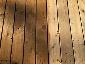

- Apply Wood Brightener to neutralize.

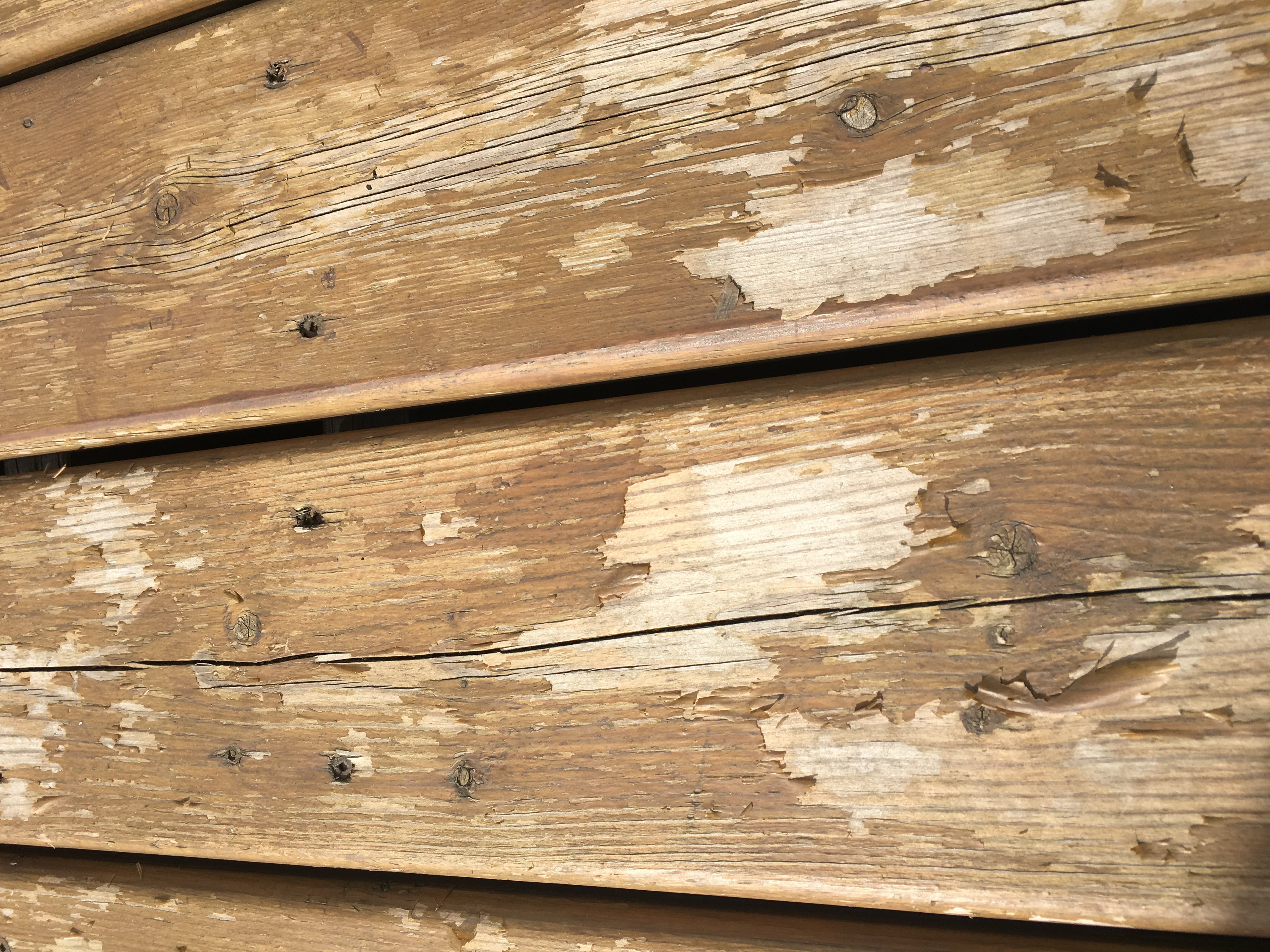

To get the best results using a wood stain stripper, let the product sit for several minutes after applying it to the wood. This allows the stain stripper to penetrate and break down the old stain. The dwell time depends on the type of existing stain. For instance, most semi-transparent oil-based stains will be removed more easily than semi-solid deck stain.
For hard-to-remove stains such as acrylic or silicone-based stains, several applications and longer dwell times may be necessary. In extreme cases, such as when dealing with a solid deck stain or paint, some sanding may be needed to remove the existing stain fully.
Once the failing deck stain seems to have softened, it is best removed with a power washer using light to moderate pressure. The caustic stripper raises the wood’s pH level during the stripping process, causing it to appear very dark. This darkening is why a Wood Brightener is needed to restore the pH balance and lighten the wood.

Expert Tip: Most stripping failures happen because the product wasn’t left on long enough or was allowed to dry.

⏳ How Long Should You Wait to Stain After Stripping?
- ✔ Wait 24–48 hours for the wood to fully dry
- ✔ Ensure the surface is clean, neutralized, and dry before staining

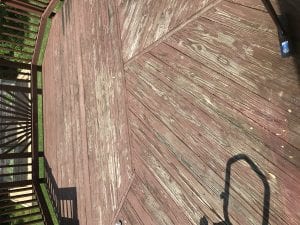

What is the best paint stripper… I inherited a painted deck…
You will need to sand off a paint.

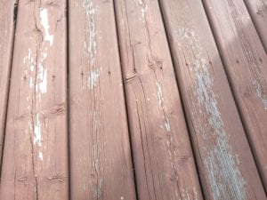

I have a solid stain deck that the floor of is look rough, missing color in spots. Whats the best way to get another solid stain to adhere to my deck? Chemical stripper, sanding, or just pressure washing?
You can strip off what is loose and then cover the stain that is intact with another solid color stain. Use a deck stain stripper and pressure washing to do this.
I used Rustoleum 10x 4 years ago and some spots have now peeled off. Could I spot repaint with more 10x after scrapping and power washing; followed by another full coat? Any other suggestions short of total stripping or replacing?
Unfortunately, you cannot fix the issues with this product by adding more on top: https://www.deckstainhelp.com/class-action-lawsuit-against-rust-oleum-deck-restore/
It will need to be removed to fix it.

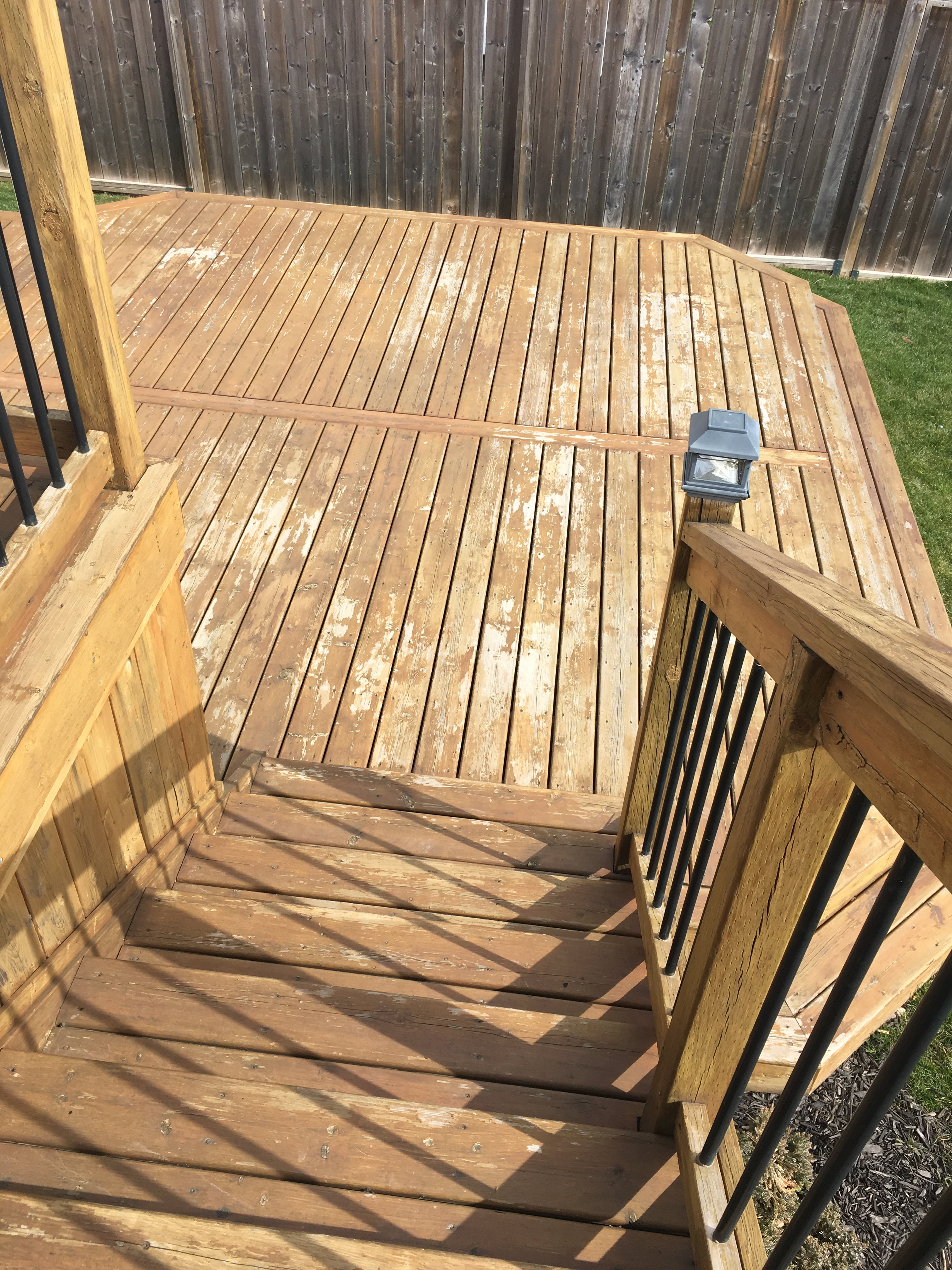

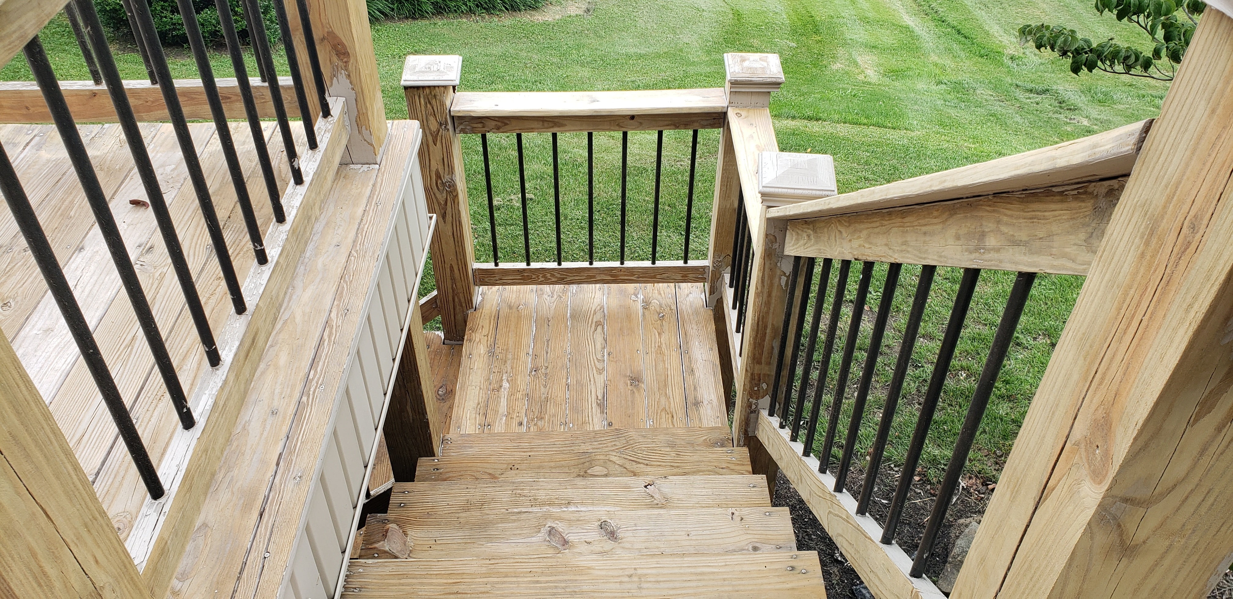

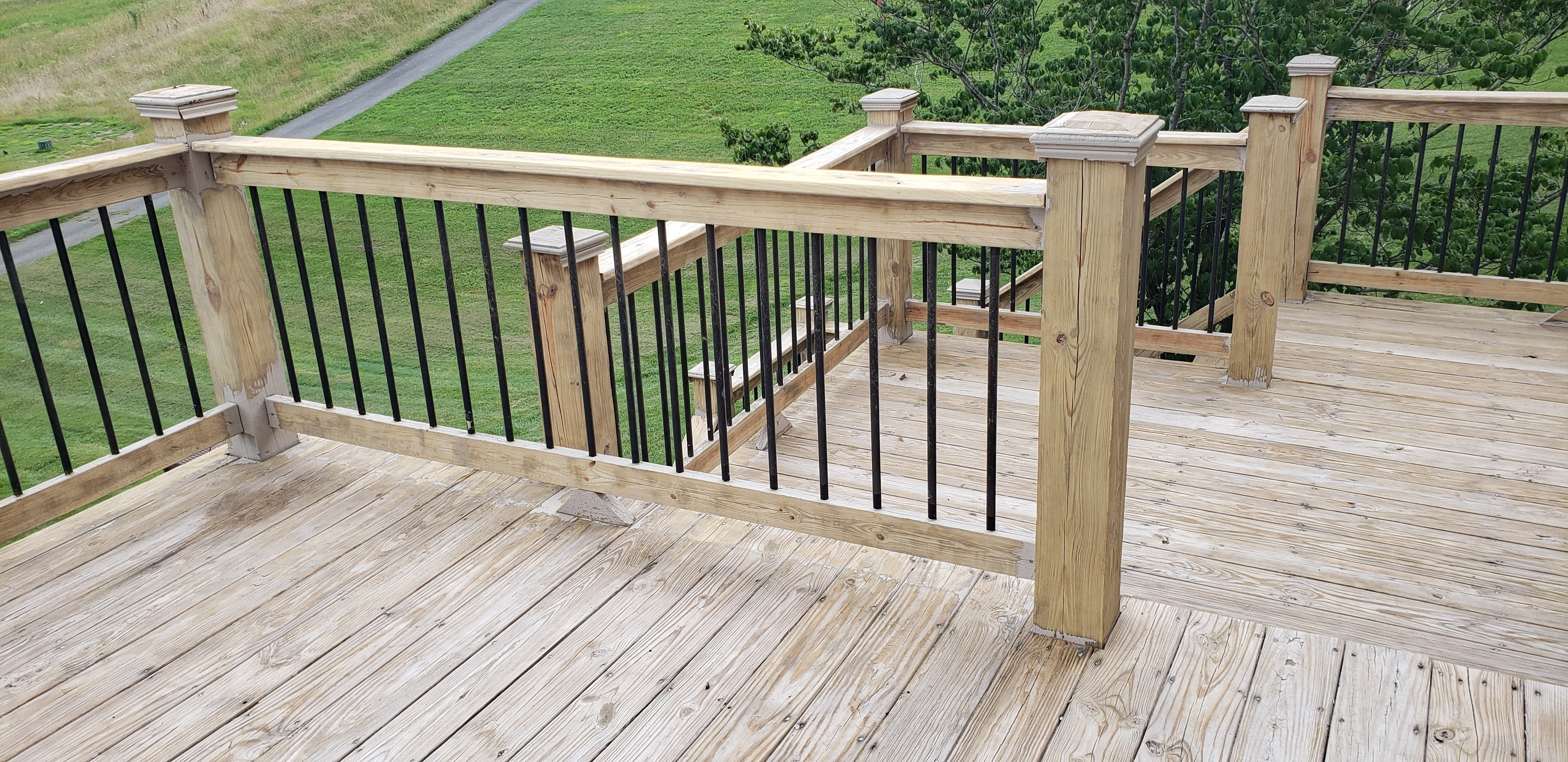

I want to fix up the deck (approximately 600 sq ft) and not sure on best way to prepare it and what stain to use. I don’t know what the existing stain is as I just moved in but it looks like semi transparent. The wood is all in very good shape but the existing stain is peeling off in many areas, so do I have to strip it first or sand it off?
What process and products are best to use? See images attached:
You should be able to strip most of this off, 90% or more. Use the Restore A Deck Stripper/Brightener Kit. Sand if needed after to remove all.
Once I get it all prepared what stain should I use? The wood is pressure treated pine. I’m in St Catharines, Ontario and deck is on north east corner of house so sun half the day. I want it about the same colour.
Try the Armstrong Clark Wood Stain.

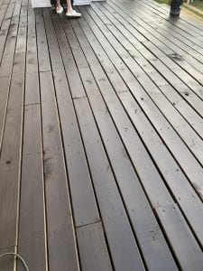

Thanks for your reply – so this is looking up the stairs. The lighter wood is what I did yesterday, the darker wood was RAD’d and brightened this afternoon and is still wet. I mentioned in my earlier post that there was some gooey stuff that came off…turns out it was wood fiber. Should that be happening? The other picture shows a partially completed post. Note that the post was just power washed and then stained…to me, this looks ok, but will it last?
I think you are good with the prep. No issues.

We need help! The previous owner applied a semi-transparent stain. We had hoped to remove that (ugly) stain color and reapply with a transparent stain. We first power washed it to get the loose stain off, then we tried a stripper called ABR Fast stripper. It just muddied the color and made the wood fuzzy and damaged looking. My husband and has now sanded off the stain which has taken a million man hours! We have a 500 sq ft deck and he has removed about 70% of the stain, but there are still areas we can't get the stain off. Deep crevices in the wood and hard to reach corners, etc. Any suggestions? Do we need to give in and out on another semi-transparent stain? Will it need to be darker than the original (brick red) color in order to cover it? Some local places have said to use a solid stain, but I'm worried we'll be in the same situation 3 years from now. Help!!!
Do not use a solid. Try to get off close to 95% of the current stain so the new stain will work correctly. Best to strip as much as possible first and sand after to remove rest and smooth the fuzzies as well. Semi-transparents will not cover the existing but possibly will blend.

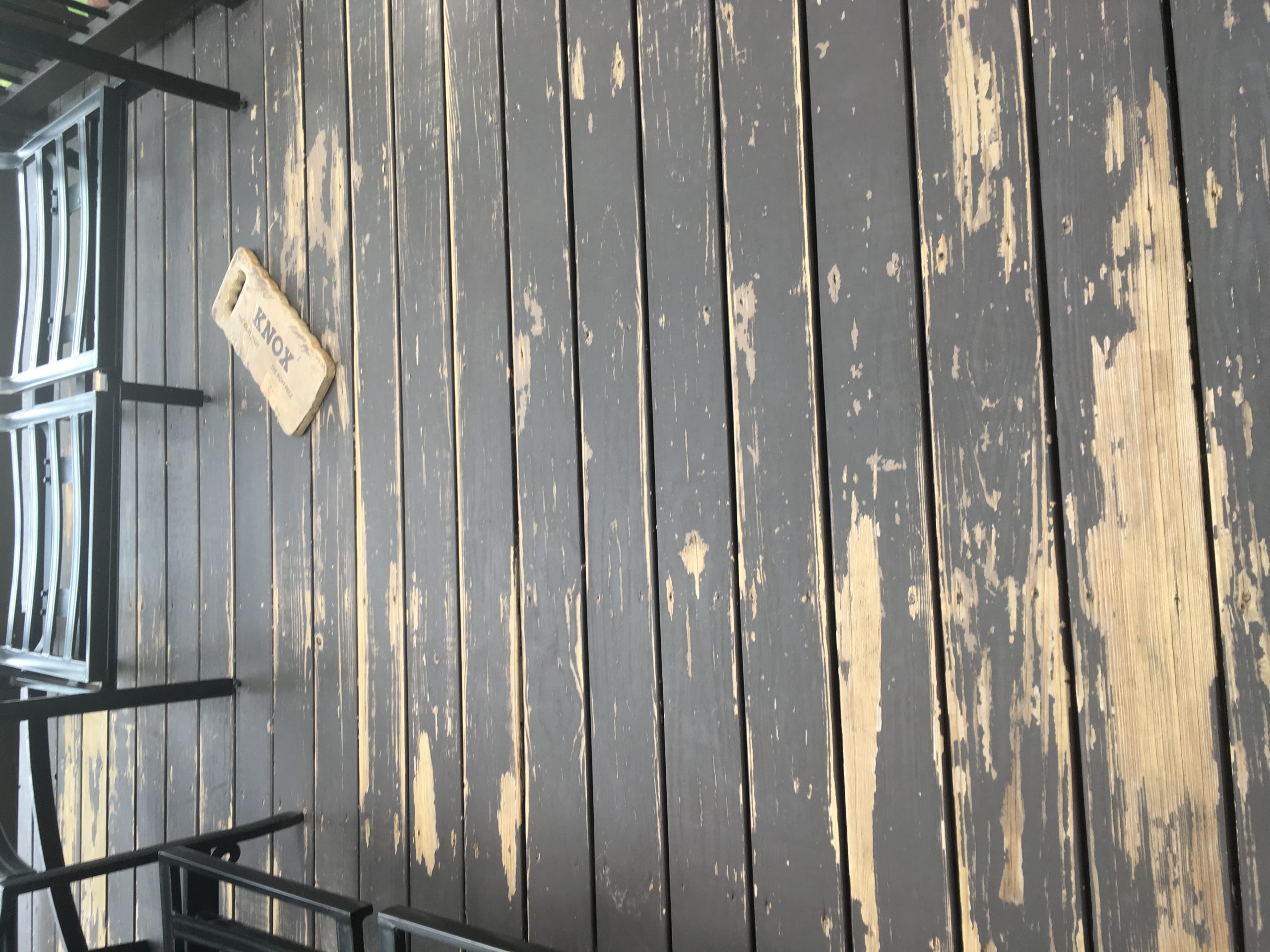

Ok, I have been reading over your posts and still need a little bit more clarity. We have a small fence restoration business (www.FenceMakeover.com). We pressure wash and stain fences in Colorado. We ONLY use Behr Premium Plus solid stains because the color lasts/holds 5+ years (from our experience) in the harsh sunlight climate we have here. We have 2 jobs that were done in the past where the Behr solid color stain has pealed or flaked off. We're doing to apply a new solid stain over the top of this. But before we do it, we want to apply some type of stripper that will loosen the old stain so we can scrape it, wire brush it, or power wash off the old stuff. I read many reviews and still feel I need your advice on WHICH stripper to use in this situation AND any advice you have on the best way to apply and remove it.
Brian, strippers will not remove the solid stain but will help remove the loose stain. Try Restore A Deck stain Stripper.
Are you saying that there is no stripper on the market that can remove solid stain from a deck? None?
None that will 100% effectively remove a solid stain every time.

Unfortunately, we were talked into using a latex deck paint which started chipping in one year. What would be the best way to get the deck in condition to stain. We live in Alaska and have heavy snow and ice. Thank you!
Jan, sanding off the solid stain is really your only option for complete removal.
