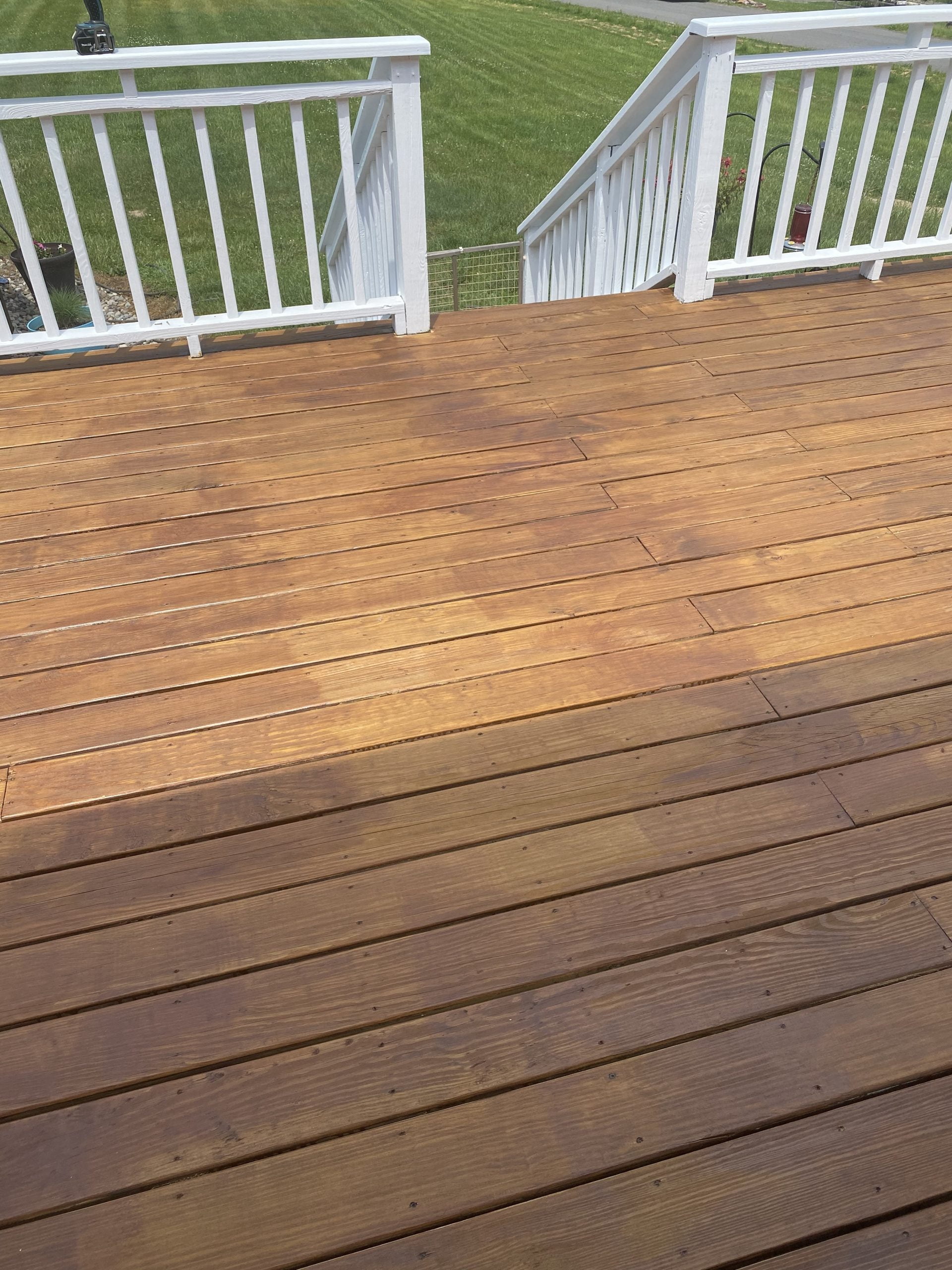

8-Step Review of Cabot Timber Oil Wood Stain and Dry Time
The Mahogany Flame looks very red but is overall very rich and nice-looking on the PTP test deck. All grain was visible and not “covered” by the semi-transparent pigment.

Cabot Deck Stain Photos and Real Application Results

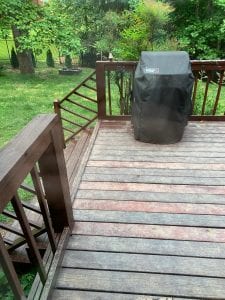

Stained our deck back in mid-March with Cabot Jarrah Brown after replacing a few boards as previous owners neglected the maintenance. A couple of days later it started to look cloudy and muddy. We had scrubbed the deck and cleaned prior to staining. It looks terrible and we can’t figure out how to clean off the cloudiness. I really am hoping not to strip/sand and start over. Any recommendations would be greatly appreciated.
You cannot fix this outside of removing all or covering it with a solid stain.
Can you elaborate on how/why this happens so I don’t get into the same issue again? Was there too much product used? or is it that the cleaning process prior to staining didn’t work? I am at a loss for how to prevent this from happening.
Thank you for your feedback
Not sure why it happened but Cabot is not a very good brand anymore. They sold the company years ago and then they changed all the formulas. Now it has lots of issues.
If you want to prevent, then remove all and switch to a better brand like TWP or Armstrong Clark Stains.

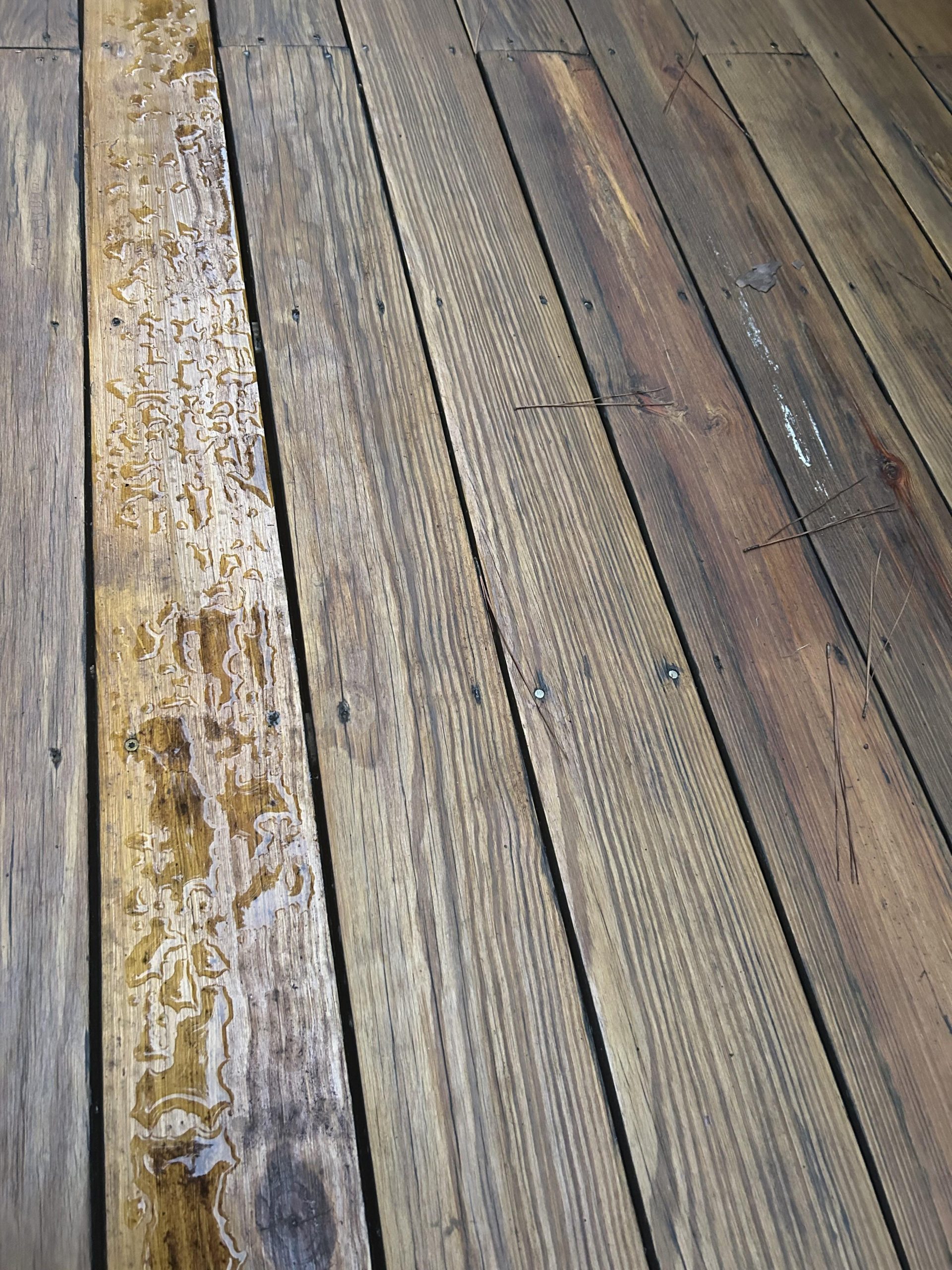

Applied the Cbot Australian timber oil 48 hrs ago, When you walk on it, it is leaving shoe prints. What may be wrong?
Most likely over-application and or improper prep. If it does not cure on its own in the next week or so, you may need to remove and start over.
It’s a “one coat only” product, did you use 2 coats?

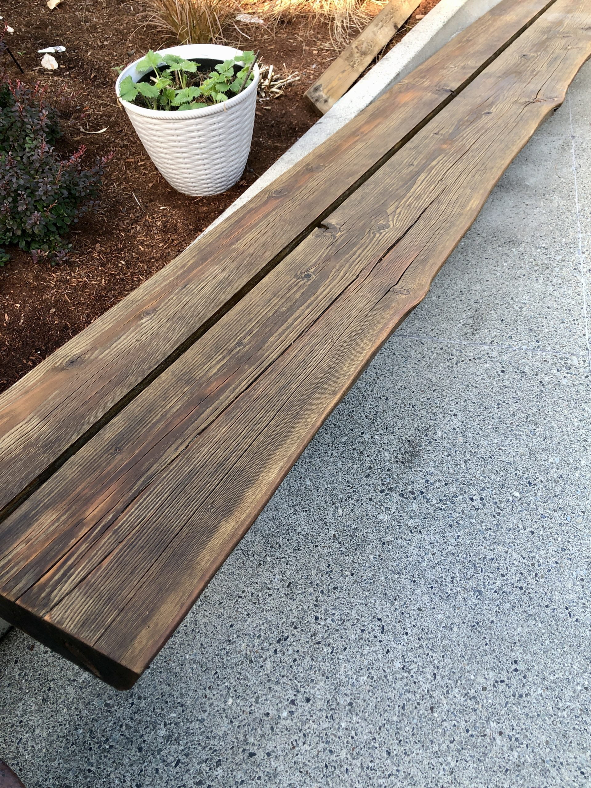

Just wanted to add a picture. I am very happy with the result. One coat of Natural Australian Timber Oil.

I just applied this to our outdoor benches. They are rough cut fir, and have been fairly neglected the past few years so they are very porous and the grain has opened up. I was not looking for a perfect finish. They were heavily greyed, so I gave them a quick sand to help the stain penetrate. I did not use a brighter or fully strip them (although I think I would next time) so that’s why in the photos you see inconsistency in colour (from the sanding due to the very rough grain).
My question is—I was planning on a 2nd coat, due to how porous the wood is but from what I’ve now read, less is more? But does that still apply in this case with such open porous wood? Or Should I just wait and brush on another coat next summer, if so what do I need to do for prep at that point?
Thanks in advance.
More is not always better so leave them as is. In 1-2 years you can clean and recoat.

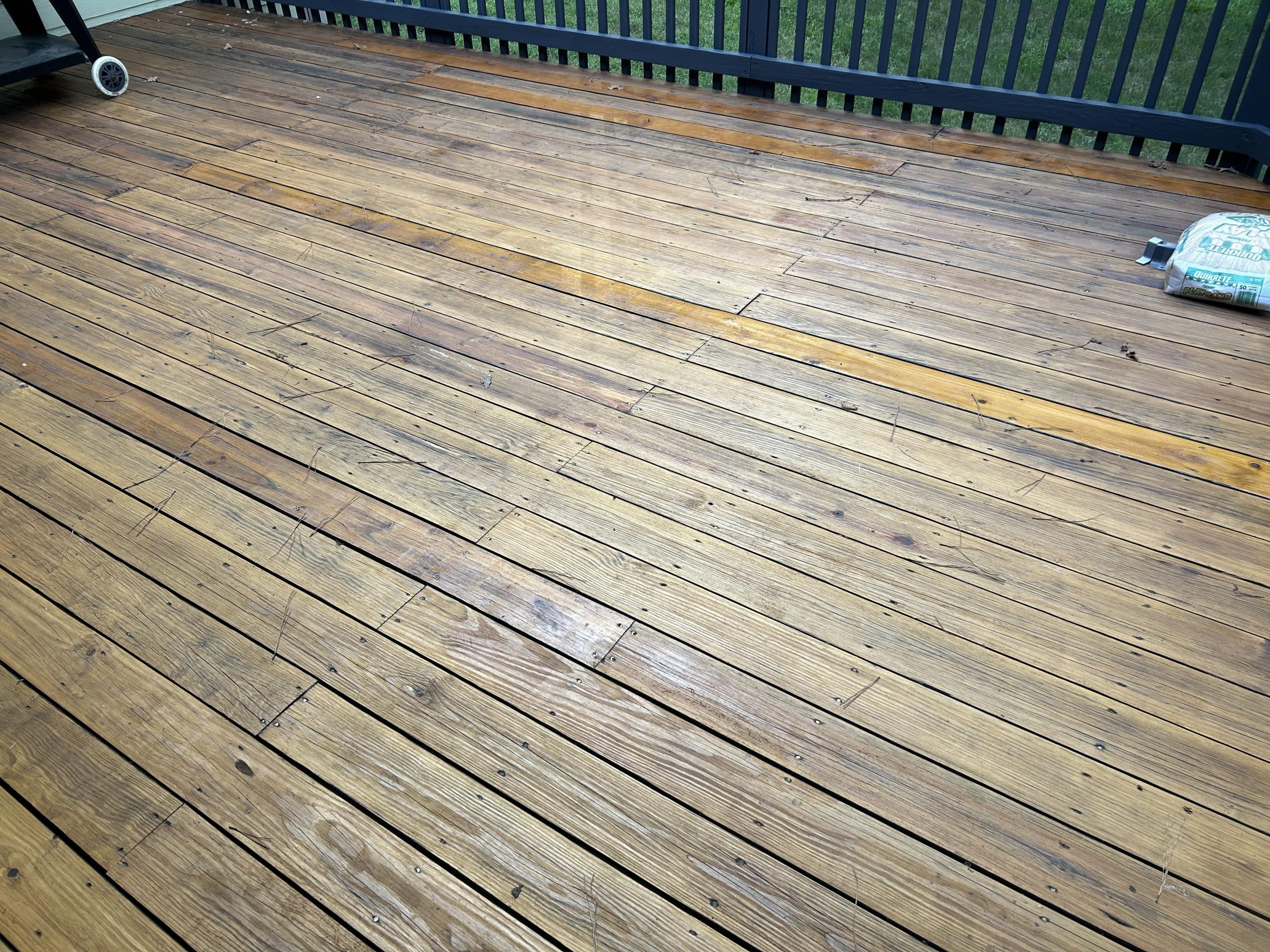

Look ok? Did the 2 steps. Seems like there is a lot of fuzzies. Can I stain over the fuzzies.
Looks good. You can stain over the fuzzies or you can light sand or buff those off first.
Why so many fuzzies? Seems like sanding it might be a lot of work
That is from oxidation removal. Buffing a floor with a sanding pad is very easy and does not take long.
Used the Cabot Australian Oil in Natural. It was not humid and a bit windy so it was quite dry to touch after 8 hour ……. then it rained .
Is this ok ? The water beaded on it for a ling time , but next day it appeared like there was darker spots on it , is this just wet wood ??
Should be fine.
I have a multilevel deck. One section has sunscreen covering it. This section is twenty years old and there are no signs of rot. I live in east Texas. Humid and wet! I recoat every 3-4 years. Other sections are in open and get much more sun. After 12 years did have some rot in these sections. However some of this I attribute to other factors. I have used several other products ( Deckover, Thompson’s, and Superdeck). Cabot ATO is best experience by far. Deckover is horrible BTW.
Still better products out there than Cabot: https://www.deckstainhelp.com/the-5-best-deck-stain-reviews-and-ratings/

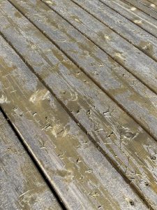

I applied this oil last year, after a harsh winter there are already some peeling… can I lightly sand to remove the peeling and reapply a new coat without completely removing the previous stain?
Tha would depend on how bad the condition is? Pictures would help.
Here are the pics. I would only restain the boards with peeling:
Upload images directly into the comments. Not a link.
oops, here
The only way to get this to look even is to strip all down and start over. Spot sanding and staining and it will look very blotchy and not blend.
Alright, thanks. Is it normal that it is peeling? I thought oil stain like this one fades instead of peeling?
If you do not prep correctly and/or over apply the stain then yes, it can peel.
