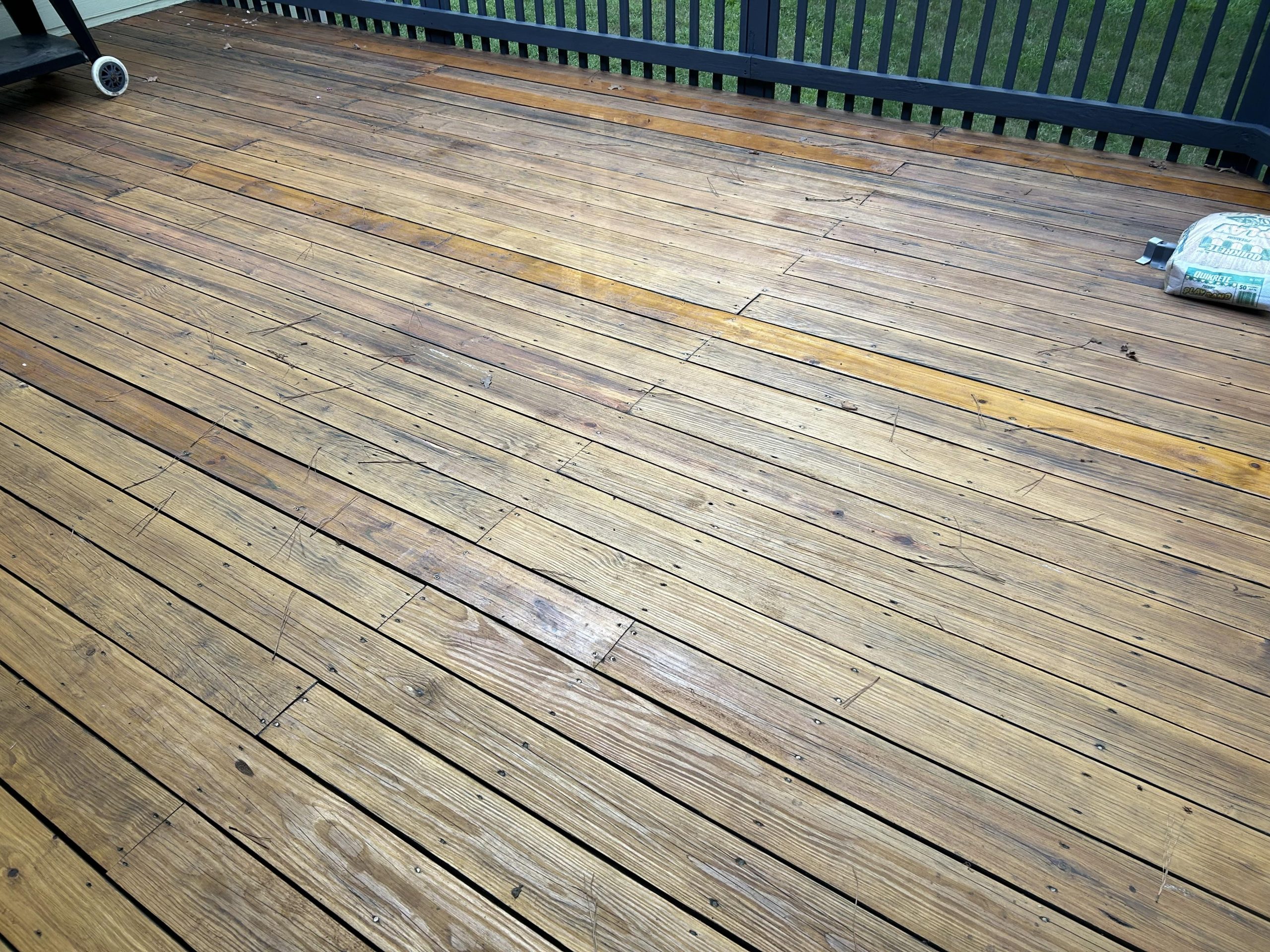

The Mahogany Flame looks very red but is overall very rich and nice-looking on the PTP test deck. All grain was visible and not “covered” by the semi-transparent pigment.

Stained our deck back in mid-March with Cabot Jarrah Brown after replacing a few boards as previous owners neglected the maintenance. A couple of days later it started to look cloudy and muddy. We had scrubbed the deck and cleaned prior to staining. It looks terrible and we can’t figure out how to clean off the cloudiness. I really am hoping not to strip/sand and start over. Any recommendations would be greatly appreciated.
You cannot fix this outside of removing all or covering it with a solid stain.

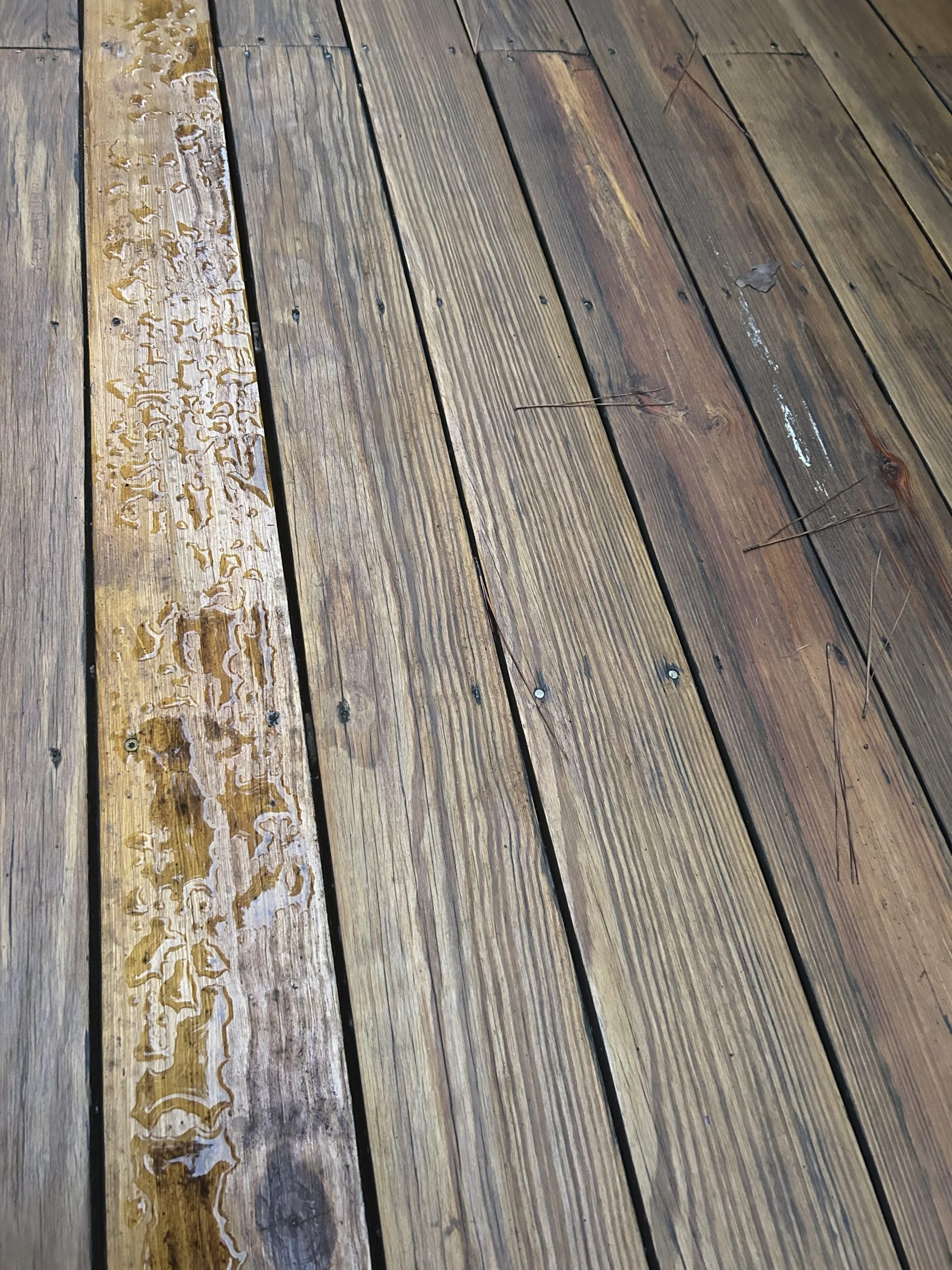

Applied the Cbot Australian timber oil 48 hrs ago, When you walk on it, it is leaving shoe prints. What may be wrong?
Most likely over-application and or improper prep. If it does not cure on its own in the next week or so, you may need to remove and start over.
It’s a “one coat only” product, did you use 2 coats?

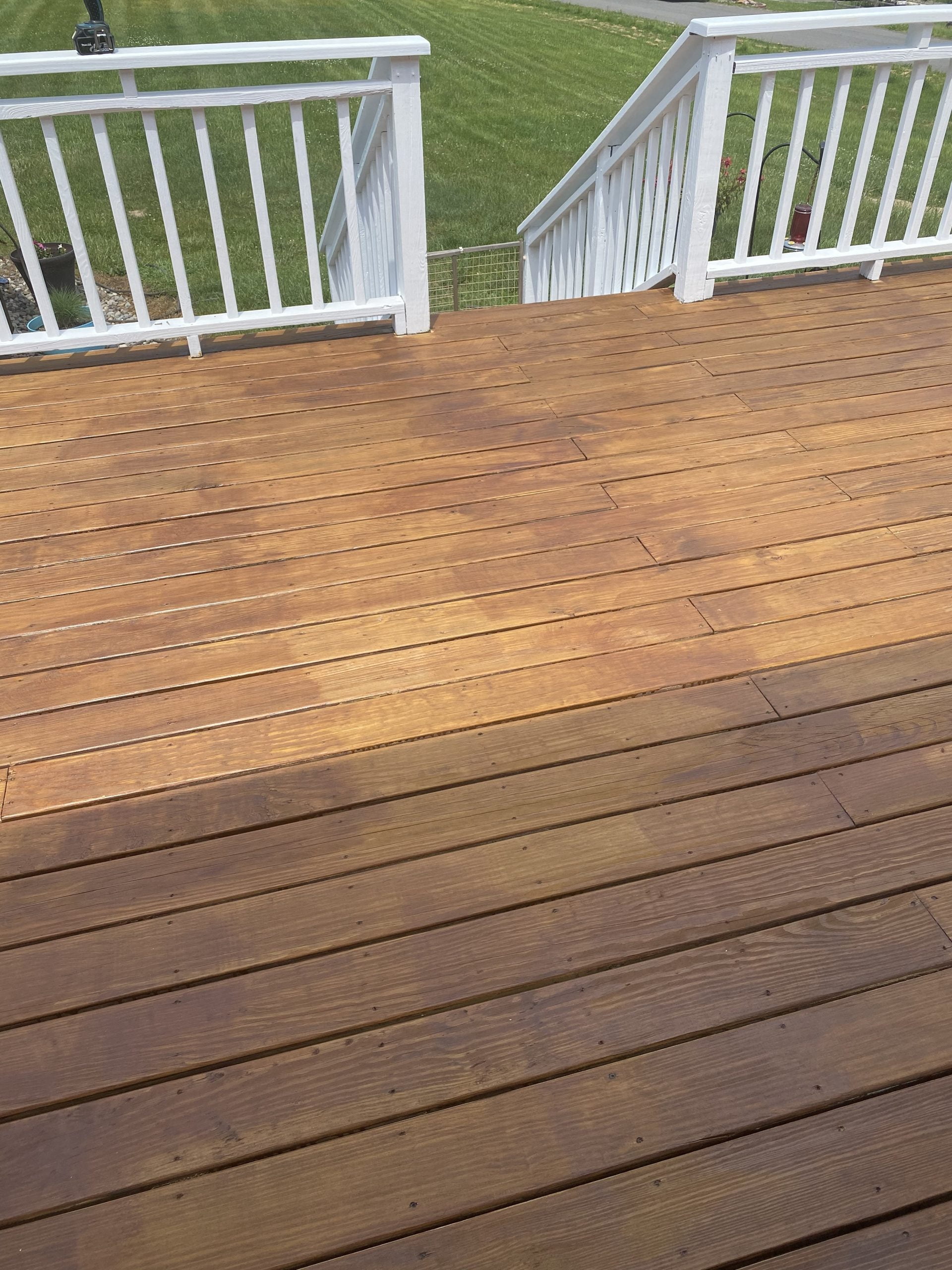

Just wanted to add a picture. I am very happy with the result. One coat of Natural Australian Timber Oil.

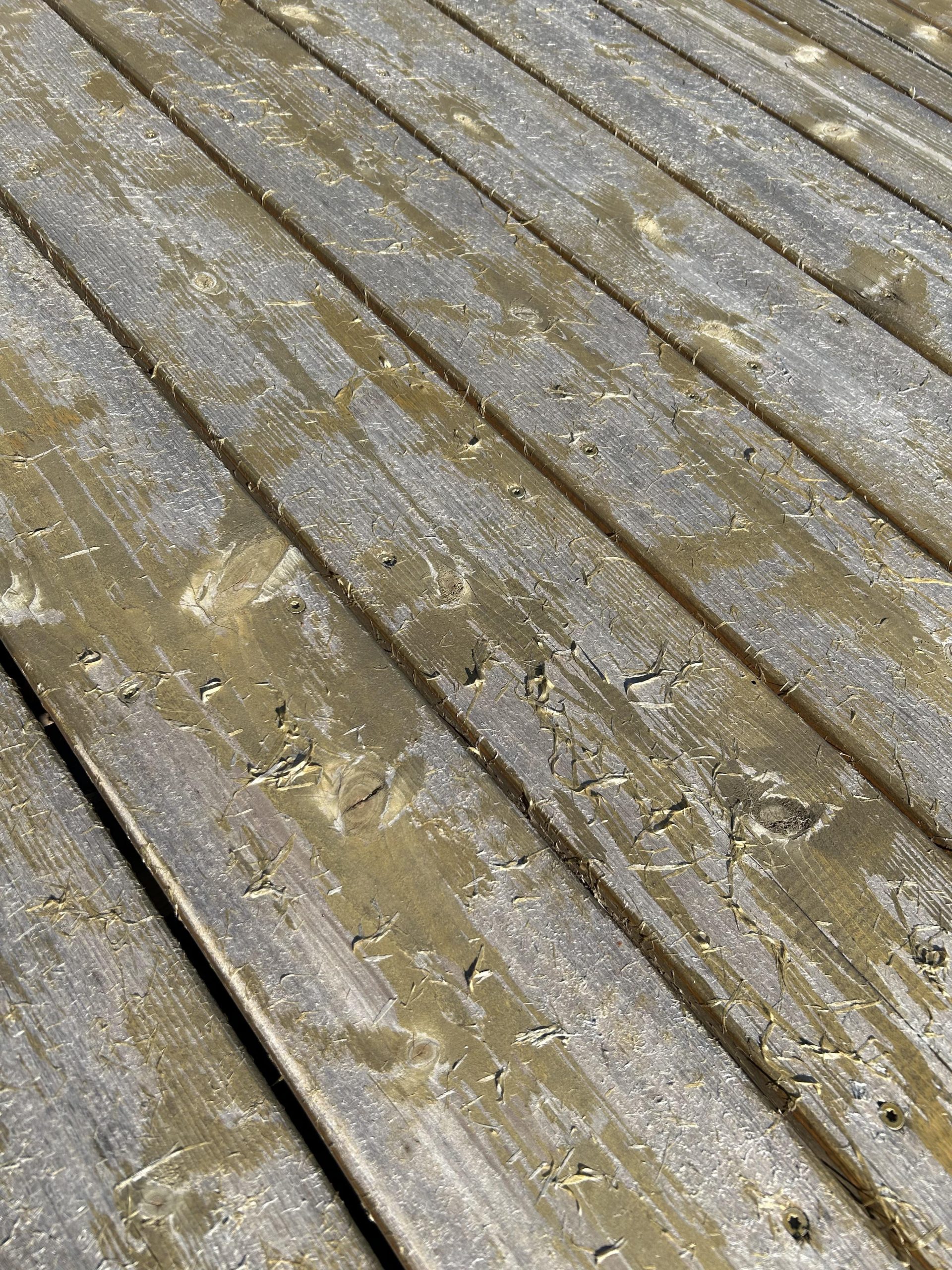

I have just finished sanding all the peeling stain (1year old) off my deck. I am looking for the best option to finish the wood. I would prefer a transparent gloss or high gloss finish (I like the wet wood look). Is Australian Oil a stain and sealer in one?
You cannot use a shiny finish on a deck. It will peel if you do. You want a penetrating wood stain so it does not peel.
That’s interesting because after applying the OG Australian Oil my deck was “shiny”.
That would only happen if you did not prep corectly and or over-applied. The Australian Timber Oil is designed to be a penetrating stain, not shiny.
