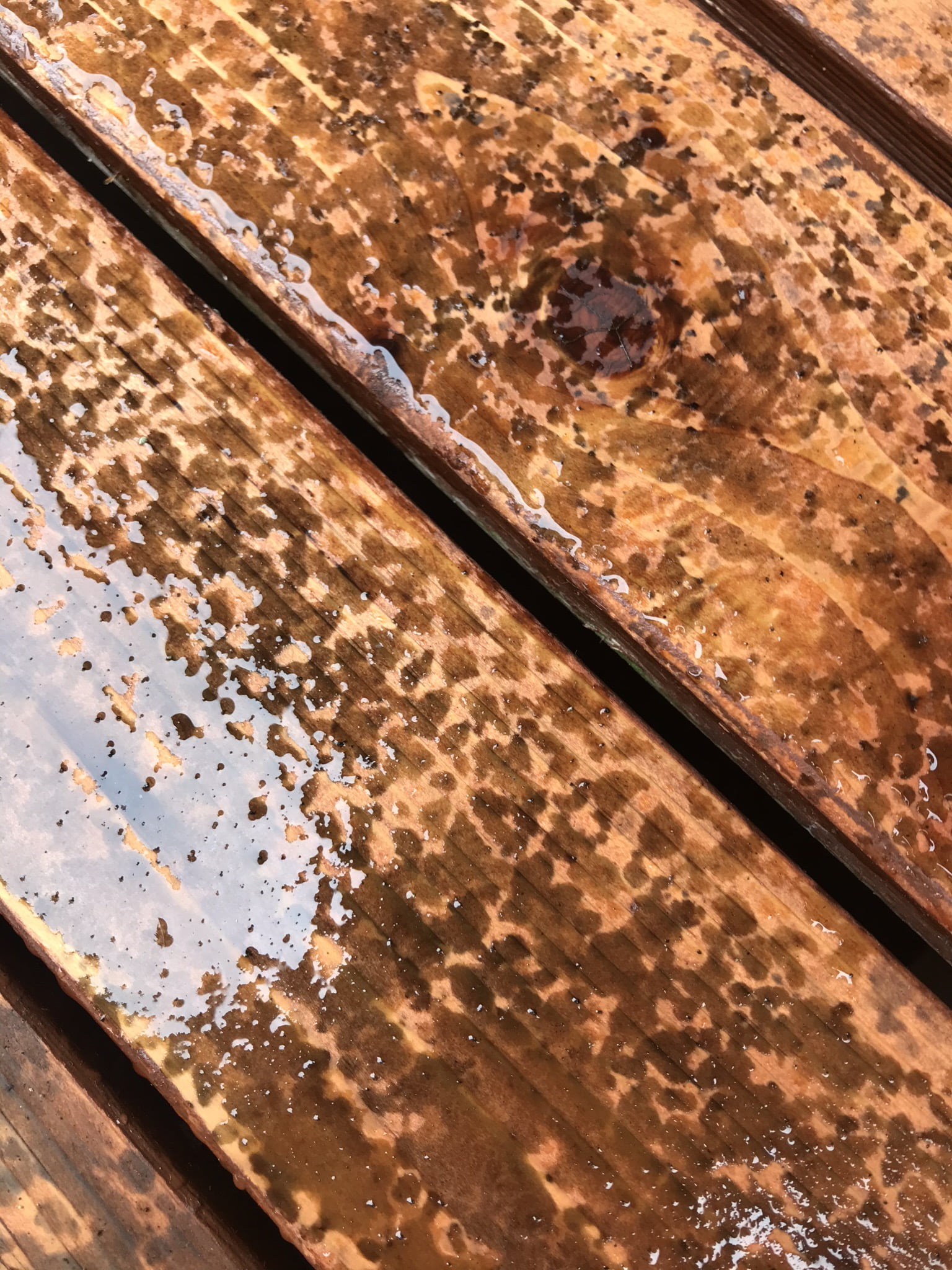

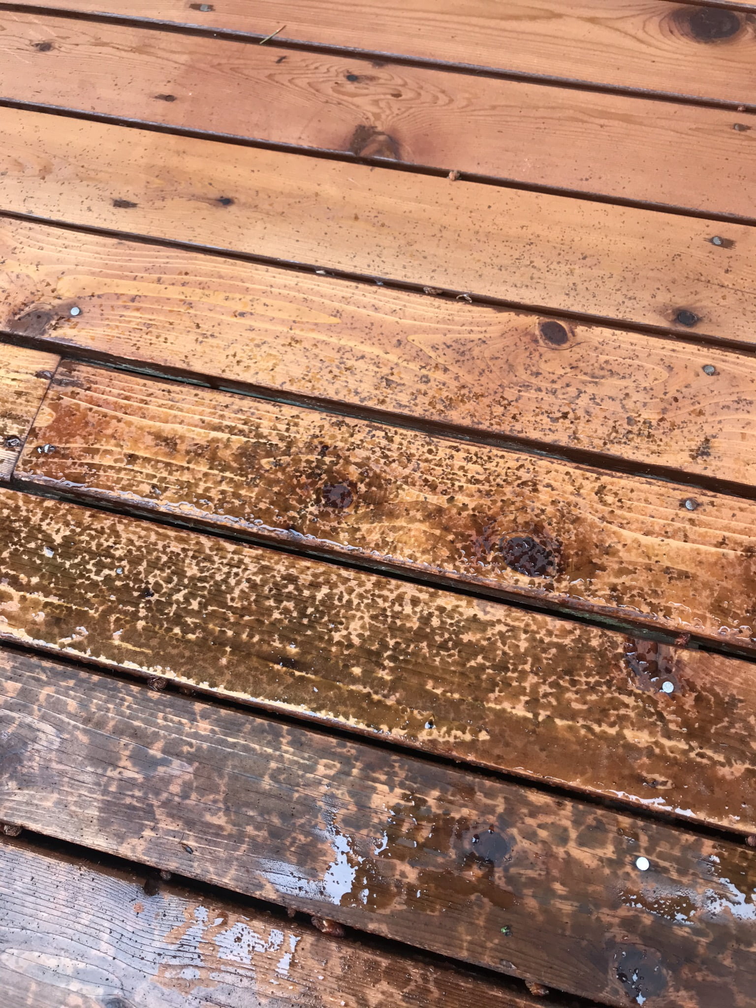

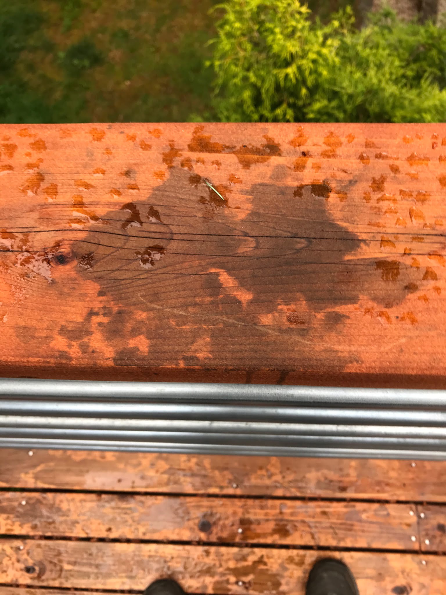

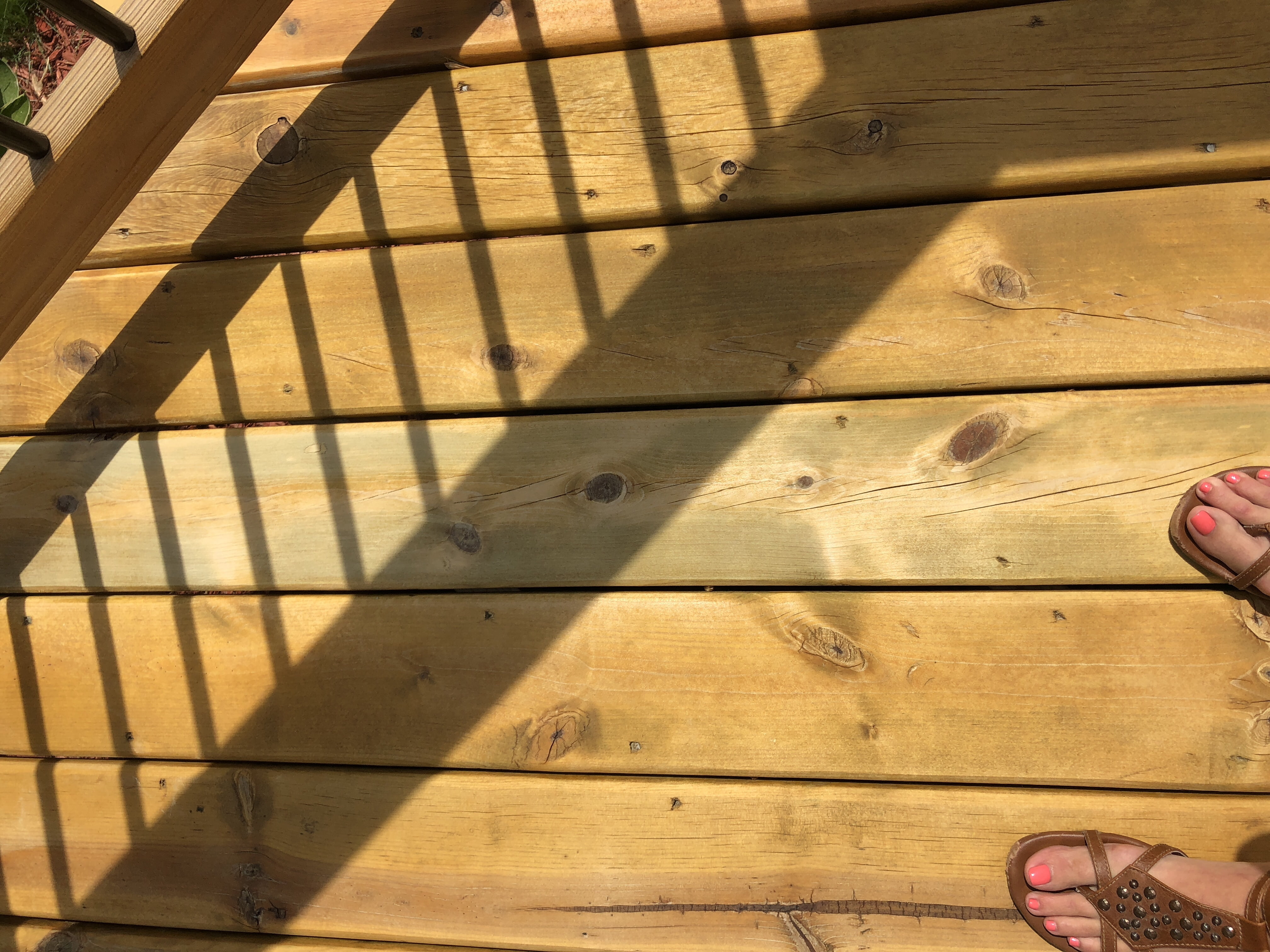

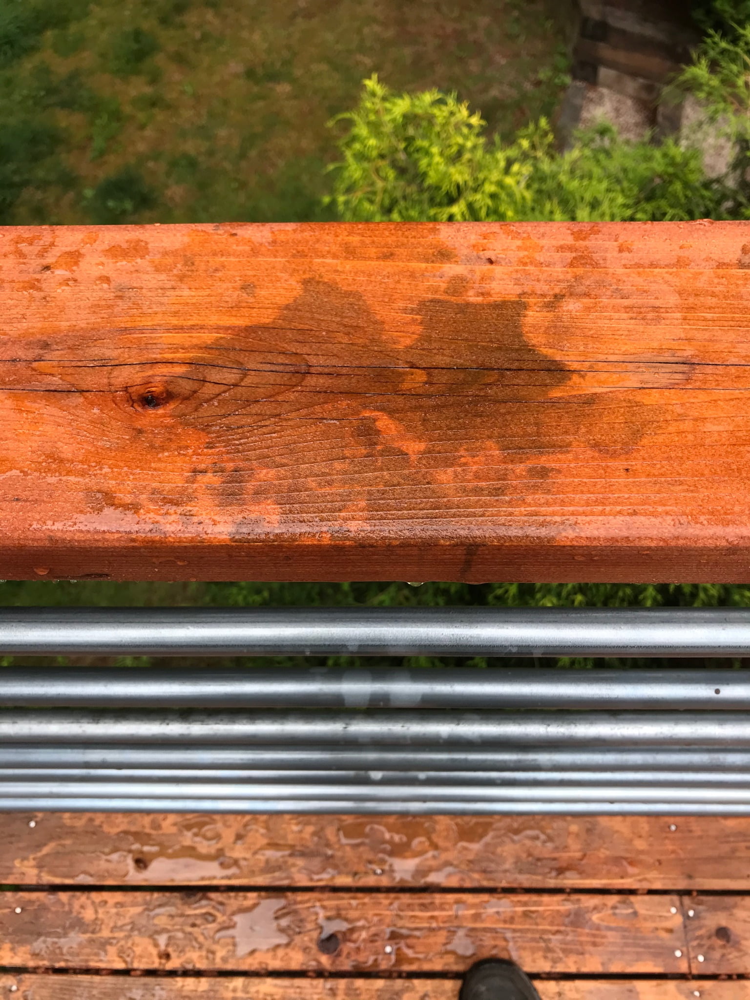

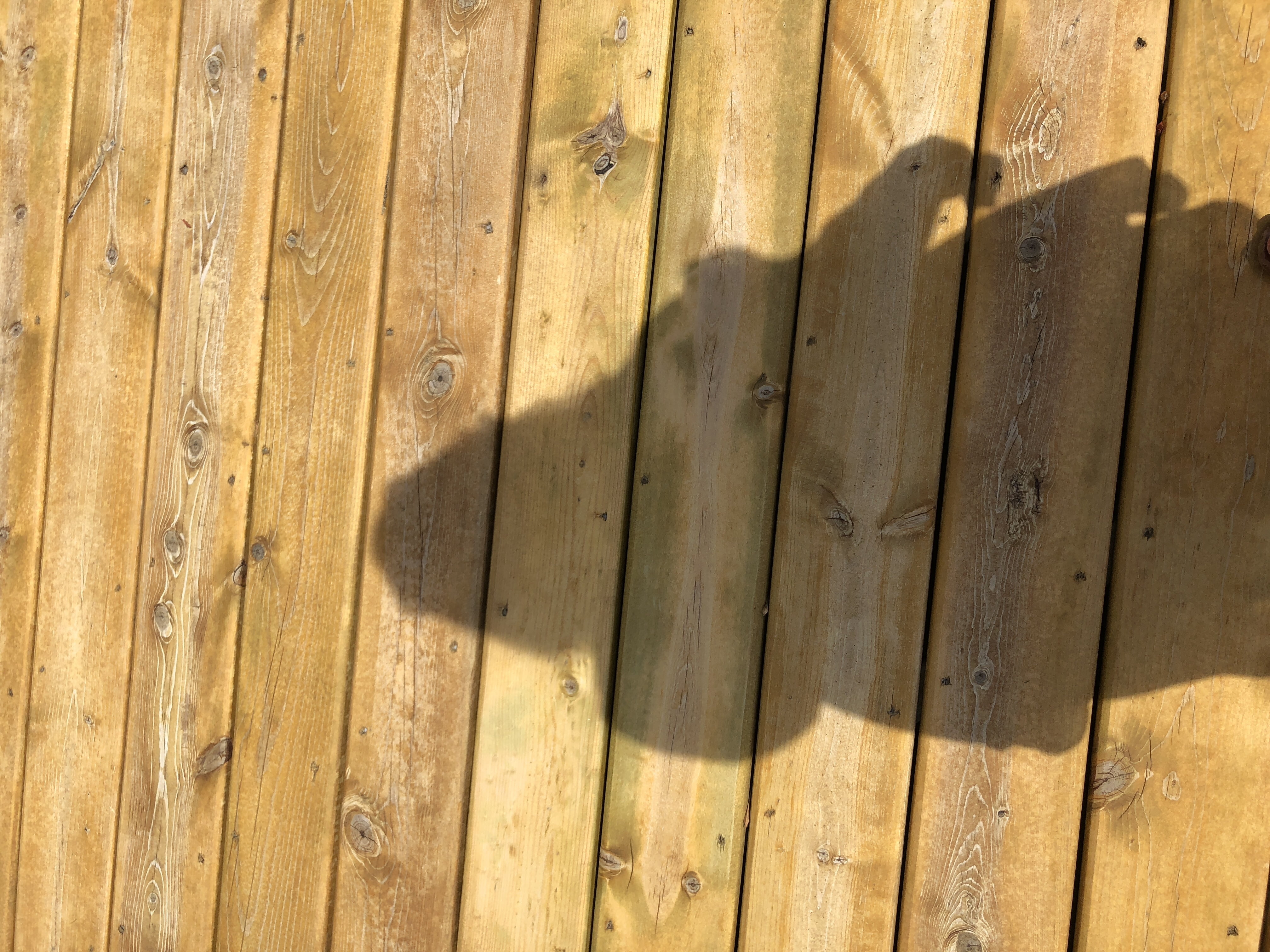

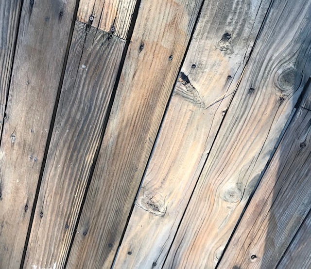

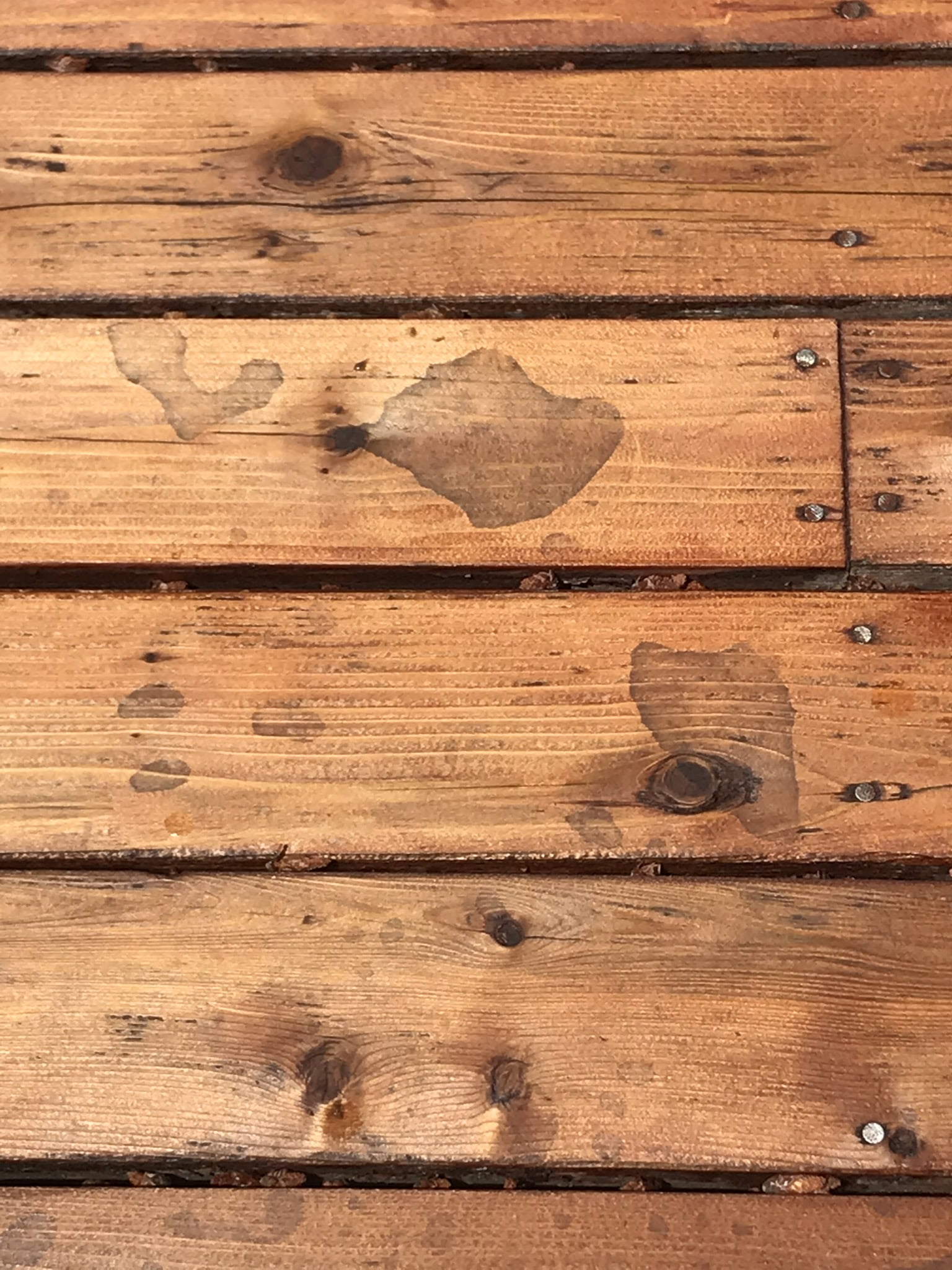

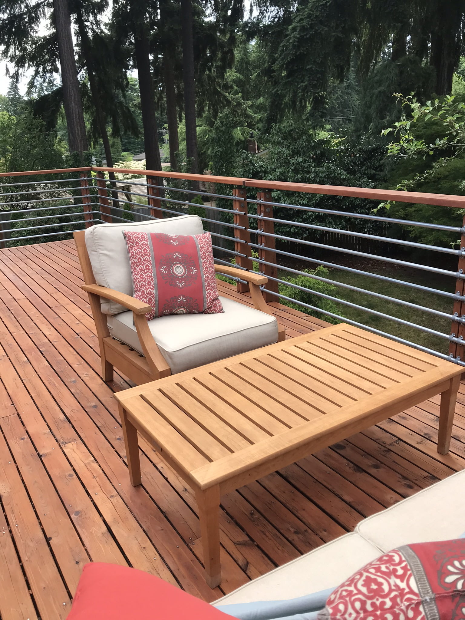

Hey all. I stripped my old cedar deck. Stripped by sanding to bear wood in most places. Used Gemini safe stripper in a few areas. All areas were cleaned and brightened following with restor-a-deck. Waited 2 days, on main deck, longer for rails… applied TWP100 rustic. It looked great. It sprinkled 2 nights after staining. Water beaded up. Looks great. Then about 5 days after staining I spilled a bottle of water and notice a grayish black stain formed when the water evaporated. Then it rained and the whole deck turned black. Photos attached. What happened… what to do? This occurred in hours as the heavy rain fell. It can’t be mildew… it seems chemical?
Help
Orbital sander. Zirconia sanding disks. Think that given that it is so wide spread, It can’t be rust- could it?
It does indeed look like some form of chemical interaction. Any other thoughts?
If it was rust, how might we get rid of it? What would be options? Could it be bad product?
You got me thinking. Several days after staining, we cleaned the metal railings you see in the pic with steel wool. We did that using the deck as our work place. So it could be scattered dust from that that wind spread over the whole surface…. wow! If so it should be on the surface, not deep in the wood? So might a brightener bring it all back? If so, is the stain impacted? Will I get shorter life etc? Thanks
I had some RestorADeck brightener I had mixed up 2= weeks ago. I helped, but didn’t fix. Does brightener age and become less effective? Is there a best brightener to use? Can I buy any brightener or are some stronger and better? This is with about 20 min of dwell time. Thanks for the help…
Reply to  Steve
Left 2 are after. Right is before
Ugh… what about using cleaner any chance that could help? Followed with brightener? Or will that just open up the wood pores and make it get dirty faster and undermine the stain
Reply to  Steve
Or might something like bleach or oxiclean help?
So if I strip, brighten and restain will it fix it? Or do I need to sand all of this off?

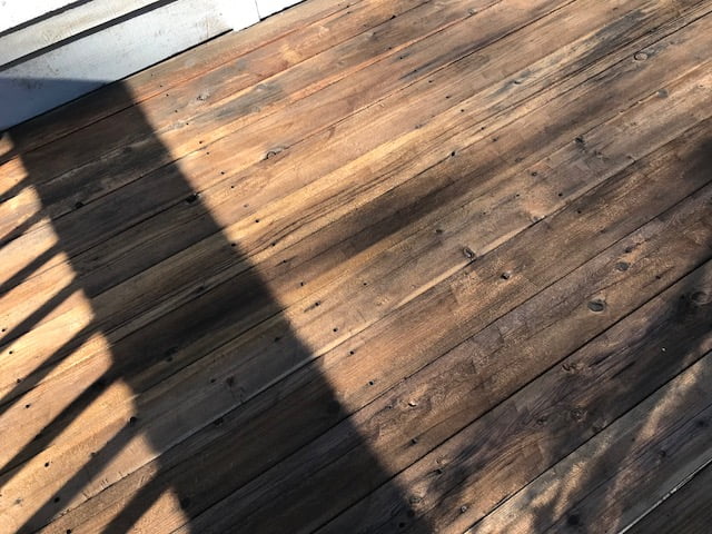

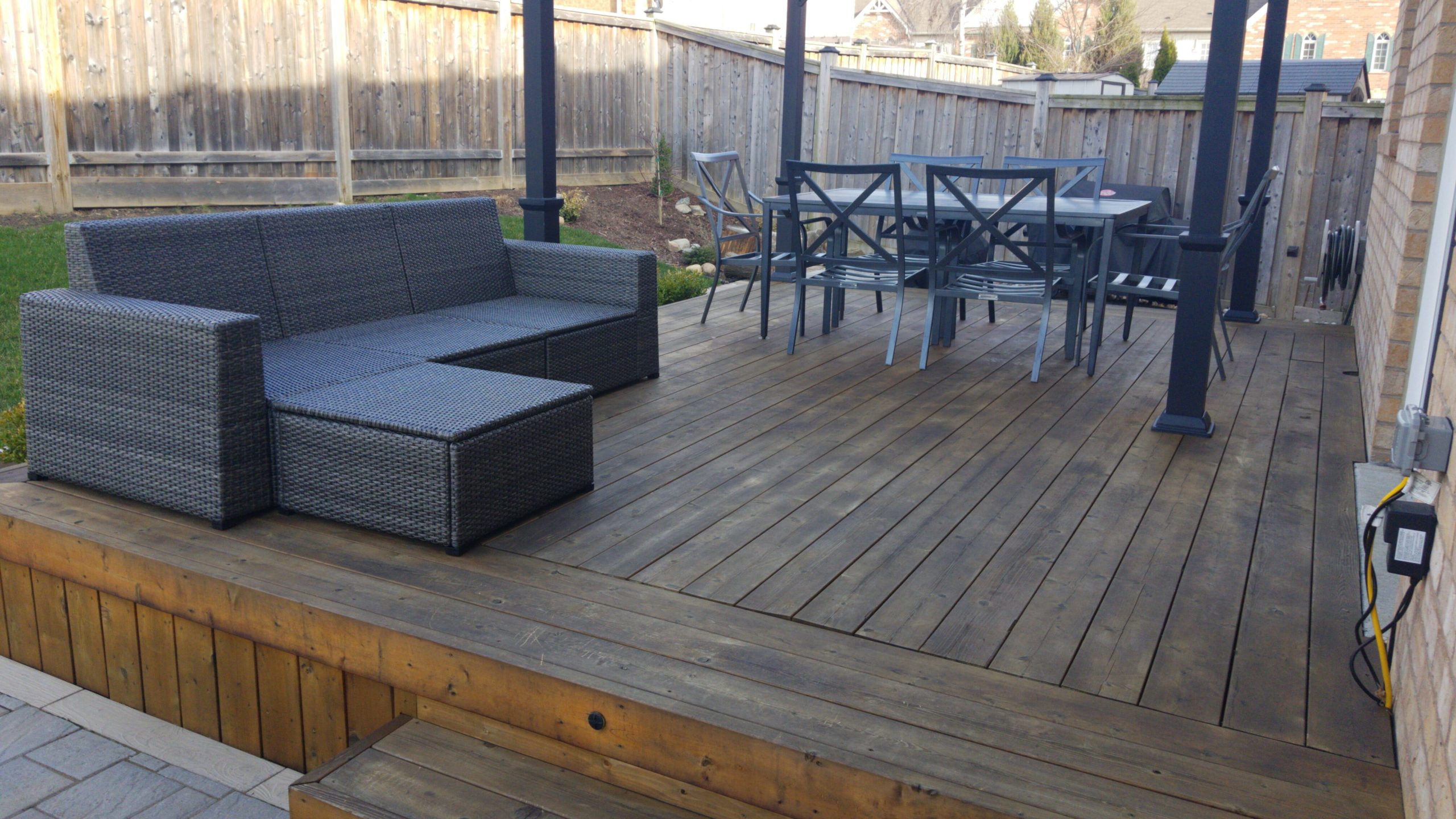

I used SuperDeck Oil-Based Transparent stain and noticed that it looked good in the beginning but slowly it got dark as you can see in the picture, the skirt of the deck looks okay but the top is just horrible.
I’m able to clean with a stiff brush but when I did this last season it looked like it lifted the stain off.
Do I need to strip this down and start over? Do you recommend sanding before applying the stain? The deck is entering it’s 3rd season.
pls see attached picture as requested, it’s not dirt or mould, thank you for your help.

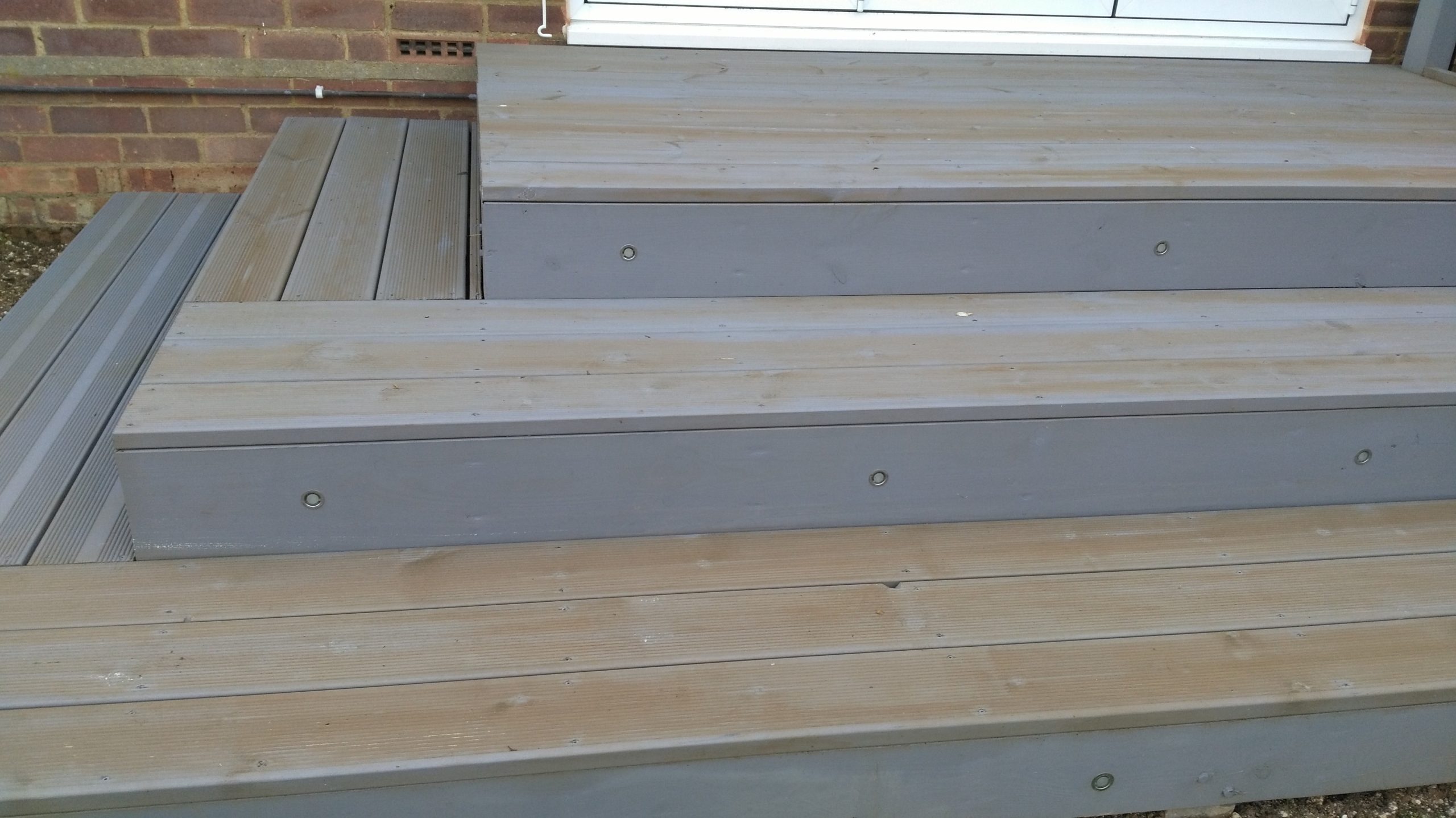

hello, I treated each deck plank prior to painting them with four coats of grey decking paint before they were fitted to the frame and it looked great – sadly 3 months later there are brown marks all along the decking which I thought was dirt from rain (we haven’t used it much to get it dirty as it’s winter) but when I tried to clean it off with patio cleaner it’s not touched it, also tried a spurt from the jet washer and all that did was start to strip the paint off but the marks are still there and it looks awful. The staining seems to be coming though the paint from the wood below but it can’t be mould as it’s too new, any idea what it is & how to treat it please? I don’t want to re-paint until I know what’s causing it otherwise it’s just covering up the problem. Thank you for your time.
susan
susan
ok, thank you for your help

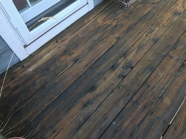

James Whitaker
James Whitaker
How do I remove the black spots?
What is the best way to cure and prevent future excessive blackening? I also have spots where the stain has come off. Thank you
