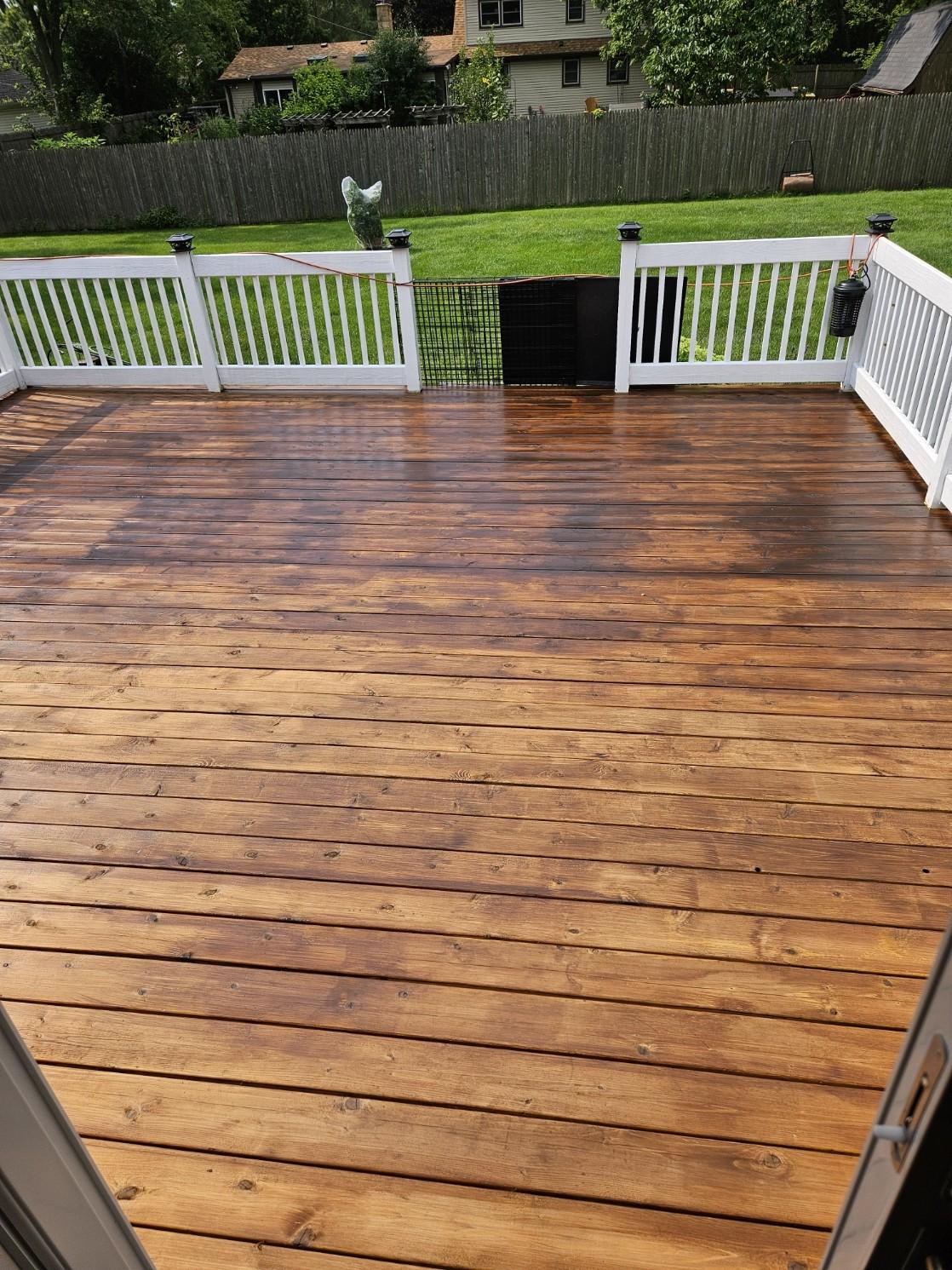

20240723_094324
A well-maintained deck.
That’s why staining your deck every two to three years is critical with a deeply penetrating stain. This barrier of protection resists moisture, sunlight, and other causes of damage. The staining process must begin with preparing the wood, by removing any existing coating completely, repairing any damaged boards, removing any splinters, and cleaning and brightening the deck surface.
