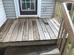

Deck after prep showing damp wood but not soaking wet.

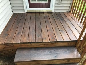

Our deck immediately after damp wood application

Josh
What stain is used in the above picture?
