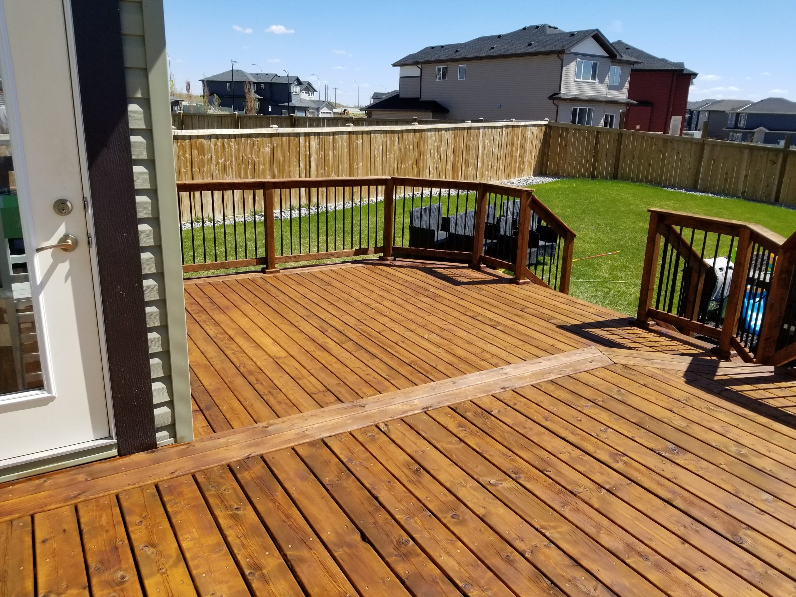

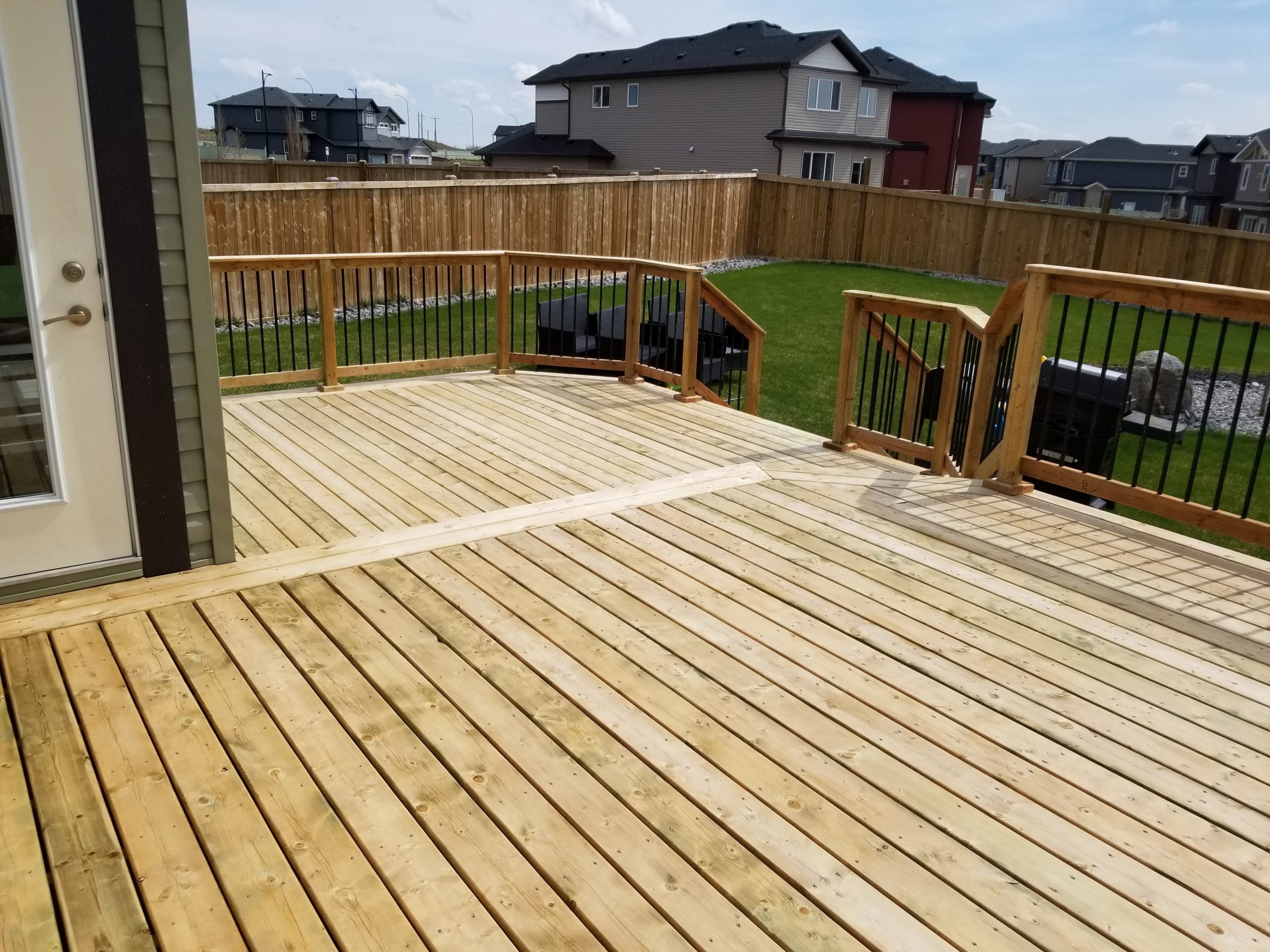

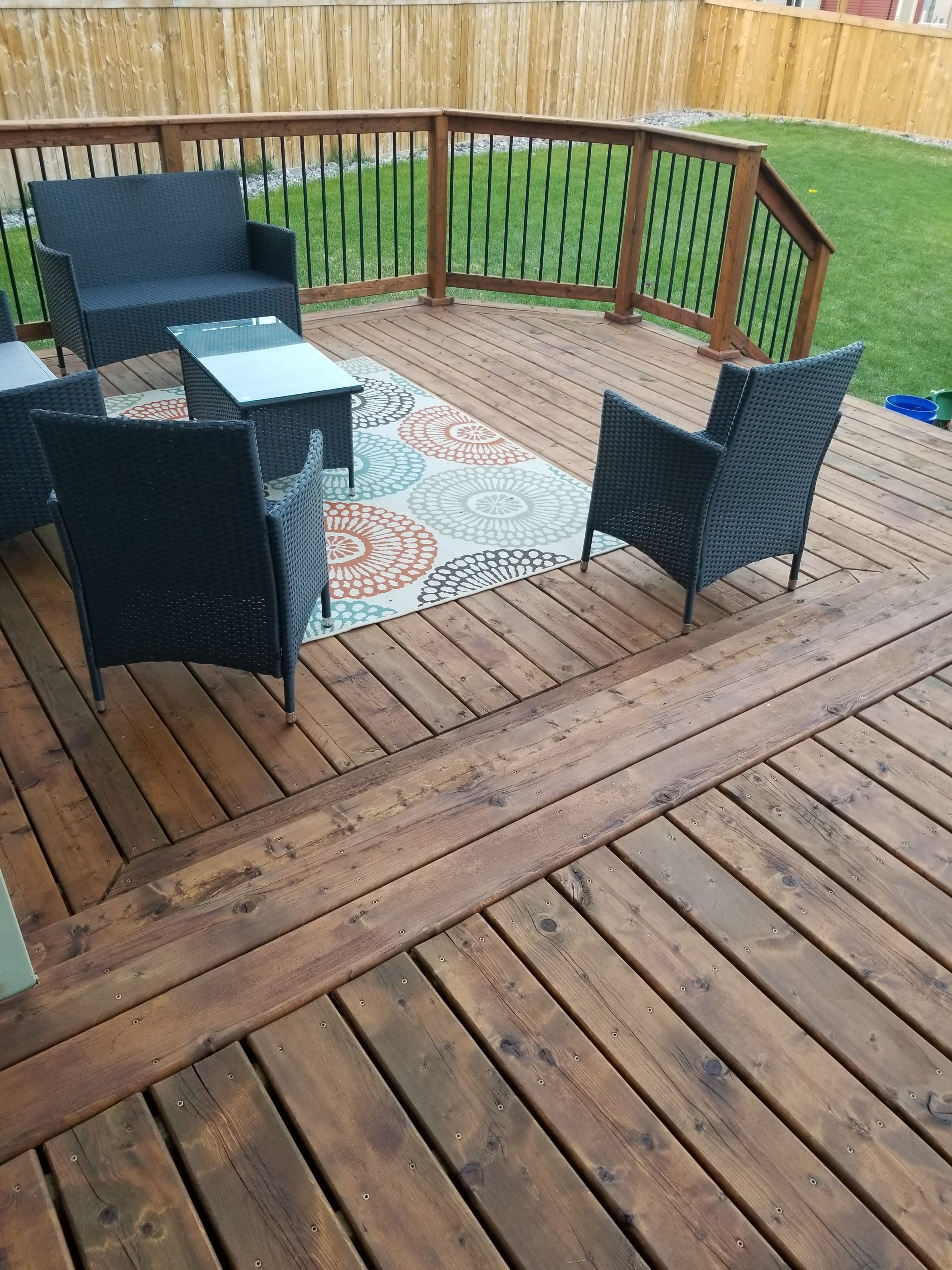

This is Natural Oak Stain. Looks amazing and was really easy to apply after cleaner/brightener!
Looks great!
