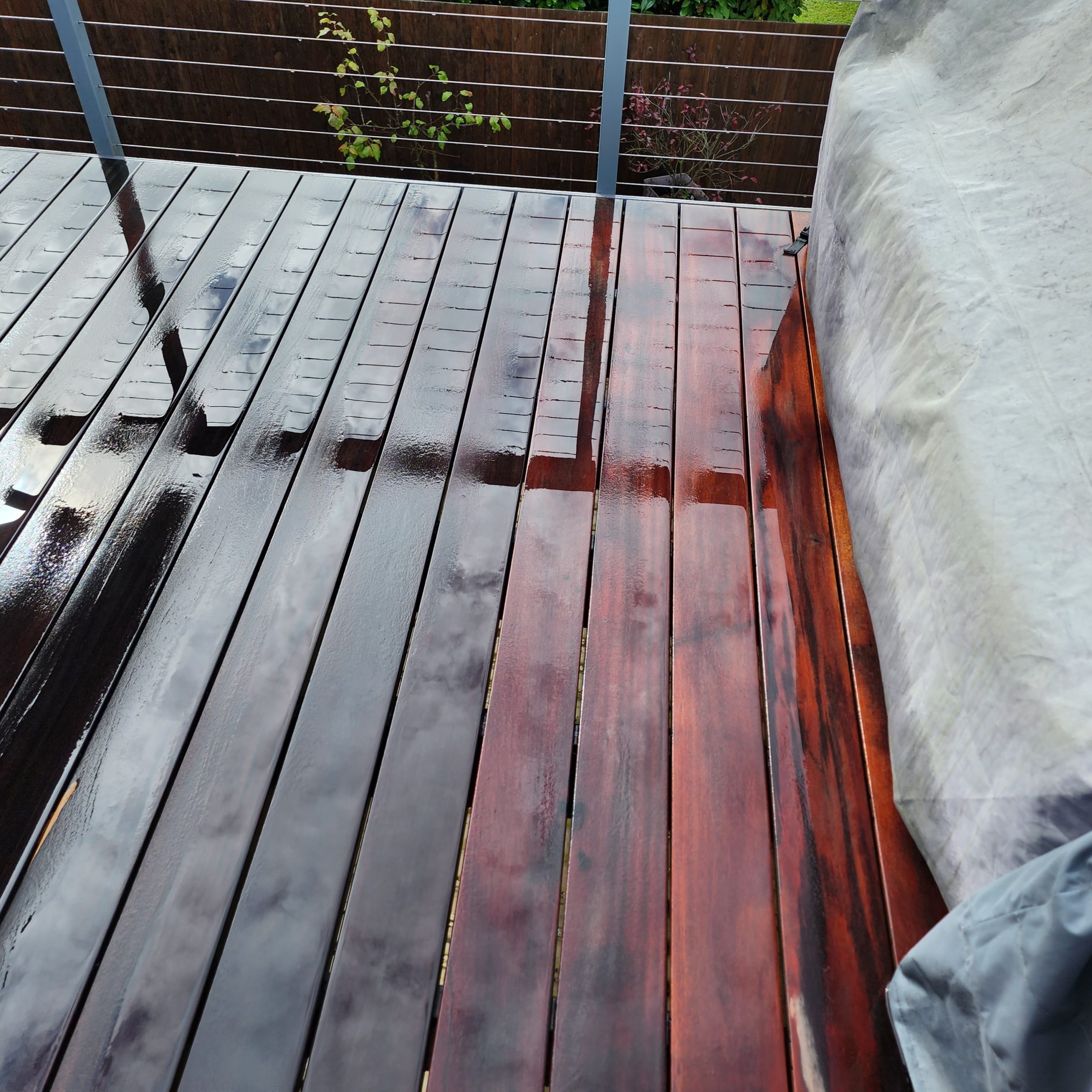

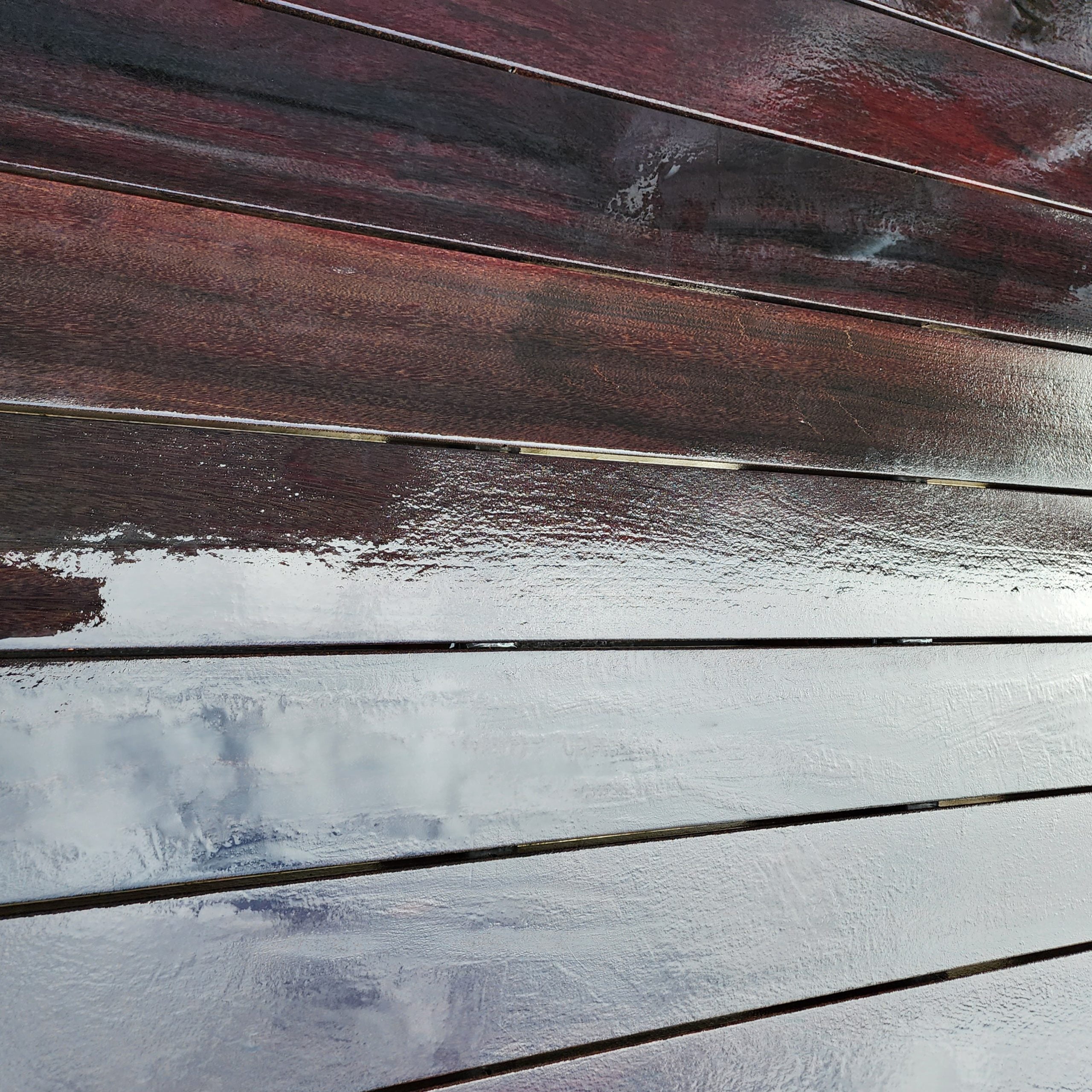

Same bottle, different color solutions. I stripped half the floor with the Original product. Worked as it should. Made the wood back to its natural state. Got the second bottle and it is straight garbage. Doesn’t work like the original formula. I thought it was me. I googled it. They changed the formula. It is not cool. Now I have to ether find something better or sand everything! Will never use this product again. I’ve used the original for 10+ years.

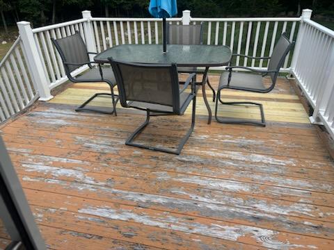

Hey there used behr premium stripper on a solid stained deck that was chipping all over used this product with a hard brush and a commercial power washer took all the stain completely off down to bare wood ,in my opinion the product worked amazing no issues I think as long as you follow the procedure it will work great
I used this deck stripper and it darkened tigerwood after use and left a film residue on deck boards that I cant get off. Can you offer any advice as to how to get this film off? I have tried the restore a deck cleaner, brightener, penofin stripper, pressure washed it, nothing gets it off. I have heard sanding doesnt work, I am desperate. I started using penofin stripper and got 2/3 of my deck done, looks great. It was a sunday, and store that sells penofin was closed, and weather window was short, so I went to home depot and bought Behr, since it had same main ingredient. Half the deck looks great, the way it did when I resurfaced it twice before, half of deck looks dark, gritty with a residue left on boards, and is slippery to walk on when wet. PLEASE HELP ME, WHAT PRODUCT CAN I USE TO GET THIS CRAPPY PRODUCT, ESPECIALLY RESIDUE FILM OFF. AM REALLY DESPERATE

I purchased the Behr wood stain and finisher stripper and was very disappointed. We followed the directions carefully several times and rinsed the deck thoroughly with low pressure washing.
after the deck dried it left my wood with a film residue and where it did try to come off there small rolls of ?.
We tried 150 grit sandpaper and it did not remove the rolls which could possibly be stain.
We do not know how to remove the ashy film on the deck, we did try using deck cleaner to revitalize it. Didn’t work.

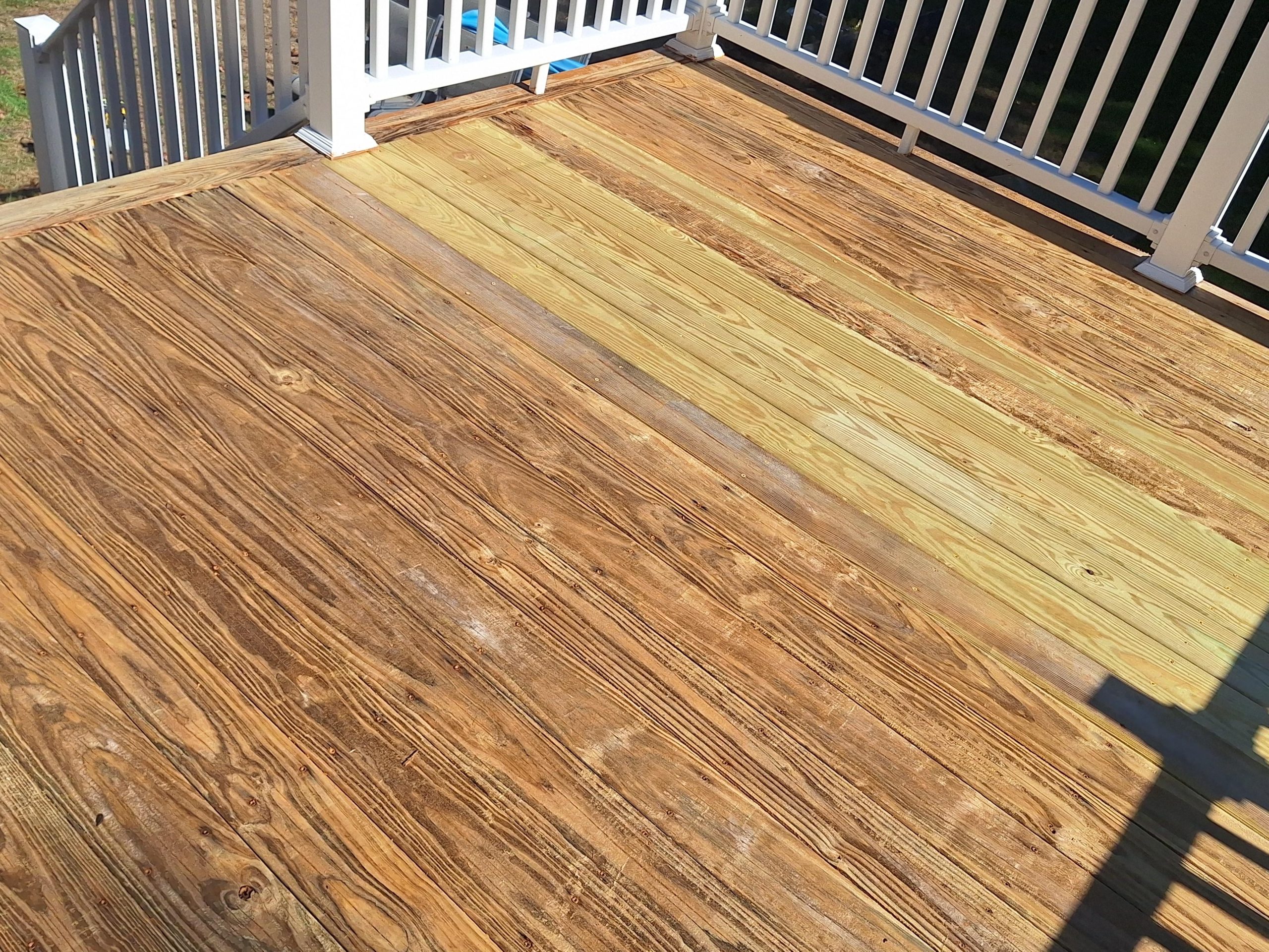

I just finished stripping our deck with this product. It worked pretty well once I got my routine down. A lot of the reviews I see didn’t follow the directions it seems. First of all it states on the bottle it is not to be used with a pump sprayer….
My process (which pretty much follows the directions, with an additional scrubbing)
1. pre-wet the boards, not soaked, just damp
2. apply the stripper with a paint roller liberally over the boards, working it in well
3. spray a little more water over the boards
4. with a strong bristle brush, scrub the stripper into the boards well
5. wet again, with a light cover
6. wait about 15 mins, and scrub well again
7. wet again with a light cover (the bottle says to keep the boards wet) not drenched, but just wet/damp
8. let sit for another 10-15 minus, keeping damp as needed
9. rinse well!
This worked pretty well for my deck, and it was hard work. But it did remove the stain. I wouldn’t have done my whole deck if it wasn’t working. But it is hard work. My thought is people aren’t putting in the effort to make this product work…it is hard, long, wet work.

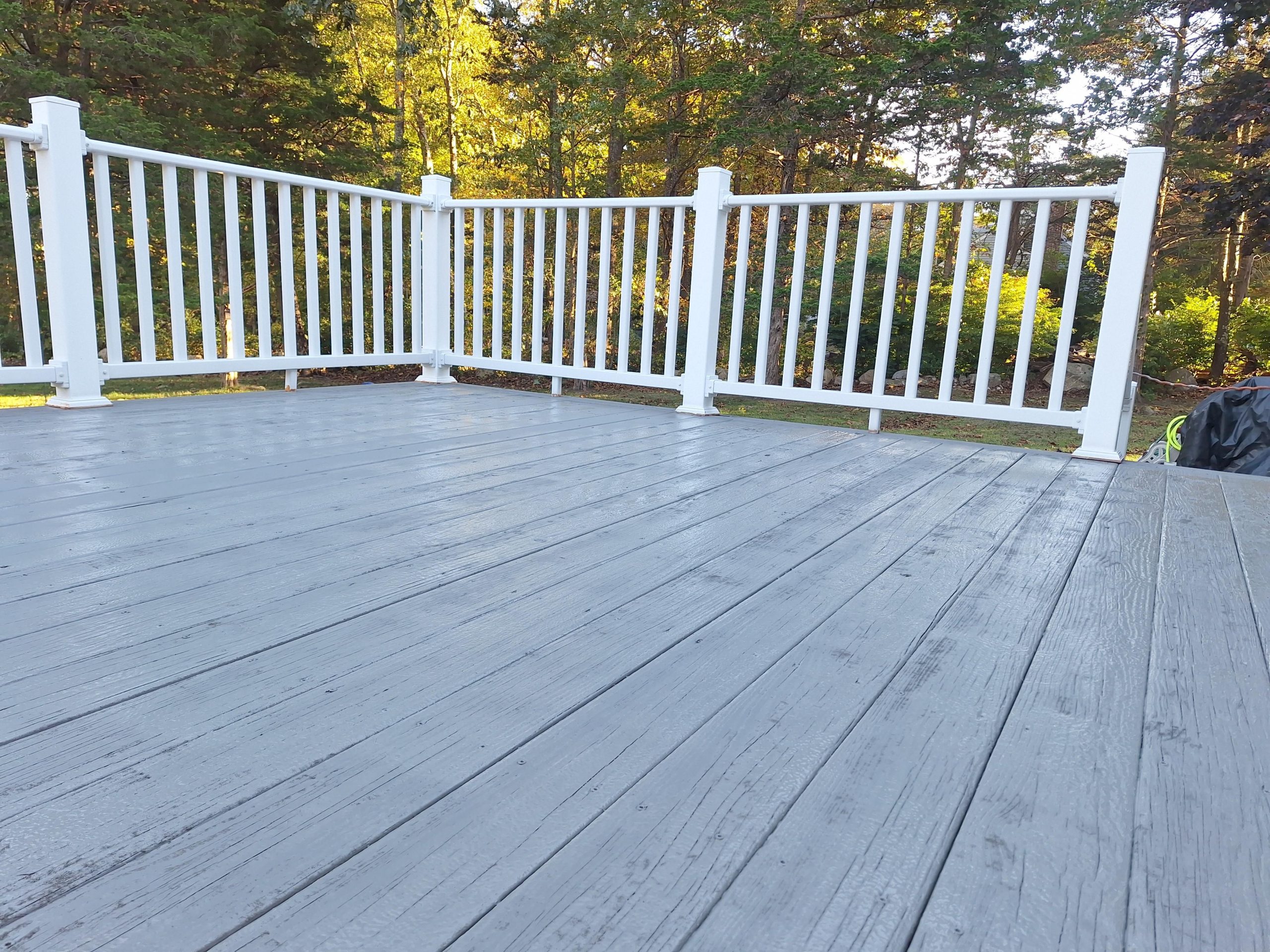

OK so I’ve had some luck with 17 gallons of this product. I’m in AK where most of this sites recommended products are not available. I have a 2000 SF cedar deck that had 4 year old Flood UV5 oil to remove. I didn’t hate the stain and may do it again. I waited for a cloudy rain forecast day. While the deck was dry I applied Behr no.64 using heavy duty 2 gallon Chapin poly pump sprayer. The product is thick so the cheap model sprayer won’t work! No. 64 clearly separates while sitting on HD shelf for years, this is a big problem if you don’t notice it. To fix, open container and poor half the gallon in the 2 gallon sprayer. Close half full jug and shake vigorously to get contents off the bottom of jug. Poor remaining in sprayer and shake in larger volume sprayer to completely mix the product. Mixing very important! Spray on deck in 30 minute sessions. Do not let dry. I worked in sections so I could apply product without it drying. High humidity days slow down drying and help a lot! Using the product full strength without water misting greatly improved results. Do NOT work in direct sun or wind. Moist cloudy calm morning best! If it drys simply spray more no. 64 on top. Keep water close and wear full rain gear, rubber boots and safety glasses. When the mist hits you in face it BURNs! If it starts raining you can simply look up to help with the burn! After 30 minutes at full strength I used a stiff push broom to quickly work the deck. It was a big mess but the product dissolved most of the oil based stain as advertised. It seemed to really soften the top layer of wood so I opted for garden hose rinse vs pressure washer. (Mine is 70 psi so a bit higher than most). Interesting enough I also tried warm water (100 Deg) which improved rinsing of the stripper and removal of stain. Note that this stripper stays active until you spray on brightener. So after you have fully rinsed you can wait another 30 minutes and rinse again until rinse water clears. Overspray of this product kills green leaves quick! Water all plants thoroughly then cover with plastic. Grass got a little yellow but did not die, water it first too.
I applied Behr Brightener as a follow up while deck was still wet. I got a cheaper second pump sprayer that worked fine for this thin liquid. Use at full strength on wet deck vs suggested 50% dilution on instructions. Rinse fully and let dry.
After deck dries you can clearly see where you have missed. Repeat strip/brightener on those spot areas as needed.
I have also tried this product on Behr Acrylic stain which it does not work. Paint or solid stains nope! For oil based clear or semi-transparent stains it works ok, albeit expensive.
