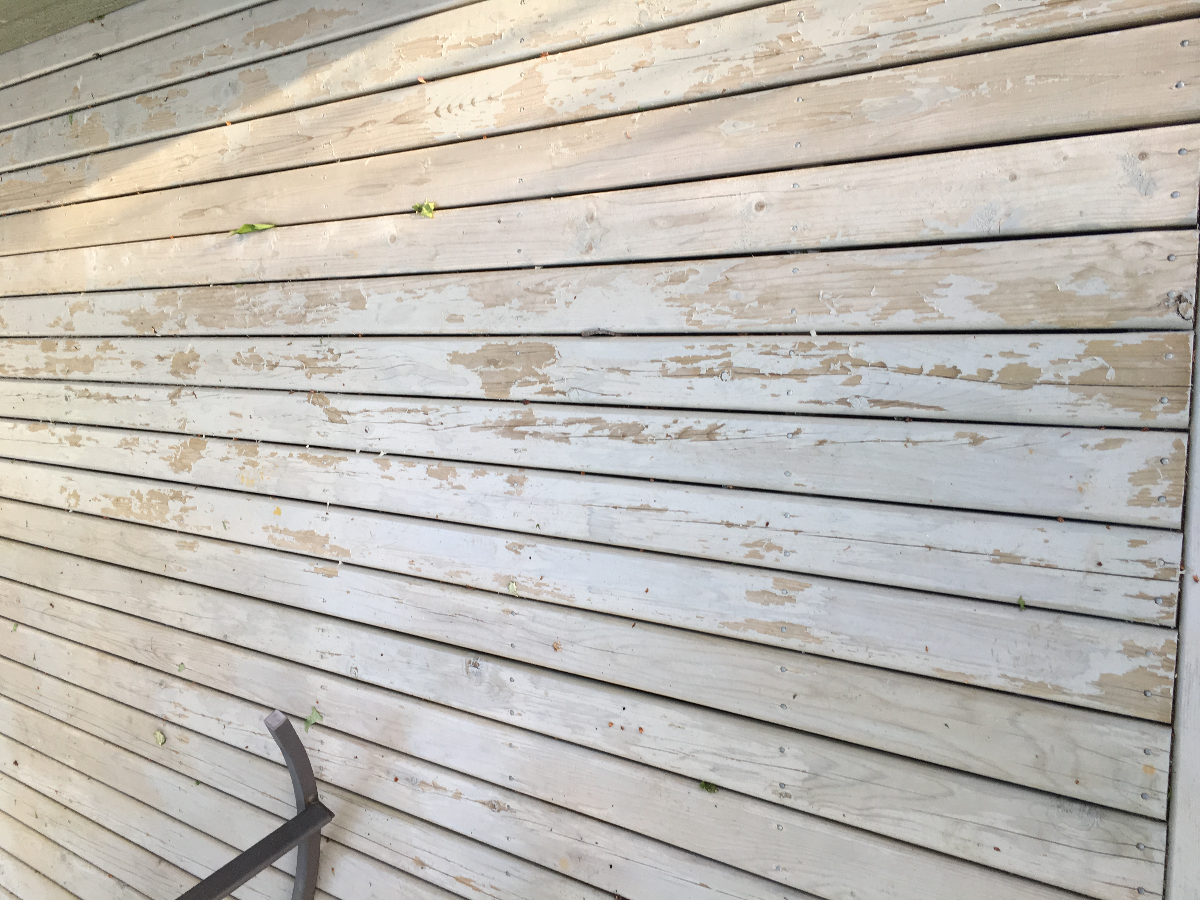

3. Wear/Tear and Peeling: 1
Arborcoat Failure
Arborcoat Peeling on Deck
We applied this stain in the summer and got a call from the homeowner the following spring to look at the deck. On inspection, we were extremely disappointed. The Arborcoat had peeled significantly on the brand-new pine deck. Patches of the finish had peeled off the wood in strips. You could peel back large sections of stain with your fingers. The product did not seem to have penetrated the wood at all.

After less than a year, the customer was so displeased with the deck’s condition that they requested that the Arborcoat be removed. A traditional deck stain stripper did not remove the stain or topcoat. Power-sanding was needed, which cost the unfortunate consumer a substantial amount of money.

It’s the same as mine I put it on last year, and it peals off in large strips and the wood under does not even look like it had anything on it. Terrible

Here’s my No2 cedar deck one year after ArborCoat. Terrible.

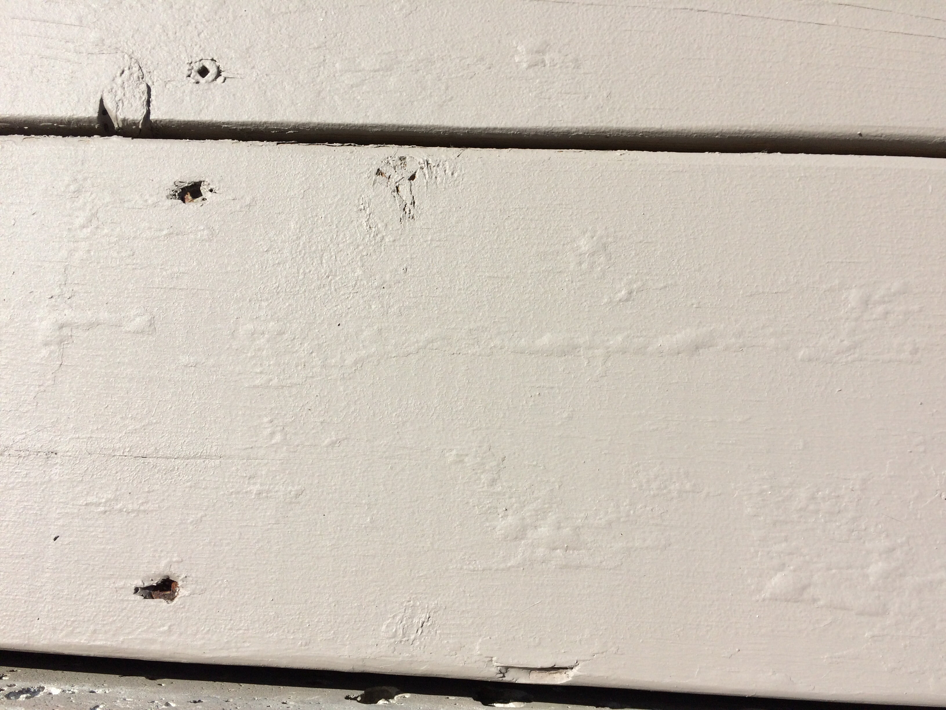

I am beyond upset about the Arborcoat solid stain that we applied to our deck. We have stained the deck numerous times over the years with other products and never had such a bad problem as we are now. We did everything right from application to letting it dry properly. It has been nothing but a horrible experience ever since. My dog’s paw prints stick to it and cannot be washed off. I’ve tried everything. And even a representative came out to look at it. I need some recourse!
g carris
g carris
Reply to  Sheila Daout
Sheila, EXACTLY our experience. Sanded 700 Sq Ft deck on lake & EVERY footprint/pawprint sticks out. The deck looks filthy. The rails are peeling. Rings End, Danbury CT came out to inspect & gave us a gallon of Krud Kutter to clean. That’s not the problem. this is NOT a stain. it sits on top of the wood & attracts dirt. Any suggestions?
