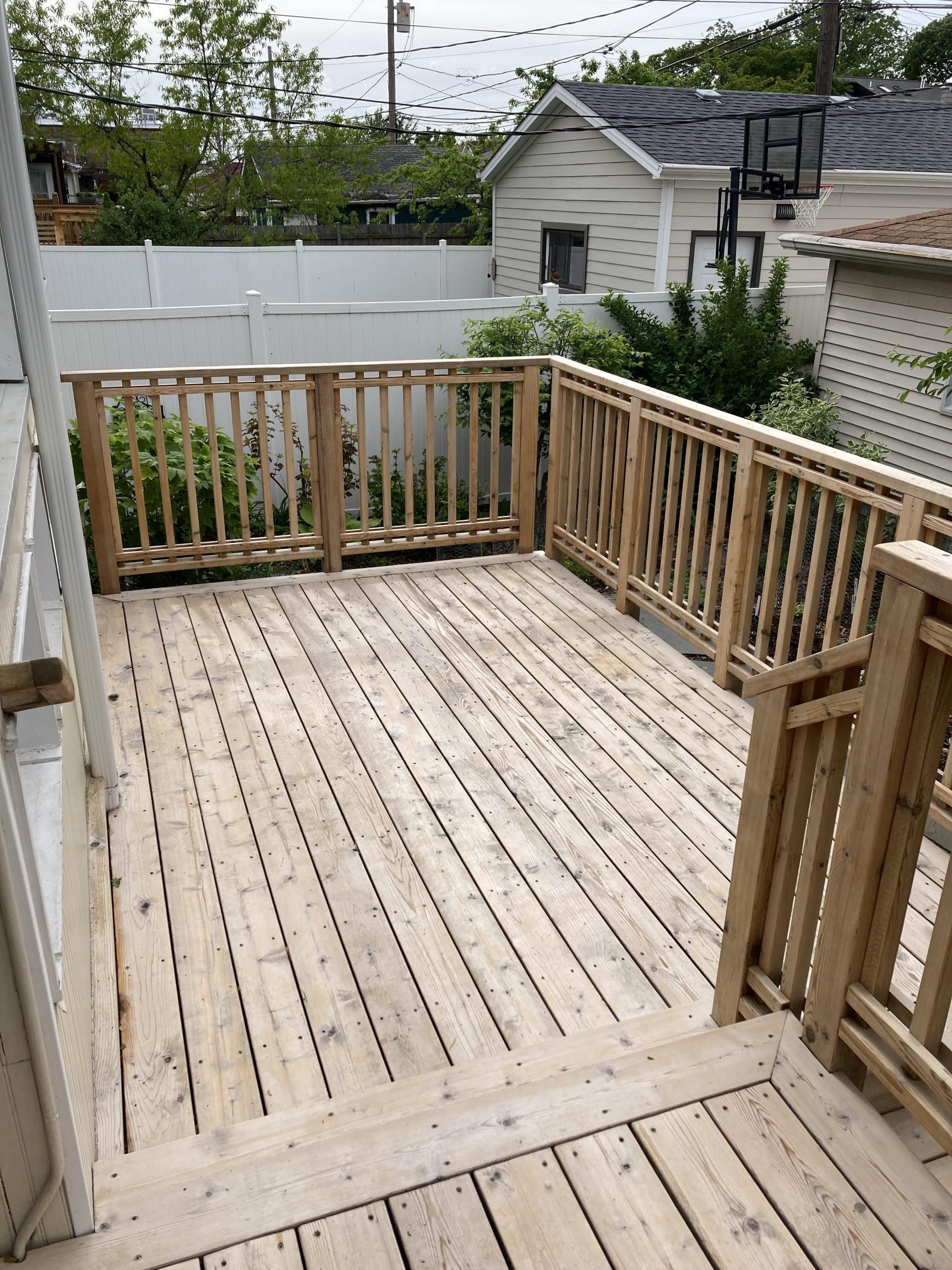

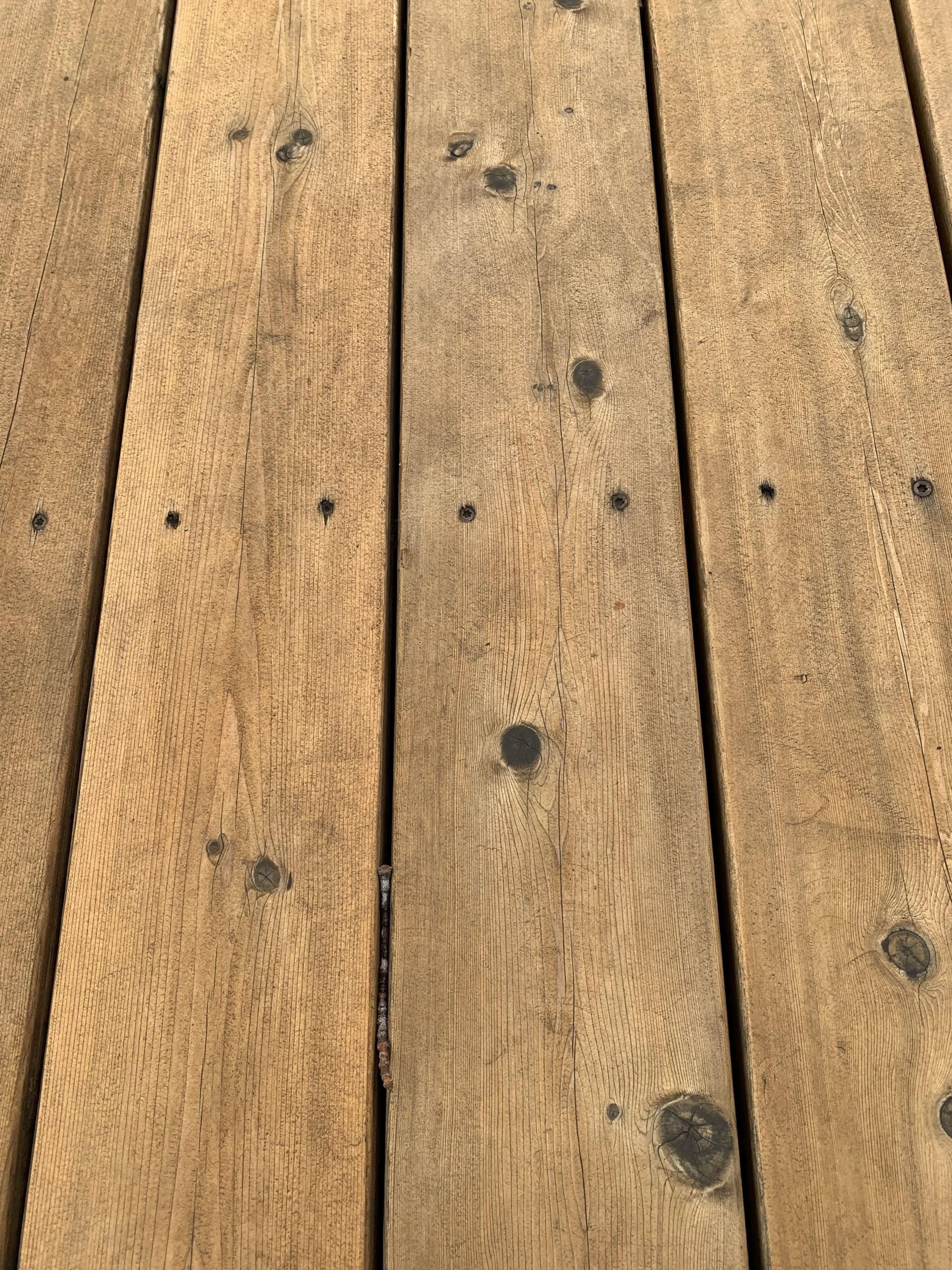

I went ahead and ordered restore a deck package for our port orford cedar deck. There are significant grease stains from dogs and bones, what can I prep those areas with to get the fats that have darkened areas of the decking?
Those may not come out as the grease stains can be deep into the wood grain. Prep products remove dirt and other contaminants at or near the surface. If deep, it will not come out.
Rats, I’ve read elsewhere regarding dish soap and also baking soda as agents that might help. Give it a try, unless they make things worse??
Sure, give it a try. It really depends on how deep it is. Brighten all when done to even out any potential issues of color change.

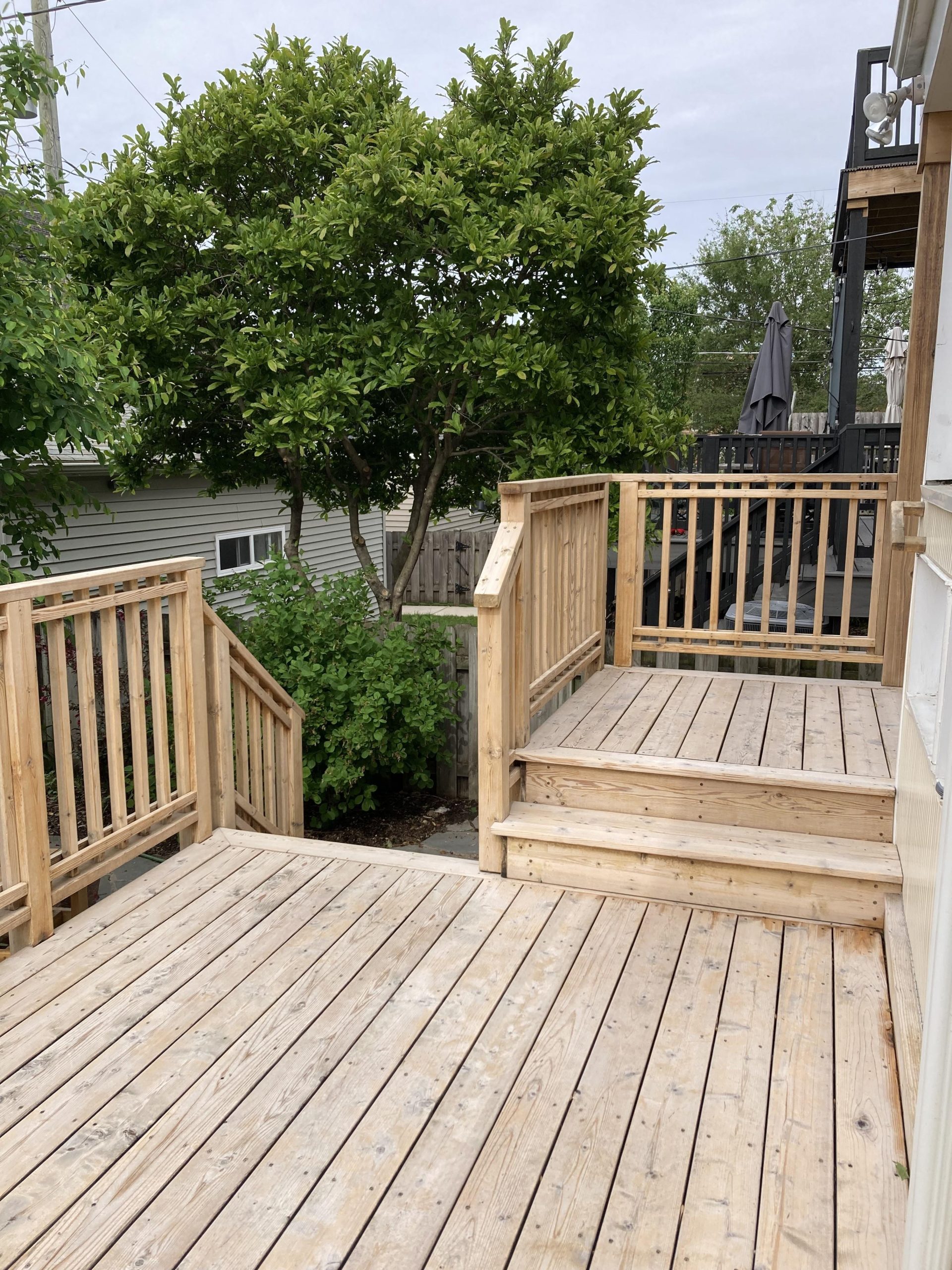

Hello again, from Chicago, with my progress report. what a process! Between the rains, the unending cold temps, health setback and general snafus, I finally completed the stripping (of the blackened penofin sealer) and brightening of my ’24 cedar deck, using the products you recommended. What an awesome difference!
Now, MUST I apply a sealer of some kind? or can I just let it get old and silver like me?!
If I must, how soon? I wish it could stay like this! (pics taken today after finishing)
Summer is just now getting close, sun and temps wise, so it’s getting hotter!
Thank you so muck for your advice and help!
A clear sealer will not provide UV protection against graying, but it can protect against water, mildew, etc. If you want to prevent the graying, then you need a semi-transparent stain. Which do you prefer?
I want the wood to age naturally, to grey/silver. If a sealer protects against mildew and water damage, I’m happy to apply some. What do you recommend, and when is the best time to apply?
The pic didnt post for my original message. Compare to ones I sent in March.
Two options for a clear sealer that you can apply now.

thank you. I think I’ll stear clear of oil based product this time.
I’ll use the Defy water-based if you advise it to be better than nothing!
I am using the clip but still see no pics… one more try…
there I see it, as before, until I click post comment. “HEIF Image – 2.8 MB”, could that be the problem? I do want you to see the results!
Size and file type. Make it smaller and switch to a JPG or PNG file.
3rd time’s a charm…?
Nice job!!
Thank you. and now I will order the Defy product and be done with it!

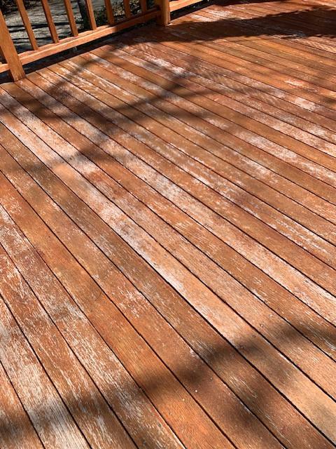

Two years ago I had my mahogany deck which was blackened and stained with mildew and mold “cleaned” using Jomax. It turned white and the Cabot oil stain which was applied did not last. Now I need to have it redone. There is some mildew present and how should that be removed before applying a primer and two coats of a Cabot solid color acrylic stain? The painter has proposed using Jomax again. Is there an oxygenated alternative or has irreversible damage already been done to the wood?
Add some pics in the comments for prep help. FYI, do not use primer with deck stains.
This picture shows the deck floor which was treated with Jomax two years ago and the present condition. I assume that the green mold needs to be removed before the solid stain can be applied. What oxygenated product do you recommend for this procedure? The painter wants to use a primer followed by two coats of solid stain in order to cover the present mess. Why do you not recommend this action? I think I need to forward that information to the painter.
Primer is not suggested for deck stains, including solid colors. Why do you want a solid color stain? It will mask the beauty of the Mahogany and will be harder to maintain as solid stains peel.
The Jomax with the added bleach has “cemented” the pours pf the mahogany and the stain cannot penetrate the wood. It just flakes off and leaves the white surface of the damaged wood visible. It has been suggested that the deck be professionally sanded down to fresh wood and stained with an oil stain. This procedure is very costly, and I am willing to sacrifice the beauty of the wood for a solid color surface. Is there an oxygenated product that would remove the light greenish mold and a deck paint that could be used to cover the cleaned surface? If this is a possibility, should a primer be used with an oil base or acrylic deck paint? The deck is not used frequently, but is exposed to the New England weather.
I really appreciate your prompt response and advice. Thanks!
Don’t use paint or promoter on a deck. If you want an opaque look, use a solid color deck stain.
Have you tried to strip off the current coating and the white marks? I have never heard of a bleach or a cleaner causing the pores to be cemented.
The Jomax with the required bleach turned the surface of the blackened mahogany into a hard white nonporous surface. “Cemented” was my term used to describe that condition. When the oil stain was applied it did not penetrate the wood and flaked off leaving the white streaks shown in the photo. Will a solid color acrylic deck stain cover this mess and last for a few years without peeling? You do not recommend using a primer? The only way to remove the bleached coating would be by sanding which I am trying to avoid because of the expense and possible damage to the mahogany.
A solid stain will cover this. Primers are never used with deck stains.
This is another picture of the deck floor.
Deck floor (with tree shadows!)

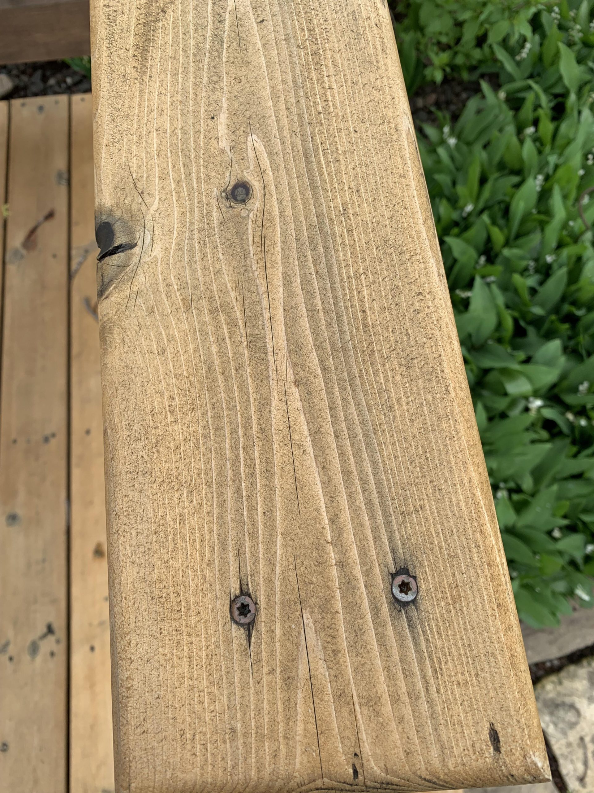

Hello. I happened on this site looking for information on WHY it happened and how to get rid of the black dirty residue on the horizontal parts of my new cedar deck. I am in Chicago. It was built in July ’24, sealed in April ’25 with Penofin oil type sealer. I spoke with a Penofin rep, explaining that I wanted a CLEAR sealer, that I wanted the cedar to age to the natural silver/grey and he assured me that it will happen. I very much regret that process as it is really ugly, dirty and dingy. At my last home, I left a 30+ year old treated pine deck that I only washed occasionally. It never looked as bad as this wood after only one year! I almost regret the extra expense for the cedar. Very disappointed. But now what do I do? Will it ever age to the silver? Will I need to wash it – and how? – every year?
The contractor began using the Penofin Marine sealer on the railings/balustrades and it was orange to me… I really do not like orange! So I went to another store for the CLEAR Penofin blue label sealer for the deck floor. ALL the horizontal parts, floor and rails, are dirty. Is it Chicago air, a mile from the big lake MI? or the Penofin? One worker told me, AFTER, that he would never use an oil based sealer (as recommended by his boss). NOW he tells me! I should say that the deck was quite blackish before it was pressure washed and sanded before the application. It’s almost time to do SOMEthing before bringing my potted garden back out onto the deck… on north side of my home, mostly shaded except the 3′ stretch where I place the flower pots (as seen in photo). Thanks so much. I learned a lot from the comment section here. unless you tell me otherwise, I think I’ll just use some dish soap (any? Dawn?) and a brush and light power rinse.
Penofin has known issues of darkening in color and getting dirty: https://www.deckstainhelp.com/penofin-ultra-red-label-stain-review/
To fix it, you will have to strip it off fully and then brighten the wood. Use this kit:
Do not use Penofin again, as the issues will repeat. For a true, clear sealer, try TWP 1500 Clear: https://www.deckstainhelp.com/product/twp-1500-series-1-gallon/
or Defy Extreme Clear:
https://www.deckstainhelp.com/product/defy-extreme-clear-1-gallon/
Both will silver and gray over time and will not enhance the wood grain or make it orange.
Thank you Scott! I’ve got some work ahead…
And I will pass the Penofin advice along.
Another question – will I need to repeat the clean/seal process again?
You will need to strip, brighten, and redo with a proper “true” clear sealer now. Redo every 2-3 years down the road is normal.

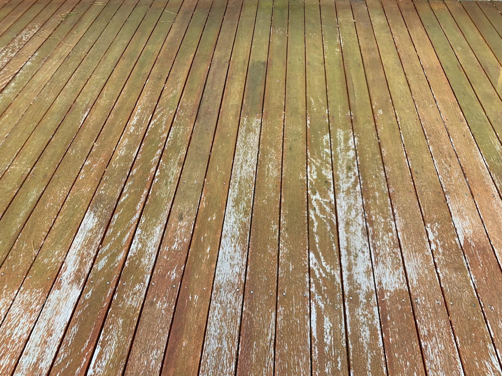

We installed a new deck surface about 7-8 years ago. We live in a very humid area and by the end of August the shady parts of our deck ( near our house) are almost completely black with mildew stains. We have Ready Seal stain. In the past the only cleaner that seemed to work was Olympic but it removes whatever stain is left so I would have to stain every time I clean it! Quite a process. I’ve tried the Restore-a-deck but it never completely removed the stain and I had to go back to the Olympic again. Any suggestions on how to get better results? I have a pressure washer but it seems to damage the wood fibers so I typically do more of a soft wash with that.
thanks!
You would need the Restore-A-Deck Stain Stripper (not cleaner) to fully remove the mildew and the Ready Seal.
Once removed, you might want to try a stain that does not attract mildew, like the Restore-A-Deck stain. The RAD Guard would help after the staining to prevent the mildew from returning:

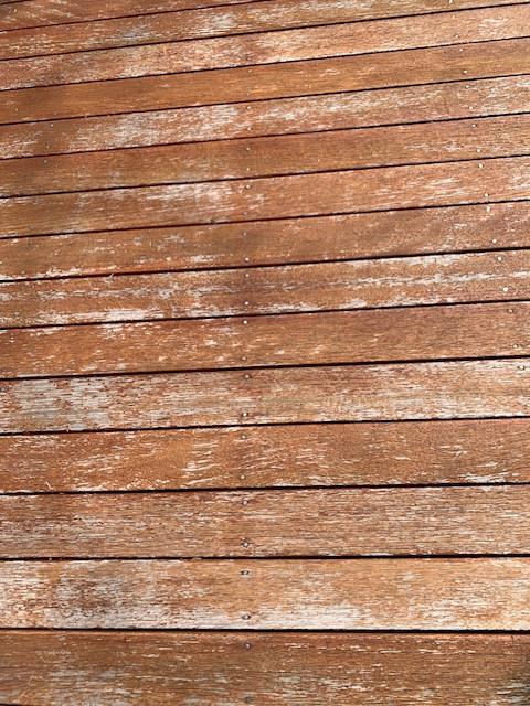

Hi Scott – I appreciate this web site with its very helpful advice on deck care and maintenance. Do you have a comment on Deck Wise products: Ipe Oil Hardwood Deck Finish (photo attached), Deck & Wood Cleaner, and Deck & Wood Brightener?
Attached below are three pictures of the my eight year old exposed mahogany deck over the past several years:
Picture #1 – Taken 8 years ago after applying BM Arborcoat, it looked great when the stain was applied but this stain flaked after a year so I had to sand it off.
Picture #2 – Taken 5 years ago after cleaning and brightening with Deck Wise products; it looks ok but the wood has darkened more in tone and uniformity than I prefer and the shine is fairly flat.
Picture #3 – Taken today after cleaning the surface with Murphy’s soap and before applying an oxygenated wood cleaner and brightener.
Is there a process and product you recommend to lighten the deck wood and result in a glossier sheen?
You should strip and brighten the wood to fully remove the Ipe Oil and restore the lighter natural wood color. You cannot have a “gloss” when it comes to deck stain coatings. Having a shine or gloss will result in the coating peeling and blistering.

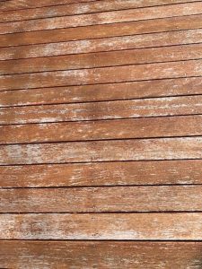

I really appreciate your web site and all the helpful advice you share. Can you please comment on Deck Wise products: Ipe Oil Hardwood Deck Finish (picture below), Deck & Wood Cleaner, and Deck & Wood Brightener. That is what I have been using on my deck over that last five years. Attached are a few pictures of my exposed 6’x18′ mahogany deck.
Picture #1- is the deck 8 years ago after refinishing with BM Arbor Coat; achieved the look I want but the shiny surface flaked off after one year and I had to sand it off.
Picture #2 – is the deck from 3 years ago after using Deck Wise; it works and looks ok but the wood has really darkened and I would prefer a higher sheen.
Picture #3 – is the deck taken today after washing with Murphy’s Soap but before applying a brightener.
Can you please recommend a process and process that I might use to achieve the look in Picture #1 to lighten the wood color and achieve a shiny look that will not flake off?
