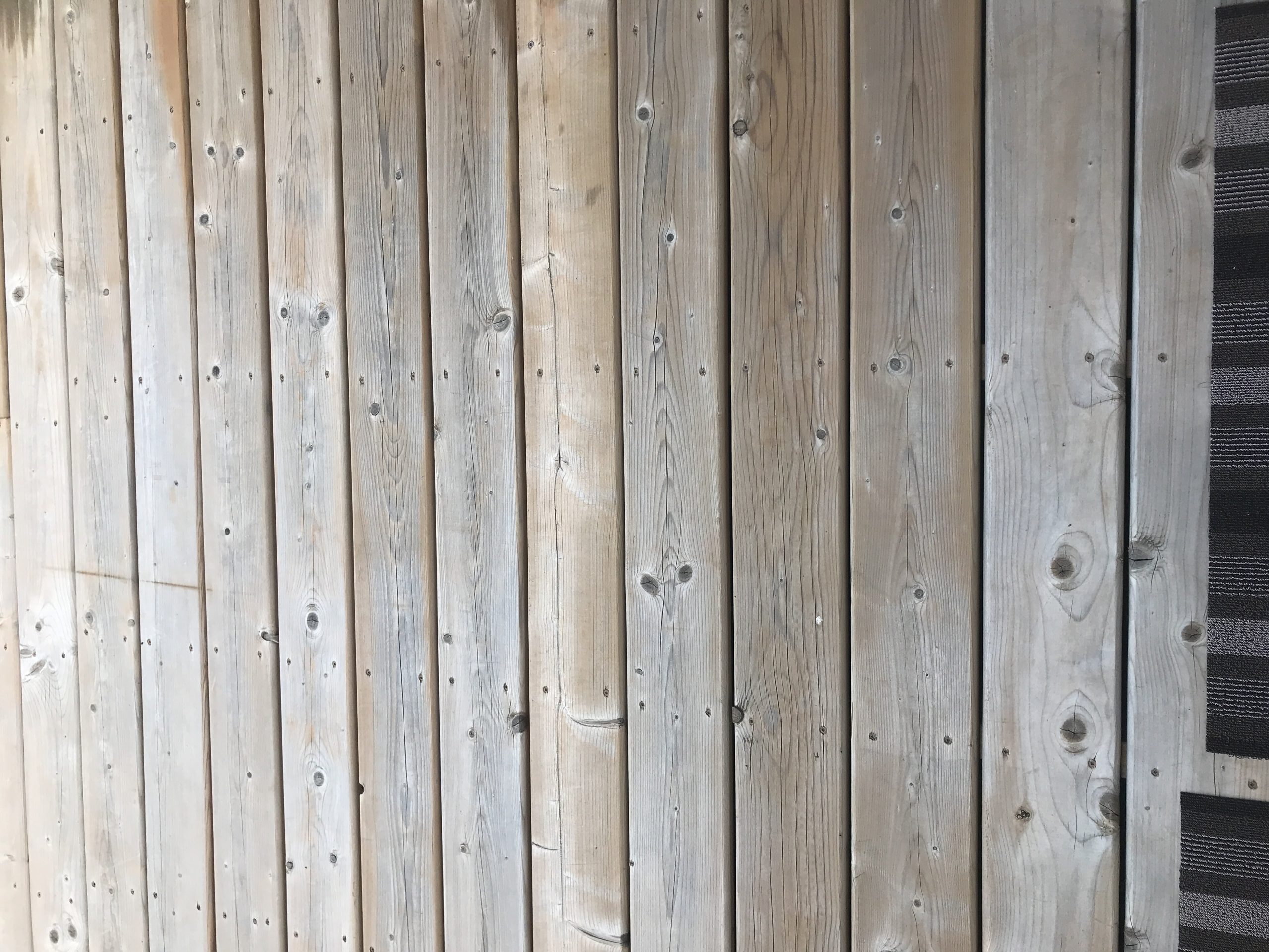

I’ve used restore-a deck 5 times (twice pressure washed) and can’t get all the grey off my ipe. Was finished 3 years ago with clear Messmer’s for hardwoods. Is TSP out of the question? Am I left to sanding?
Yes. Your pressure washing marks will need to come out with sanding.
Thanks. Then restore a deck will take out remaining grey after that?

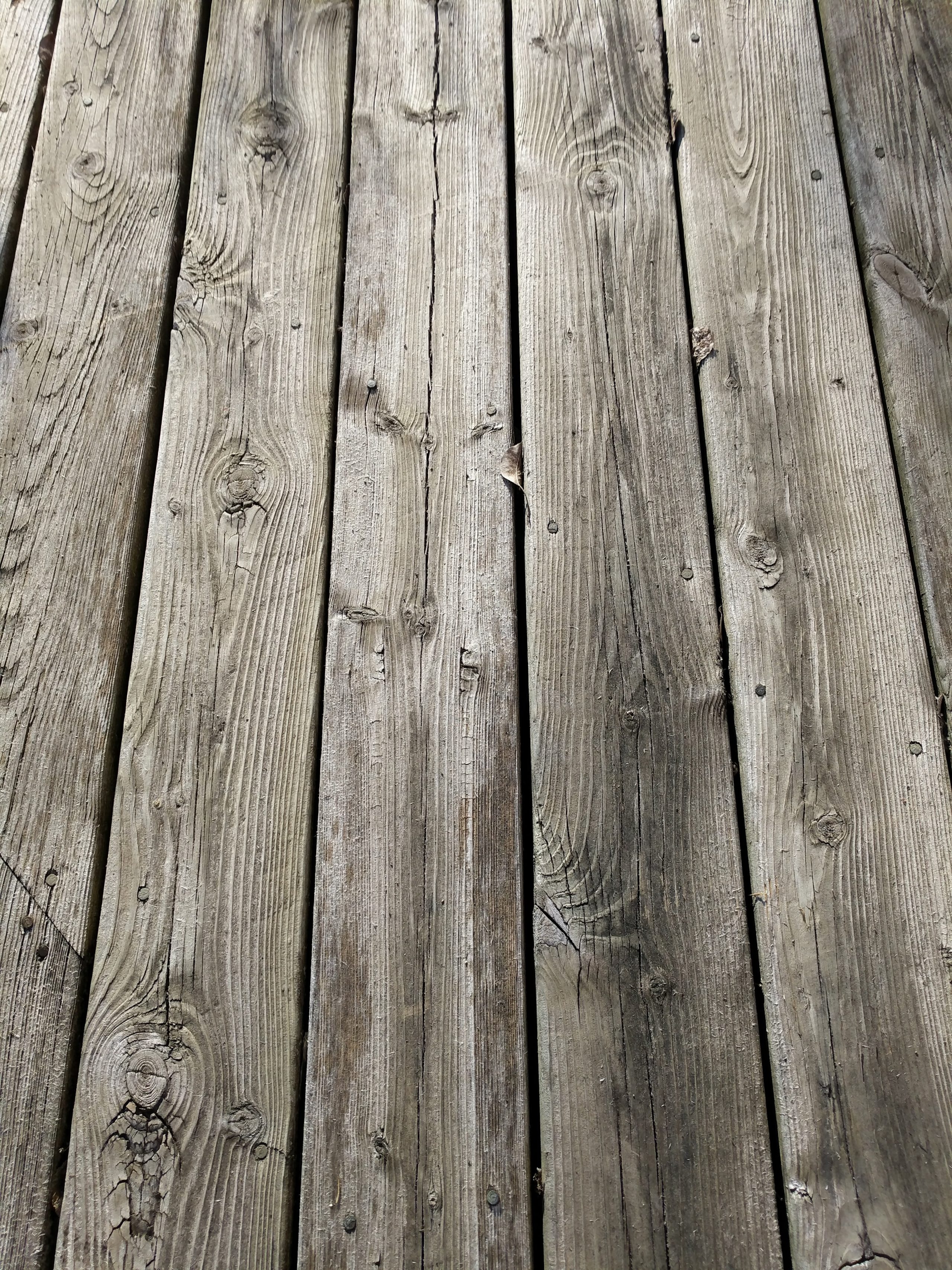

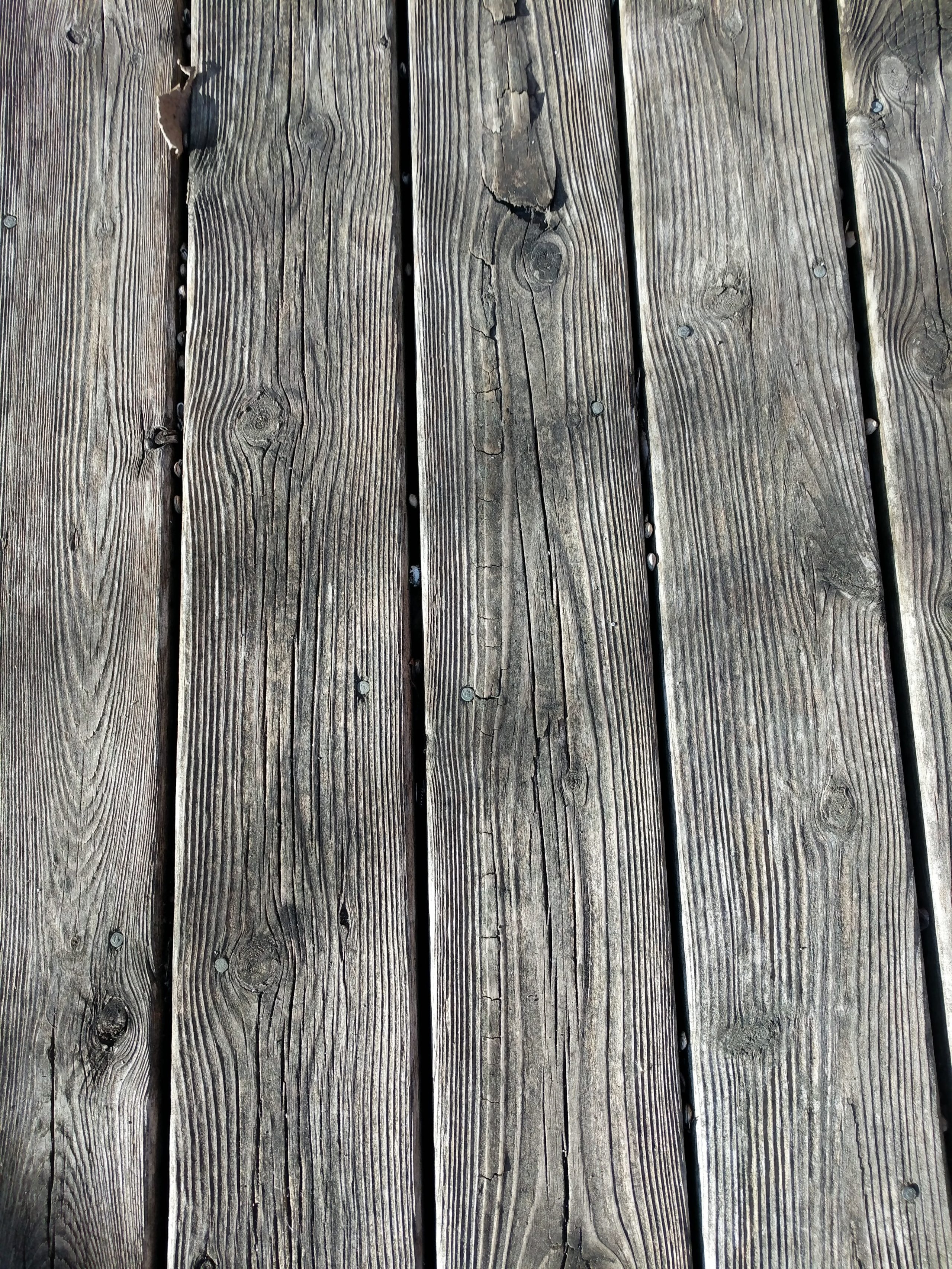

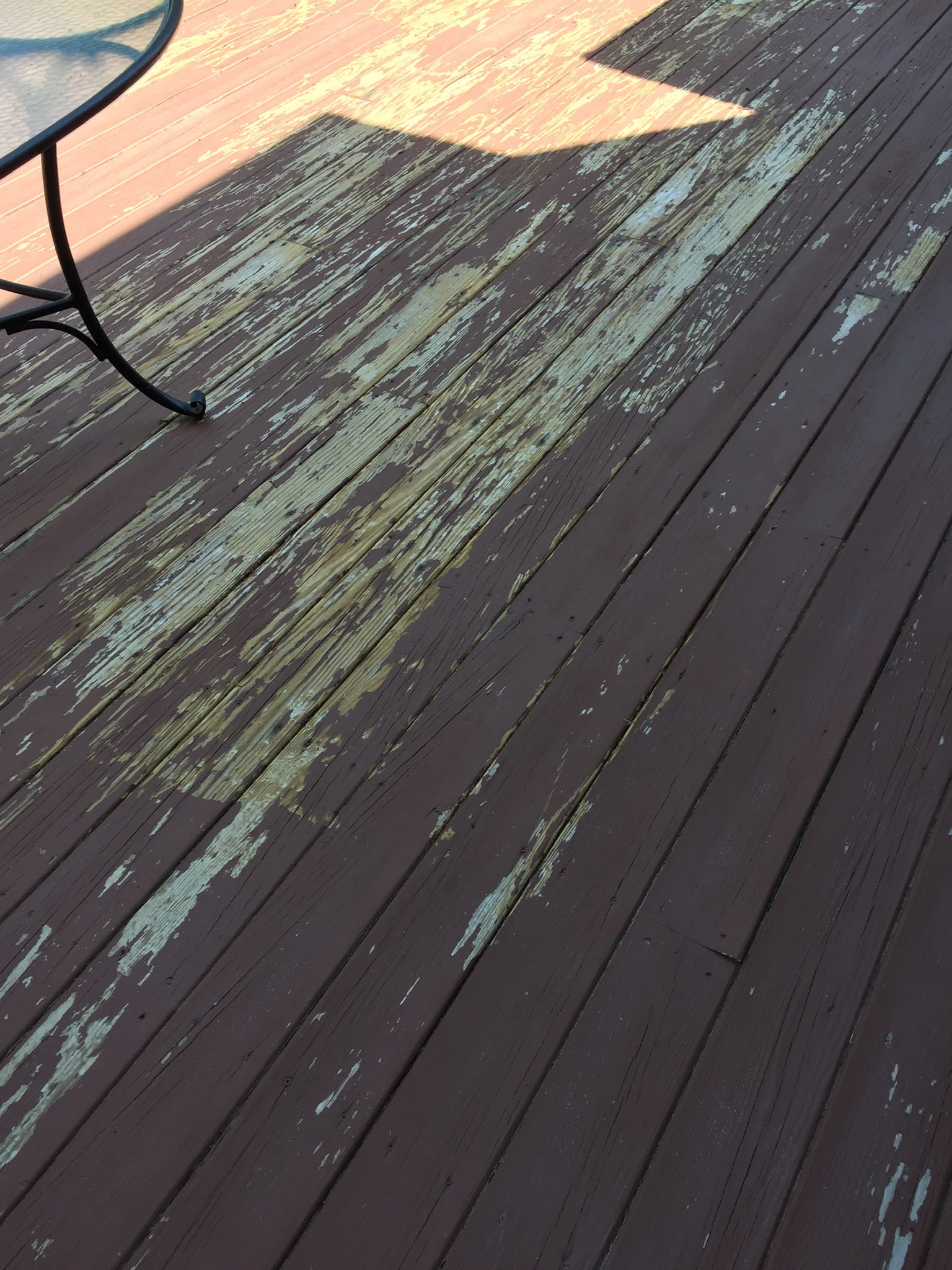

I live in New England where decks are subject to extreme cold and snow in winter, lots of rain in the spring and hot, humid summer days. I had a new, low level deck out of pressure treated wood (first bad decision) built 7 years ago, 15 x 24. Sealed it myself after letting it sit for one season. It grayed and looked dingy at year 2, so I cleaned it. But I didn’t like the the inconsistency of color, some spots brighter than others, some spots very dark – so I stained it in year 3 with a product from Lowes. Big mistake. The stain began peeling the following season. I lived with it. At year 5 it needed a good cleaning and re-staining. I decided to hire a professional to clean and re-stain with Benjamin Moore Accolade, which is what he recommended. Another big mistake. The finish was a magnet for mildew and pollen and also peeled slightly. So this year, to save $, I decided clean my deck myself. Used Olympic Deck Cleaner to clean the stained deck – based on advice from Home Depot customer service rep. Another bad decision on my part. It took off the mildew and pollen along with removing the stain in several places. It also left a white, powdery film that I cannot get off no matter how much I brush. The professional’s advice is to completely strip the deck, clean, and re-stain. The cost to do so is 50% of what replacing the deck boards will cost me and I am still faced with seasonal cleaning & sealing. I could be a commercial for composite decking or stone patios. Am weighing my options at present.
Post a picture.
Picture posted as requested
The easiest and least expensive thing to do at this point is to pressure wash for prep and apply a solid color stain over all. See if that works well for a couple of years.
That is what the painter did last time for $1200. It lasted one season. Thanks for the input. I decided to remove the boards and go composite.

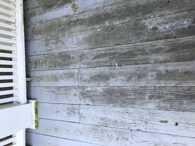

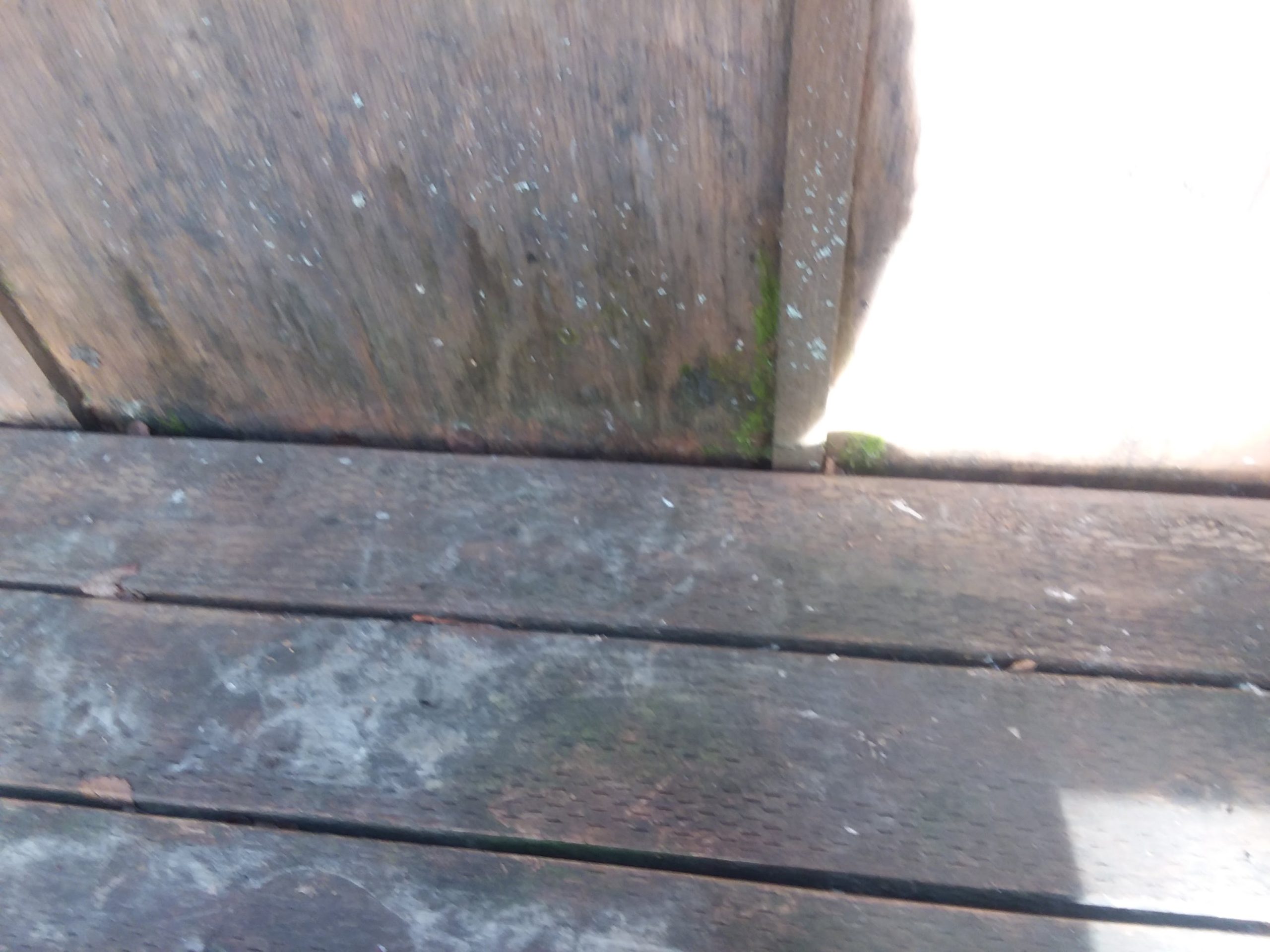

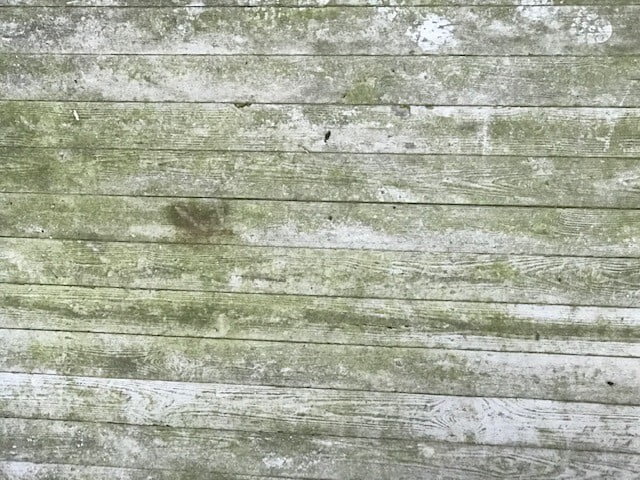

I have a two level deck on North side with towering pine trees nearby and a serious discoloration issue. I’d like to try to just clean it and see if I can get by another season before having to resurface again. (I spend more time working on this deck than enjoying it.) Can you provide recommendation?
Try this cleaner while pressure washing to remove the dirt, mildew, and algae: https://www.deckstainhelp.com/restore-a-deck-cleaner-system-review/

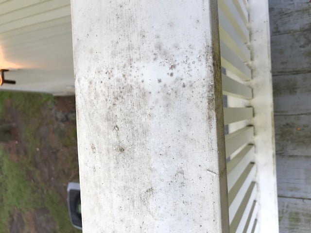

What to clean my white painted railings with yellow pollen stains on them and not ruin the white paint
Try warm water and dish soap with a soft car wash brush.

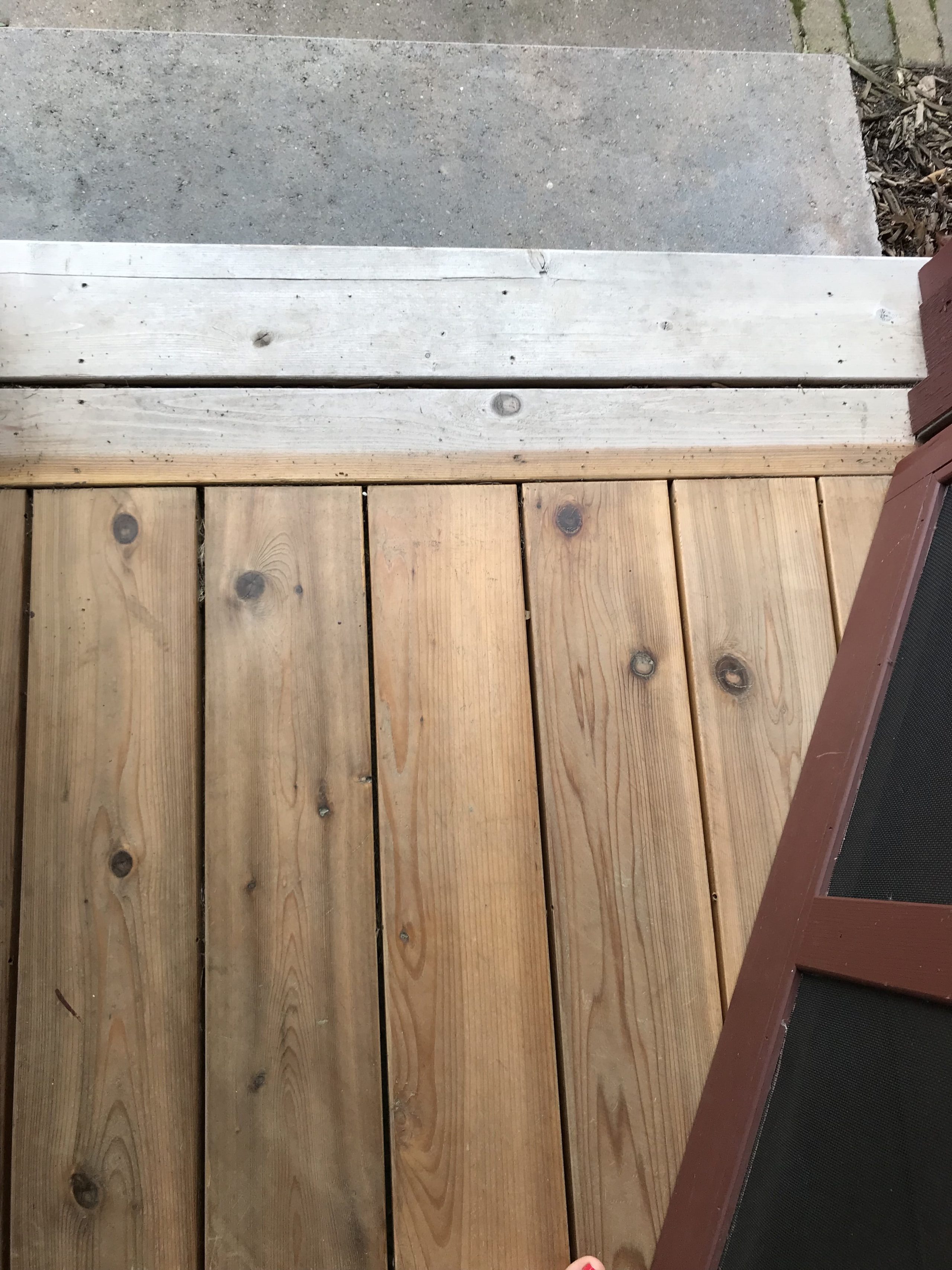

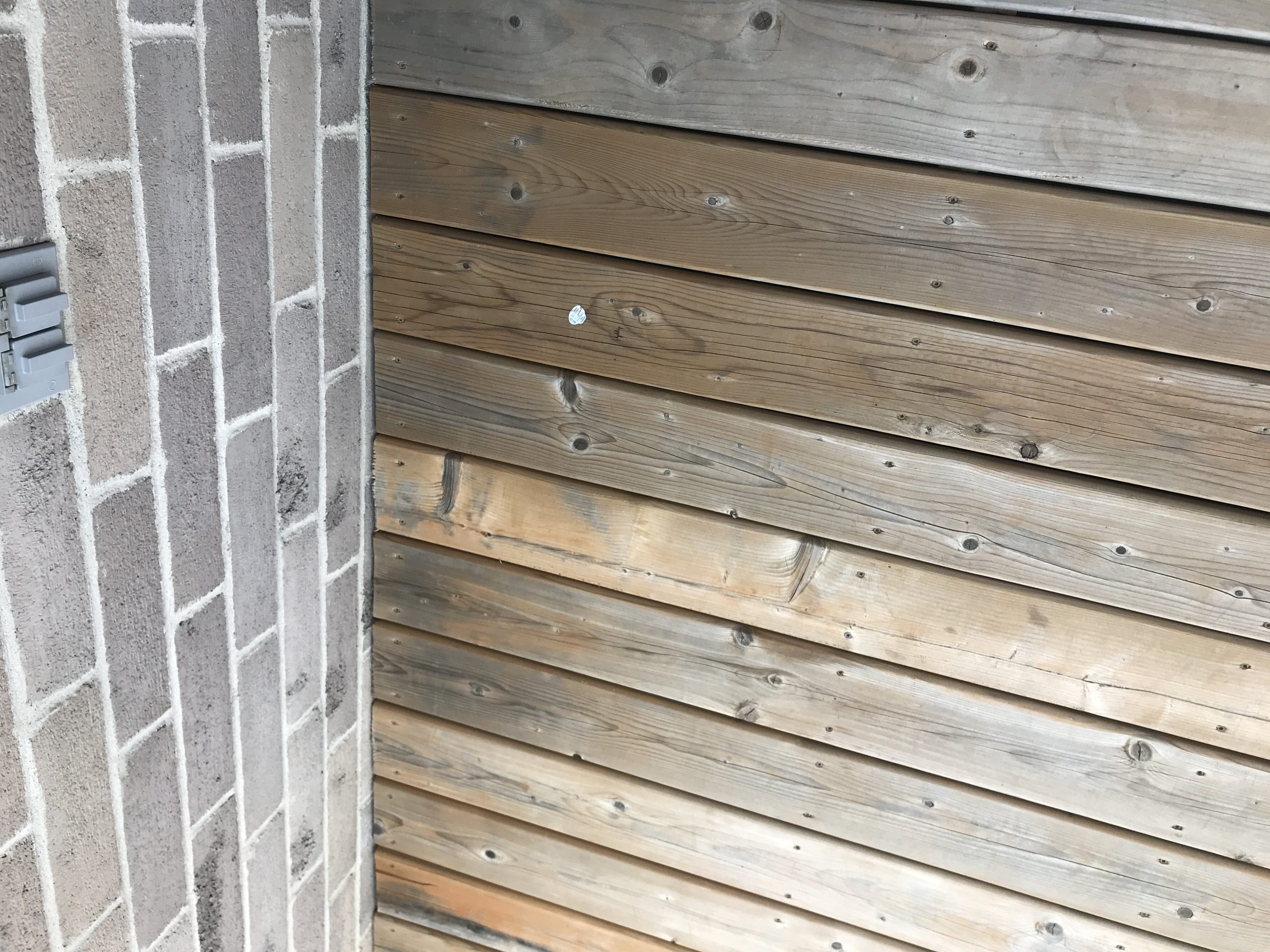

The natural wood stain is under a covered porch and the lighter wood is exposed to the outside. What should I use to clean and prepare for a new coat of Cabot’t ATO?
Here’s a picture

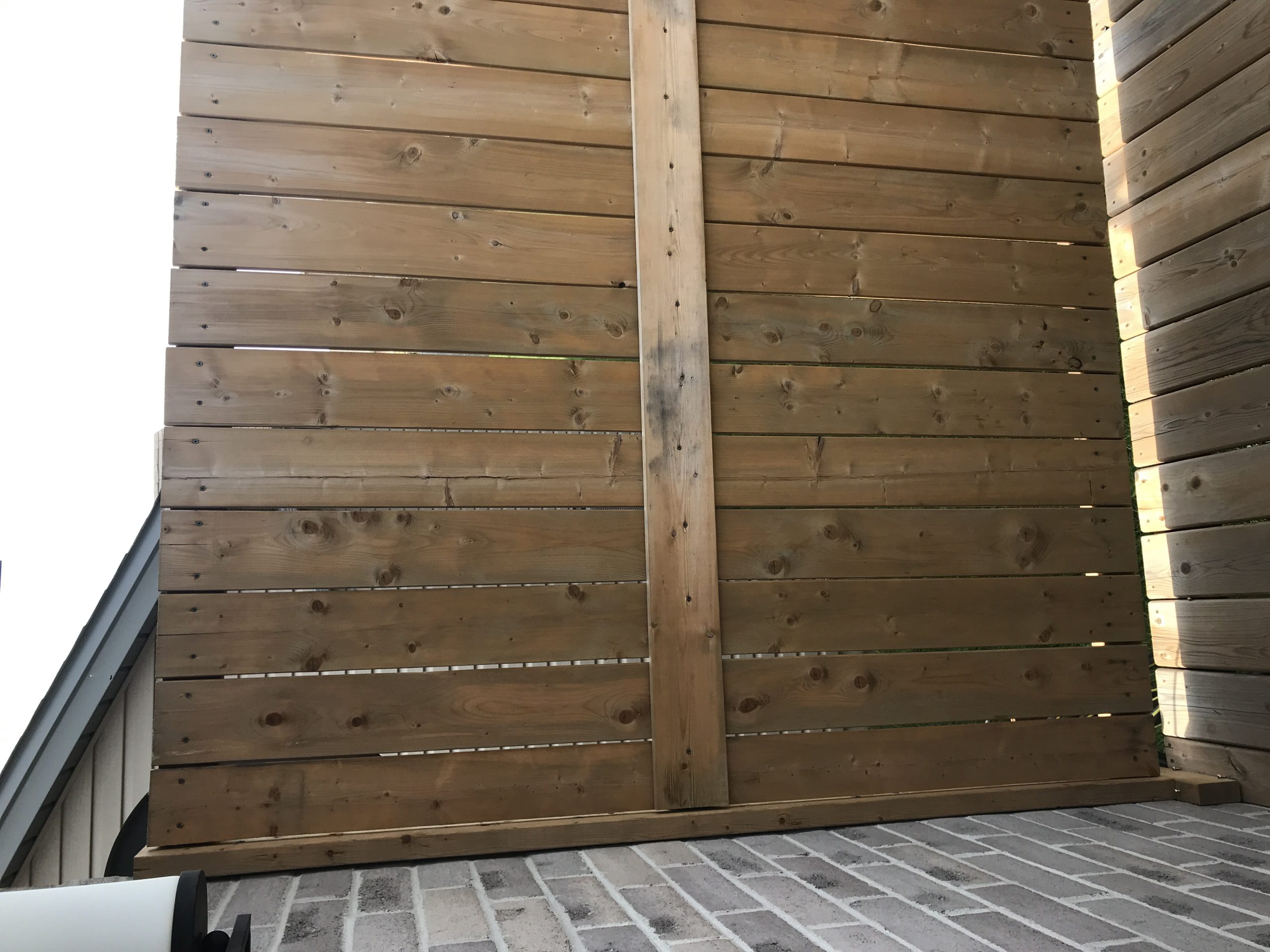

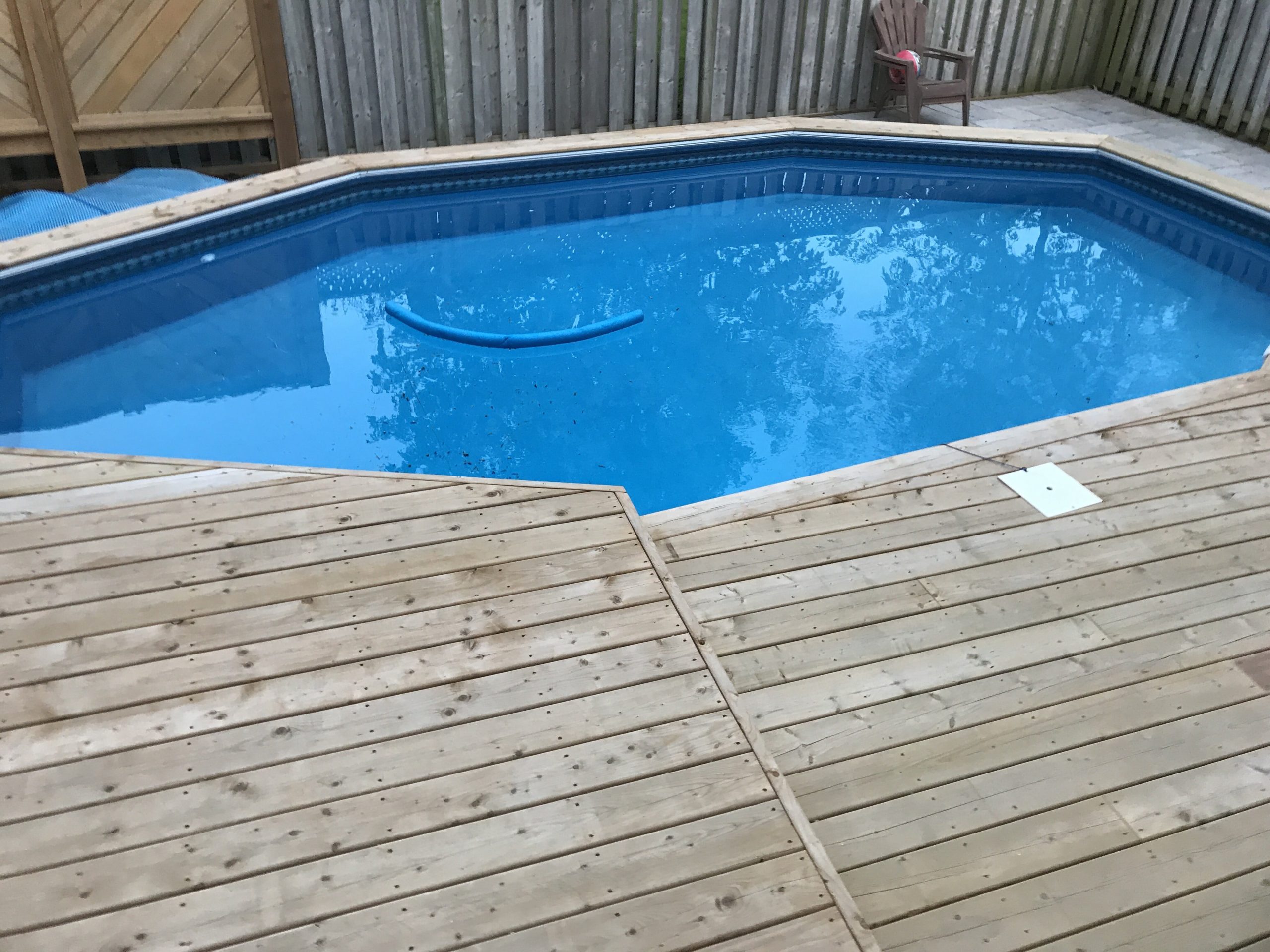

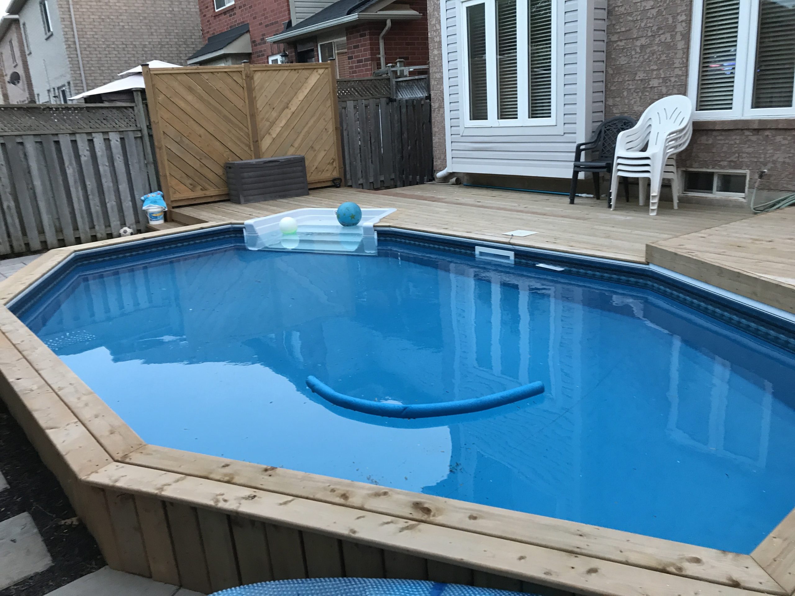

Installed pressure treated deck prior to last winter (7 months ago). Live here in Ontario Canada. Looking to seal / stain deck. How long do I wait and what is best product – we’re looking at Penofin transparent penetrating oil finish stain and sealer? Also, deck goes around outdoor pool
Penofin turns black. Try TWP 200 Series after prep.

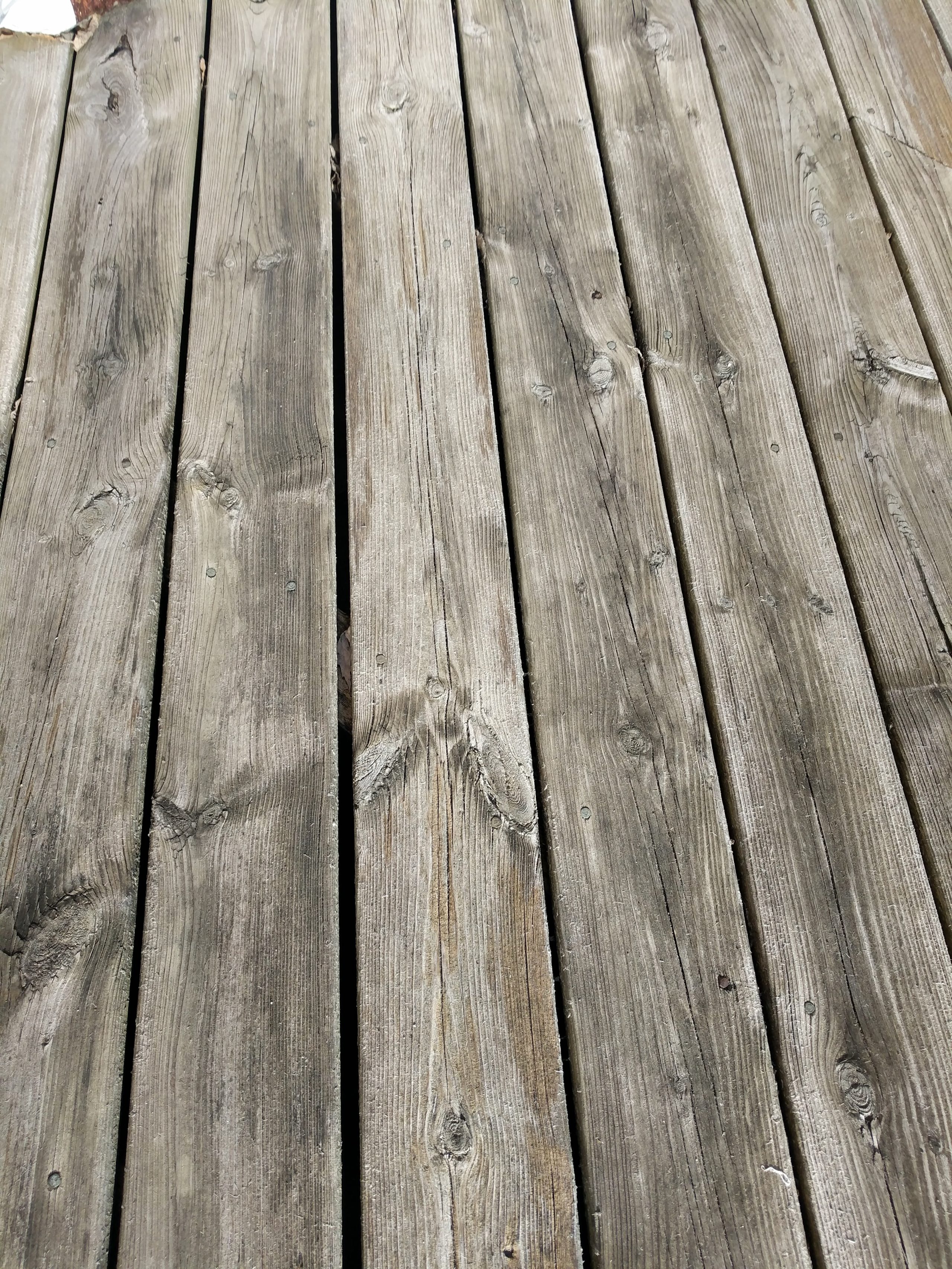

We have a 20’x20′ 19-year old pressure treated deck that has never been stained. Pictures attached. We receive full south facing sun most of the day. What do you recommend in terms of treatment and stain? Sand and then wash?
Thanks in advance for any advice and help.
No need to sand. Clean and brighten for the prep. Use Restore A Deck Kits. Stain with a penetrating semi-transparent stain like the Armstrong Clark or Restore A Deck Wood stains.

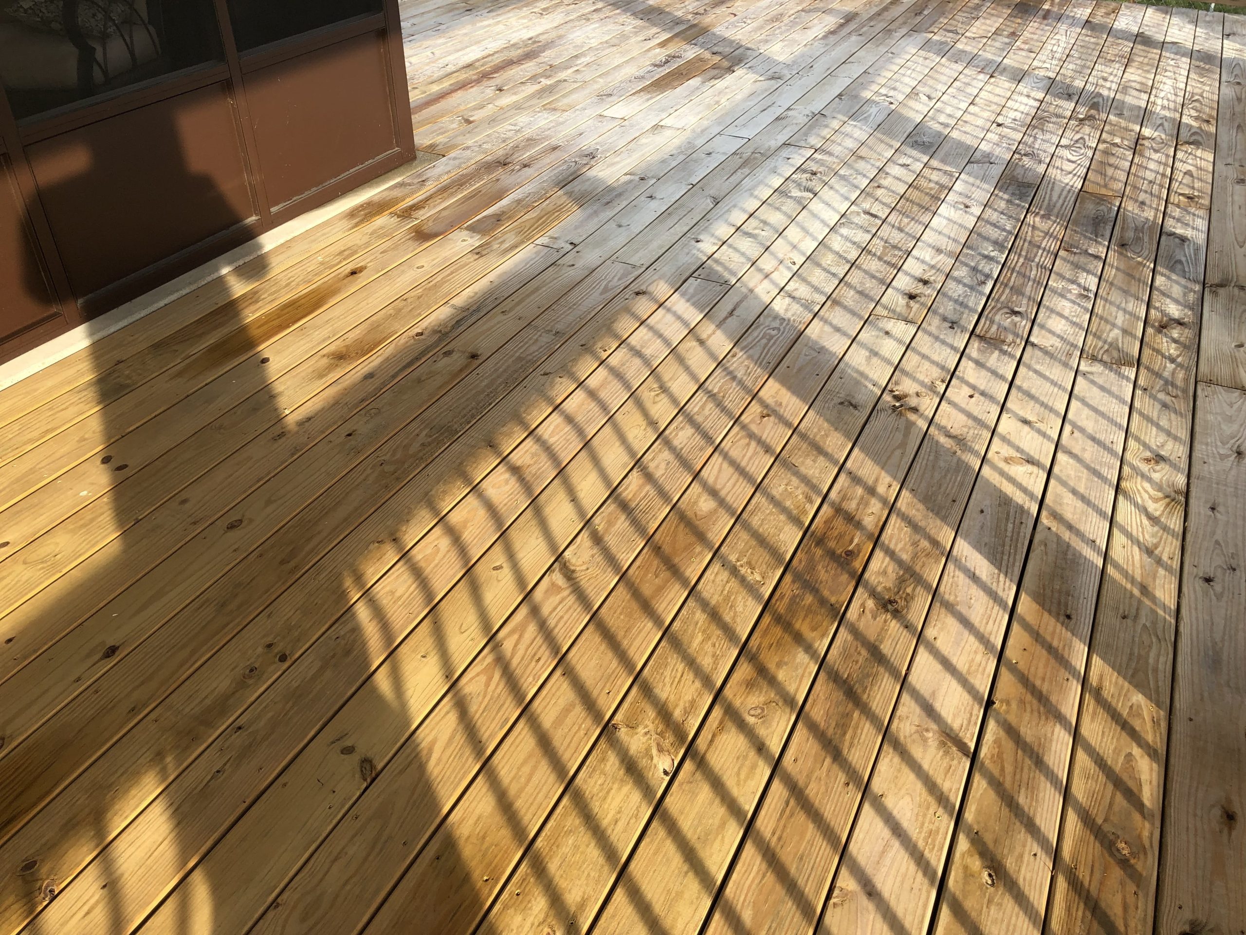

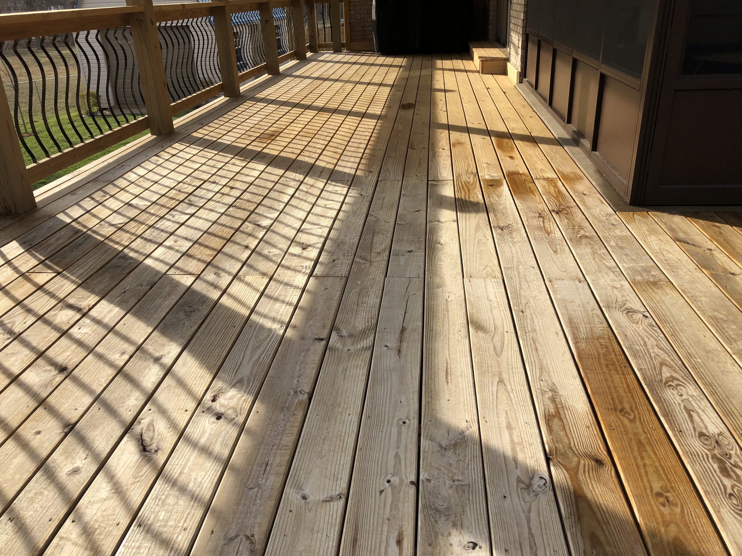

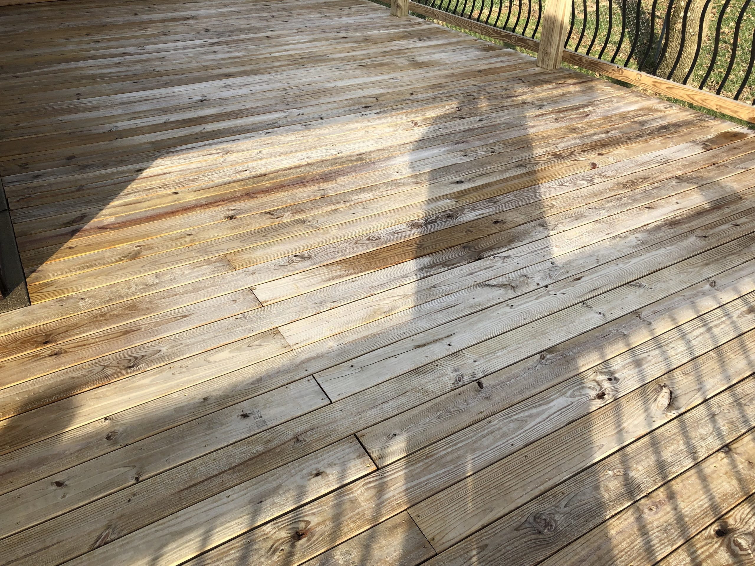

I had a guy pressure wash my 1 year old deck today so I can stain it. He used a soap and bleach mixture and said deck wash is just bleach anyway. Now my deck looks more white than natural wood color. Half my deck is covered so it still looks new. He’s willing to do whatever he needs to do to fix it. Can you make a recommendation to correct this. It’s white and sticky and has many wood fibers and fuzz on it also. How transparent of a stain should I use also so it matches where its covered and uncovered also. You can see the difference in the pics if they uploaded correctly.
To help even out the color, clean and brighten the wood again with the proper prep materials. Look at Restore A Deck Kits. Let dry and stain with Armstrong Clark or Restore A Deck Wood Stains. It will even out.
Clean and brighten the part that still looks new under the covered portion also?
Thanks for your help and just to be clear should we clean and brighten the entire deck including whats covered and still looks new?

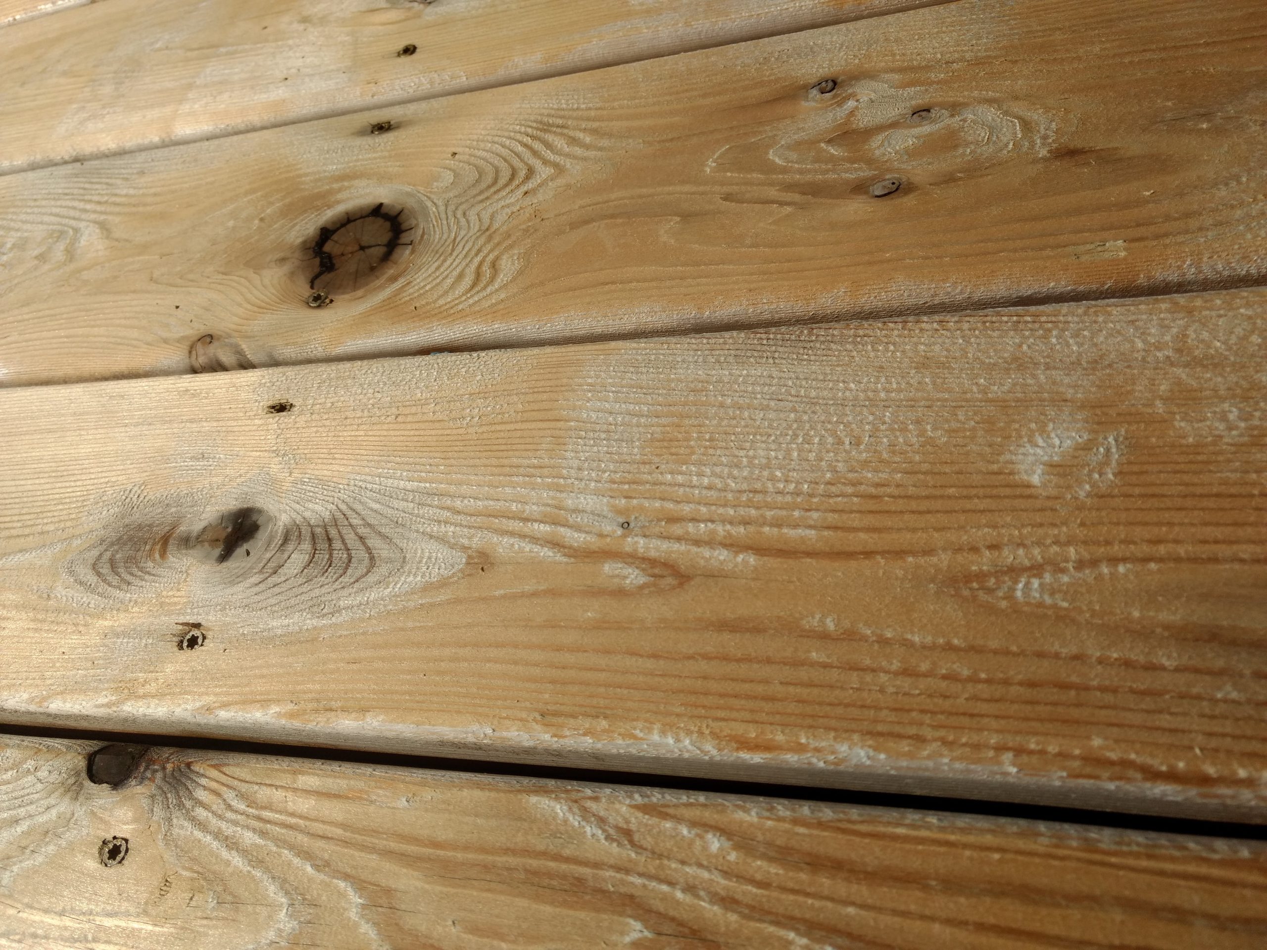

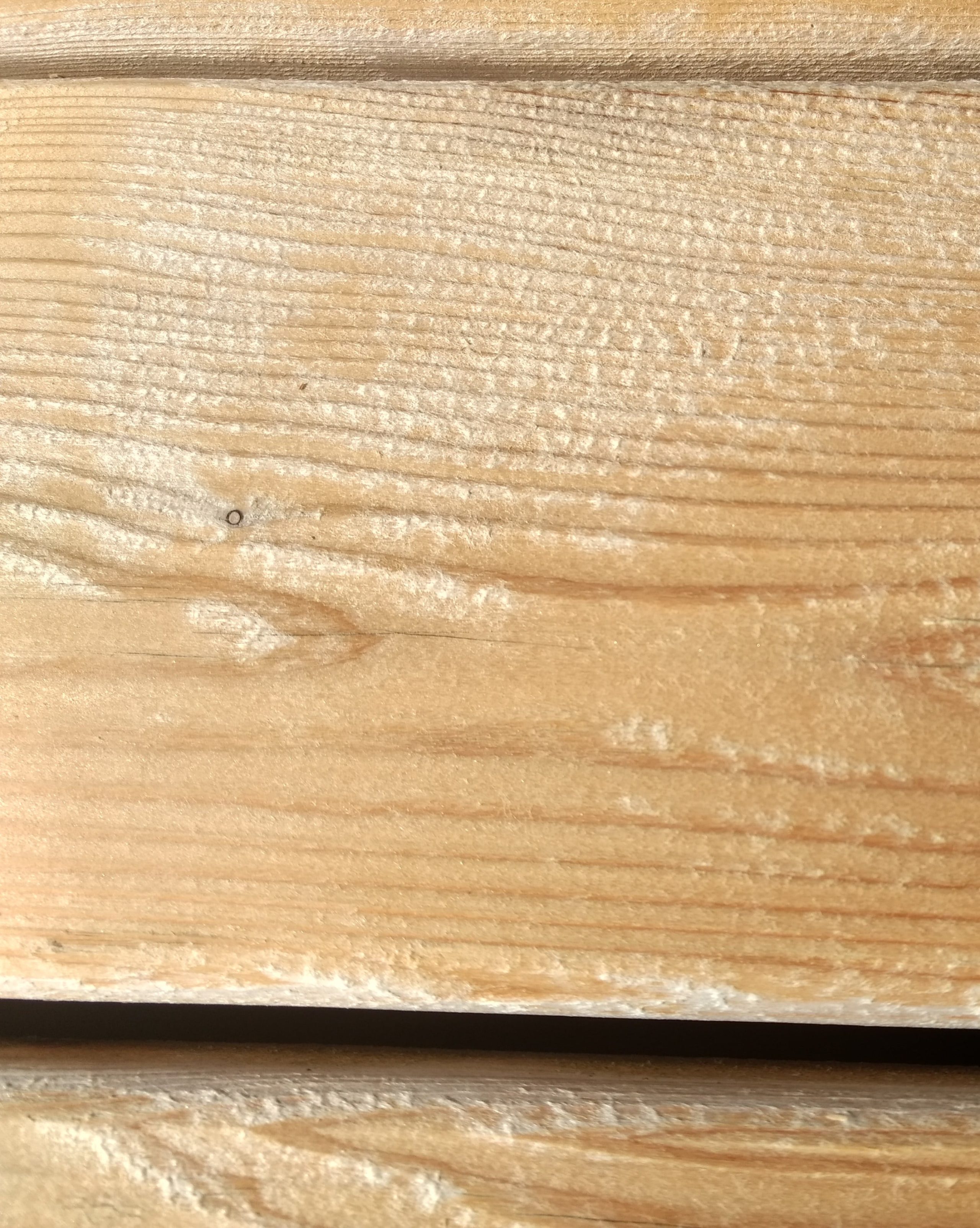

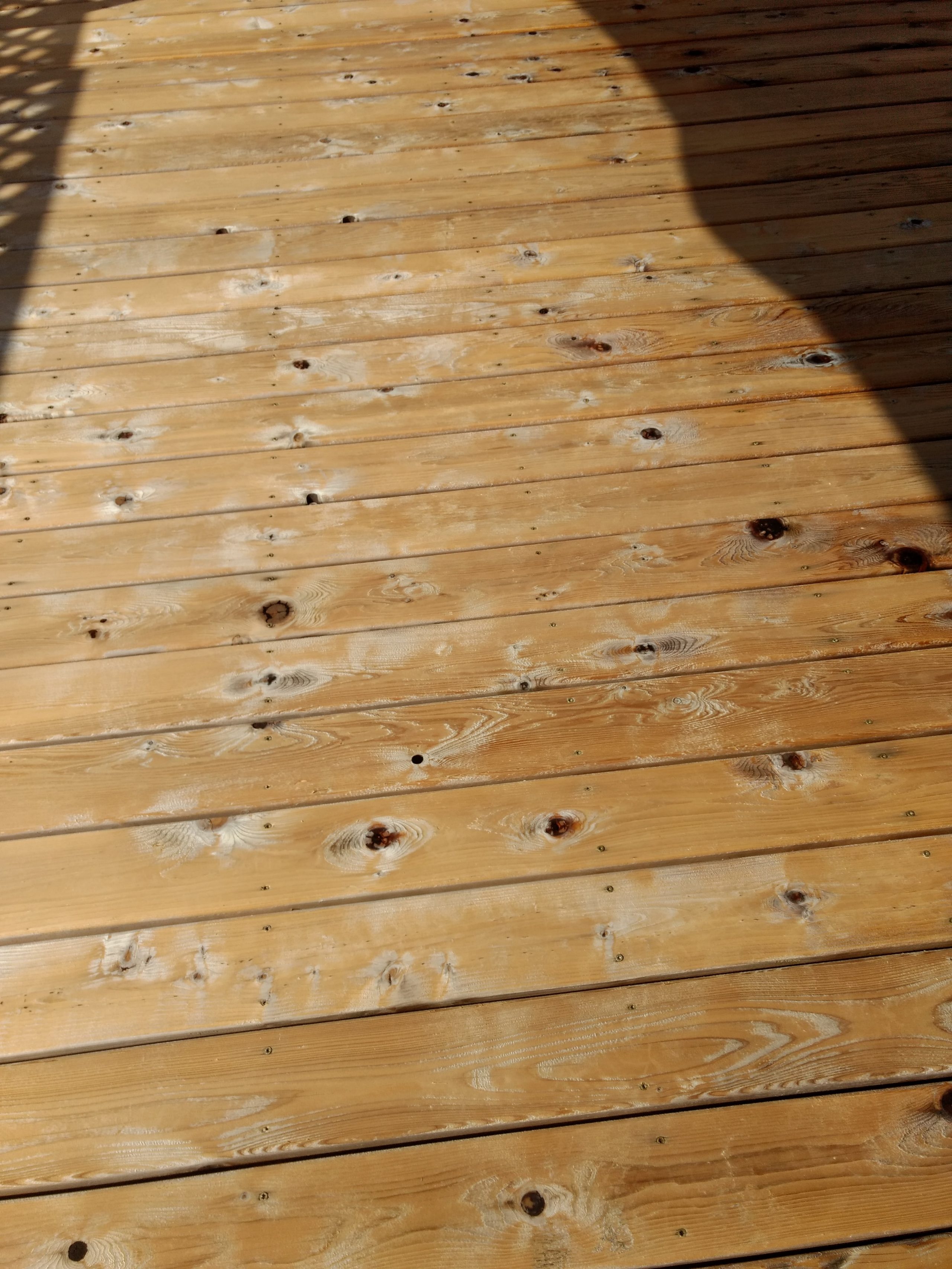

I used restore a deck cleaner and brightener today on my one year old unstained cedar deck. I plan on staining it next week with Armstrong Clark oil based stain. I vigorously scrubbed the deck with a stiff brush then went over it with a pressure washer as recommended then scrubbed again and rinsed. After applying brightener, my deck is still blotchy with white spots, particularly around area with knots, but also in other areas too. Do I need to repeat the cleaner scrubbing and brightener process, or can I stain it as is?
That is oxidation of the wood fibers that did not come off fully. It typically does not show when stained.
We have decided to sand the spots off with 80 grit. Should I reapply the cleaner and brightener afterwards to “open the pores” of the wood?
We are spot sanding the discoloration off with 80 grit. Do we need to reapply the cleaner and brightener after to “open the pores” and prep the mood for stain?
